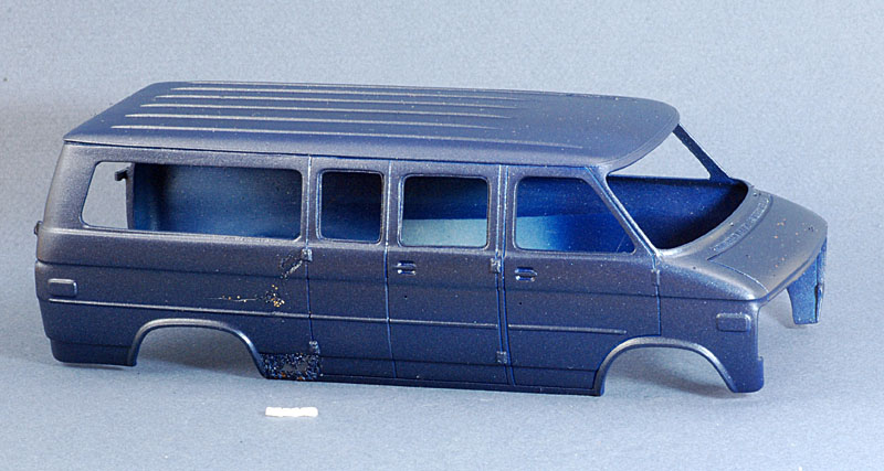

Well, the paint went on well, but my "easy to maintain" Iwata airbrush clogged as usual and in the end It won't even spray pure thinner! There is no other way they show to clean besides what I have done. A small brush in the hole for the paint cup comes out full of blue paint! The cheapo Testors airbrush I had before this didn't cause these troubles.

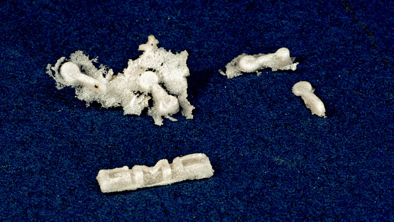

I also cast the GMC logo and some door handles using Acrylic fingernail filler per Custom Mike's post It's all at the link if you're interested. The jury is still out as to the smoothness of this material out of the mold. It sure is easy though. These are the pieces right out of the mold before any cleanup. There's two door handles in that big mass . eheh
