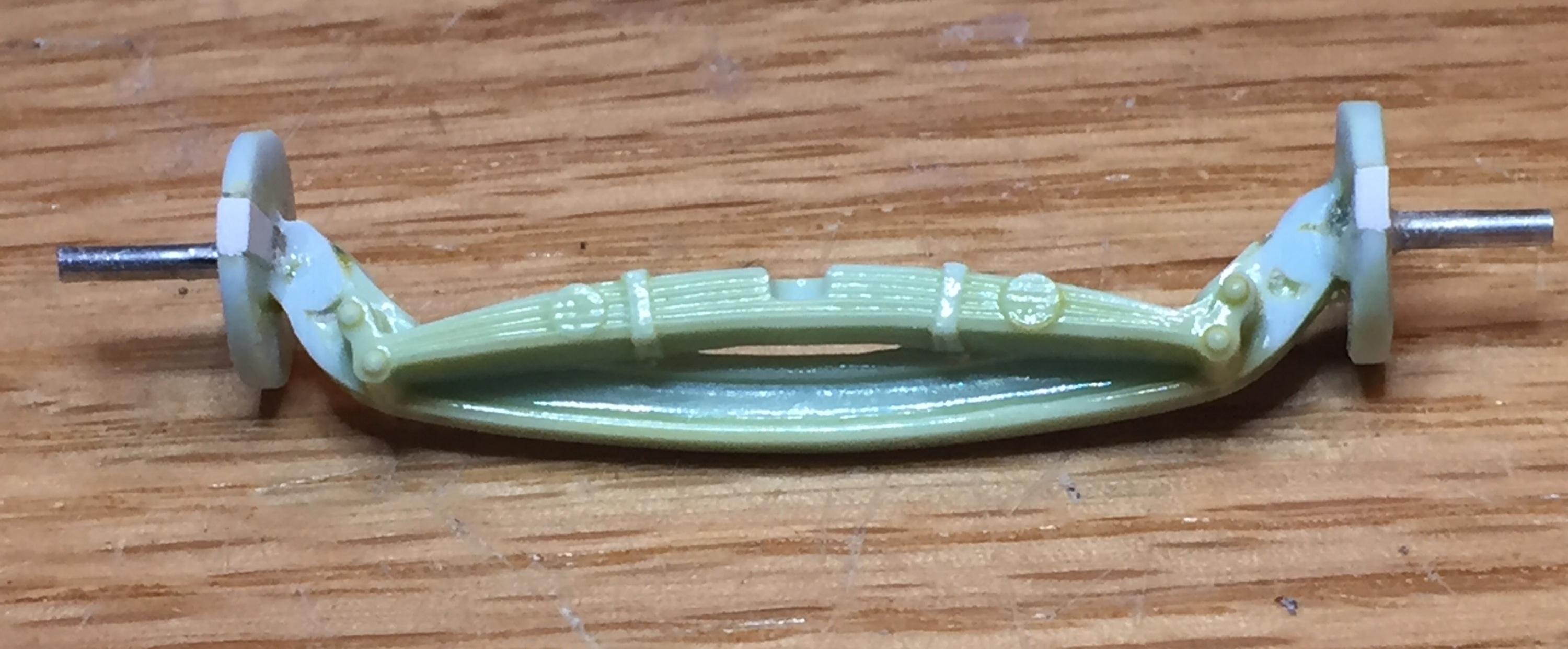

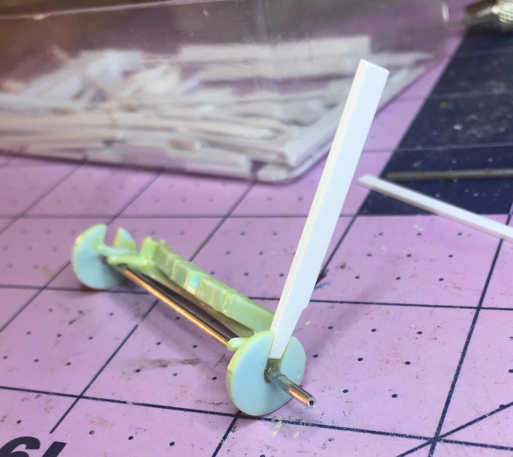

Jim, this axle was made from 3/32" evergreen tube for the axle and the axle ends. The spindles are 3/16" evergreen square tube cut off and then sliced to form a U. The axle ends are fitted to the inside of the U. The actual spindle in this case is K&S brass rod, 3/64". I cut up some stuff to show you. The pics show the raw pieces which need to be shaped and fitted. Your wheel choice will determine what rod or tube you use for the actual spindle. It ain't great but it's OK for a gasser. The thing to be careful with is drilling for the rod insertion on the ends. I'm sure you can figure that out. Then you need steering arms and a tie rod. It's all just evergreen and brass. This one isn't done yet, gotta dress it up more. Easy peasy.
