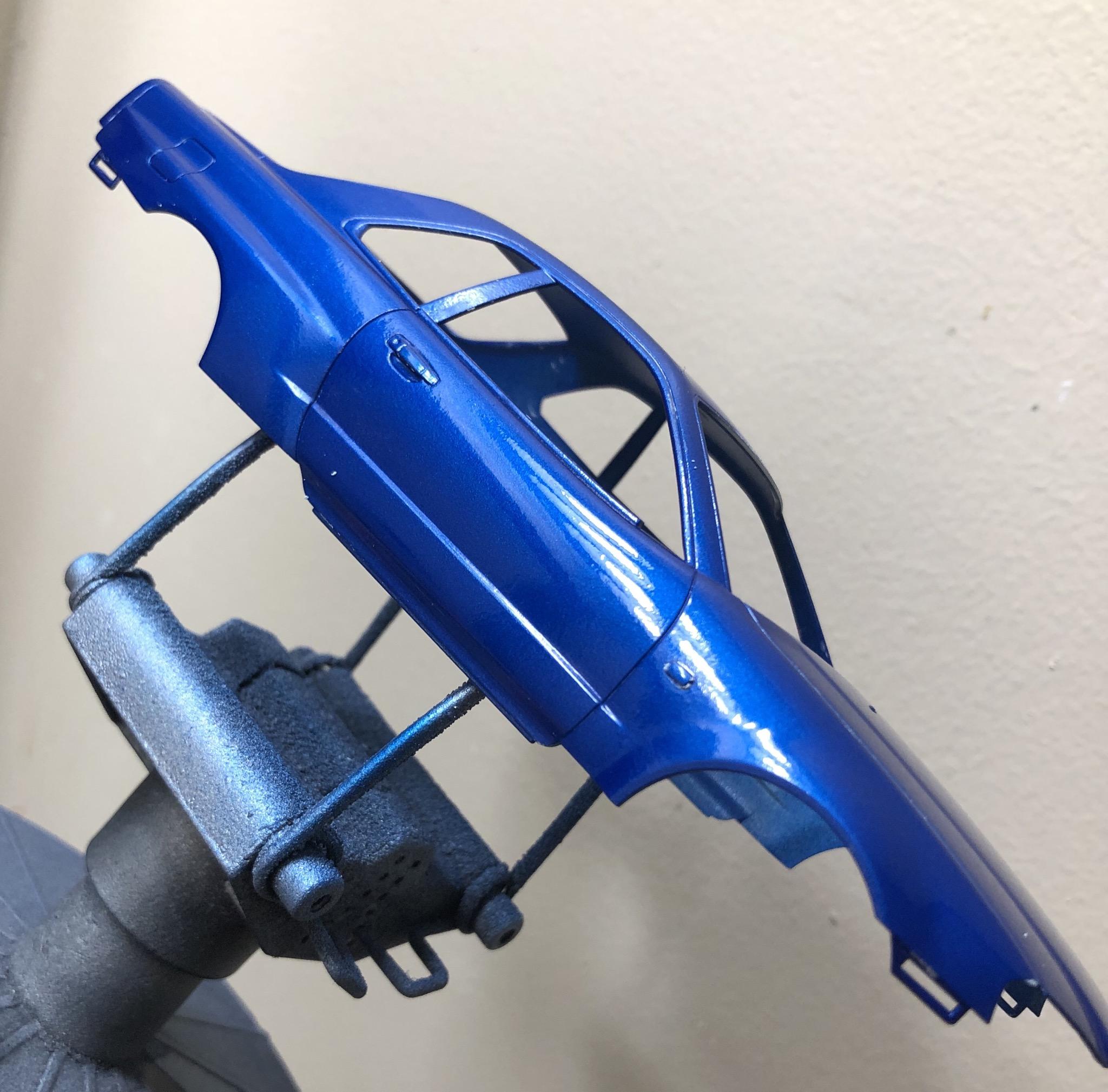

  5. Here’s the painted body. Pardon the wax residue. . It’s been a nerve racking job with this one because I had a lot of orange peel. I unfortunately realized I burned through the paint when polishing in a few spots.So it’s been a lot of back and forth of polishing and small resprays. So I carefully resprayed these areas last night with the airbrush. It was tempting to just chuck it in the brake fluid because you can usually tell with metallic paints where spots have been fixed but it came out pretty good. I also didn’t want to waste what would otherwise be a good paint job. I unfortunately chipped the paint pretty bad on the front bumper when I drilled into the fog light so I’ll be respraying that. That’s not as big of a pain because I still need to paint the spoiler.

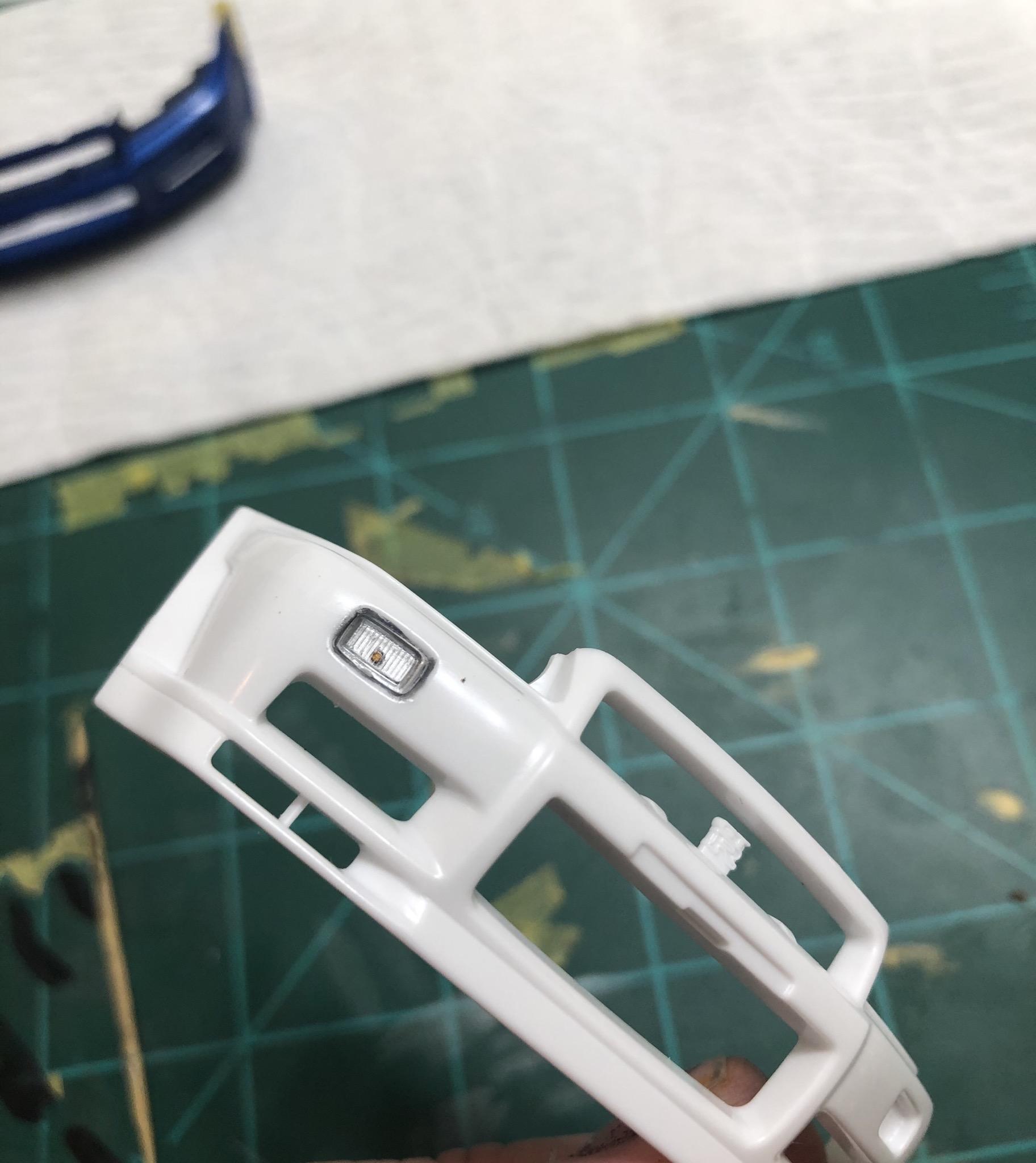

  8. Little experiment I’m testing with the front fog lights. This is a spare bumper I had. Painted the bucket of the light with Vallejo chrome then drilled and inserted plastic rod that was painted clear orange. The actual fog lights have an orange bulbs and chrome housing. You can see the painted bumper in the back.

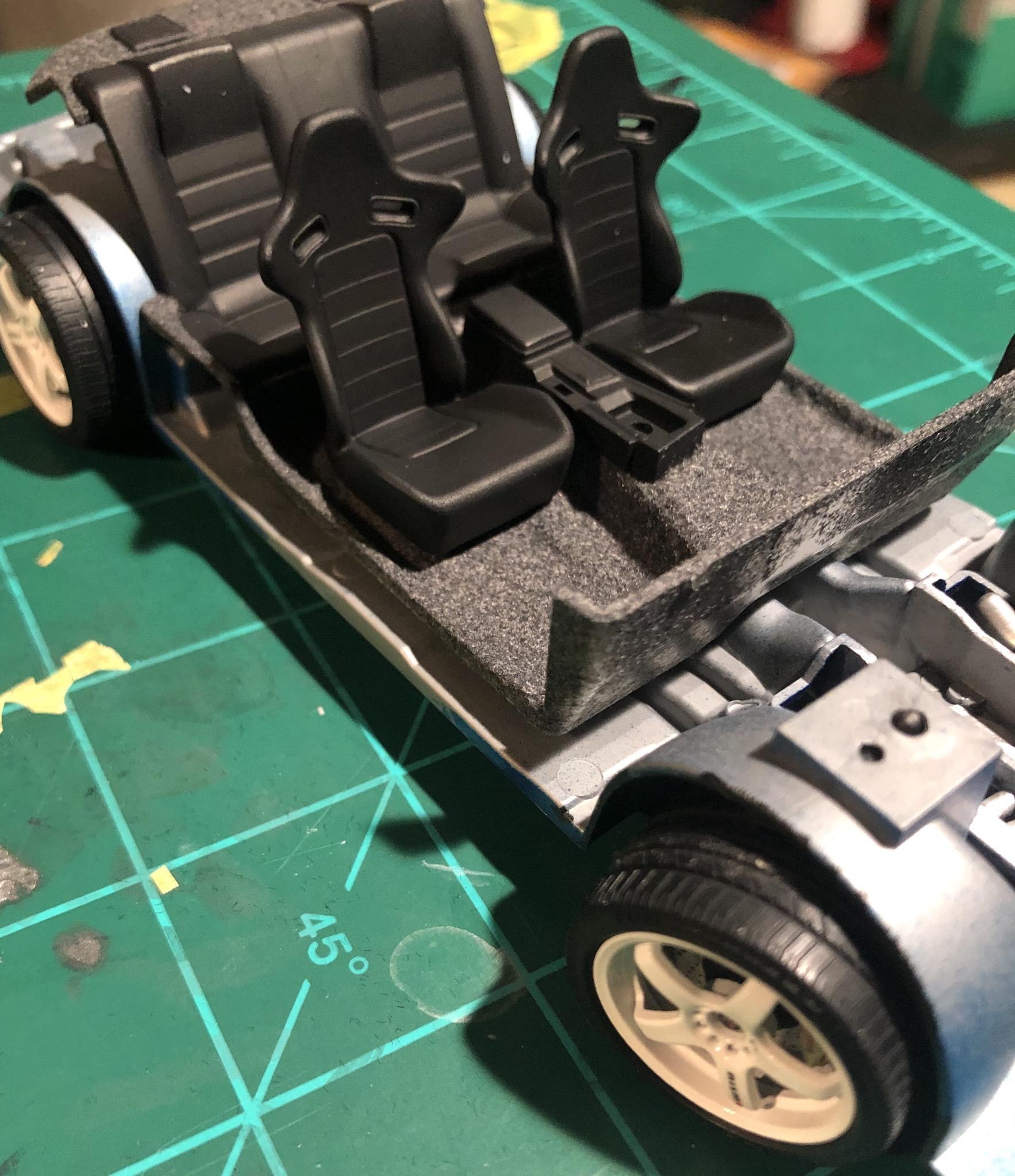

  11. Got the interior tub sprayed along with the the seats and door cards(not pictured). I sprayed the interior with Vallejo air black. I was originally going to do the typical two tone with a dark grey on the inside of the seats. However I found a really nice M-Spec R34 with a full black leather interior in my research and decided that would be nice on my version too. For the flocking I used detail master grey. I use spray adhesive to apply my flocking after masking the areas I don’t want covered. It takes a little more work and time than the white glue or enamel paint methods. But I tend to get better results this way. You might notice a few paint chips in the back seats from where I took the masking tape off. I’ll have to patch that with the air brush at some point. I also need to patch the area behind the center console with flocking. I’ll probably use white glue there.

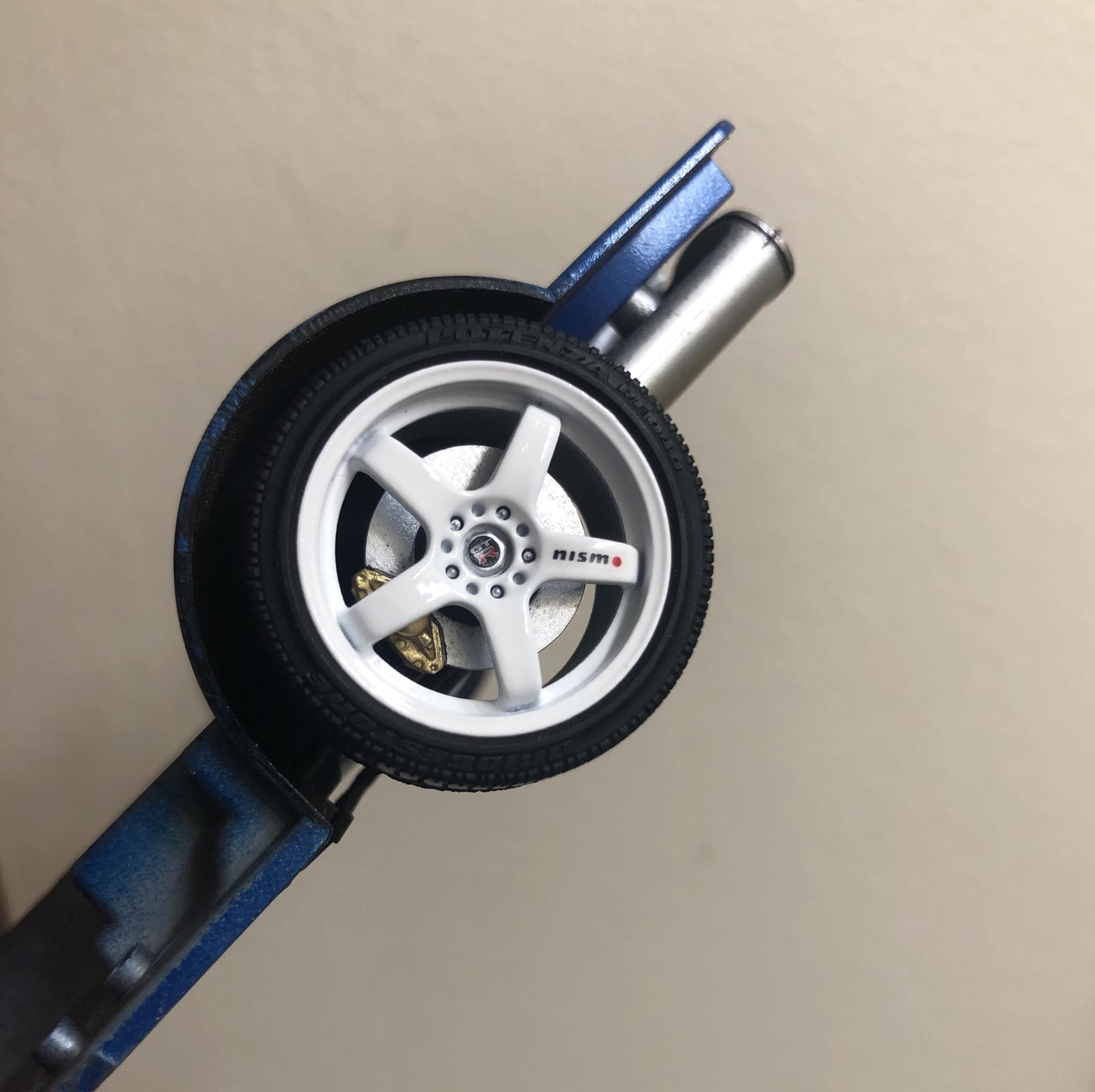

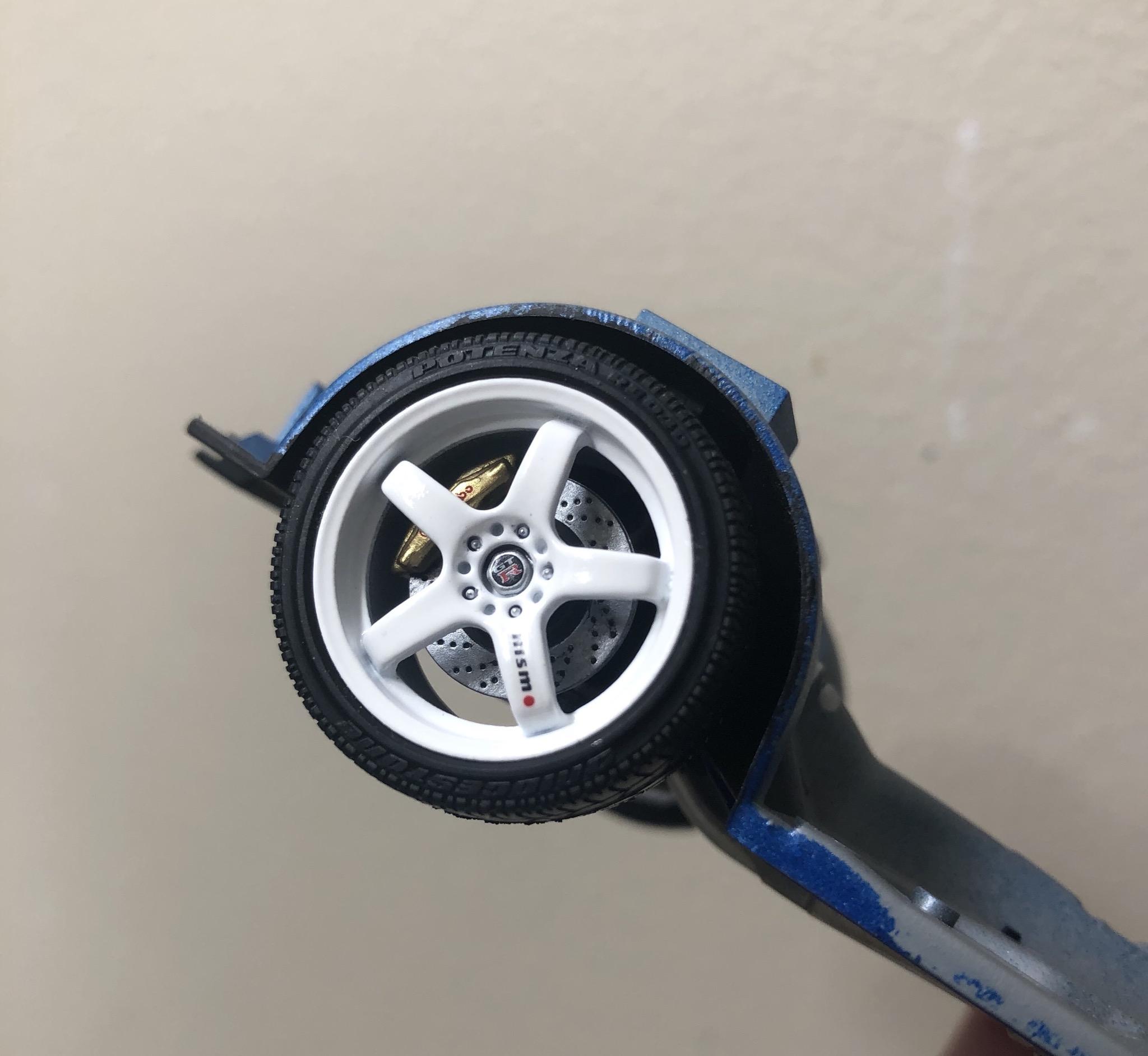

  12. Wheels painted and installed. This is Testors lacquer gloss white. I initially gave them a flat clear coat but realized they would look better glossed so I shot some ts-13 over them. Then used the kit decals. Center caps were painted Vallejo air silver with a brush. Micro Sol for the decal solution. Love the look of white wheels.

  15. Hey guys so this has been my official build of the quarantine. I’ve actually got a few going at the same time but this is one I’m most comfortable posting. This is an excellent kit. I’m going with the Bayside blue with white nismo wheels. I’ve got the body painted in Tamiya mica blue and I’m currently in the polishing process with that. However I just finished the under carriage. Still need to add the exhaust tip but it’s coming. So I painted underside with Tamiya mica blue. Gave it a light clear coat. The wheel wells and gas tank are painted with Vallejo black with a brush. The engine and the other molded in silver bits were painted with Vallejo air silver with a brush also. It’s a god send of a paint because it doesn’t leave brush strokes. Ive taken quite a liking to painting the underside of car kits now. It’s usually the first or second thing I do. It’s an enjoyable process and lets me treat the whole kit like a work of art. It’s also forgiving because of weathering. Suspension pieces were airbrushed with Vallejo air black and the bolts were picked out with a tooth pick with some silver. The exhaust is Model Master Aluminum plate buffed. I then used a little bit of some weathering powder and used Tamiya panel line accent on just about everything to define the parts better. I used the optional nismo brakes and am quite pleased with how they came out. They have a nice sheen. This is MM aluminum plate, buffed, no clear. I then used Vallejo gold with a brush for the calipers and used and acrylic wash to define the drilled brakes. I then used a q tip to shine up the rotor again. Probably not quite as good as a PE part but it’s a lot cheaper! Need to retouch the black a bit though. That’s it so far. Interior up next. Thanks
