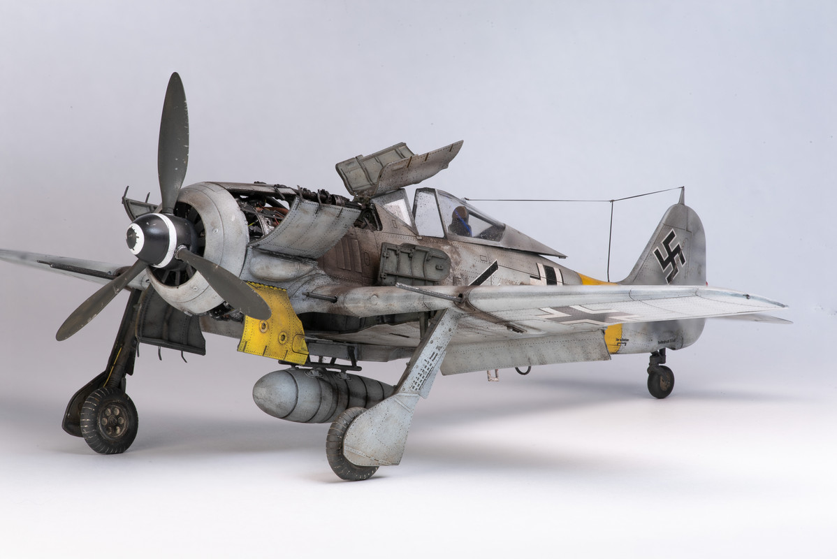

The last couple of days at the bench have been spent on re-working the engine cowlings. These are two piece panels that are hinged in the middle to give two folding leafs to gain more access to the engine area on both sides of the engine. Dragon has put both leafs together to make a single opening panel. What I did was cleaned up the injector pin marks on the inside of the panels and cut about 80% of the way through the join of the two panels to give the proper open look of these panels. Untouched panel on the left and the modified panel on the right. I started by making passes through the join line with an X-Acto knife and when I got most of the way through the panel I used the troweling tool to make a V into the plastic to where the bottom panel could be opened and glued to the top panel with a clean joint.

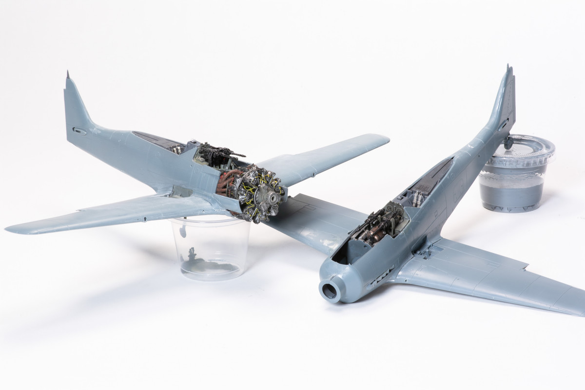

No color applied yet but believe it or not there's been a ton of work going on as of late. The wings are now mated with the aircraft and after a LOT of working them in with the fuselage by way of sanding and filling, I'm about done except where the wing roots join the fuselage at the top of the wing at the leading edges (you can see the putty at the wing root). All I have to do is work that in and that part will be complete. I also got the nose piece attached to the front of the aircraft and after looking at the prop and spinner out of the Dragon kit and not liking what I saw, I went with the ZM prop assembly and spinner. This was a massive improvement because the spinner in the Dragon kit is the wrong shape and size and the blades on the ZM kit are proportioned more accurately than those that the Dragon kit offers. Next up, engine cowling and landing gear door prep and then I think we're off to masking the engine & cockpit off for color.

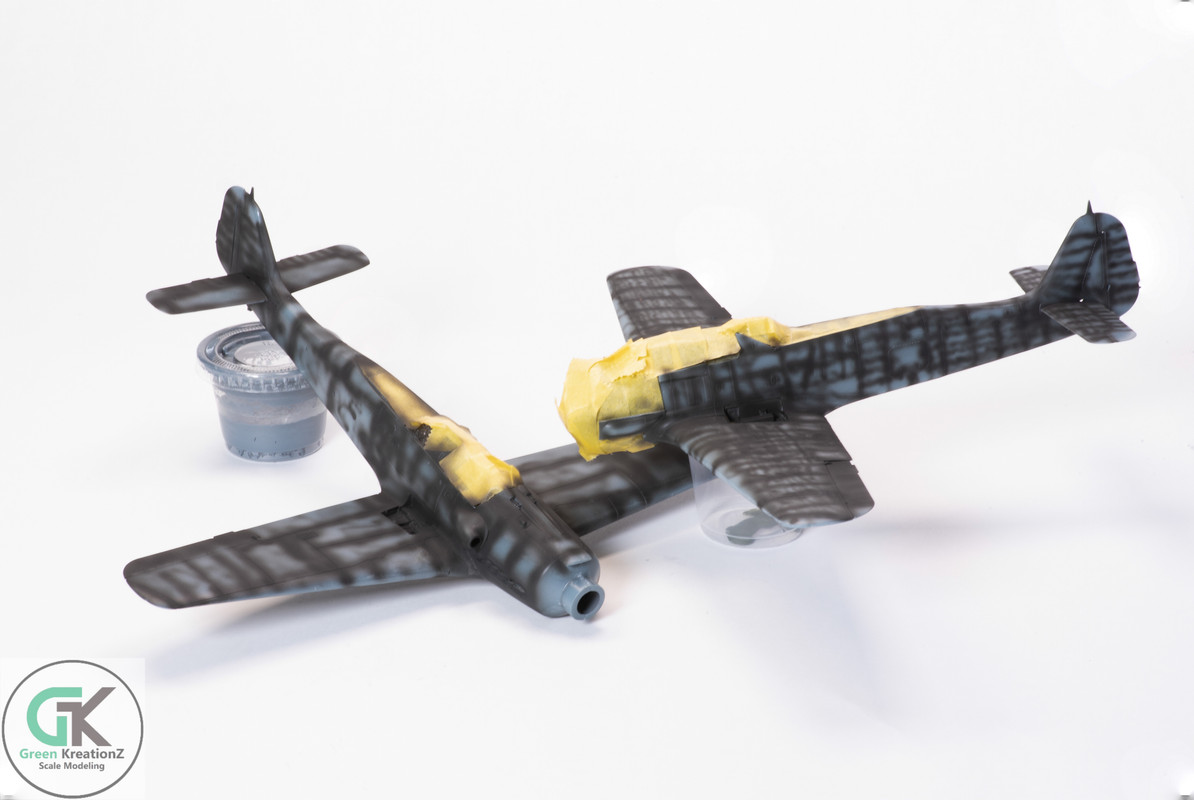

I've now applied the marbling to the black primer and will be working on getting the cockpit and engine into place so I can marry the wings and fuselage and do all of the necessary body work. A little backwards from the normal building and painting processes but I wanted to minimize handling with the pit and engine in place.
