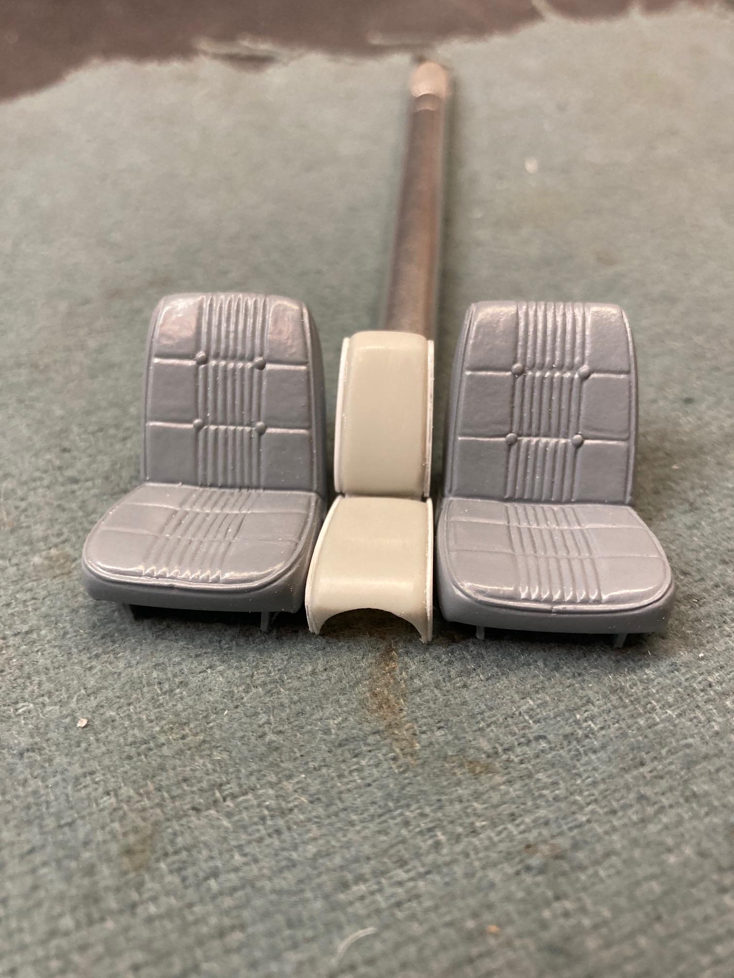

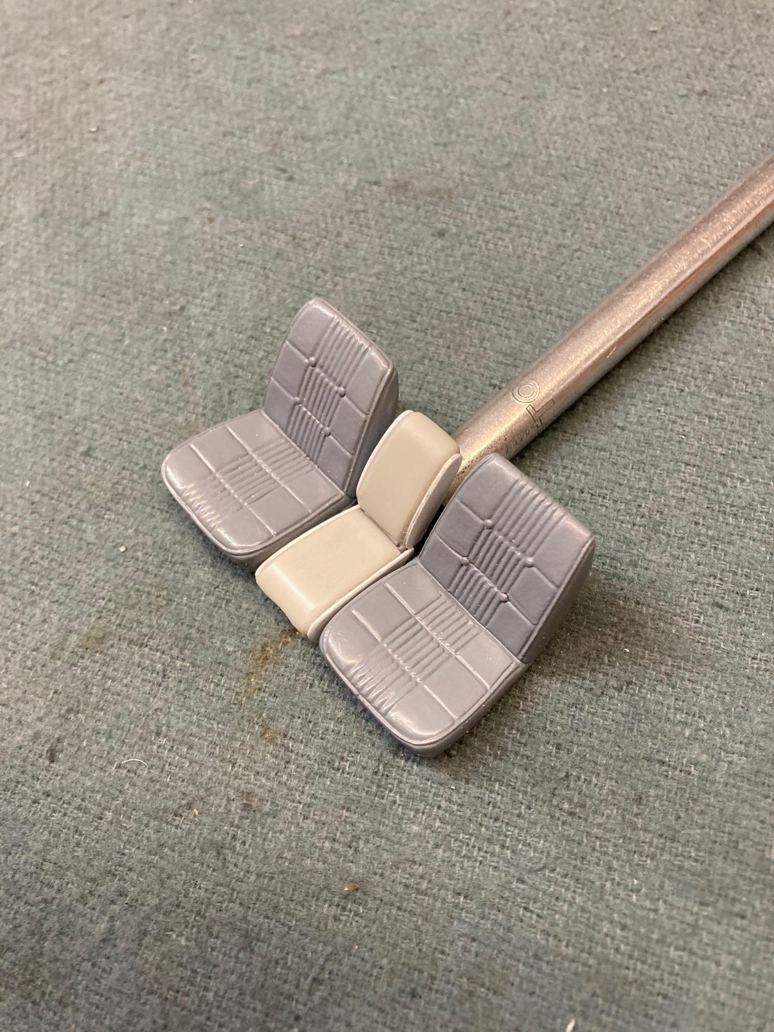

Haven't had much time to spend in the shop lately, but I think I've finally finished up all of the interior parts, which means that the interior should be ready for paint!! The last parts to scratch build were the gas, brake and emergency brake pedals and the brake release handle. Steve
