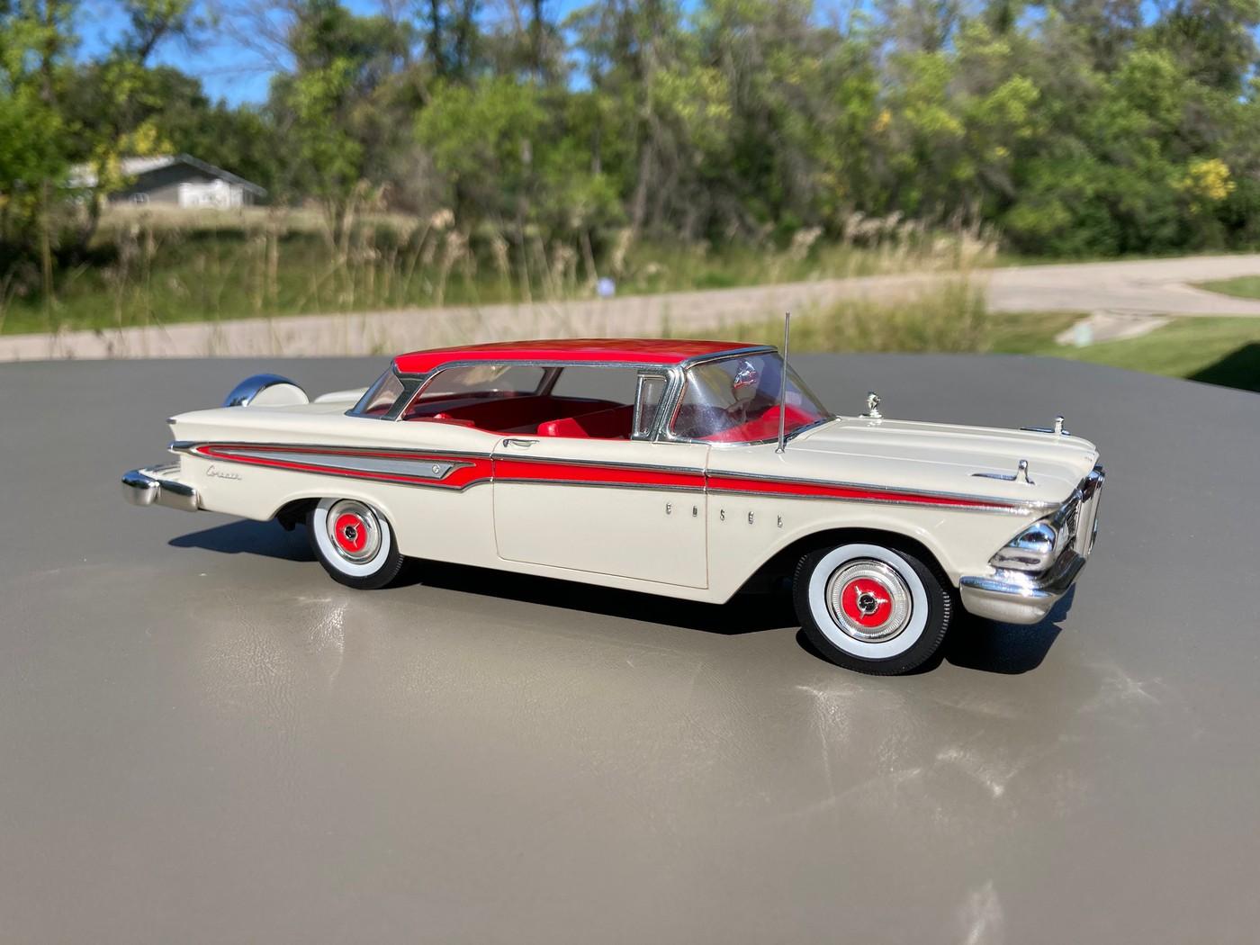

My guess would be that it's not terrifically rare, albeit it has certainly become much more difficult to find and exceedingly more expensive in recent years. I'm not entirely certain about the convertible, but the hard top version was re-released in the early 60s as a "Junior", snap style kit, which would cut into the '59 Edsel's overall rarity. This one was built from the "Trophy Series" kit. Steve

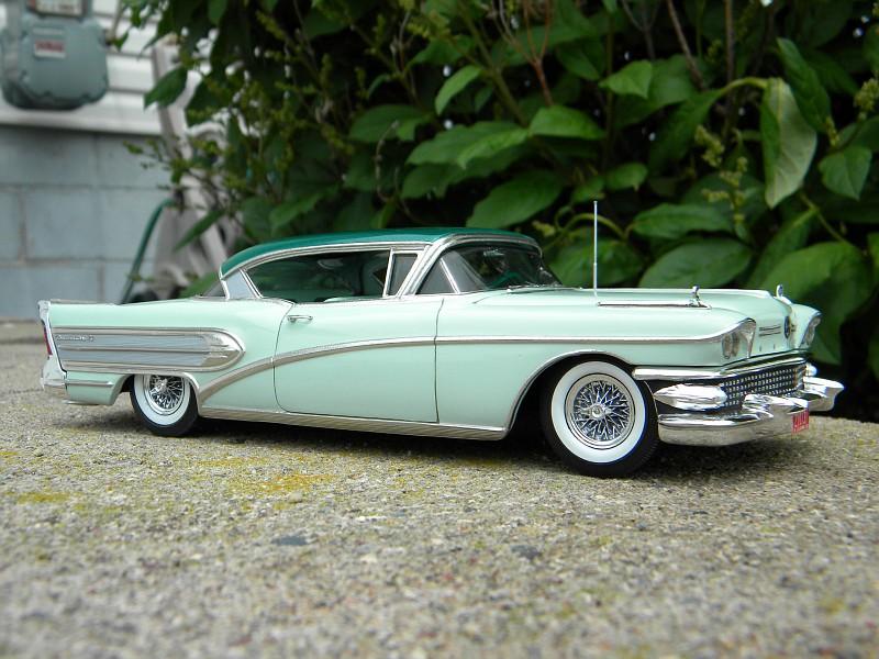

Yes, it is in fact a ‘58 Mercury. Unfortunately, the ‘58 Mercury was never produced in kit form, however, it was produced in resin by Modelhaus at one point. Unfortunately, Modelhaus kits have often become even more expensive than some of the originals that they copied, and even more so for kits like this that were never produced in plastic. Steve
