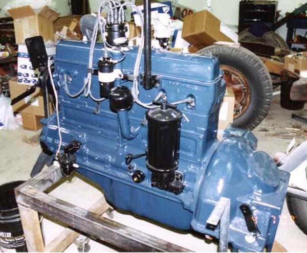

Scratchbashing the Blue Diamond
landman replied to landman's topic in WIP: Model Trucks: Big Rigs and Heavy Equipment

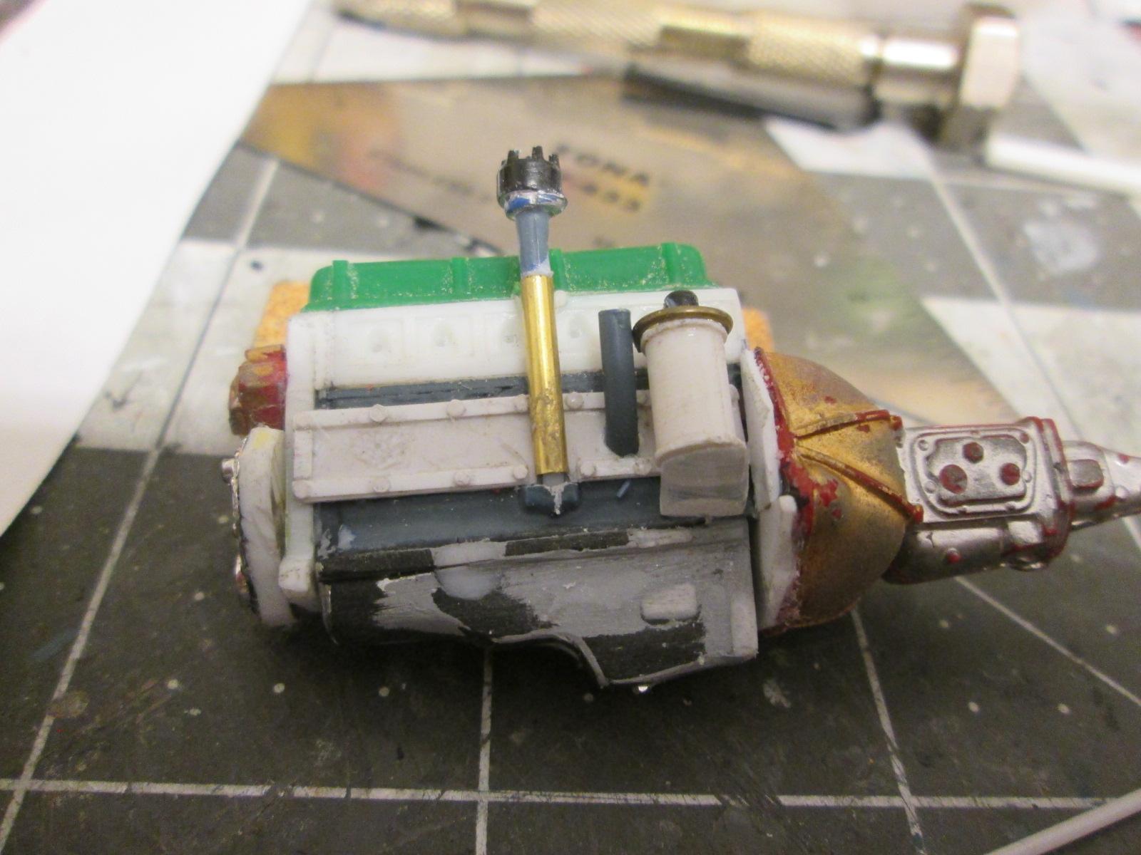

Thanks guys. Wayne, I don't know about great. I think coarse might be more appropriate. But I think it is beginning to look similar to the 1:1, notice I said similar.Oil filter is too big, so is distributor shaft. Will see about those. It is fun though. -

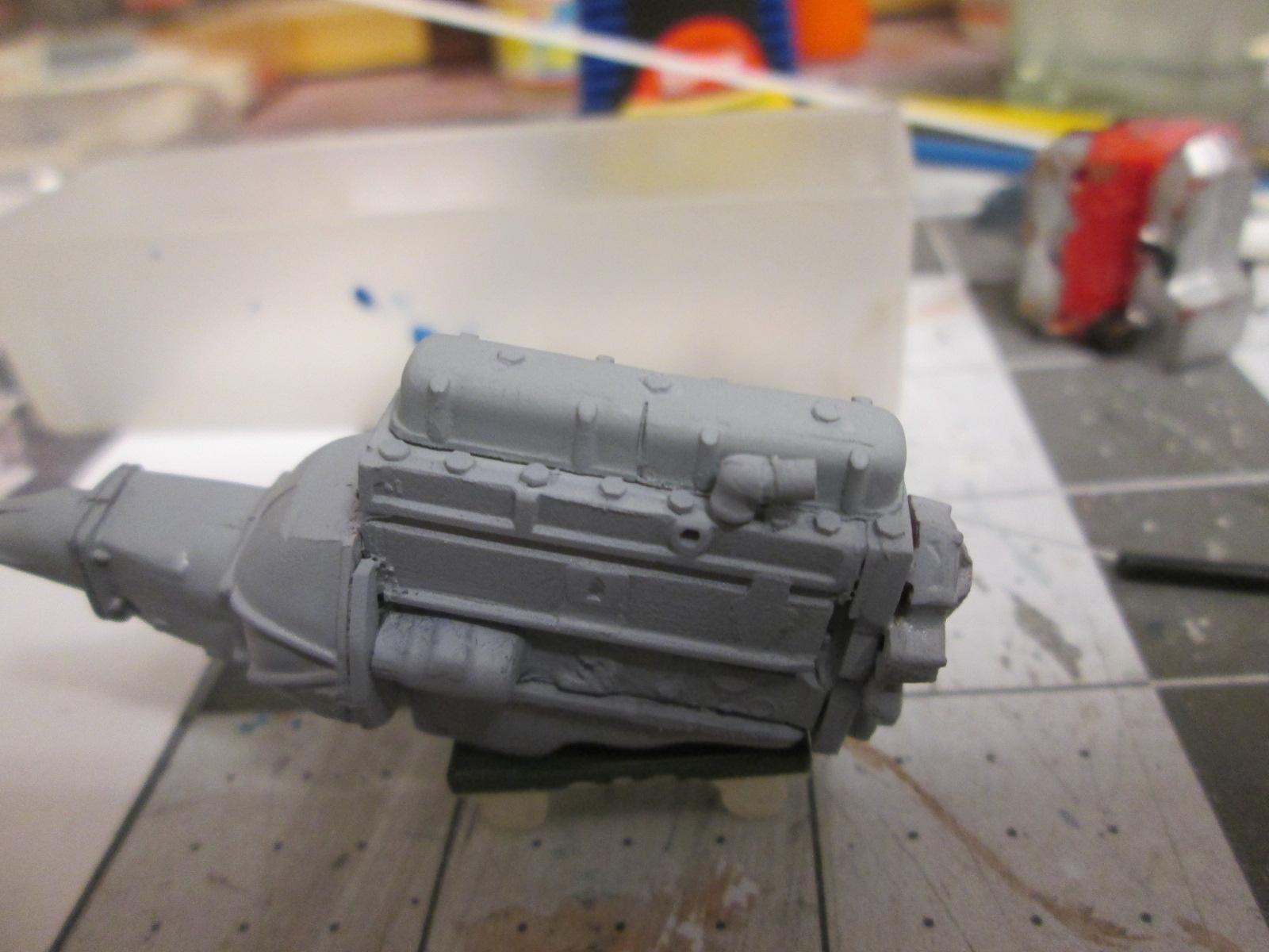

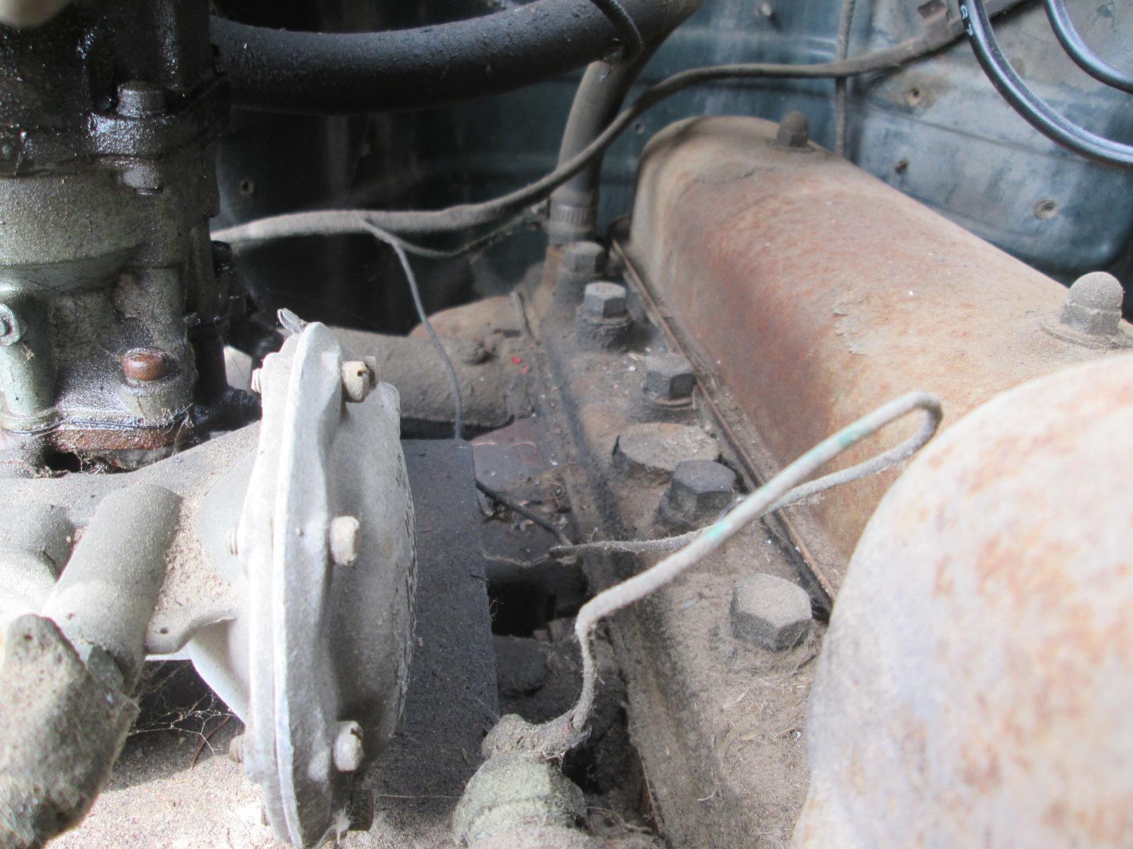

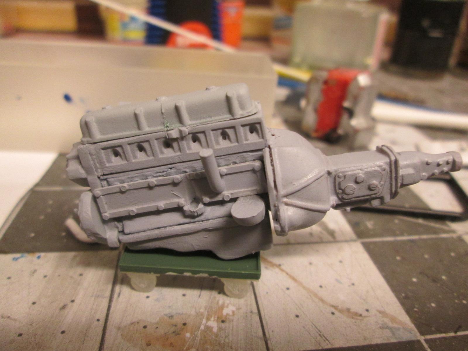

Added what looks like a cam cover to one side. The valve cover doesn't cover the whole head on these engines. there is a row of headbolts visible on the passenger side. Cobbled up a canister oil filter. -

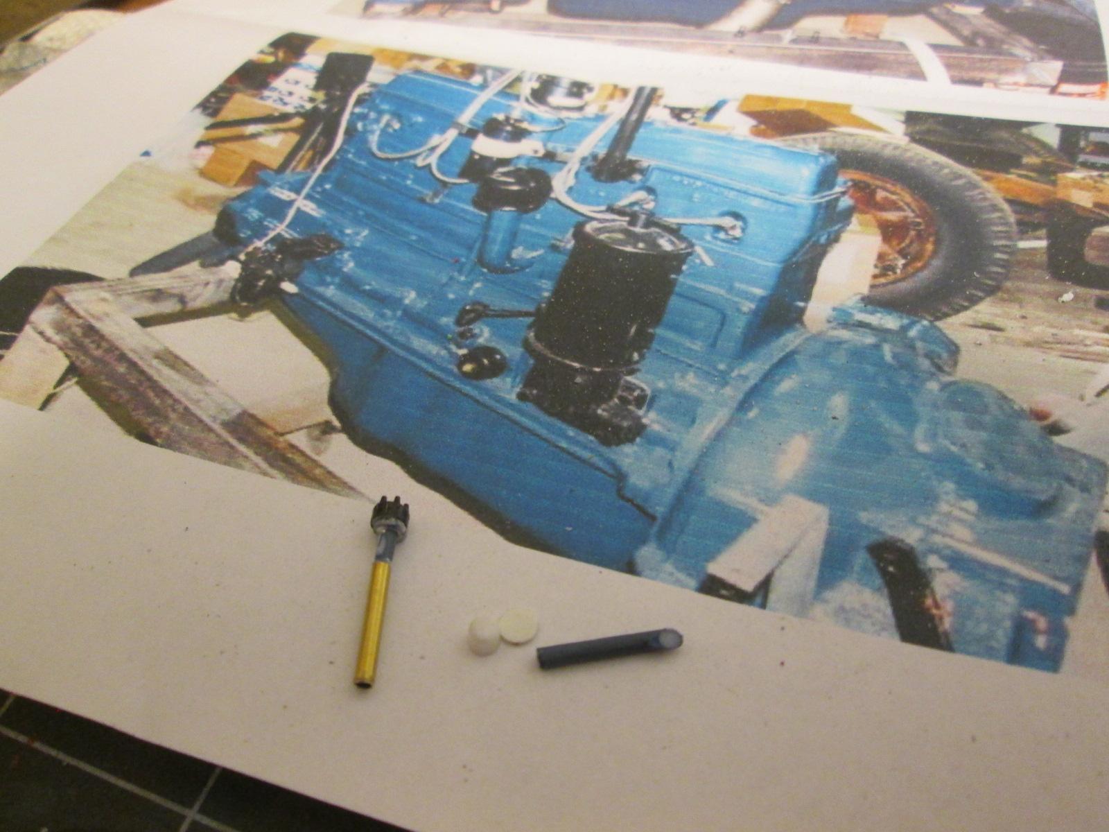

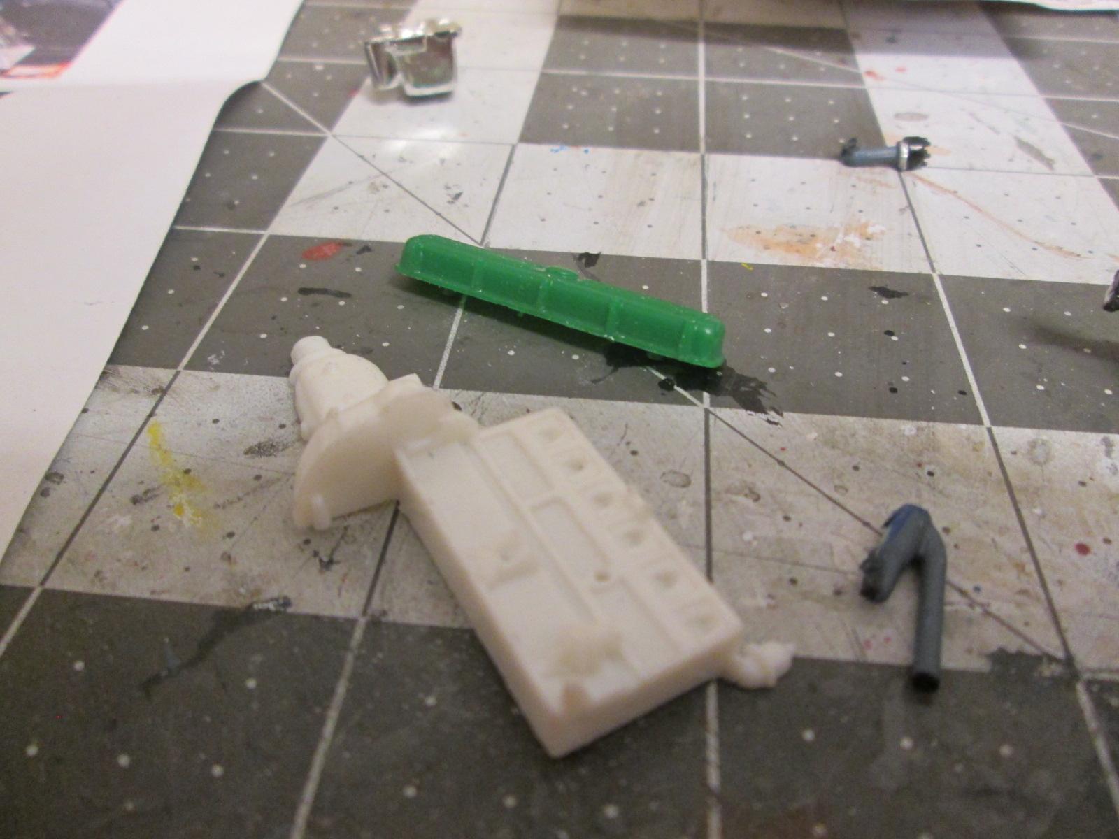

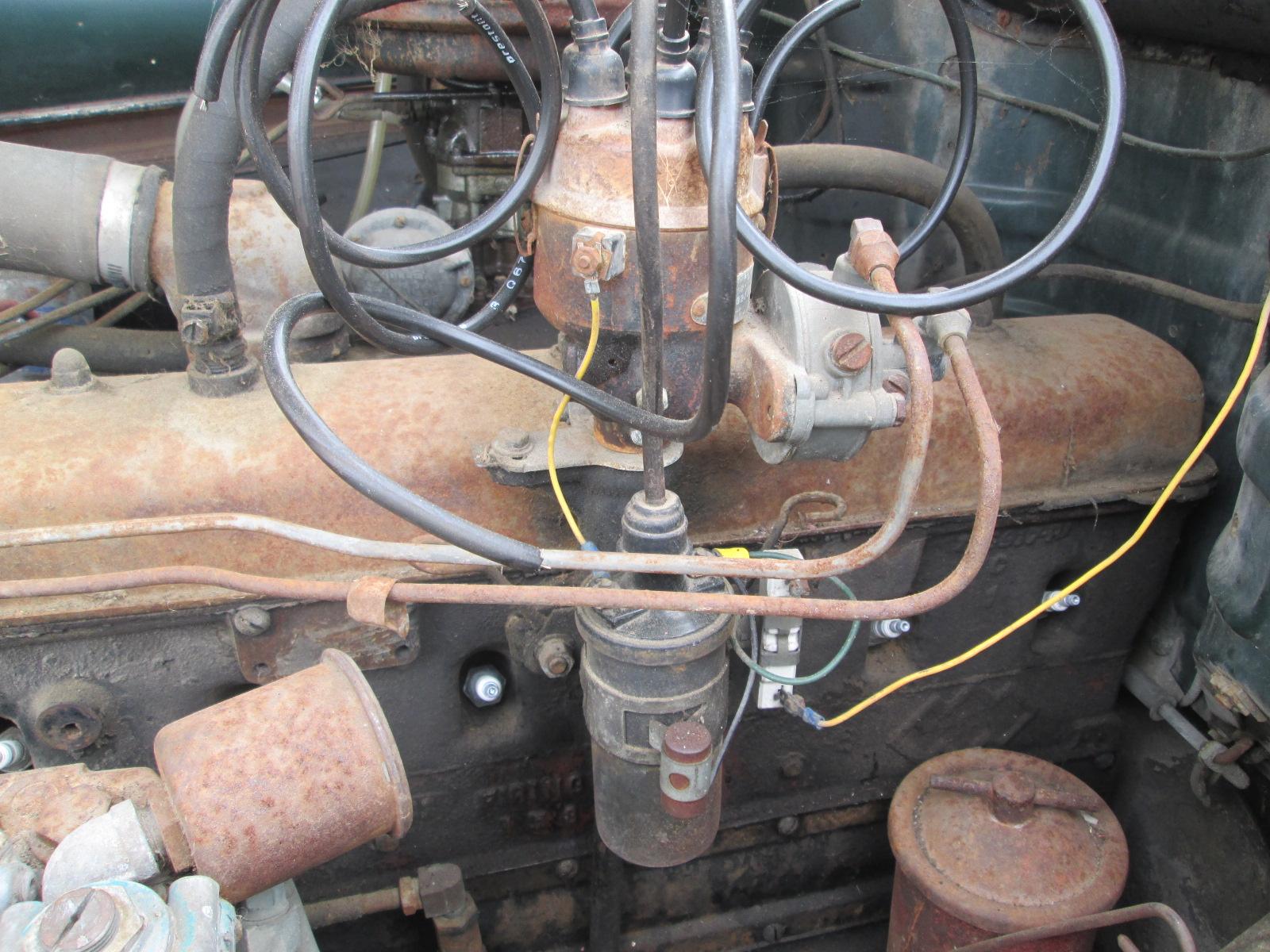

Using both the distributor and the oil filler from the Chevy engine. The IH distributor is on a long stem which runs from just above the oil pan to above the valve cover. Made a cap for the oil filler. -

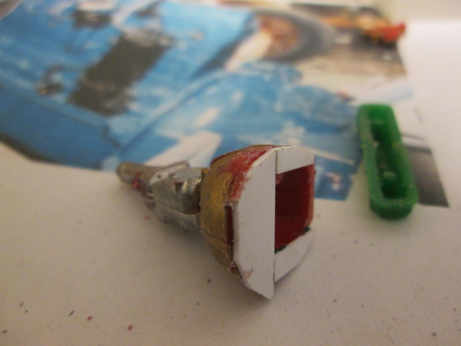

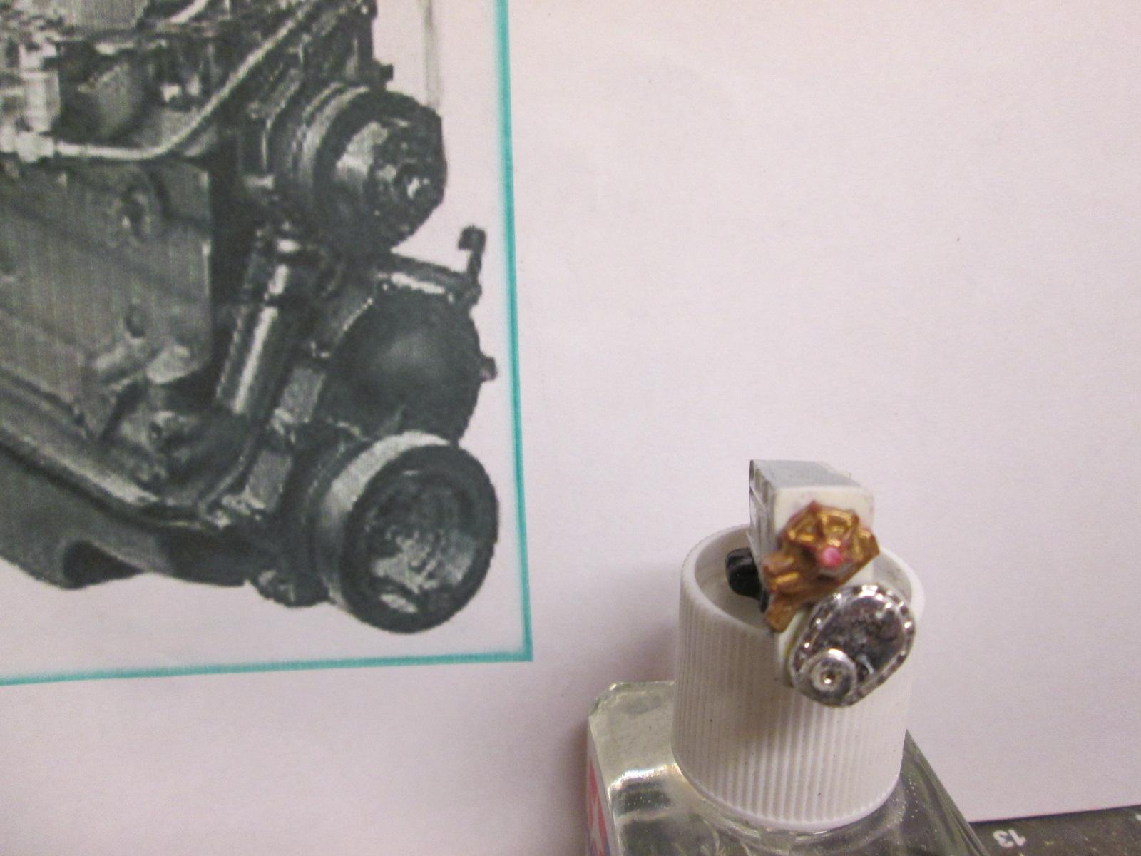

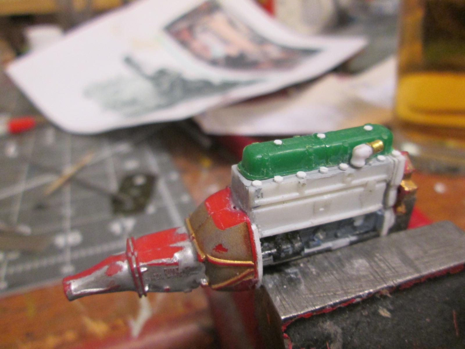

By adding to the front I achieved the 29" block length. The junk engine also donated its bell housing & transmission.Another one donated its oil pan. This required some filling of axle holes and the hole left by the removal of the molded-in oil filter. Playing with a front cover and the water pump to achieve the general appearance of the IH engine. The amalgalm coming together. -

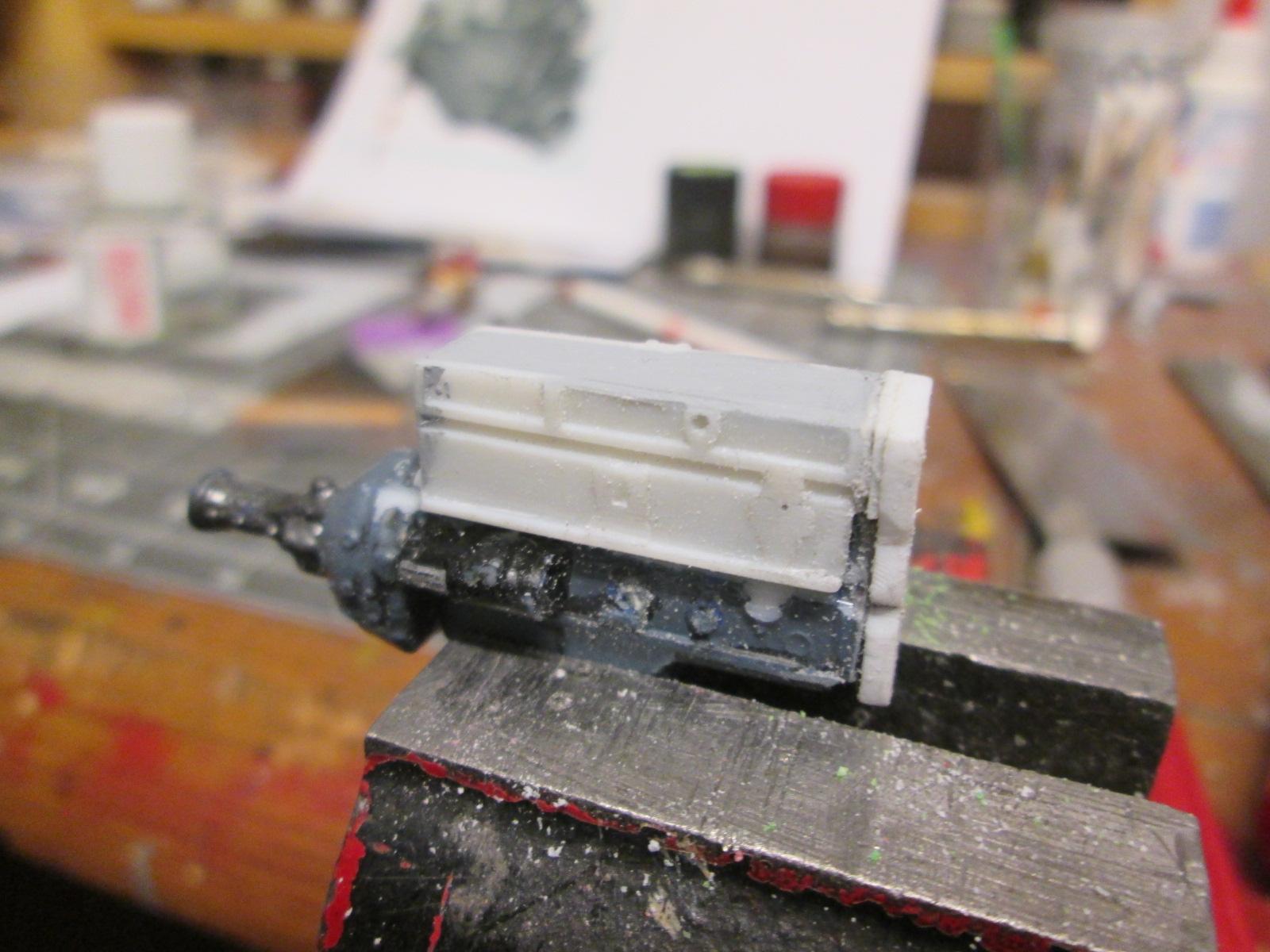

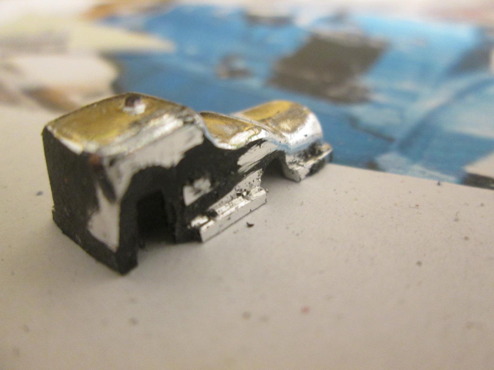

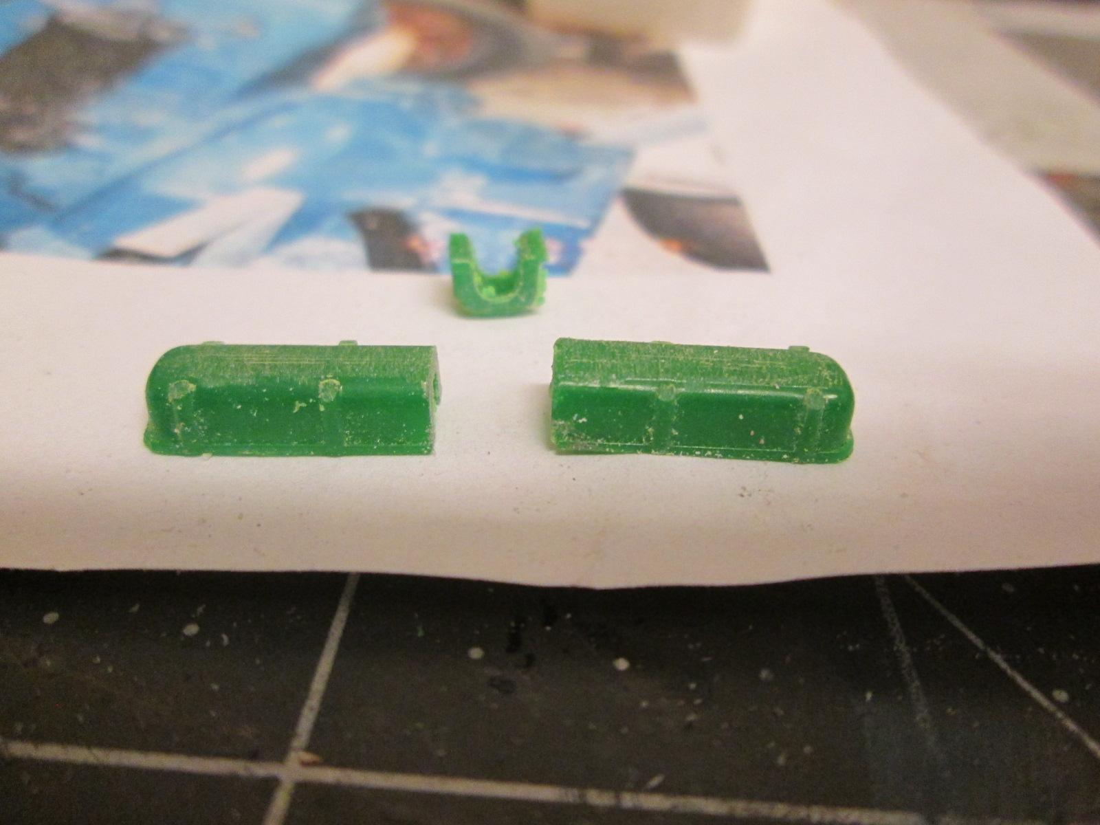

The next step is to find the makings of the engine. The closest I could come dimensionally is this 1951 Chevy block which was hanging around in the shop. This half block of another, more modern looking Chevy will donate its half of the head and a wall to widen the other one. The valve cover from a Cadillac V16 is the correct width. It will be trimmed to fit. A junk engine kindly donated its front cover. -

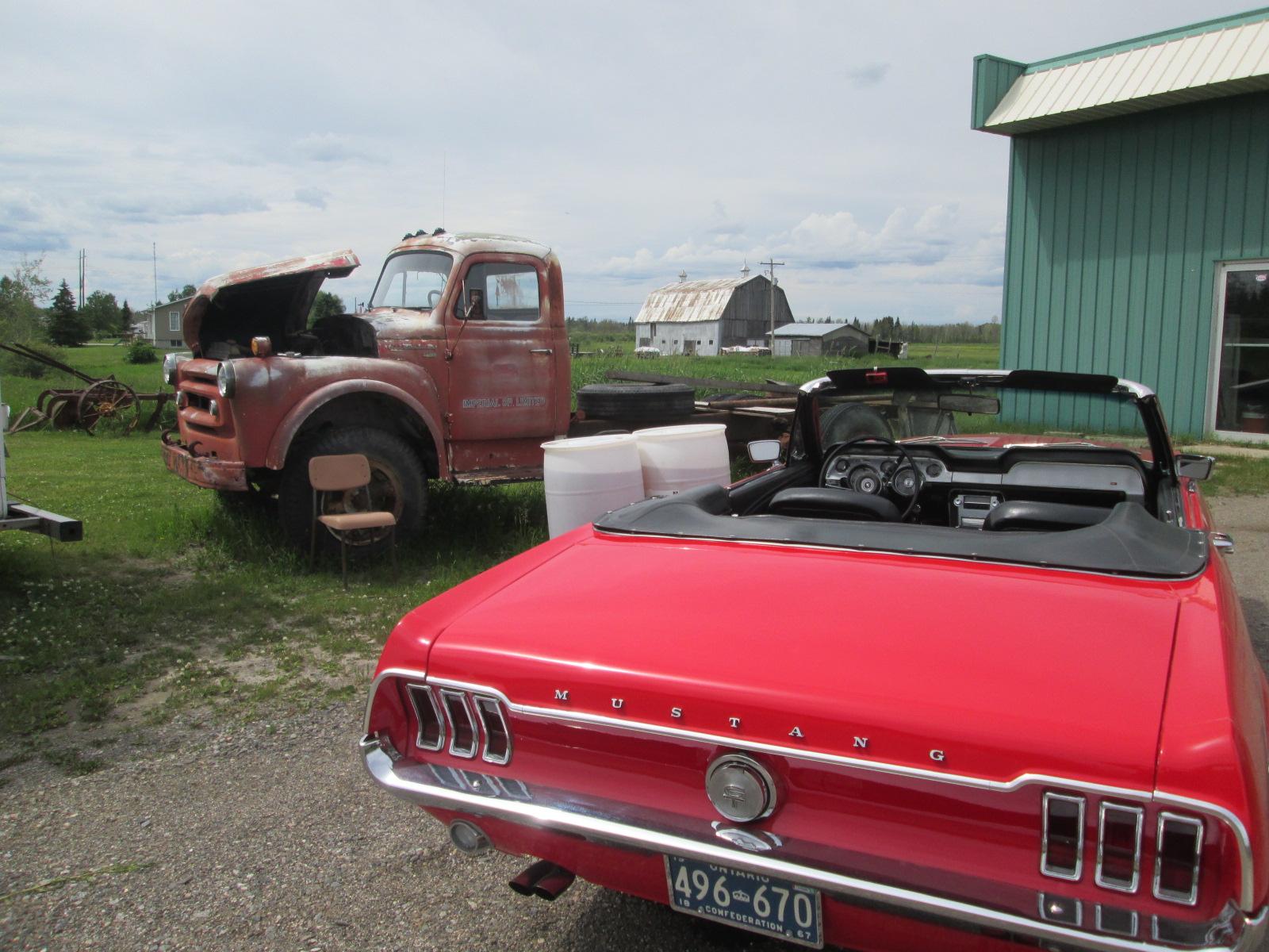

This is a photo of my daughter's father in law's rig. He made this out of a building supply delivery truck.
