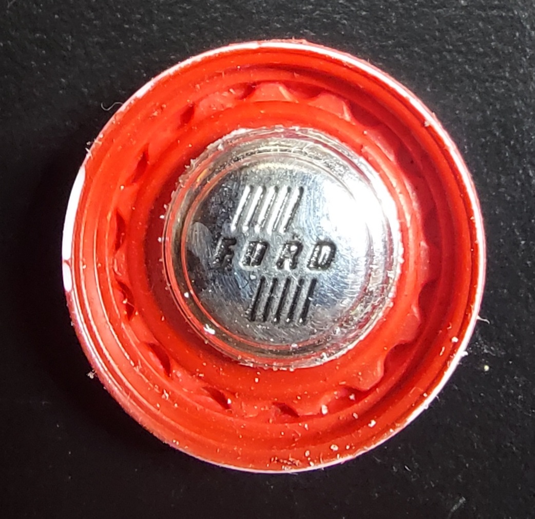

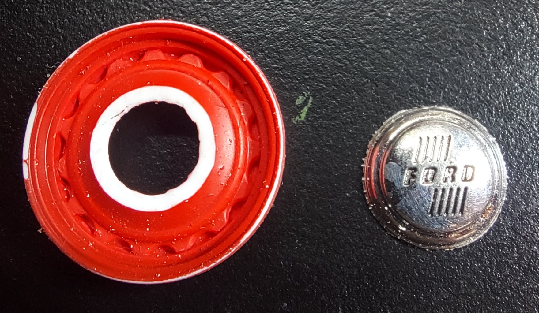

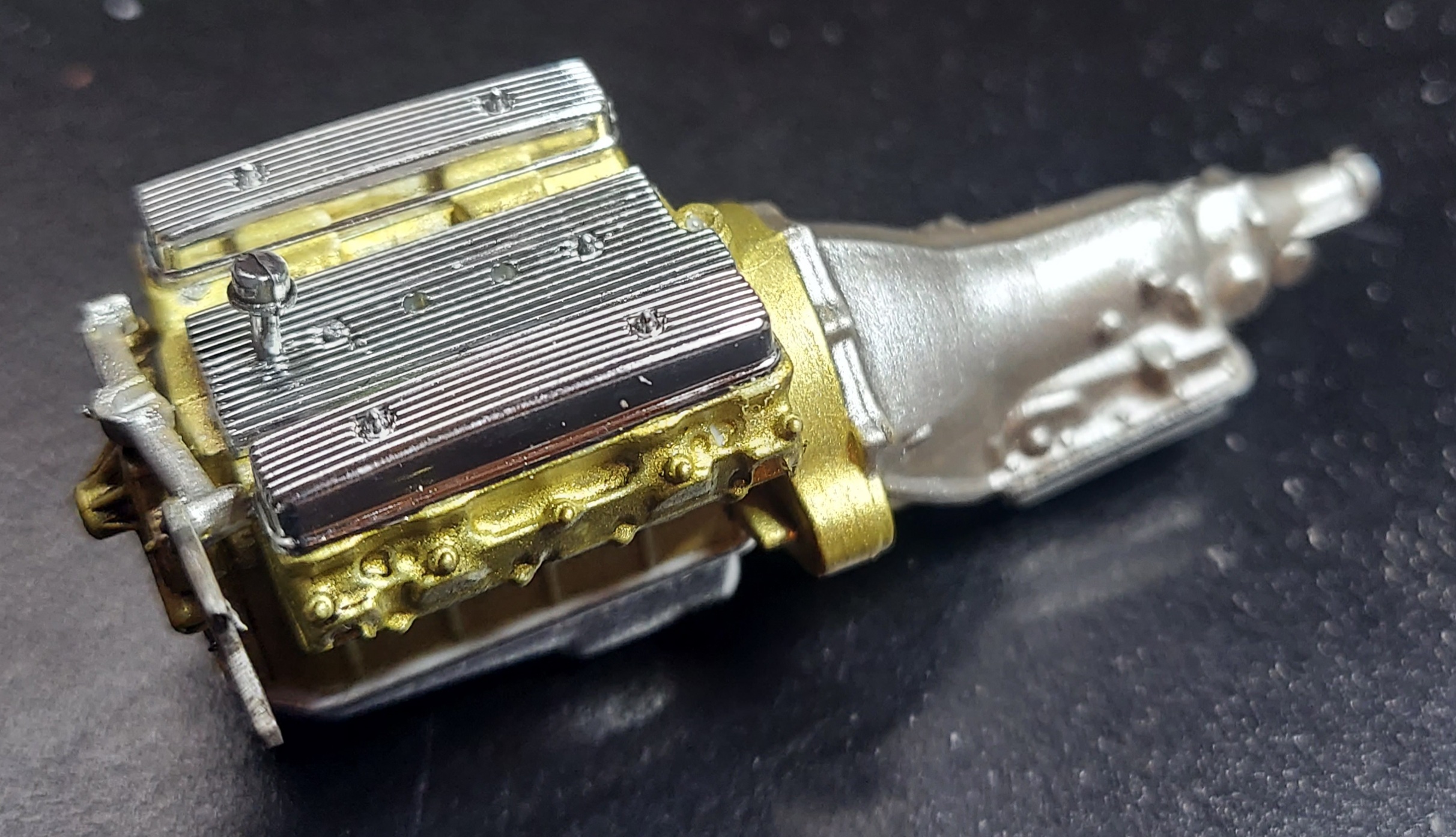

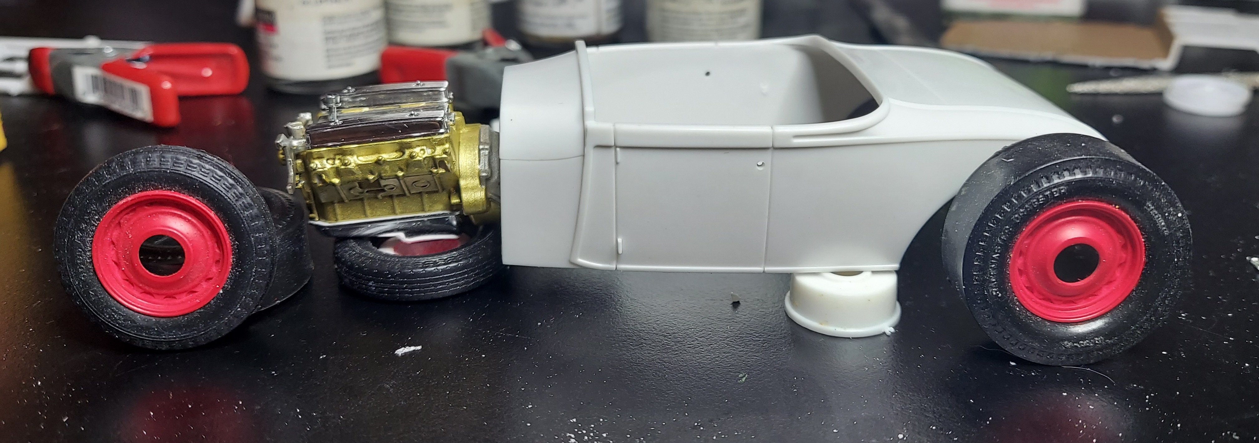

So I got bored today, and was scrolling through Facebook marketplace when I stumbled on what I thought was a deal too good to be true, a Revell '29 Model A Roadster, and a Lindberg '38 Ford Panel Van. Both for $15. Couple hours later, I'm driving home with two new kits. The A was missing some bits, wheels, tires, front axle, and what I really wanted, the Buick drums. Oh well, I'll make it work. Stole a set of Artillery wheels from my '32 Salt Flats project, and a front axle from the parts bin, and started on it. I'll also be using the non channeled parts from the '29 in that build, so stay tuned! Painted the Engine Tamiya X-12 Gold, Transmission and alternator bracket Model Master Steel, and went over the mostly finished engine with black panel line accent to give it that "used" look. My goal is to make this look like something that's never been on a trailer. I modified the artillery wheels to take the kit hubcaps, and did a quick mock up. I plan on doing a tan/saddle brown leather interior, gloss black paint, and the red wheels. Any constructive criticism is greatly appreciated! Still trying to figure out how to use the micro camera settings on my new phone...

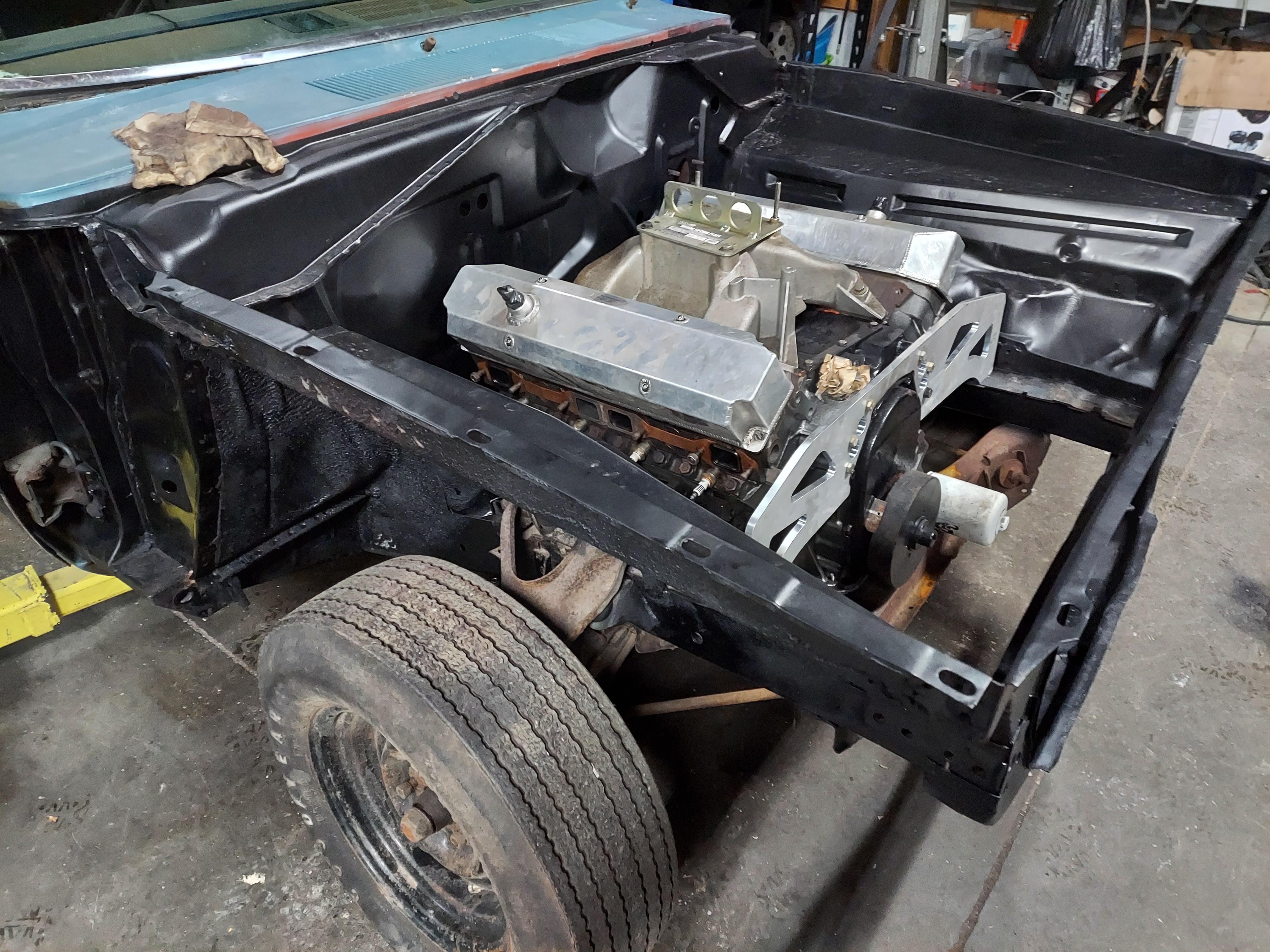

I'm not As far as I know it's been an Ohio car all its life too! The stickers on the Windshield for parking in Cincinnati are from the early 70s. I'll find a set of headers here soon. The hammer doesn't scare me much, neither did the plug situation. I'll cross that bridge when it arrives though. Engine and Tranny will be going in shortly to be mocked up and mounted with the motor plate.

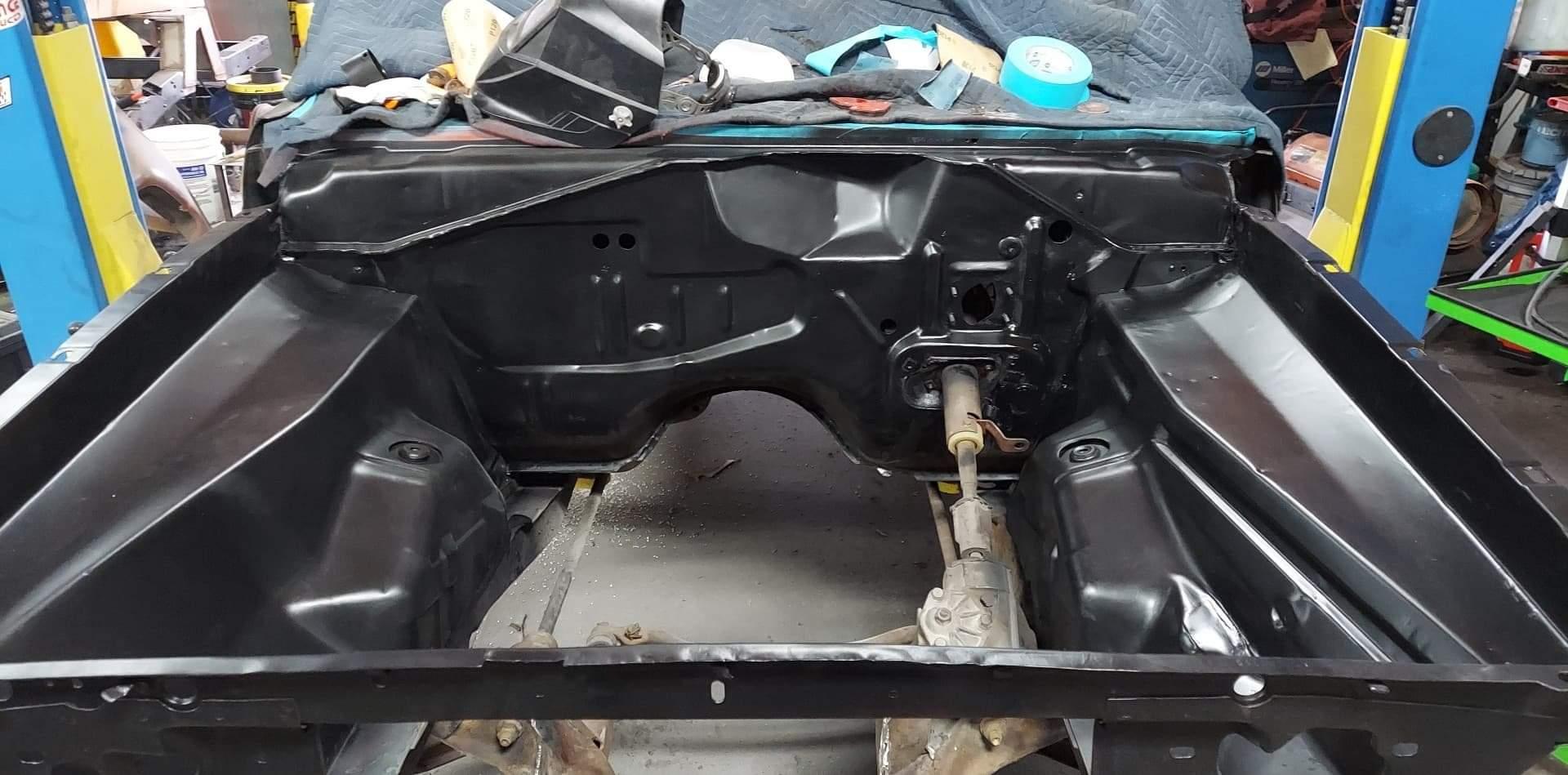

What a Big hole! Cutting out the rust on the inner fenders and welding in patches, then running over with kitty hair, and then bondo. I want this thing cleeeean. Started welding up all the small holes on the inners and the firewall as well, then my die grinder broke. Oh well, I have errands to run tomorrow anyways.

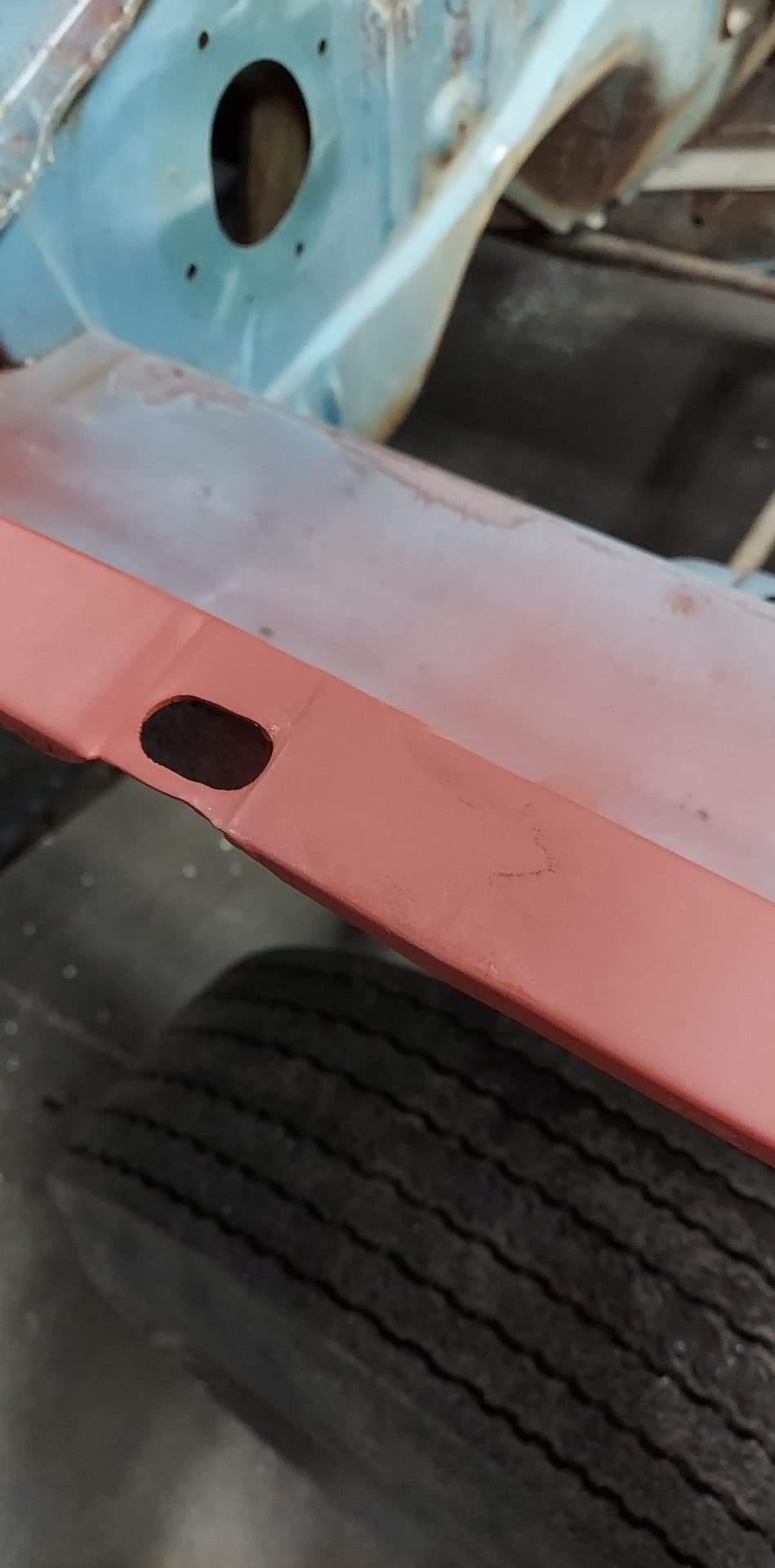

I began to wire wheel the engine bay, and asses what needed to be replaced/fixed. Luckily nothing has to be replaced, only a few small rust spots which are easily fixed. Once I get the engine bay smoothed out and nice and clean I'll be spraying it with VHT Epoxy Chassis paint, great stuff. I cut out the old, rusty metal, made a filler piece, got it as level as I could, and welded it in. I then skimmed it with bondo and sanded it smooth. Then, covering it with the sandable primer I use on everything, I covered it up to prevent further corrosion. I'll let everything cure for a day or so then go back over it with a follow up coat.

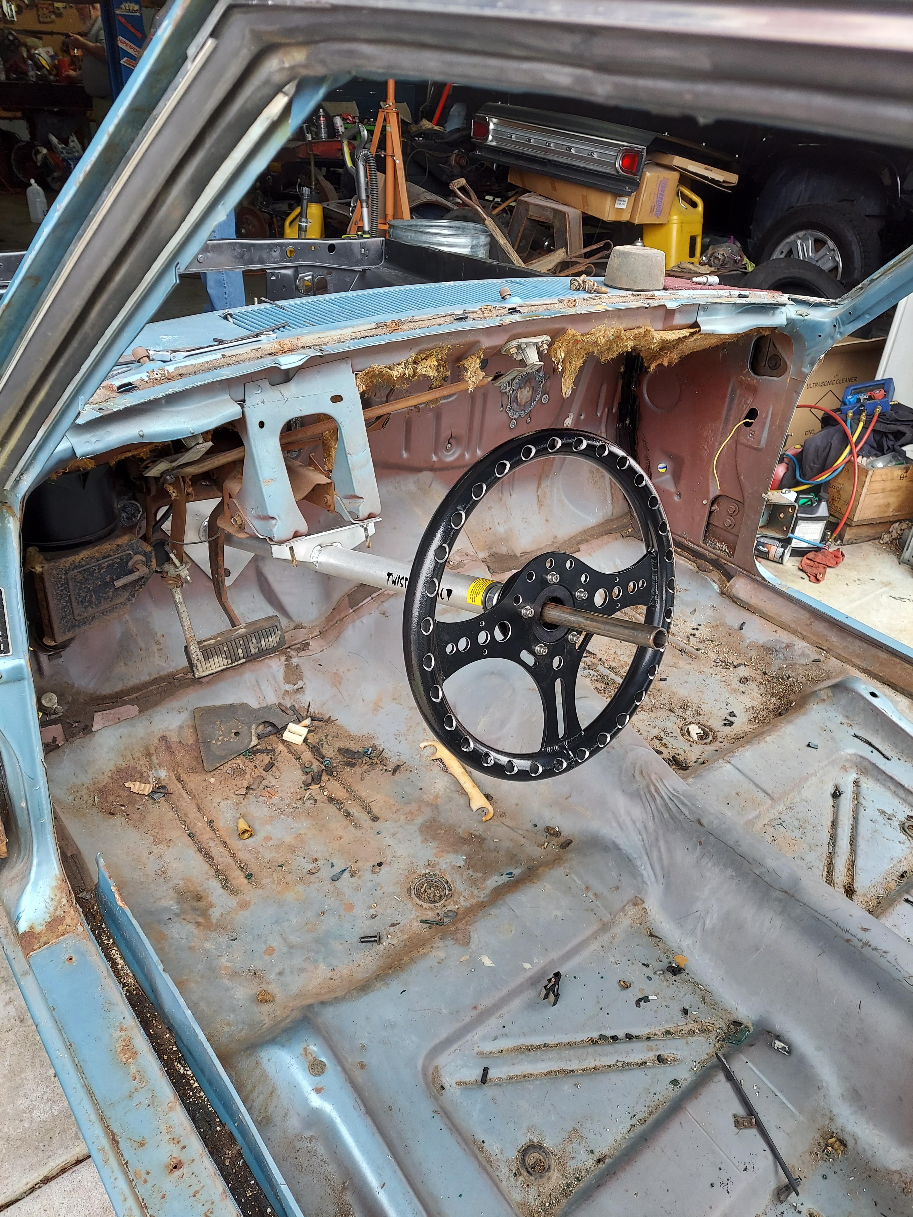

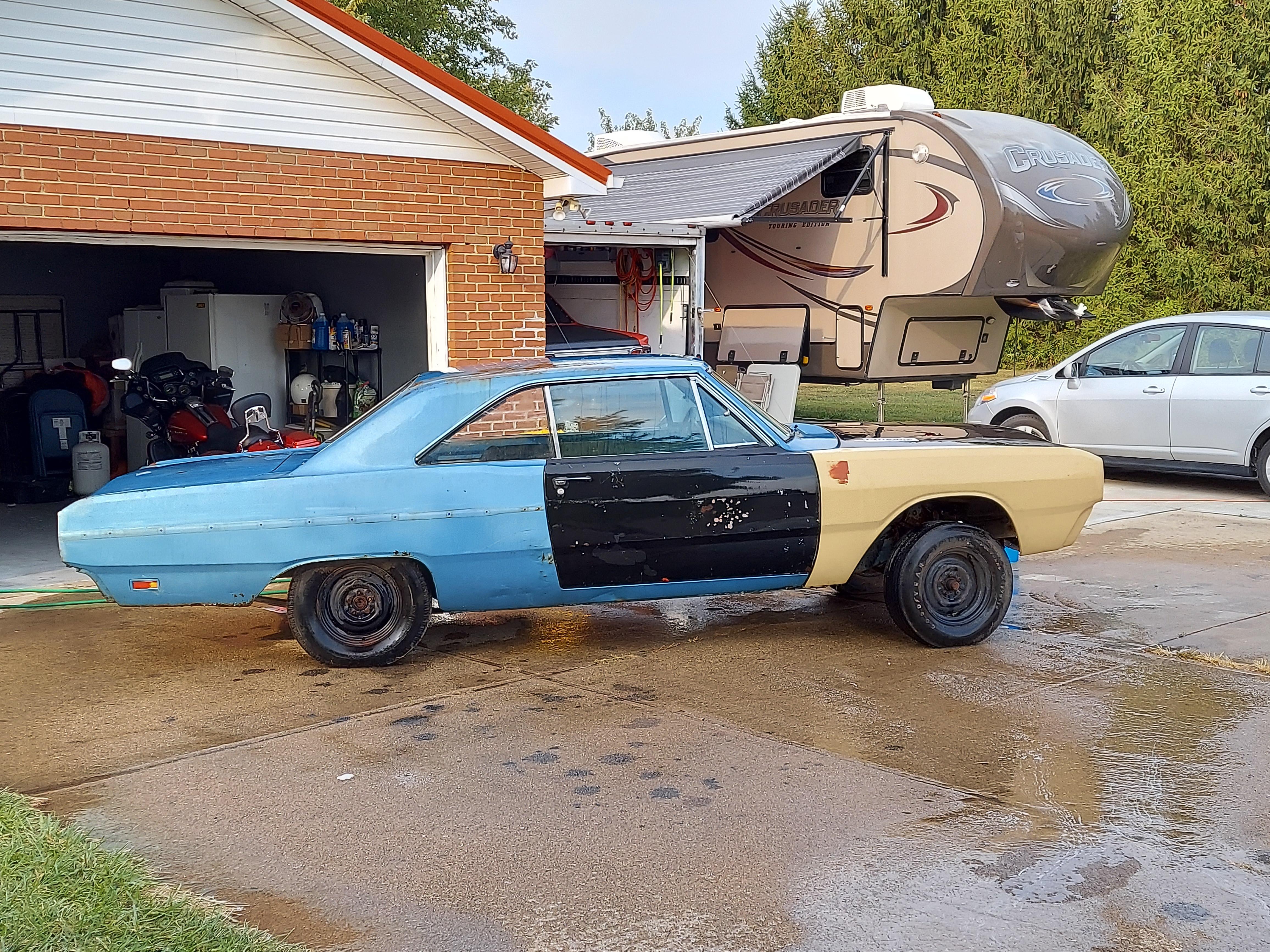

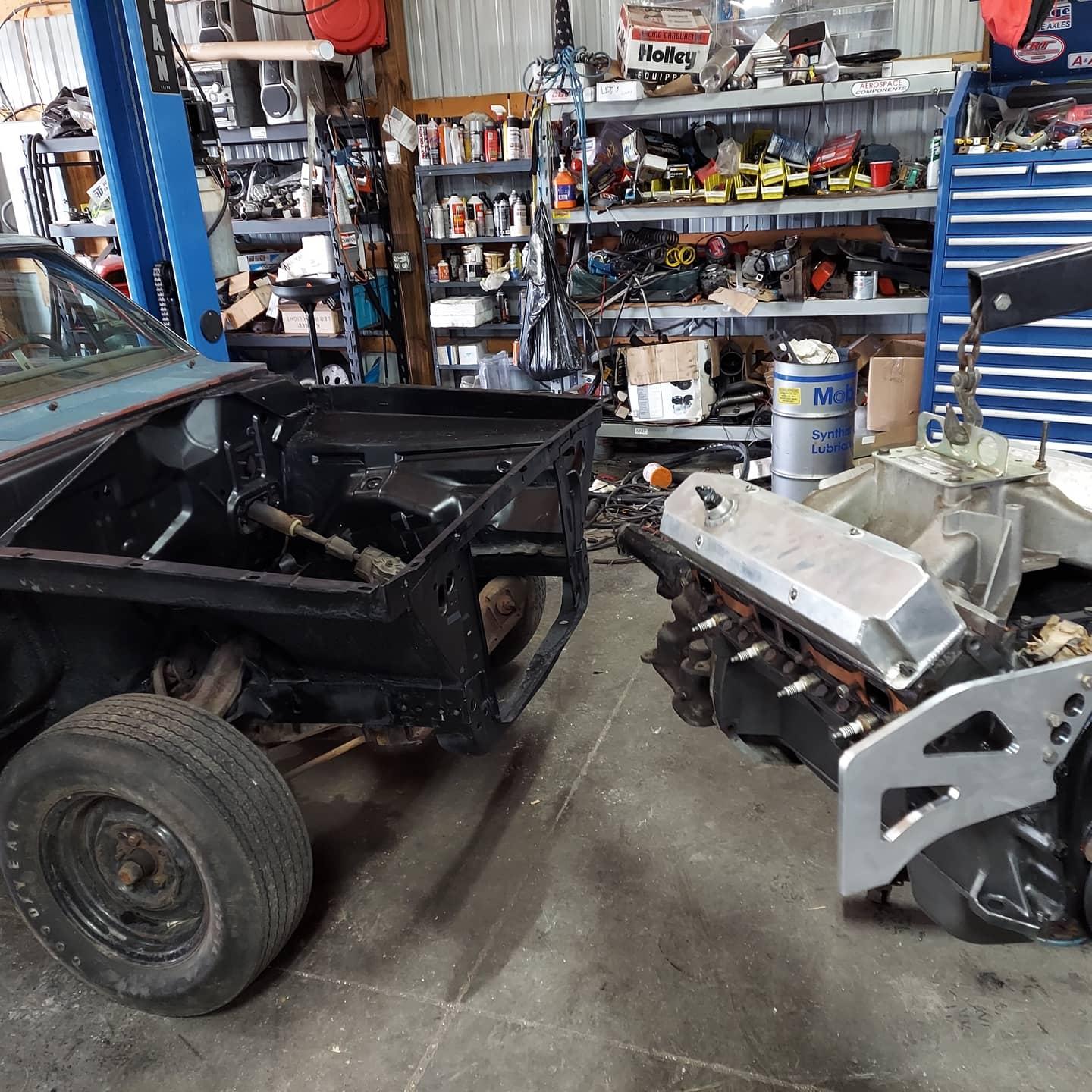

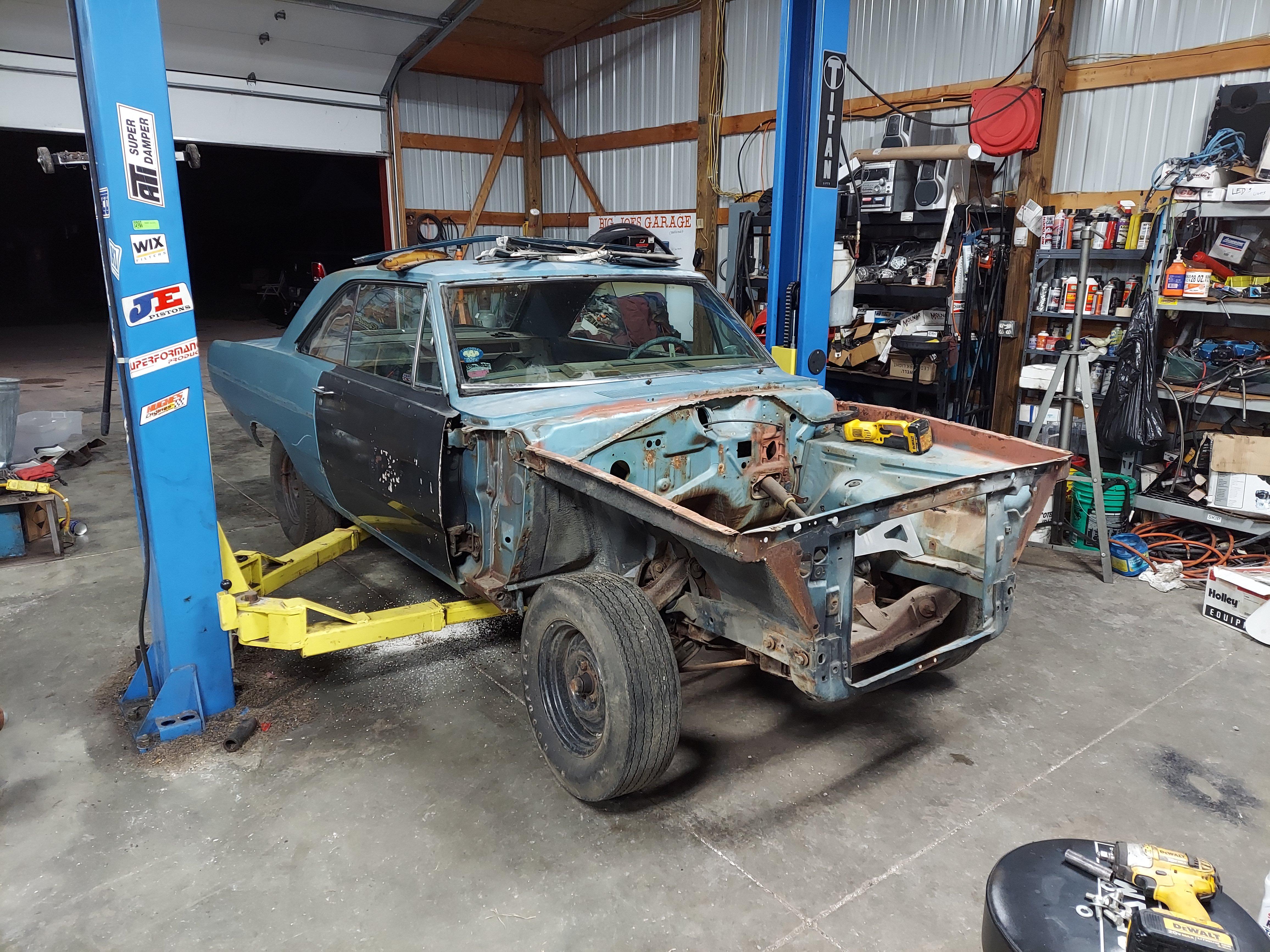

This is the main reason for my recent absence of modelling. Right as I get back into it this falls into my lap. But hey, I'm not complaining. The Car is super solid and it will take some work, but I'm excited to have a clean slate to start with. I'll begin in Pro and then bump up to Nostalgia Super Stock here in a few years. It began with a discussion with a family friend about wanting to upgrade from pit crew, for my dad's '66 Hemi Dart, to my own ride. Wheels got to rollin' and next thing I know I'm on my way to pick this up. Already has Fiberglass fenders, and besides a scrunched up quarter panel/tail light pocket, it's clean. I have a mild 440 and a built 727 Torqueflite going in it, which will be hooked to an 8 3/4 after bracing it. Car should weight about 3000# with me in it, myself weighing roughly 265#. I started on the rust repair tonight, and will smooth out the firewall and various under-hood bits and will leave the exterior as is until I can start the body work.
