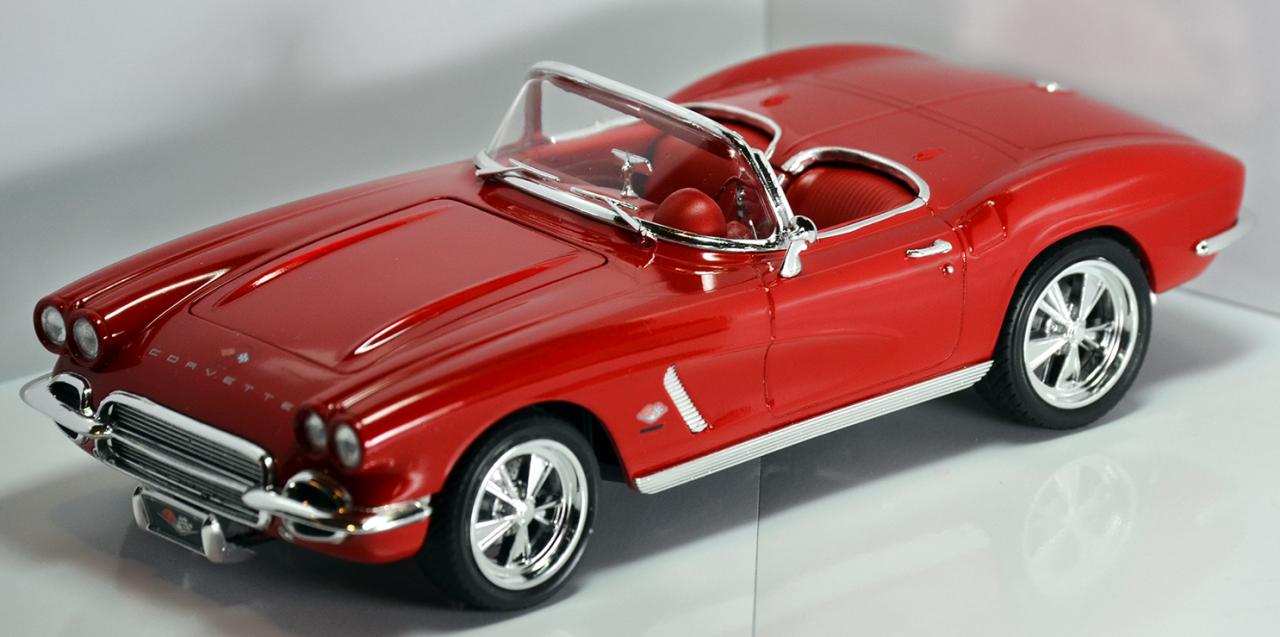

  19. Hi Scott, This was the newer Revell 2 'n 1 kit. It's a very good kit and I didn't have any major issue. Tim
  20. Very nice, Rich! Tim
  21. Nice work! Looking forward to seeing it "Under Glass".
  22. Thanks guys! Tim
  23. That's a wrap. Tim
  24. Under Glass now... Tim
