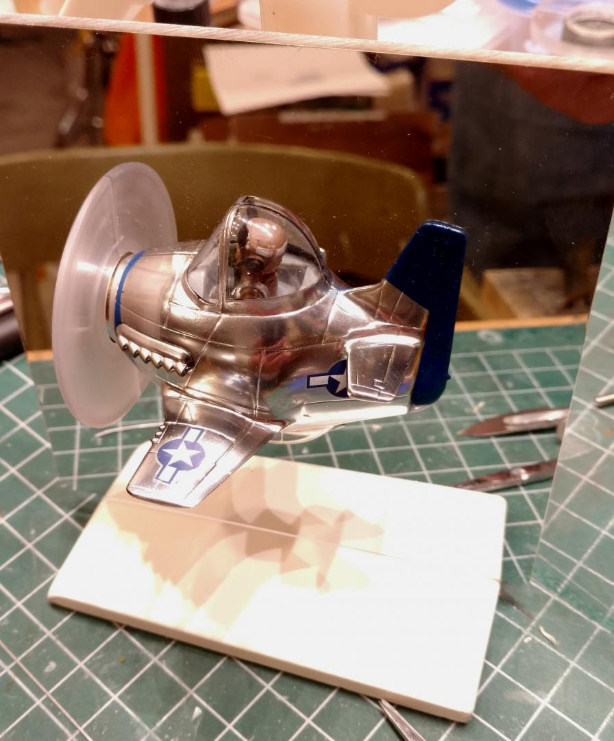

You do understand that this refers to large non-model kit applications like car/truck rims, bike helmets, etc.? Look at the speed shape in my photo. One coat of the urethane basecoat and one coat of Easy Chrome. That's it. It doesn't get any easier. But hey, if you want to spend 50+ bucks to re-plate a couple of bumpers/grilles, then maybe wait a couple of weeks to get them back, who am I to tell you how to spend your money? I took a chance after reading the thread Pete J. posted about it in OTL and am satisfied that it does as advertised. Pete J's results: Quoting Pete: "Yes, I did some of the chrome work with a brush just to see how it would work." Nuff said. His pic says it all. Addendum: When applying Easy Chrome with an airbrush, spray very light, misting coats until you see the mirror-like finish appear. Stop at this point and don't apply further coats.
Literally one, thin coat applied with a paint brush. Easy Chrome has the viscosity of water; so, it can't be sloshed on like, for example, acrylic or enamel paint because it isn't paint. The carrier is lacquer-based. Airbrush application is even thinner.
