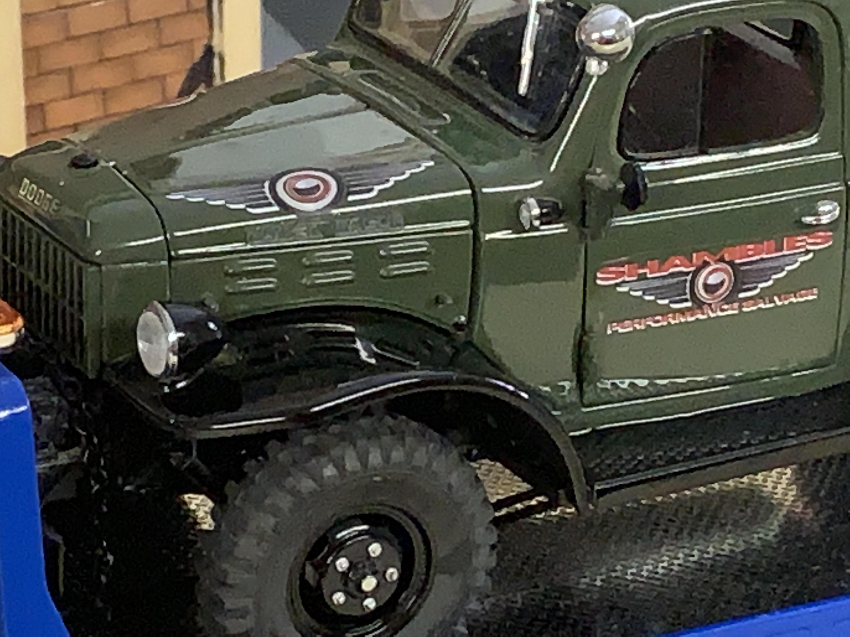

  3. Cool! I like your paint box too. I've got one out in the garage that I use a lot. I thought about getting a 3D printer, but didn't know how much I'd use it, and they ain't cheap! In the last year, I splurged on the MicroMark' decal maker package so I can print decals with a white base coat, and a Wondercutter, also from MicroMark. That pretty much wiped out my budget for a while!

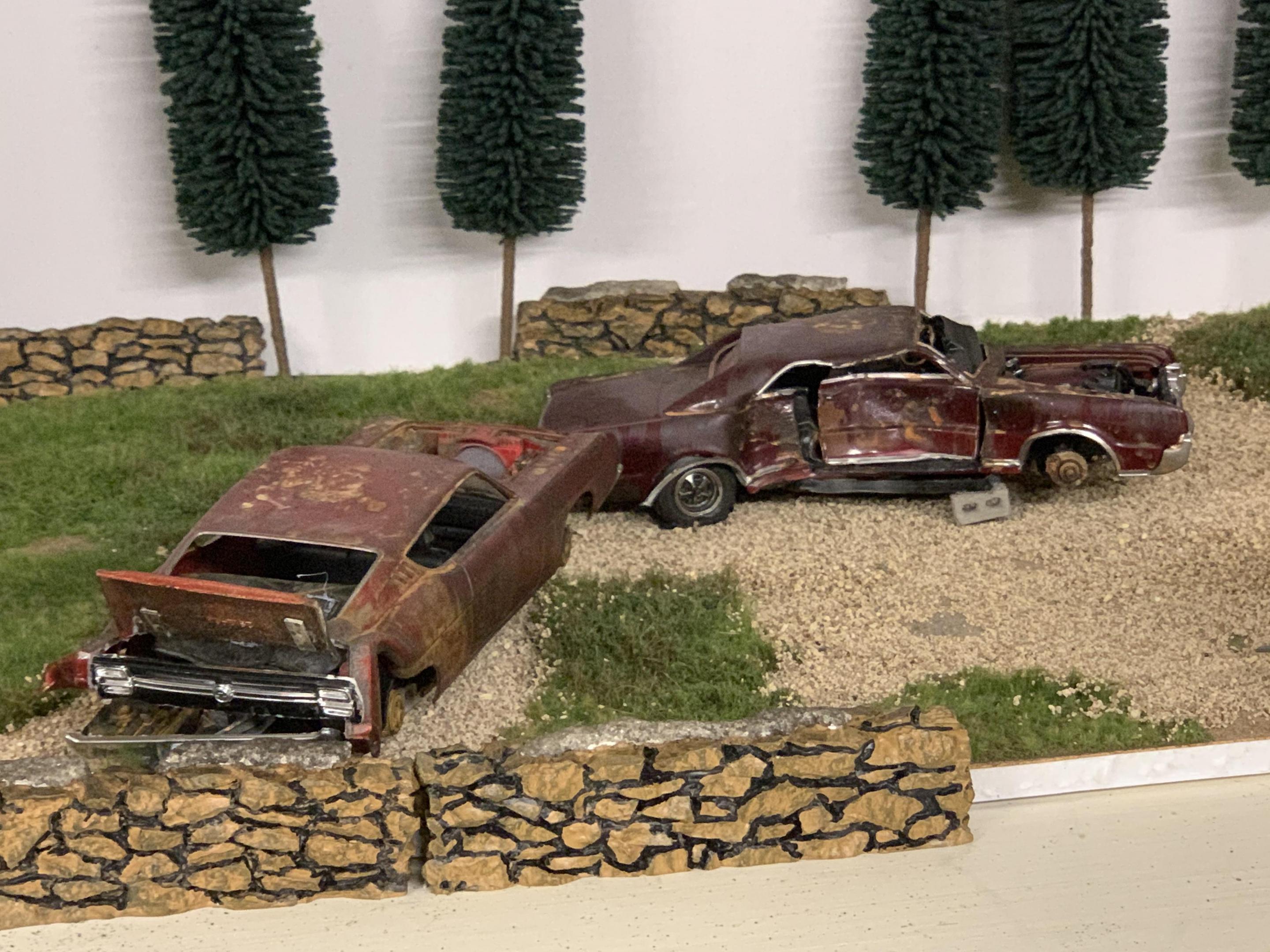

  7. Another one bites the dust.. Pre-Photoshop background in 2nd photo. It's in the works....

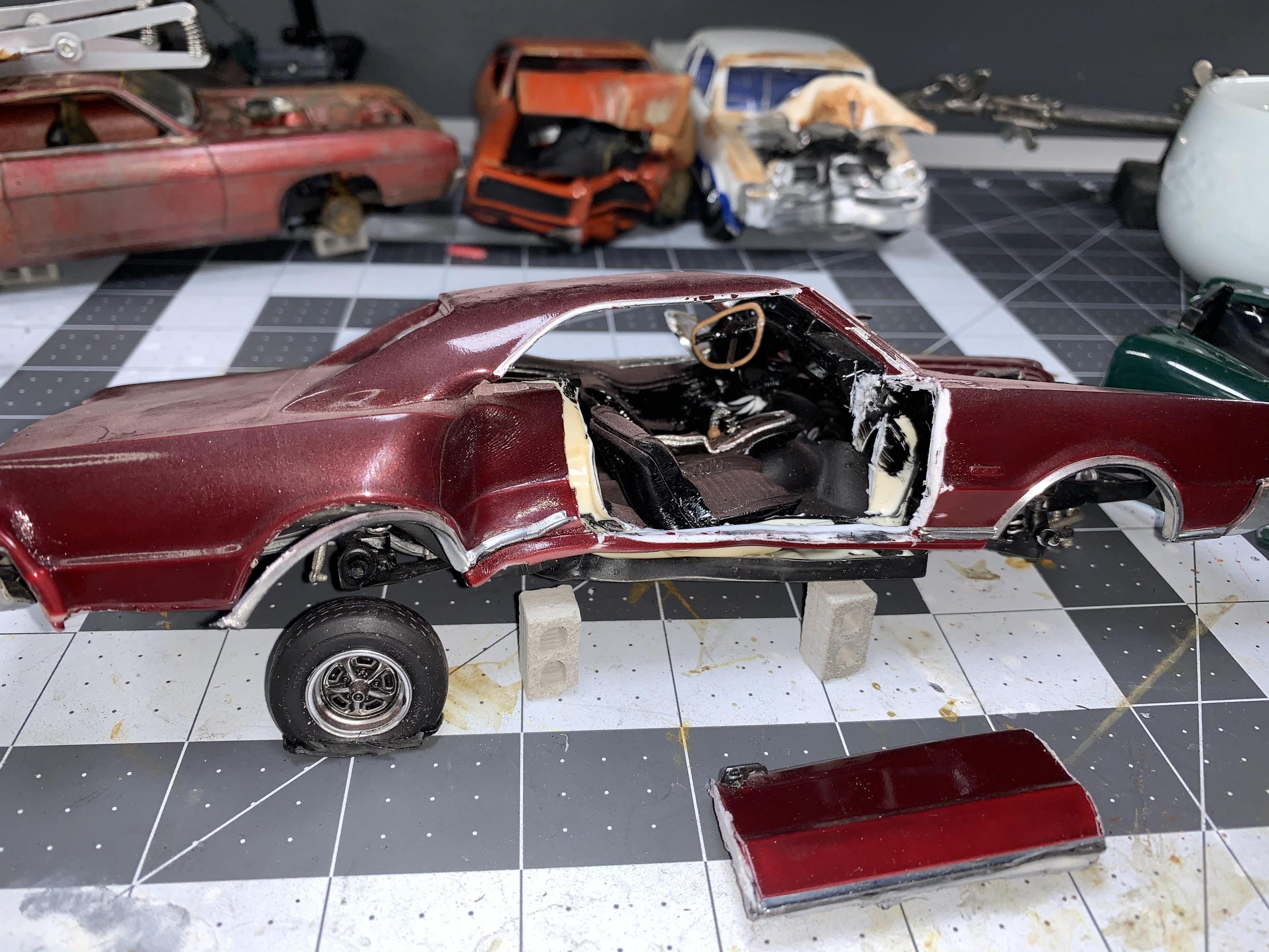

  20. I started out long ago using a Bic lighter and/or a candle. I have scribed out doors and deck lids for years, but this "Wonder Cutter" from Micro-Mark really speeds things up. It takes some practice, and it's easy to mess up but, since these are wrecks, I can get away with it. I sometimes use a Dremmel butane soldering tool for short bursts, but it can easily overheat the plastic and make it shrink, especially thin items like A- posts and exhaust pipes. I do most of the heating with a Micro-Mark heat gun but still have to be careful to distribute the heat evenly and stay off of the thin parts. I often take the model apart, "wreck" the interior and exterior separately, test fit a few times, then put them back together. After years of trying to make realistic flat tires, I found something that works pretty good; a hot plate and a 7/16 deep socket for 1:25 tires. I remove the tires from the rims so the rims don't flatten too. Then, trim away the excess rubber, and insert the rim. I've found resin "steel" wheels on eBay if I want it to look like the wheel cover came off in the wreck. It also helps to have something solid to "crash" into the model being wrecked. For this one, I'm using the cab from a disassembled DM die cast '53 Chevy pickup (a whole other project that's in the works). Sorry... didn't mean to go on and on. I didn't know if yall would be interested.

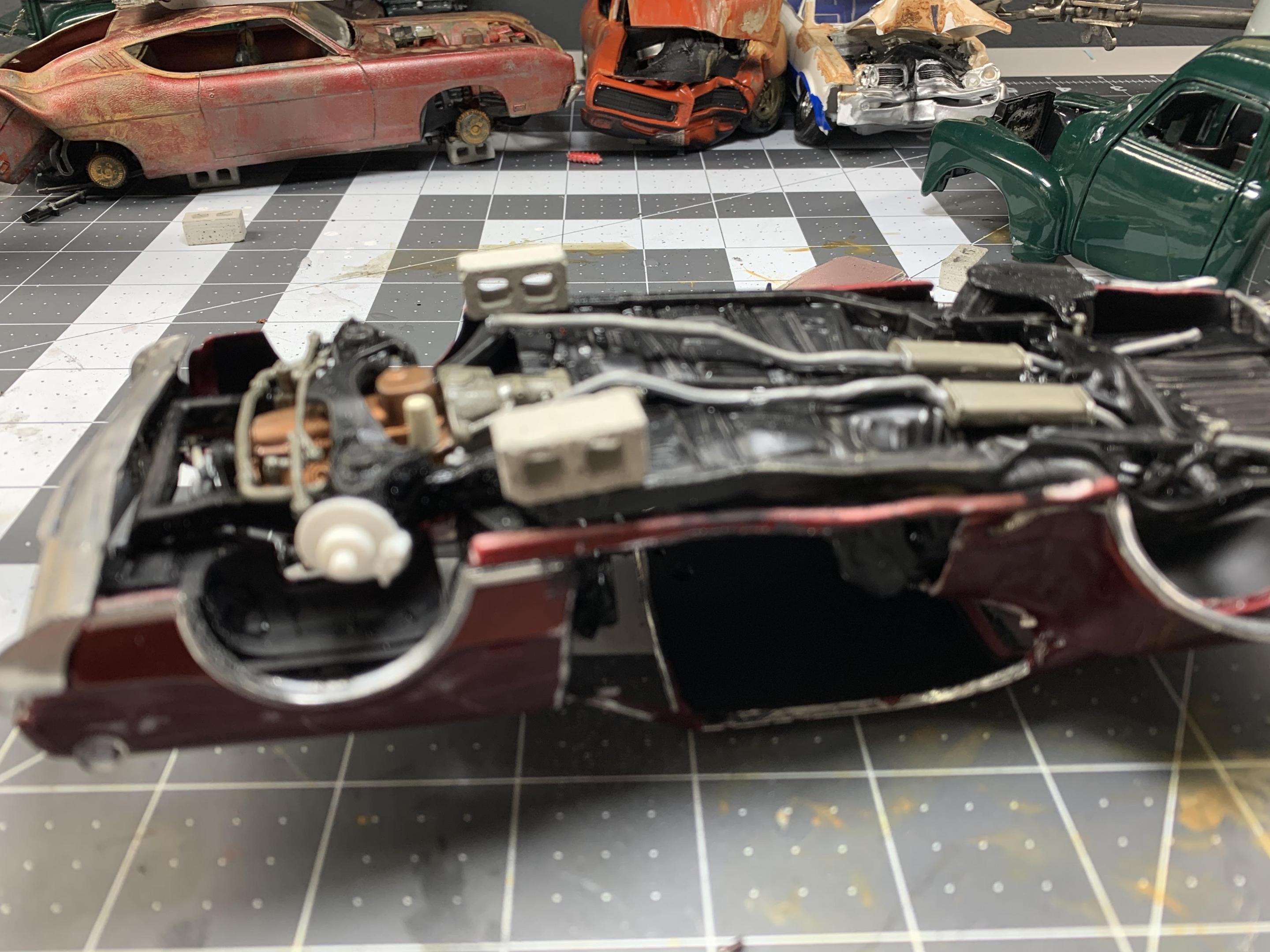

  22. Wrecking another one tonight. An Olds 442, nicely built model I found on eBay. Sorta hate to wreck it but it was dusty and, well... destined for Shambles Salvage Yard. A tedious process to make it look real. This one was T-boned on the passenger side. Door cut out, exterior and interior carefully heated and "crunched". Brake rotor attached, concrete blocks glued to the undercarriage. Weathering is next. The details probably won't be visible in the final diorama... but it's fun doing them.
