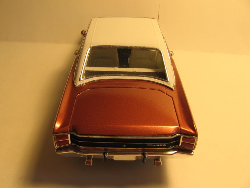

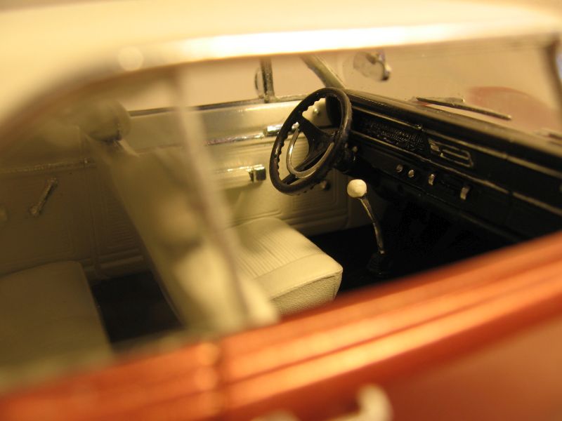

  6. This is a re-do of an older build... I replaced the 383 big block automatic with a resin 340 4speed, and modified the interior to make it a non-console four speed hump. I went with a Fireball Holley, a resin dual snorkel breather, some Fireball resin BFGs and a set of Cragars from a '66 Nova. The old, too-thick urethane was stripped from the body, a vinyl roof was added and the Light Bronze comes from some thinned nail polish followed by a single coat of automotive clear. The flat hood is a Hart's Parts piece. Wish it would stay flat... I spent waaaayyyy too long getting through this, but I'm happy how it sits. Built more as a Day Two car than a stock 340 car. Comments always welcome.
  7. I copied the engine and trans myself. There just aren't any small blocks out there and I can't see raiding kits for them all the time. I've got plans for a LOT of small block Mopar projects. Fitting the engine was pretty easy: I shaved the K member mounts and the trans crossmember mount to get the engine lower, as seen in my pics. Trial and error... I didn't do it here, but the water pump snout is fairly long. The next one I do, I'll spend some time fitting the pulley and belt closer to the engine. With a cooling fan in place, there is ZERO room to fit a rad. This car has a shroud that hits, so I'll have to come up with something... maybe go with the shroud and ditch the fan.

  21. Some very nice work here! Your foil work is frigging awesome!
