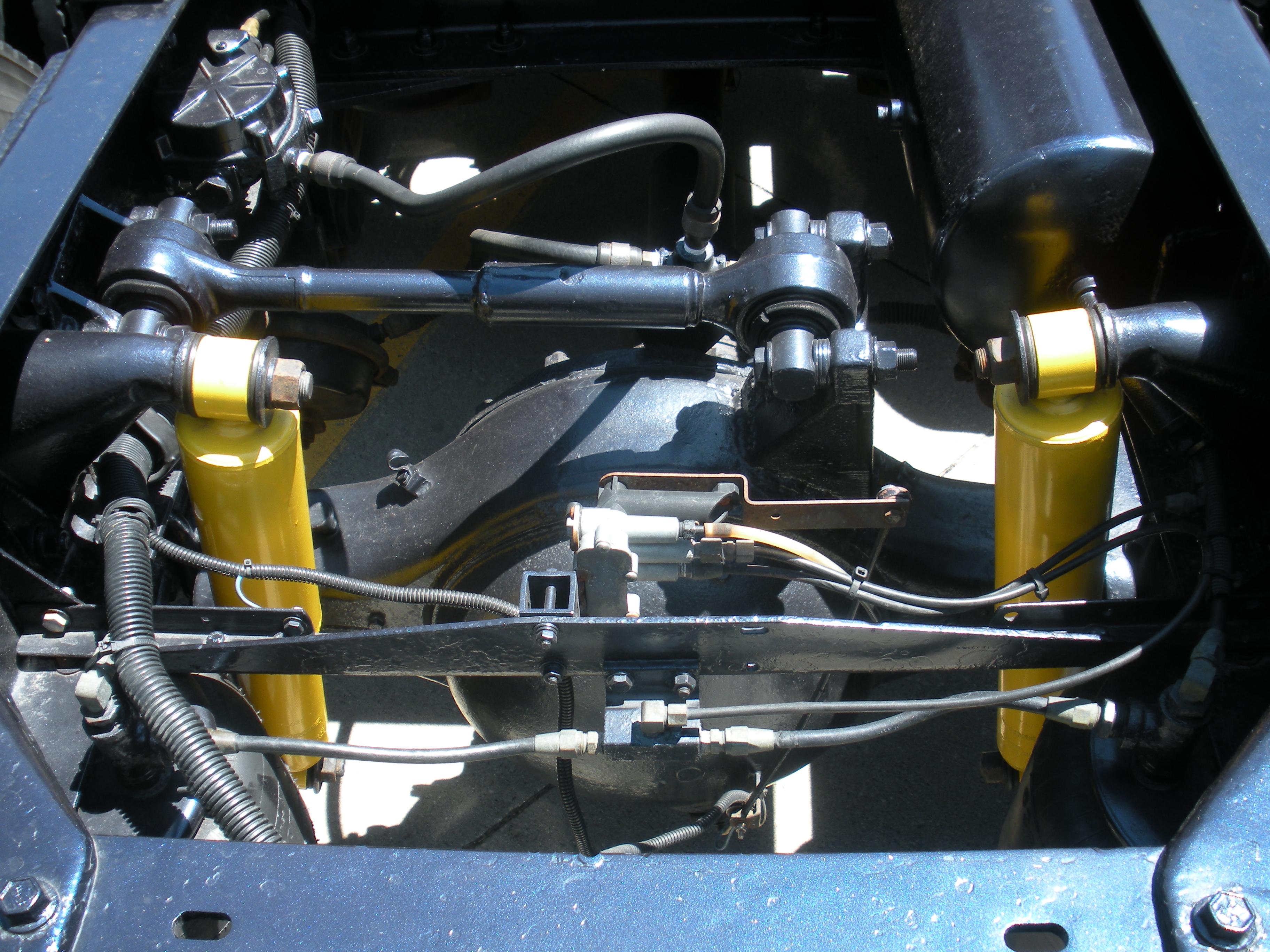

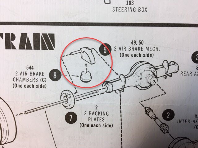

  4. Getting the rear suspension on now. Will post an update pic tomorrow. Can anyone post a pic of your 352 axle to show how these brakes are supposed to be attached? The AMT instructions are a bit of a mystery.
  5. Just checking if anyone can help with this ? Thanks

  8. OK guys -- More help needed. :-( The attachment of the air brakes to the rear axles is a bit of a mystery. The instructions really aren't helpful. Could someone possibly post a photo of their 352 axles showing how these are attached ? It would be very much appreciated !

  11. Well, Shazam !!! Wow. Thanks so much for posting that picture. That explains a lot. That photo also is nice as it shows the 1:1 suspension -- much better than the AMT kit instructions. I'd love to get a copy of that brochure !! If it could be copied and maybe emailed ? Thanks again for this !!

  13. Thanks! so, in fact, on the kit part, the "fingers" are actually on the wrong side of the angle iron "L". And -- contrary to the instructions, the piece should be located *forward* of the rear axle shock mounts -- not behind them as implied by the instructions.

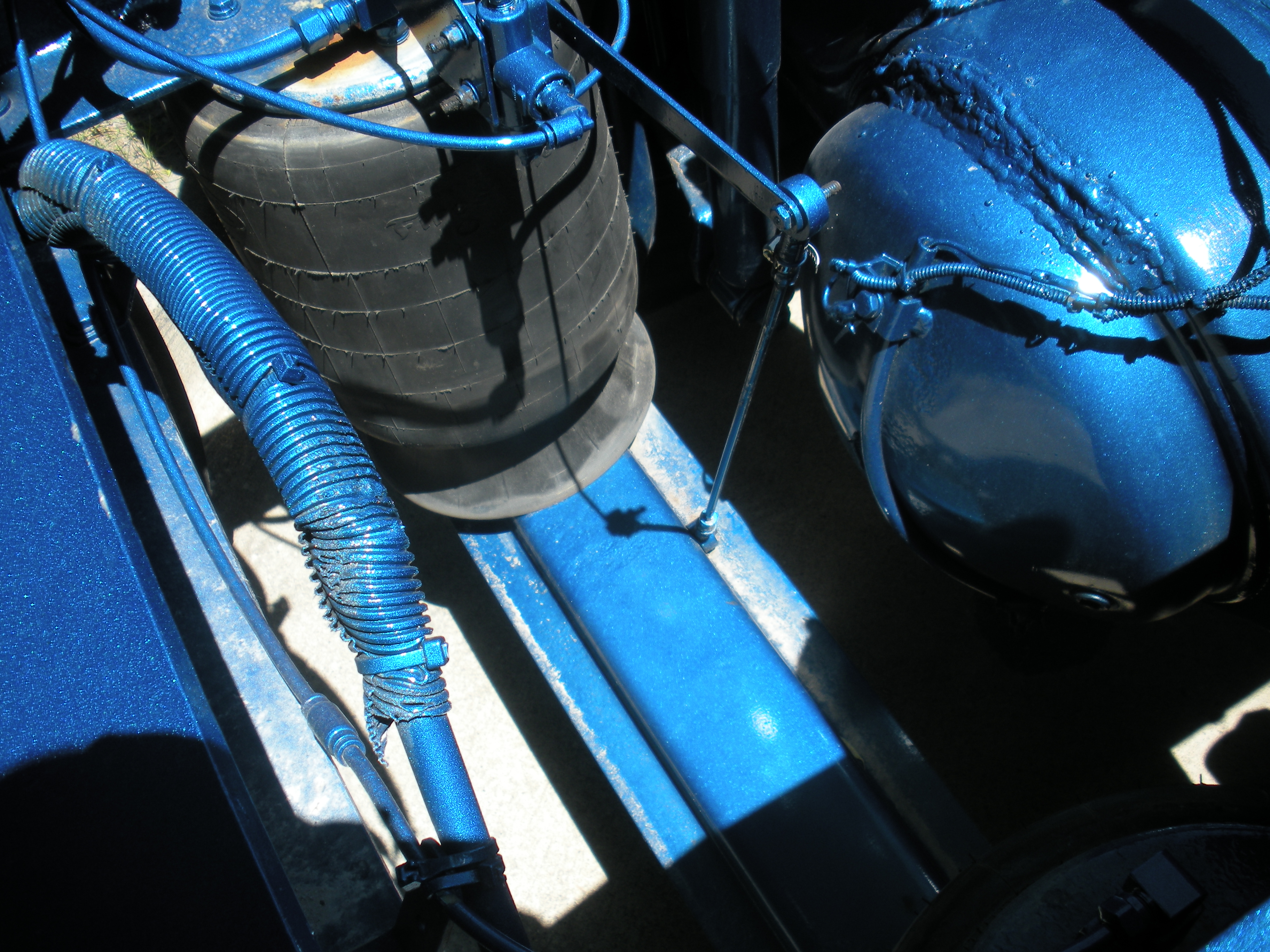

  15. Thanks ! Yeah about the air leveling switch piece -- I saw a couple different ones at the ATHS truck show in Des Moines and I couldn't make sense out of the piece in the kit or what it was patterned after. These are the kind I saw (on KWs).

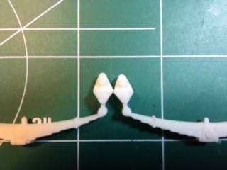

  16. Hi all: Two things I need some help with. 1) The piece called "air ride leveling switches" -- the instructions aren't really clear where on the frame rails this piece should go. Are the "fingers just supposed to butt against the rear cross member as I show in the picture ? How do you know where to locate it on the frame rails ? 2) Front springs -- the pin on one of the front springs is higher than the pin on the other front spring. So on one side, you have a gap between the frame rail and the spring mount bracket -- what have you done with this ?? Thanks !

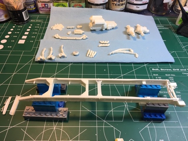

  17. Got the frame mostly glued together this weekend while watching the 1987 Atlanta 500 and the Motorcraft 500 races. Also got some of the other suspension parts cleaned up and the axles together. I need some help on a couple items -- I've posted that in the "Truck Stop" board.
