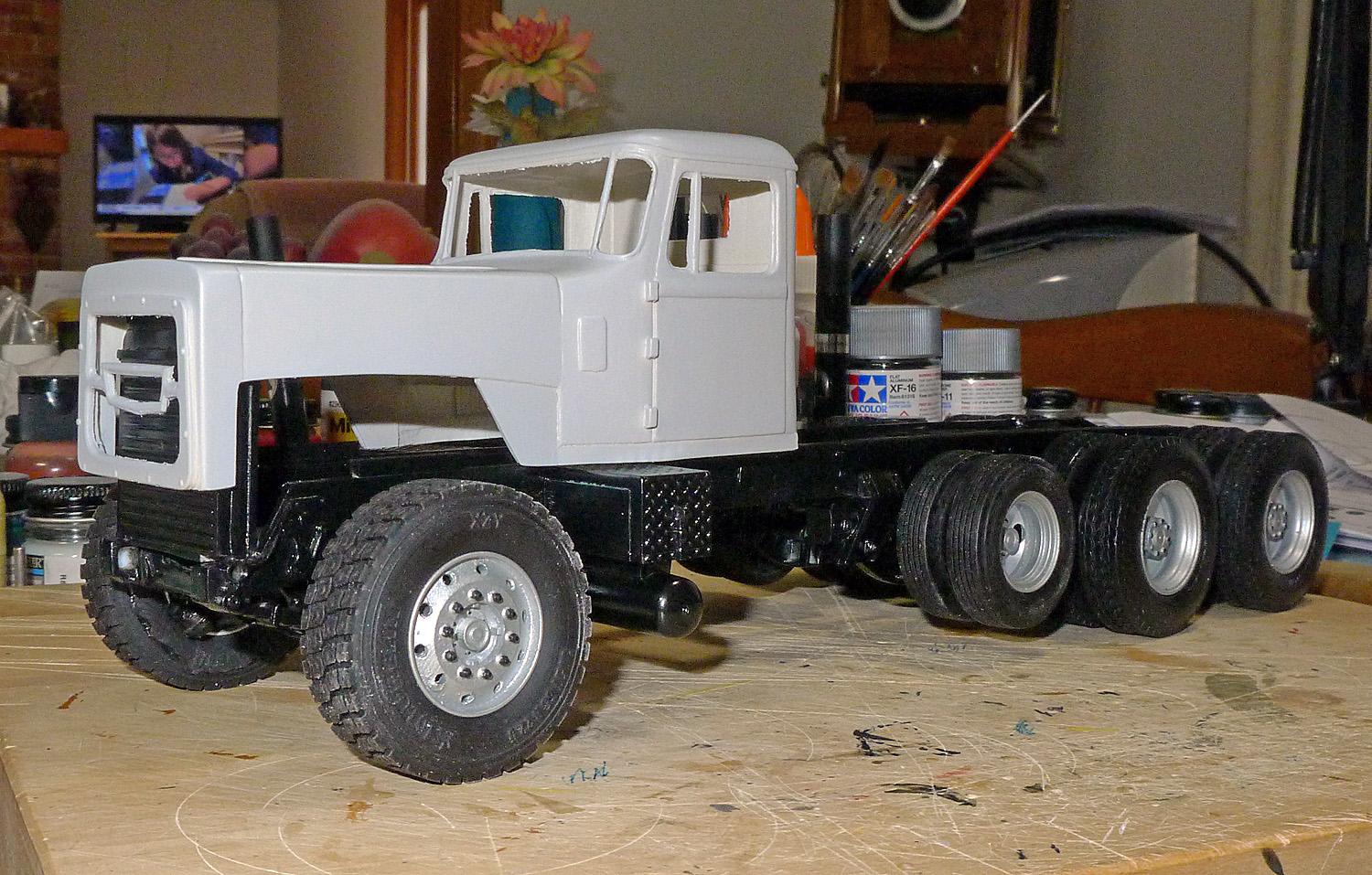

I was a little concerned the frame might be too short, but as it gets built, I think it will be fine. I picked up a KW Aerodyne frame but it's way too long at 13". I'm leaning toward the DD 6-71. I have one from Gary Wallace and it's mostly together. I left the front crossmember off the frame for now, need to see where the engine will land. I think the straight 6 will fit better than the V6. Yes, it sticks out the back but it seems to fit well under the cab and interior. I'm leaning toward the turquoise as the green is too close to the Waste Management colors. -

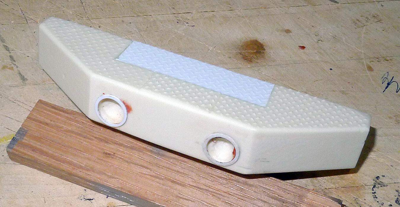

Starting the next build. The cab is from AITM, the Leach packer body is from Doug Wagner at Keystone. I think I'll use the Freightliner COE DD chassis, won't know for sure until I get it put together. Engine will be a Detroit 6, not sure which one yet, maybe a 6V92 or a 6-71. I'll build up both and see which one fits better. Wheels and tires are still up in the air, probably 22". I've skinned the visible flat panels on the packer body as it's easier than many coats of primer and days of sanding.
