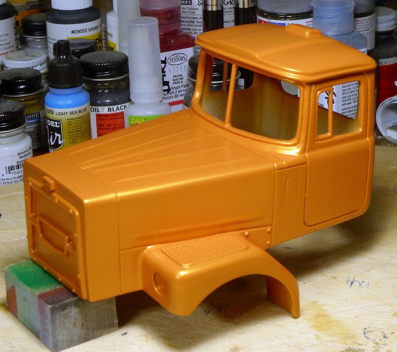

Calling this one done: -
Calling this one done, this is as the truck appeared at the June 2021 ATCA show in Bethlehem, CT. I was told that it had logos added for it's debut at Cortland a few weeks later. Chassis is the AMT Autocar A64B kit, Cab/hood, battery boxes and air tanks from AITM. Rear fenders from scratch. Tinted windows from my eye doctor (those throw away dark glasses they give you when they dilate your eyes). Paint is my own mix of acrylics. The real truck: My take:
