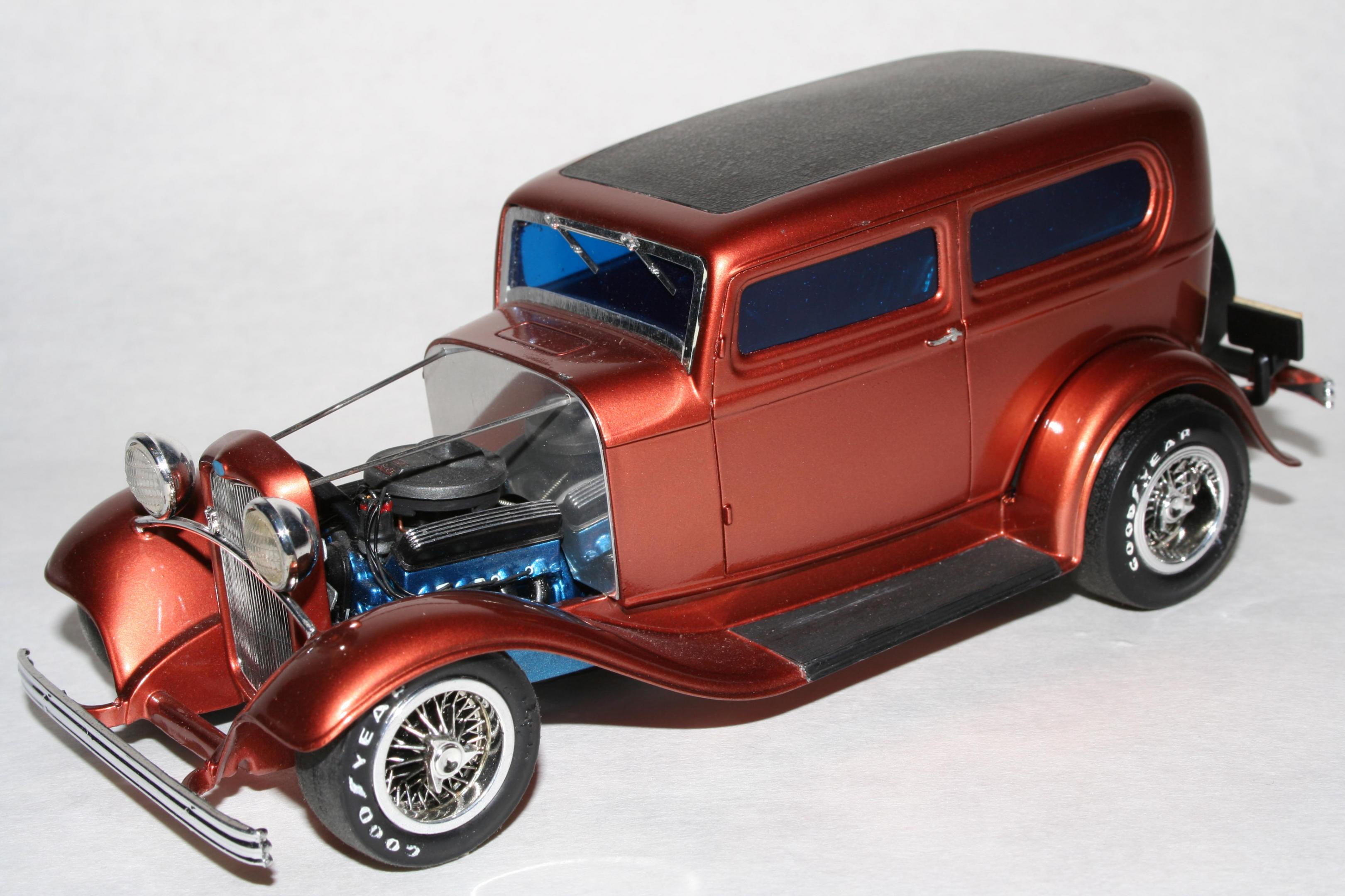

  9. Chop looking good. For some reason the sedan looks better when you lay back the A pillar rather than stretching the roof line between the A and B pillars as you do on a coupe - either 3 or 5 window I will take note of how you did it as I have a chop on a 32 Sedan on my wish list. Did one on a AMT Sedan years ago before they became unobtainable. I layed the screen back on this. The blue windows is a nod to @tim boyd

  13. Nice build Makes me green with envy
  14. I 2nd - Is that a photo of the model, or 1:1 vehicle? Seriously - I thought I was looking at 1:1 scale. Only after I started looking more carefully at things like the wiper arm, the cowl vents, and the shape of the water pump, I realized it is a model. It looks great
