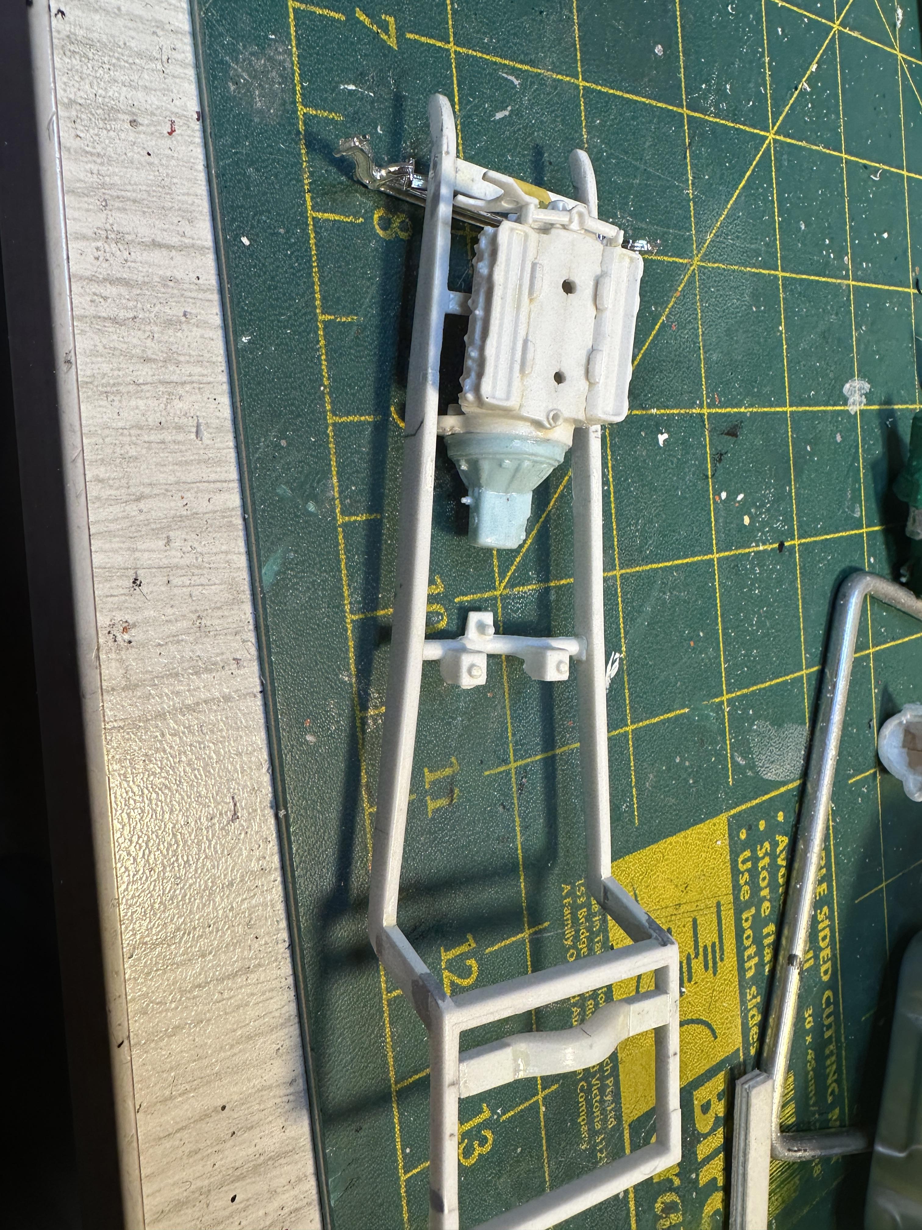

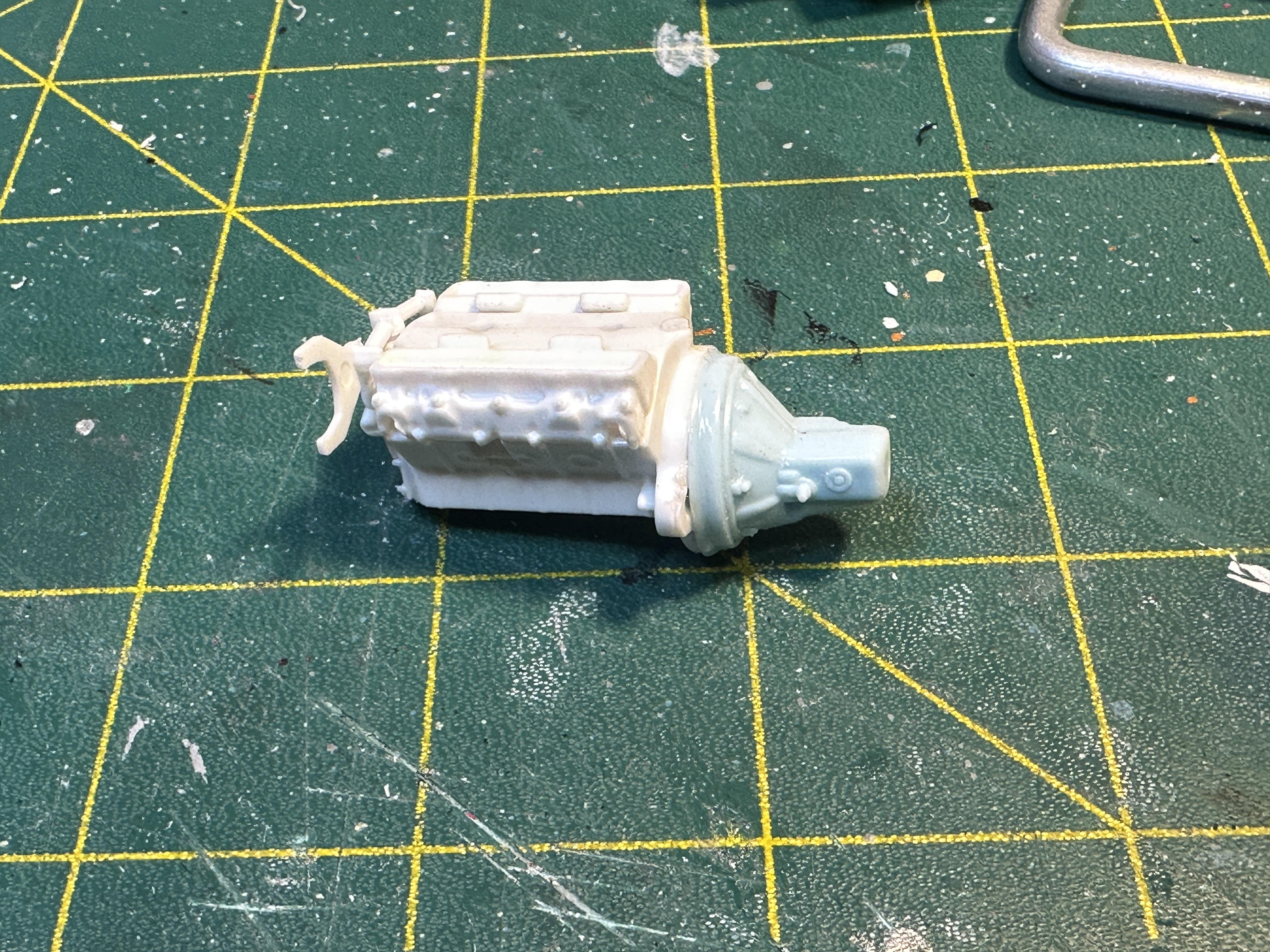

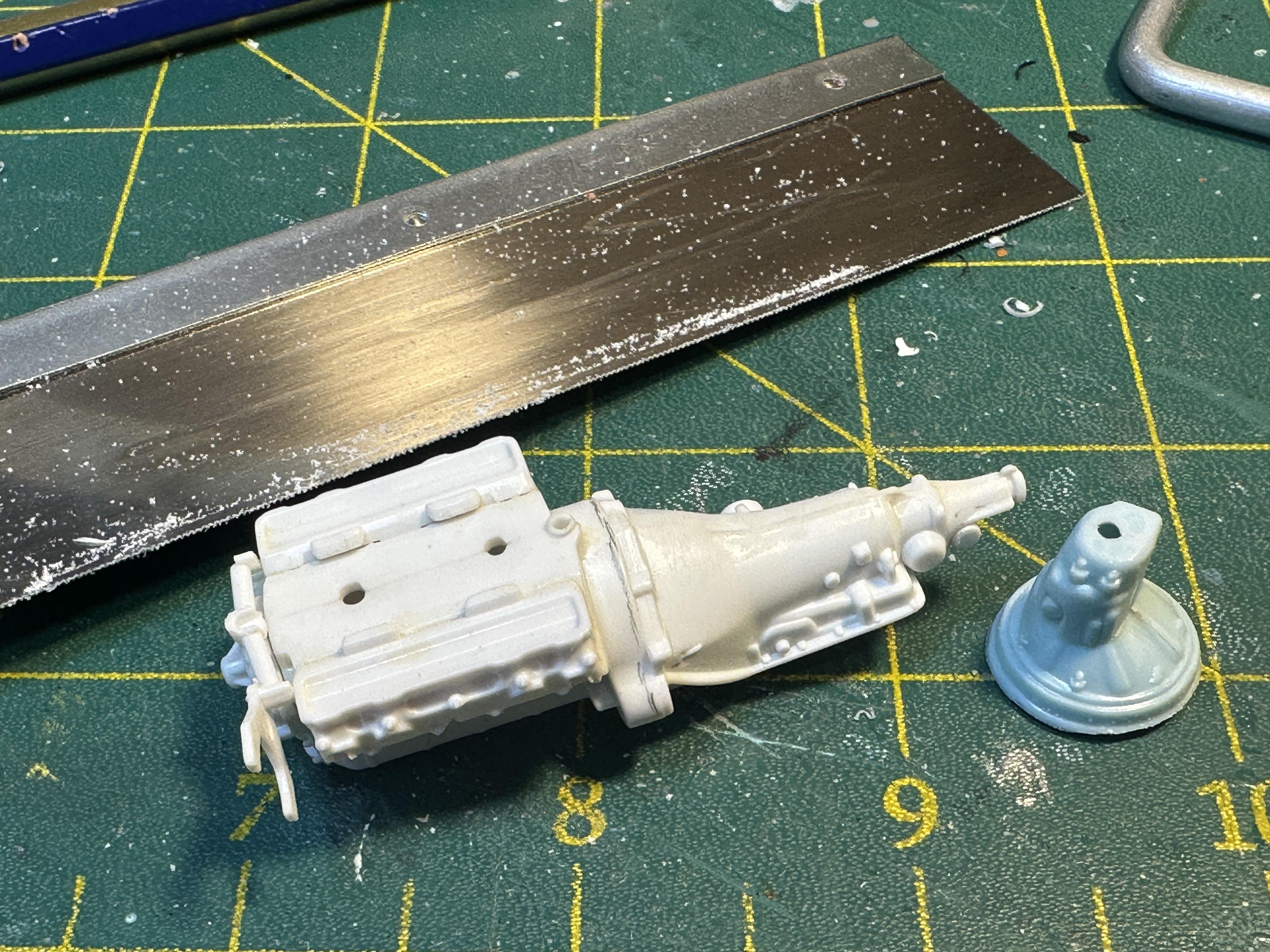

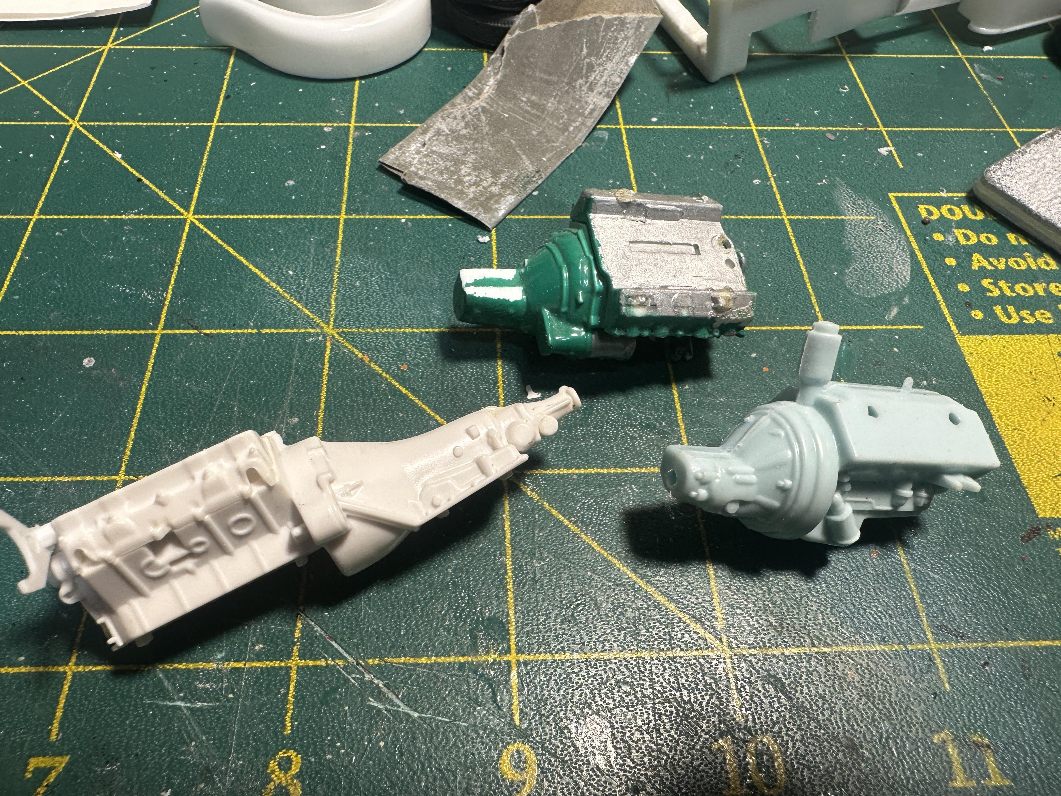

  4. A thought was to use the PU as a tow vehicle for a recent build - just not so sure now after seeing it mocked up. A way low tow car ahead of a way high drag car. Be a sight to see on the road. And I have enough left over LMG metallic blue for the pickup too. This is what happens when you mix scales - coupe is 1/24th Before I put together the mock up the thinking was that the nailhead motor from the 29 roadster is still a good tow engine choice but the slush-o-matic was not. I needed a period correct gearbox choice - in the parts box is a nailhead from the AMT 40 coupe - aha it is a flat motor gearbox with an adaptor - just what I need. Some surgery called for. The green motor in the background is a Ford 427 with a flathead gearox. There were a lot of optimists back in the day - but flathead gearboxes were cheap then And now together. The centre crossmember will now need to be moved for the shorter motor combo And then when I cut that out I noticed a little twist in the frame A tweak and a breakage - the front cross member broke out. Well a chance to get it glued back together - straight this time. This may have been one of the reasons for shelving this in the first place I am going to carry on with this build - it may not become the tow vehicle but what a support car. Just imagine a race car with tow truck and entourage all decked out in the same colour scheme Thanks for looking

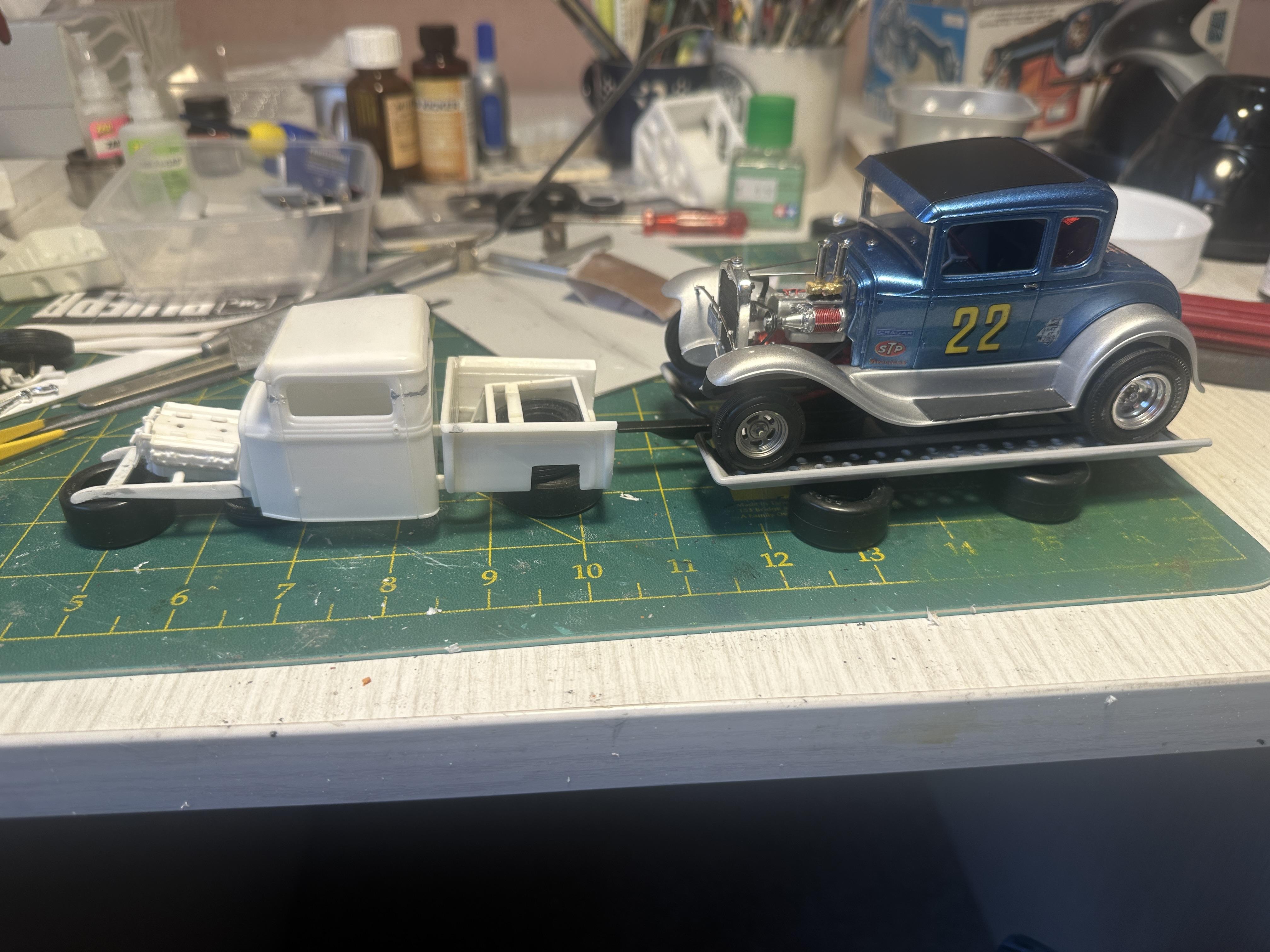

  5. A wee mockup with intended tow vehicle. This would look unusual coming down the road. A way low rod with a way high drag car.

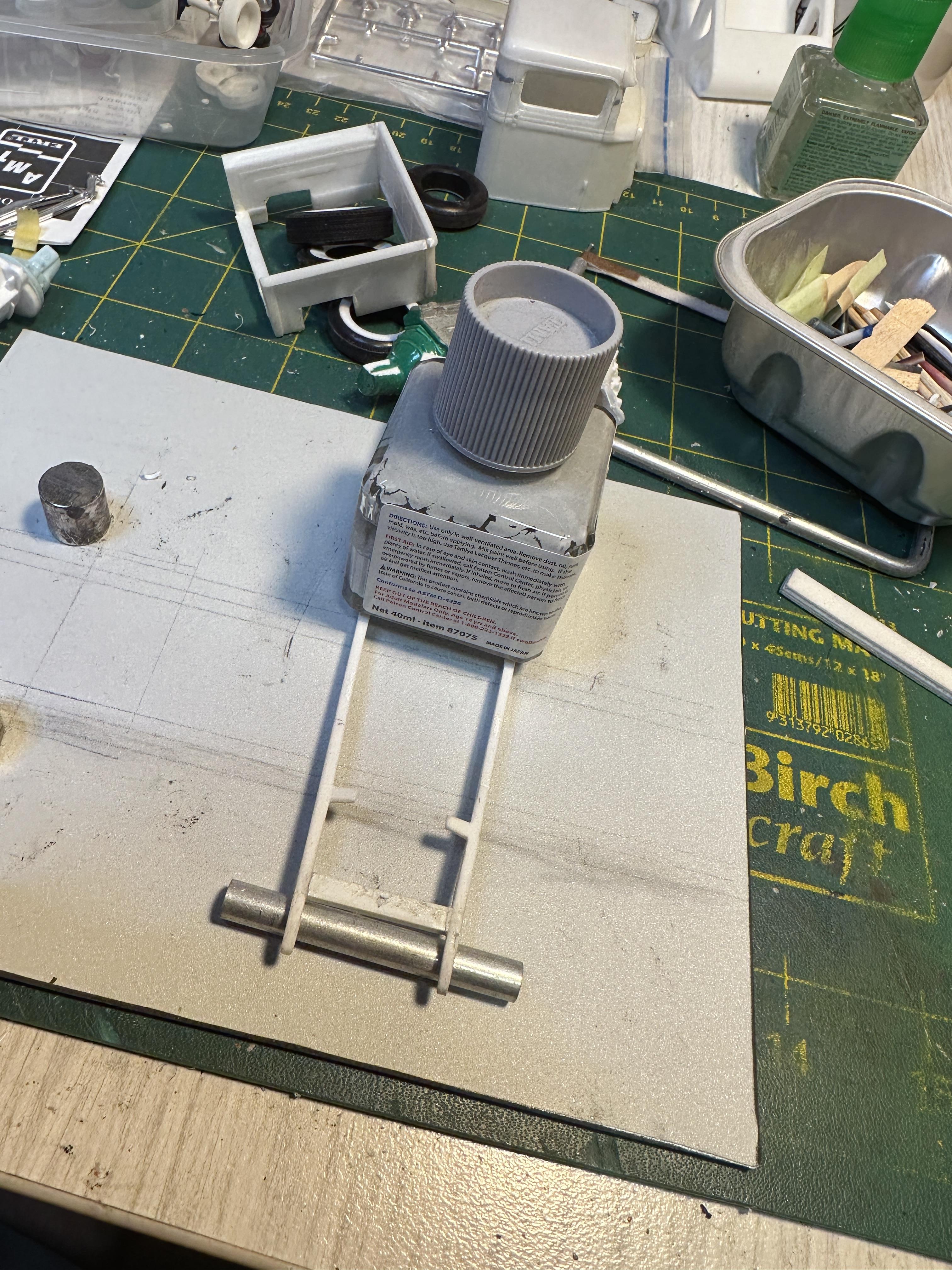

  8. Moving on to the chassis. As can be seen in the first pix above the frame has a serious zed in the rear. The chassis started out as the Lo-boy version from a Revell 29 roadster. The Z has been pinned top and bottom for strength as there will be a lot of handling before the is completed. A comparison. Also at the rear the axle locating tabs have been removed and part of a Model A rear cross member added for a buggy spring and has been moved forward to have the spring above the axle - one of the reasons for the big Z The front cross member has been removed and replaced with a flat cross member to get as much lowering as I could with out resorting to other methods. It would have been easier to double pie cut the chassis at the firewall and closer to the front end to get the front of the car in the weeds but the flat cross member is enough I think. I made the cross member by milling a groove into a piece of rectangular bar stock And in the frame At this point the transmission cross member has been removed after being glued into place to accommodate a gearbox change. This will be moved forward. The pickup box has been shortened a fair amount as well. This mockup shows where this was headed when I started the build Un fortunately those narrow slicks got used in another build so moving to the big'n'little cross plies in the original pix Next post is where this is now headed Thanks for looking
