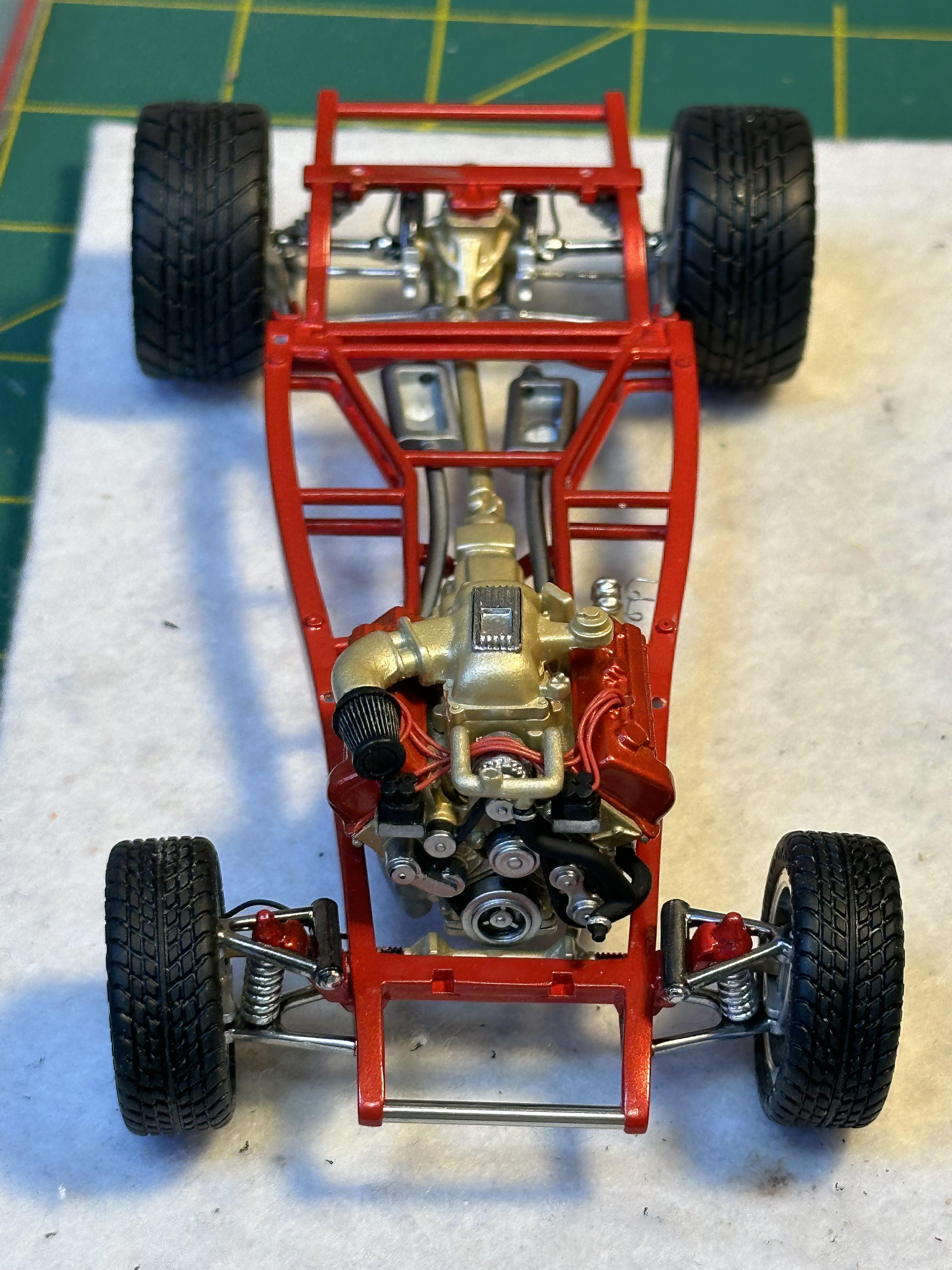

Body is back in the paint shop for clearcoating after I sanded out the worst of the masking tape rash and fixing some red overspray Between coats and sanding between coats I did some assembly work on chassis and motor. This is a very nice Mopar B motor I must say. Moebius call for it to be assembled as a wheezy old 2bbl 383 and give you the air cleaner decal for a 426 Commando. The carbs and intake are in the kit but not the air cleaner for the 426 so I have not put a decal on the air cleaner. I lost a front shock whilst cleaning it up, it pinged off somewhere so I made two replacements and have painted them metallic blue. Chassis assembly will continue when the paint dries.
I fixed the brake booster mounting and redid the brake line - sorry no pix Looked at the oil filter and was not happy with empty back side of it as it would show up when mounted on the firewall. Ugly! So to fix the ugly I made a small mounting flange and glued that to the back of the filter and gave it a touch of paint. I had to mess around with the mounting placement on the fire wall as the Thickstun head covers are quite large. Also the motor sprouted a few more line lines that need to be connected when the body meets the chassis. The new lines are oil lines to the filter. I did not clean up all of the mould lines on the oil filter as these were sand cast ally and there would be a parting line in the same place a the 1/25th version. If I were to polish it up I would remove them, but I haven't. A mock up to see how it looks It is getting there - just taking a bit longer than I thought
Got the headers all completed, painted and installed. Install a fan belt on the motor and mounted it into the chassis. Next up was marrying the kit exhausts to the headers. I cleaned up the mould lines and drilled out the ends ready to fit up. I cut the kit exhausts at the K member and bridged the gap with some 2mm solder. Pinned and bored the ends so they all fit nicely The exhaust system was painted with SMS stainless steel (headers too) and installed Note to self - need to fix the brake booster mounting and brake line View from top side - this thing is getting close to final assembly Thanks for looking

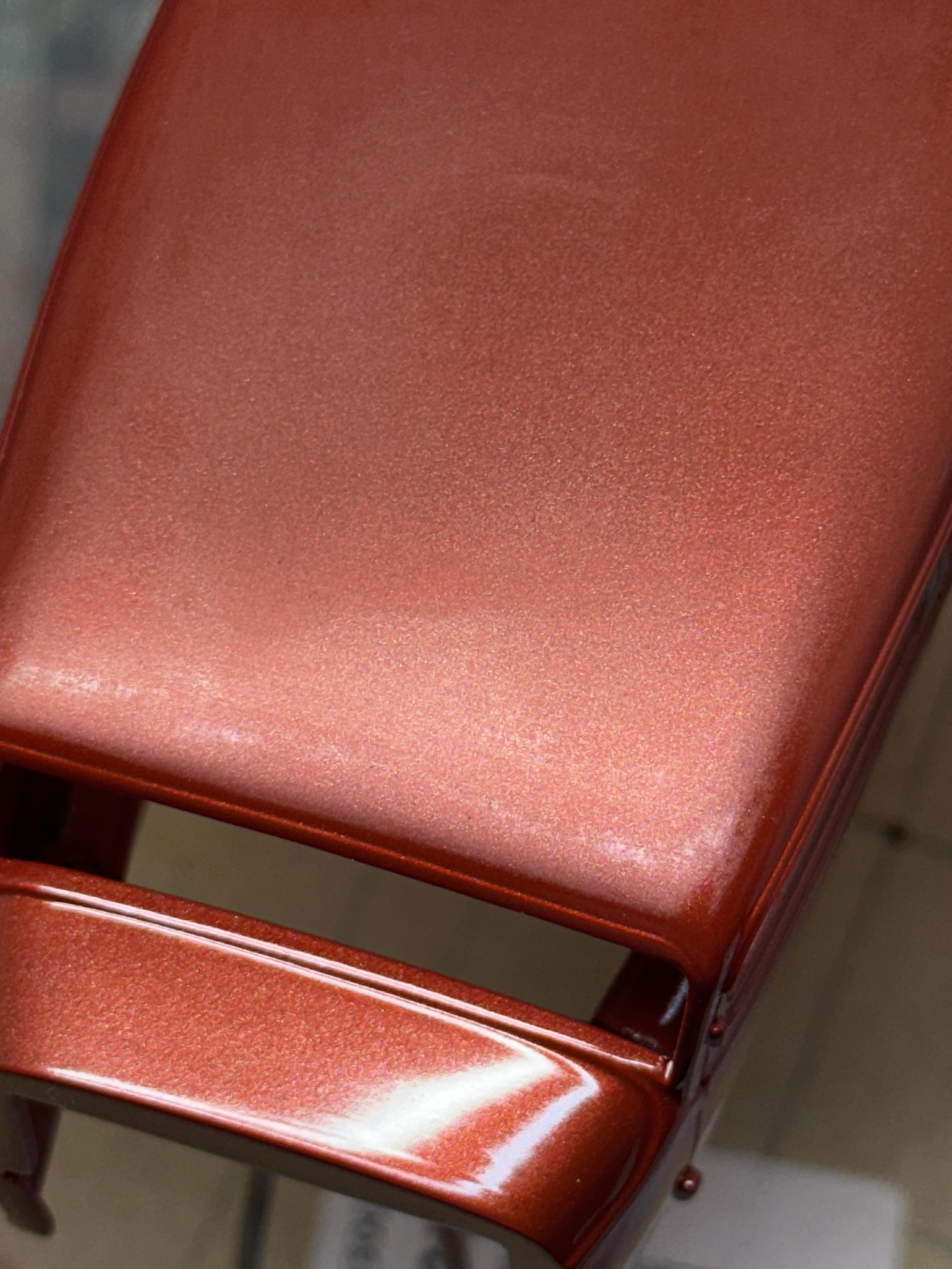

Goth the second colour on. Paints are Tamiya LP Racing white and Metallic Red. A reverse two tone. I have an issue I need to sort where the masking tape ate into the white. This is a known issue with Tamiya paints where they do take a while to fully harden. Even the lacquer takes a while just not as long as the acrylics. I waited three days but obviously not long enough. It is a bit hard to see in the white paint but it is there. Oh golly gosh (and some more explicit words were said)

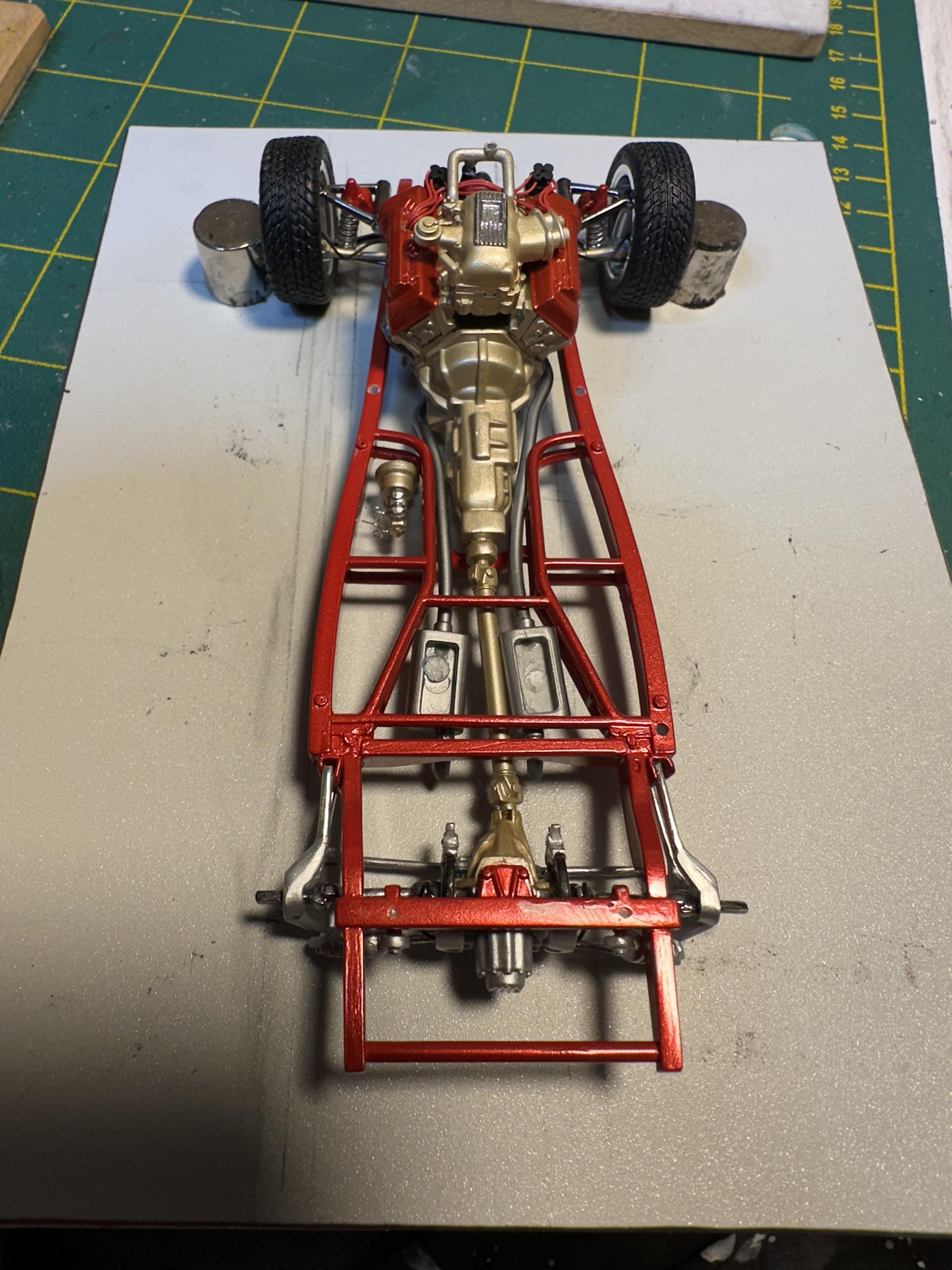

I went to fit up a starter motor - one from a sbf from a 32 kit - and it would not fit as I mounted the trans too high. Oh dash. Remounted the trans a bit lower and got the starter motor mounted up and went to install the Fenton headers that came with the motor but the LH side clashed with the starter motor - surprise, surprise as the Fenton headers are asymmetric. The original flat motor has the starter on the RH side but the later multi-speed manual I am using has the starter on the opposite side. To get over this wee hiccup I have scratch built a header for the LH side copying the one from the RH side. I check fitted and the LH header now clashes with the steering column. When I moved the tranny down I suspected that I would need to alter the front motor mounts - they now need to be longer so I made new ones up. This is the third set so far in the build. You can just see one sneaking into frame on the LH side of the pic.
