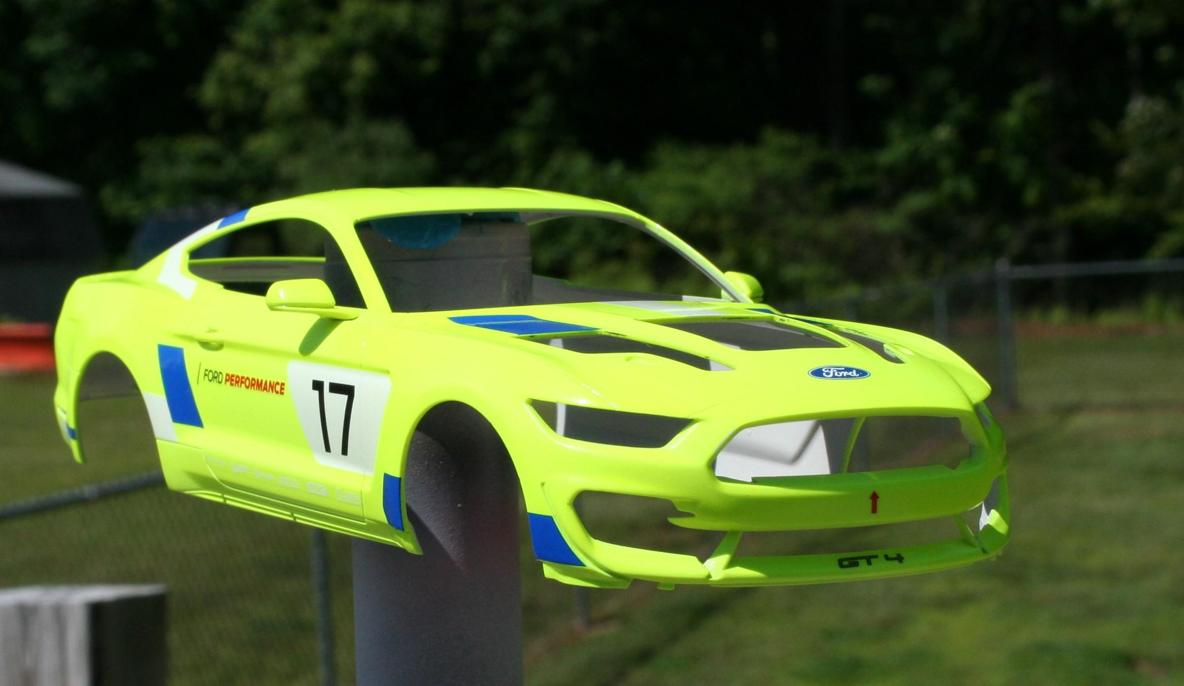

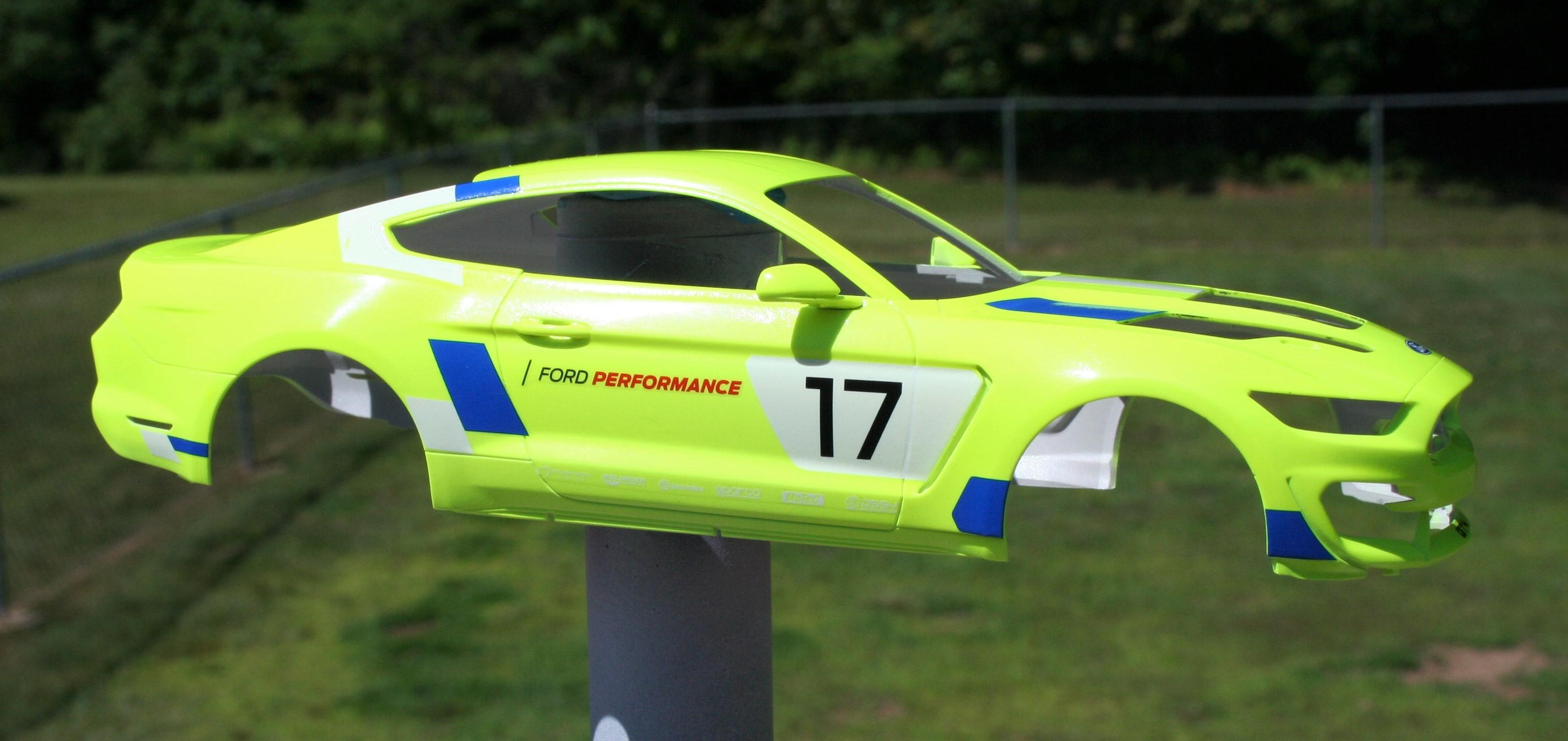

Volt GT4 Mustang
Penguins87 replied to Penguins87's topic in WIP: Other Racing: Road Racing, Land Speed Racers
I got the tires sanded and decaled last night. This morning I gave the body three coats of HOK USC01 clear. Now it must sit for 24 hrs. for clear to cure. -

I started this a week ago. Tamiya GT4 kit, Gravity Colors EUR flourescent yellow exterior sprayed over Tamiya fine white primer. Interior is AS20 Insignia White. Sprayed a coat of Tamiya clear to smooth out and seal the color for decals. IndyCals for the decals- microsol and hair dryer on low to set them. Going to now give it about 3 coats fo HOK USC01 clear. I have to touch up a couple places where the grey decal didn't cover over a lip. Tamiya's German Grey is a match.

Thanks all. I bought four more of these kits and some decals from Indycals. Doing the Volt car now. Painted interior on Saturday (AS20) and exterior yesterday (Gravity Colors flourescent yellow). Got to put down a couple coats of lacquer clear and polish out before decaling. -

I used Createx Wicked Colors, Flourscent Yellow and House of Kolor USC01 clearcoat. Love their clear. It self levels and requires very little polishing. However there was a learning curve to get it reduced for our scale projects. I've done a couple Nascar kits before the GT4 and used it. Seemed to go on to thick and kinda syrupy. They say mix 3-1-1 (paint, reducer, catalyst) probably perfect for full size cars. Looked good but I found (3-3-1) misted on is better. Doesn't build up as fast. More realistic to scale. Dries hard in less than 24 hrs. -
