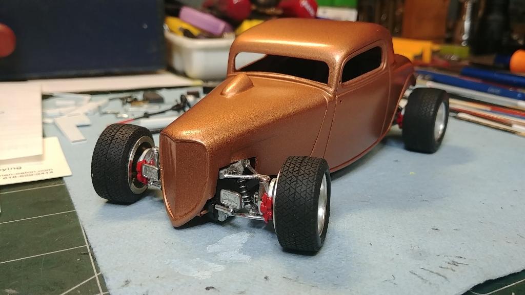

Introducing the Copper Coupe! I started this 25+ years ago, then it went into storage while I built other kits and spent time on my many other "hobbies." Got it back out last year determined to finish it. That took a while, but here she is! The body and center frame section were all that was used from the Monogram ZZTop Eliminator kit. Many mods including: - roof molded to the body - molded in windshield frame - 1-piece molded tilt & removeable front hood assembly w/sectioned grill - recessed and smoothed firewall - custom partial belly pan - opening trunk lid with working strut - scratch built trunk with 3D printed fuel cell - custom fabricated hood and trunk hinges - chassis modified with scratch built front and rear subframes - independent front & rear suspension, 4-wheel disc brakes, and rear transaxle, all from the Hardcastle & McCormick Coyote - Chrysler 2.2L Turbo from a Dodge Daytona kit, modified for RWD - aftermarket Fujimi wheels and tires

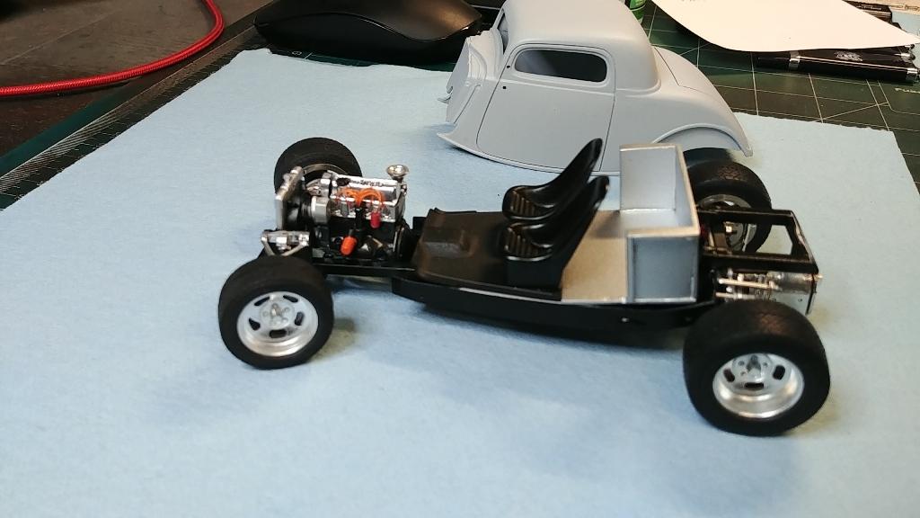

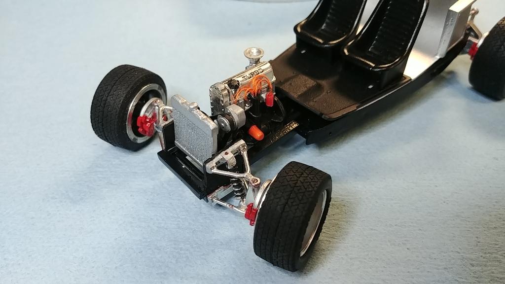

A little more progress... Yes, this is a really slow build. Not necessarily because I actually build slow, it's just that I have a lot of other things going on. It's difficult to find time to sit down at the bench. And I thought I would have more free time in retirement! ?? Anyway, I've got the rear interior tub fabbed up and painted, rear suspension prepped with mounting pins, front frame fitted with pins for mounting the suspension, and a few small parts painted. The frame should be ready for paint soon, then the body. -

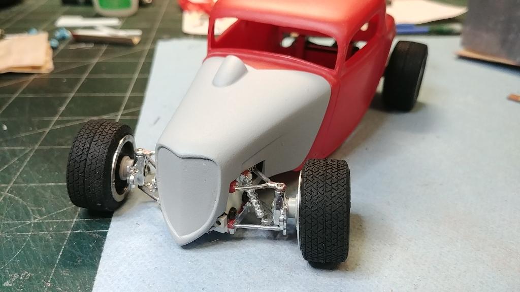

Some more progress. Got the hood scoop molded in and the tilt hood unit smoothed out a little more. Scratchbuilt the trunk box and got it fitted and started molding in the recessed and smoothed firewall. Also smoothed the grill bars off on the sectioned grille shell. Will use a grille decal after paint. Every modification requires reworking something else. Lots of work yet to do. The body is channeled over the frame which will require modifying the interior panels. Will also be using a modified dash from the parts box. . -

I have been traveling for a while, but finally got back on this one today. I temporarily pinned the body to the chassis so I could keep the body and hood aligned to make and install a discreet hinge for the one-piece tilt front hood. It was a bit finicky, but I think it will be OK. Now to get busy on the rest of it! -

A few updates... Rear inner fender panels installed, trunk lid hinged, body smoothed out a bit more, flat firewall created, and the engine somewhat detailed and mockup-fitted. What is the offset rear-facing hood scoop for you ask? It feeds cool air to the velocity stack on the Chrysler 2.2L Turbo 4-banger! Engine has been reconfigured to north-south orientation (instead of east-west FWD) and fitted with a clutch bell housing to connect the driveshaft to the rear mounted 5-speed transaxle. Lots more left to do! BTW...those "giant" 2mm screws holding the front suspension to the frame are temporary for mockup only. Once the frame is painted, the suspension will be glued and screw holes filled in. -

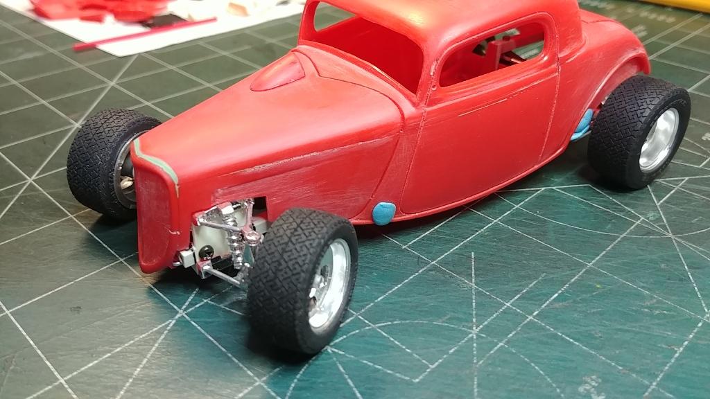

A little progress... Got it sitting on all four wheels and the one-piece hood/grill assembly fitted. The goal is to have a tilt hood, but not sure yet if that will work. Smoothing out the body and LOTS of fitting, filing, modifying.... -

Started this project about 20-25 years ago. Time to get 'er done! Monogram ZZ Top Eliminator kit. Rear mounted transaxle, IRS and IFS from unknown kit. Engine will be unique as well. Stay tuned!

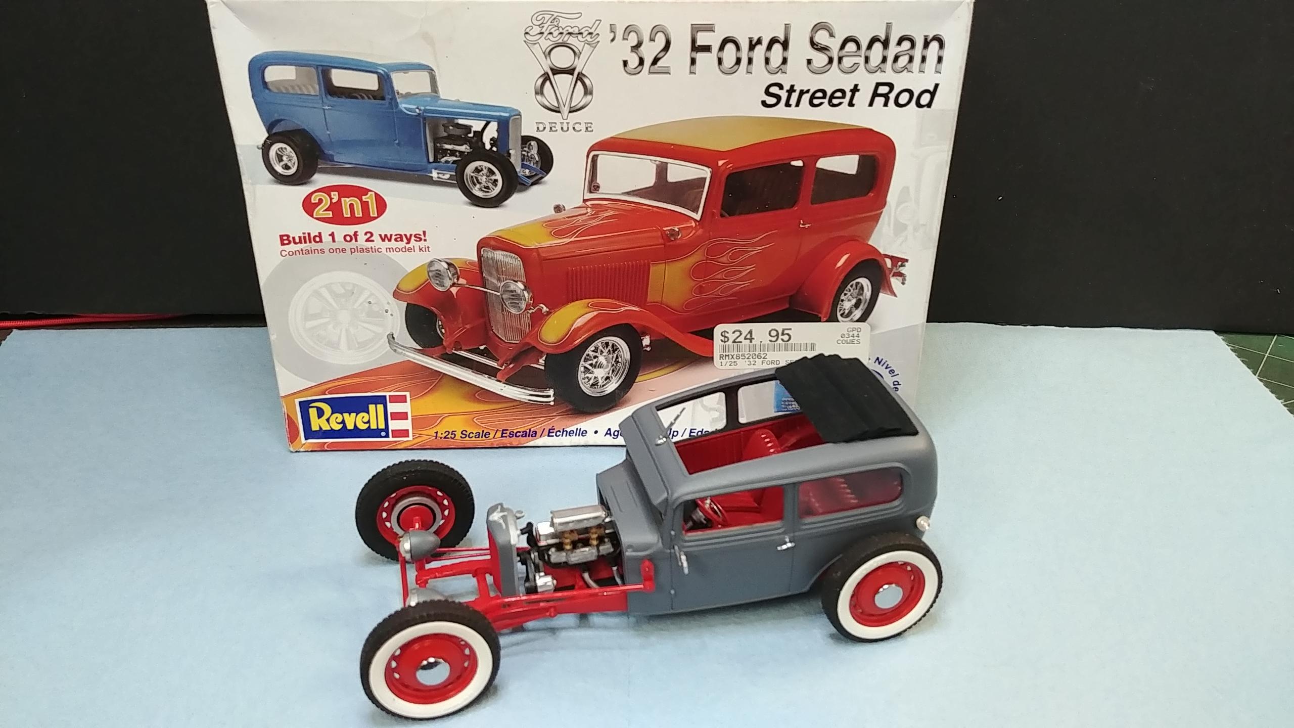

I haven't posted here for some time due to not working on models much lately. However, I did finally get one finished! Started with Revell '32 Ford Sedan Street Rod 2 in 1 kit, but I think I may have gone a little bit beyond "Build 1 of 2 ways!" Lots of mods and scratch building. Body: Channeled over the frame, frenched rear tail lights, scratch built sun visor, scratch built folded fabric top, recessed firewall, chopped radiator shell, '39 Chevy head lights. Rustoleum 2X grey primer. Interior: Front seats and door panels cut down, rear seat reshaped, custom shifter (bent straight pin), '59 Impala steering wheel. Testors metallic red lacquer. Chassis: Stock kit frame and rear suspension, spare parts front dropped axle, quarter elliptic front leaf springs, scratch built steering linkage. Testors gloss red enamel. Artillery wheels and tires off a 1/18 diecast. Hubcaps are chromed steel plug buttons. Engine: '51 Chevy 235 6-cylinder, dual carb intake, split exhaust, scratch built magneto, breather tube, exhaust head pipes, fuel line and radiator hoses. Exhaust: Stock kit duals mated to custom head pipes and finished off with scratch built chrome steel tips. From spare parts box: Wheels & tires, brake drums, head & tail lights, dropped I-beam front axle, front leaf springs, steering wheel, engine, air cleaner scoop, quick-change rear end center section. Scratch Built: Fabric top, sun visor, magneto & wires, crankcase breather tube, fuel line, radiator hoses, exhaust head pipes, front suspension & steering linkage, shifter, body mounts, recessed firewall. It was a challenging build, but fun!

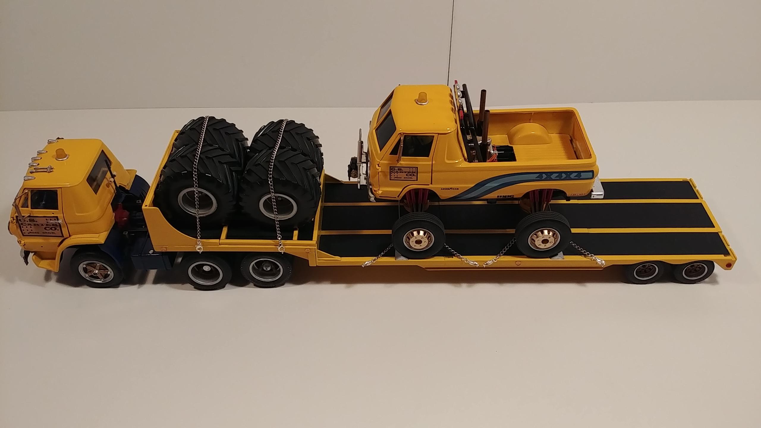

Well... I thought it was done.... With the load on the trailer I discovered that the trailer was bowing at the joint between the drop deck and the upper deck. I was concerned that long-term display with the load would result in permanent tweak of the trailer. So...I added a couple heavy duty triangular supports disguised as a toolbox. NOW it's done...I hope!

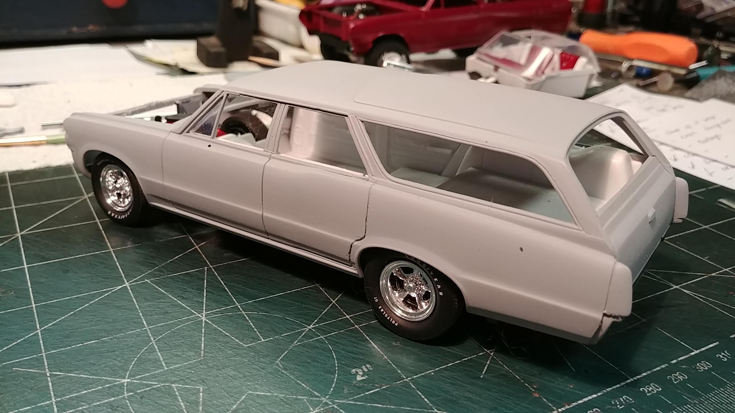

Thanks! Well...I really need to finish the 1/25 '64 Tempest wagon project I started a couple years ago. But first I need to get a 1:1 Honda 550 running so I can sell it.
