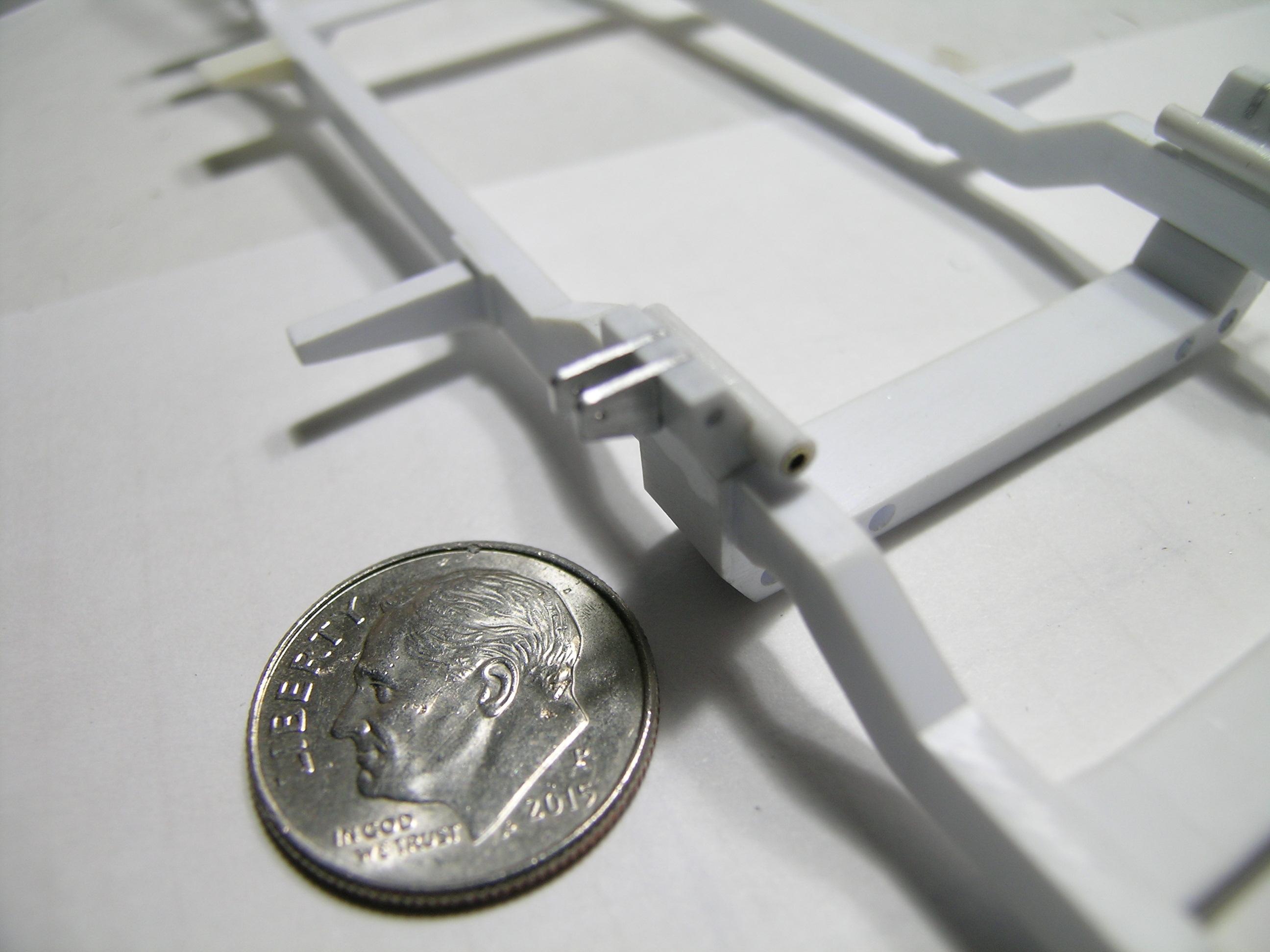

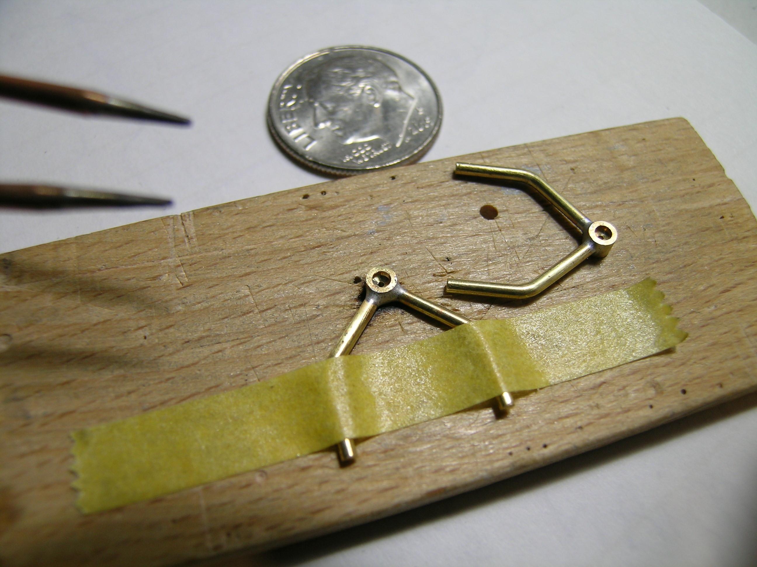

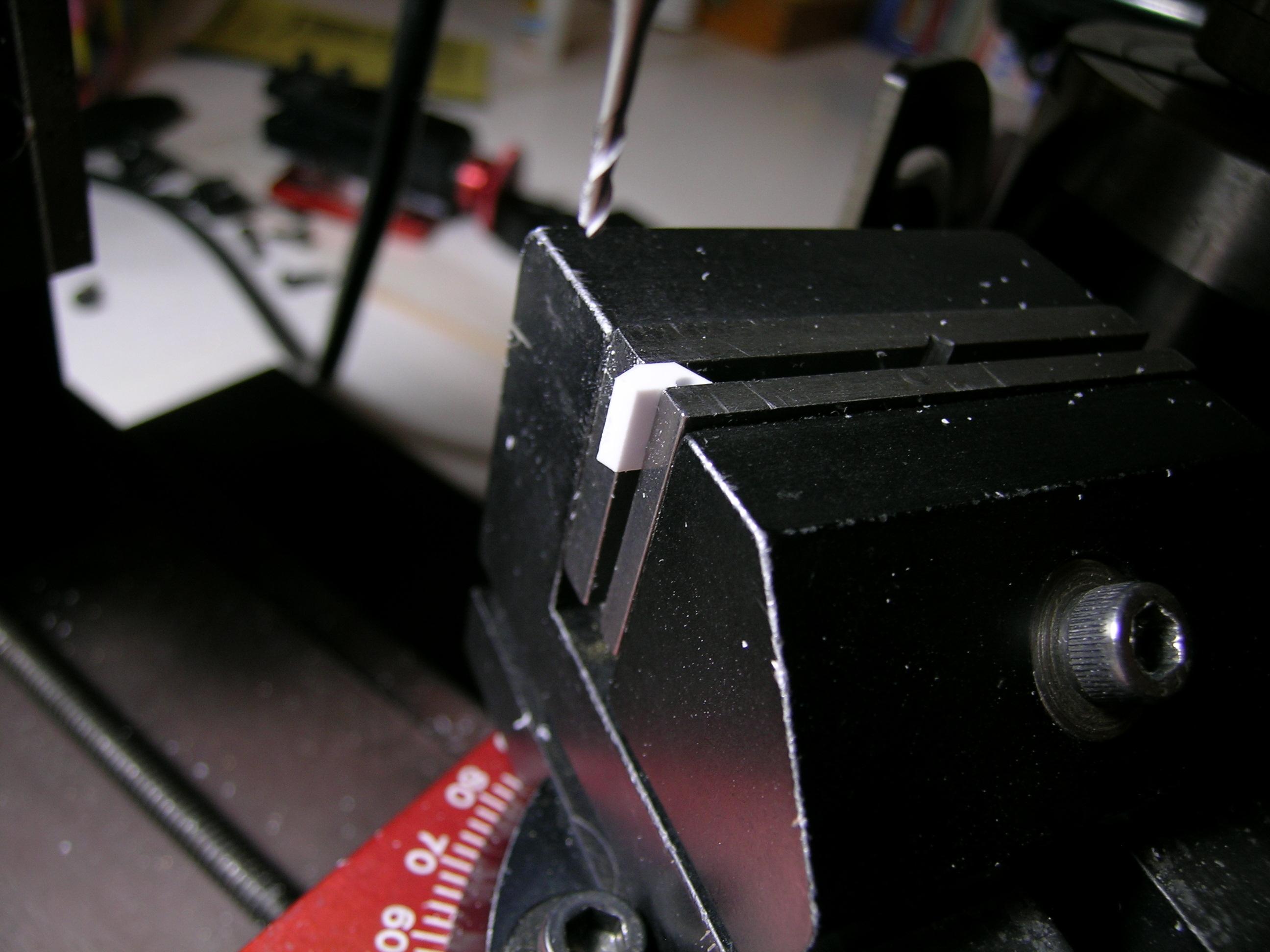

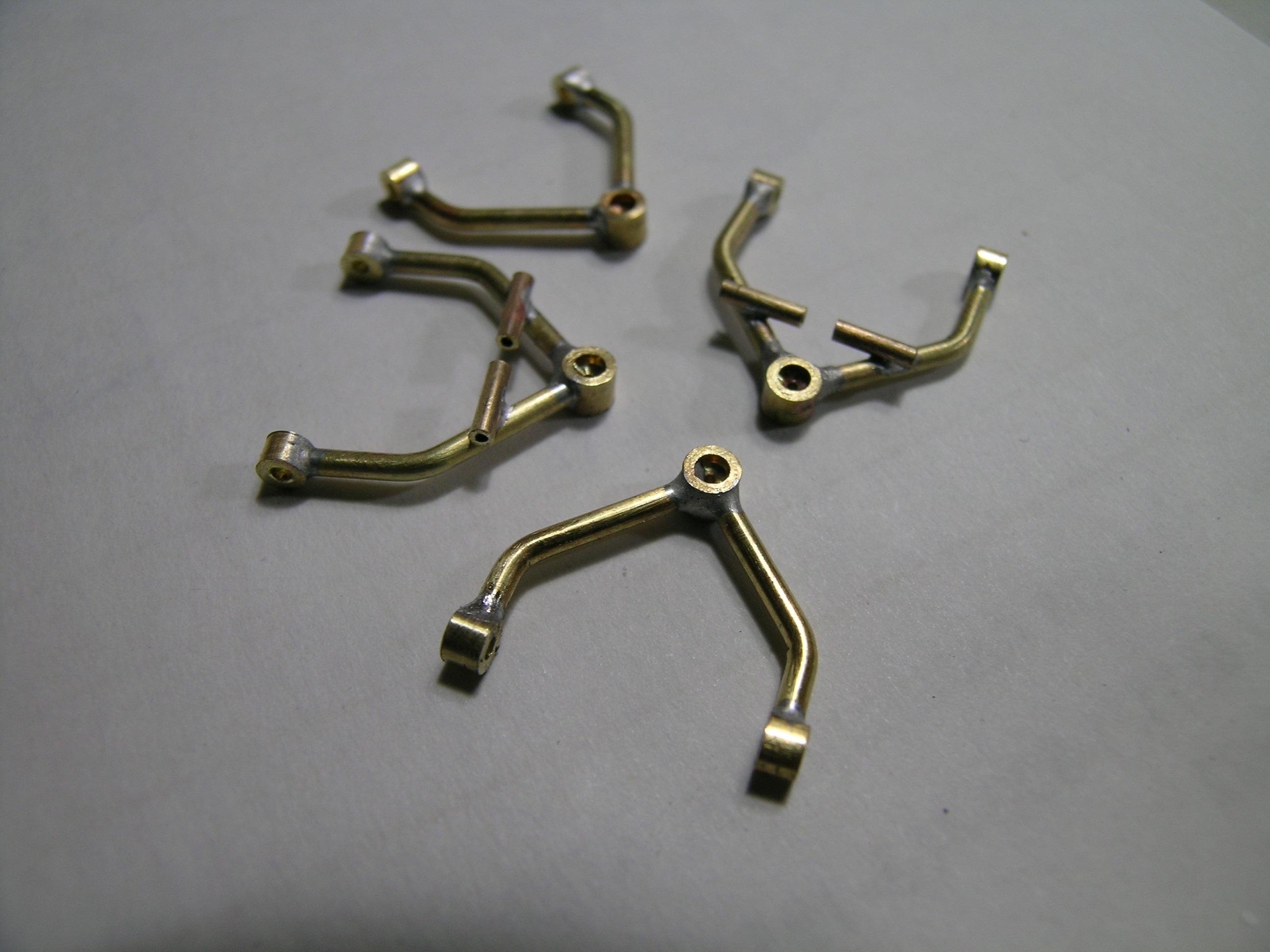

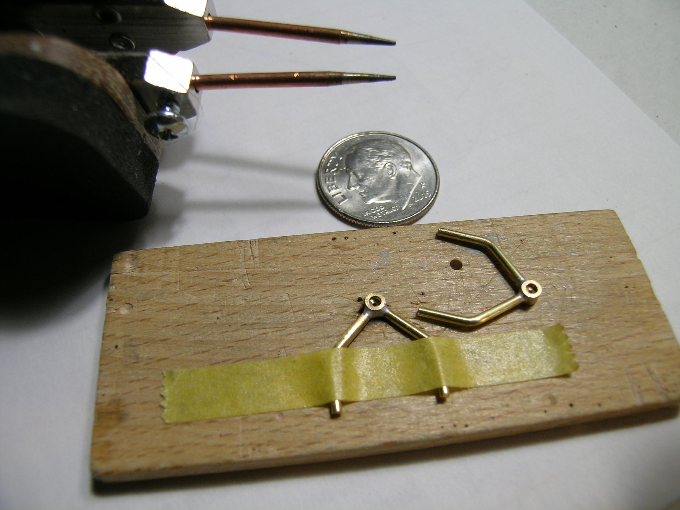

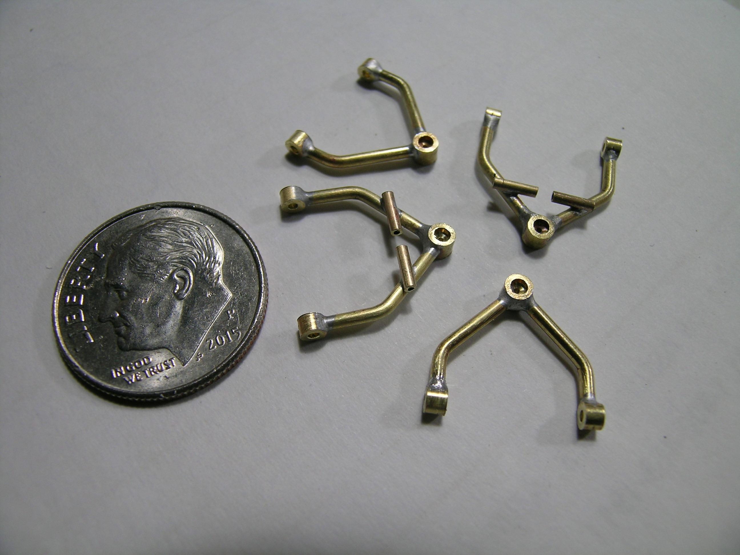

Hello All, Moving back to the structural base of this build I decided to try something new to me by making some of the front suspension components from brass. I do have few experience with welding brass parts and those are critical parts and must be as perfect and equal sized as possible to get the front straight. The brass wishbones will be stronger than plastic and the weld will also make them more reliable than aluminum. The glueing points are too small and the superglue might surrender after some time. Again, I might have to make some adjustment during the construction, it's almost inevitable in this kind of build. Besides, it happens in the real world during the construction of a real vehicle ... Cheers, Francis Part of the front suspension on the milling. This is a part that will receive the bracket for the upper attachment of the shock. Part of the suspension installed on the frame (I inserted aluminum anchors for durability). View of both sides. Wishbone arms in progress made with brass rods and welded by resistance. Closer view Upper and lower wishbones with mounting eyelets. Same pieces, note the perpendicular tiny tubes are the lower shocks mounts. -

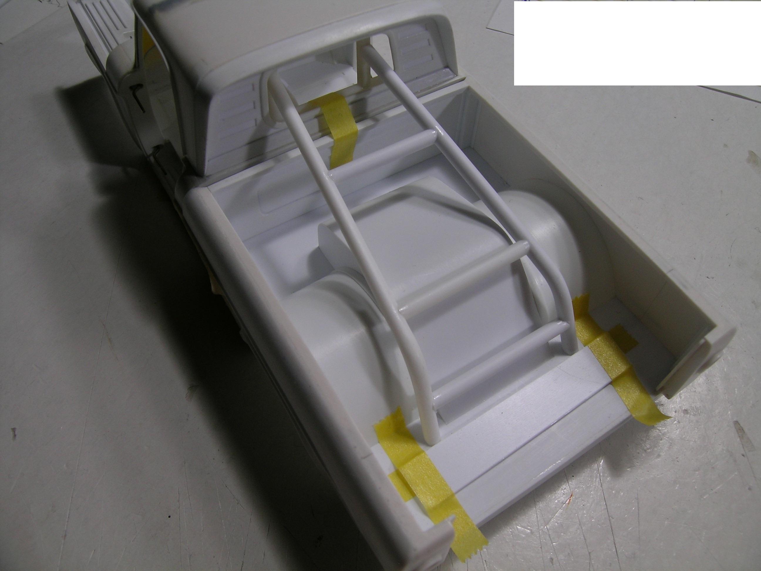

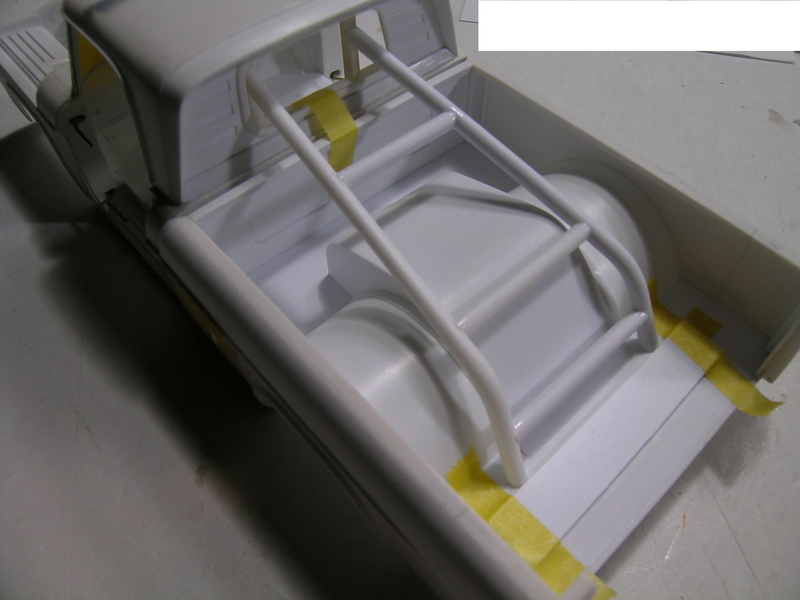

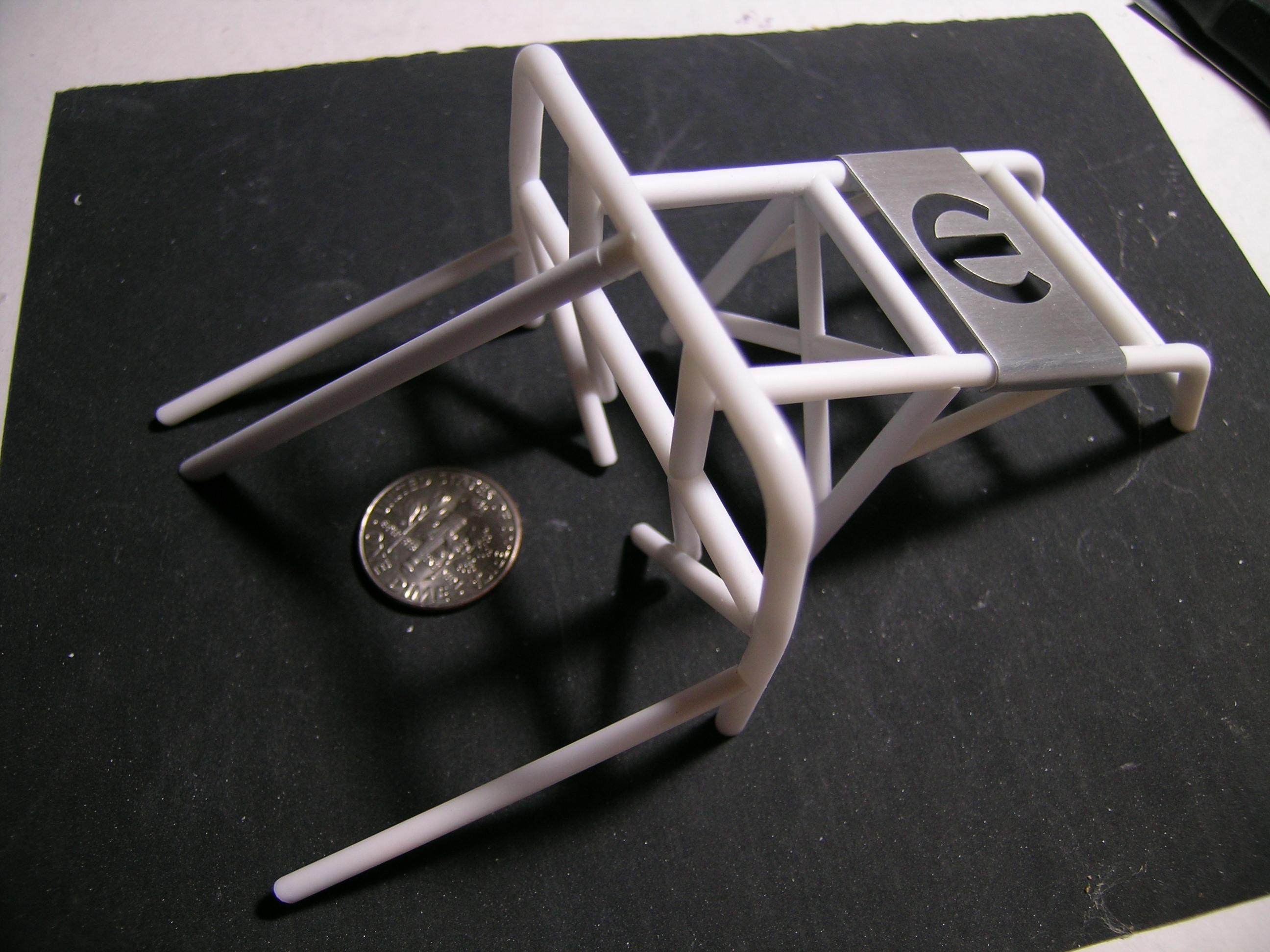

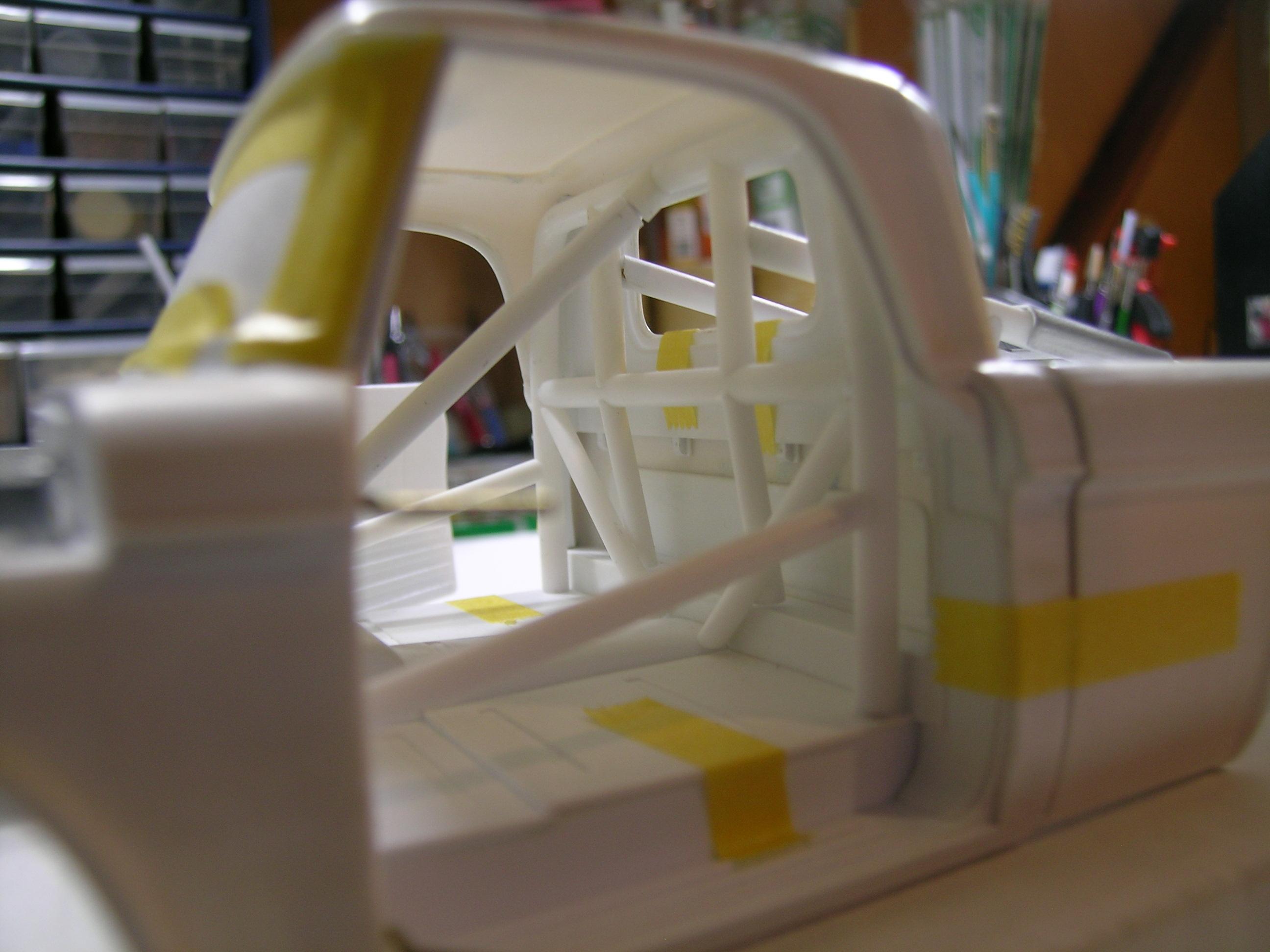

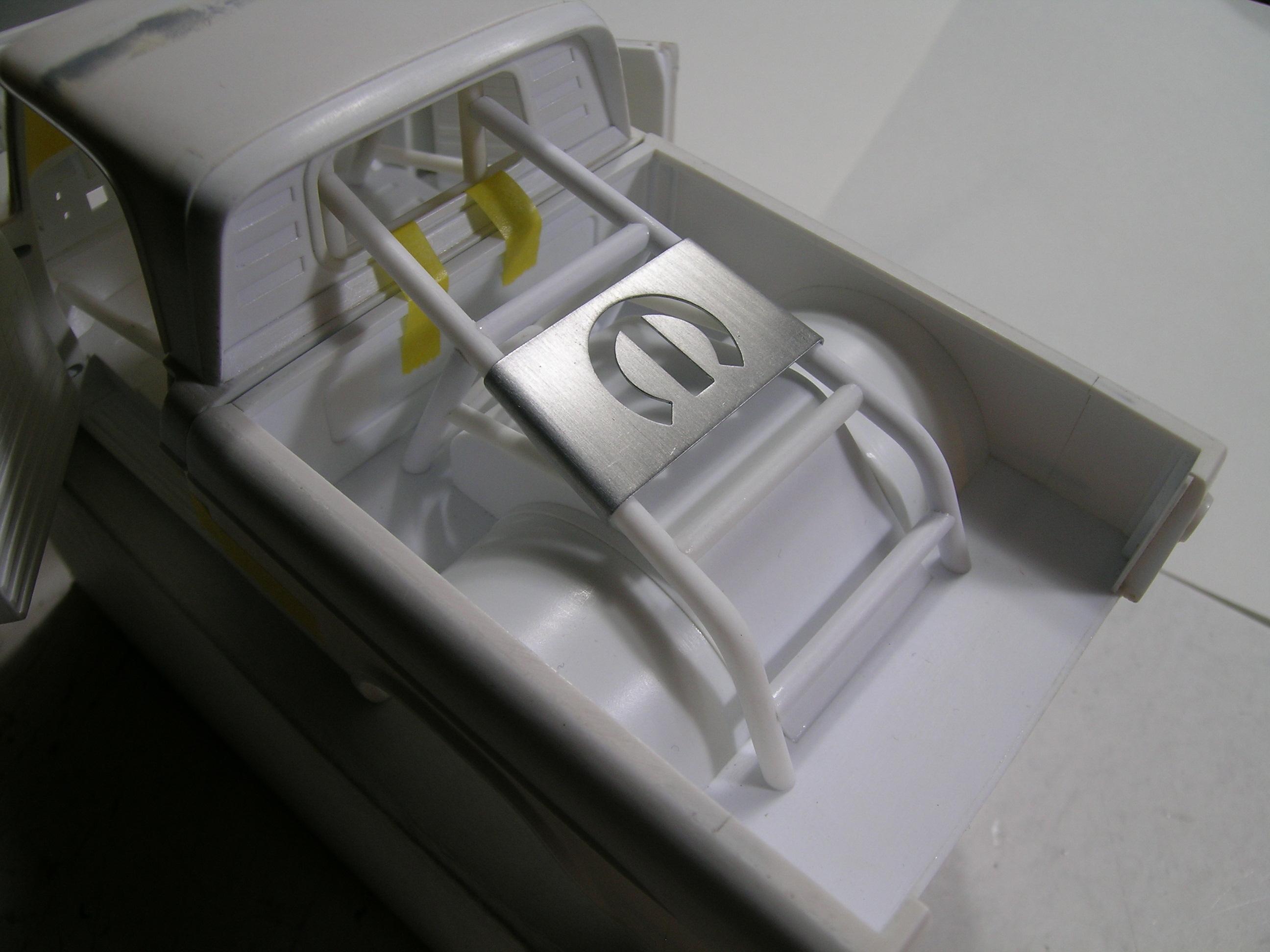

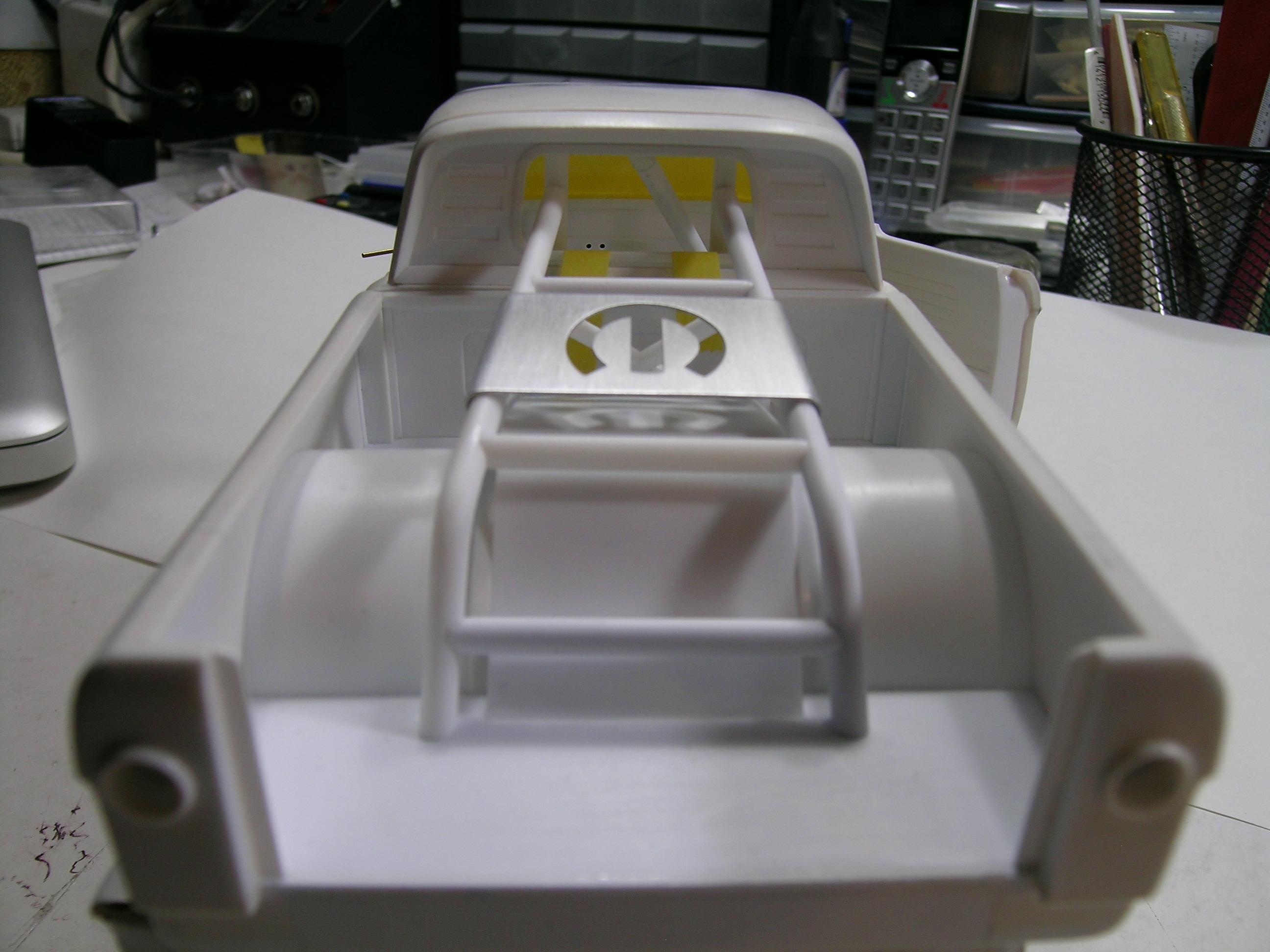

Hello Everyone! Today's update is for the roll cage. I was dealing with the idea to make the bed tilt but after some reflexion I do prefer to keep it bolted to the frame and add a roll cage to stick with the drag racing soul that I want to implant to this build. Some of the details between the back of the cab and the bed will be hidden but it's like that on the real truck anyway and you all know that I've made them. The section inside the cab that touch the transmission tunnel could need some adjustments. I'm not 100% sure yet but I think that I will machinate a Lenco transmission so the tunnel will probably need a major modification. After the roll cage for the cab was made I decided it would be cool to add a section in the bed like the NASCAR trucks. The main tubes are made with 0.125’’ styrene rods for a sturdy look. Different angle, I taped a strip of styrene to keep the main tubes straight during the construction. I decided to add a reinforcement plate so I made one with 0.010’’ aluminum sheet. I used 0.125’’ solid brass rod as a guide to rounded the edges in order to make them fit the main tubes. I thought it would be cool to add a MOPAR logo so I drawn one and made an opening with a 0.063’’ drill bit and opened up the logo using a half-round jeweler file. I did test fit the plate on the roll cage and looks great! I will drill small holes and put some small aluminum bolts on final installation. Completed roll cage including the section inside the cab. I will probably open 2 holes in the back window in order to connect both sections together. Roll cage in position for test fit. Roll cage seen from inside the cab. View from the back. -

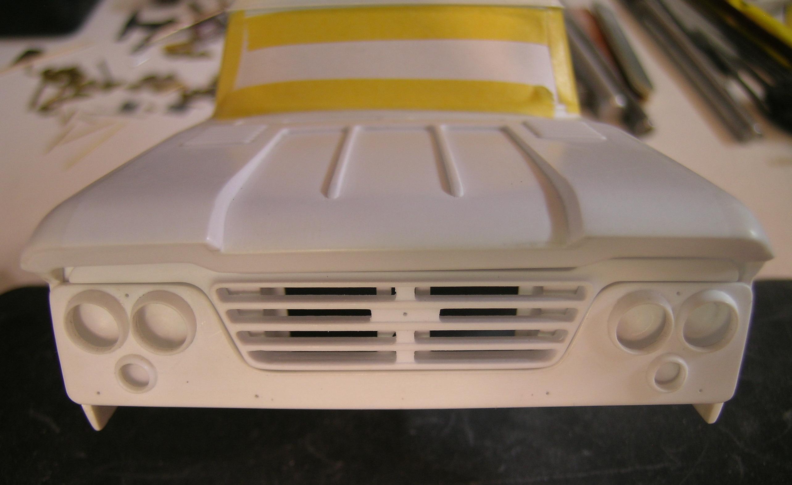

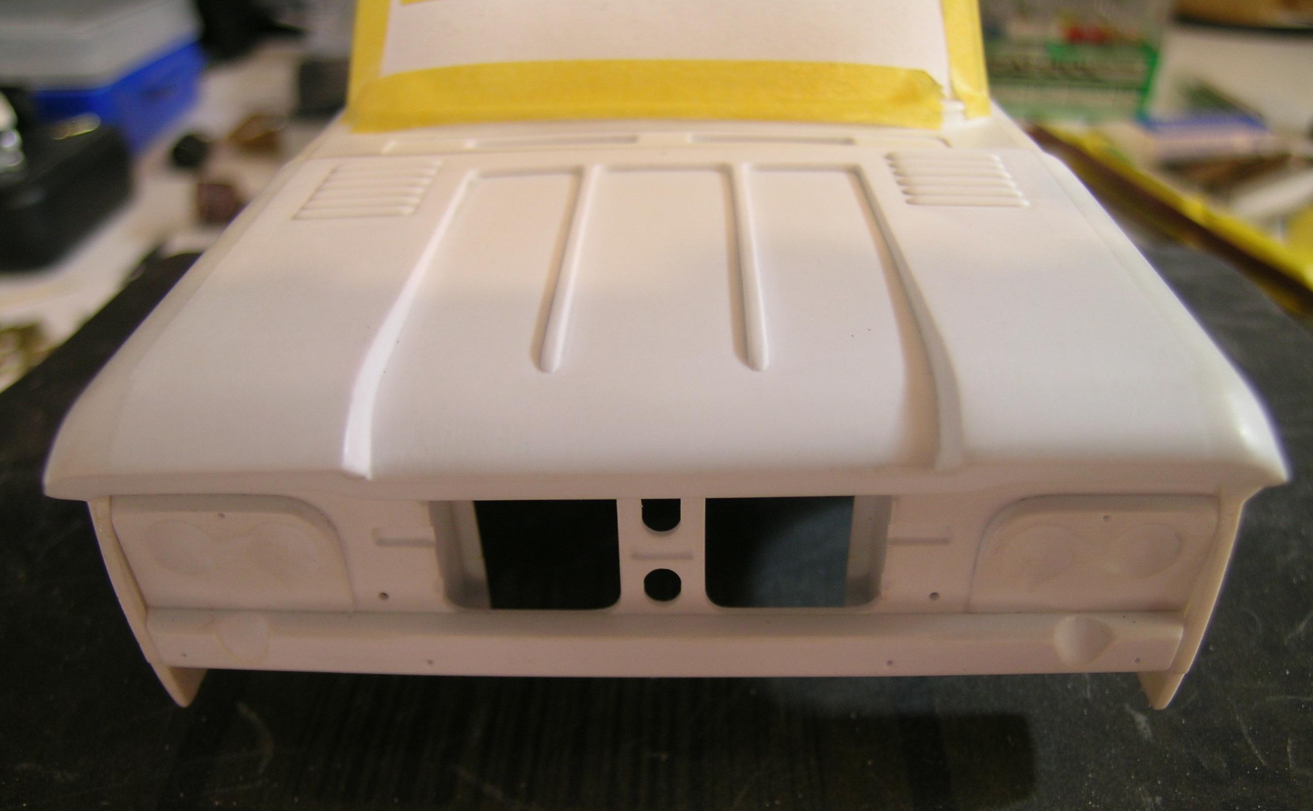

Hello all, I just realize that I forgot to add the pics showing the hood on the body. I will try (later) to make the hinghes and some minor adjustment remain to be done. Cheers, Francis I did put the front fascia and the grille temporarily to check the fitment. -

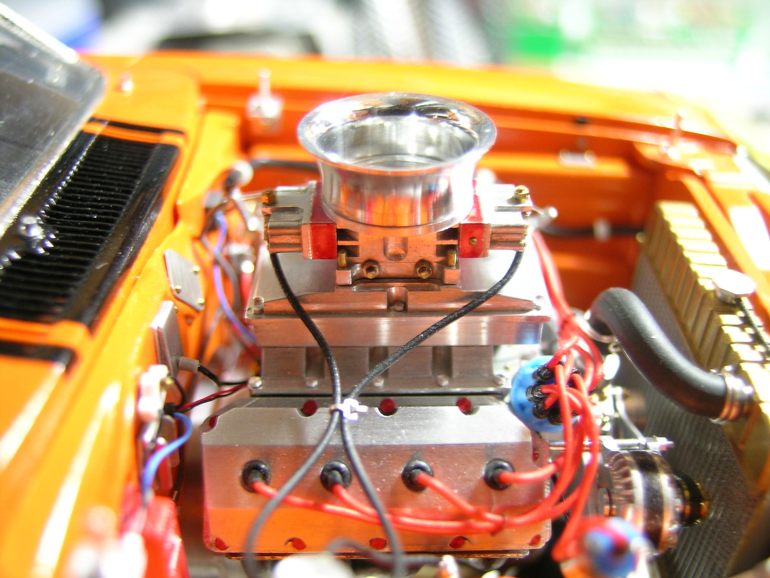

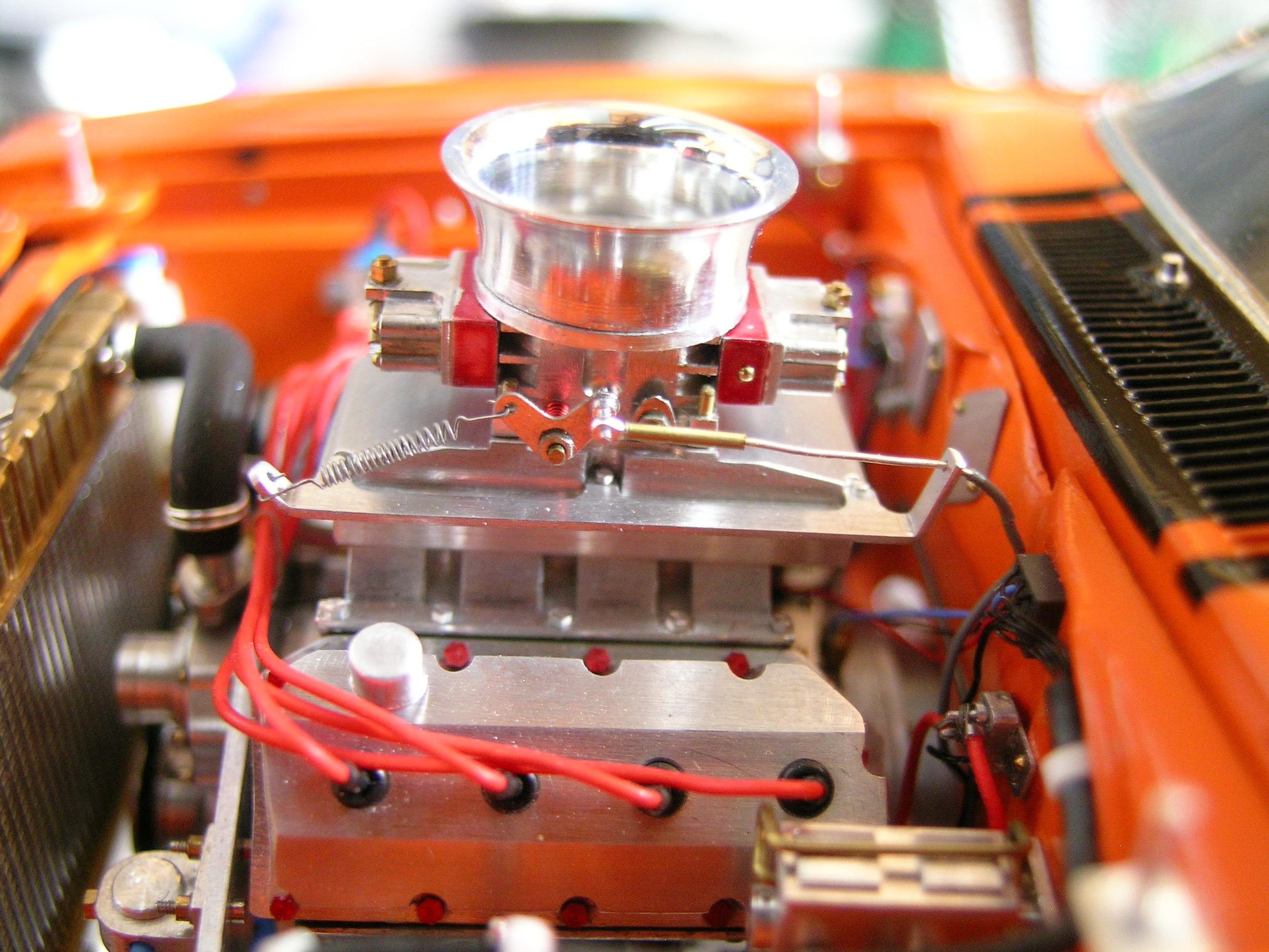

Hello All, I got a request from a fellow member to see some pics of each side of the intake manifold so here they are. Cheers, Francis -
