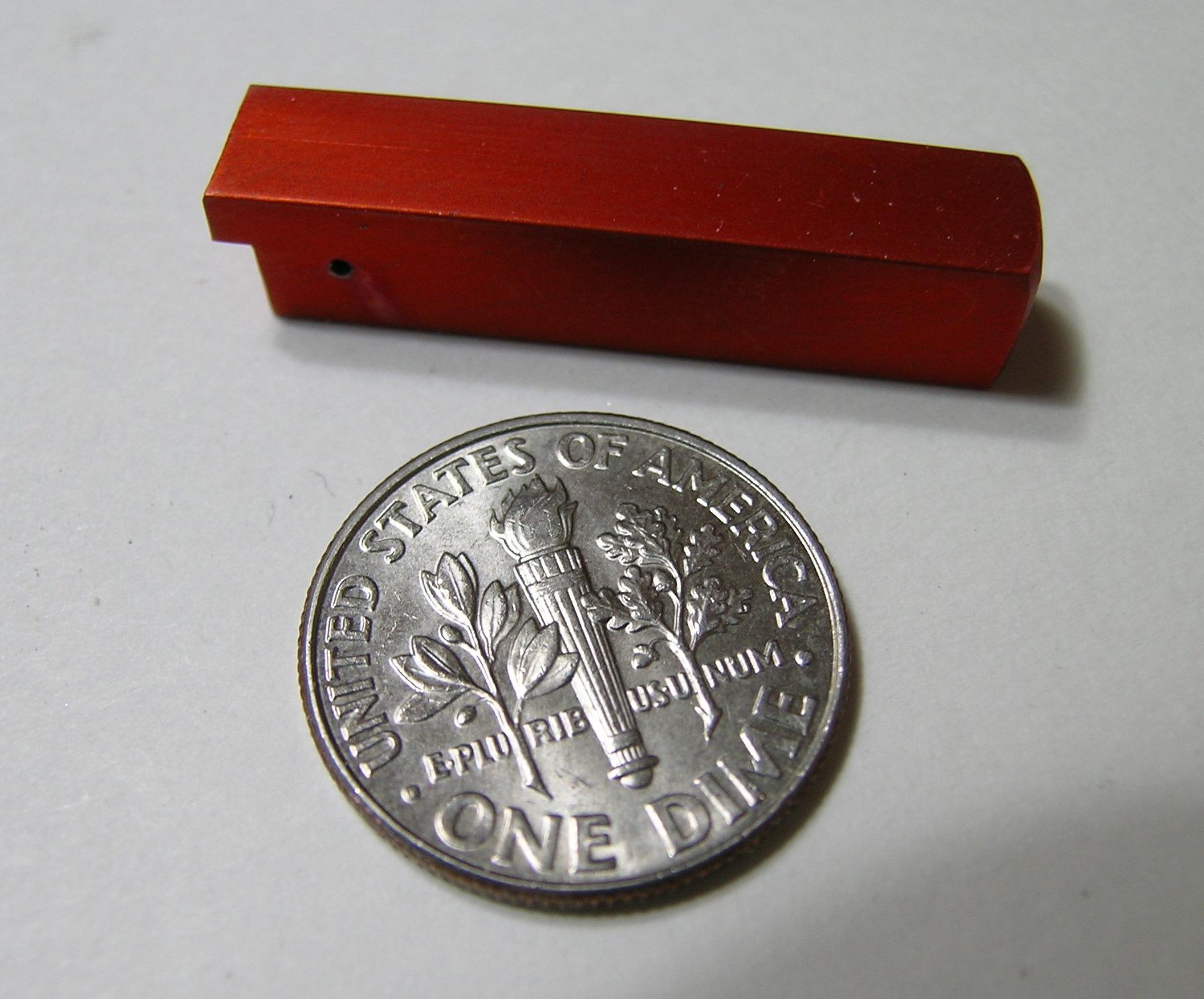

  1. Thanks Tim! I didn't add much details because I found most of the technique on Youtube videos. Basically, you can do this with household products with the exception of hazardous and disgusting battery acid for the anodizing bath (I know that we can replace this by the PH- for swimming pool but I didn't test that yet). You need a power source so a car battery charger settled at 2 amps is sufficient but I purchased a variable DC power supply for more accuracy. You need plenty of distillated water and not tap water for all the operations. You can use cheap clothing dye available everywhere but results are variable according to what I read from different stories. I bought the aluminum dye on eBay but you can find everything from Caswell. I invite you to check online videos for the technique but on thing sure, your parts must be spotless (no problem here with you) to get a perfect result... really worth it! Don't hesitate to send me a PM if you want more infos, I will be more than happy to help if you need. Take care, Francis

  4. Hello to everyone! Hope everything is going well to all of you and your relatives all around our mother earth!!! I just want to share with you my last add-on to the hobby. I wanted for quite a long time making my own anodized aluminum parts so I bought all the equipment and supplies to do so and I want to show you my very first test. I polished a 0.250'' piece of K&S aluminum square rod and I did test the red dye, I'm very happy how it turns-out. The finish is very hard, scratch resistant and shiny and won't hide details as transparent paint. I also bought blue and black dye (product specialized for aluminum) so I will have some other options for my next parts where I want to add colors instead of raw finish. I will post new pics of the progress on the engine next weekend. Stay safe during these disturbing days, Francis

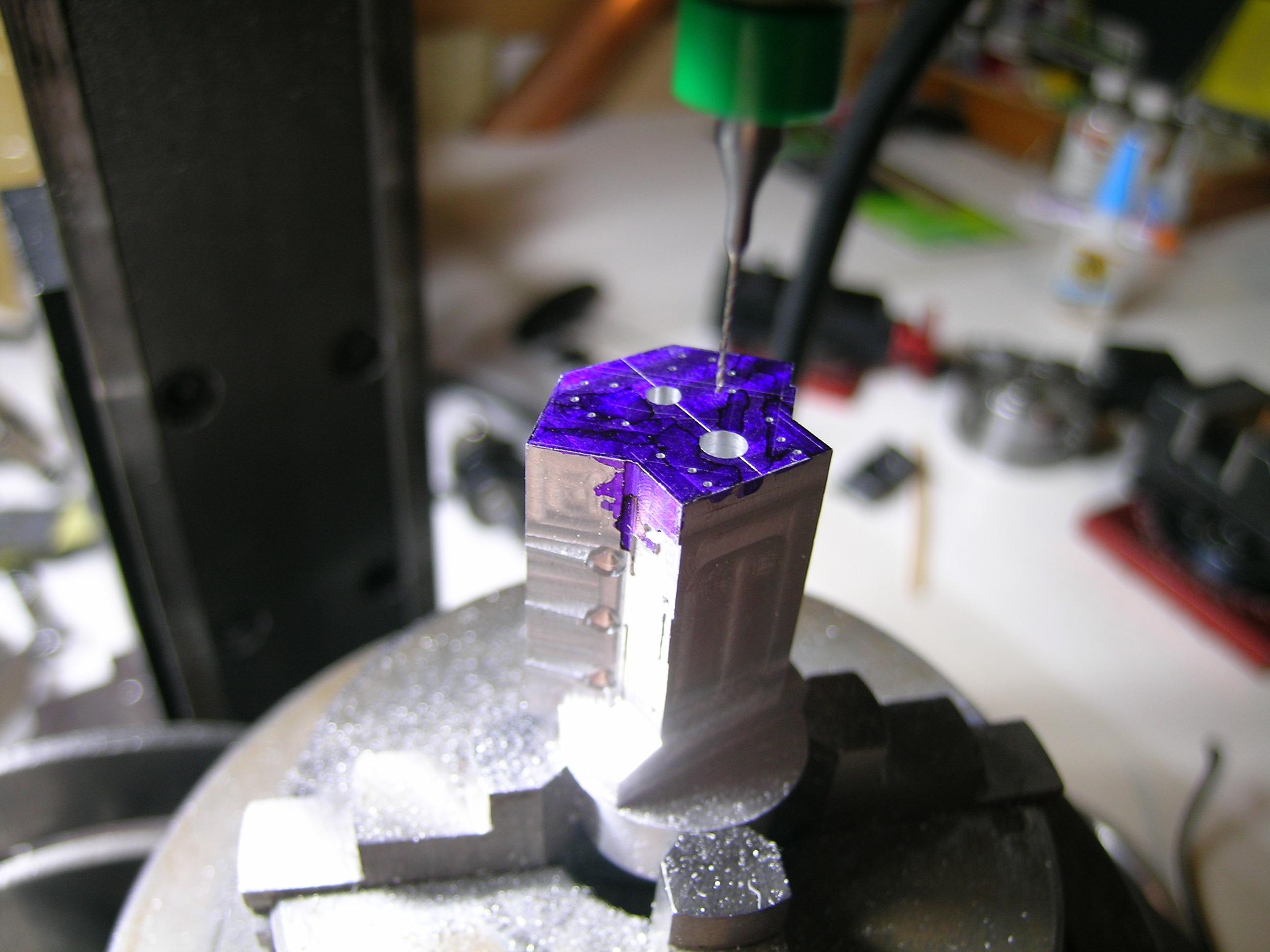

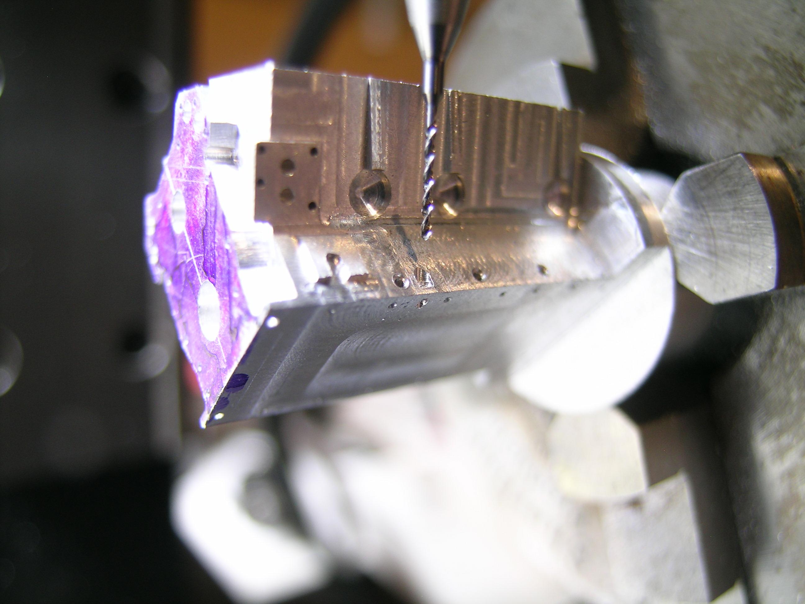

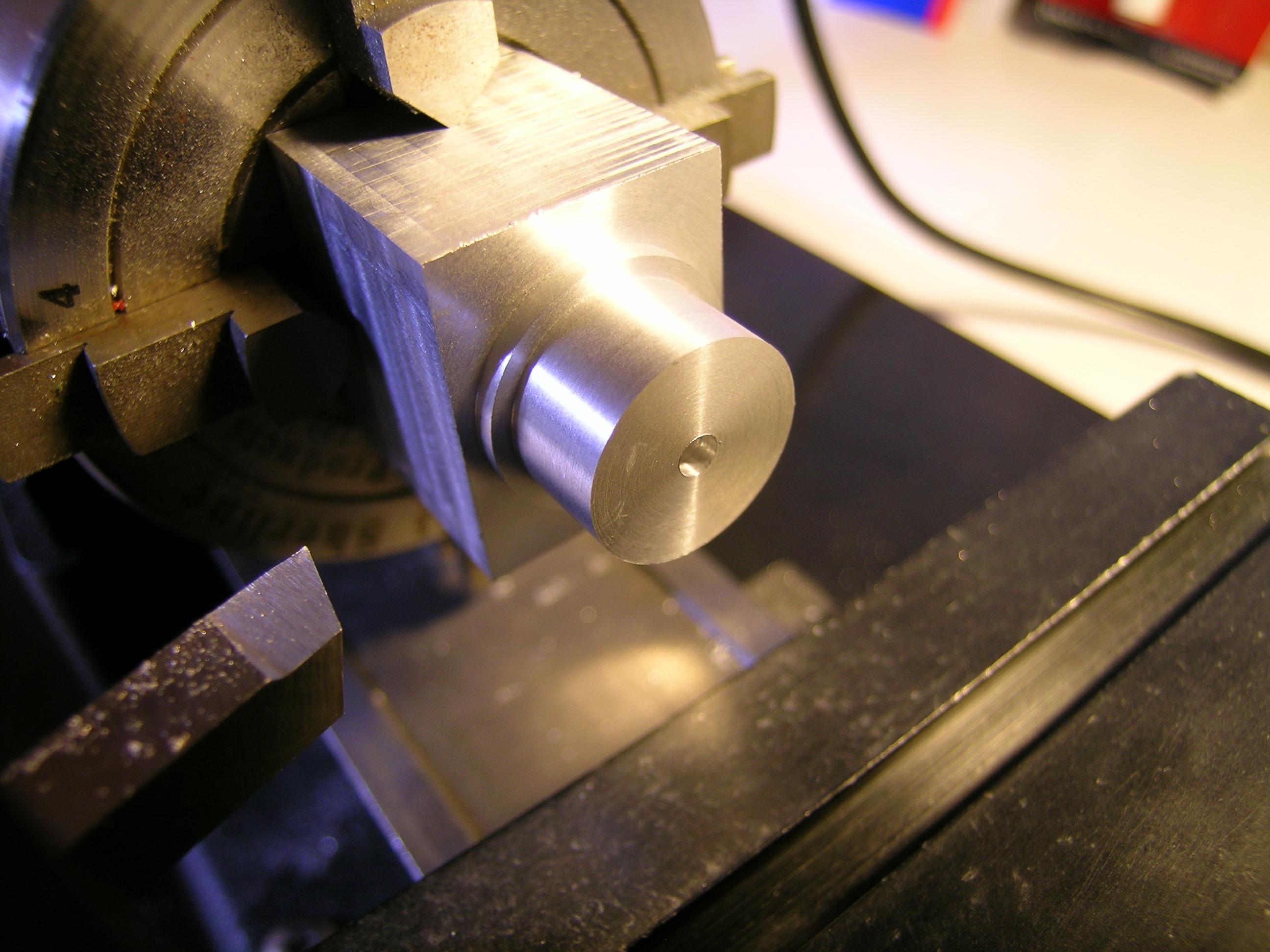

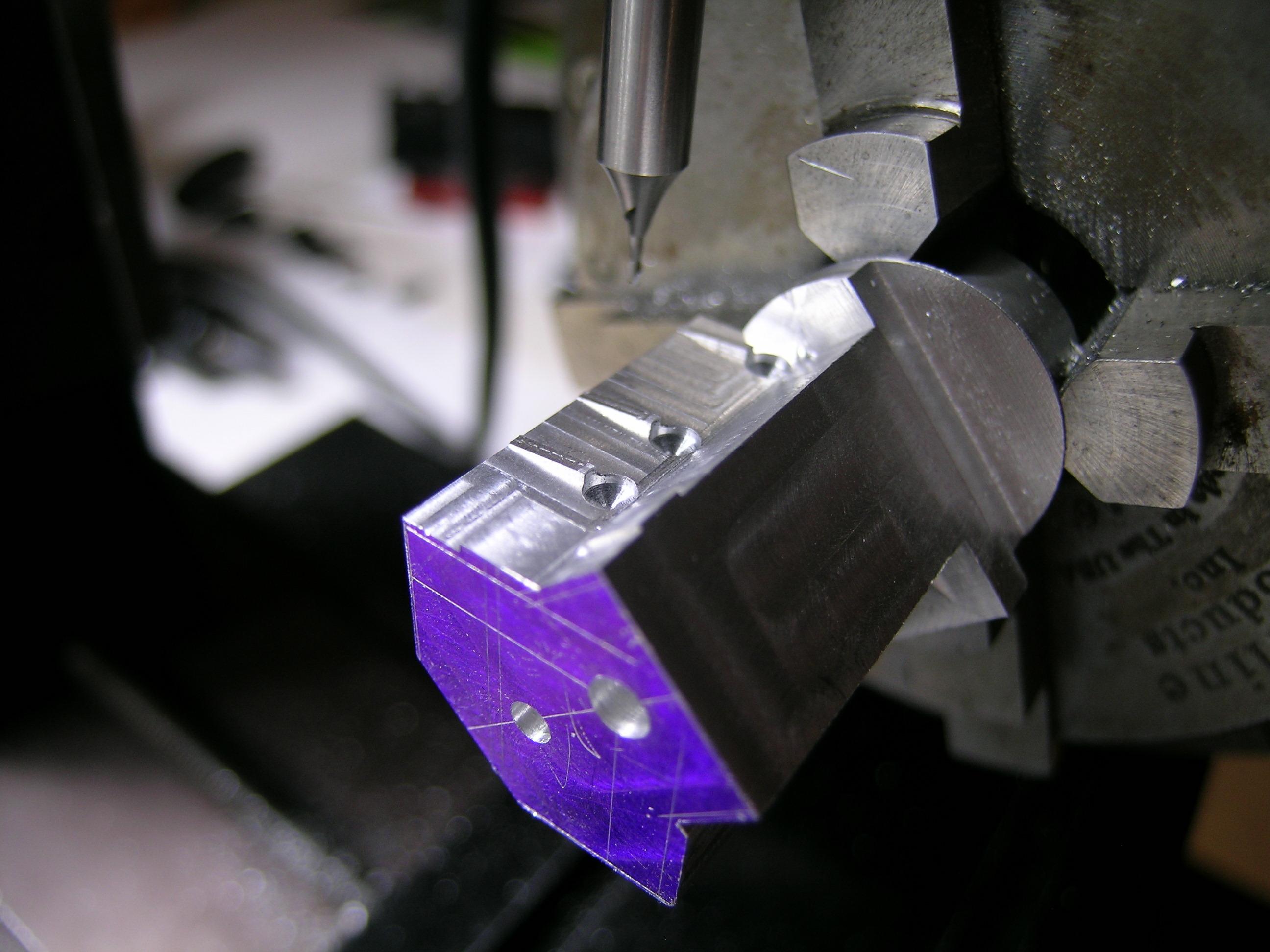

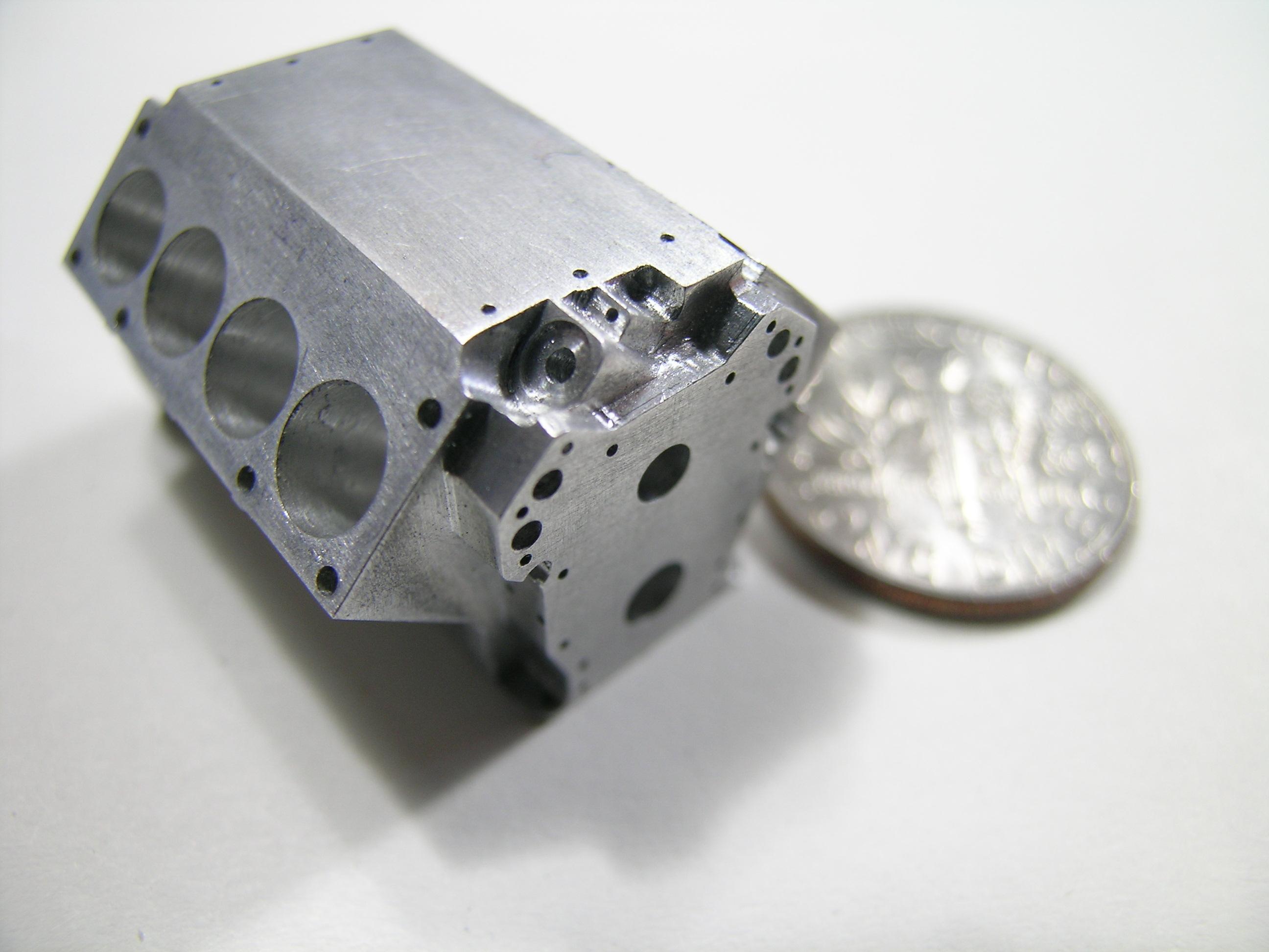

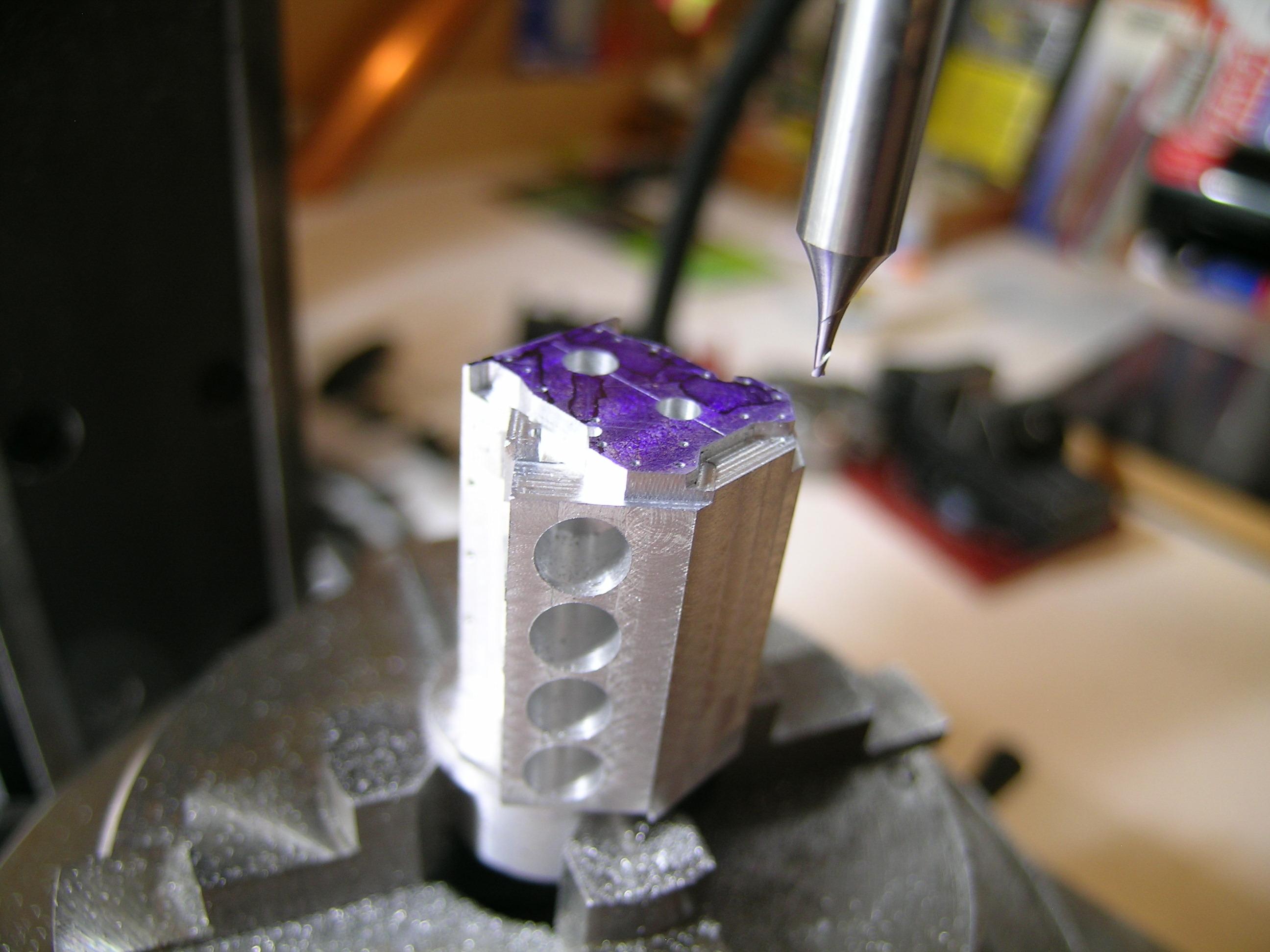

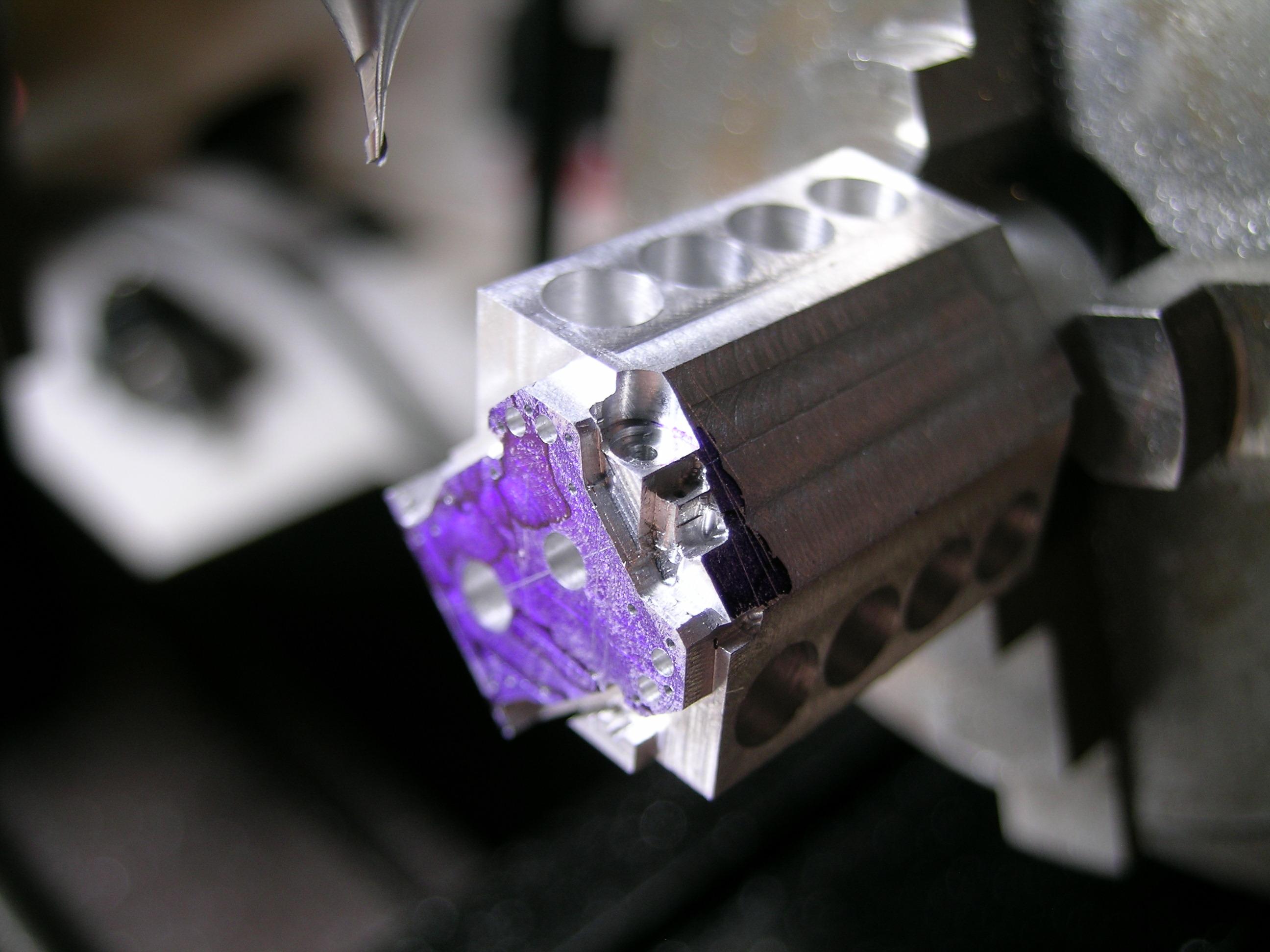

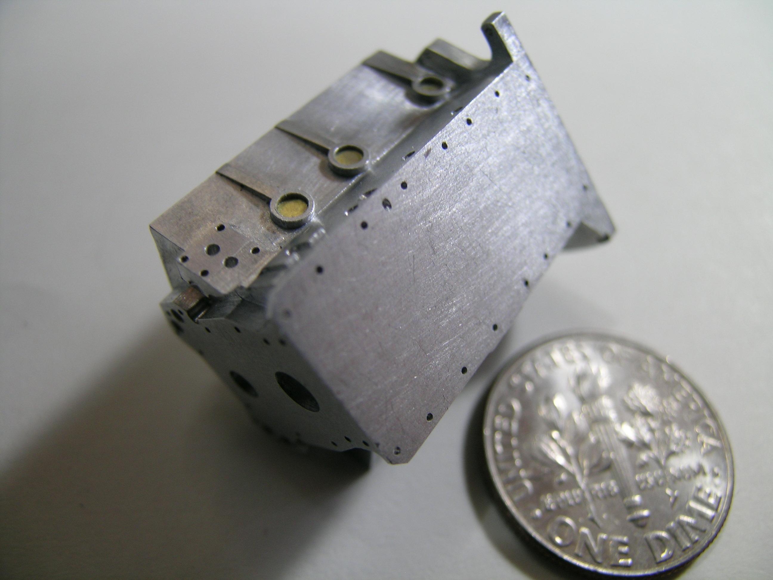

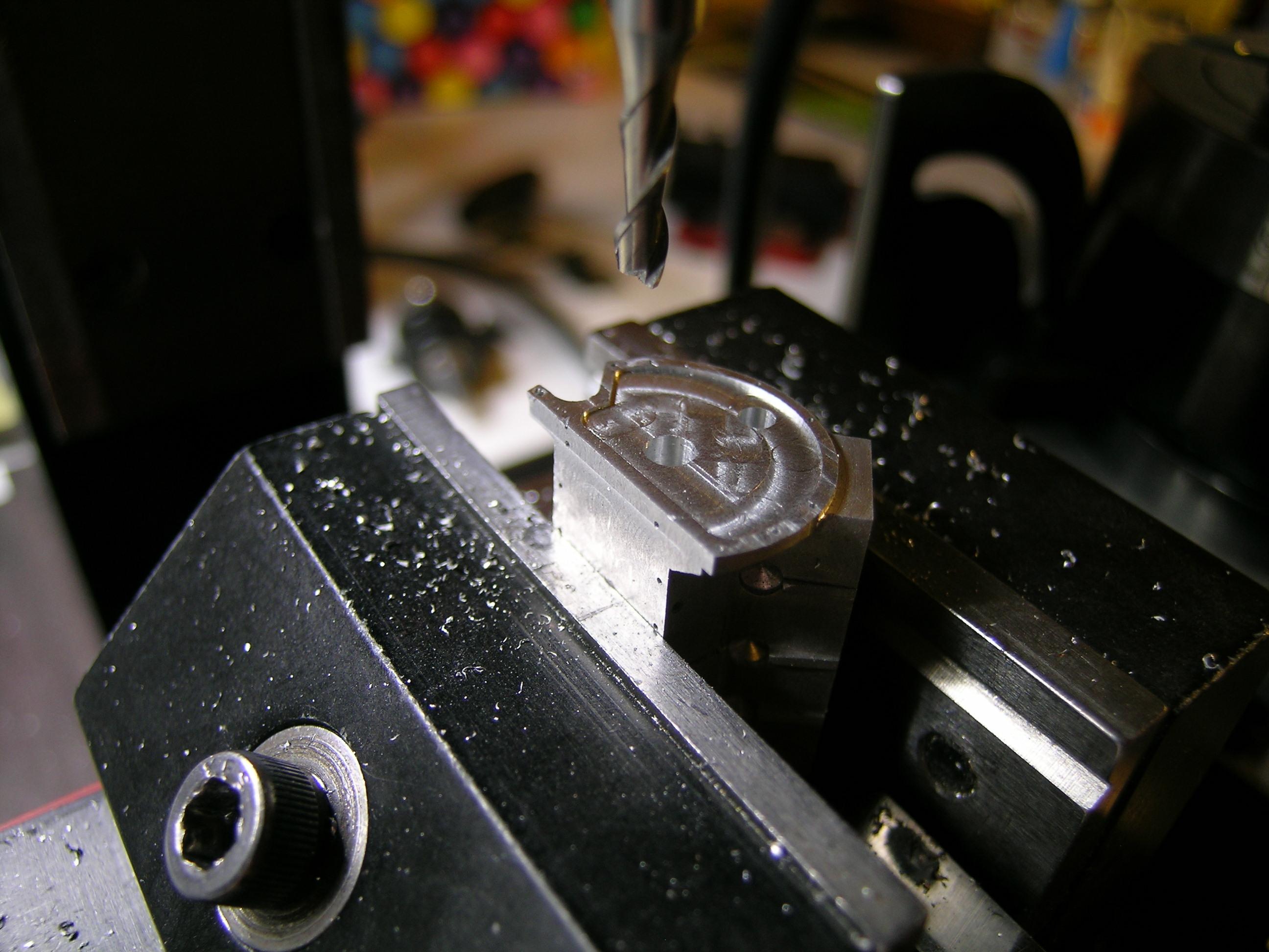

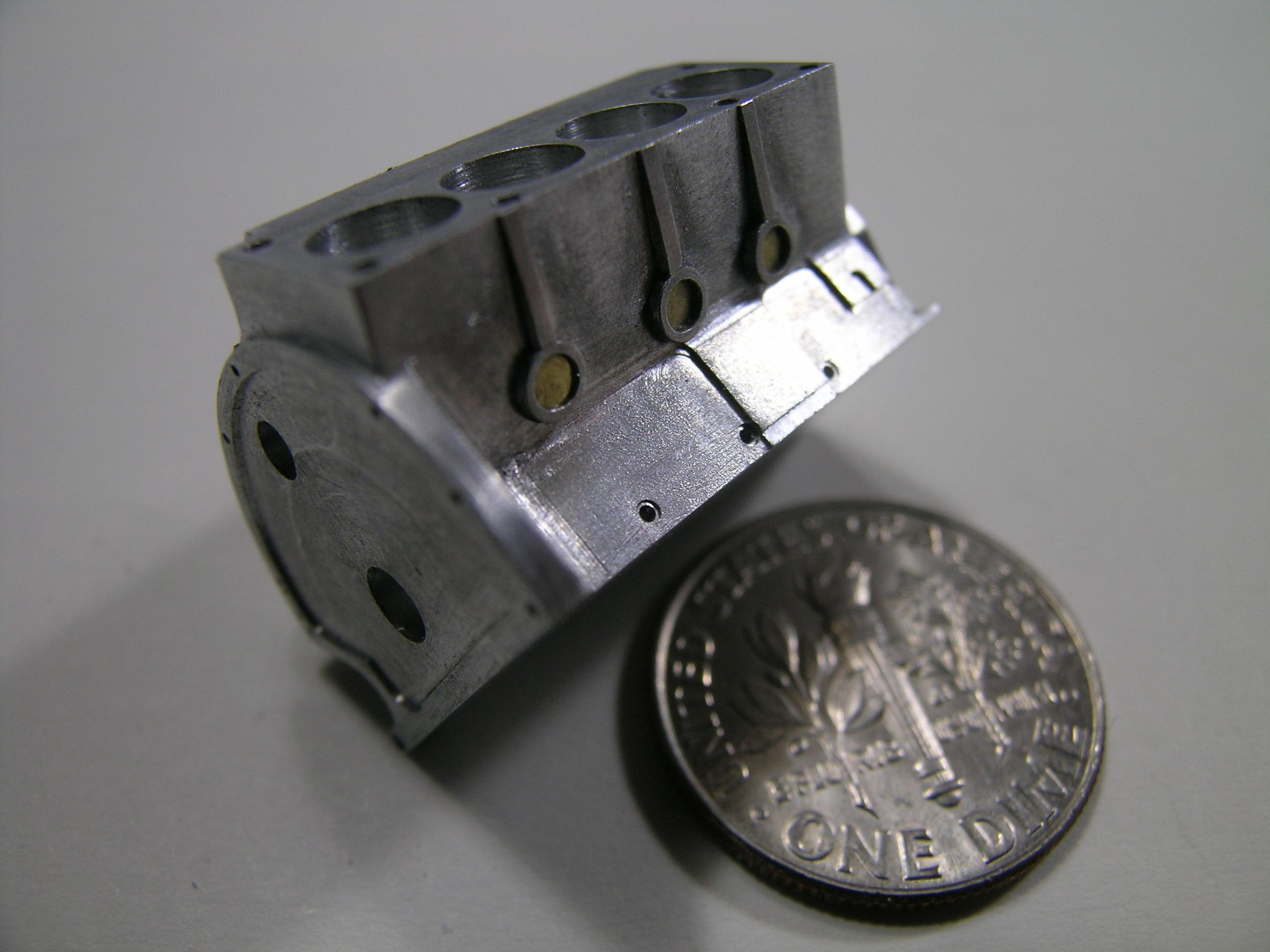

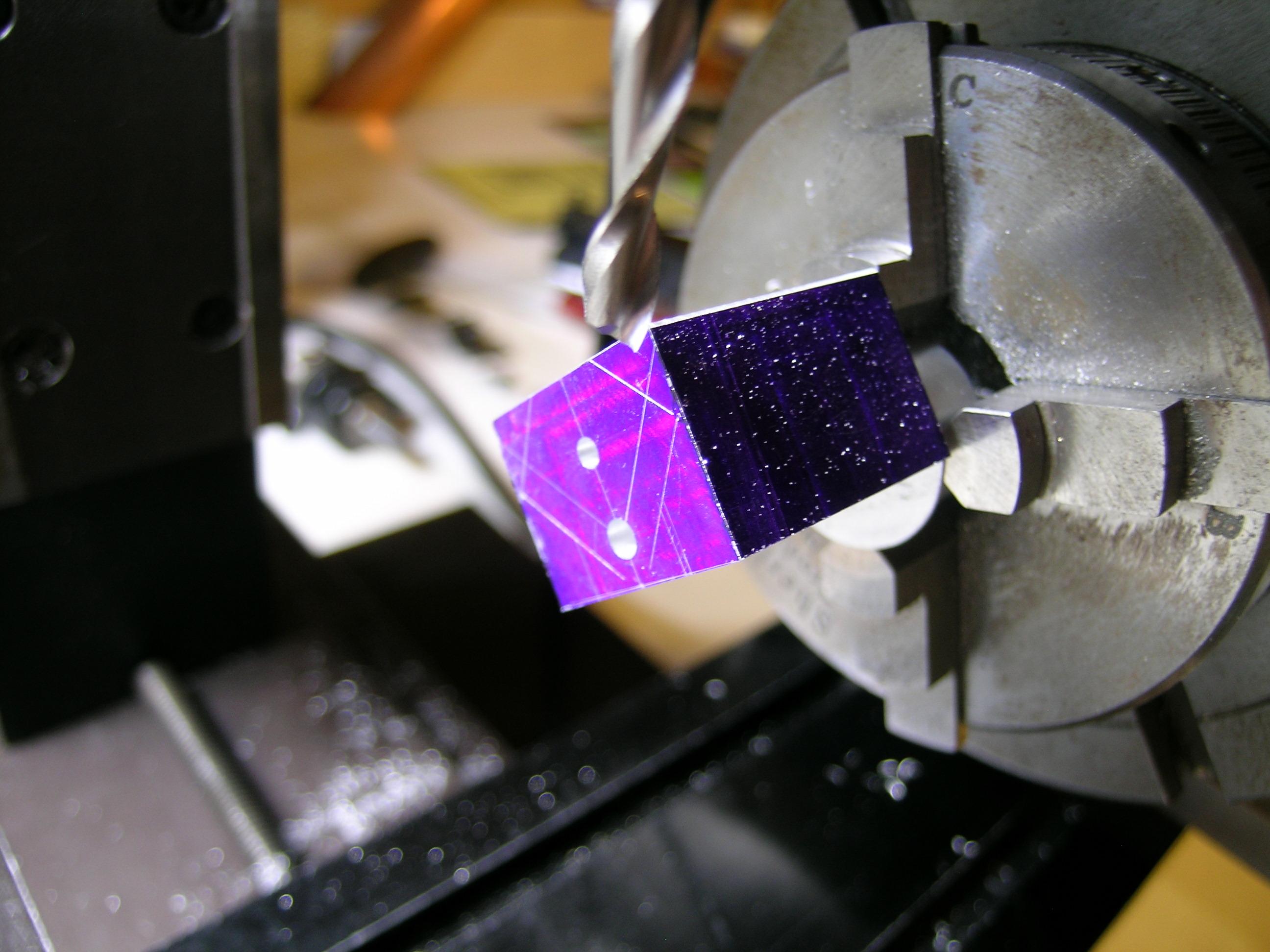

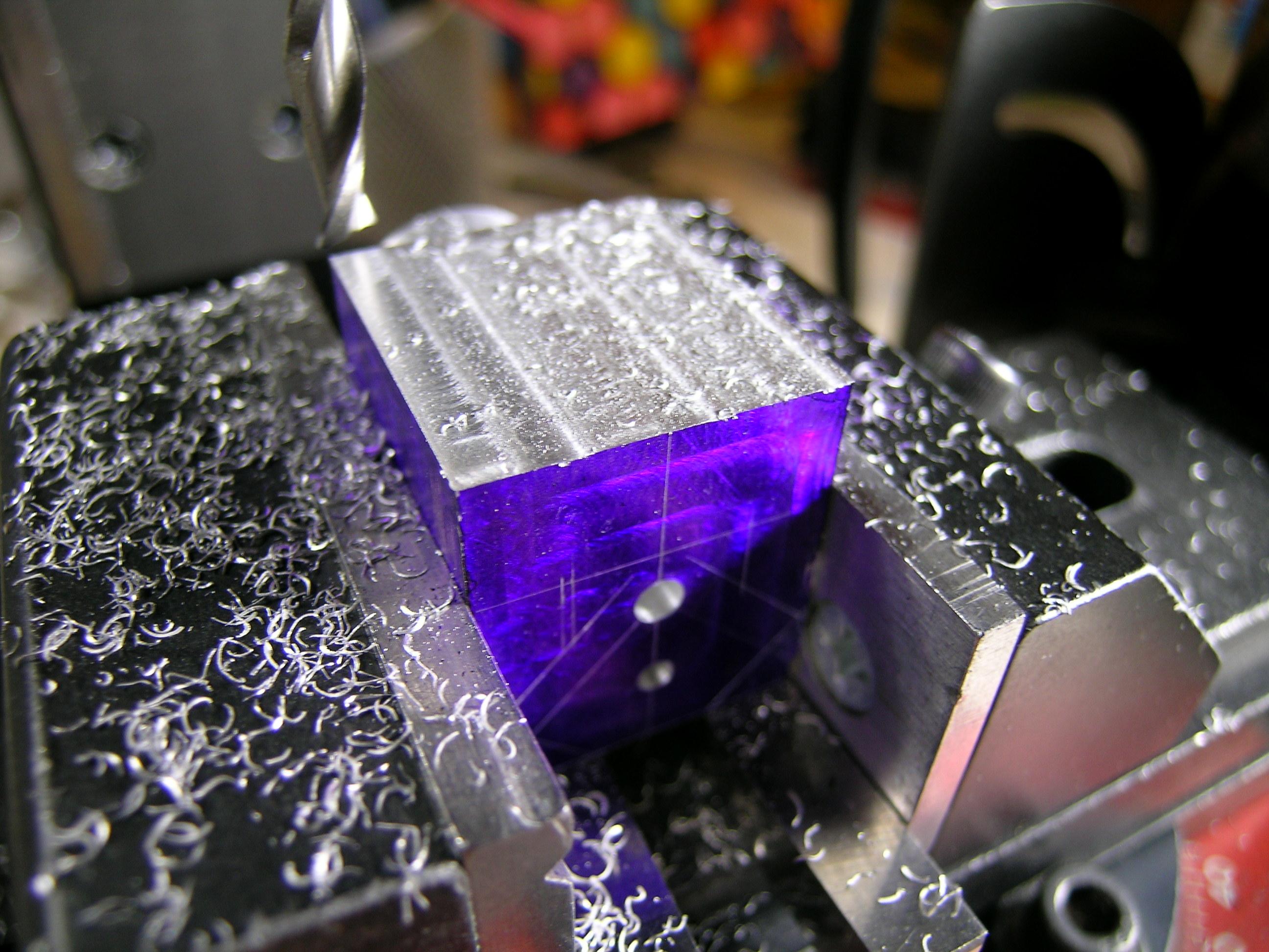

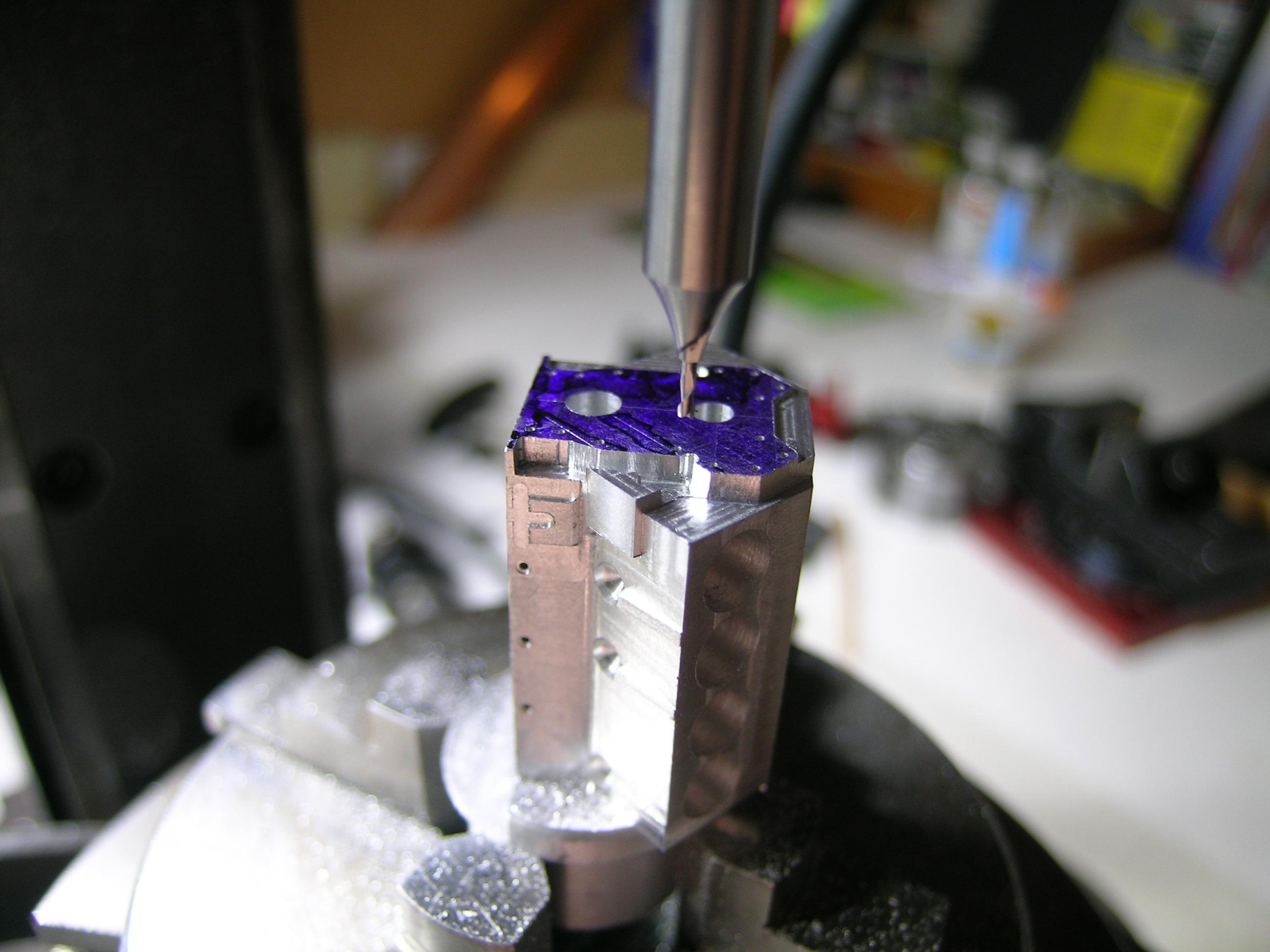

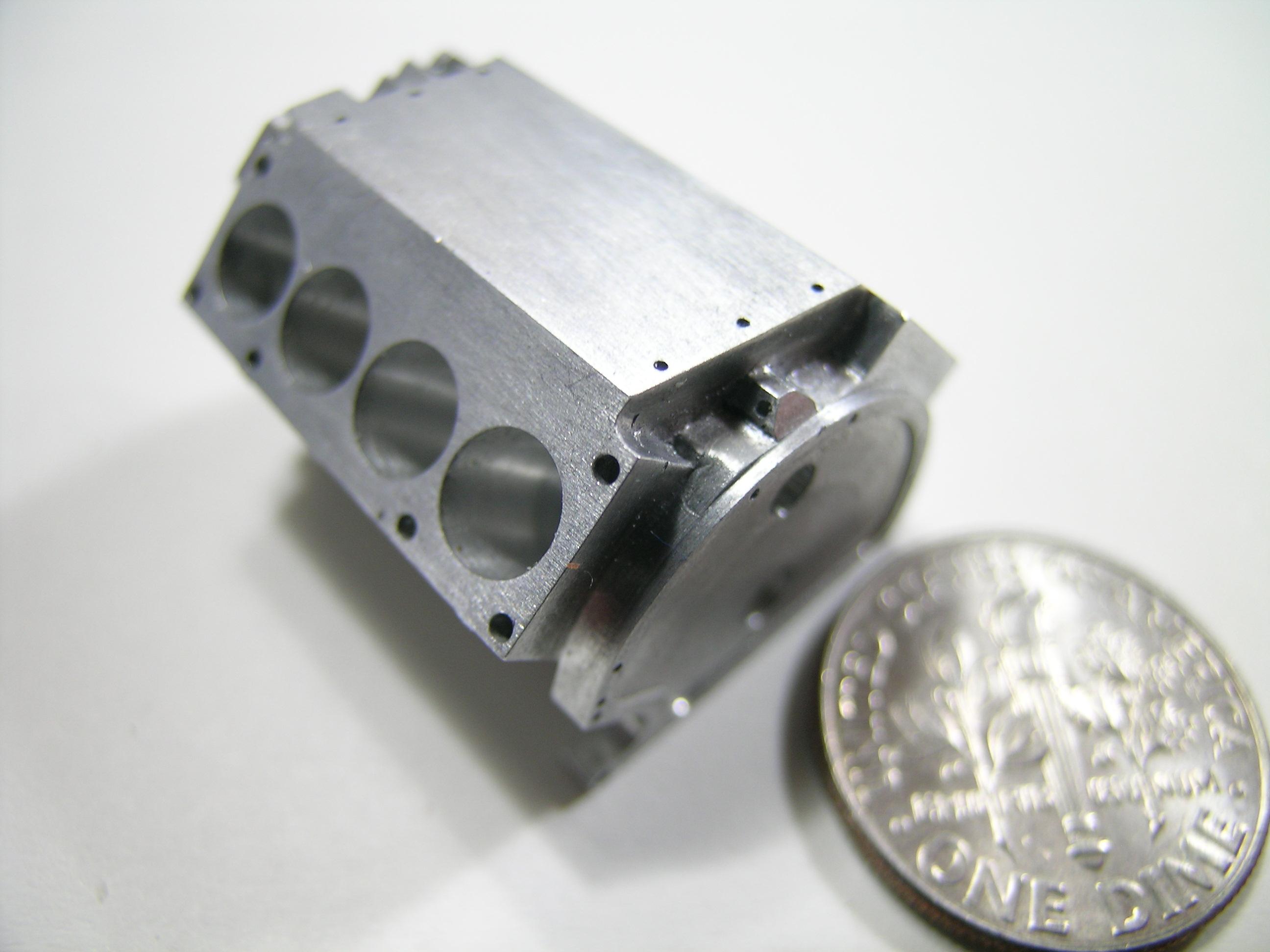

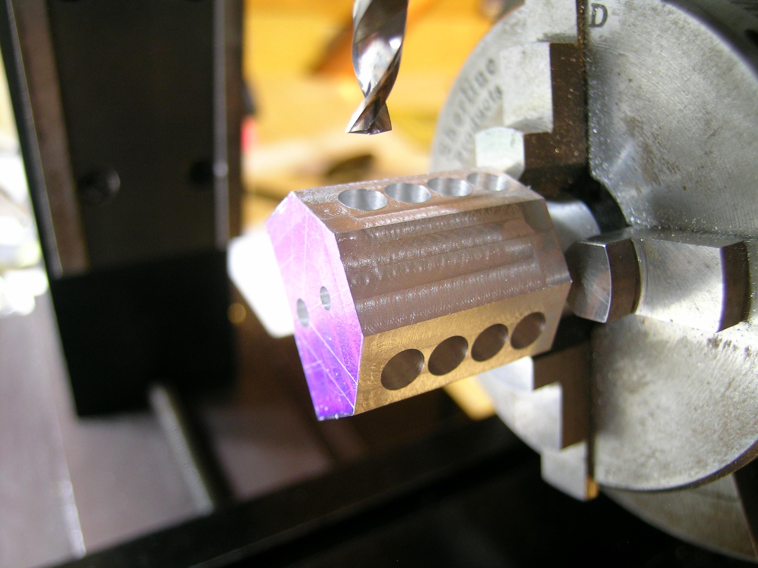

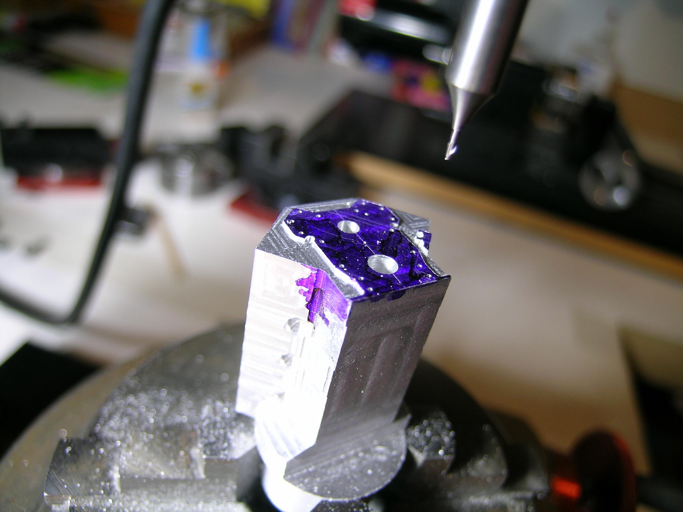

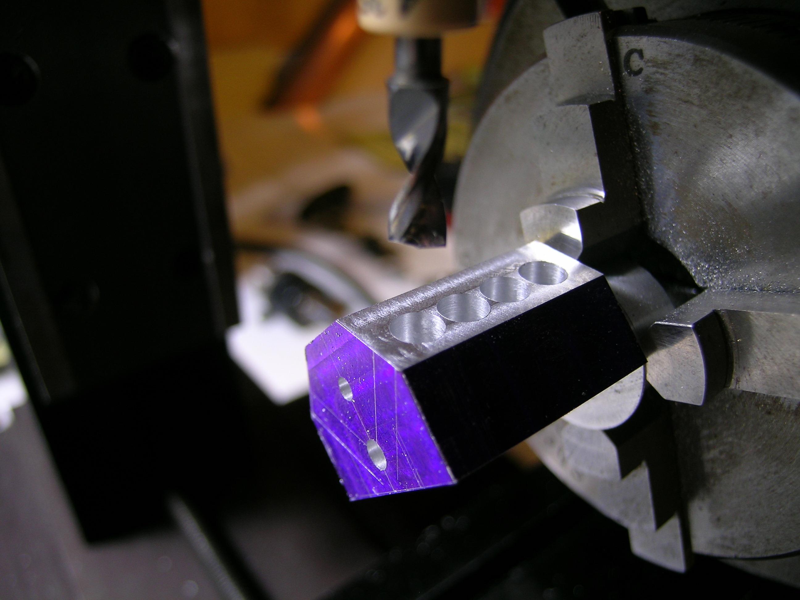

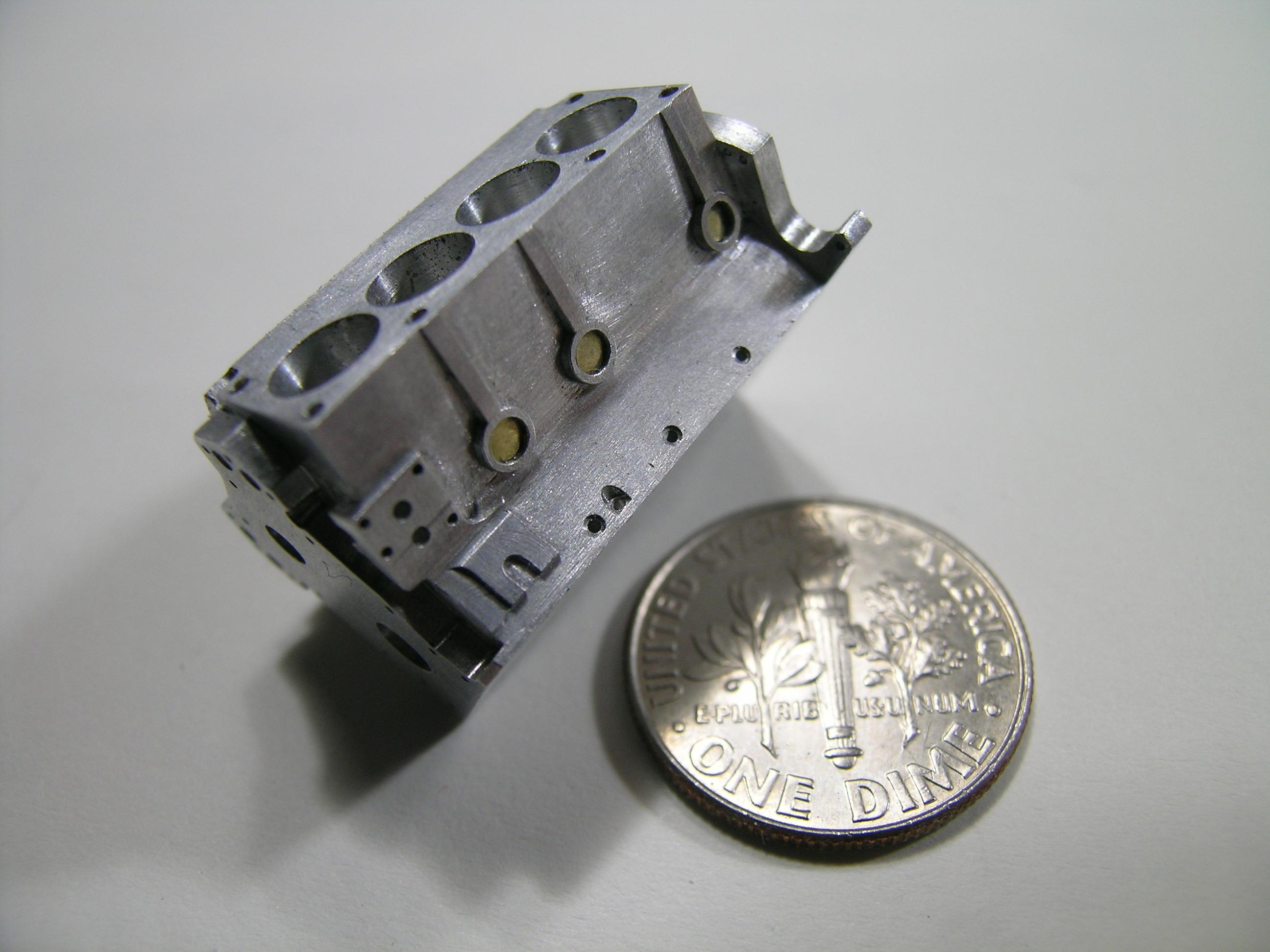

  20. Hello everyone, Today's update is a big one... the HEMI engine block. I spent an outrageous amount of time on that thing. I wanted a one piece engine block as the real one so I made a lot of cuts with different tooling. I started with a T6 aluminum block that I squared perfectly on the milling and moved on the lathe for the first rough cuts. The major part of the job was done on the milling as well using the rotary table and the angle plate for most of the cuts. Hope you'll appreciate it as much I found it challenging to made it! Take care to all of you and your relatives during those disturbing days... Cheers, Francis Using a 1.500’’ x 1.000’’ 6061 T6 aluminum bloc I started machining a a round section in order to mount the part on the milling’s rotary table. Round section done, it could become the Bell housing but I want to make it at a separate part so I will part this section at the end. I coated the rectangular portion with dye and drilled the holes of the crankshaft and the camshaft to the right position and scale as per the real Hemi block from technical informations found on different web sites. I also traces the engine block shape in the front and started to remove the extra material starting by the oil pan face (a lot of aluminum to be removed). After having milled the top portion (below the intake manifold) I moved to the rotary table to cut the pistons top deck at 45 degrees. I drilled piston holes at scale and repetition in order to get the exact engine block length. They are not functional but used as a guide for the next operations. Second side done staggered at scale as per real engine block (width of the crankshaft end of one connecting rod). Engine block's sides in progress. You can see some extra material close to front block end for the oil pump housing. Sides ribs engraved and 0.093’’ shallow holes for the freeze plugs (K & S 0.093’’ aluminum tubes will be inserted and 0.062’’ brass for the plugs). Beginning of the front engine block detail (timing chain housing). Holes are drilled at the perimeter using a 0.016’’ drill bit and act as a guide for machining the shape. Beginning of machining the shape using a 0.031’’ end mill. The other shape on the right is the part of the oil pump housing that exceeds the front engine block as per the real one. Machining in progress. Machining the top portion of the timing chain housing where the distributor is located. Distributor hole and housing drilled at 45 degrees. The distributor shaft will pass just on top of the camshaft bore hole and is aligned with the oil pump housing. Hole and seat for the oil dipstick. Machining of the engine block transmission housing. Holes for the bell housing and starter are drilled using a 0.020’’ drill bit. Engine block final with brass freeze plugs and drilled holes for crankshaft side mains bolts, oil pump and oil dipstick. Engine block seen from the other side. View of the front including hole for the distributor and hold down clamp. You also can see the engine block stamping ID shape. View of the back including the hole for the oil sensor switch. View from under including holes for the oil pan and oil dipstick.
