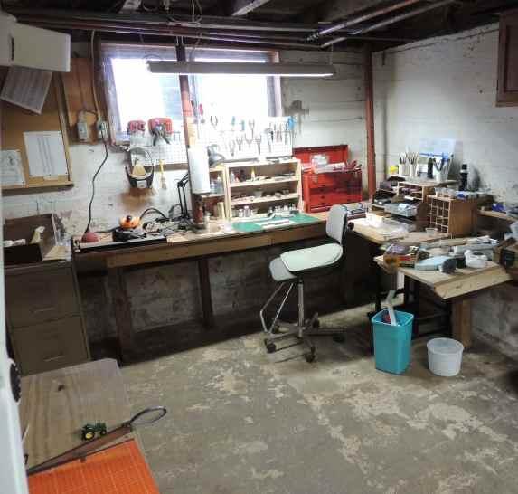

Okay, you guys embarrassed me with your neatnik work spaces so I spent the day making storage for my paint and various doo-dads. Just as well, I'm waiting on supplies to build structures for my diorama and watching paint dry on my scratch-built combines, also for the diorama. Considered checking to see if the little 5&10 a couple of villages over is open and grabbing the 51 Chevy pickup kit that's been on his shelf for a while. Haven't built a 1/25th model kit in dog's years. 1984, when I was stationed in Iceland on an unaccompanied tour as best as I can recall.
