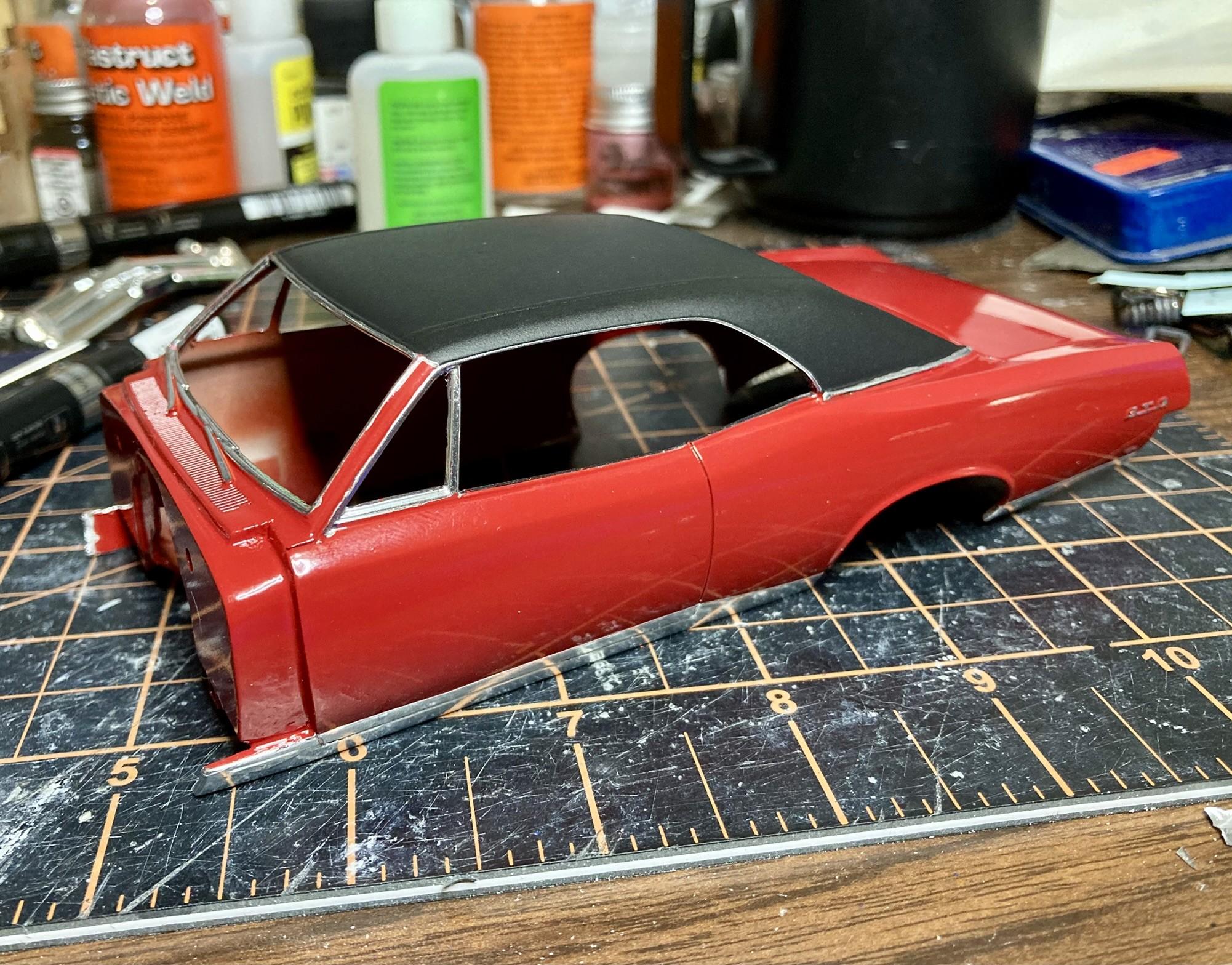

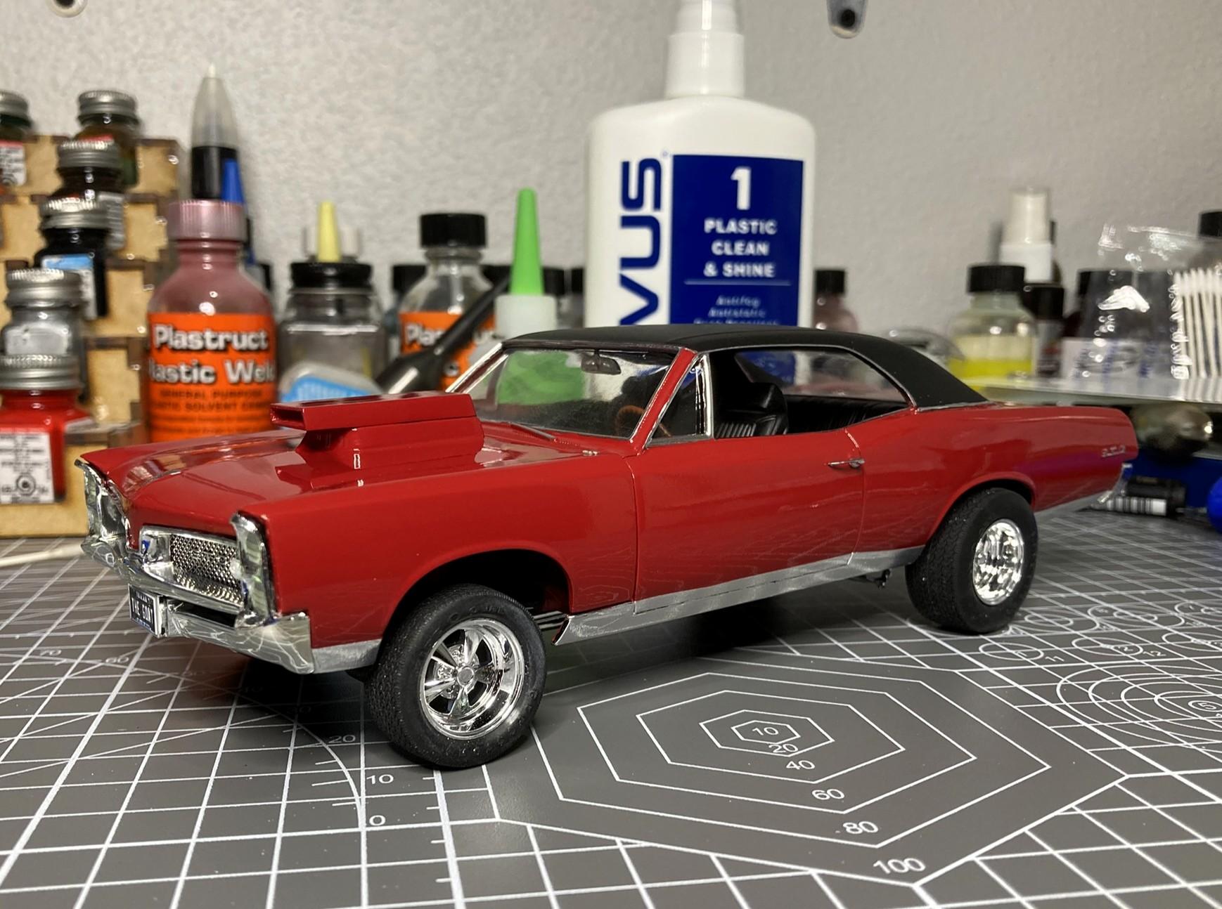

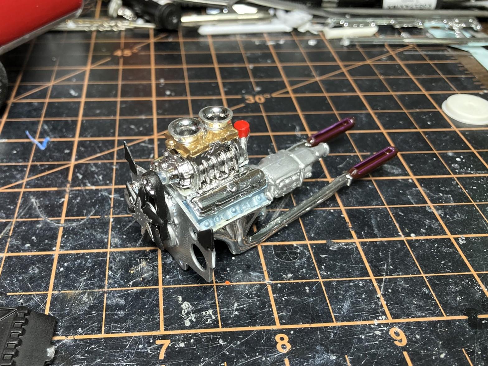

The ebay seller ghosted me after he said he'd send another hood...never showed up, then he "was away" on ebay for a month. But I didn't push it either. Then I cracked the hood -again- trying to tweak it and decided to just glue it all back together on the body, bodywork it in place and forget about any engine. The blower and hat are from a Revell Charger funny car. I cut the hole in the hood then glued a piece of styrene to the bottom side to support the blower. I filed the intake until it sat at the right angle and added a pulley/belt piece from the parts box. The zoomies on the car in the ad are certainly fake (I mean, the blower too I'm pretty sure), so I didn't feel bad about just cutting the ends off of the headers from that same funny car engine and fitting them to the floor of the car. Added shackles to the rear springs. Finished sorting out wheel mounting, but I'm still not happy with the wheel offset or tire size on the front. Might keep working at it, might roll with what I have.
