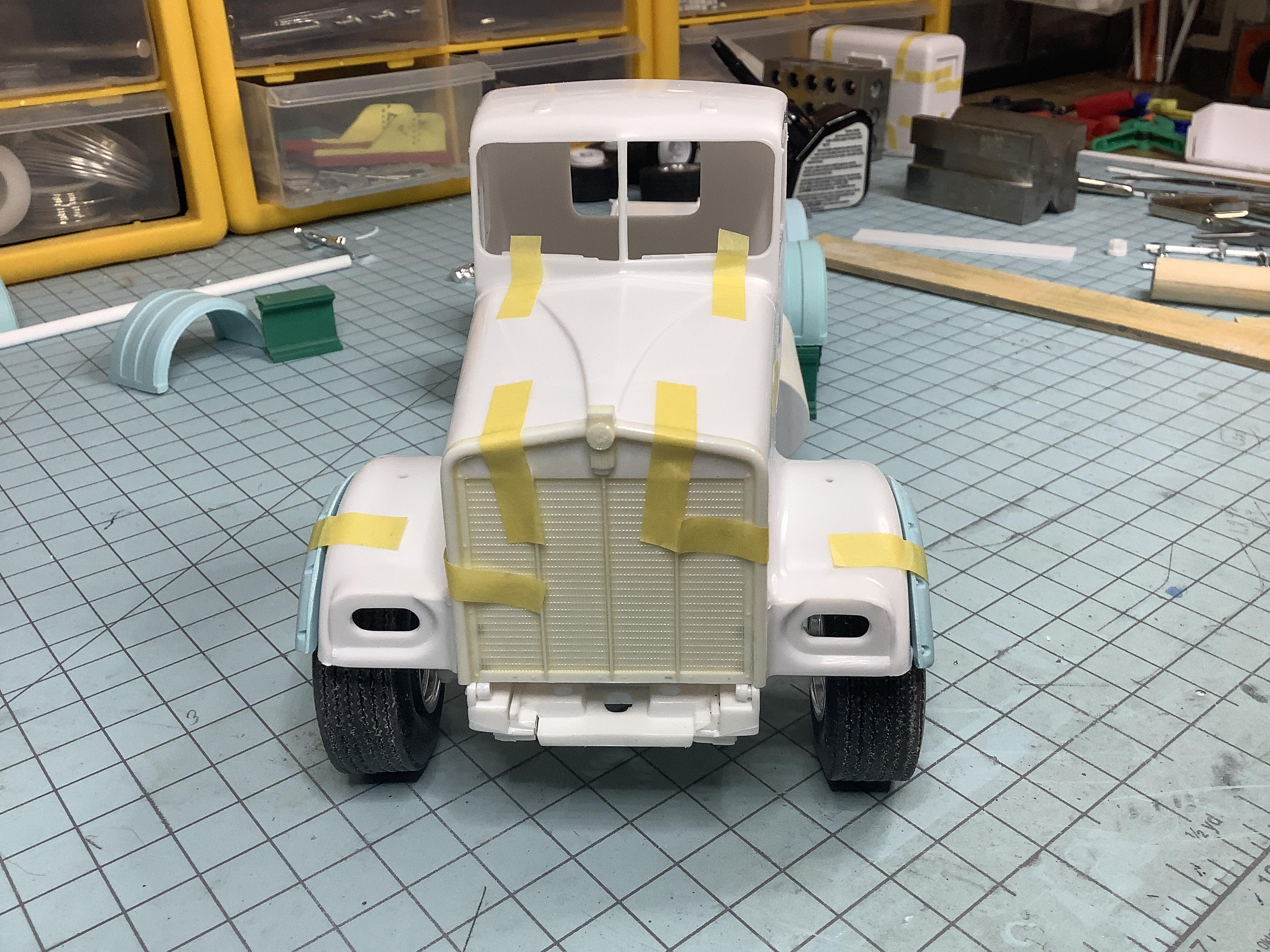

  6. The CTM grill fits the AMT KW 925 grill shell acceptable, spent a lot of time recorrecting the radius and removing the molded in KW emblem, but going with this. Headlights now fitted, and turn signal holes filled. All edges cleaned up and sanded. Grill surround will be painted body color with silver screen insert. Now to find cool turn signals and a place to mount them.

  8. Got the grill cut out and PE grill installed, headlights need a lot of work (don’t fit in fender holes. Looks better that kit grill

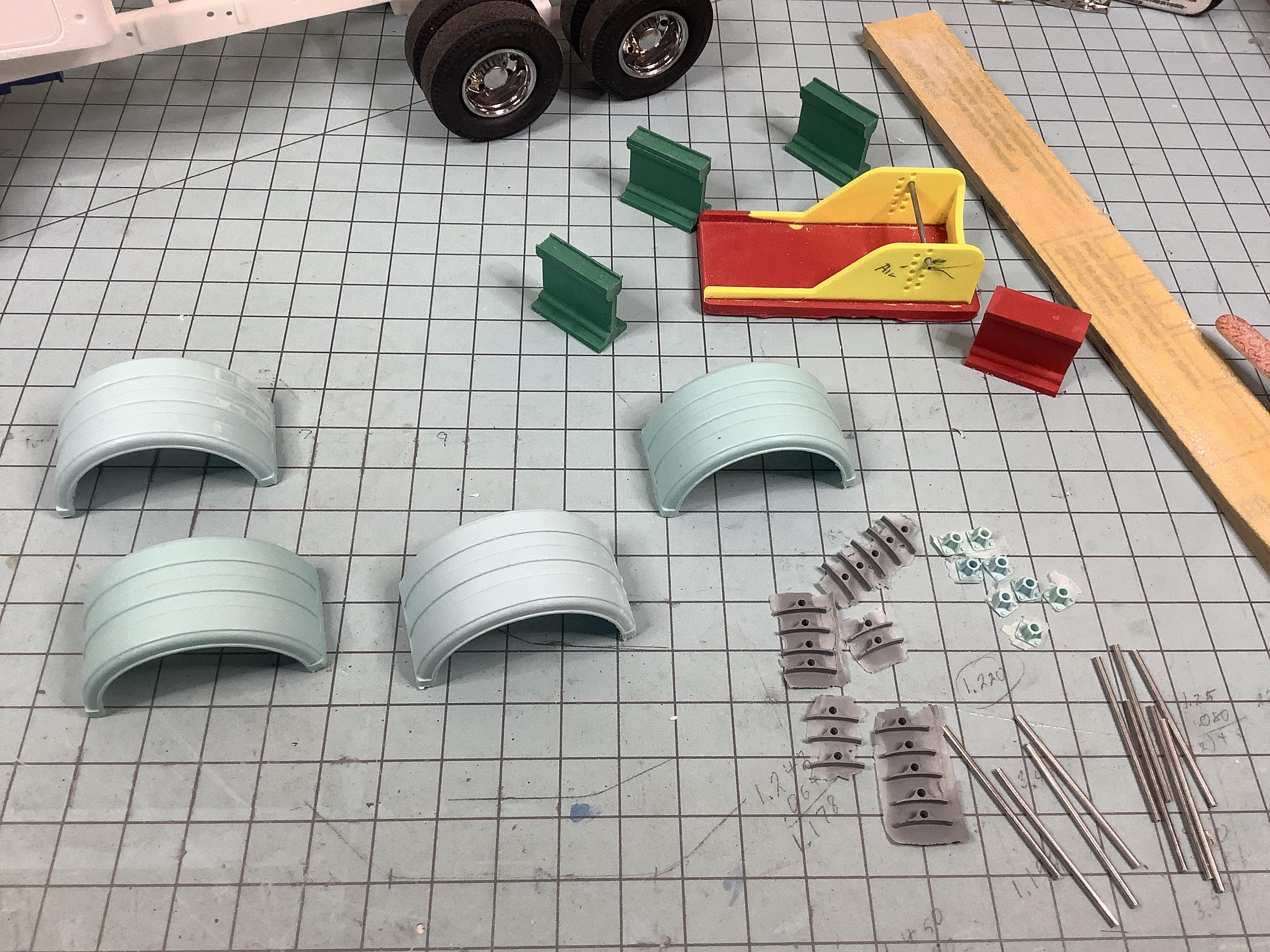

  9. Fitting resin cast flares to the hood and cleaning up. Removed the fake windshield wipers, air horn bosses on the roof, filling non utilized holes and cleaning up molding lines.

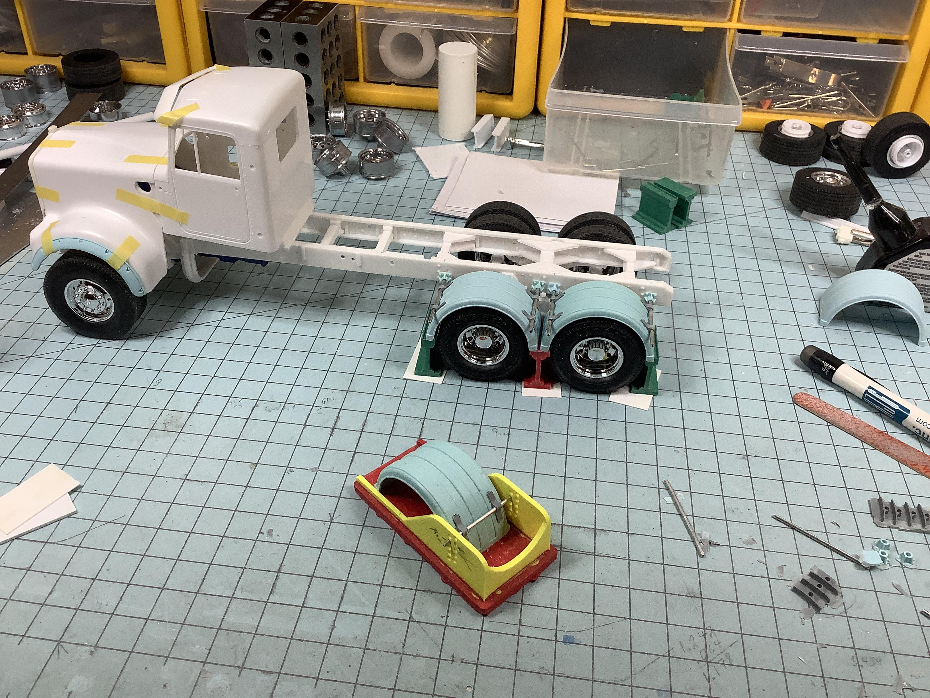

  13. I am going with these mounts for the exhaust, got the square. Holes plugged where the exhaust was to be mounted. Now remove crappy molded in wipers, some cleanup on the cab and ready for primer.

  15. Did some experimenting with an exhaust mount. Problem is cab tapers in on the sides and rear tapers forward. Think I could use 123 blocks to keep them square. Think on it tonight to see if any other idea comes up.

  18. Did a quick mock-up to find a new problem to solve. I purchased these after market battery boxes from Truck builders model forum and they have good detail, so I want to use them but as you can see the exhaust mounting holes are not in the correct place, so need to plug those four holes and make exhaust mounts off the back of the cab. Will switch to Auslowe exhaust, which was the original plan. I can still move the fuel tanks back a bit for exhaust clearance
