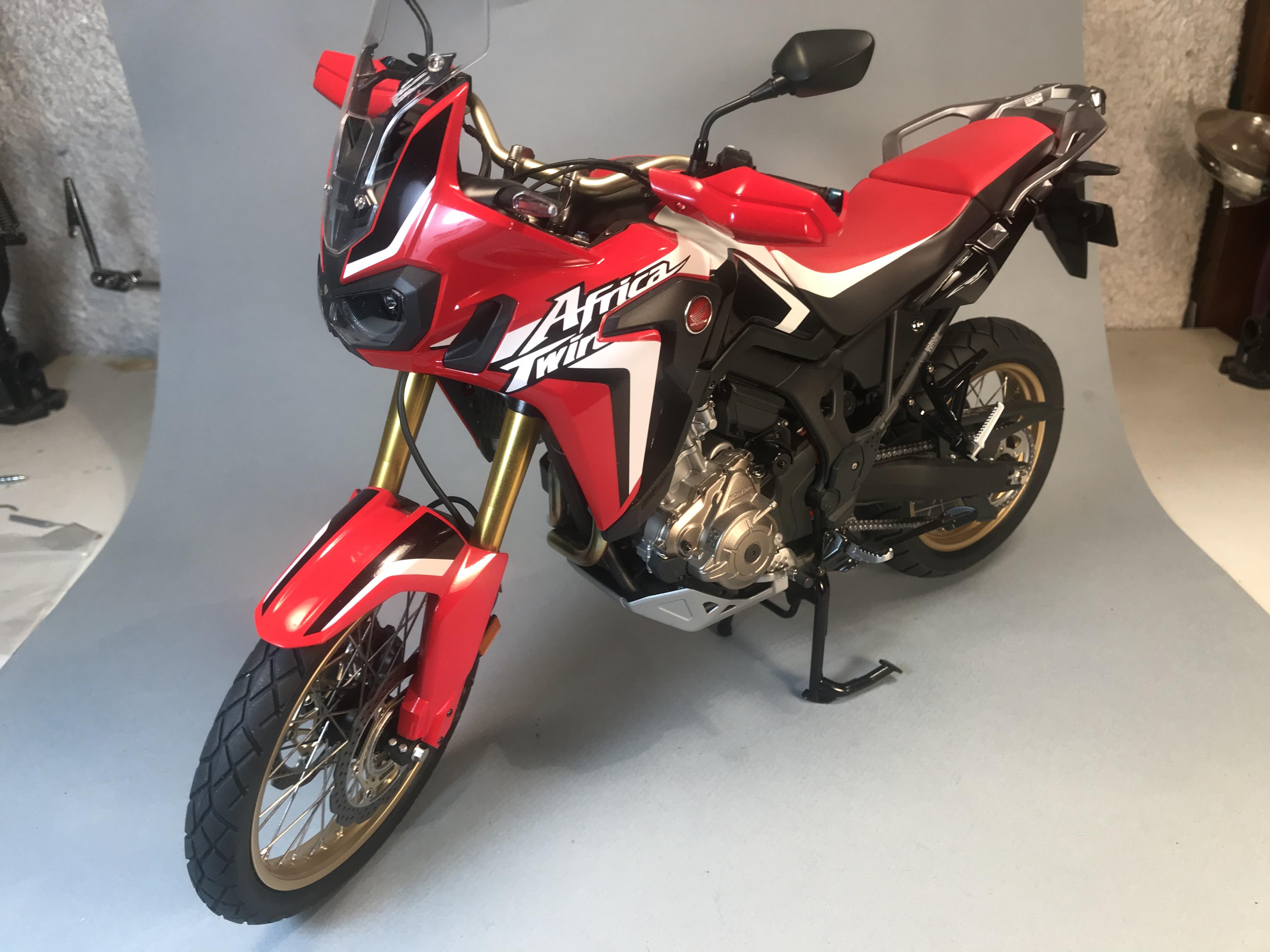

  19. Humble beginnings, While waiting for some aftermarket items to arrive I’ve been browsing through the forums here and searching the ol’ inter web for images of the real deal. I’m trying to get a sense of where I want to go with this build. It’s been a very long time since I’ve built a car, not counting Tamiya’s big Africa Twin motorcycle, so looking at references and my Revell kit I’ve decided there’s a few obvious enhancements I can make. The first thing is the headlights on this kit. Aside from the odd distance between the high and low beam lights the lenses supplied in the kit are awful. To replace ‘em I’ll be using these: These lenses are convex on the front and flat on the back which gives them a very authentic reflective look. They come in a number of different sizes depending on their application. To fit them in the kit headlight housings is really quite easy. The lenses are just a bit smaller in diameter than the housing they’ll fit in to so I took advantage of the holes in the back of the kit part and used wood skewers to adjust the depth they sit. Here’s what I mean in the above photo. I had to sand the skewers diameter down but just enough to have a nice friction fit. The lens was dropped in place and then the exact height set permanently by adjusting the skewer length and securing them with some thin fast setting CA. The lenses will be permanently affixed with 5 minute epoxy giving me lots of time to ensure they’re centred and aligned properly. The image above is really too large but you get the idea. Once the lenses are installed the outer rim of the housings now become the headlight retaining ring. I’ll move the low beam headlight slightly inward and the high beam headlight slightly outward and use a larger brass tube thinned at it’s outer edge to become the black bezel surrounding the headlights. That should resolve the headlight position and size nicely. I also played around with the turn signal/park light assembly. Revell could have made this much easier if they had moulded what is supposed to be the lens in clear plastic! I used a couple of round burrs and drill bits to create the concave housing for the amber bulb. For the bulb itself I’m using an MV lens from the model railroad section. These are tinted a pale yellow but a small dab of Tamiya’s clear orange gets me what I’m after. I’ll make a mould of the chrome kit piece and use clear casting resin to make a new lens so I can retain the star shape on the lens face. Then I’ll drill a couple of small depressions on the lens face and fill ‘em with photo etch Phillips head screws for the fasteners. At least that’s my plan which should work out well. It’s a little difficult to see but the one side has been done, without the lens of course, and the opposite side remains untouched. I have a few things that need clearing off the work bench and some stuff to get in the mail before this project gets going but it feels good to have at least started. Cheers, Wolf (who loves his ‘Cudas but will likely never be able to afford one)
