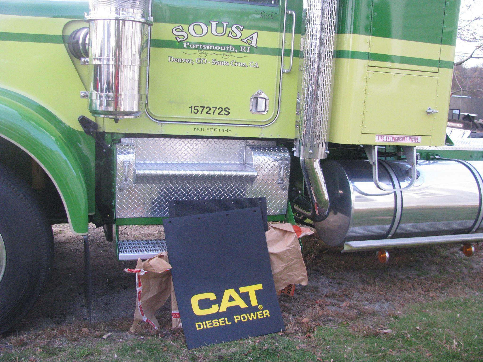

  21. They are nice but unfortunately not the correct style I'm affraid, here is the 1973 truck at the Lamar's scene and the 1974 has the same door handles. Auslowe has the correct style in photo etch, the middle ones in the picture below are right with the triangle shape and lock cylinder on top, can most certainly be found at STS. The ones on top is the new style used on modern KW's CMT do also have them but you have to get a complete detail set to get them, STS deals with CTM parts too.
