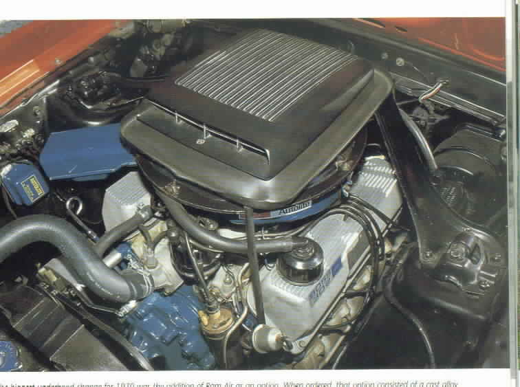

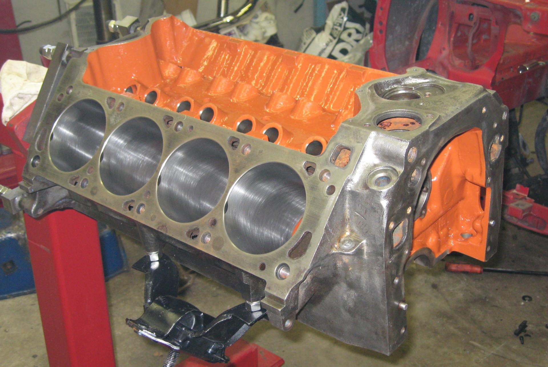

The 90 degree family 351 Windsor and the 335 family 351 Cleveland are two completely different engines and don't share much except for bore spacing, bore and stroke, and bellhouse pattern (the taller deck 351M and 400 has the larger 429-460 bellhouse pattern), and they look different. The Cleveland has a dry intake manifold and the water outlet is at the front of the block, the Windsor has a wet intake manifold and the water outlet is at the front of the intake, and as allready mentioned, the heads are different. Cleveland engine block, Windsor engine block, in this case a 289-302, the 351 looks the same but has just over an inch taller deck. As for the Boss 302, it's a regular 90 degree Windsor engine block with four bolted mains and Cleveland style heads, but the Boss has a wet intake manifold like the Windsor. -
