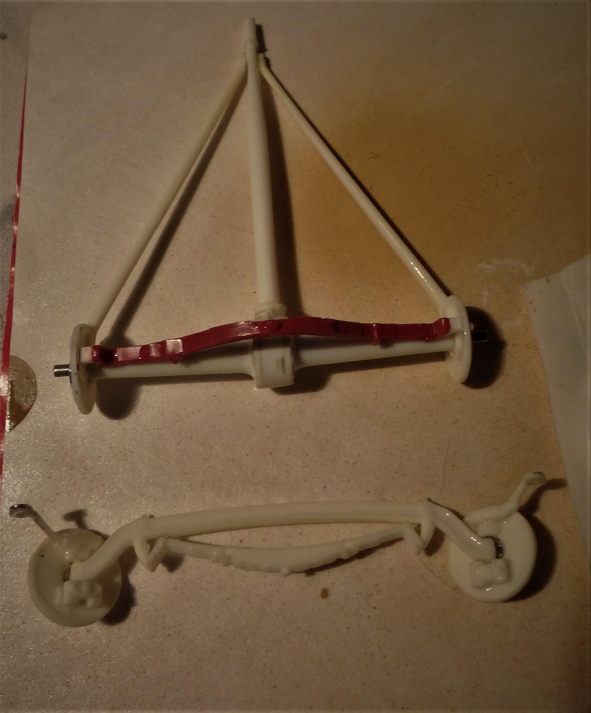

Dechromed axles ready for Alclad.....a 15 minute soak in Zep hair clog remover (a liquid plumber) too the chrome off cleanly.
