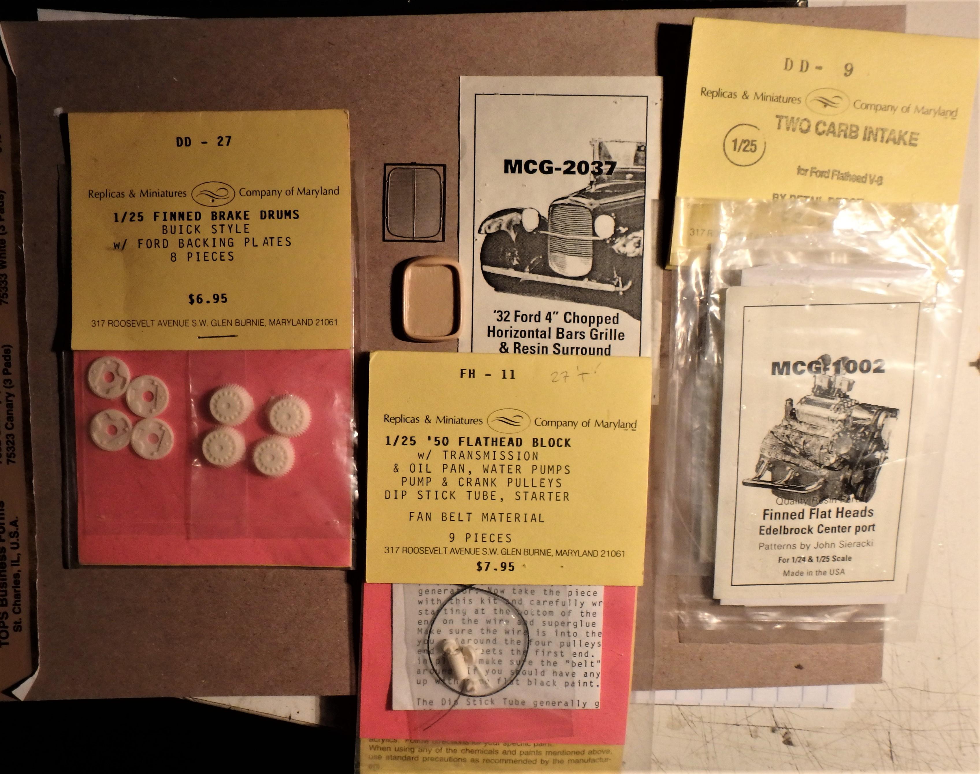

  9. Worked on the exhaust headers....R&M #DD-10 - Cut off the collector on the end of each resin piece, bent a piece of 3/32 inch aluminum tube (using a styrene rod insert to prevent kinking) to fit over the 1/16 inch of each header. Filed the tubing sides to taper the joint to match resin header OD. Headers will be plugged type for street. Measuring exhaust extension to connect to the plugged headers and fit under frame with dual exhaust mufflers.

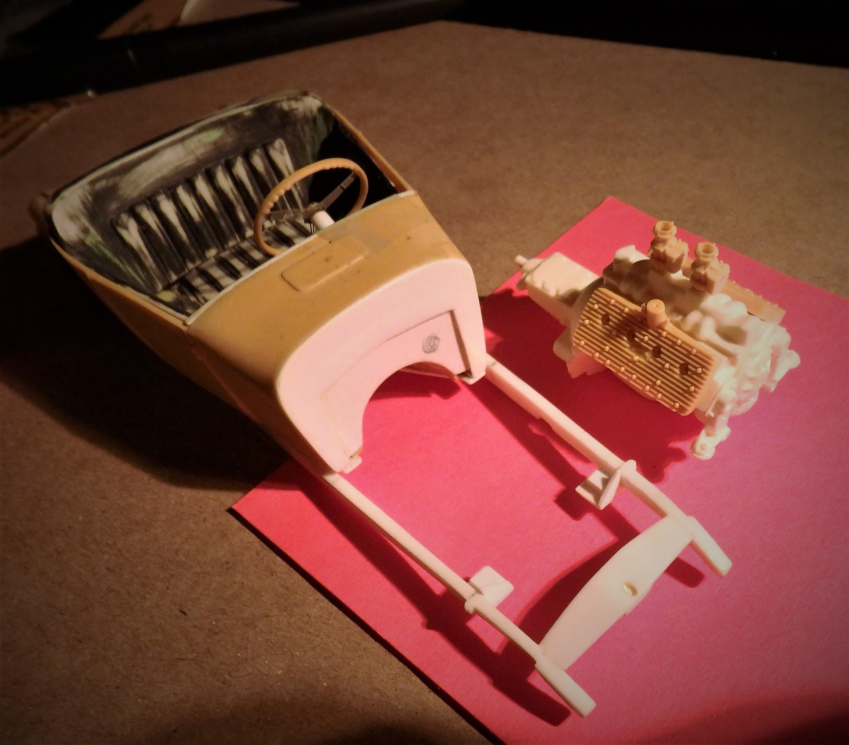

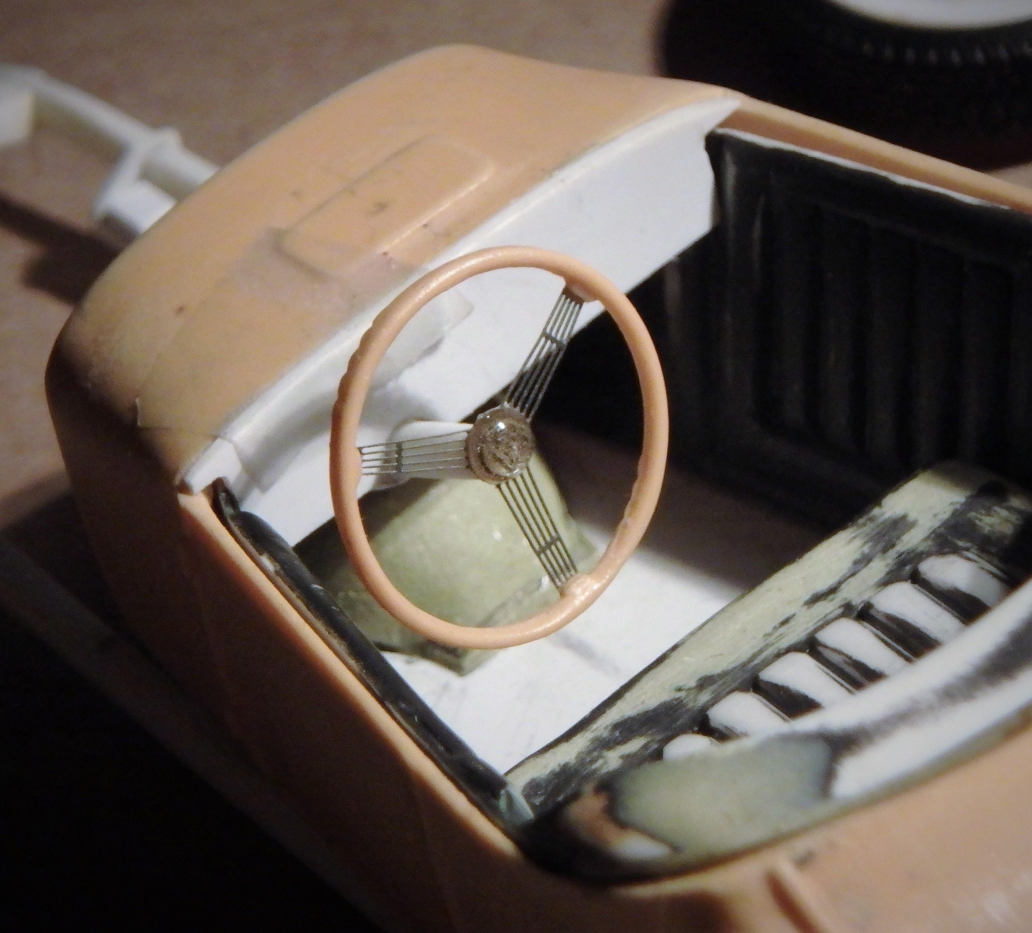

  11. Cleaning up the interior, chopping a windshield frame next.
  12. Working on the flathead exhaust headers....this is a R&M part...will need to break out some K&S aluminum tubing or brass rod...for the extensions and under frame mufflers.

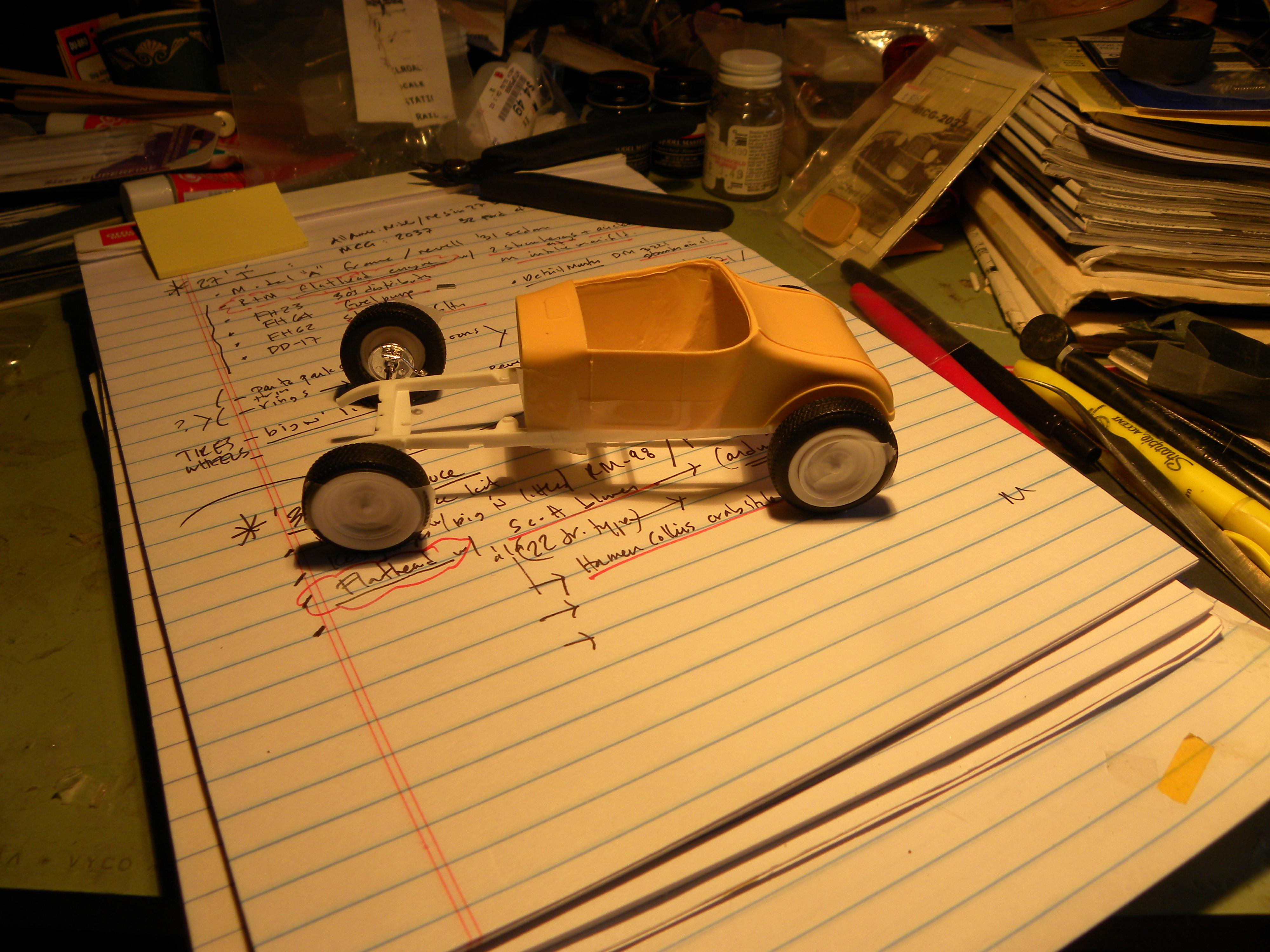

  17. My first attempt at painting ended up with orange peel. Had to set it aside, let it cure and knock down the OP with the LMG KIT. Second attempt had less orange peel but still not acceptable. I'll have to wait for it to cure and have a second go at it. In the meantime I mocked up some grill sell artwork, in keeping with the Black widow/ coffin theme. If I like it, I'll probably do it on thin brass sheet.

  20. I've been debating the color scheme for this '27 T in my head ...what I was sure of...I wanted a dark body/grill color with complementary (opposite) color on the wheels/engine Black is a bit too often used, I like red too, but that is a bit common as well. Been reading Al Drakes book on fifties hot rods, there were purple cars back then, even some on the dry lakes. I thought I maybe a very dark blue/violet metallic with red or maybe yellow orange steelie wheels. After searching the rattle can racks I couldn't find exactly what I wanted....the choices: Tamiya Blue Violet........ value too pale, hue a bit bland light blue, a solid color, a metallic might be better Tamiya Deep Metallic Blue......right value, dark, but hue was too blue, not enough violet Model Master Deep Pearlescent Purple enamel.........dark enough but not exciting Model Master/Rustoleum Ford Ultra Violet Pearl Lacquer.........the right value, dark, and a deep violet hue, and its a fast drying lacquer Made a decision, went with it. Here's what I got. ...parts mocked up, not glued yet. The Tamiya Chrome Yellow is a bit too orange for my liking.....wish they had a lighter yellow in a spray can.
  21. Thanks Tim. Norm is preparing an order for me...need more flathead parts ! I'll check with him.

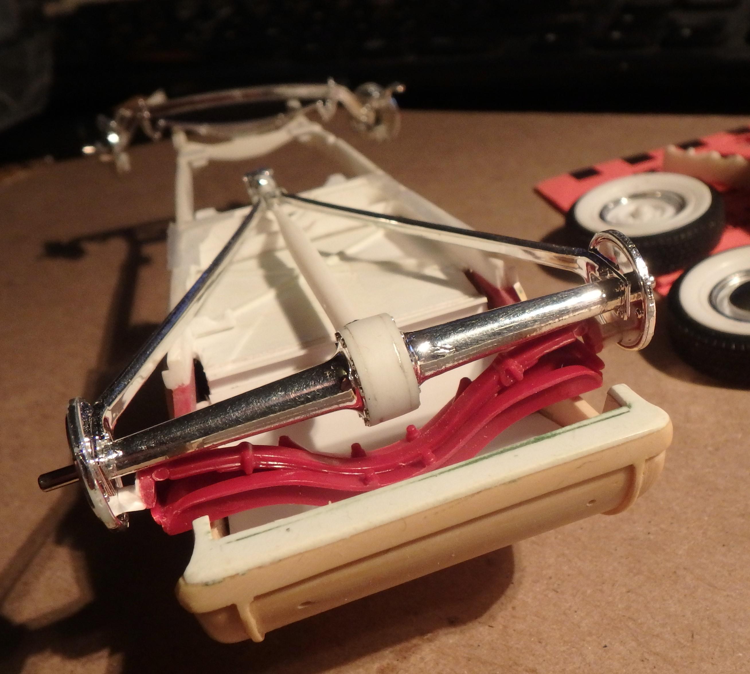

  24. After gloss black base coat, Alclad applied on the axles, beehive oil filter, generator, hair pins ...next up....the resin valve covers.
  25. Dechromed axles ready for Alclad.....a 15 minute soak in Zep hair clog remover (a liquid plumber) too the chrome off cleanly.
