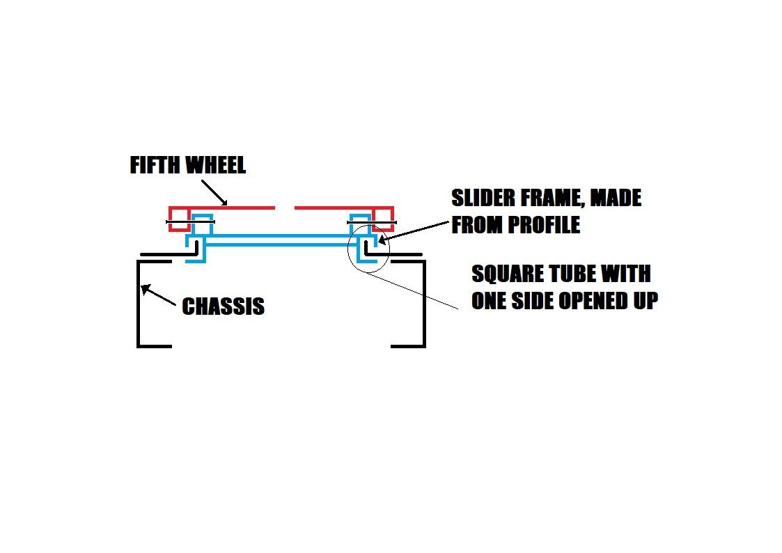

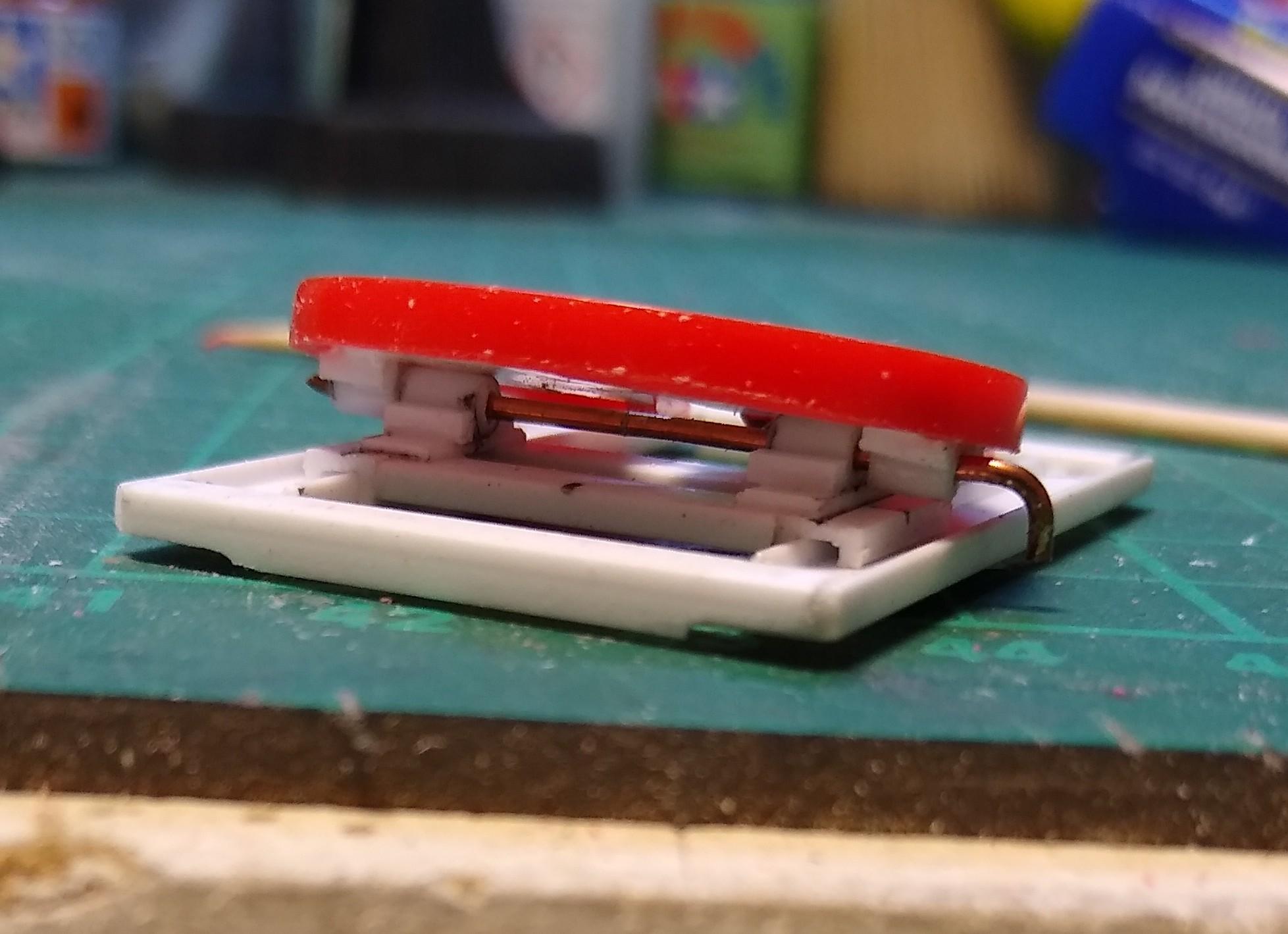

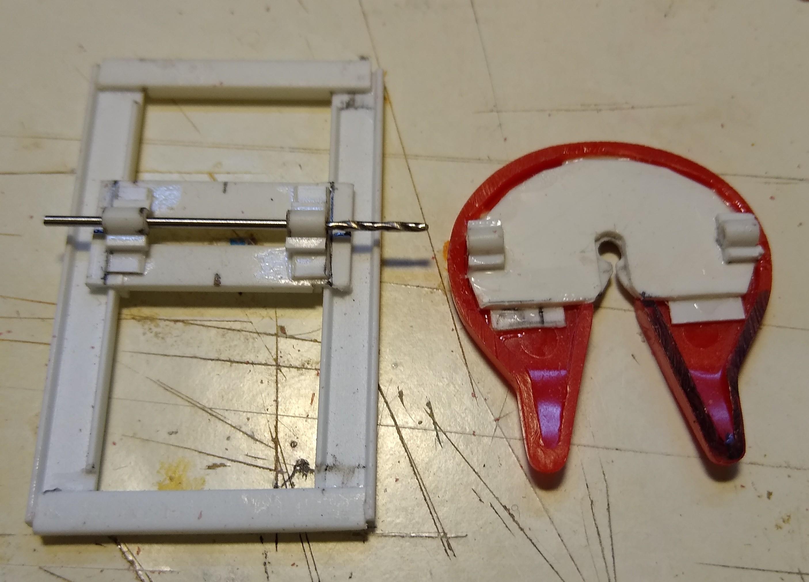

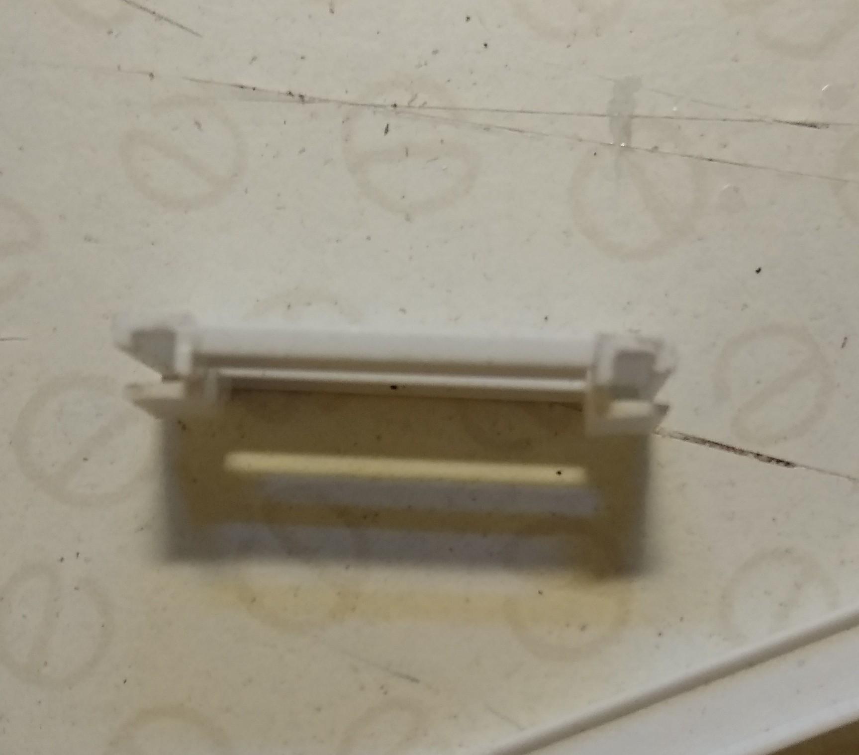

I used some 5mm strip with a lip along each edge and some square tube about 5mm too. I cut a slot in one face of the tube so that it resembled a C viewed end on. This then slid over the strip, the lip acting as the rack and running inside the tube. I linked the tube sections together to form the saddle, then linked the side rails at each end to capture the saddle. Now I had a sliding assembly that couldn't drop out. I detailed a fifth wheel, added gudgeons and put a closing piece under the whole assembly and it looks great. Still sits lower than the original kit mess. To try and explain myself a bit better, here's a picture:- -
I scored these two K100s last year. They were assembled already. The one in the foreground is an AMT and the one behind is a Monogram. I must be mad to start another project but I've decided to build a single sleeper, none-Aerodyne tractor using the Monogram cab but the AMT chassis because they're the best bits of both. First though, I wanted to try something that has been churning in my mind for months. I wanted to build a sliding 5th wheel where the 5th wheel itself doesn't keep falling off. I've built a few sliders along the lines of the old AMT 1/25 trucks and they're great, but at my age I don't like bending down all the time to pick things up, so I want a slide plate where all stays put. How to go about it? I've added a picture of the one I built for my Chevy Bison. It works great but the saddle just sits on the rails. I must do better!
