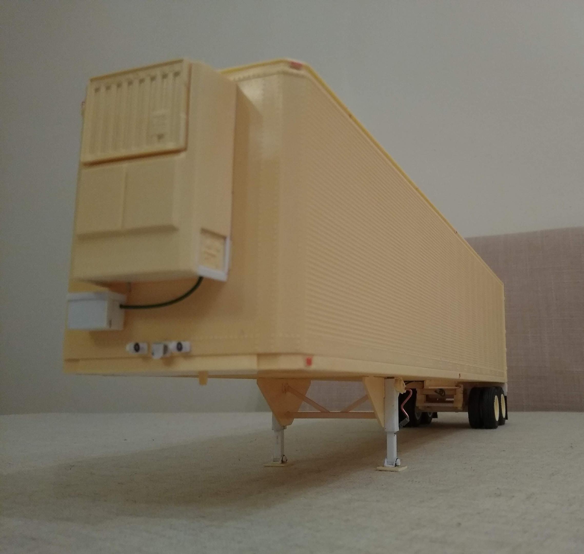

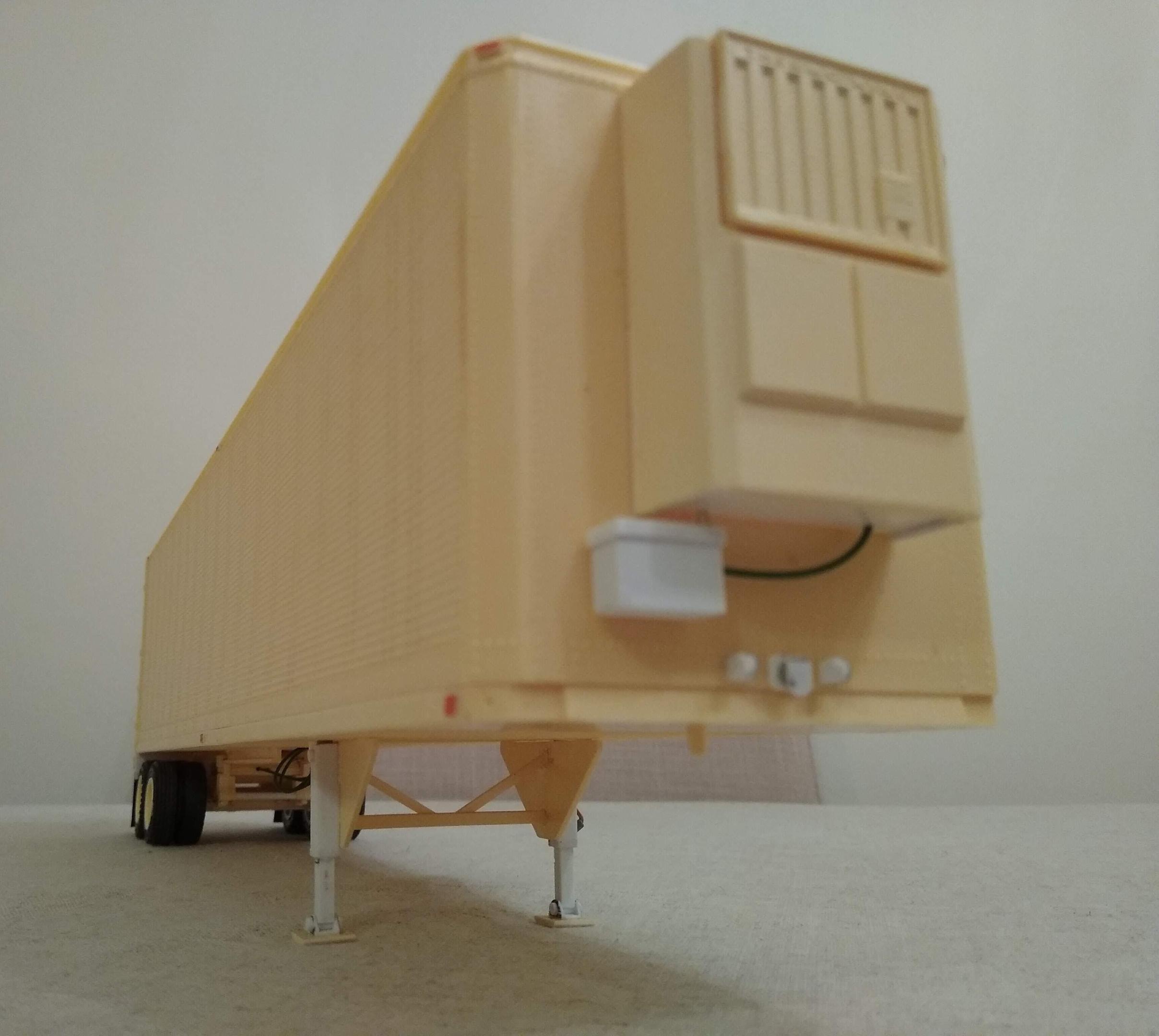

Fuel tank is assembled and tidied up ready for installation. I cut the snap-fit location lugs off so it won't stay on until I finally glue it, and I don't want to attach it until it's painted aluminium, well spotted though, and good call n the condensate drains. I'm thinking of routing a fuel line from the tank to the reefer. -

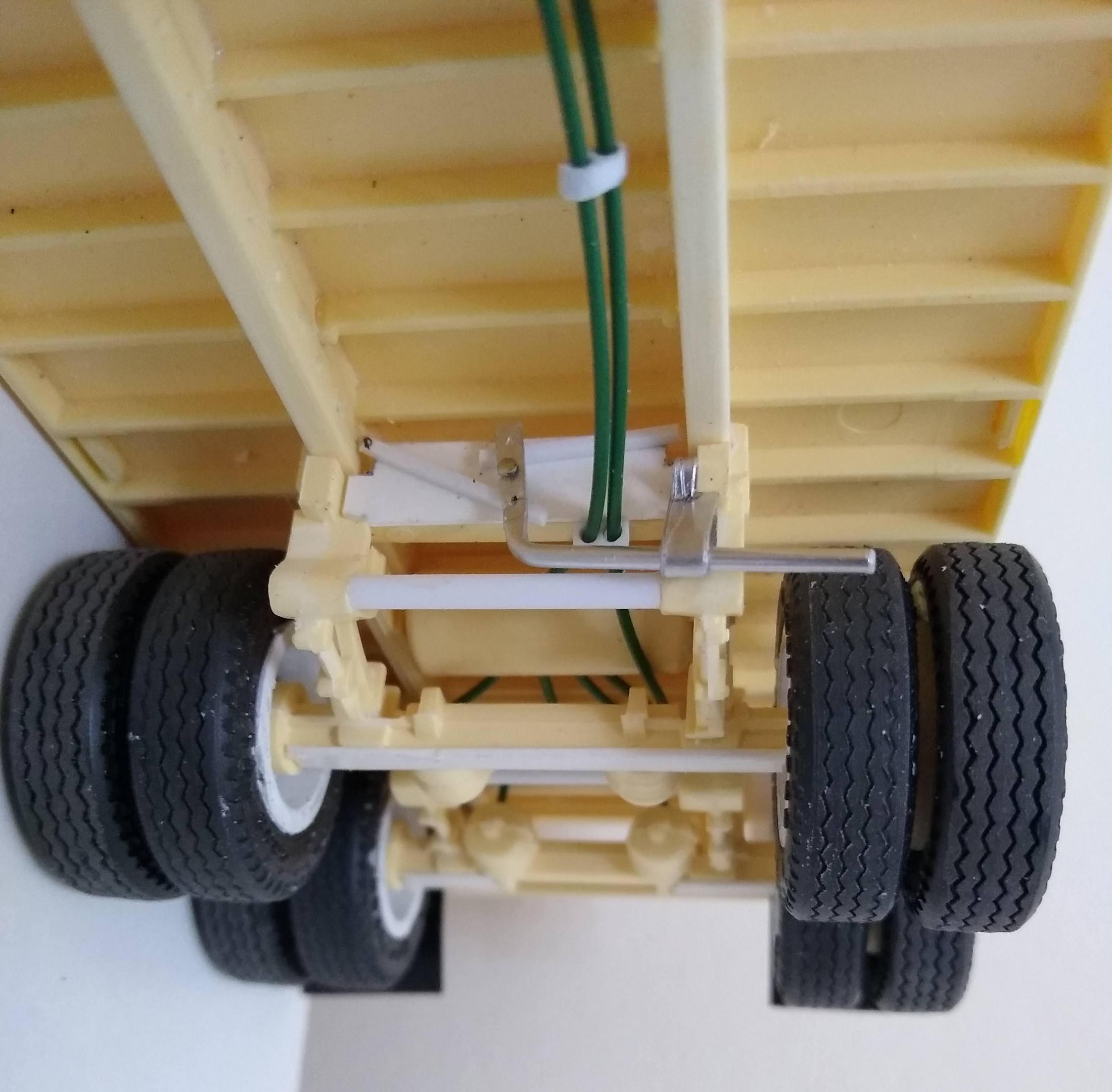

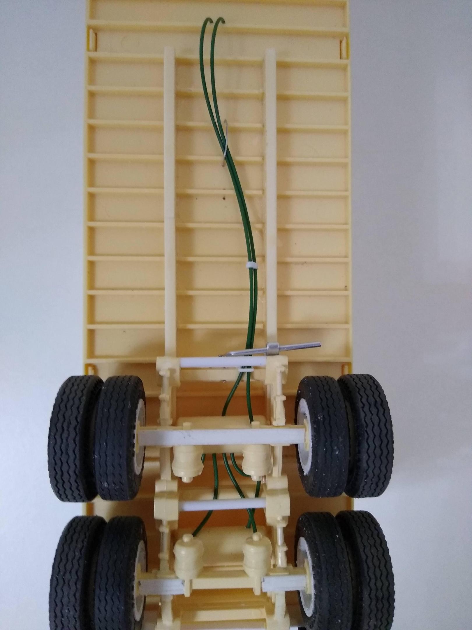

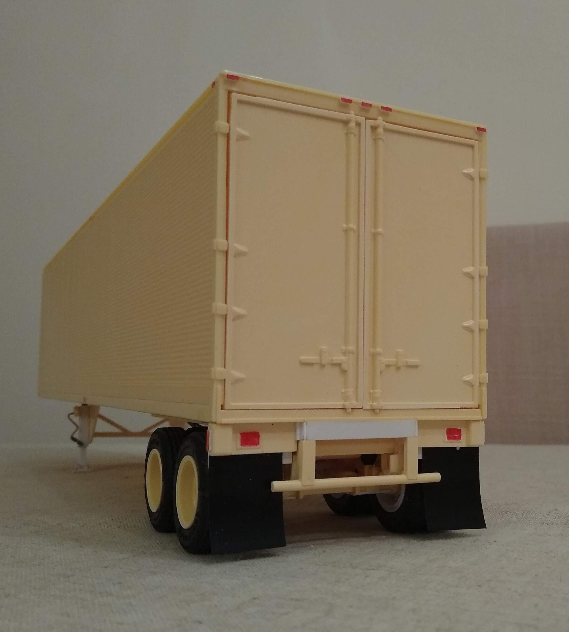

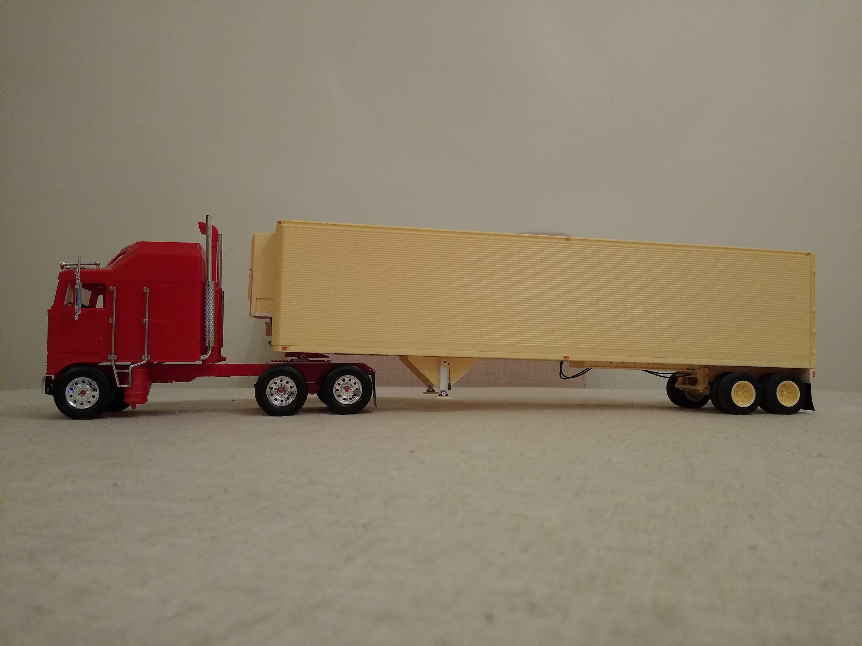

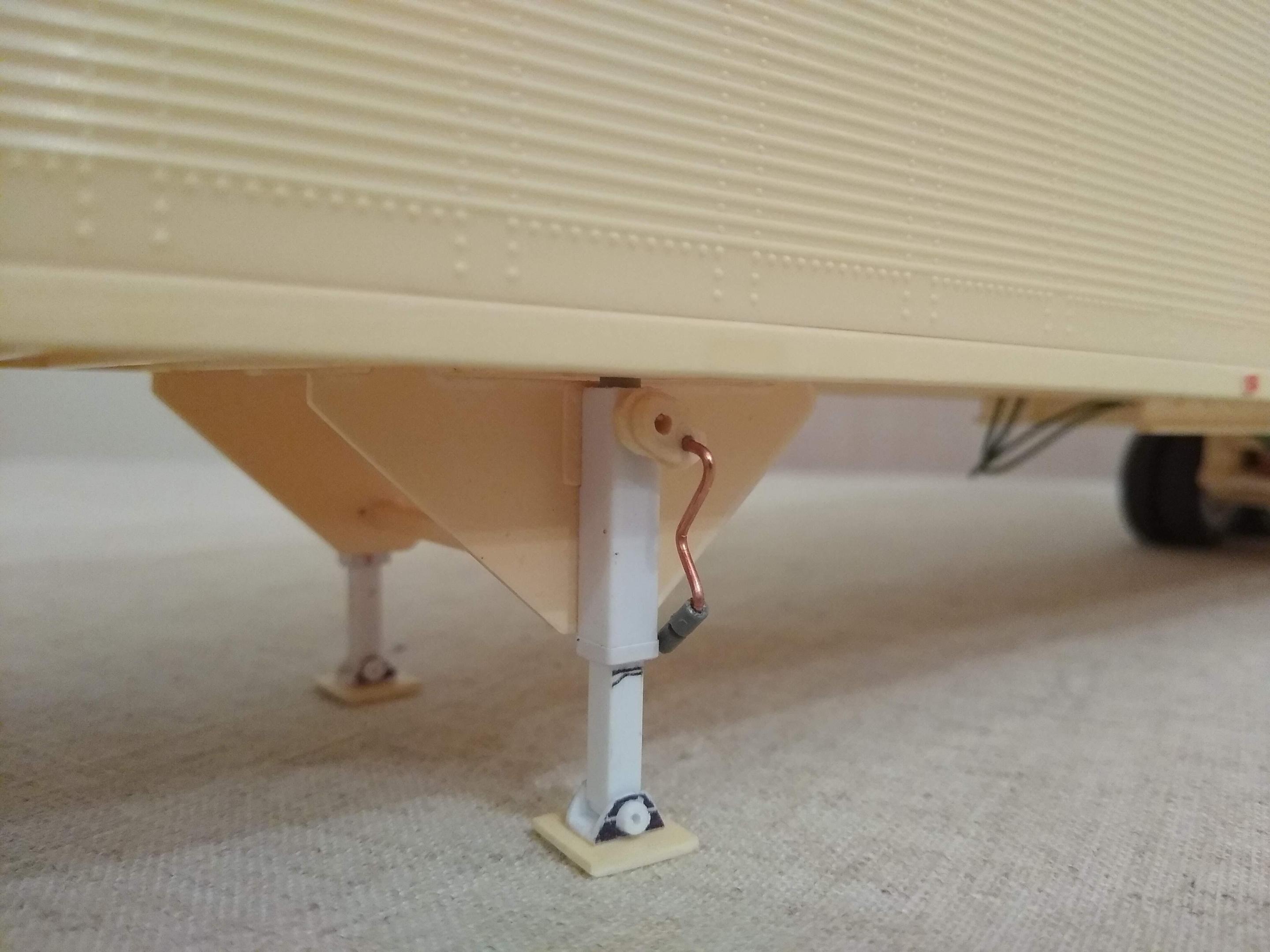

Wasn't going to do a WIP on this but here goes. Bought a few of these recently and was itching to build one. Took the enforced idleness of the holiday period as a signal to get stuck in. This typifies AMT kits in that it's brilliant and awful at the same time. Plenty to correct on these kits. First the ride height needs to be brought down by rebating the slide rails. Levelling up the horrendous rear subframe loses a few more crucial millimetres. Nothing is straight on this kit other than the van moulding, so a lot work filing, fitting etc... but end result is great. Narrowed the track of the rear axles and also the wheelbase. The tyres are too small and are 8mm apart if installed as per instructions, but slid them together slightly and the proportions look much better. Fabbed up the locking mechanism for the tandems. Usual mudlfaps from insulation tape, cut the kit ones away as they're like paving slabs. Boxed the rear end in to hide the terrible rail ends. Landing gear looks like it is made out of cake, so made my own out of square tube and some profiles for the sand shoes and axles. Took the opportunity to make them operable too, so it can stand on it's own two feet when uncoupled. Added basic air piping. Corrected the taper on the lower edge of the reefer unit. Moved the control panel up and built the casing around it. Built an exhaust pipe with a flapper on the top. Fabbed a battery box and starter cable. Added palm couplings and electrical socket. Also added marker lights. Just got to wait for decent weather for pain t now, roll on April!
