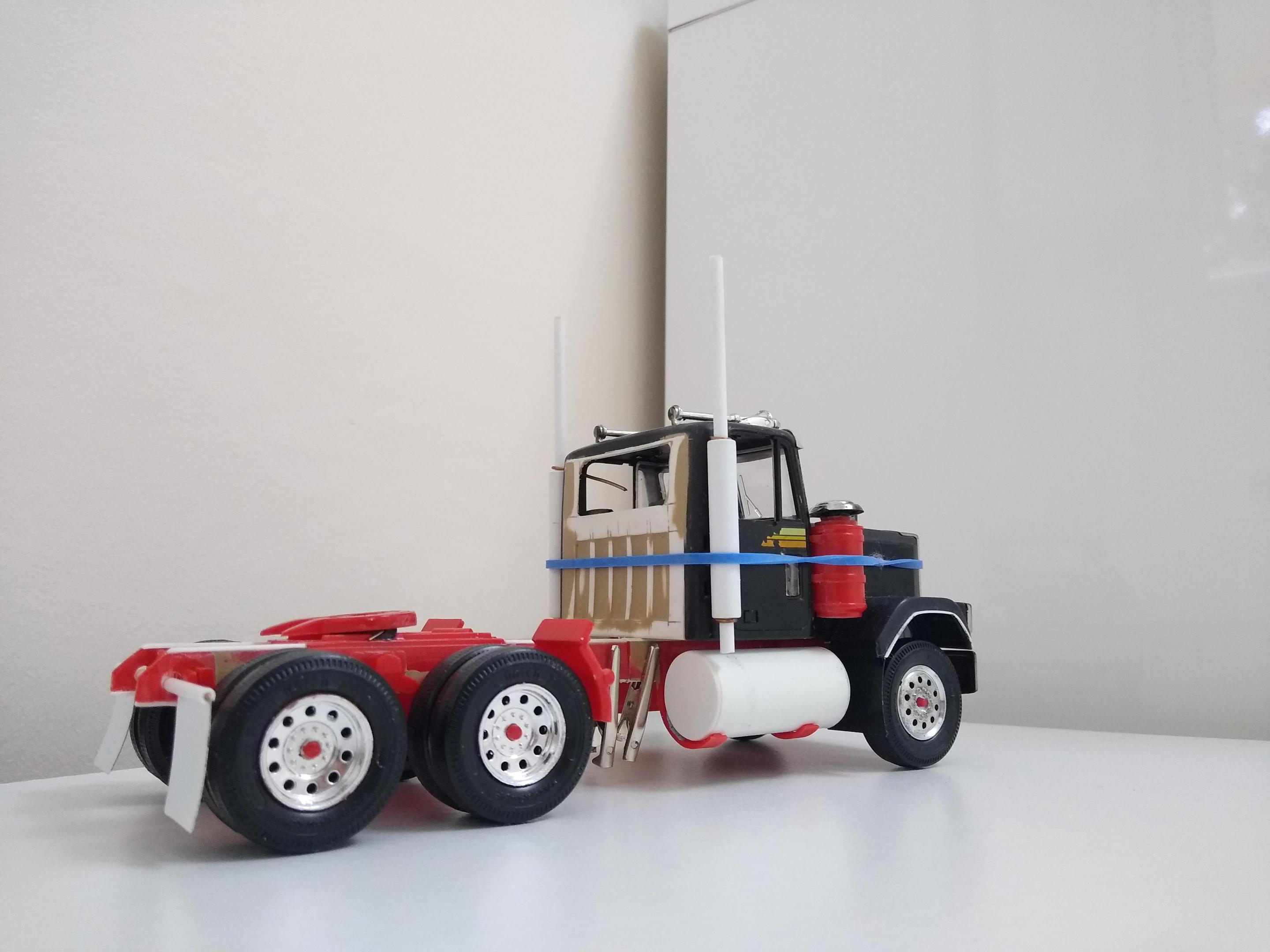

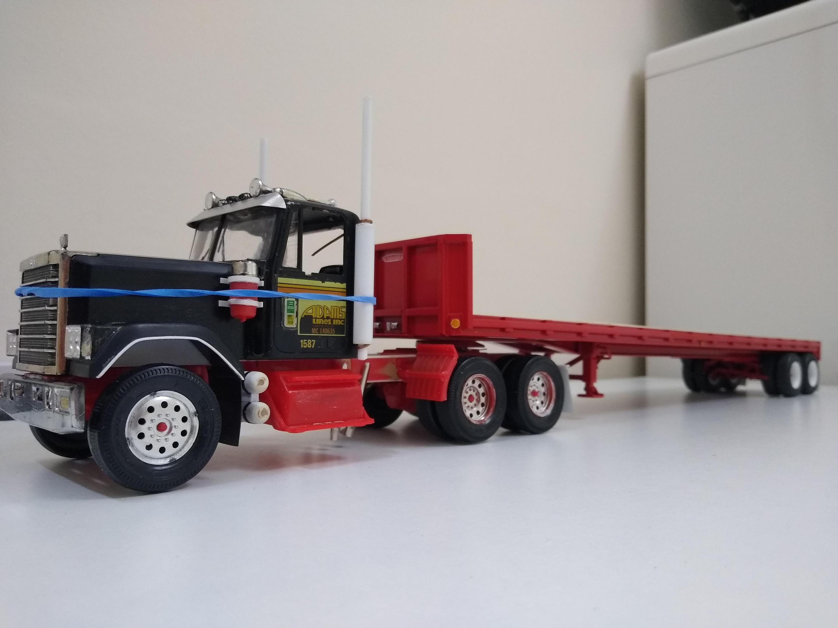

This is as finished as it's gonna get. I did intend a set of Winslow stripes but they didn't come off so another plain Jane tractor. Lot of alterations and scratch building has gone into this, it started out as the Monogram 1/32 Snaptite kit. I wanted it to look like the AMT 352 Pacemaker truck and I'm fairly happy that I've achieved that look. If you want to see the work that went in to getting this far, please look in the On The Workbench section, I won't bore you with the list.

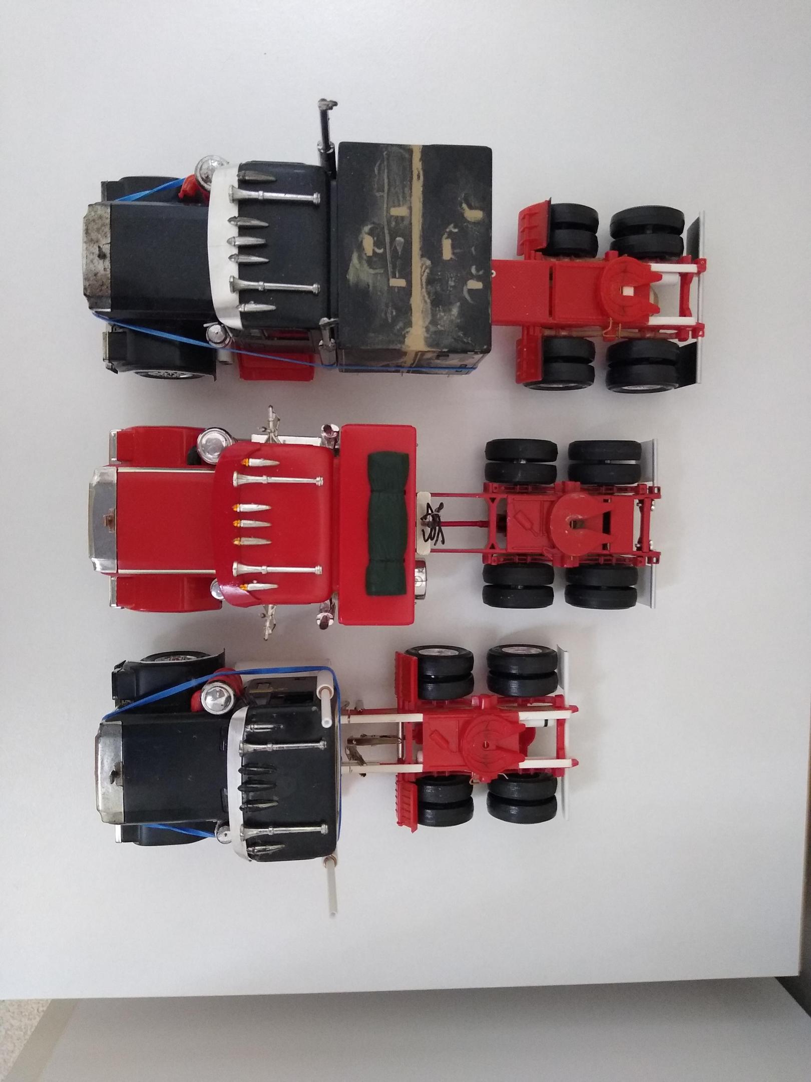

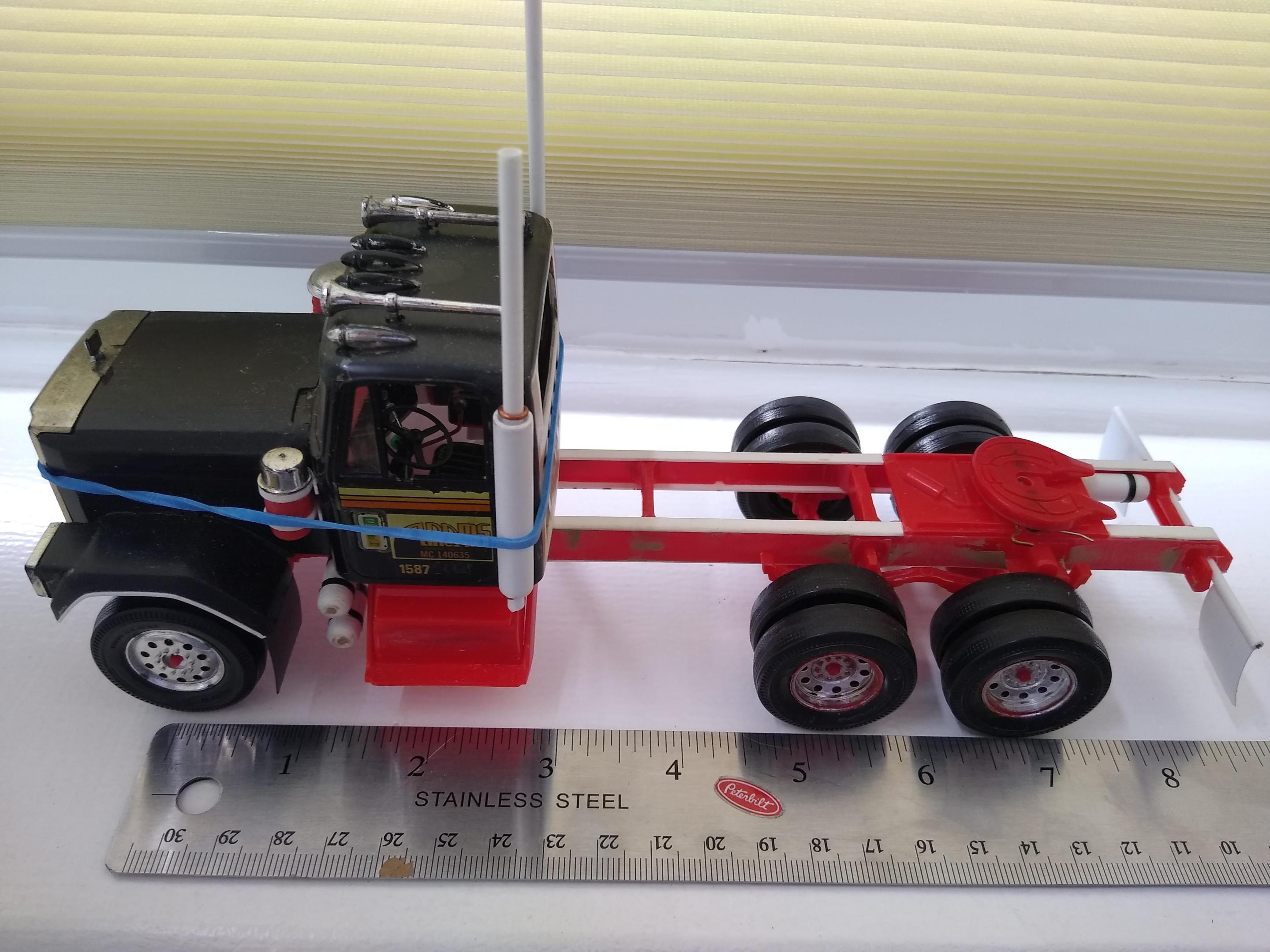

Now that the flatbed is on hold I decided to deal with something that's been bothering me. The daycab Bison looked good with the long chassis but that wouldn't be the usual thing for a workaday truck, which is what I build, I'm not a showtruck builder. I looked on the interwebs at GMC Generals for sale and looked at the wheelbases. Converting them to 1/32 scale gave a smallest figure of 4.9 inches:- I decided that was too small even for me. I tried 6inches:- Too long, I settled for 5.5 inches which was the Goldilocks figure for me:- This meant cutting 36mm out of the chassis, (Forgive me for switching between imperial and metric) and losing my beautiful hand built driveshaft. I decided to use the driveshaft on my GMC General which has only ever had most of one because it was a used kit off eBay, so it didn't go to waste. I made the cut and fitted some fillets for strength. Added quarter fenders. Looks a proper little chunky monkey now. Still a lot of work to do here but I'm so glad I did this, it looks just right. before I went any further. -

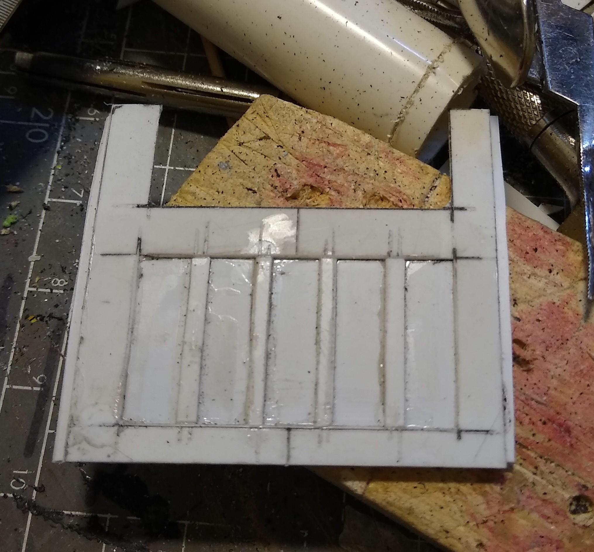

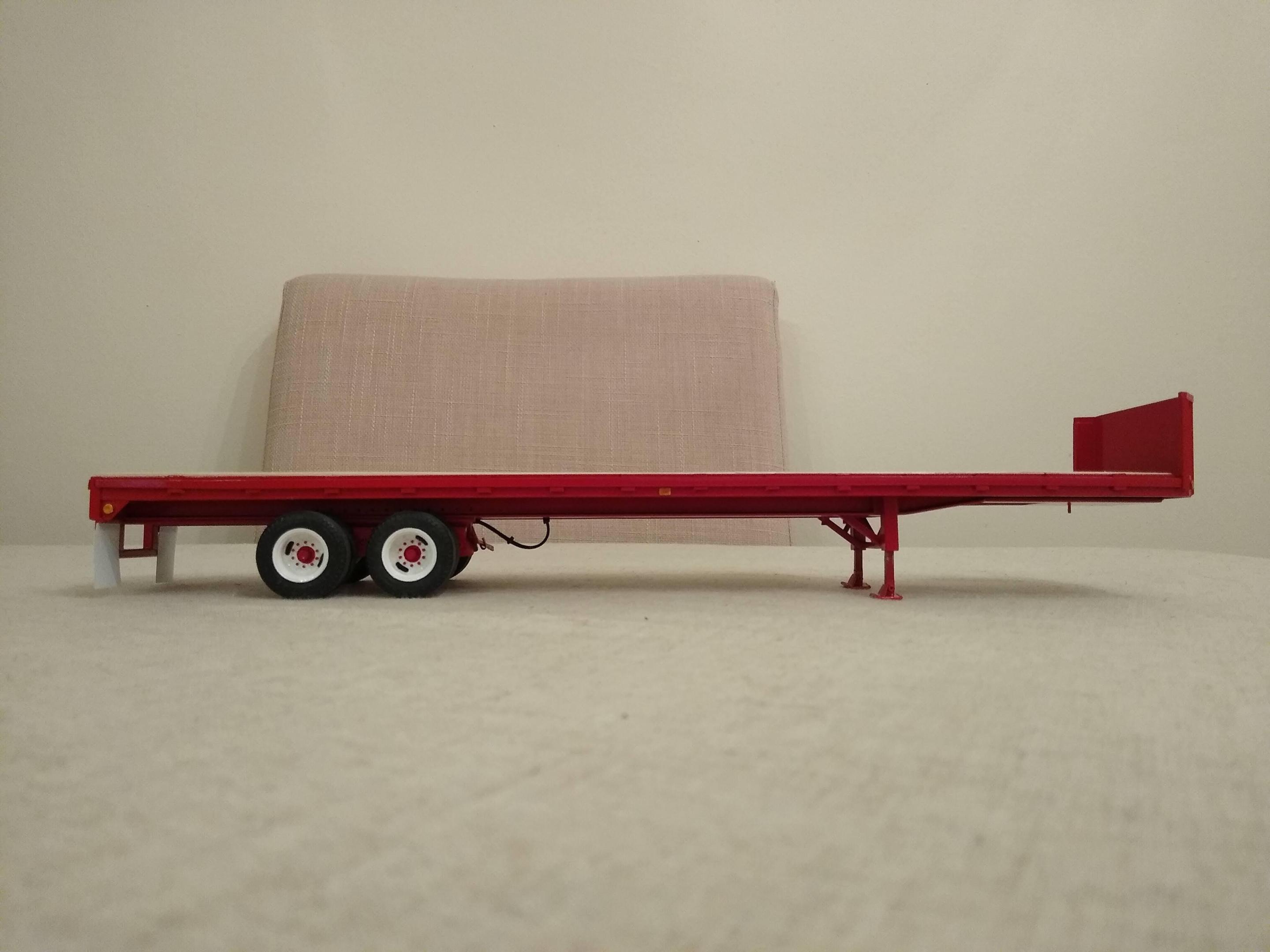

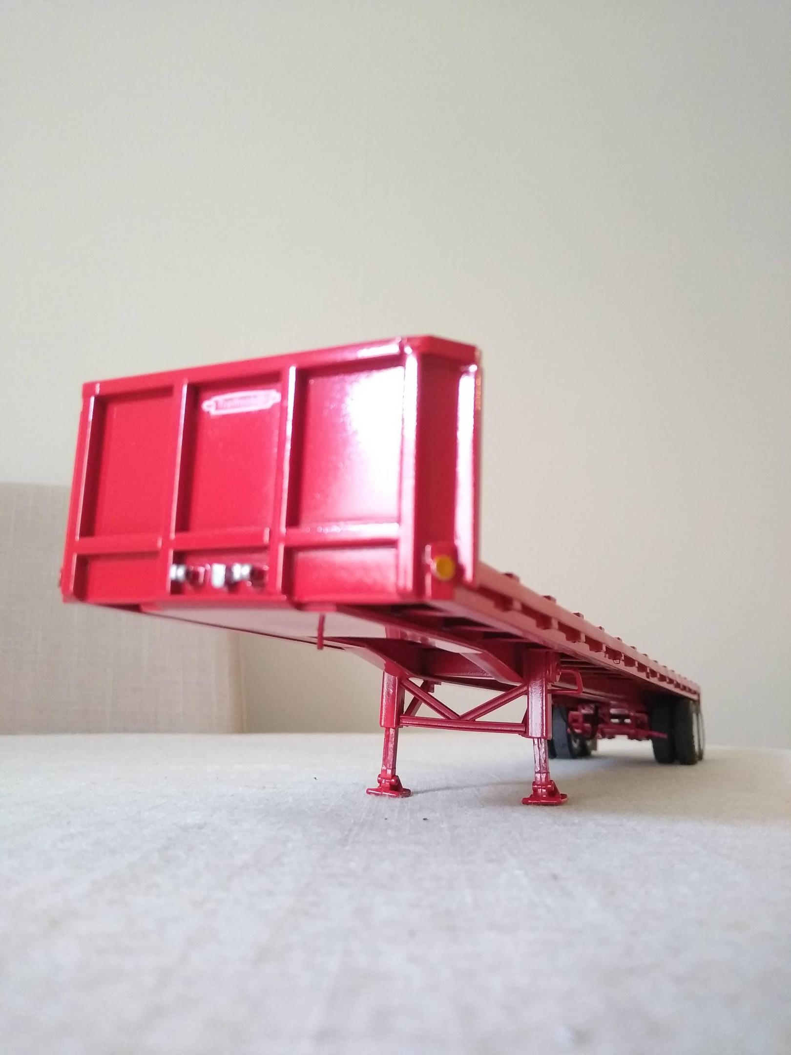

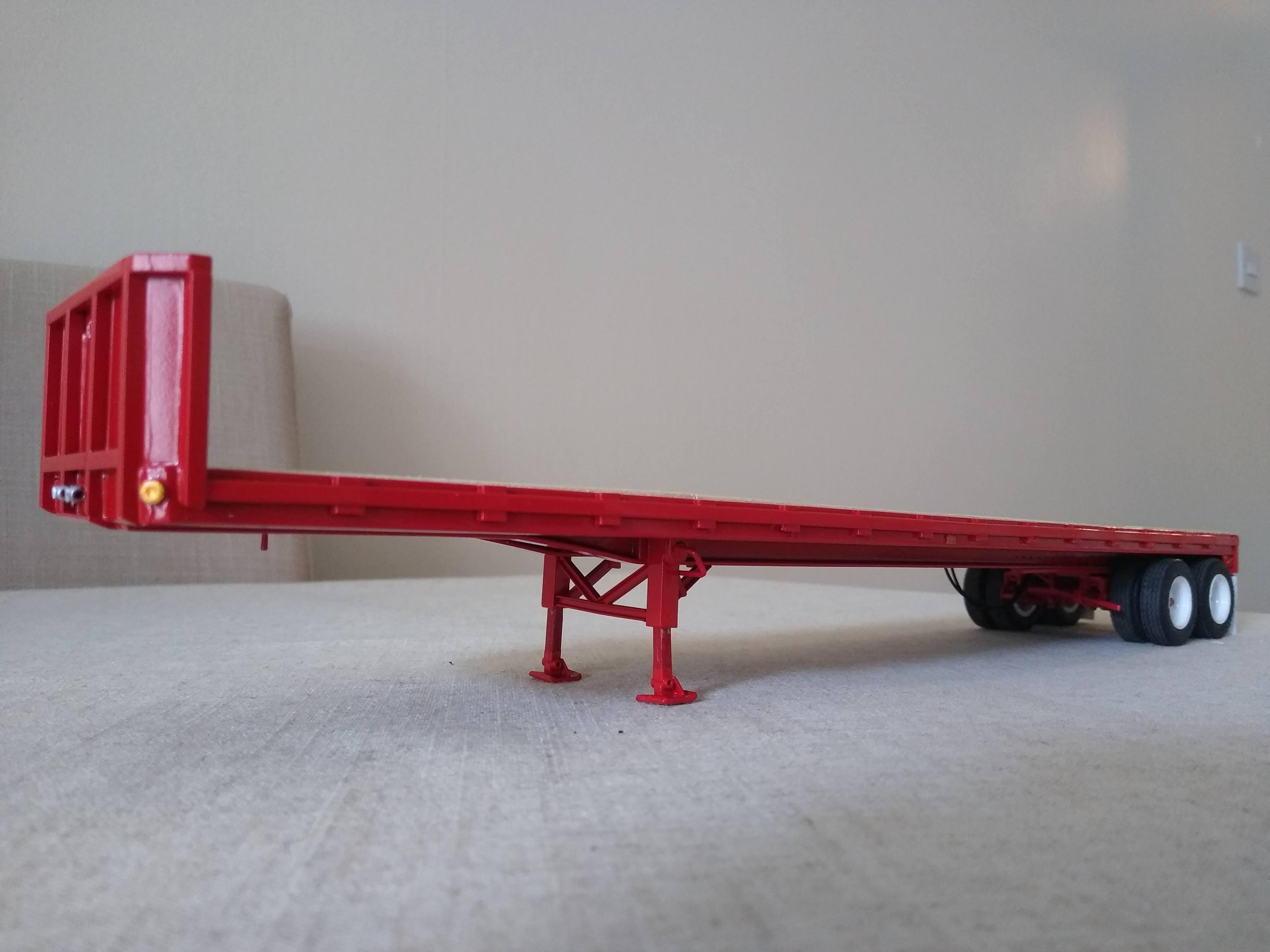

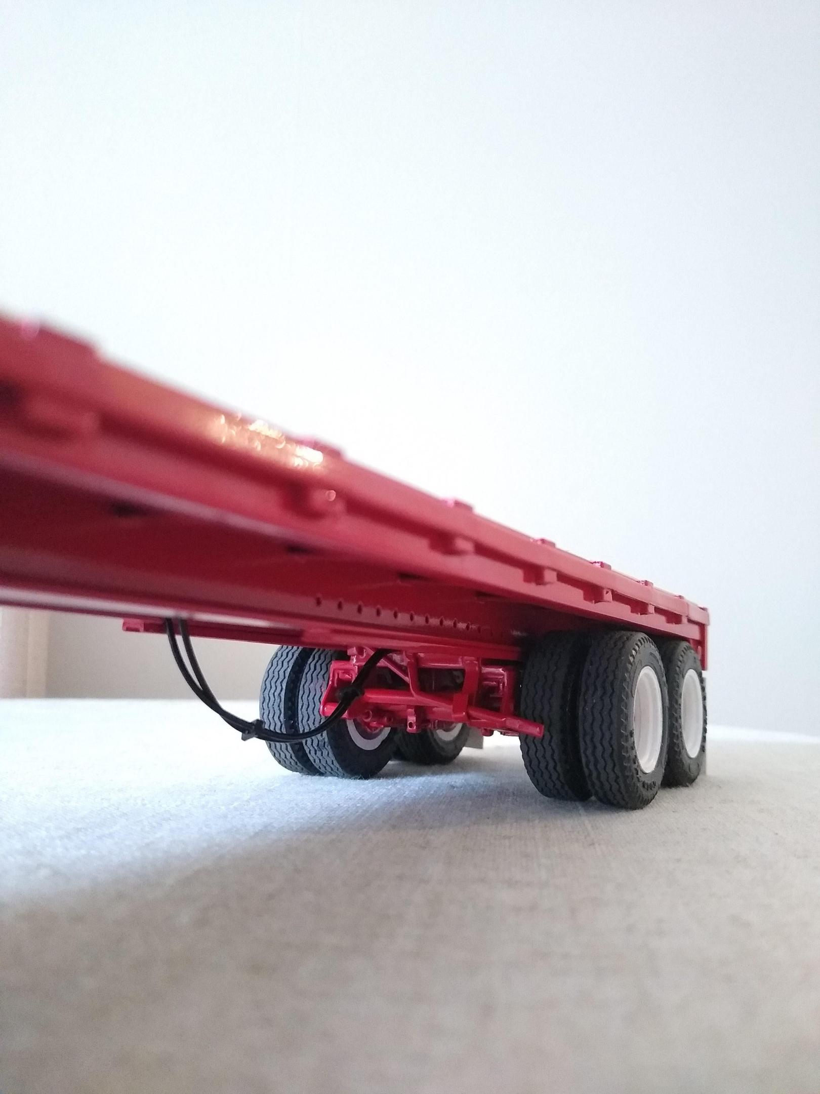

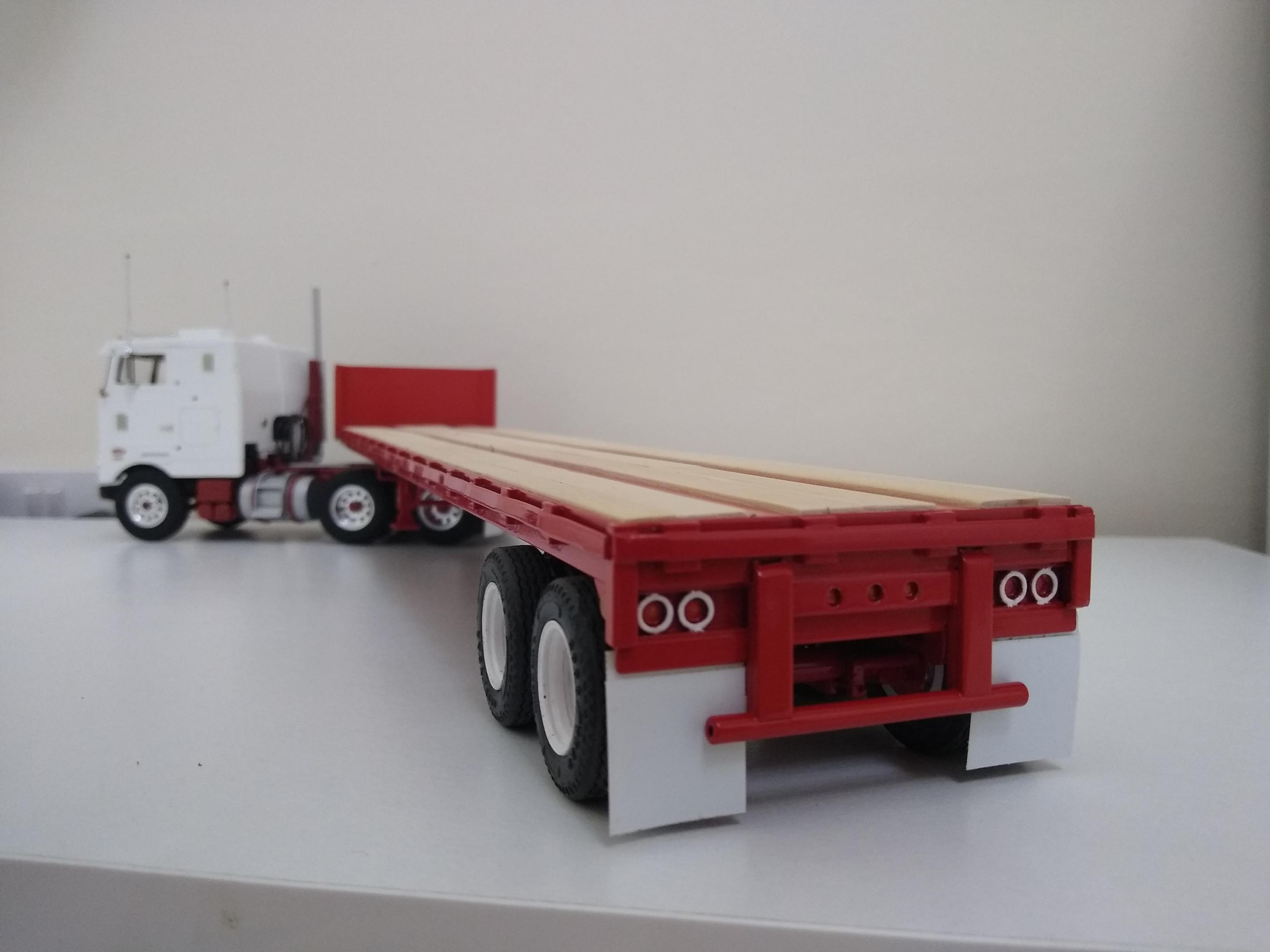

Everything on this trailer is scratch built except for the wheels and tyres and the sand shoes on the landing legs. I wanted a flatbed to go with my assortment of 1/32 tractors but at this scale there's only dry vans, reefers and the fuel tanker. My only option was to modify a diecast unit or build my own. Looking at the die cast stuff I could see it really wasn't suitable, the suspension detail was dire so I chose the "build" path. I bought various plastic profiles from a hobby shop and set to work copying the construction of the real thing. I modelled it on some Trailmobile trailers on auction websites. The rear tandems slide and the landing legs operate. The paint is Post Office Red over red oxide primer. I modified the AMT 1/32 chrome wheels to look like 2 hole Budds. I made my own decals for the mudflaps using Microsoft Paint and reduced some Trailmobile badges for the front and back. This has been one of the most satisfying models I have ever built. I'm over the moon with it and am now wondering what I could build next, despite having 4 projects on the go already. I'm thinking of a removable goose neck trailer. ?

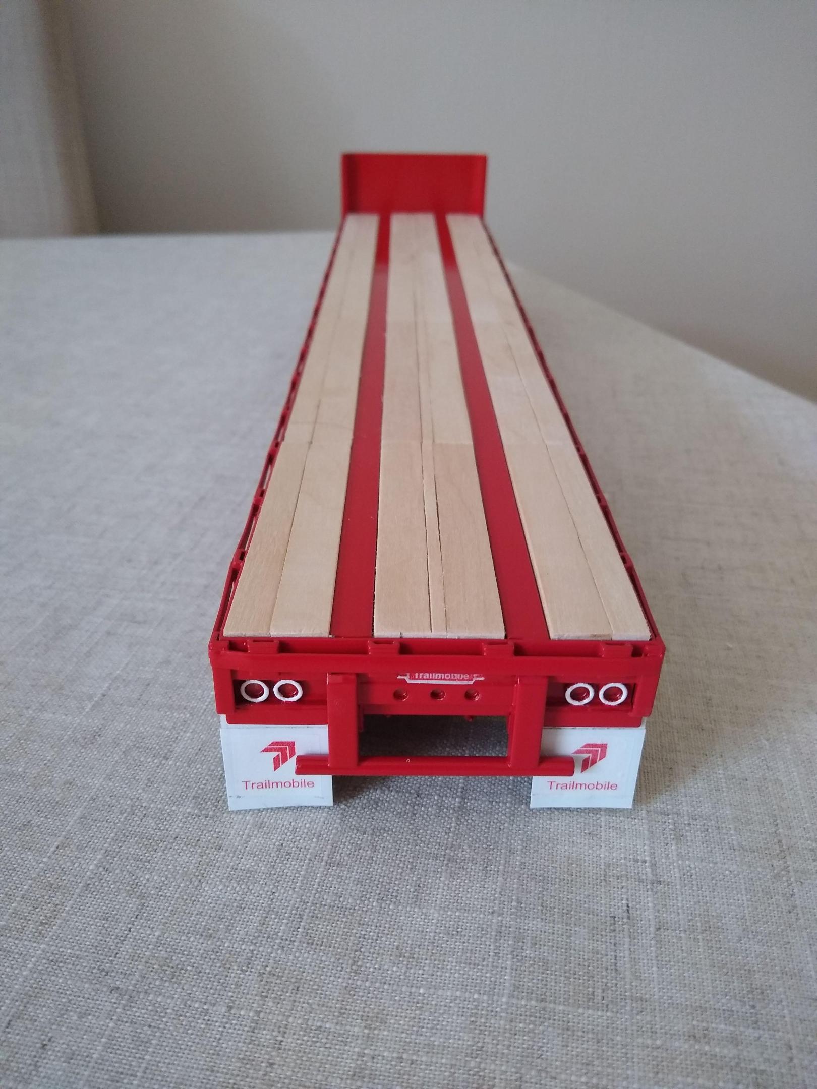

Thanks gents, very kind of you. Well I'm just about done on this build. All that was left was the Trailmobile insignia on the frame and the mudflaps. I'm ok with the wooden bed as it is. I can't think of any way to treat it. I know in real life it would be treated for longevity but it would be left fairly rough to make a good, non slippery surface. As I've said before I'd like to weather it a little bit don't know how. I might try a few things over the next few months. For now, it's done. Can't quite believe I've done it, or finished something for once. -

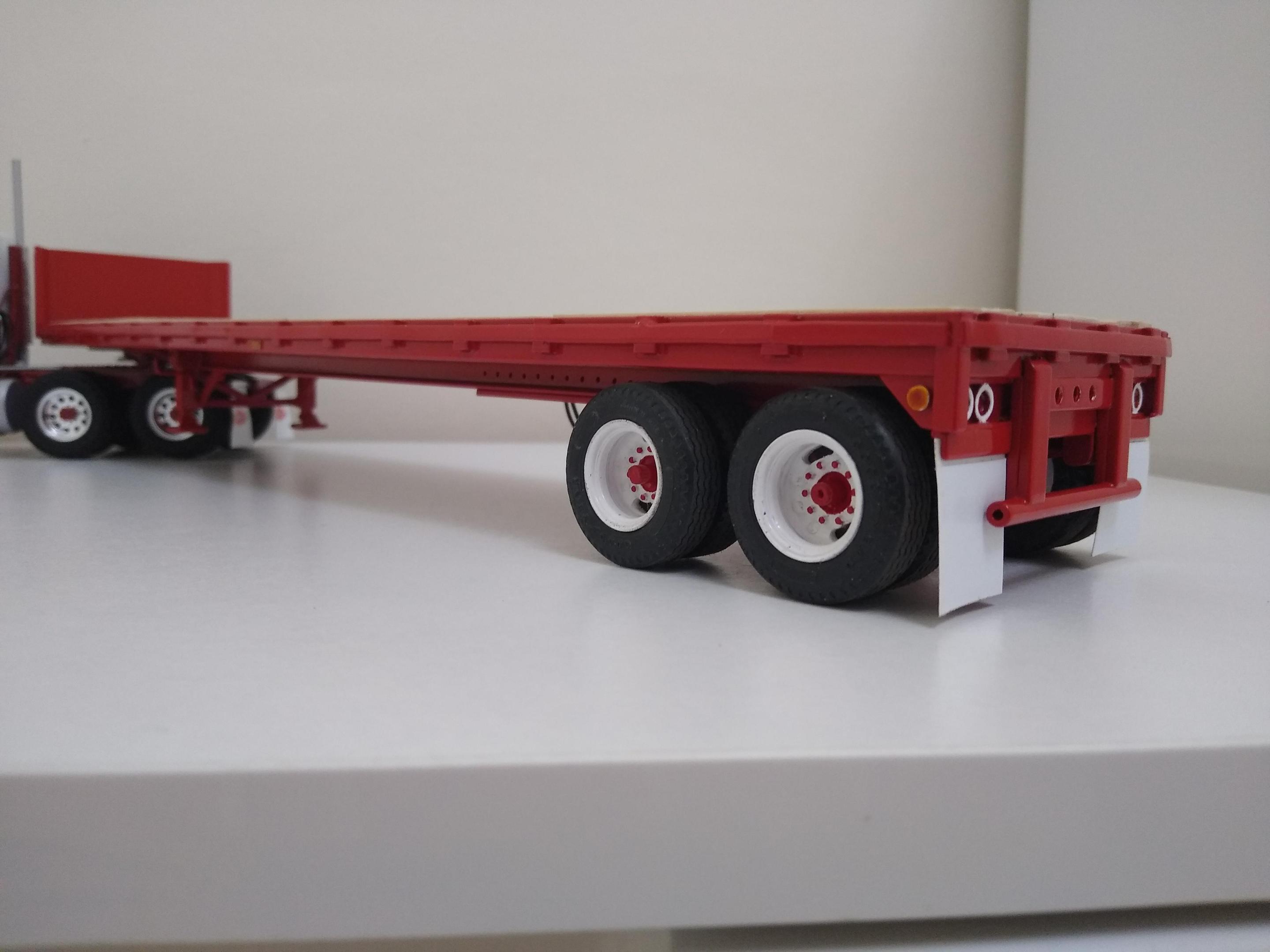

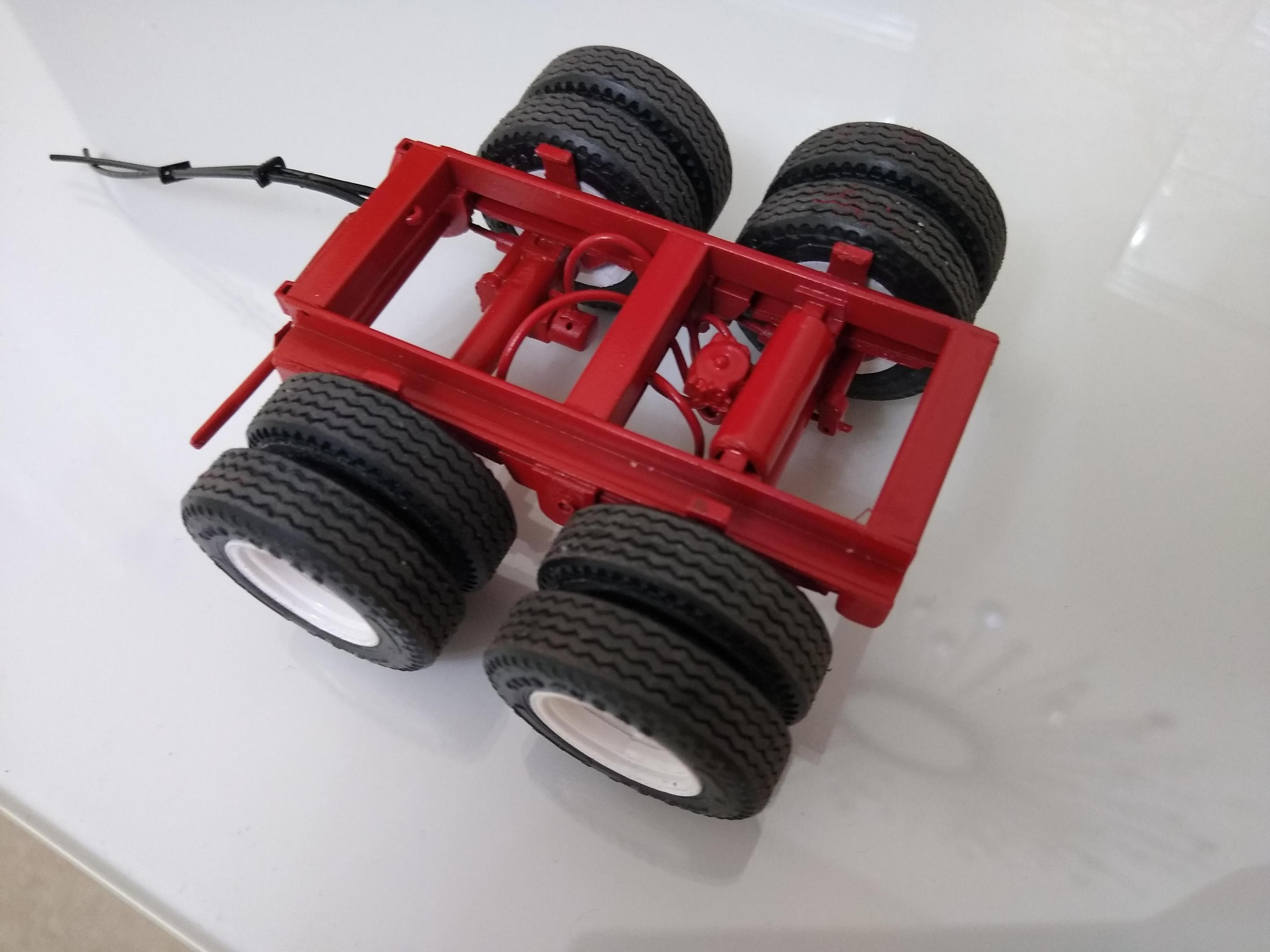

Today it all went together. I painted the hubs and the wheel nuts with Tamiya red. Painted the air lines from the chassis to the tandems. Left the lines to the brake chambers red because we never bothered masking the hoses when we sprayed a trailer. Fitted the sliding bogie and lubed it with some dishwashing liquid. Made my mudflaps out of white electrical tape. Painted the rear lights and markers with silver, then used clear red or orange or red as required. I also downloaded some insignia and reduced them. Here they are on white decal paper. I'll clear them to seal the ink. I simply cannot believe I actually built this. It looks like a trailer, not a shapeless twisted blob. The tandems still slide. The wheels look right, not too far apart. -

True answer Dan, I really don't know. I'm wondering whether I should rethink the deck but I really don't know what I could use as an alternative. Also, I'm wondering whether I should weather the deck somehow. Thanks for the kind words gents. -

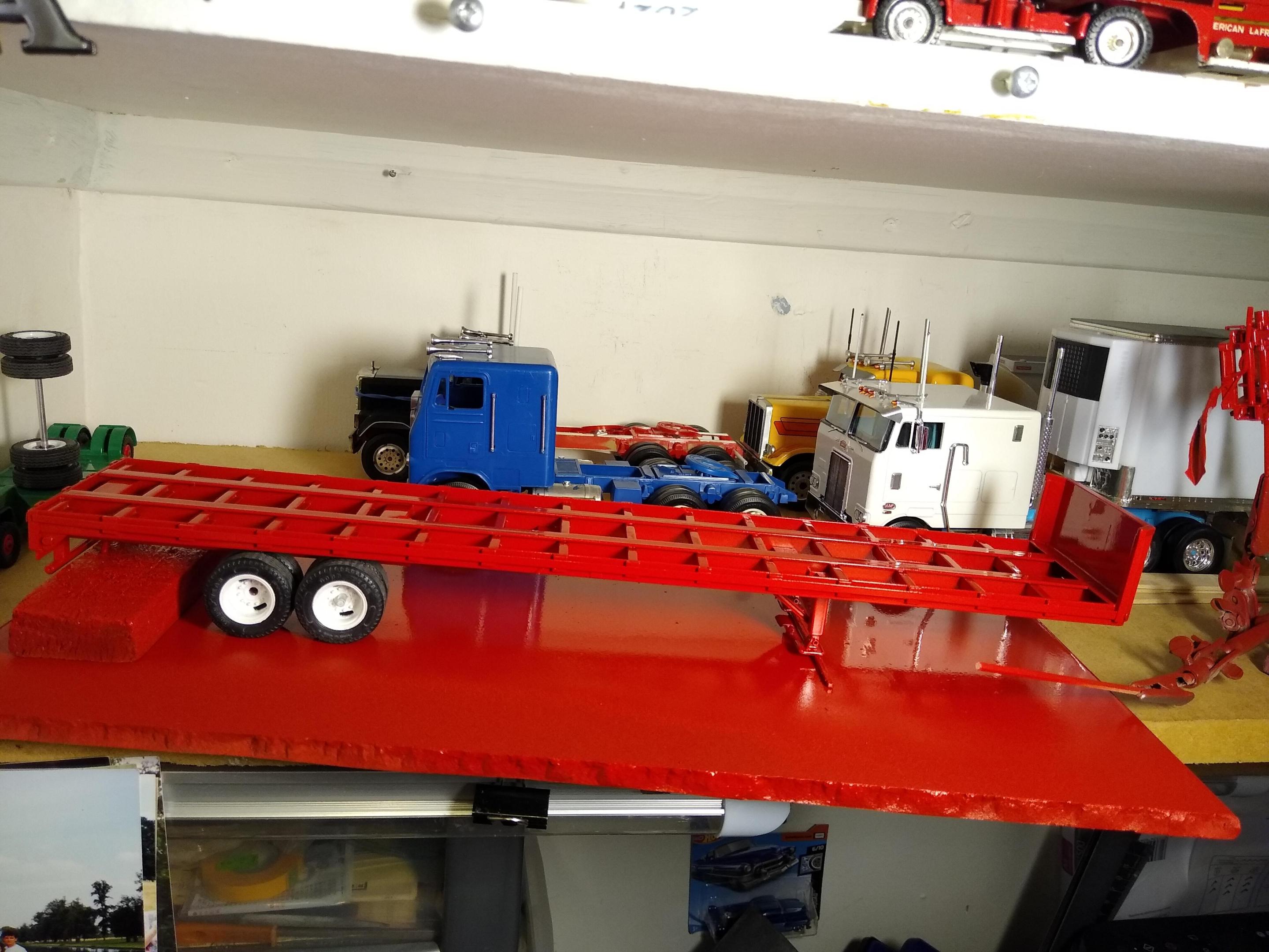

I DID IT! I GOT IT PAINTED AND IT DOESN'T LOOK LIKE I USED A STICK! In Liverpool today all the planets aligned to allow me to paint the trailer. 1) I had red primer and Post Office Red topcoat. 2) It was sunny, warm and not too humid. 3) I had the afternoon off. 4) I'd washed the trailer during the week and given it a quick going over with a Scotchbrite pad. 5) My darling wife wanted to do her own thing. I got the car out of the garage, set up my painting table and put the trailer on a turntable. I need to have the job facing the light because of my cataract, otherwise I can't see where I'm painting or if I'm spraying too wet/dry. I sprayed the lower surfaces first, let it flash off for 15 minutes then turned it over and shot the top. Two coats each of primer and then 2x topcoat so it took a few hours. Got the deck chair out and had a good read while I waited. There was still some topcoat left after two coats but it looked so good I was scared of ruining it with a third, so I left it there. I'm stunned by the results. The stress is now to leave it alone for a least a week. If I start fiddling around and moving it I'll damage it so I've got to be strong. I still couldn't resist sitting the wheels alongside it to see what it looks like. I know it doesn't bear comparison to some of the scratch building that you see on this site but it's put a smile on my face. I've never enjoyed doing anything as much as this. Thanks everyone for your kind comments. Now if you don't mind, I'm going to look at my trailer again....
