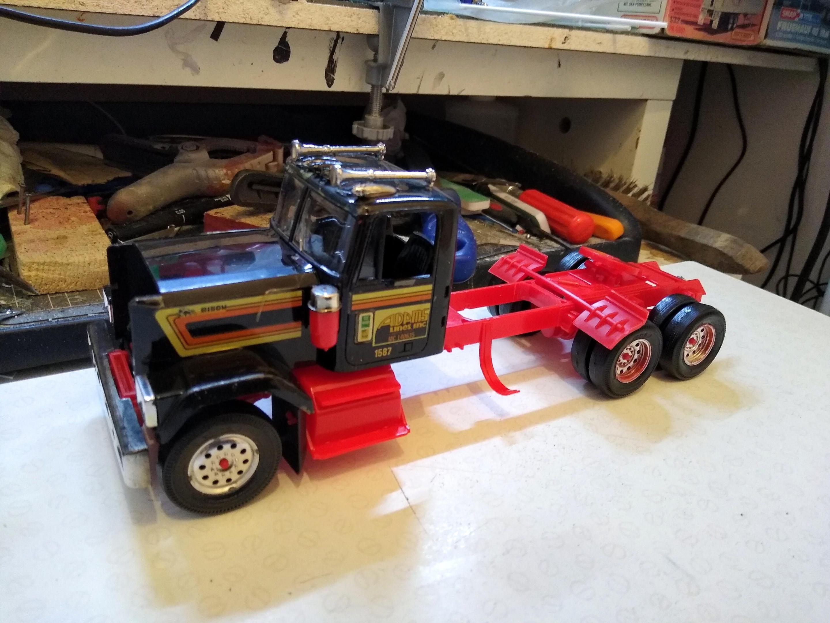

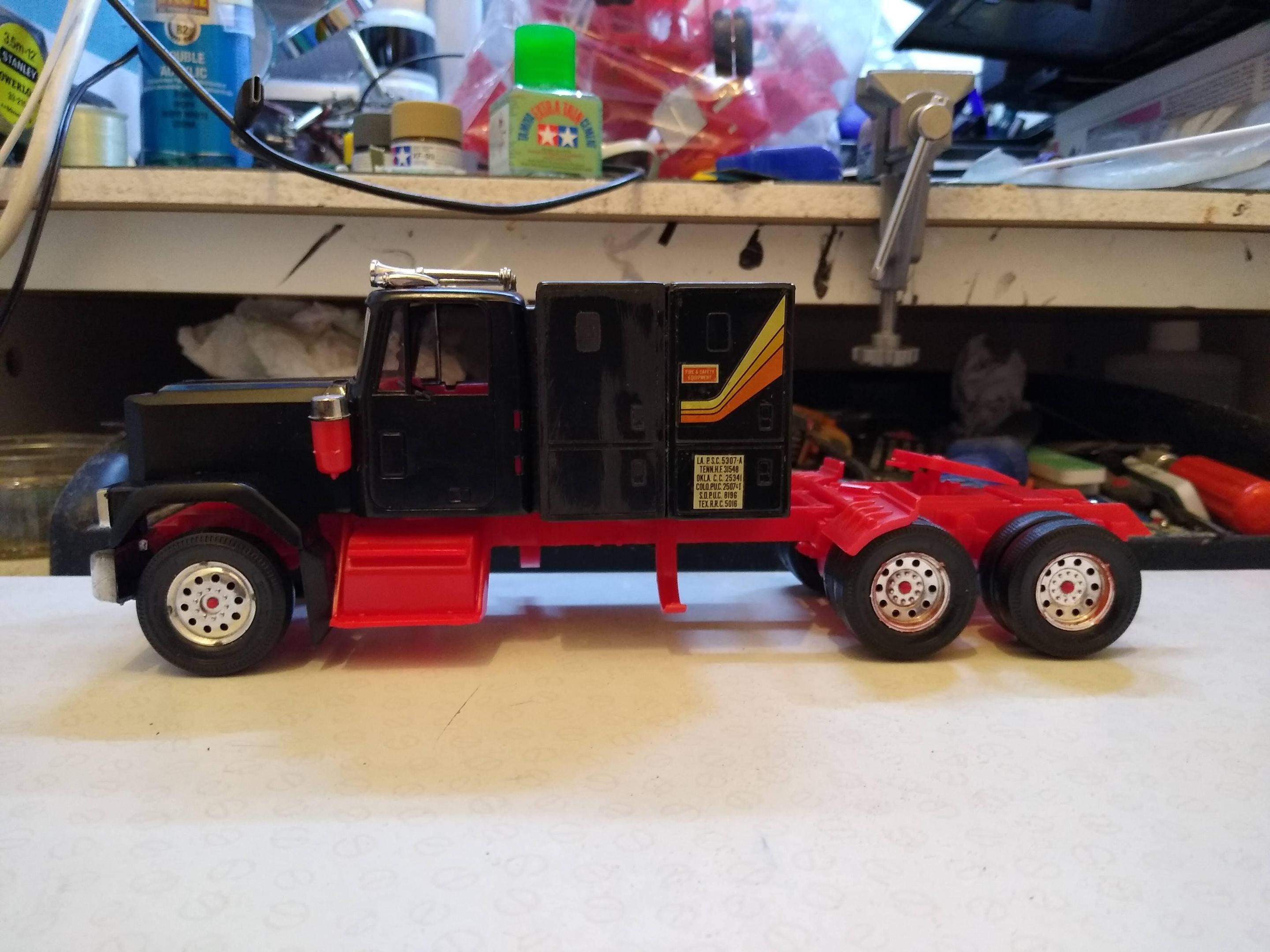

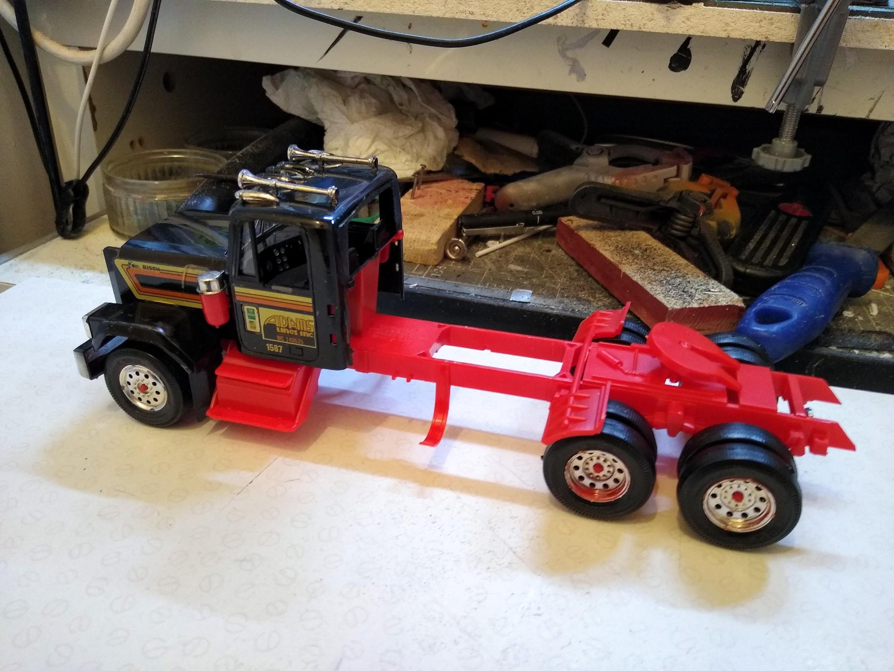

What's the difference between a buffalo and a bison? You can't wash your hands in a buffalo! Couldn't resist the old joke I shouldn't start another build with one already on the go but I'm itching to dip into the scrapyard I've just bought off Ebay and I spent a snatched hour achieving nothing on my Peterbilt this afternoon so I wanted a fix. I got two Snaptite Chevy Bisons, (I'd prefer the GMC General but beggars can't be choosers). I'm going to do one as a daycab and the other as a double sleeper using the offcut from the daycab. I snatched a moment today to do the cut and the transplant. Not great pictures but I was a bit pushed for time. I'm going to do my usual rectification work on the chassis and running gear so I'll leave that out, hopefully just show the major mods.

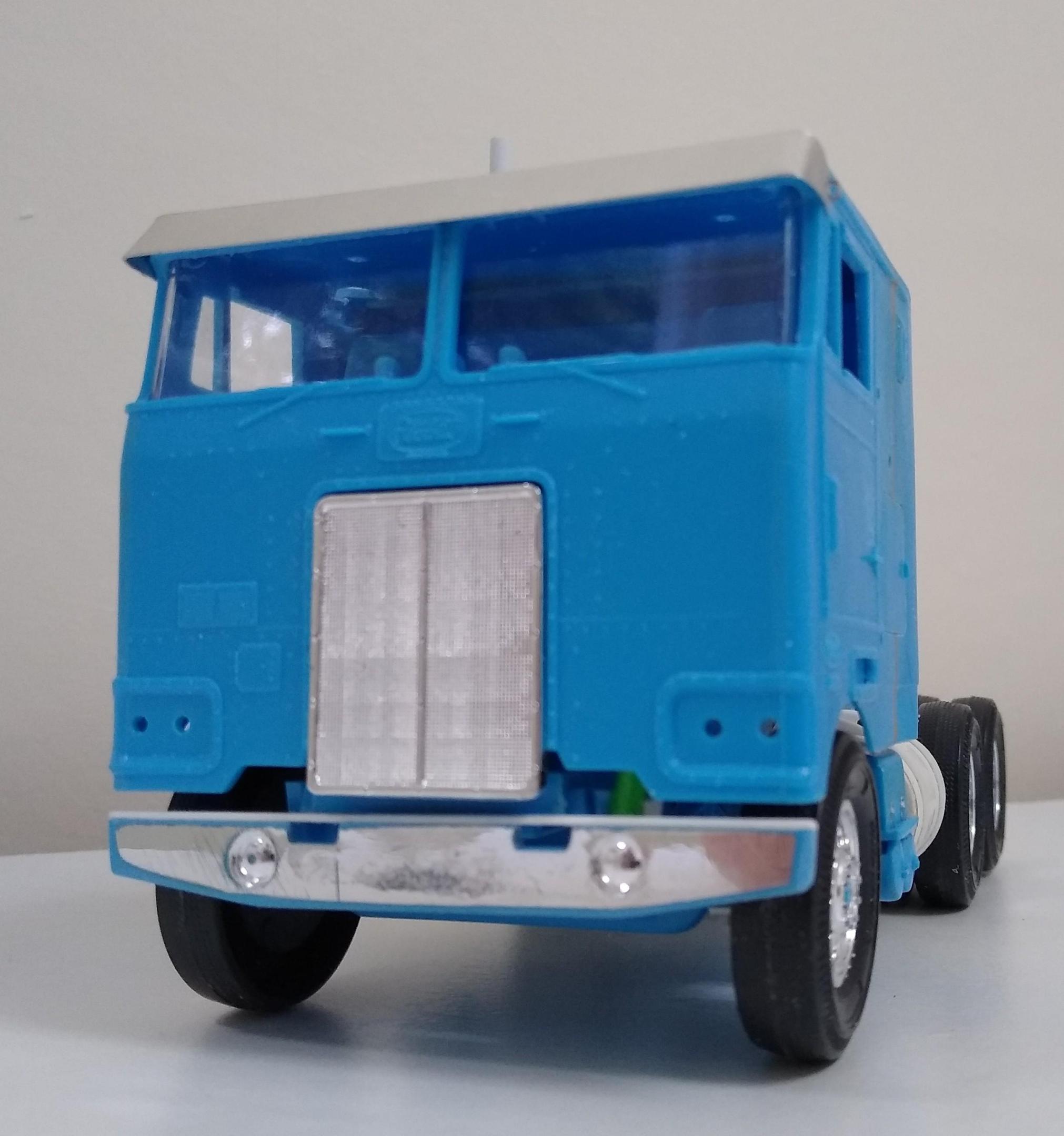

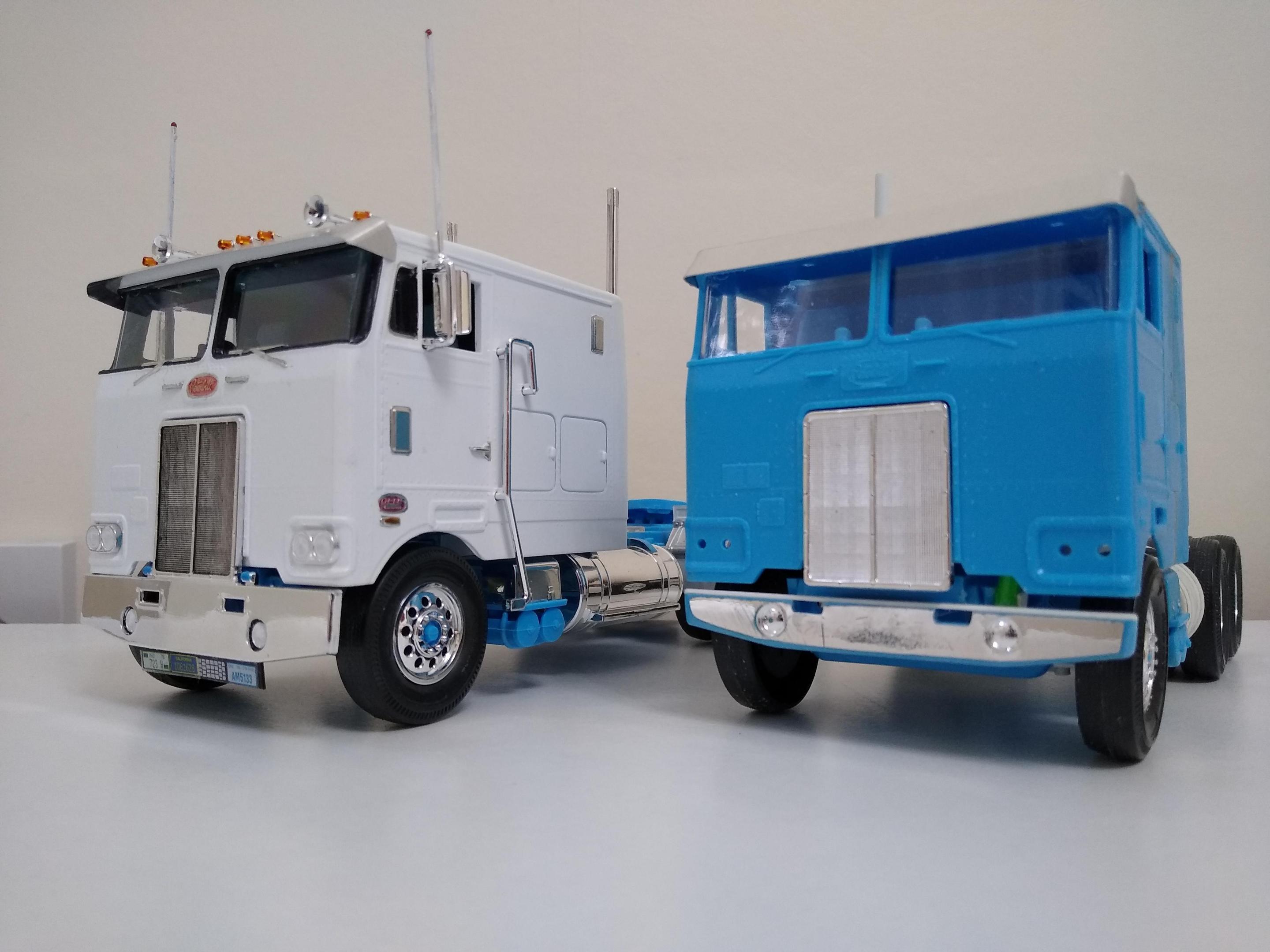

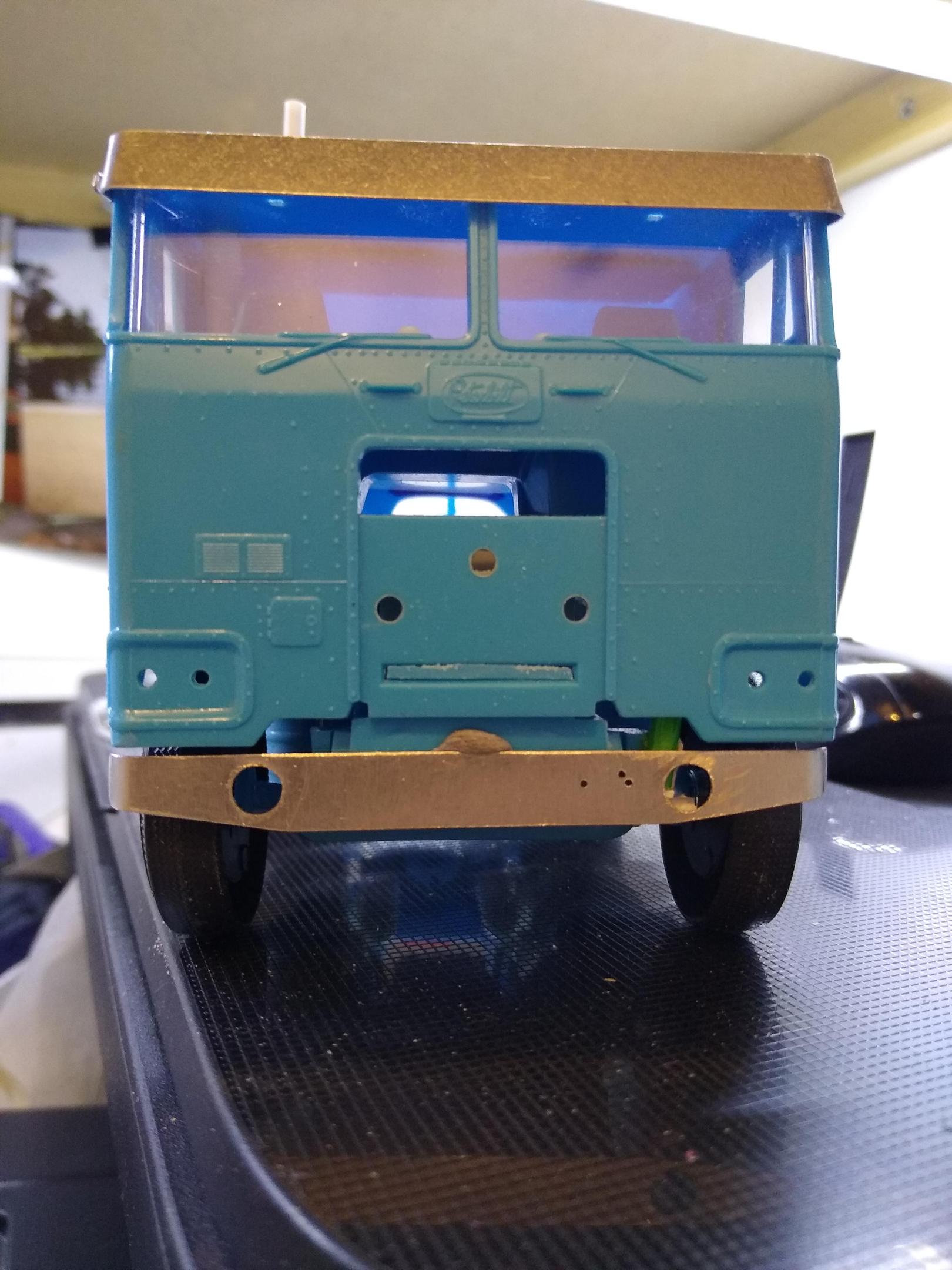

I got two bites at the cherry this week. Wanted to sort this bumper situation. I laminated three strips of plastic card together and let them set properly. Then I shaped the basic bumper but I was hesitant about drilling and shaping the tow lug cutouts because they're very close to the top of the bumper. So I made it 1mm smaller than required, filed two notches for the tow lug holes and then put strip of card across the top. Rounded all the corners off and it looks ok. Then I decided I wanted the spotlights too, so I took the kit bumper and cut to the top off, then let the tow lug holes in again and put a strip across the top. Rounded the edges again and I think this is the one I'll be using. It looks a lot better than the kit piece, but the kit piece looks ok on the double sleeper because that's a more showy truck I think. -

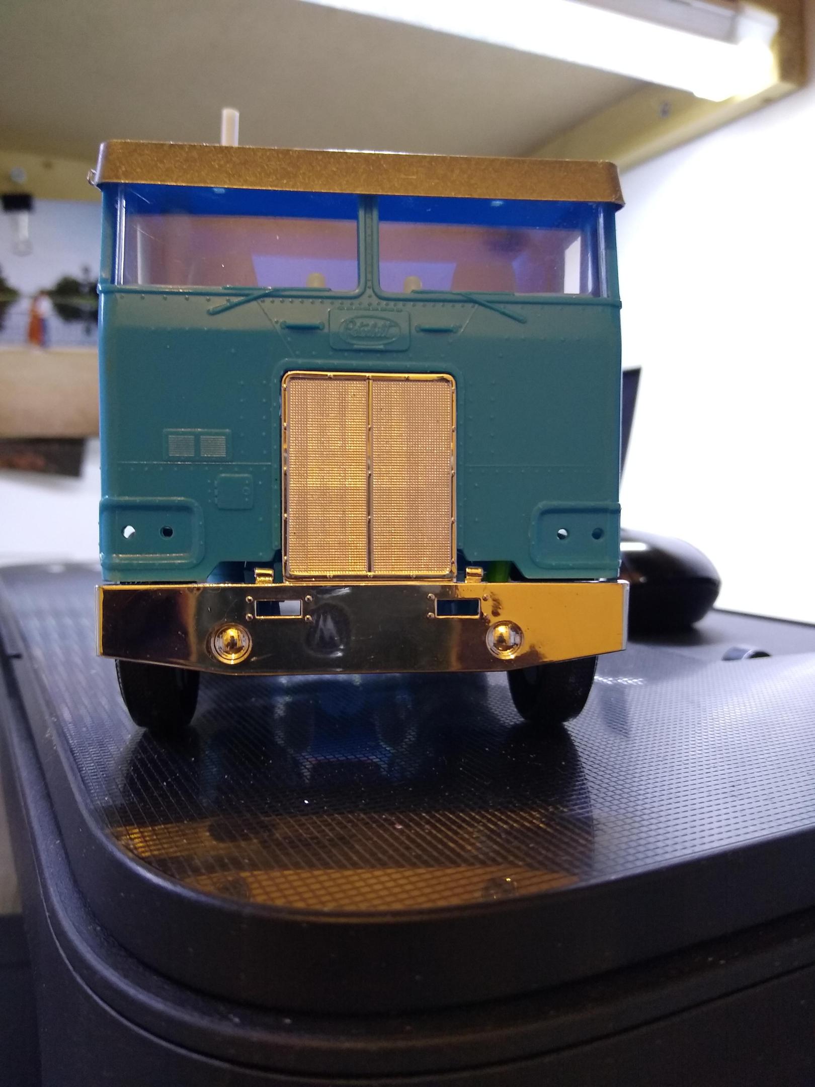

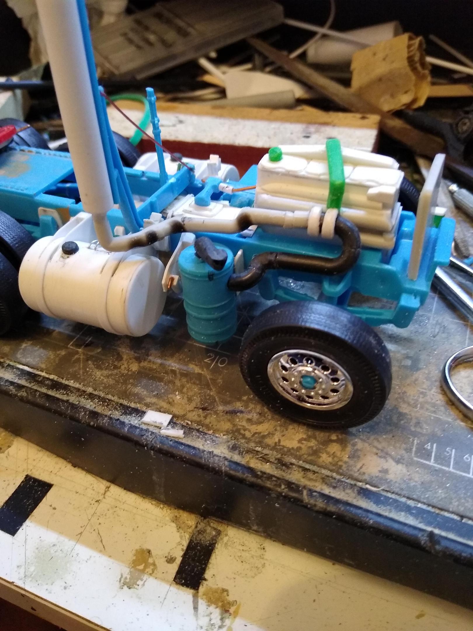

Made some front shocks and rear hubs for the Pete today. Ditched the chrome stack and made one out of hollow styrene tube. Was most pleased that my exhaust pipe from the turbo to the stack fitted. Not bad considering it's a piece of sprue bent using a candle! It's actually was less trouble than some kit pipes I've tried to fit in the past. Decided I really don't like the kit bumper. I would prefer the thinner version too so I marked one out on a sheet of aluminium. I used a Sharpie instead of engineers blue. Sadly my 5mm drill that I used to finish off the spotlight holes was as blunt as could be, leaving huge burrs on the holes and distorting the piece slightly. However, even in a slightly mangled state it looked better than the kit piece. I will try again but I may just use styrene sheet instead. The ali is too thin. -

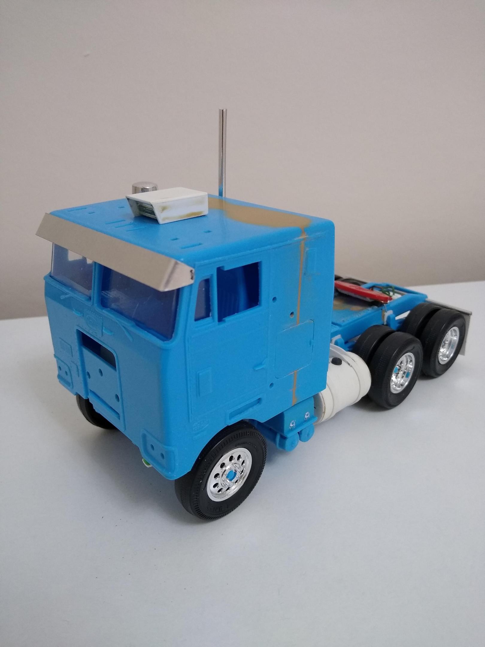

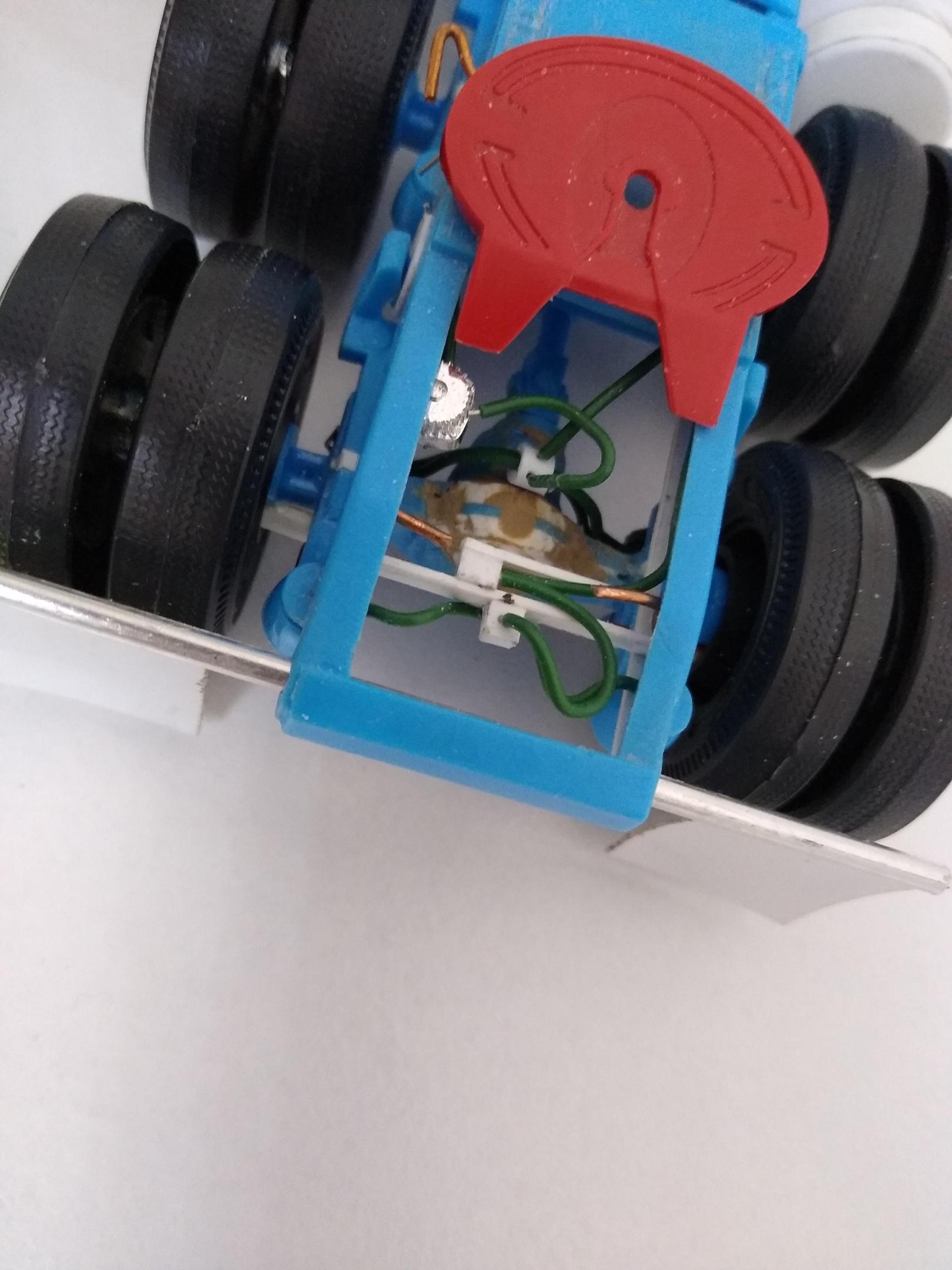

Nothing major today. Made a sun visor out of sheet aluminium. Dead easy really, just cut a strip from the sheet I have, bent it over the cab roof, then positioned it where I wanted and tapered the ends to suit. Drilled two holes either side and will locate it with cutoff straight pins so they'll look like rivets. I've just wired it on for now. Decided to add an aircon condenser box on the roof. Just square rod and card. Found a custom chrome inlet manifold off the Mercury Park Lane kit that cut down to a decent grille. I'll add a strip of plastic to mimic the conduit for the AC lines down the back of the cab. Piped up my brake chambers, running from the relay valve to the quick release valve and the feed to the spring brake chambers. Oh, added fuel lines to the tanks. -

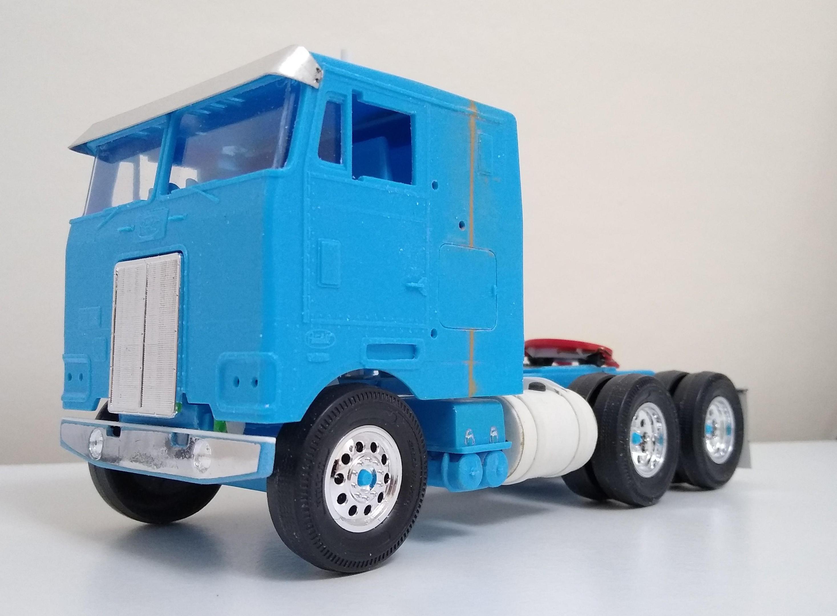

Spent a couple of happy hours on the Pete today. Fitted my brake chambers but I'll have to let them set properly before I start plumbing them in. I drilled my fuel tanks for the fuel lines and added filler necks made from good old chubby sprue. The gearshift linkage looked exactly what it was, some copper wire in a hole. So I took some 2mm hollow tube and cut down into it using a knife edged file, then rounded the edges off and cut it off the piece to represent one yoke of a UJ. Did another three, slipped them onto the copper wire and the result is fairly good. I wanted to do the air intake going through the cab on this truck rather than the snorkel up the back of the cab that comes with the kit. I drilled a 0.9mm pilot hole and worked up to 5mm. I followed on through the cab interior and doghouse. At the top I put a piece of 6mm over the 5mm and tapered it down at the bottom, than added the breather cover from the AMT K100 Aerodyne. Looks right to me but I think my first attempt was too long.
