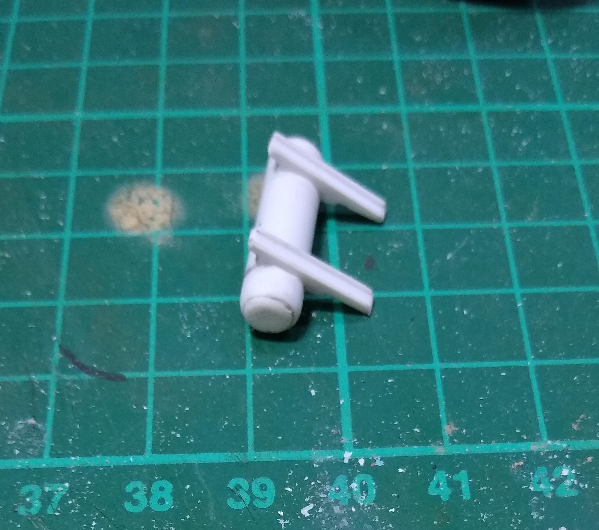

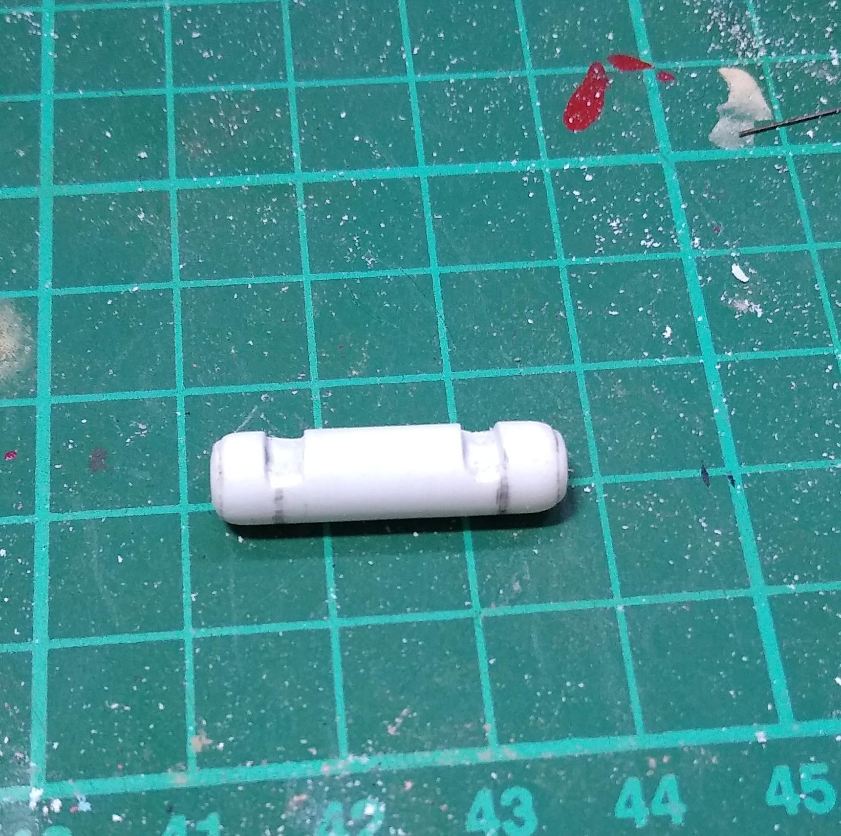

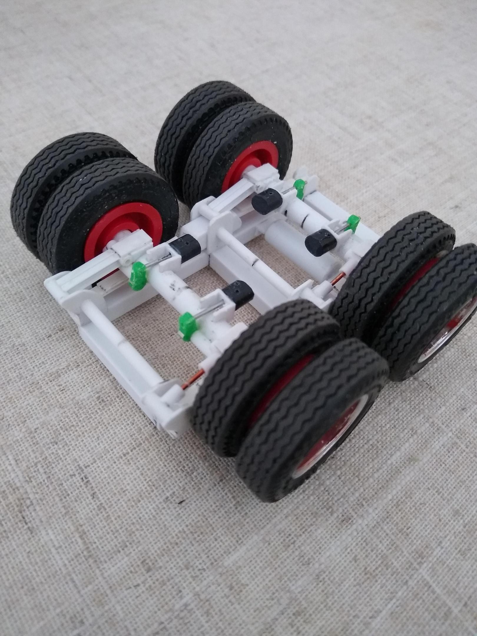

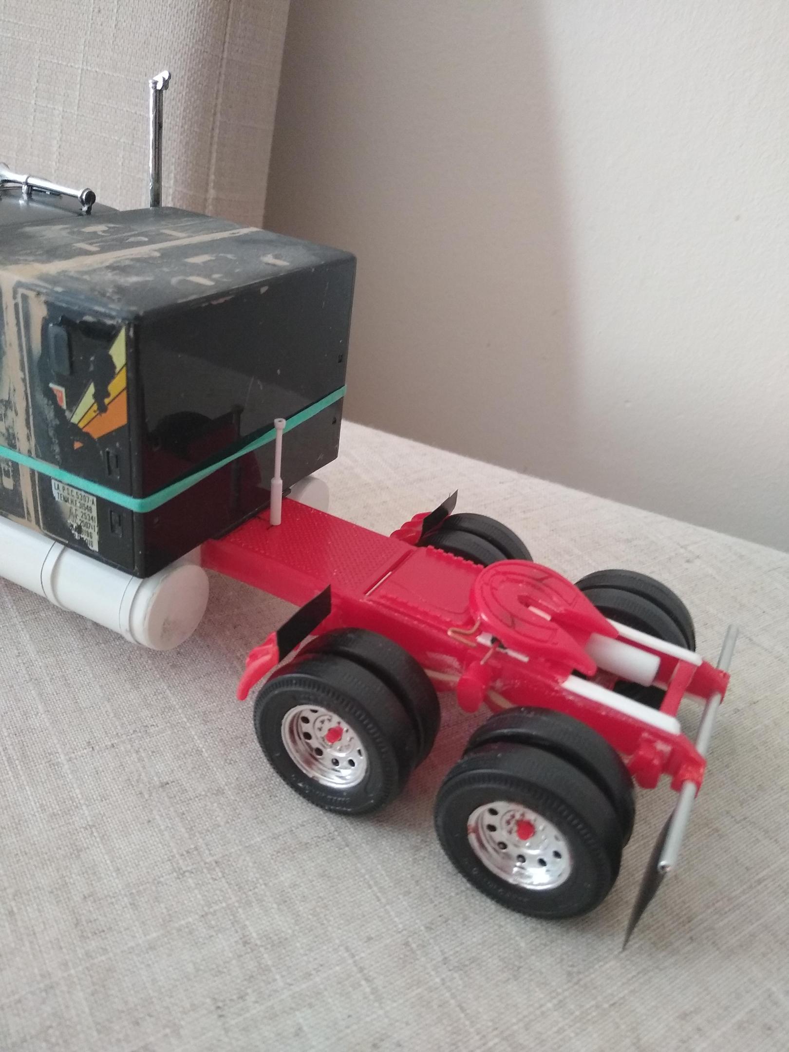

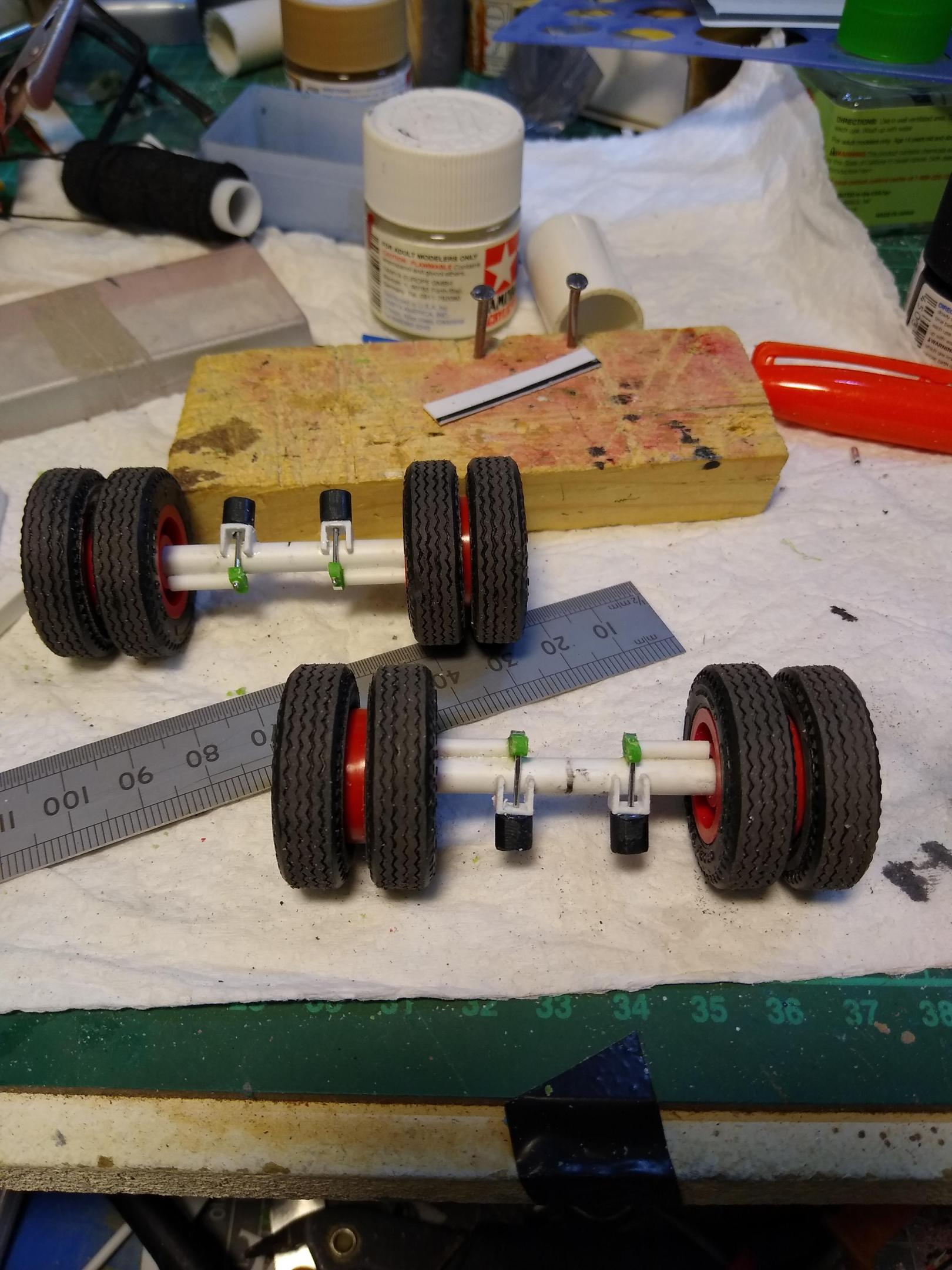

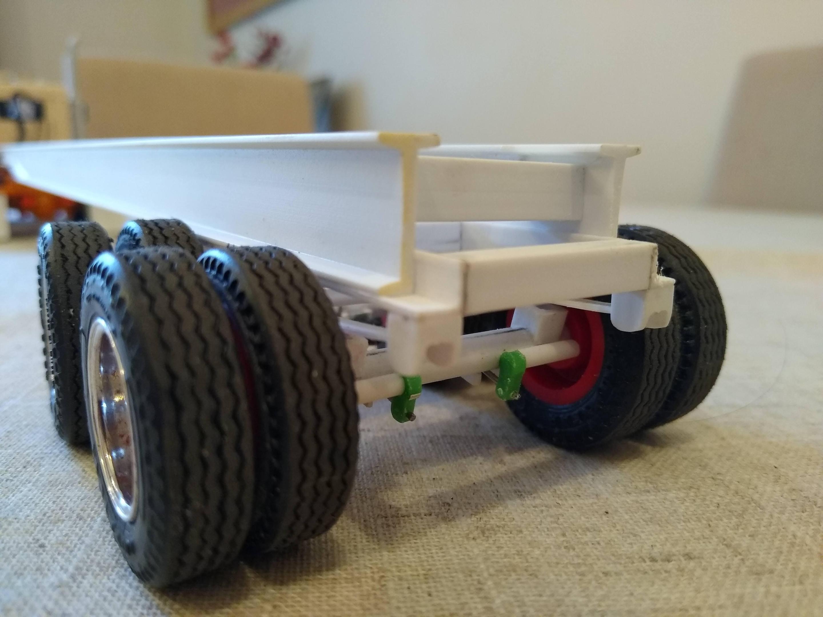

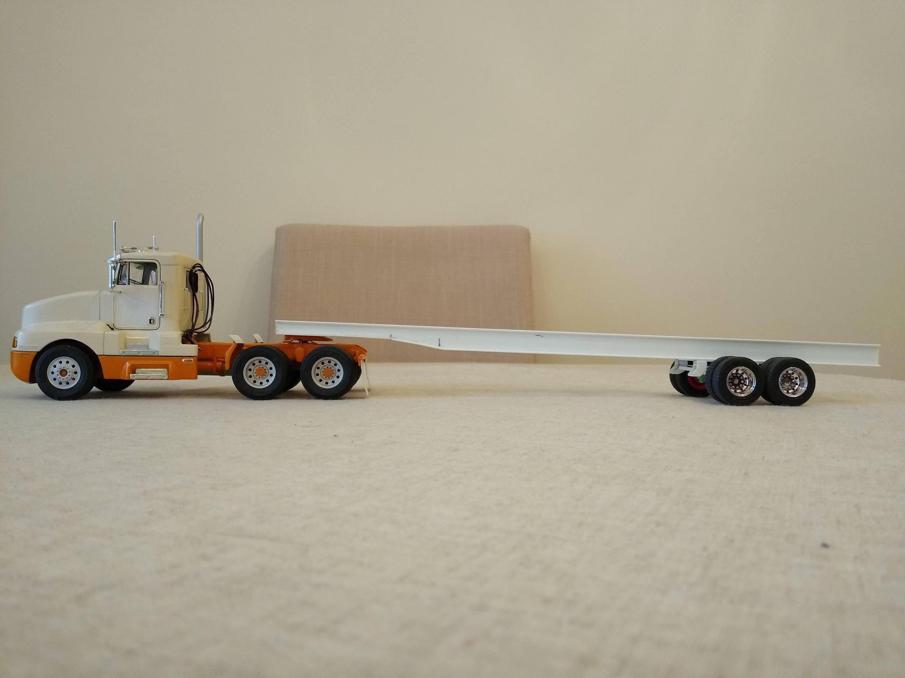

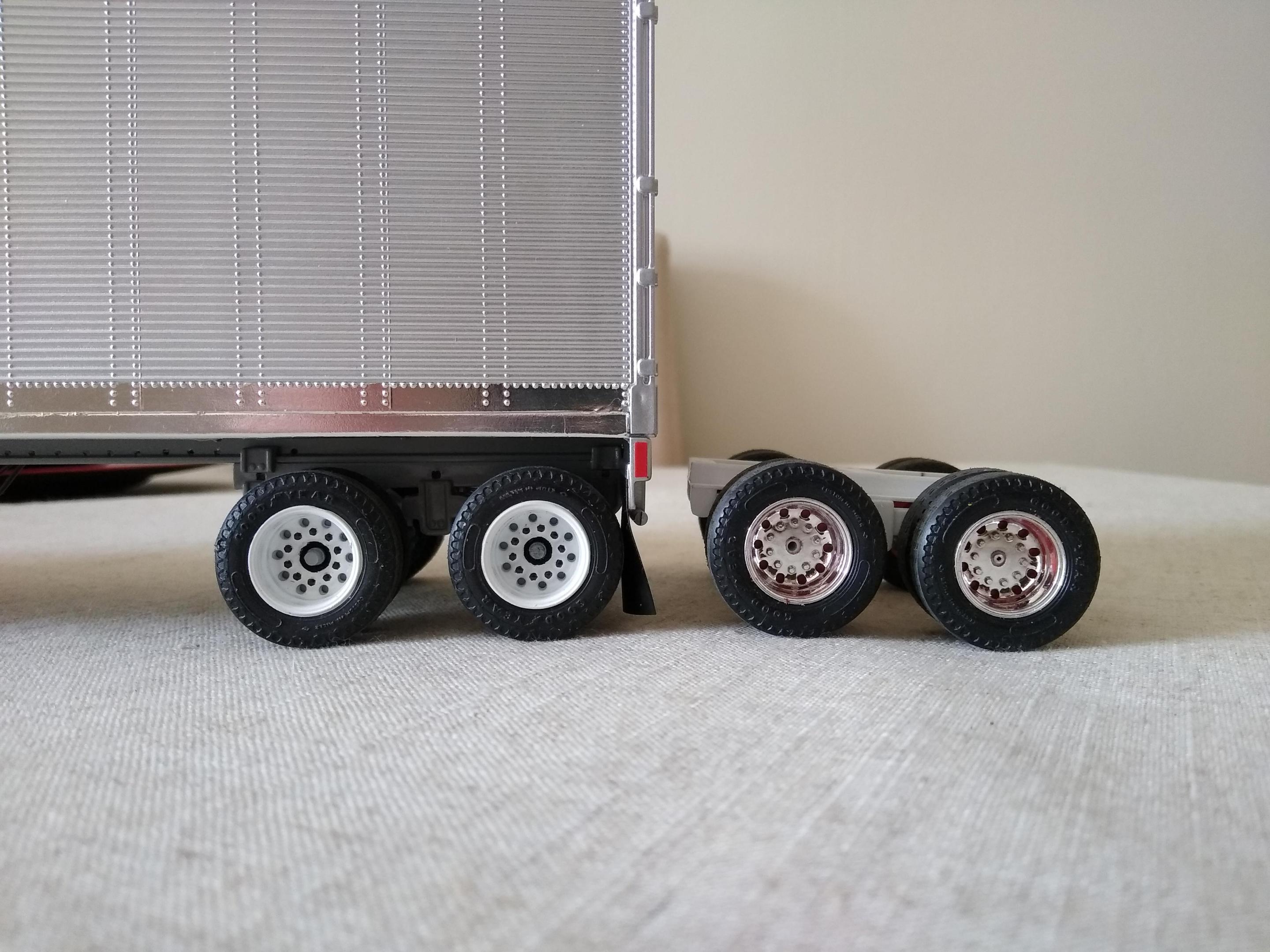

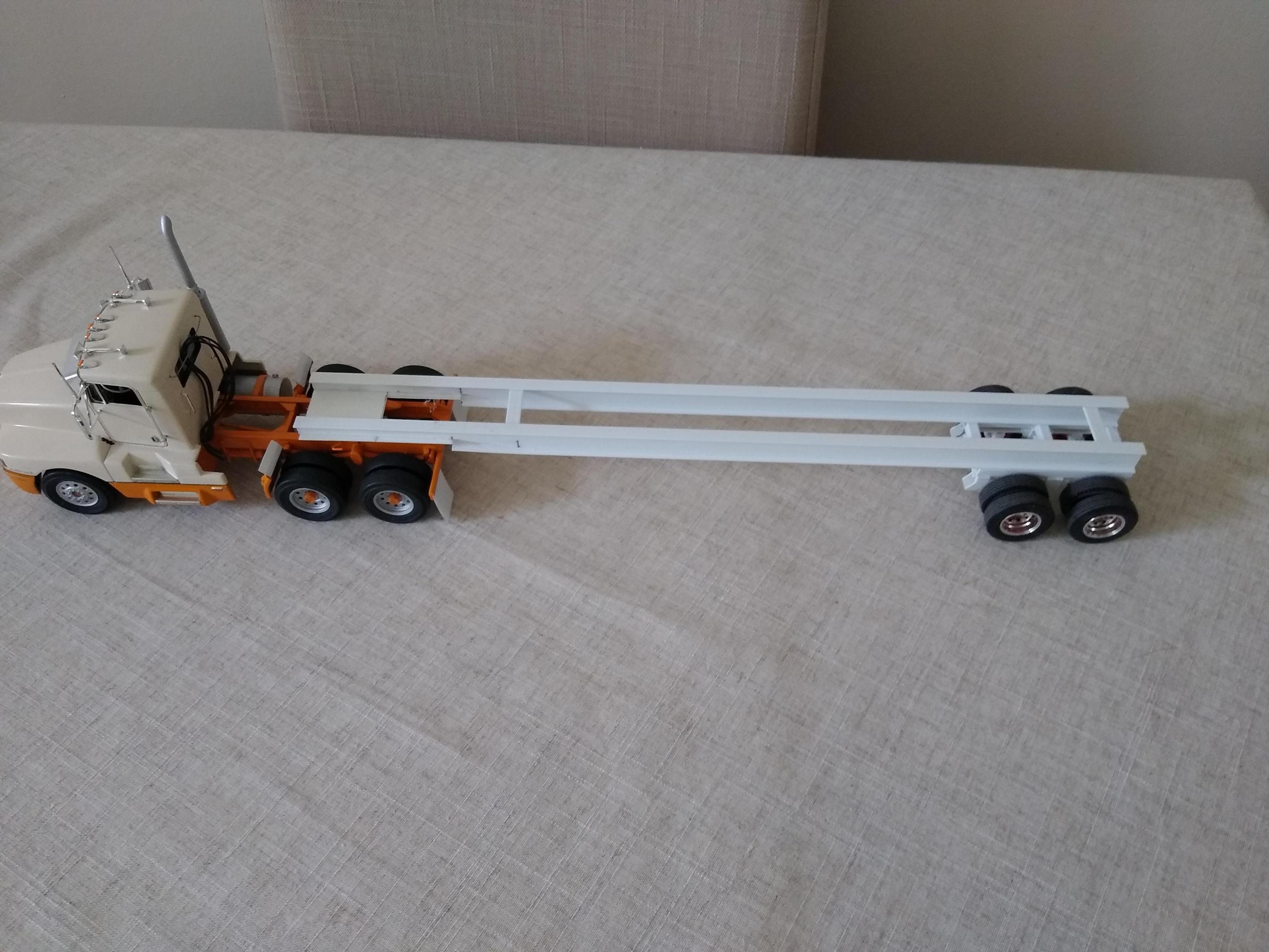

Finished building the tandems, added the air tank and track rods, on the track rods there's an adjustable one and a fixed one on each axle. To me it looks an utter shambles but it's the best my fat hands and middle aged eyesight can do. I can't seem to cut or file anything straight! Fitted the axles which was a bit scary because I wanted to rectify something that taints the Trailmobile van trailer for me. Because the wheels and tyres are smaller than scale, they look too far apart at the scale axle spacing so I wanted to bring them closer together. The AMT spacing is 8mm at the tyre tread; I settled on just under 6mm for the right look. Seems to have worked when you put them side by side. Fabbed landing gear using the 'extended' legs from the Monogram Fruehauf van. By using hollow square tube I can make them operate too. Still to do the reduction gearbox and winding handle. -

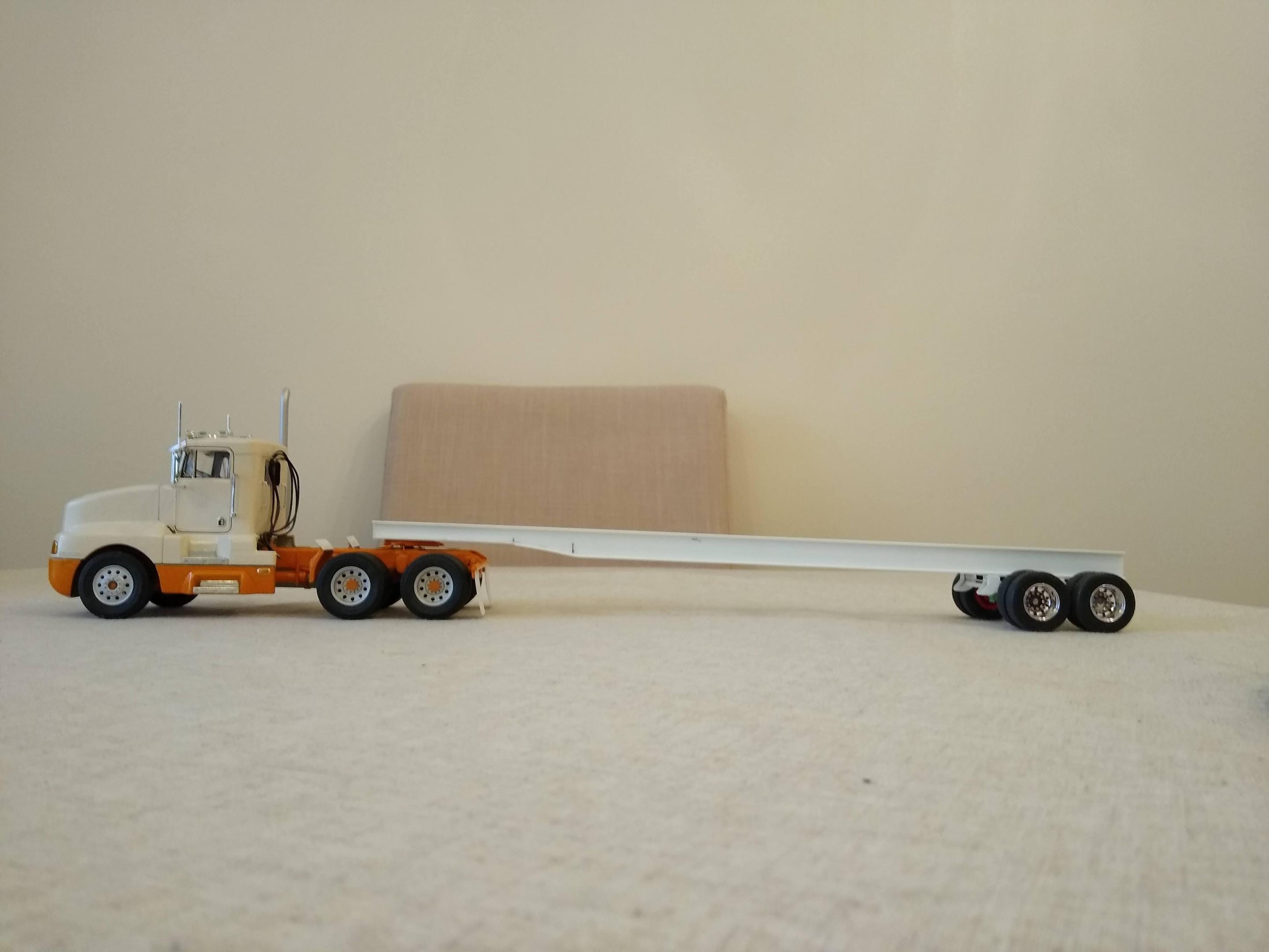

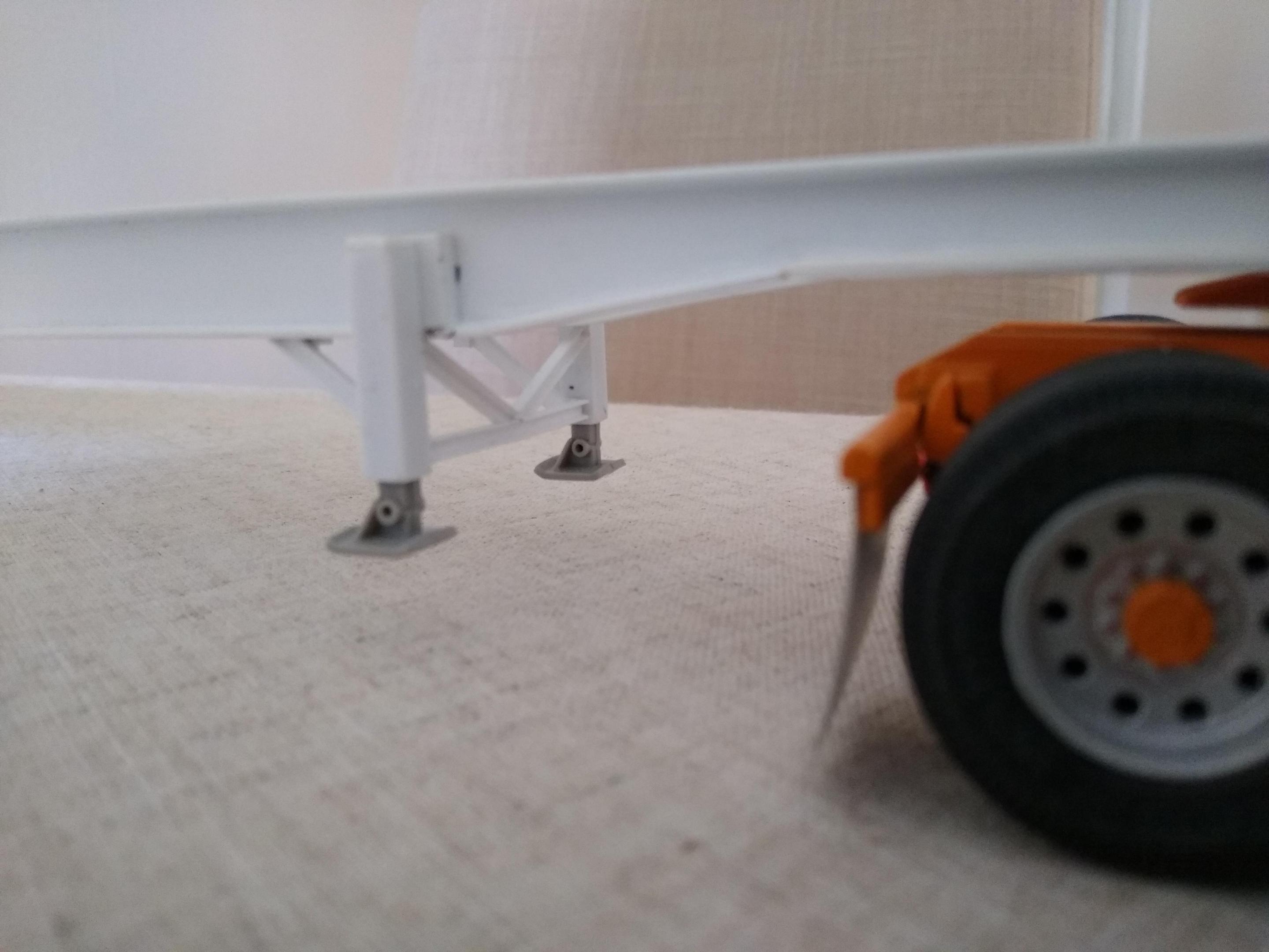

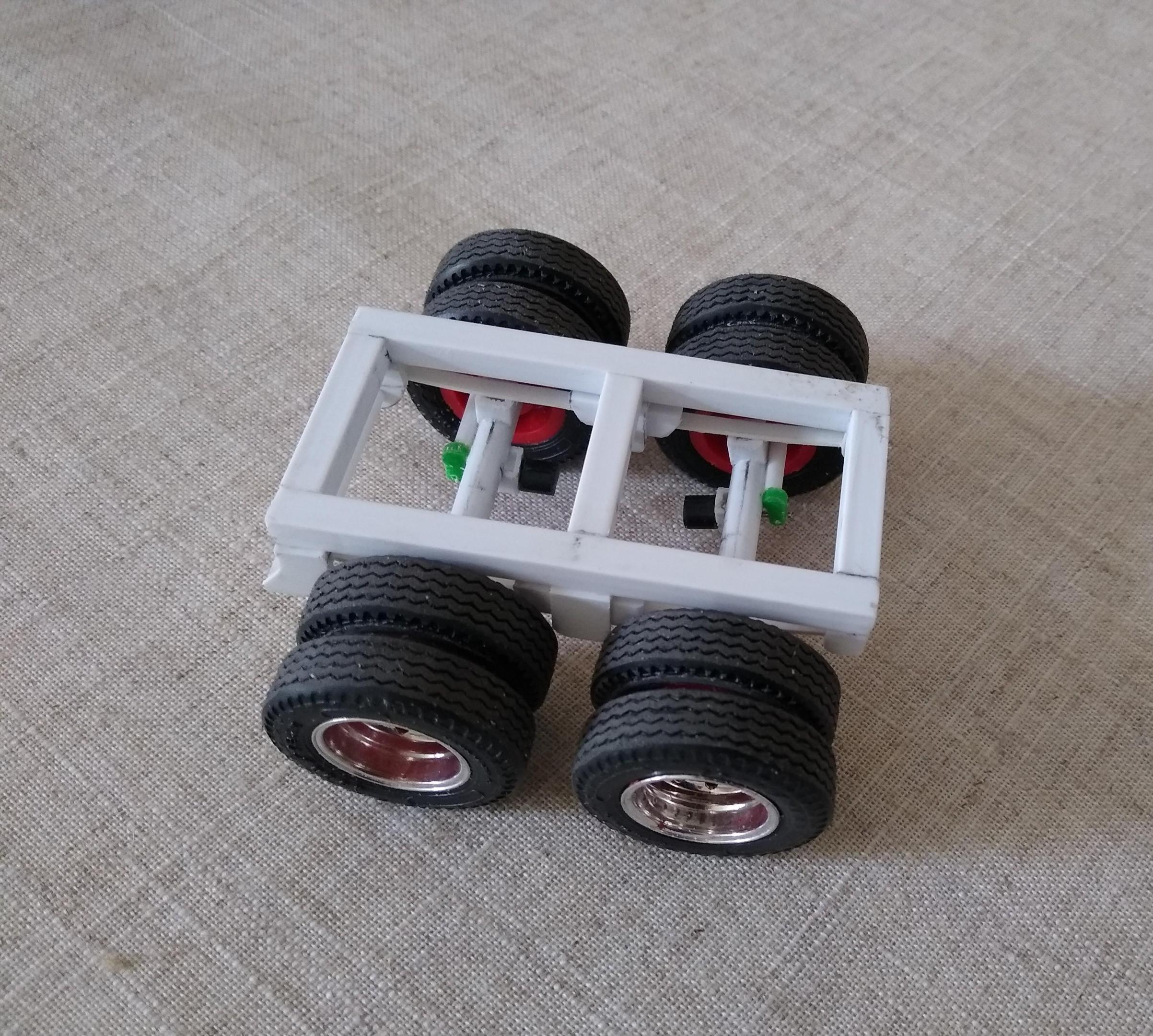

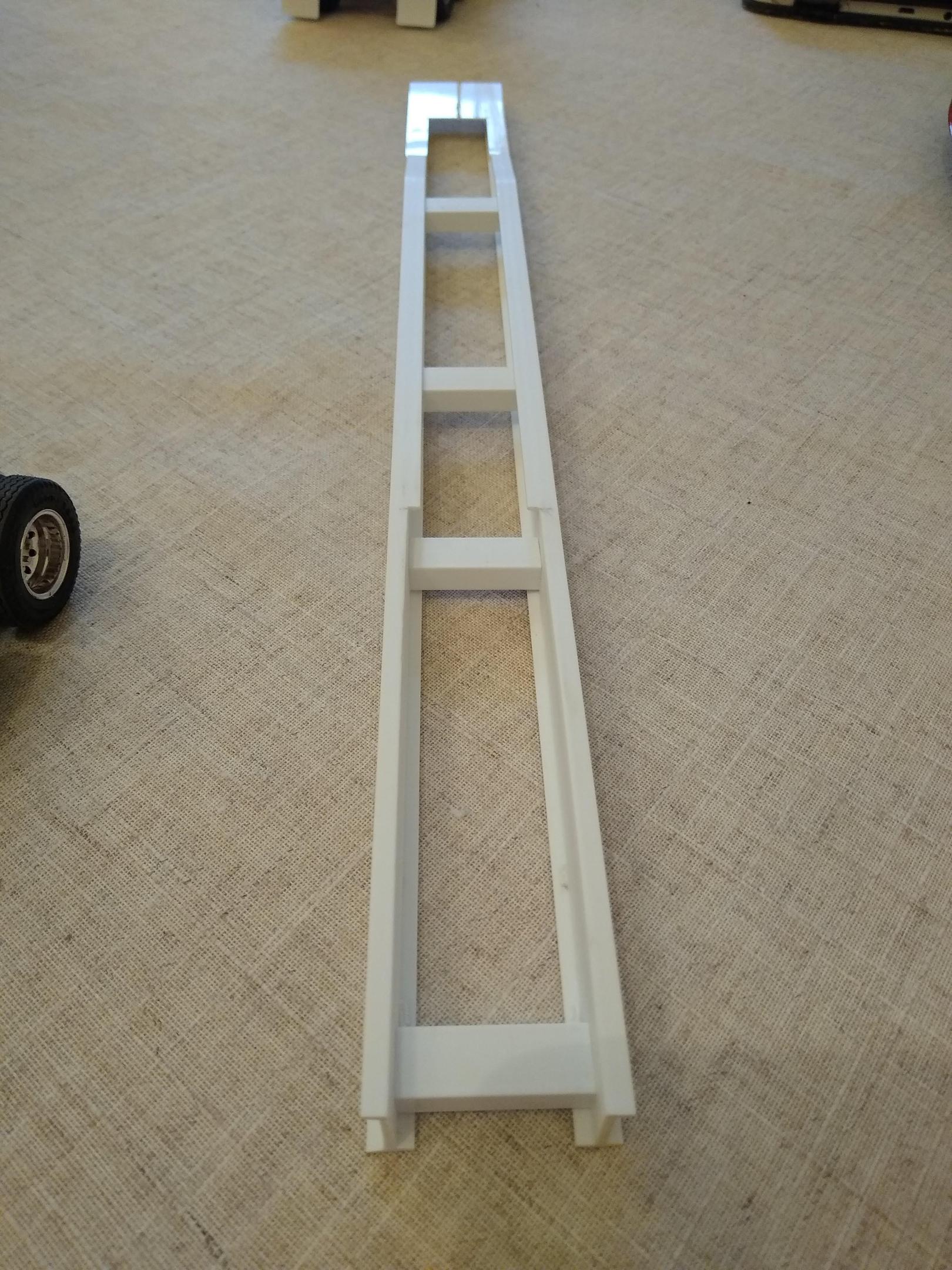

Thanks for the kind comments gents, but as usual with me it's one step forwards two steps back. The ride height was far too high so I took a few measurements and found I could drop the subframe between the main rails, as I've seen on some trailers. I cut the siderails of the subframe into L shape rather than a box section, then I cut out the inner flange of the main rails so the tandems can sit inside. Drops the suspension by 4mm but makes a big difference! I was terrified I'd ruin it but all went perfectly! I canstill slide the tandems, but I won't because I love the "bridge law" stance. -

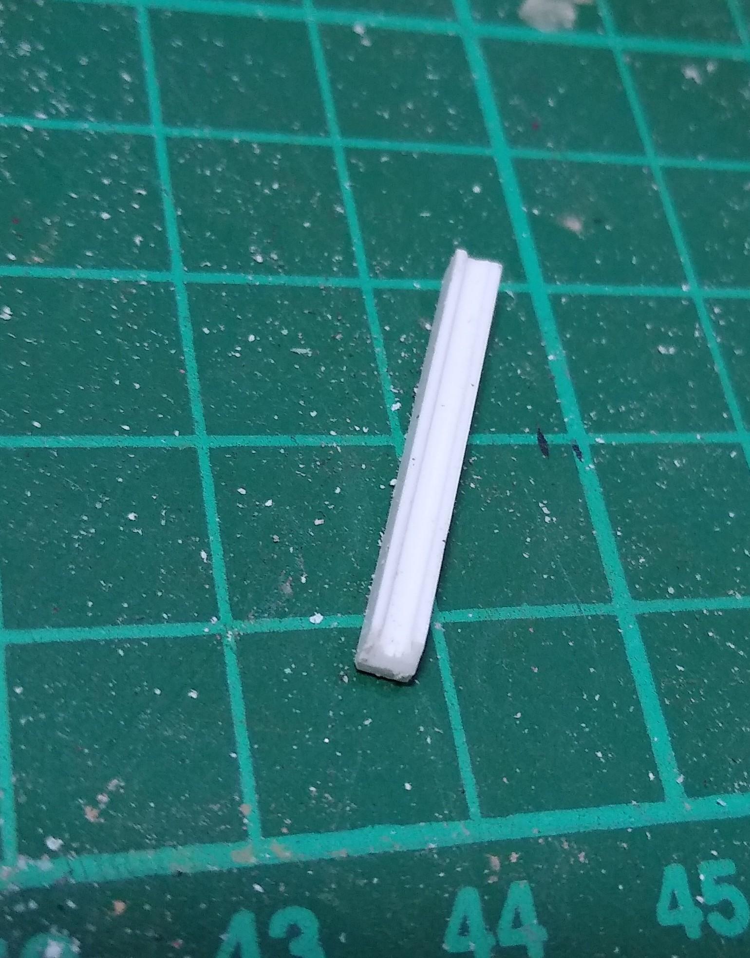

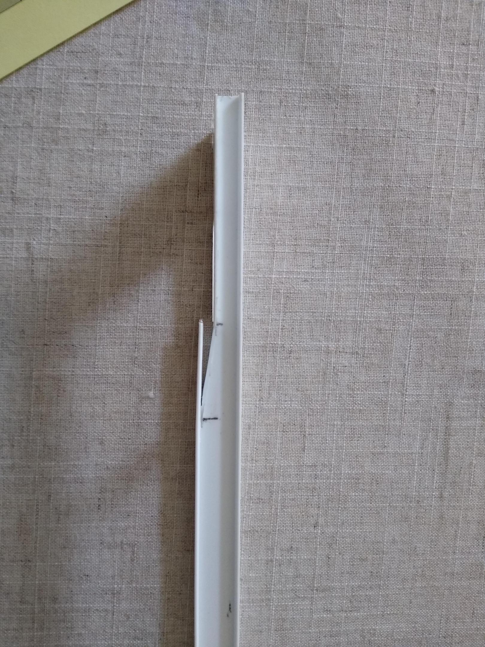

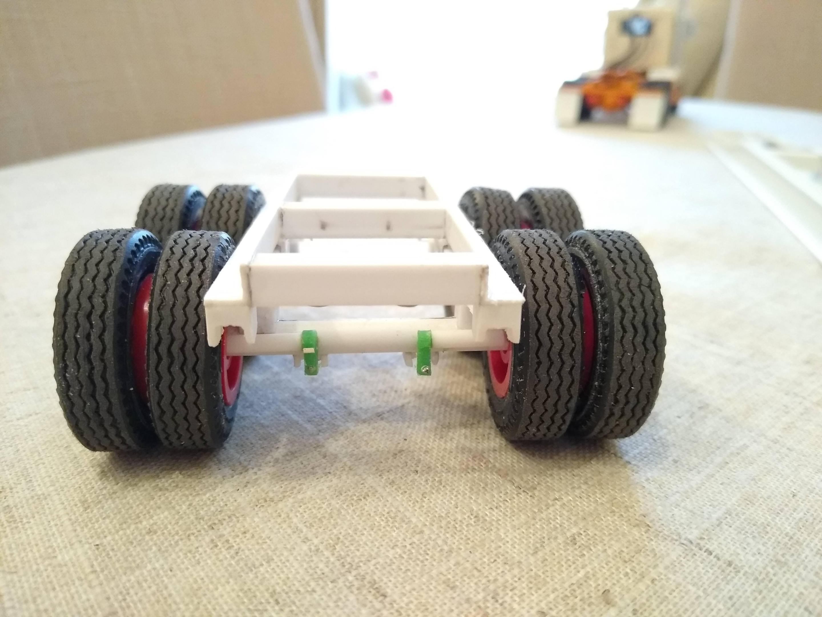

I've wanted a flatbed for my 1/32 fleet for a long time but the only trailers available are vans, reefers and the tanker. I suppose I could look for a diecast I could modify but I couldn't see anything suitable so, after seeing the work done on here I decided to build my own. I really shouldn't, I've got four jobs on the go already. I bought various channels and profiles along with two 14mm I-beams for the main structure. I built a subframe for the steel suspension fashioned after a Trailmobile unit. I fabbed balance beams and spring mounts. Built two axles with brake chambers and slack adjusters. I'll use AMT wheels and tyres from a scrap K100 Aerodyne. I still have to build the track arms that locate the axles. I was going to taper the frame at either end but decided to go for just the neck at the front with the full depth running the rest of the length because I hope to be able to have the suspension sliding. A very rough mock up looks ok.

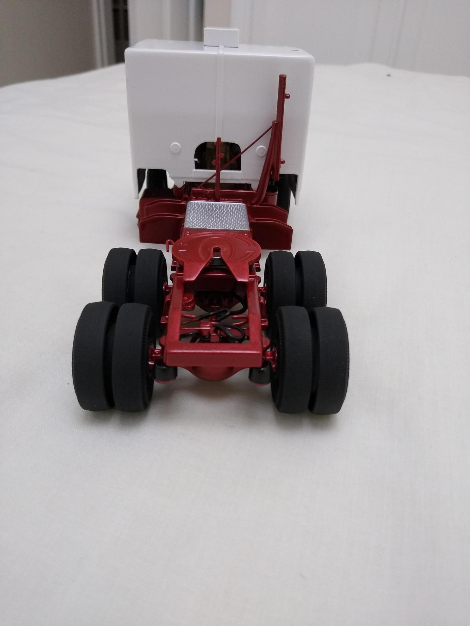

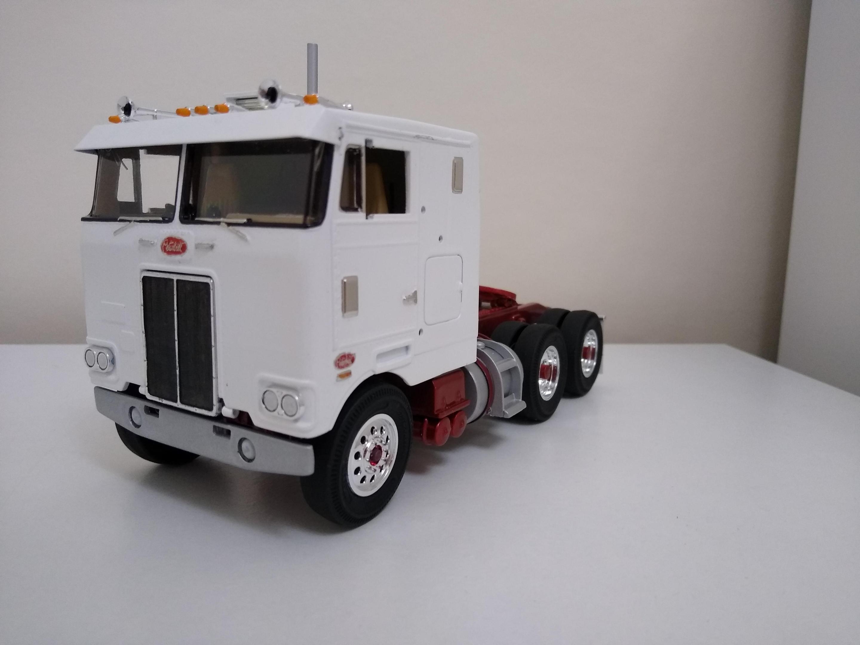

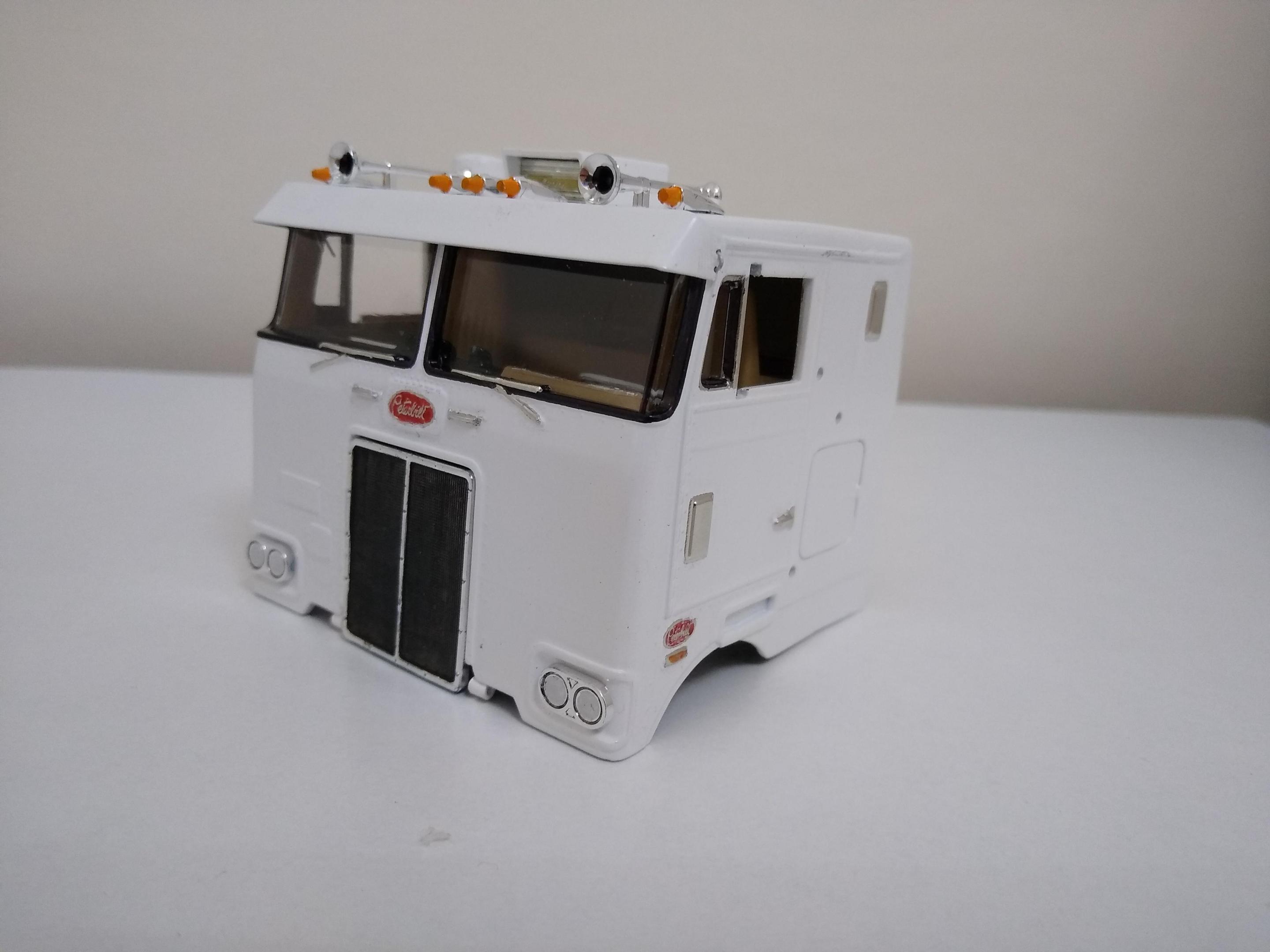

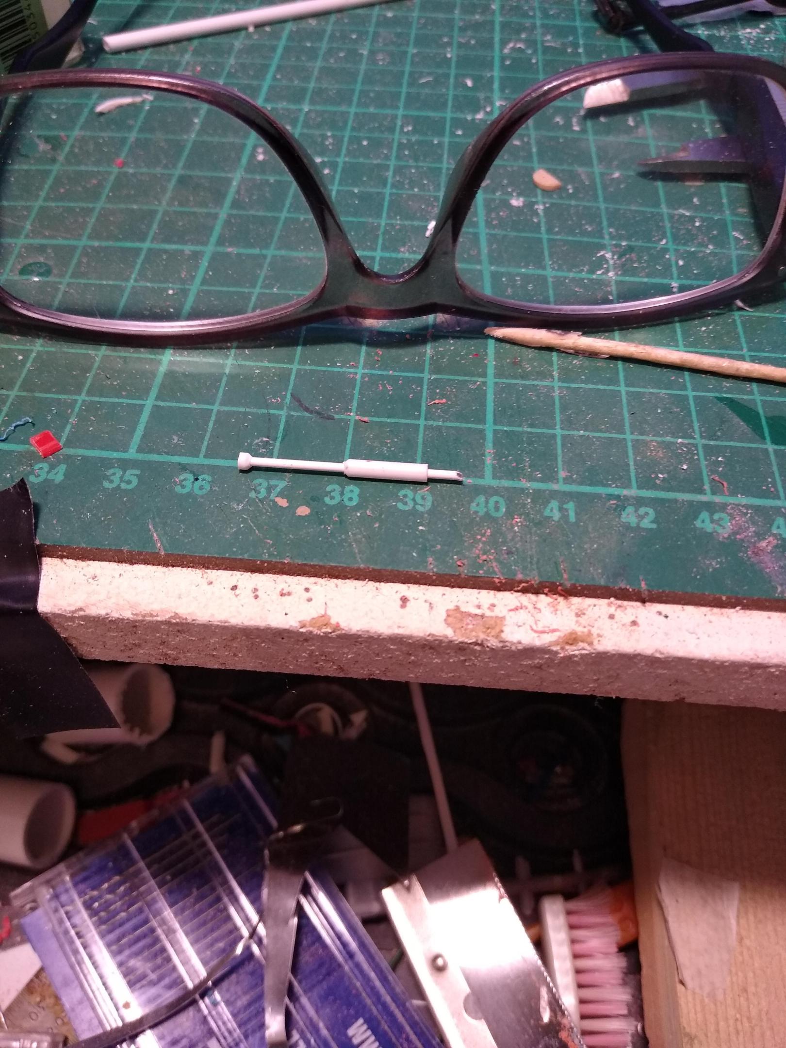

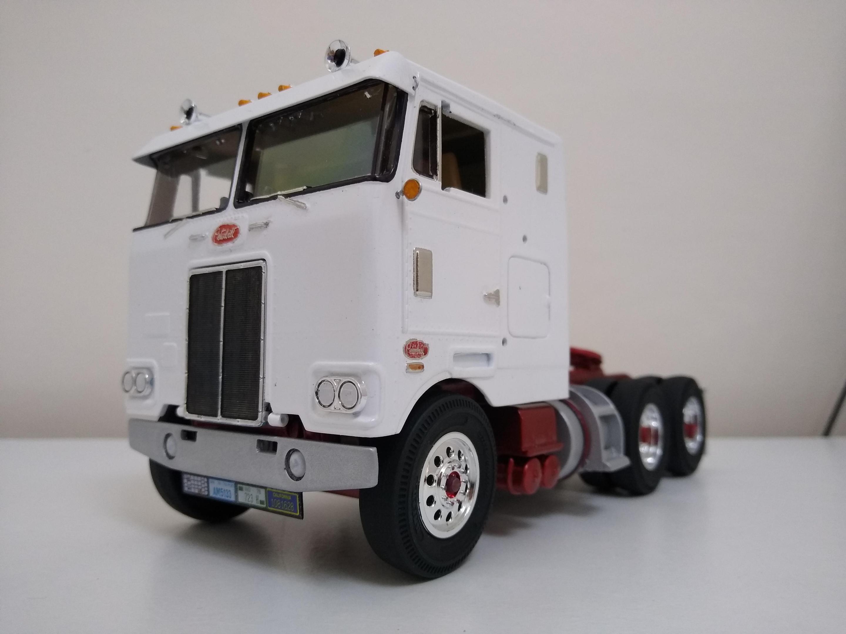

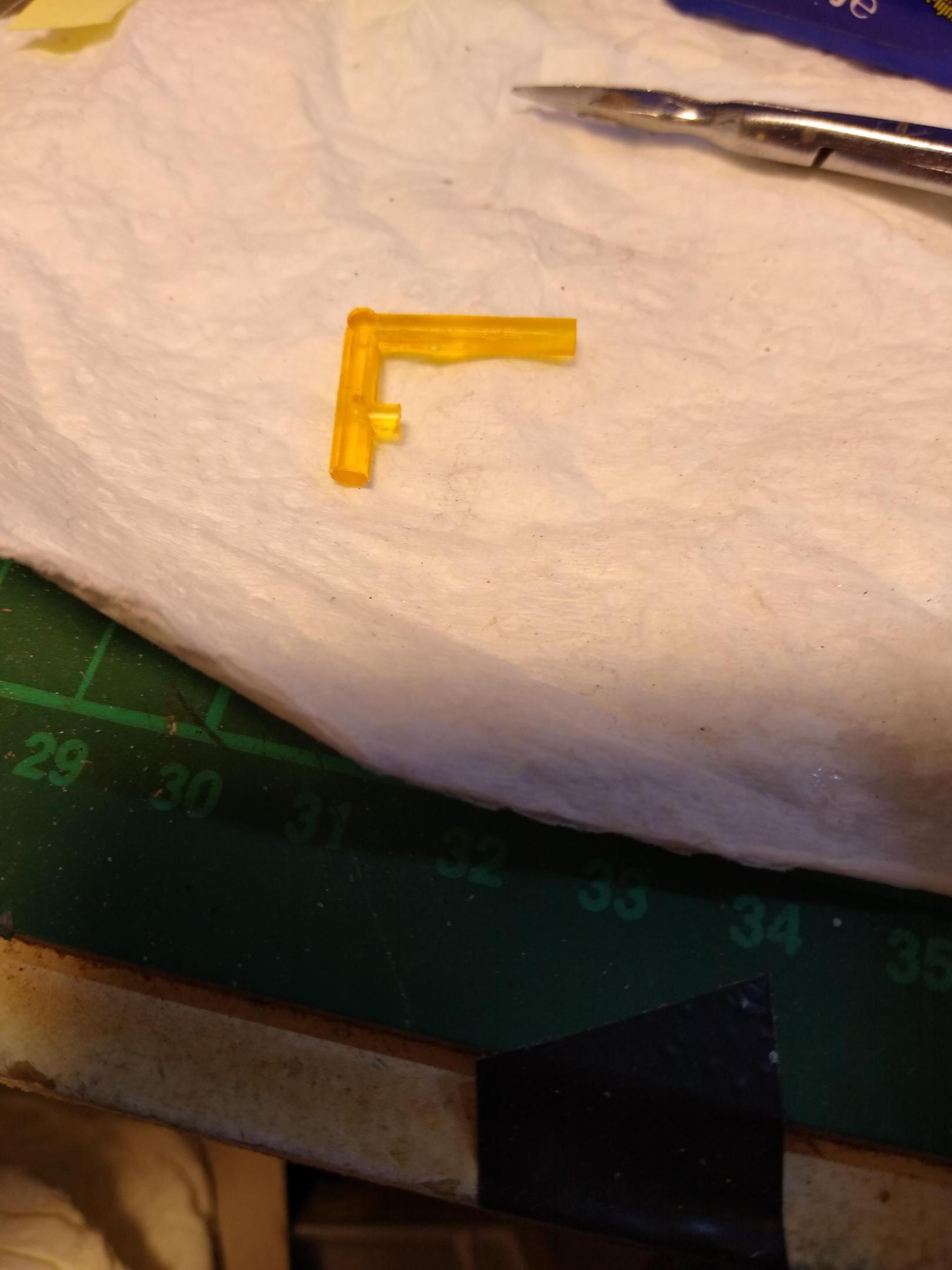

Fitted the rear shocks today, took me an hour and only I can see them!!! Why do we do it? Also fitted my air hoses around the pogo stick, front licence plates from the kit on a board under the front bumper. One thing I have wanted to do is add the round flashers on the front of the cab. I am very aware that at 1/32 scale they'd be so fragile someone would only have to cough and they'd fall off. So, I had to be resourceful. I snipped off a piece of amber sprue from an AMT 1/25 kit and filed an annular groove in it. Then, I put a piece of wire in the groove and wound it tight forming a pigtail. I cut and filed the sprue until it was a thin disc bound by the wire. A little Tamiya clear orange to deepen the colour, drilled a hole in the cab and wound the pigtail into the hole. I now have more realistic, translucent and tough lamps. Much better than the ones the kit tacks onto the mirror brackets. I'm very pleased. I'm now trying to draw up my Winslow stripes on Inkscape which was recommended to me by Peteski, thanks mate. In typical make style I faffed around with it for four days fruitlessly before deciding to read the manual and knocking out a simple pattern in half an hour! Long away from a set of cab stripes but it's very interesting. -

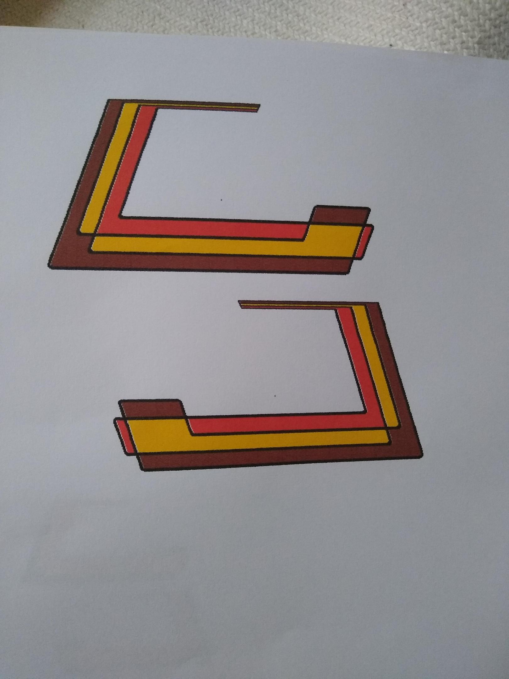

I've just been playing around with the "Winslow" stripes for my Pete 352 cabover. I've just been using old Microsoft Paint, not 3D, just the original Paint. The results are ok but they're a bit pixelated due to the nature of the program. Does anyone know of any "drawing" programs I could download on Windows 10 that would give a sharper image with better colour choices? I want to do basic stripes but anything with a curve or a slant ends up being stepped with Paint.

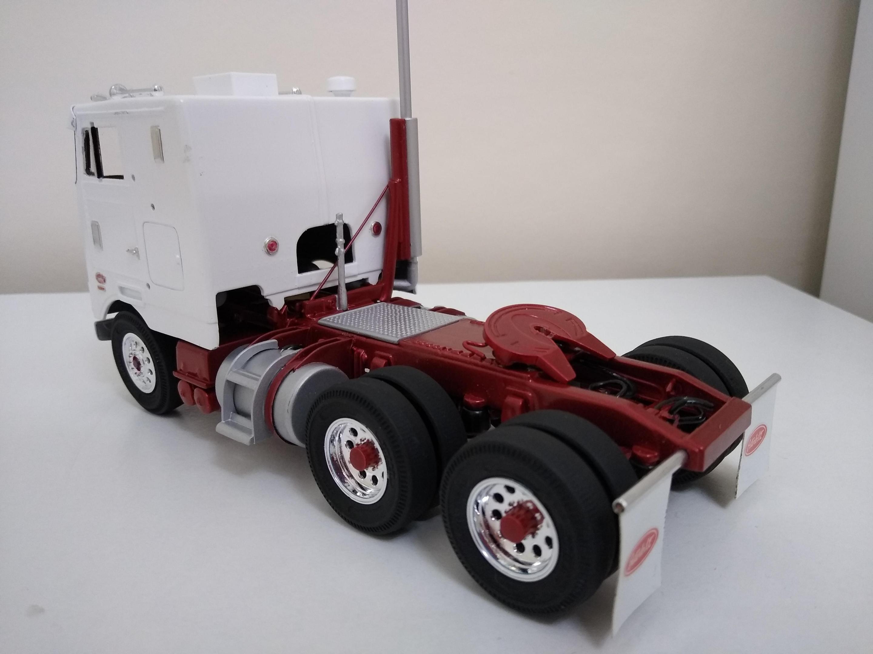

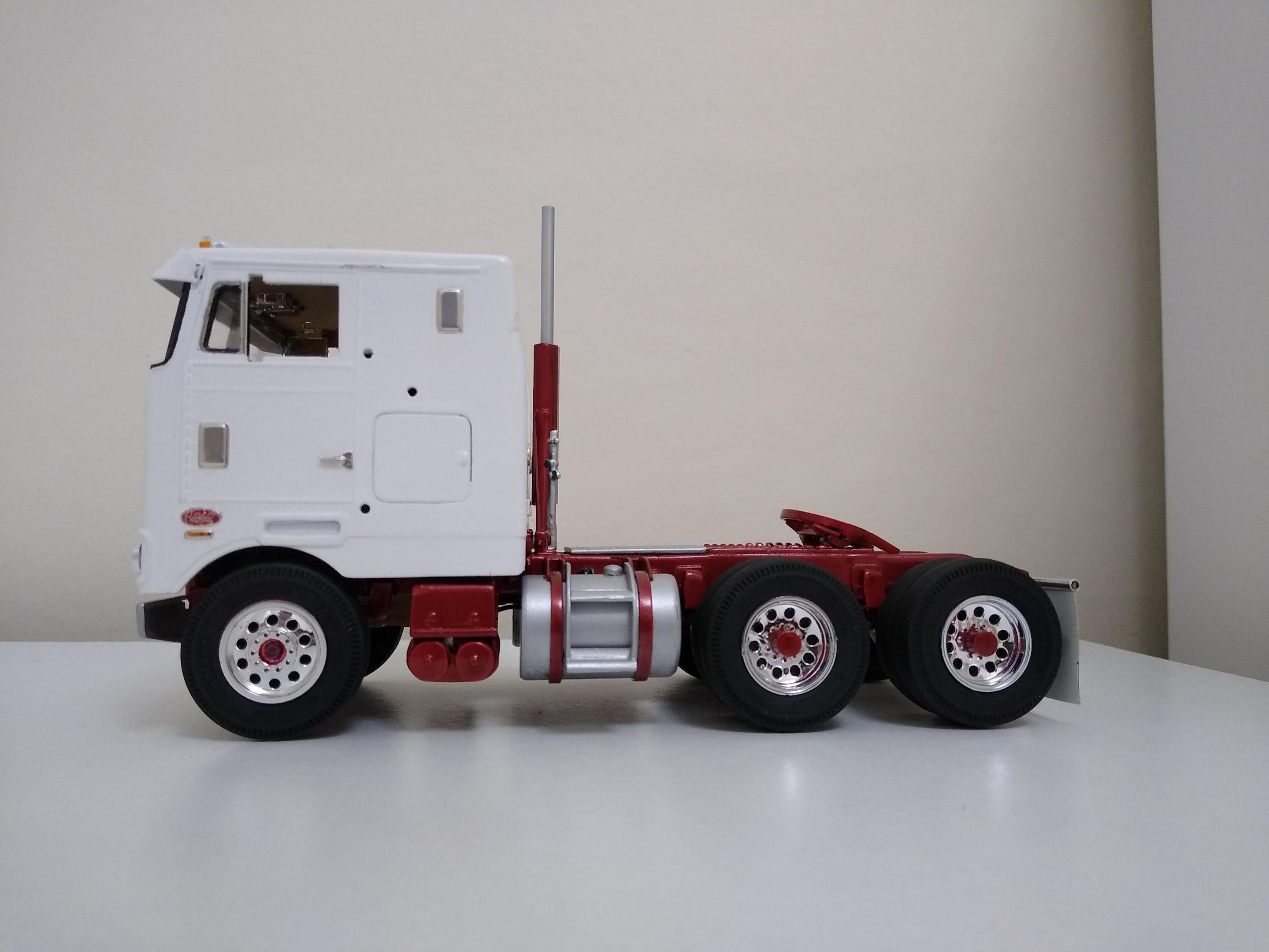

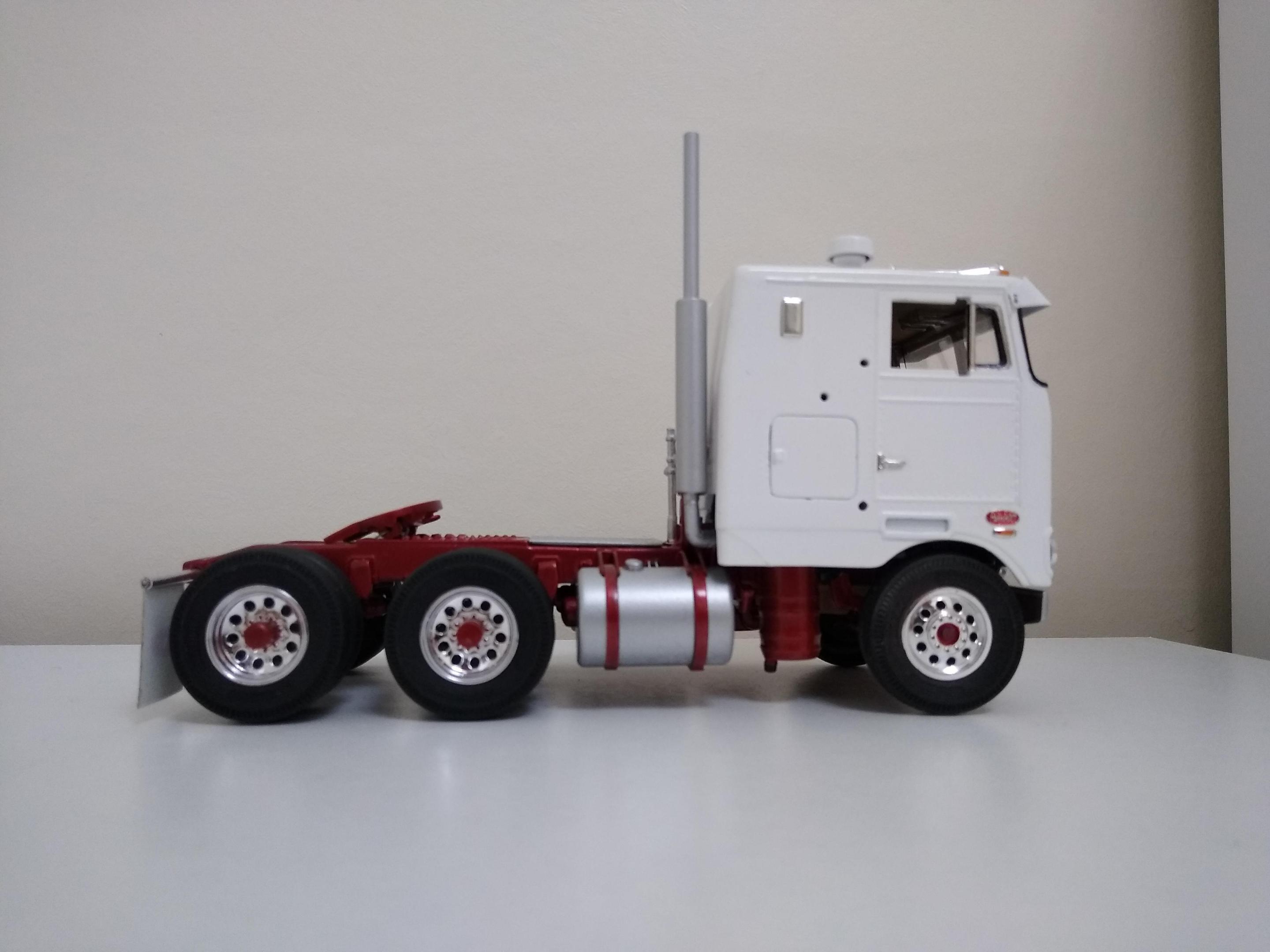

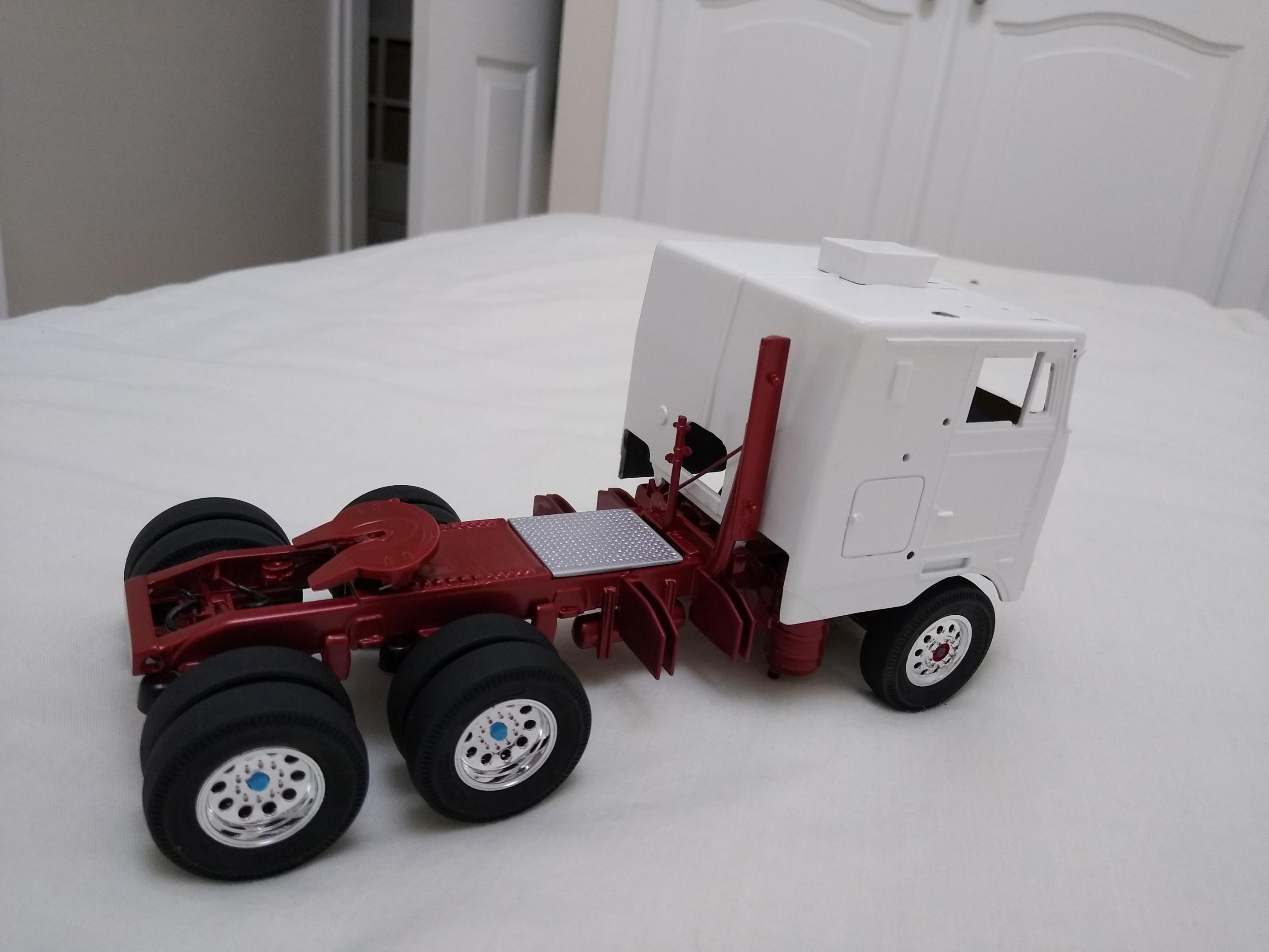

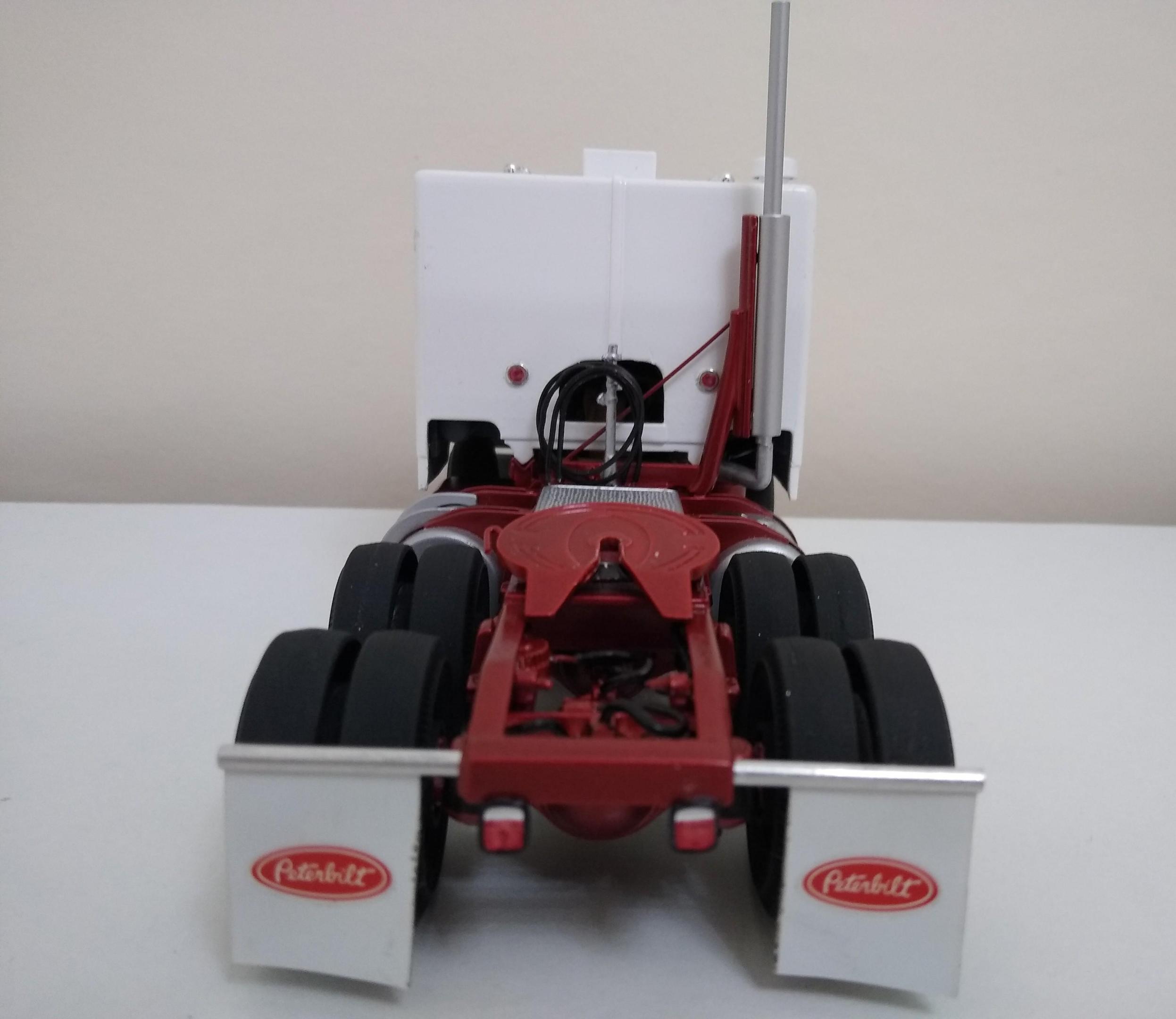

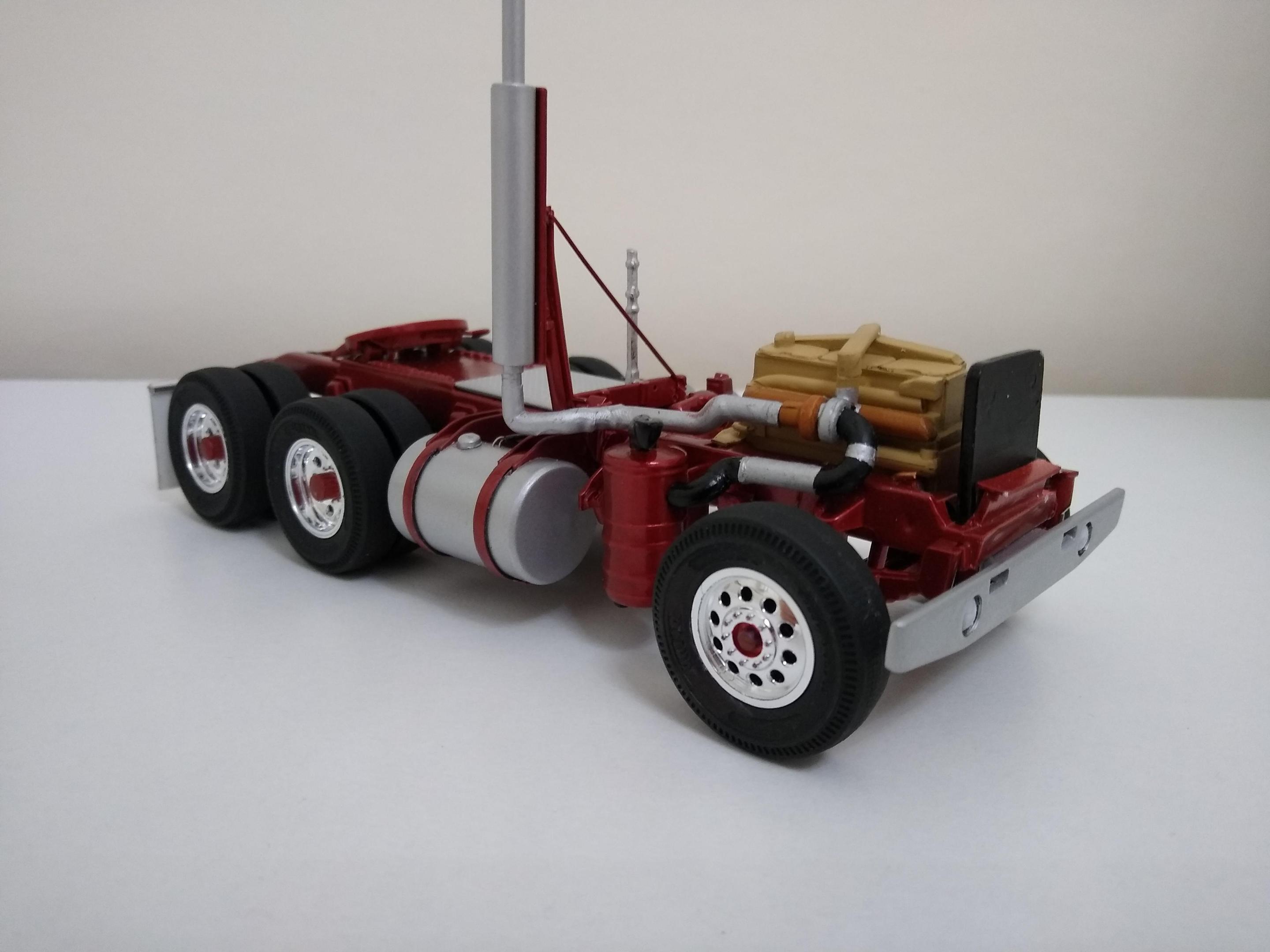

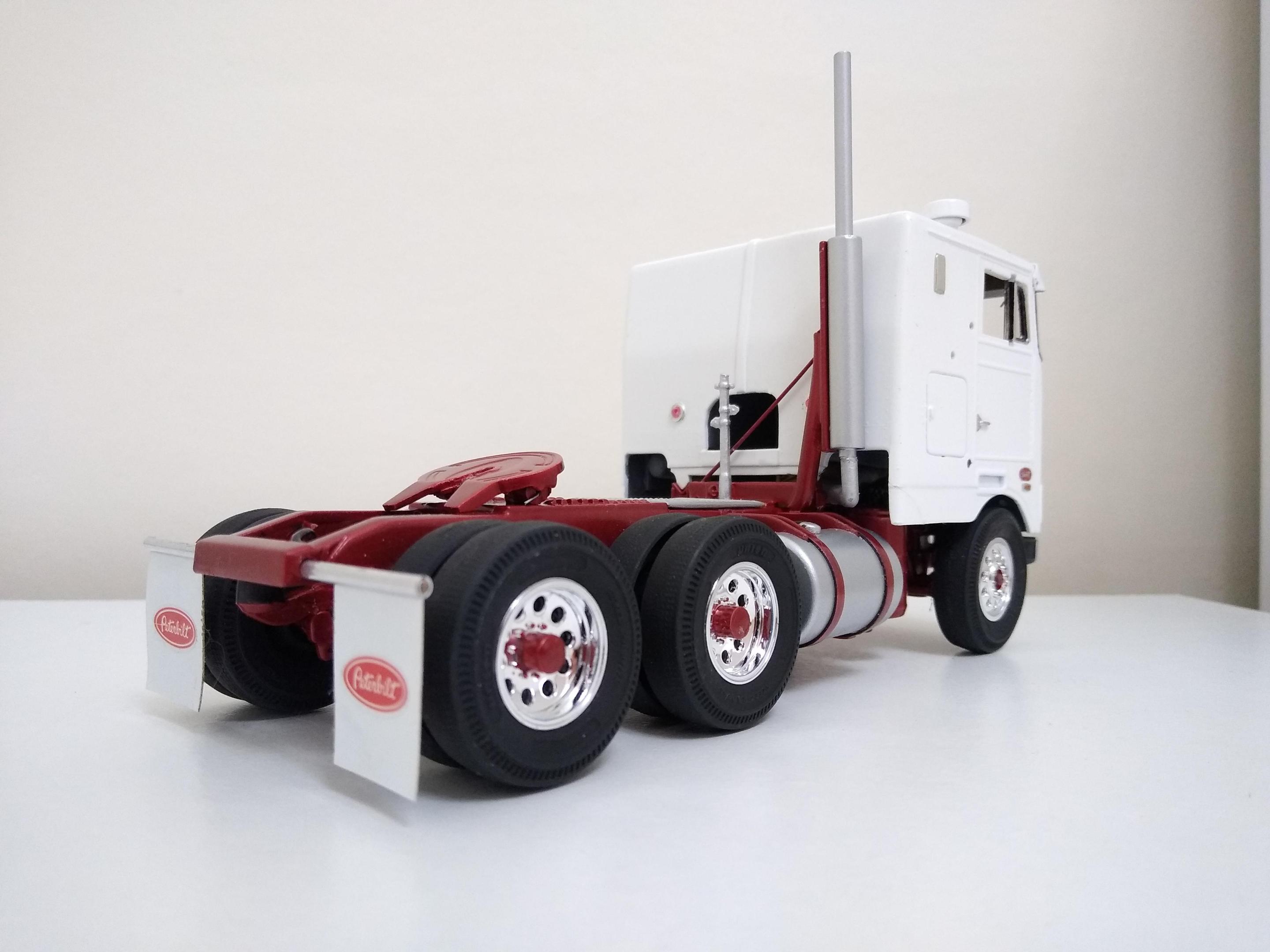

Another scary day today, trying to put the thing back together without damaging the paint. Fuel tanks needed a bit of massaging to get the brackets to slide in now that they were covered in paint. Managed that without ruining them, used an Emery board sliced in half. Slipped the tank straps over and slotted them in, look great! Added the step on the driver's side. Dressed the cab with BMF etc... and it really pops. Home made bumper looks good. Still got a few things to do, the rear shocks fell to pieces as I tried to install them and I still need to fit my Winslow stripes, airlines, rear lights etc... -

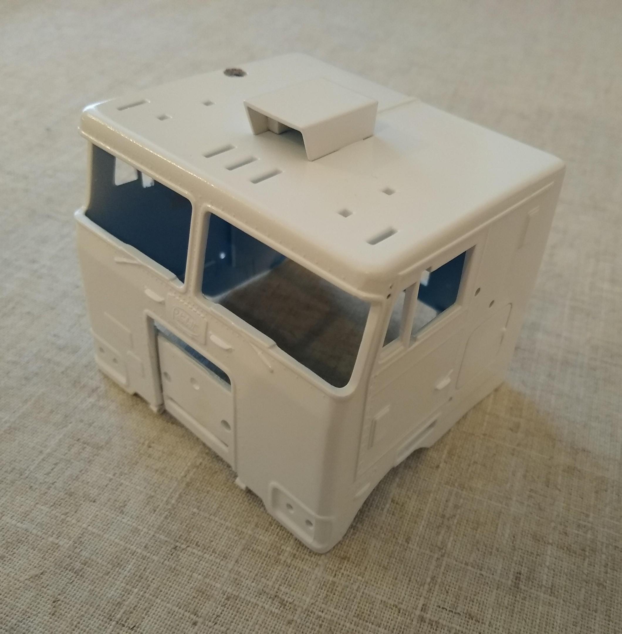

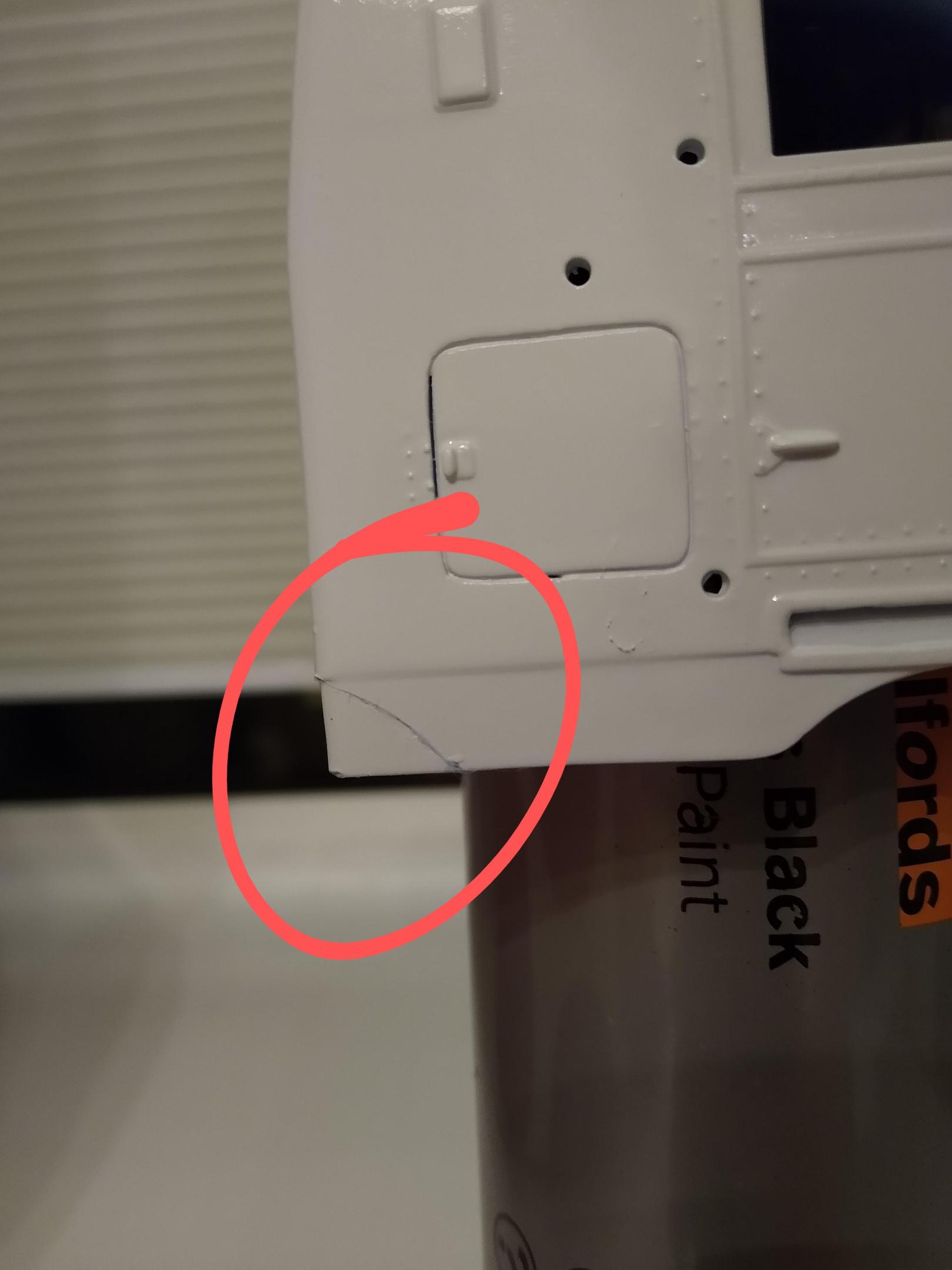

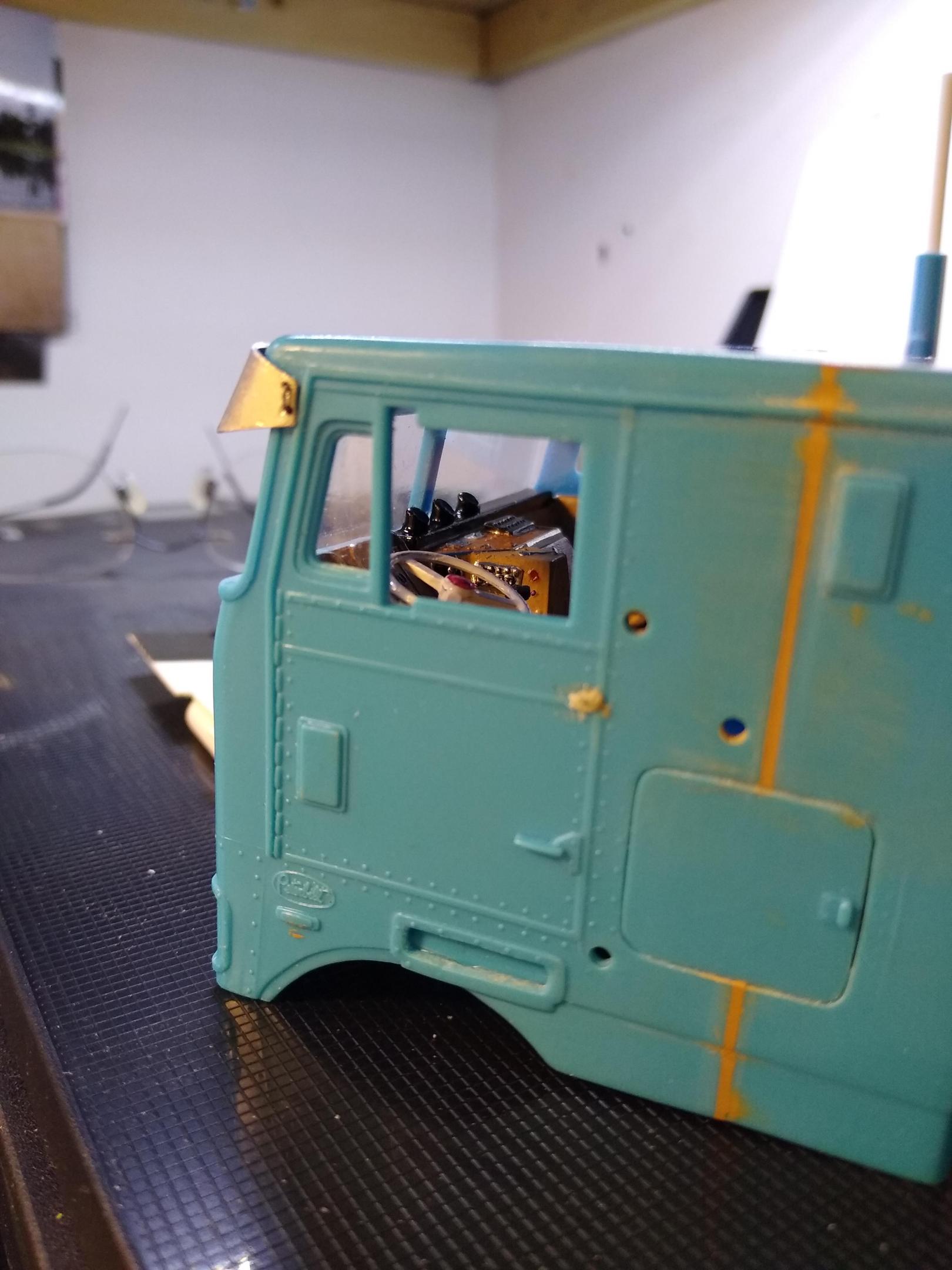

I can't believe what's happened to the cab of the 352 since I painted it. The paint was hard enough to handle the cab with no issues. I stood it on a shelf and next to it was some of that non-slip matting you can get. This was just touching the cab it seems. When I picked it back up today there were little pieces of the mat embedded in the paint! I rubbed it off with a cloth but it's left a sort of "burn" in the places where it touched the cab( ringed in the photo). I'll see if I can polish them out in a few days. I'm so annoyed. First of all I drop it and now this! Spent the afternoon doing little bits, painting the inside of the cab and the doghouse, washing the grille, colouring the wheel studs etc... Couldn't resist a quick mock-up, even though I said I wouldn't. -

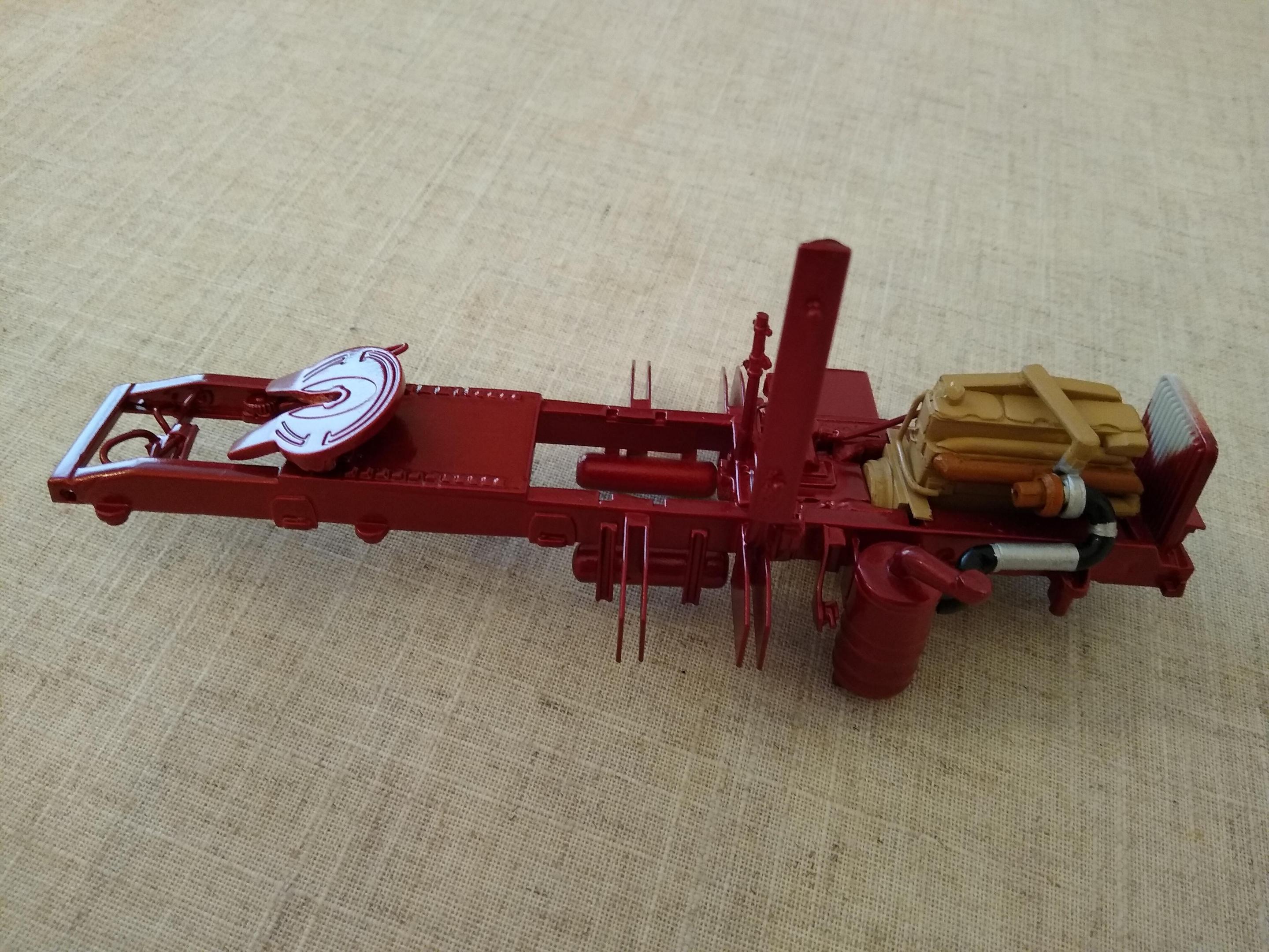

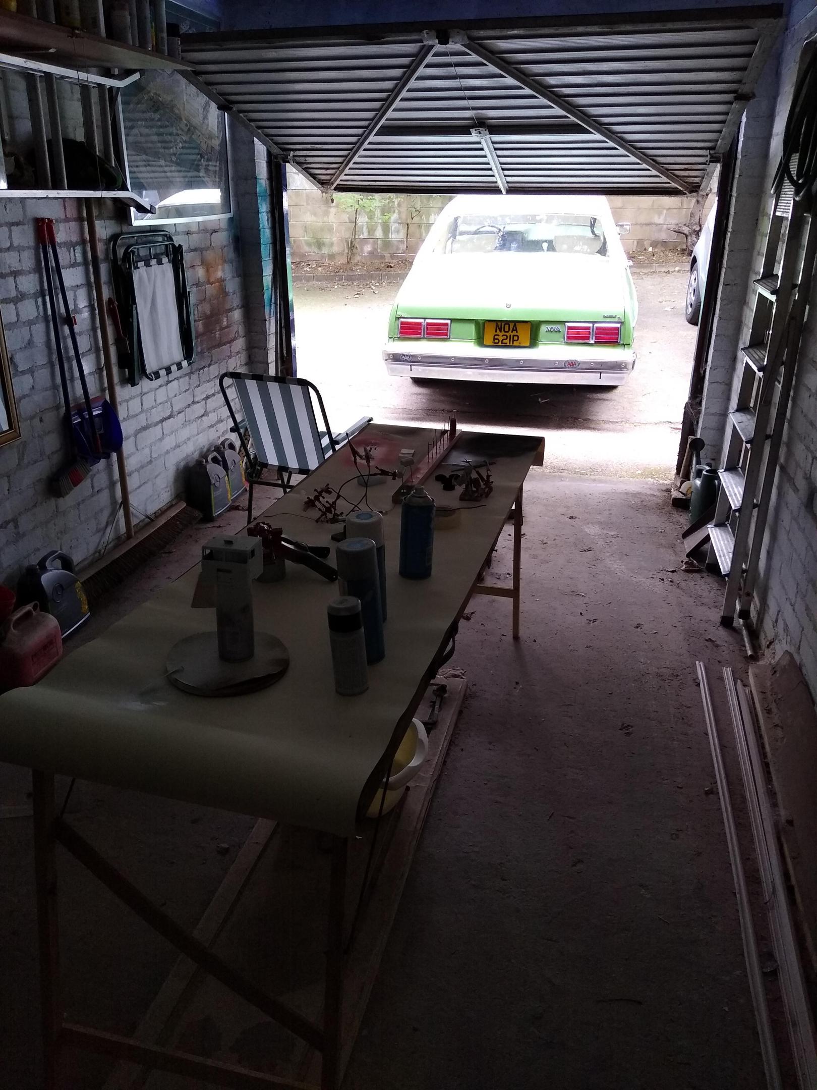

I think paint is the scariest part of any build for me. The weather has been bright but really cold for the time of year, down to 3C of a night. In the sun it's great of a day but as my "paint shop" doesn't get the sun it's been too cold to paint. Anyway, this weekend it's warmed up so I moved the car out of the way, set up a table and got to work. Chassis turned out great except for corner of the battery box that decided to play a contact sport with something before I noticed. Then I noticed I hadn't painted the front bumper I made but by that time I'd run out of primer. The cab has turned out ok. The joint between the two halves isn't invisible but it's not like the Grand Canyon. I think the casting thickness tapers toward the rear and I made the inner faces level. Oh well. At least I didn't drop it OH YES I DID! Broke the corner of the lower apron off on the passenger side. I'm not filling and sanding anymore on this job. It got glued back on and a dribble of Tamiya white. I'm resisting the urge to fidget with it and try mock ups because the paint is dry but still at that jelly like stage where it's still got a lot of gassing out to do. Couldn't resist dropping the engine in though. So, other than everything that went wrong, it went alright. ? I think. -

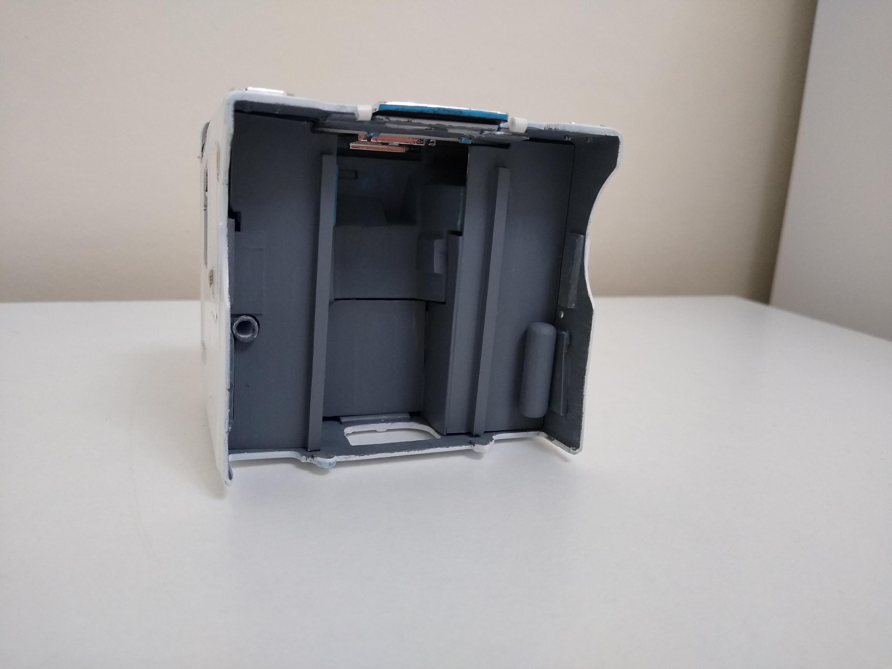

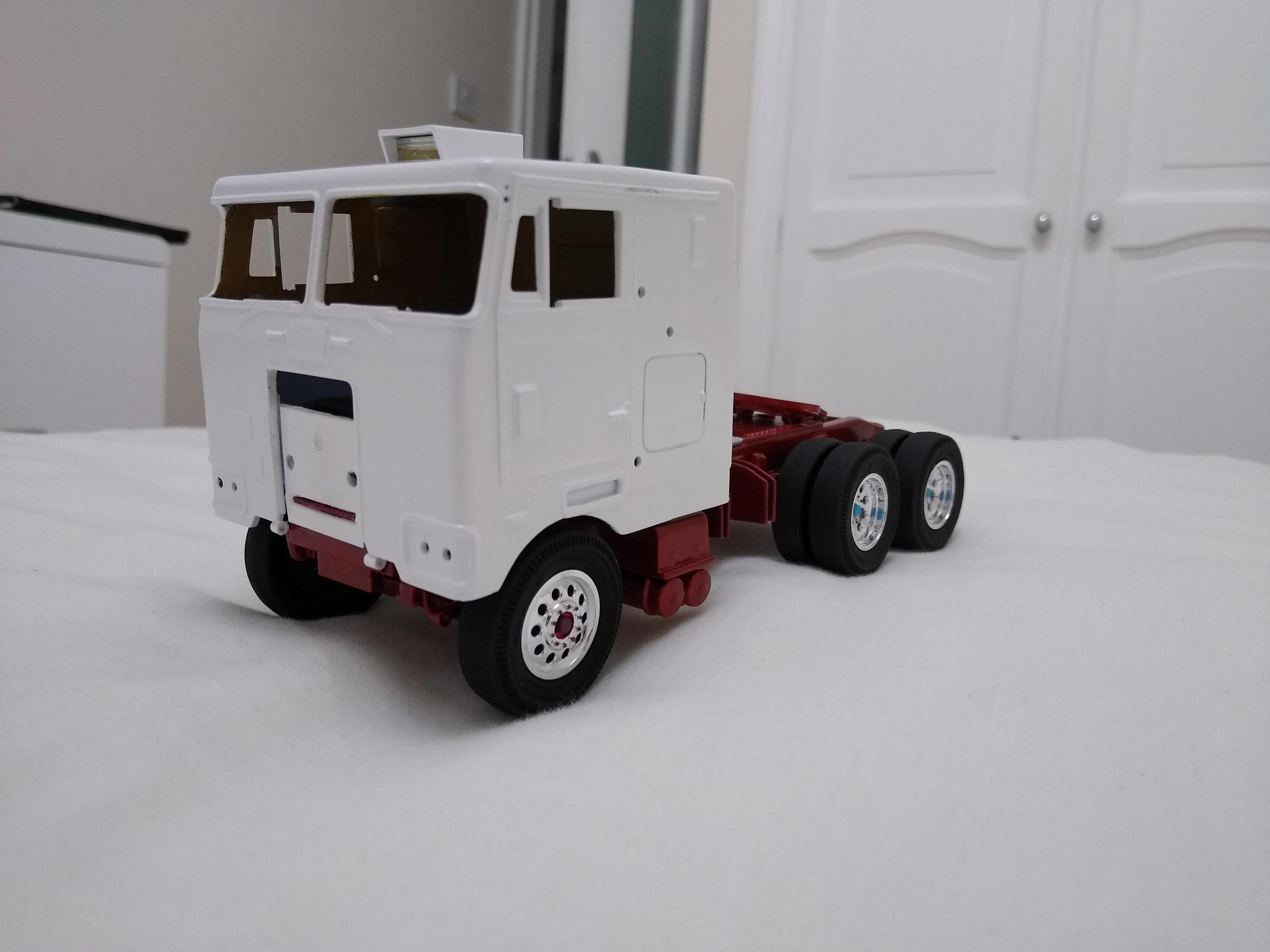

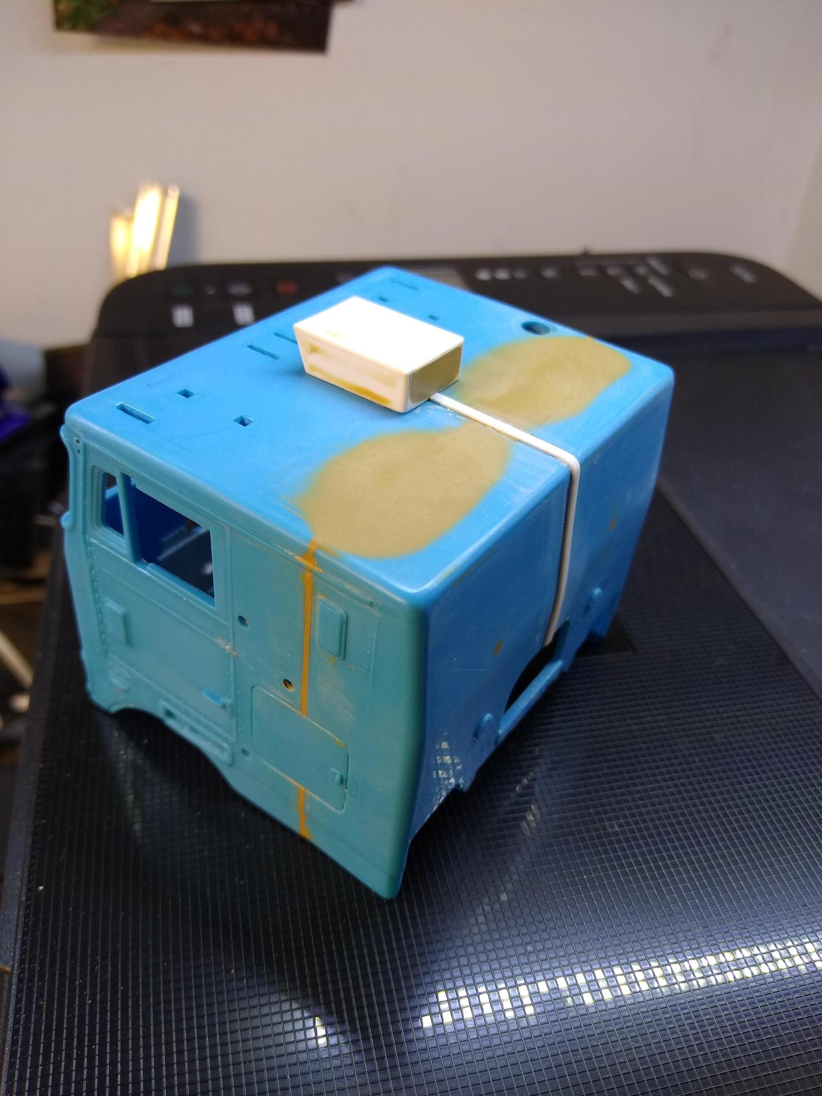

Just to confirm to myself that this isn't stalling, I'm trying to finalize a few things before I start painting. Glued the AC box to the roof and ran a small strip of plastic card from the unit down the back of the cab to depict the conduit that takes the pipework down into the doghouse. -
White Freightliner day cab SD
Rockford replied to leafsprings's topic in WIP: Model Trucks: Big Rigs and Heavy Equipment
That's a great looking job you're doing there. I would feel the headlight move would be too much for me, I'd be terrified of ruining the cab altogether. -

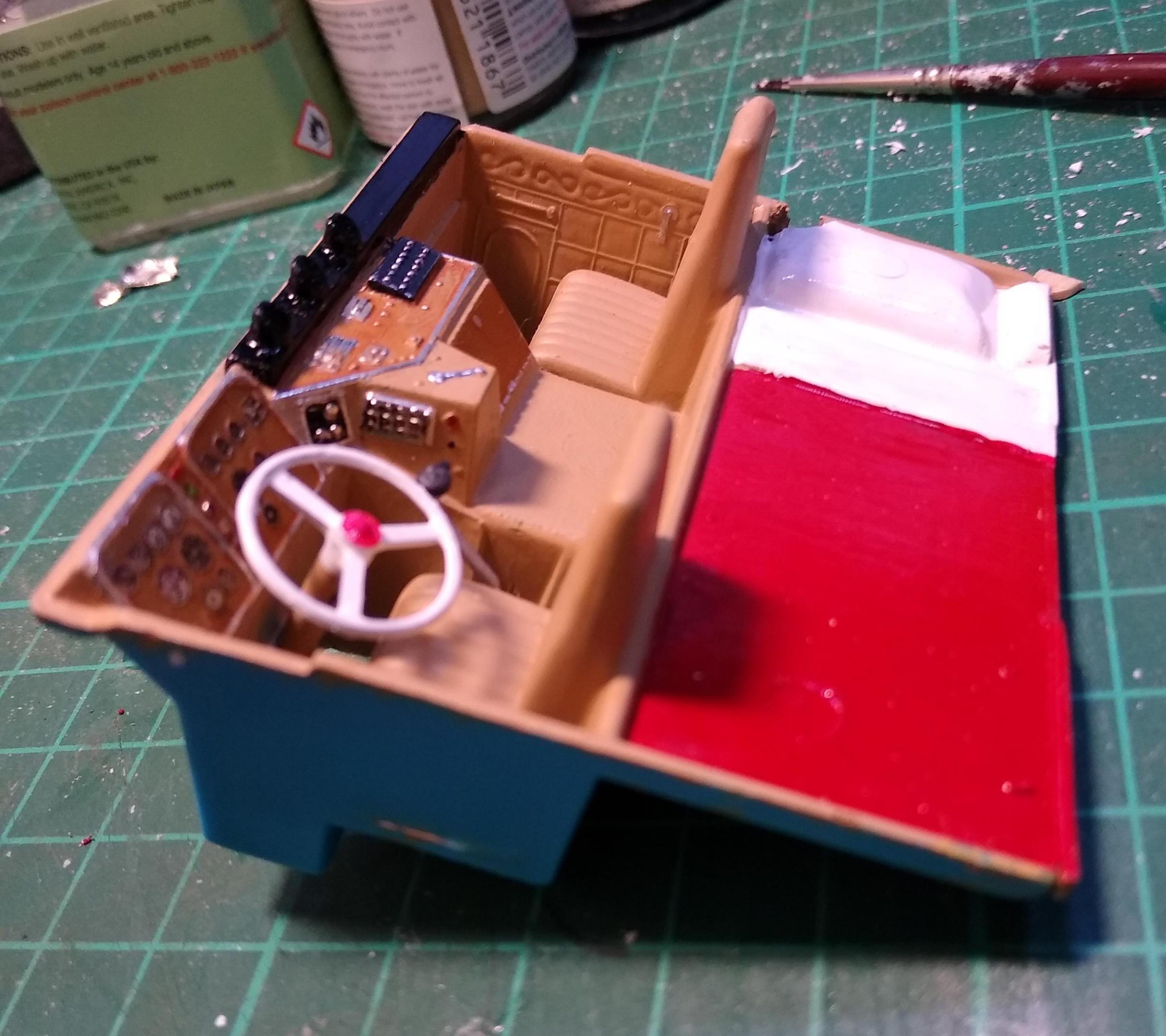

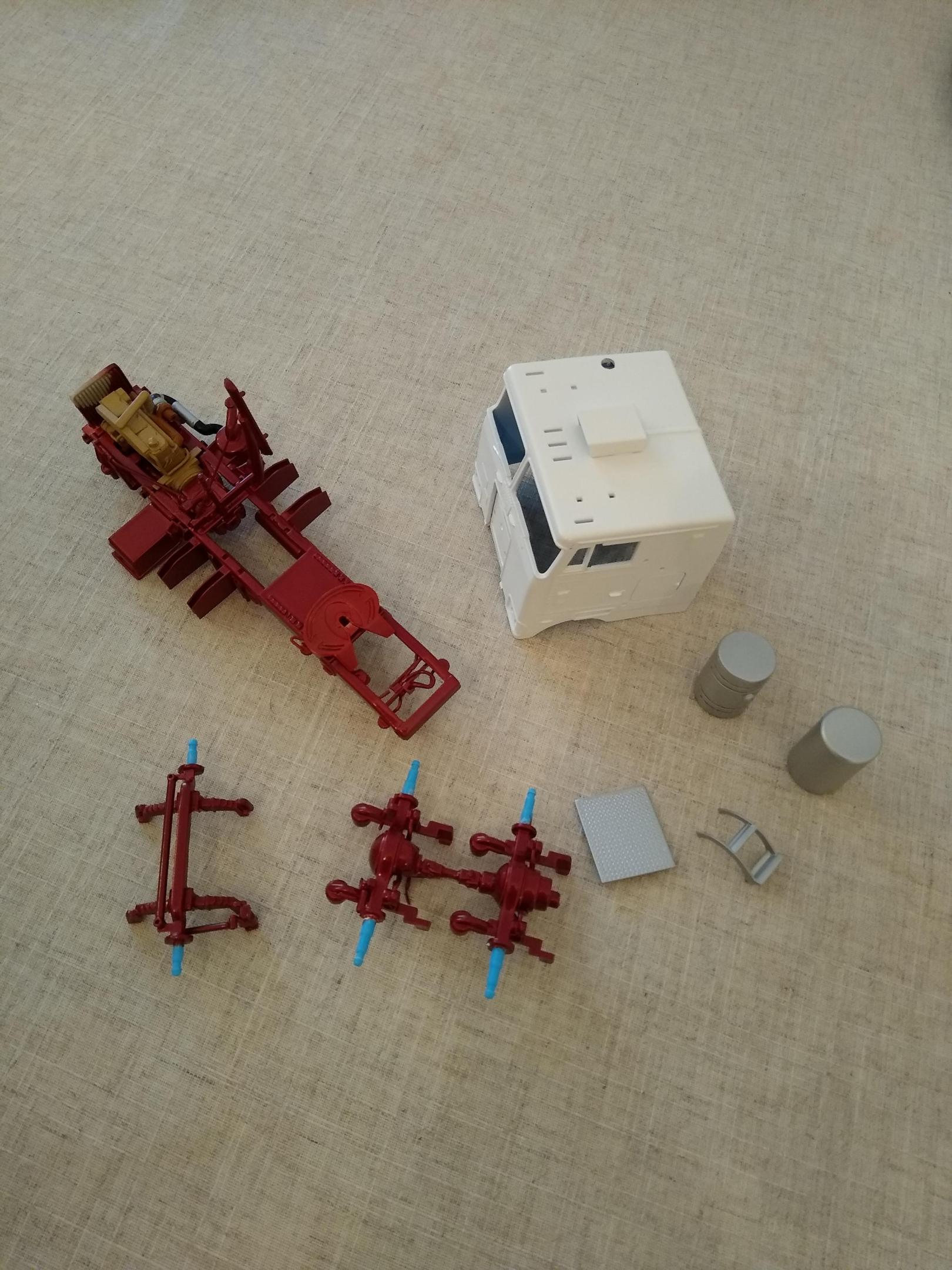

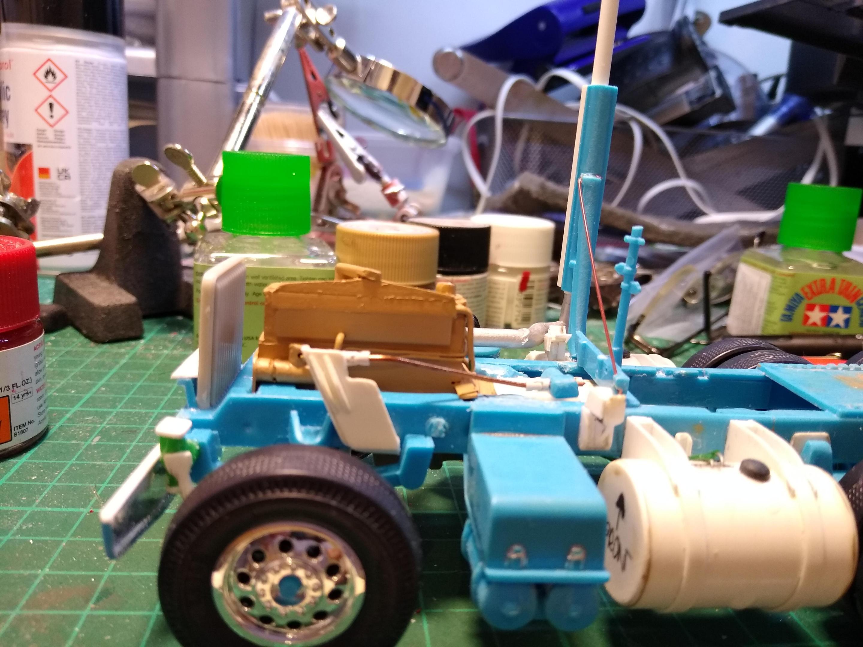

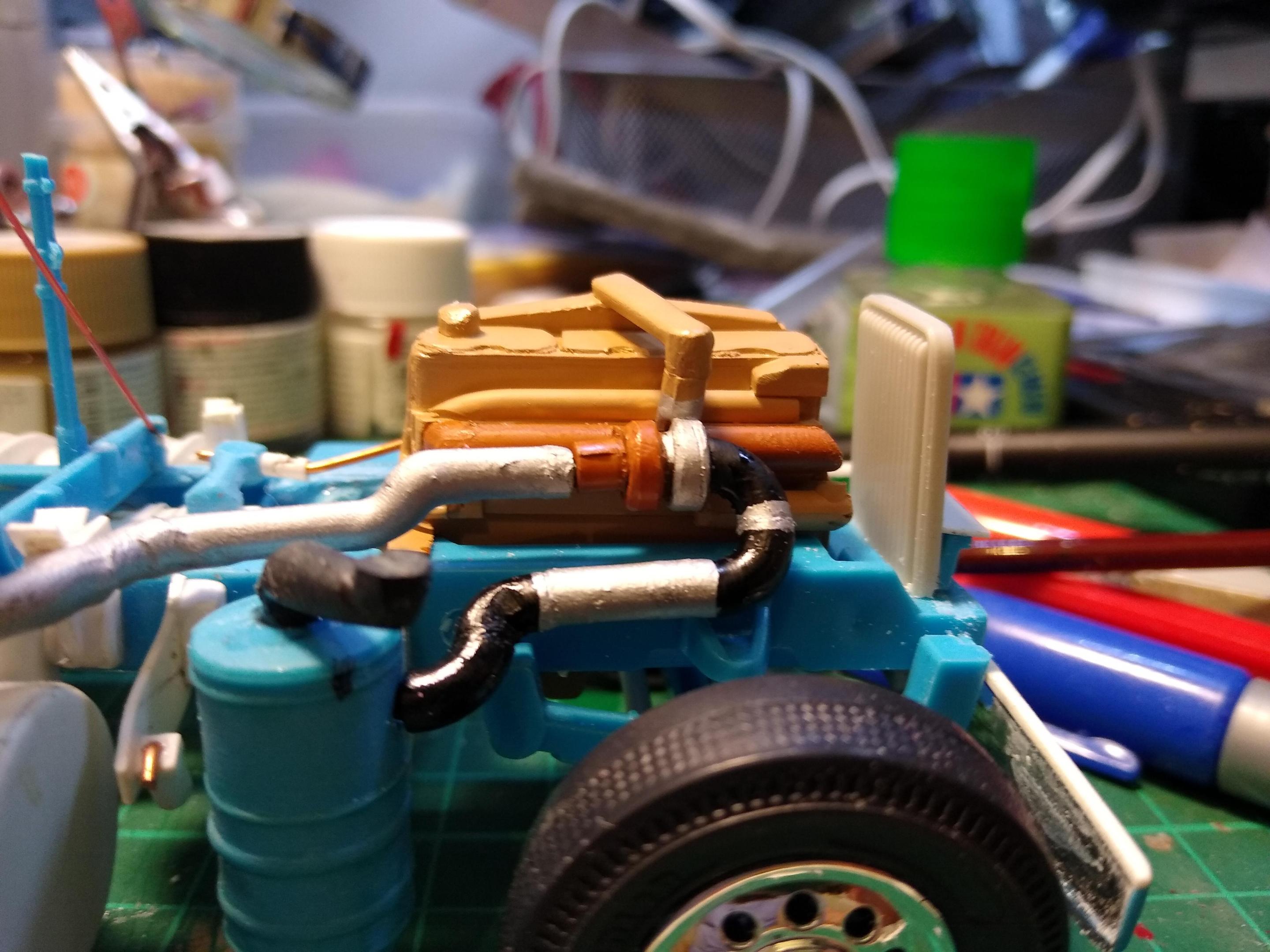

The miserable, wet weather is starting to pass now here in Liverpool so thoughts have turned to painting the Peterbilt. First I thought I'd do the interior and get my Cummins painted. I know it should really be white but I only ever worked on Cummins that were buff coloured so they look right to me that colour. Let's just pretend that the original white engine was having an in-frame after a million miles and they found a crack in one of the top lands for the wet liner on cylinder three so a replacement engine was sourced. Anyway, it looks ok to me, it'll only be seen through the gaps under the cab so does the job. Painted the interior, used BMF on the clusters then washed in dark brown to mimic the faux wood veneer. Didn't want to do too much because you can't see much once it's in place, but again, good enough. -

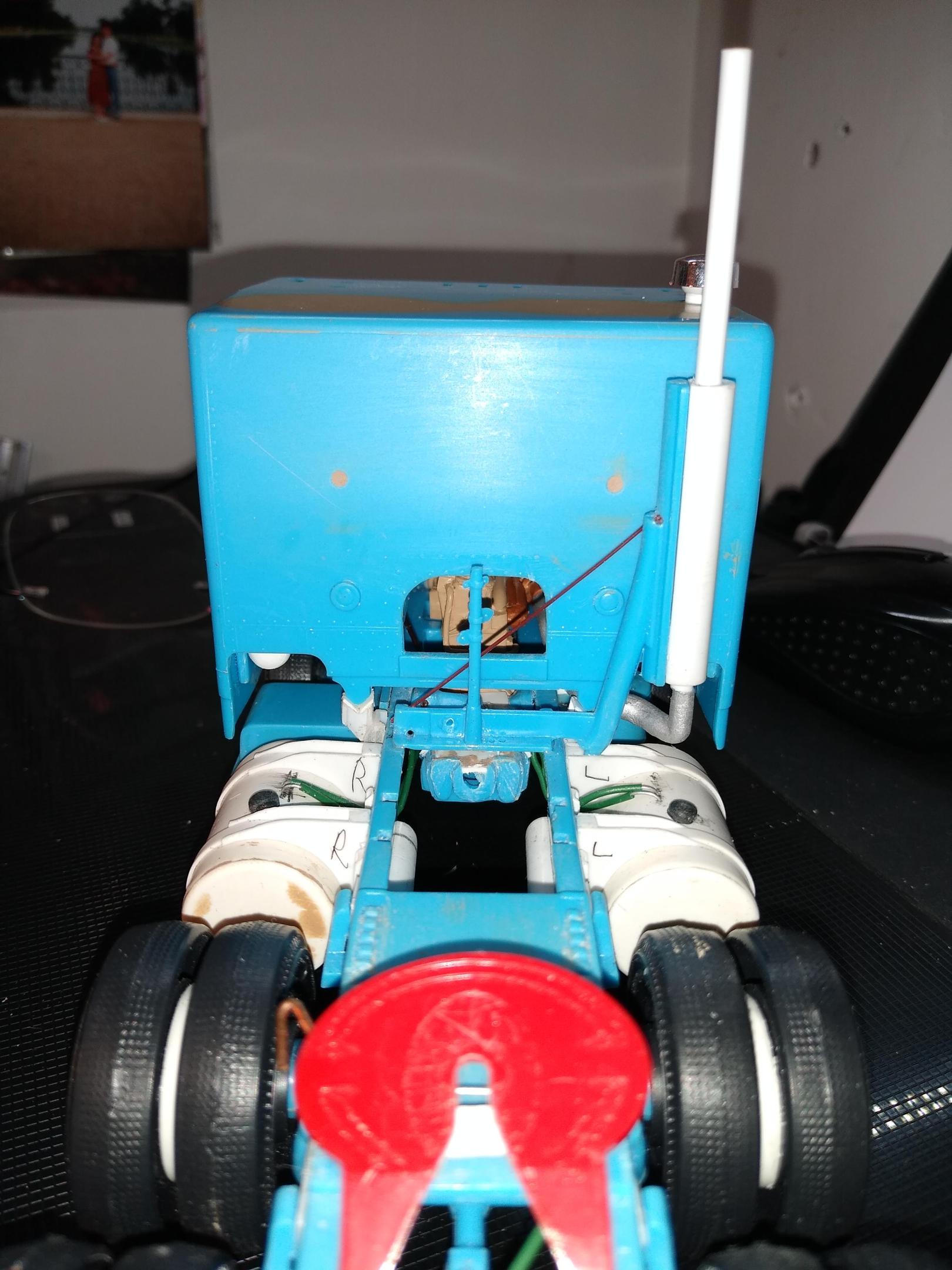

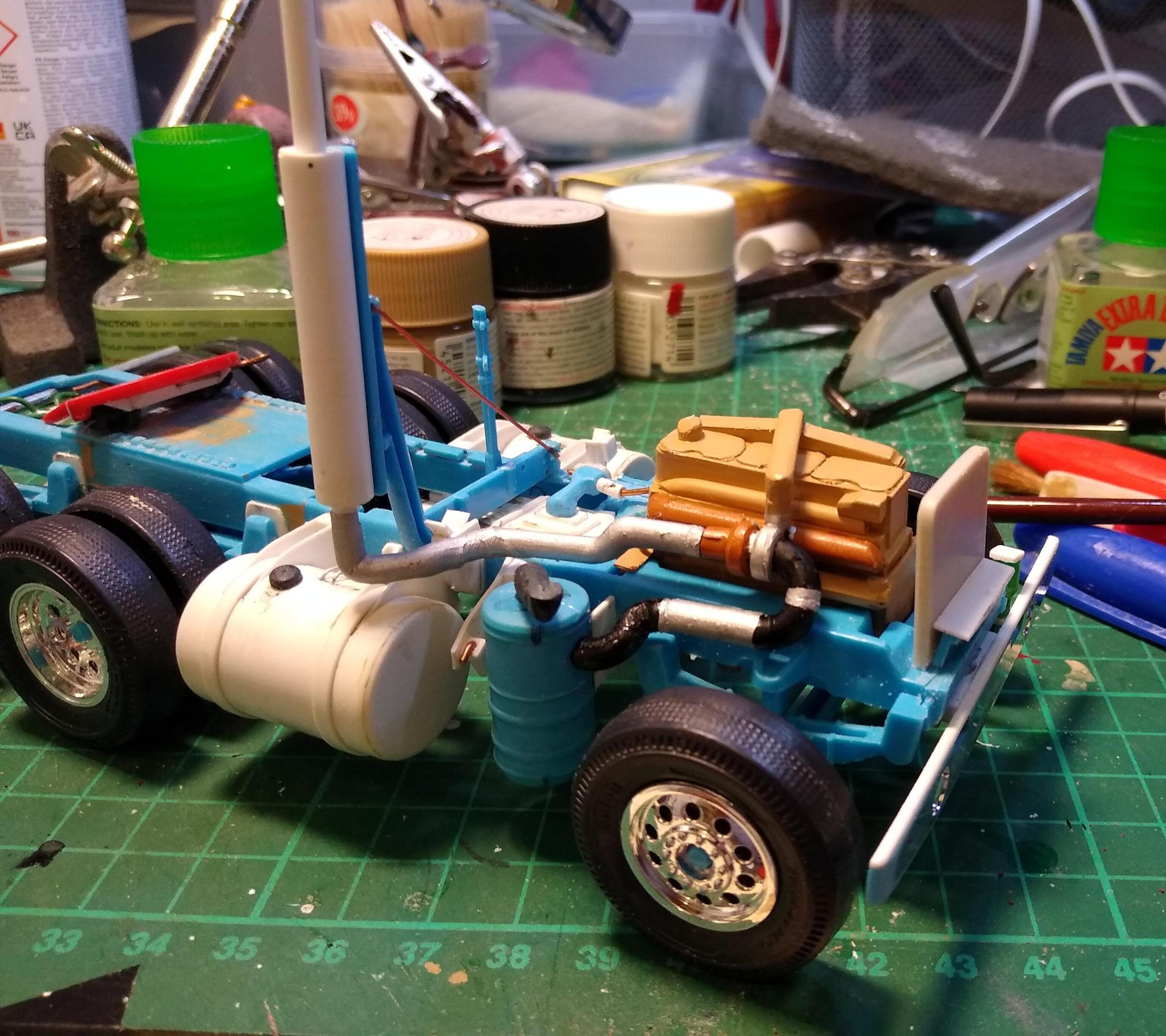

Rockford replied to Rockford's topic in WIP: Model Trucks: Big Rigs and Heavy Equipment

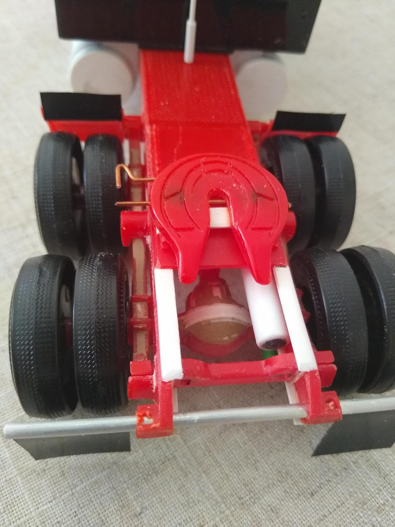

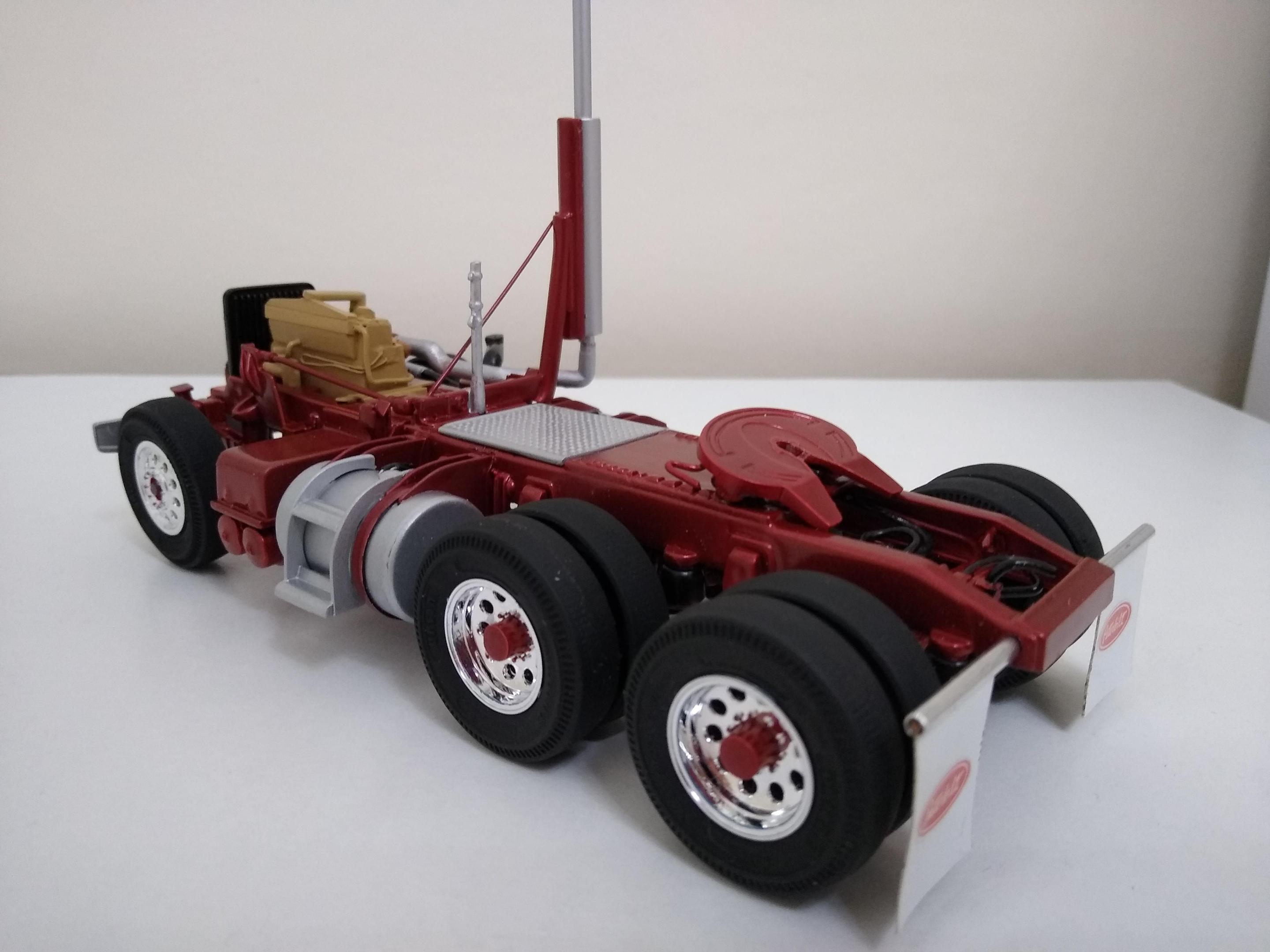

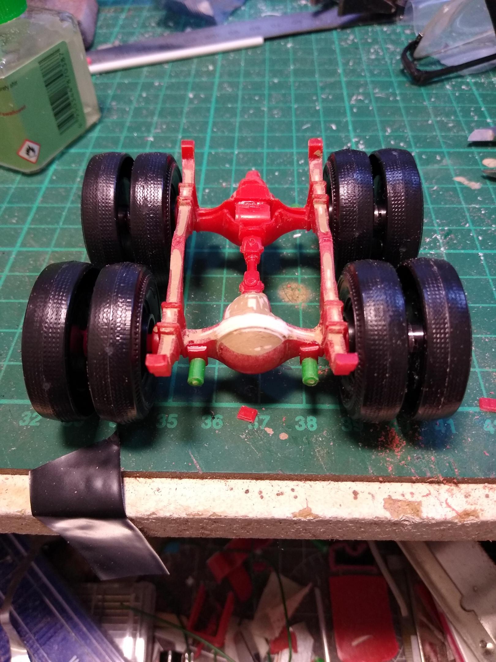

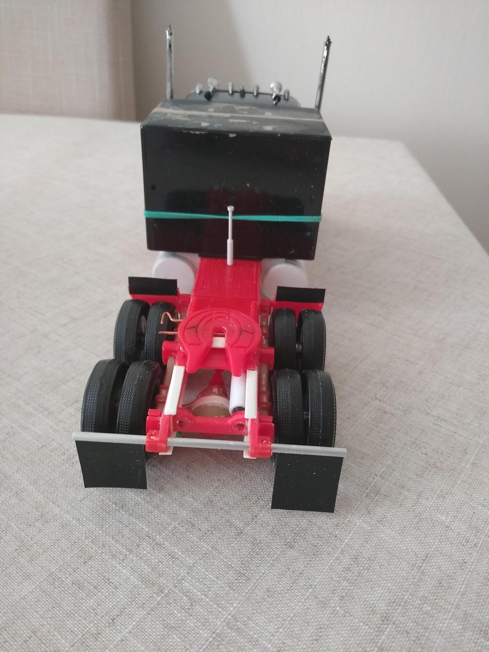

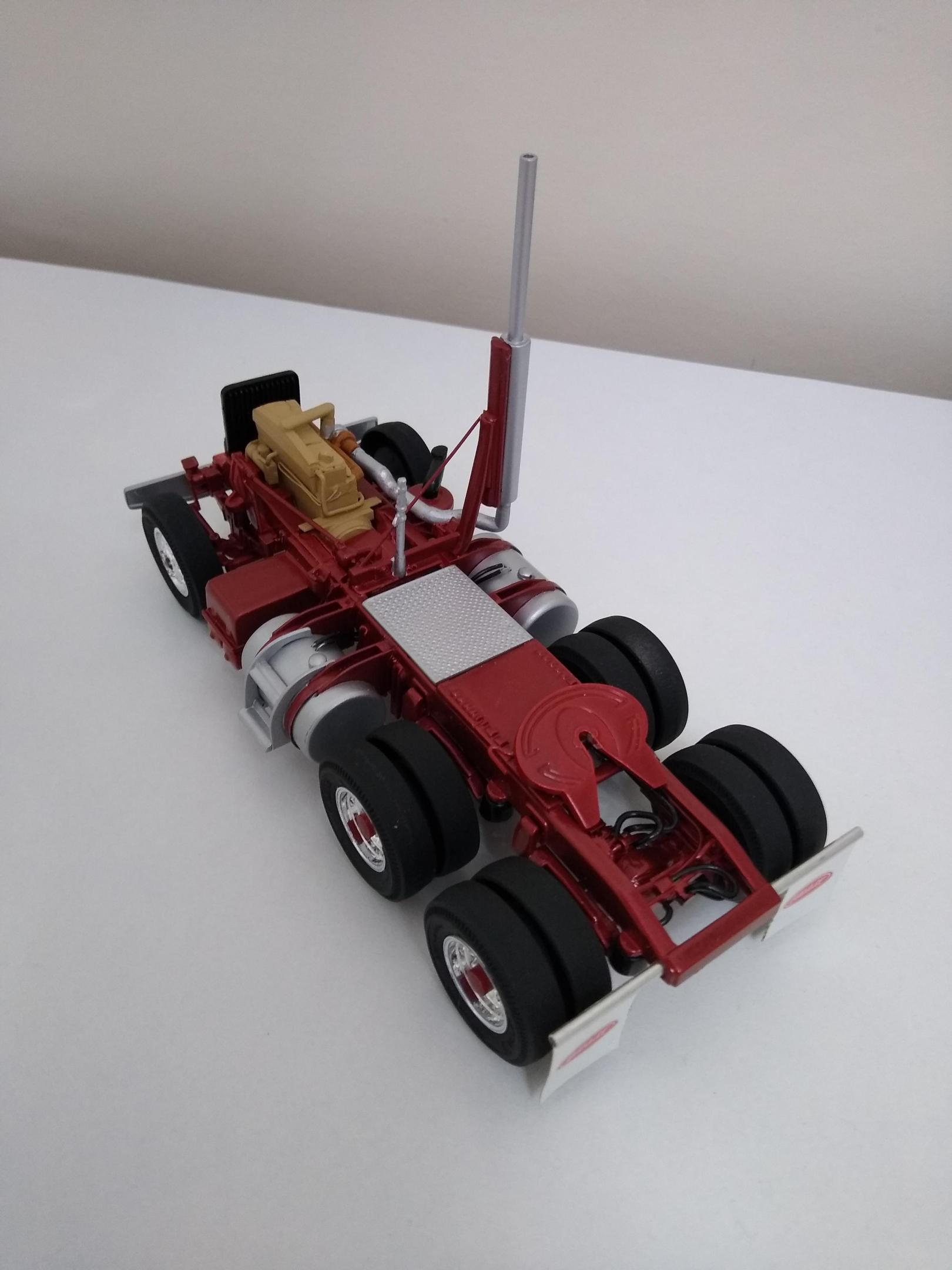

Rubbed the putty down on the rear axles, quite pleased with it. Added some rudimentary brake chambers. Used some spring steel wire and hollow tube to knock up a pogo stick, drilled the deck plate and looks ok to me. Also removed the hard plastic quarter fender flaps and made new ones out of electrical tape.
