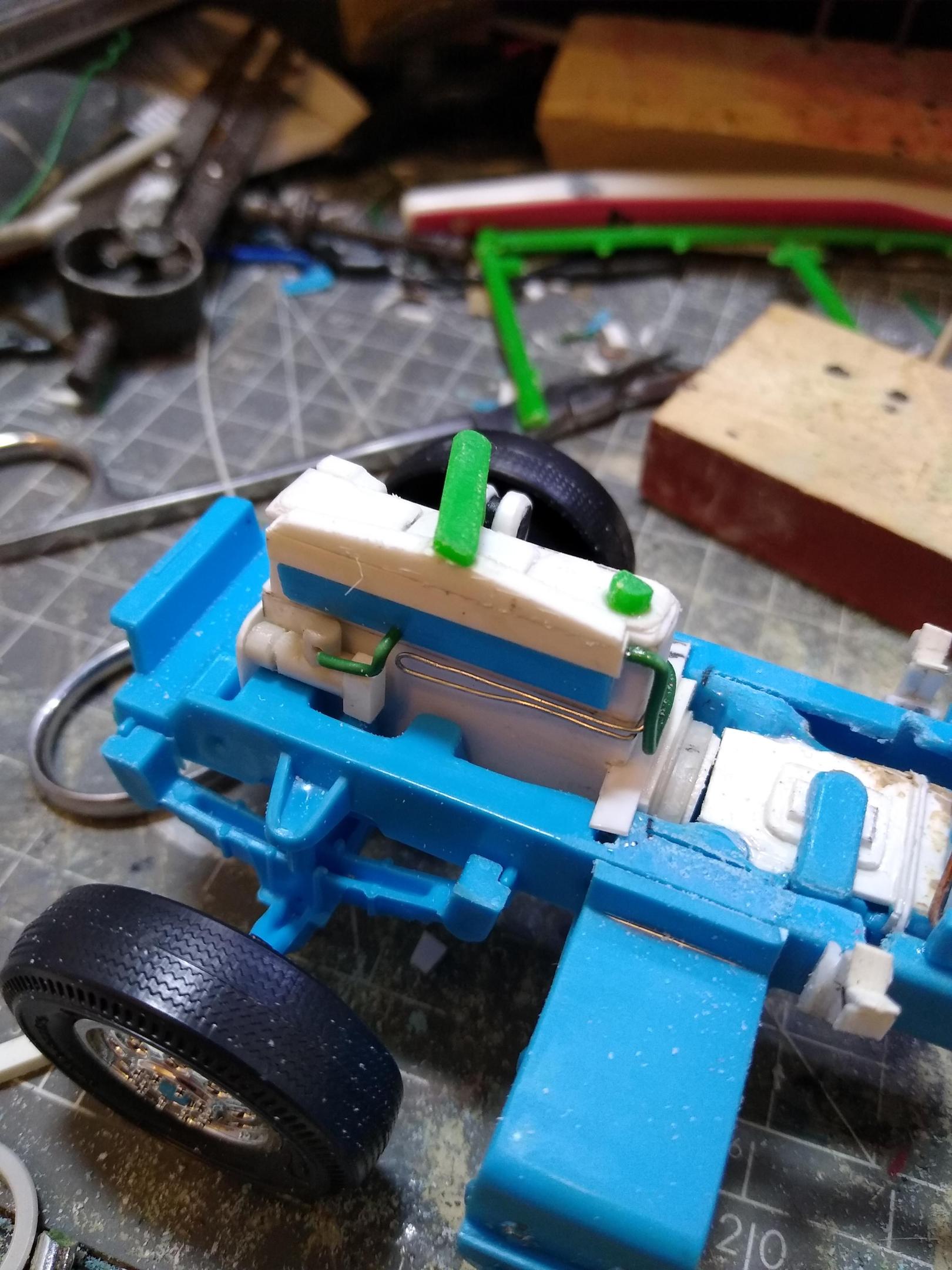

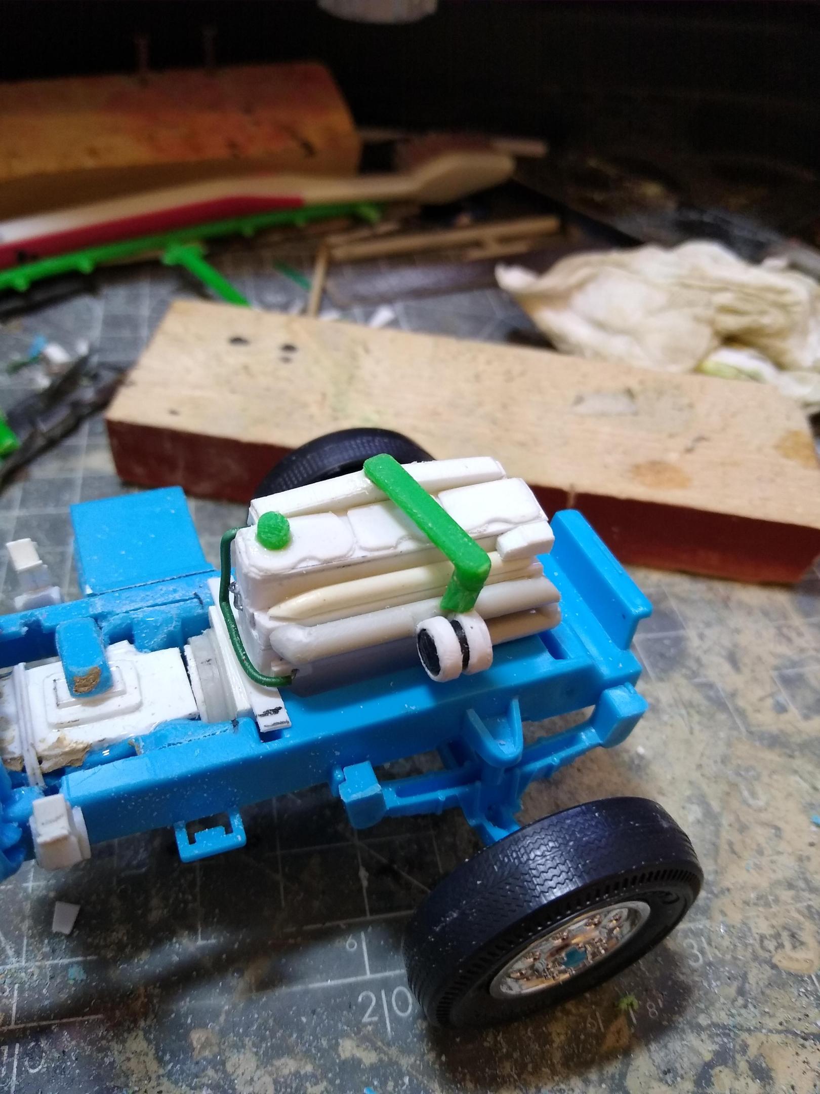

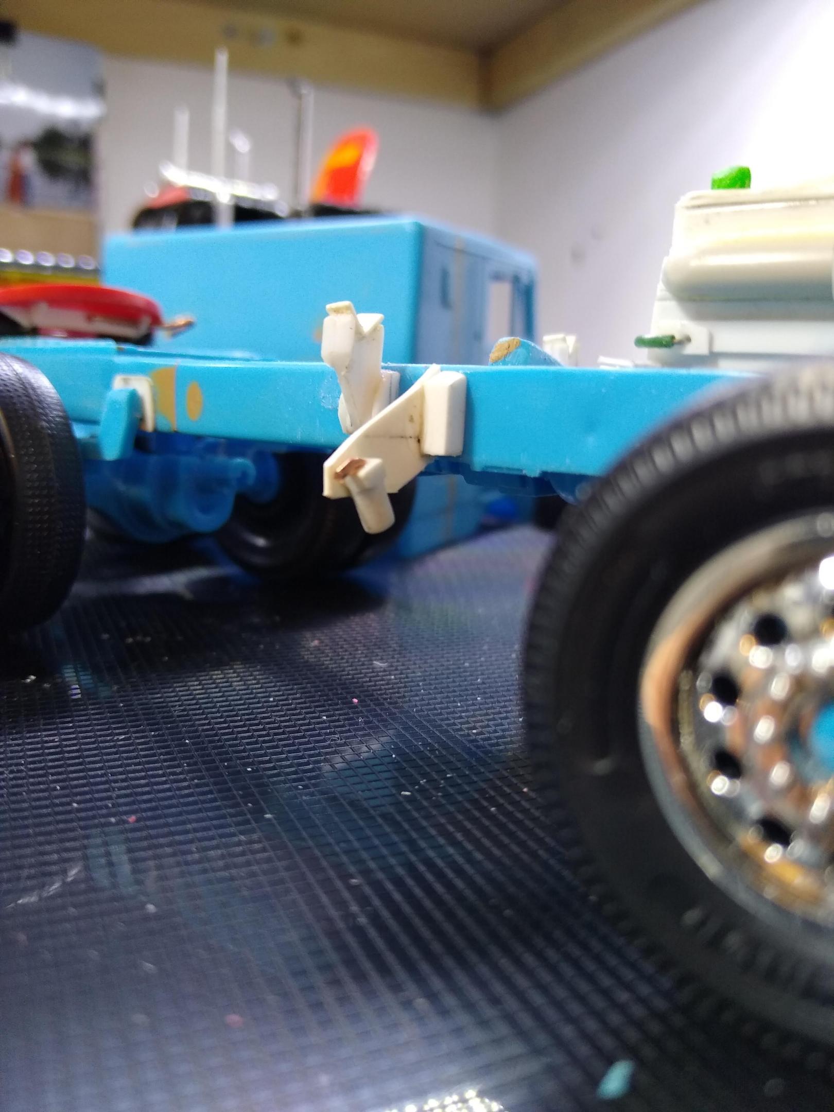

Glued the two chassis pieces together, always a worry making sure that the thing is straight. Took the saw to the driver's side exhaust mount and rigged a new diagonal brace out of copper wire. I've got about three weeks of filling and sanding on the cab and the chassis now. This is going to be a real chunky monkey. -

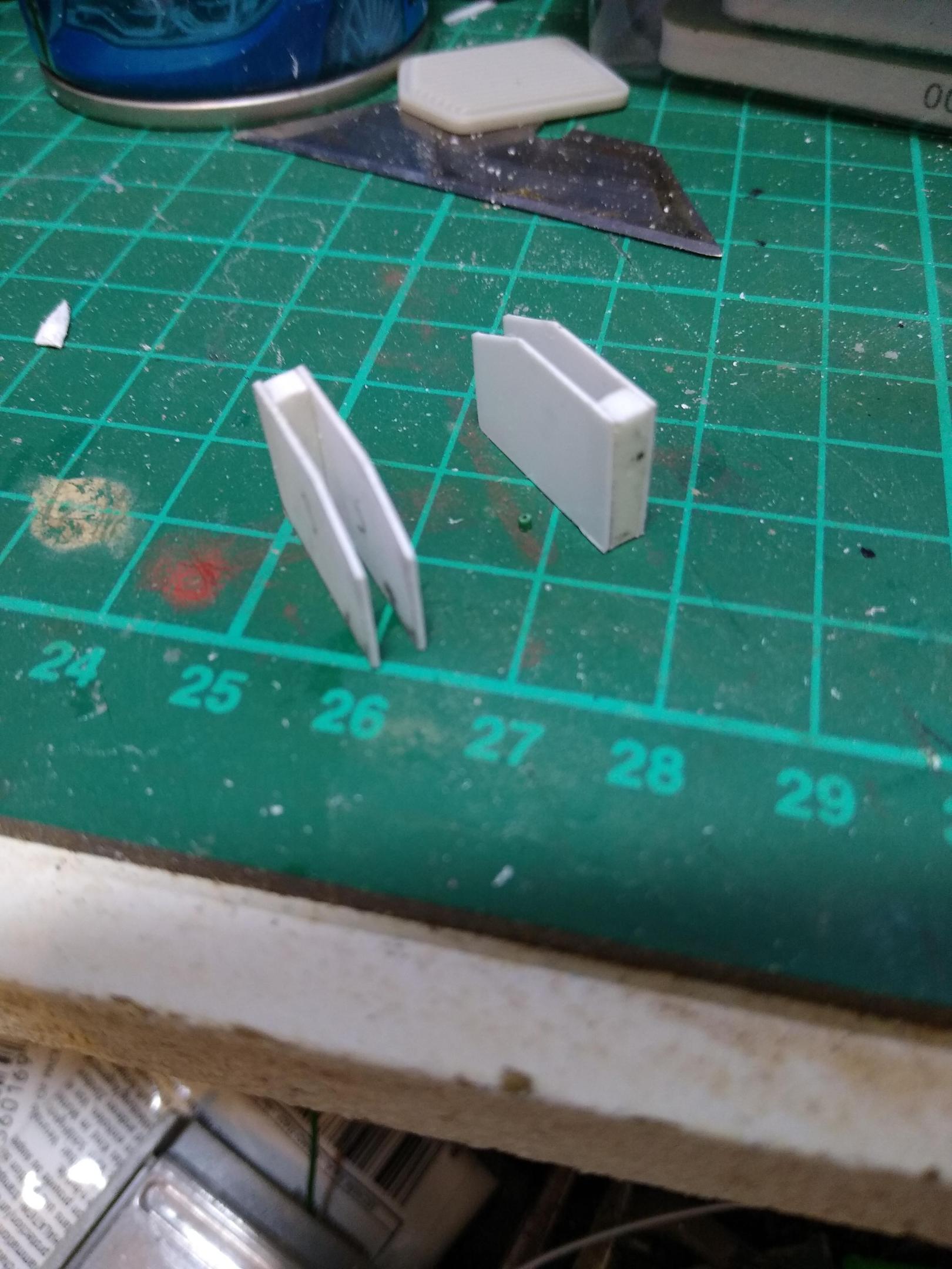

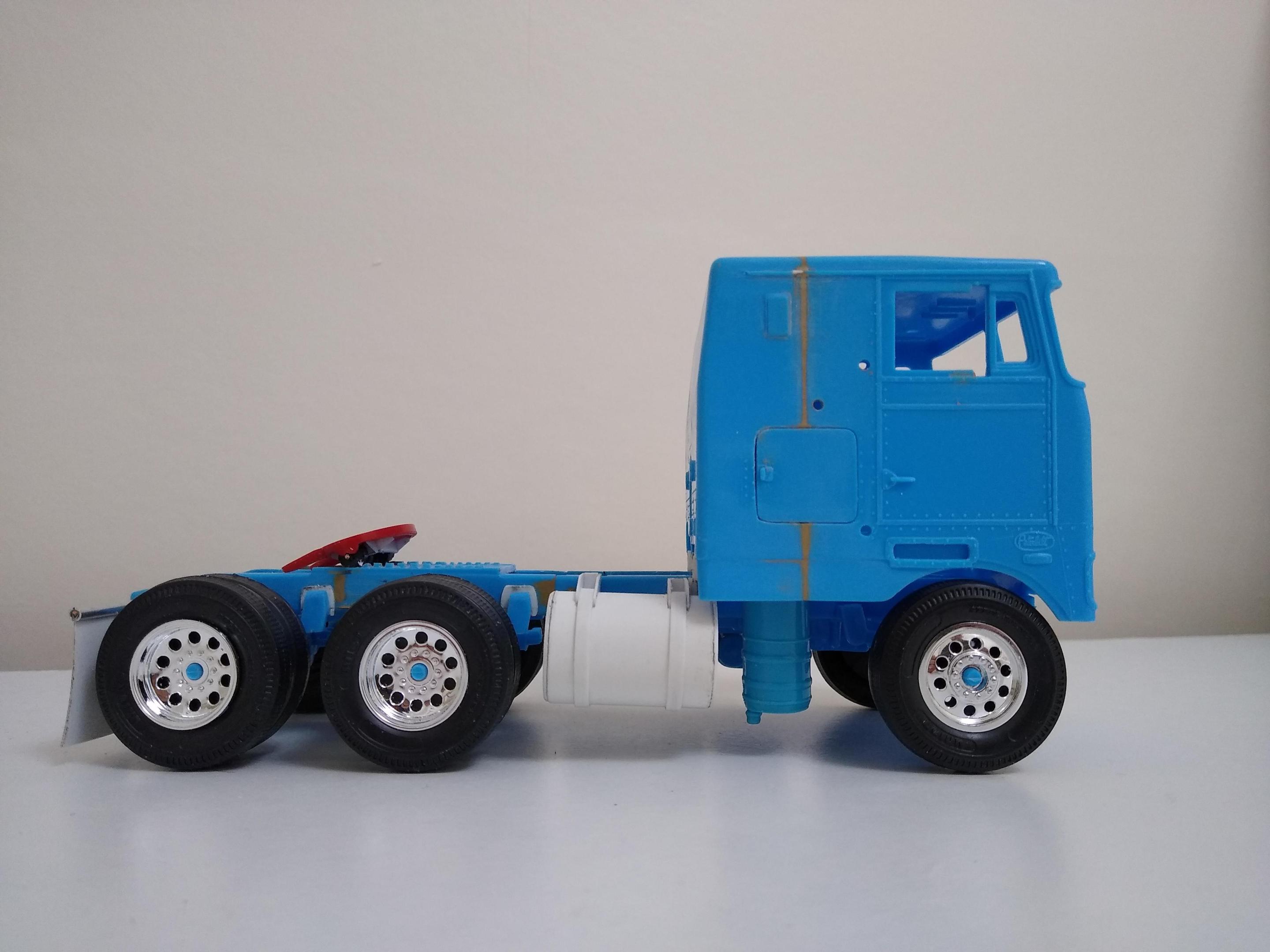

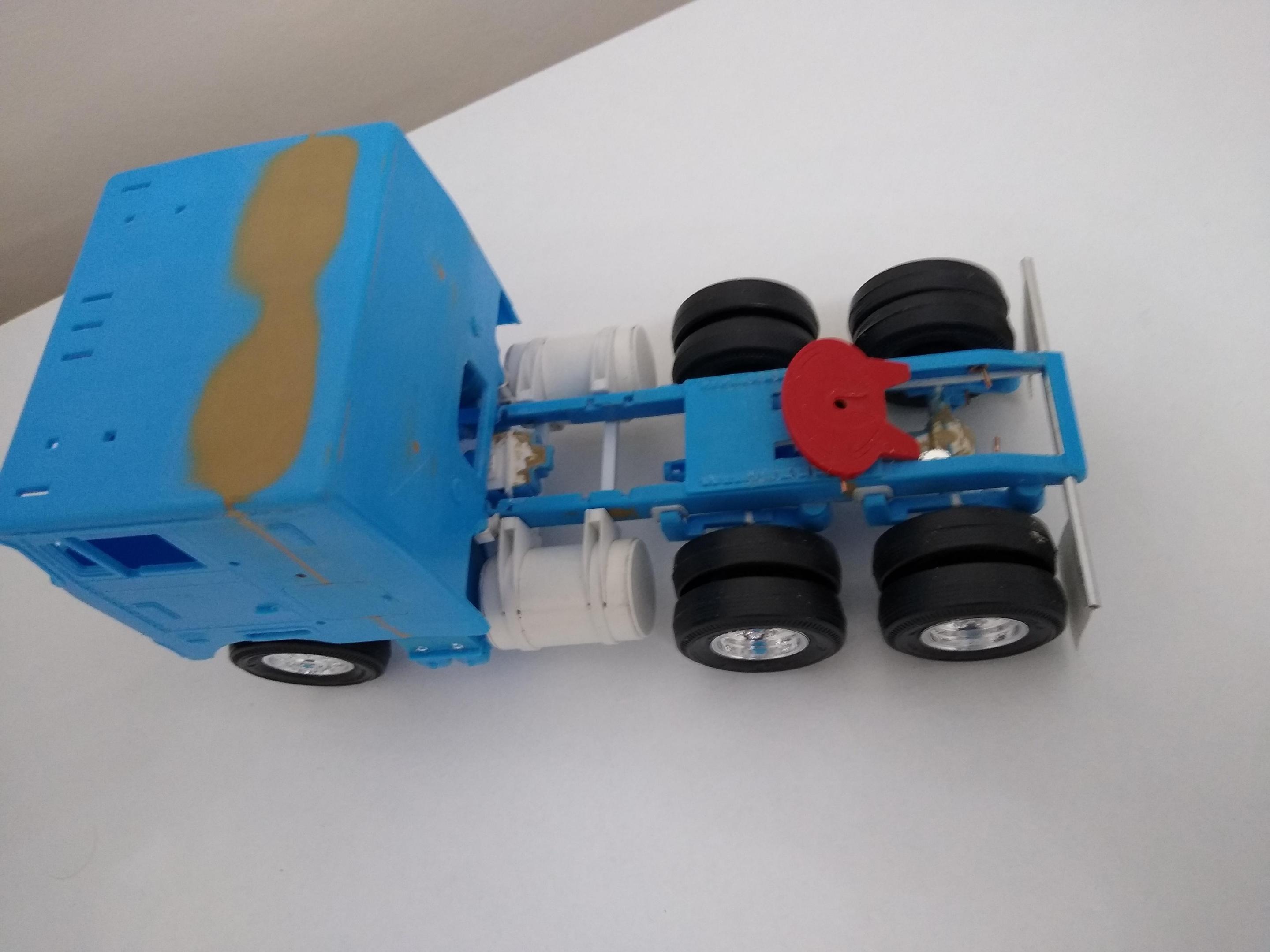

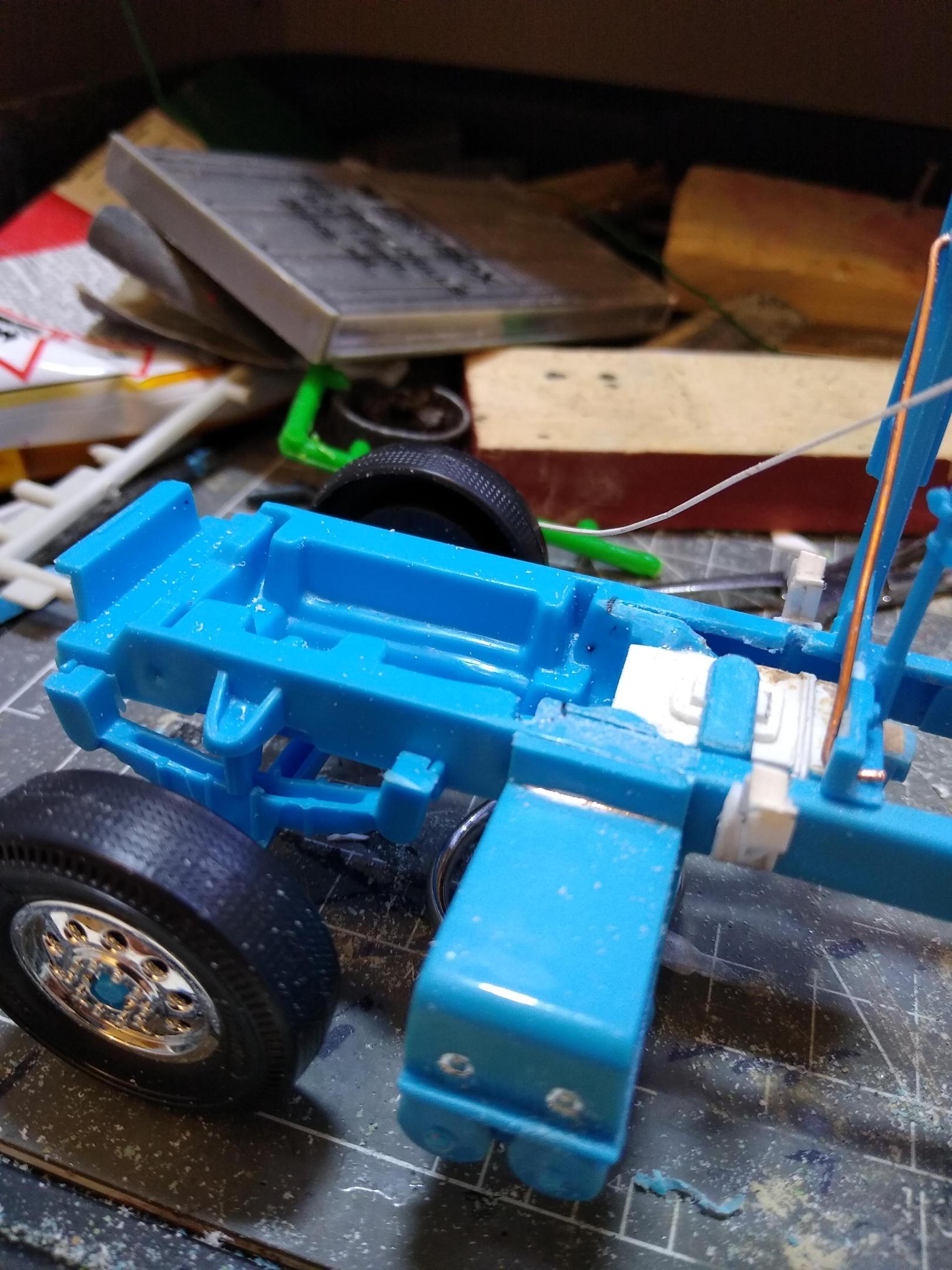

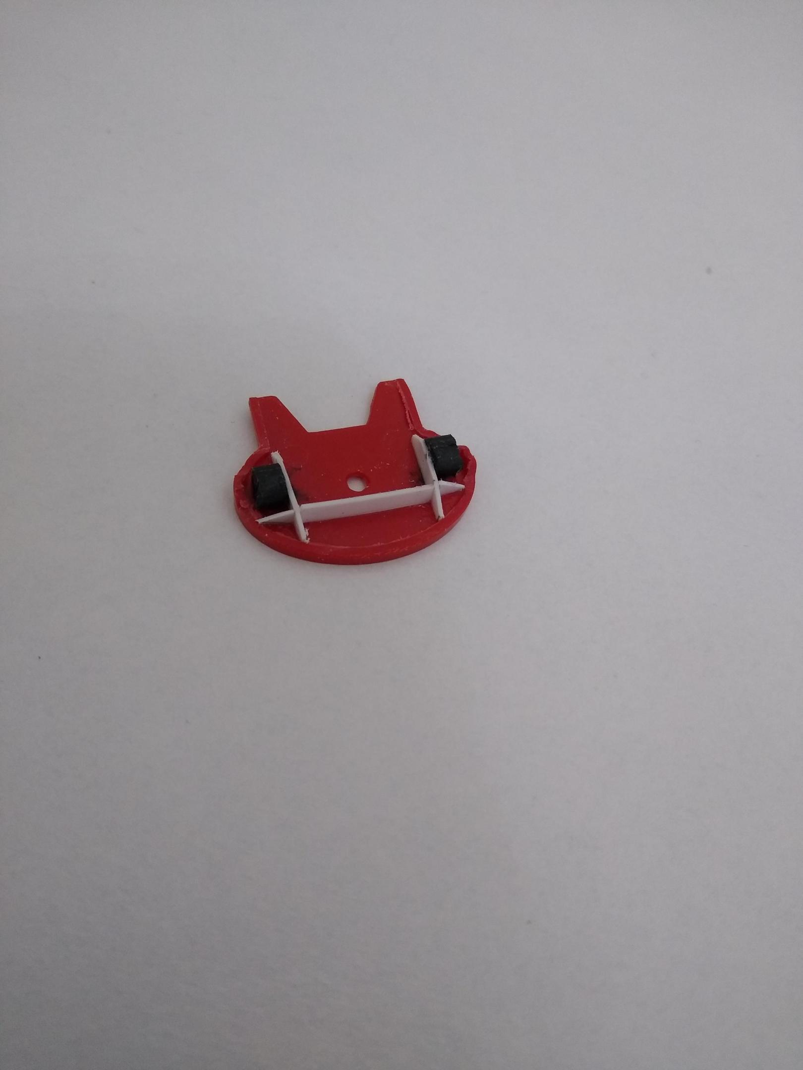

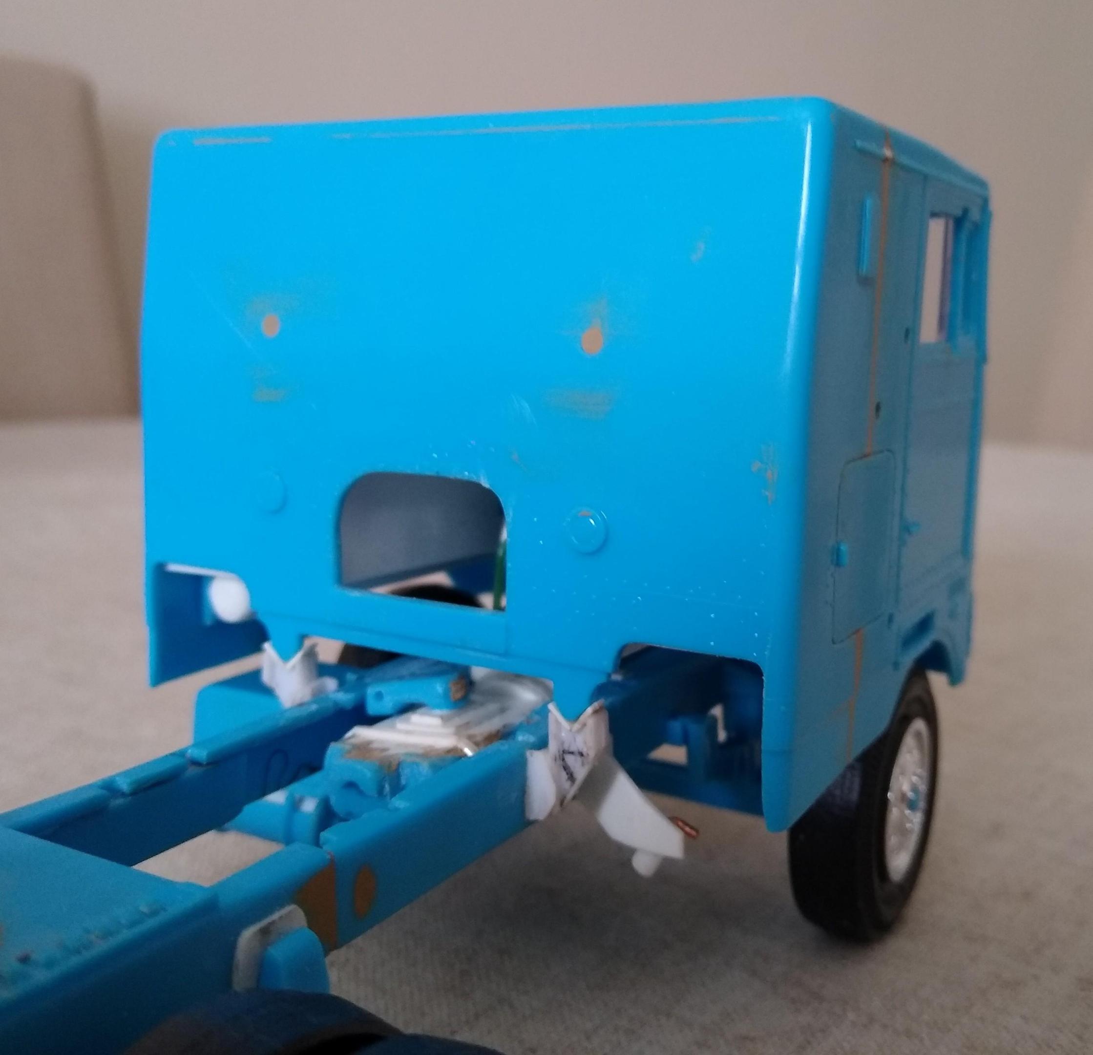

Did a little bit more yesterday. The first time I built this kit was in full lockdown in the first wave so I could only work with what I had, and that was one rattle can of white about 10 years old. Tried improving things over that build. The steps are shallow depressions so I opened them up and put a piece of offcut behind them, just to add depth. Looks a bit better. Moved the fifth wheel back a little. Then I removed the deck plating from behind the fifth wheel and cut 33mm out of the frame. My brain was screaming WHAT ARE YOU DOING!? but it was right according to the sums I did so hopefully it will work out. -

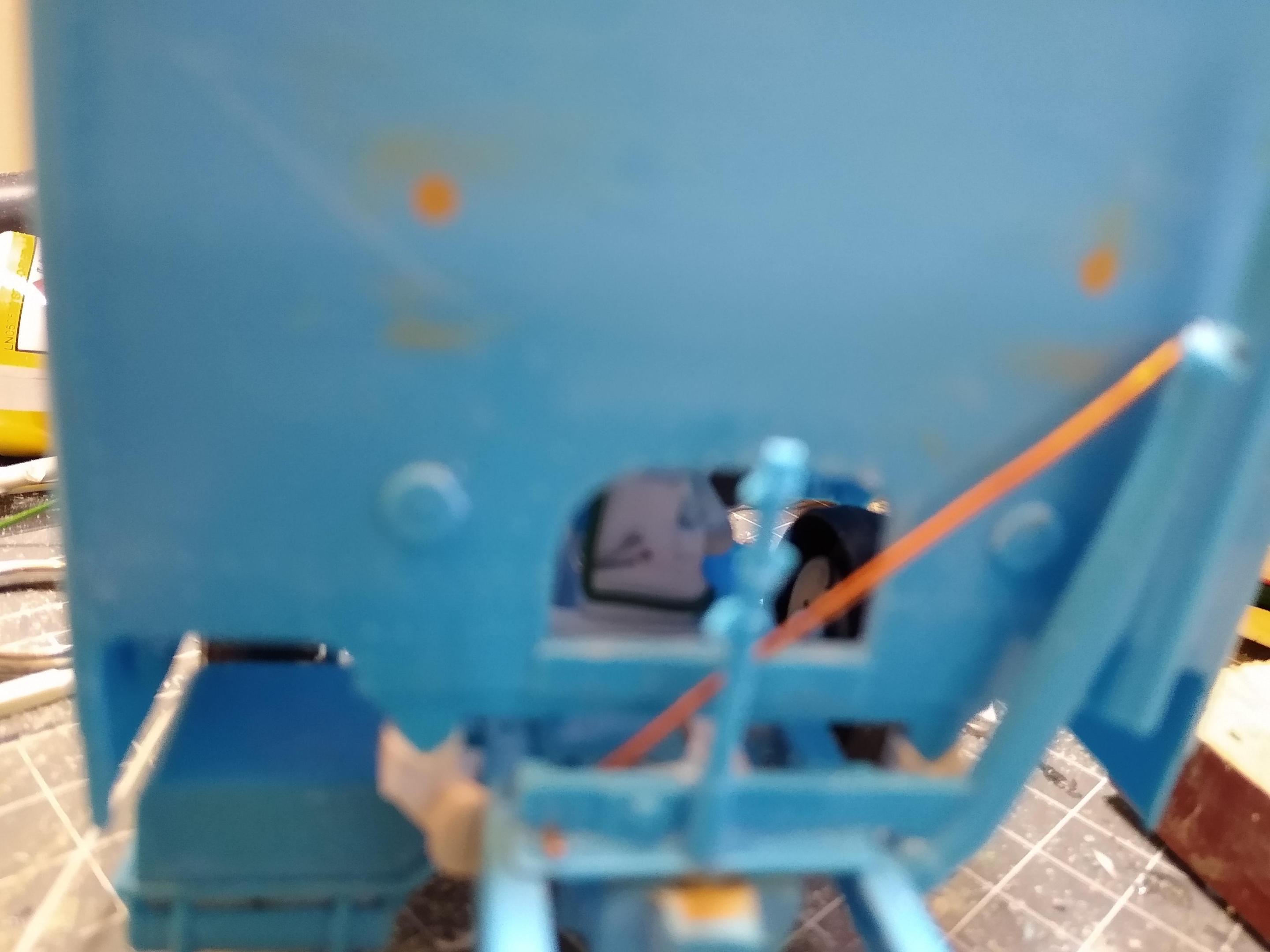

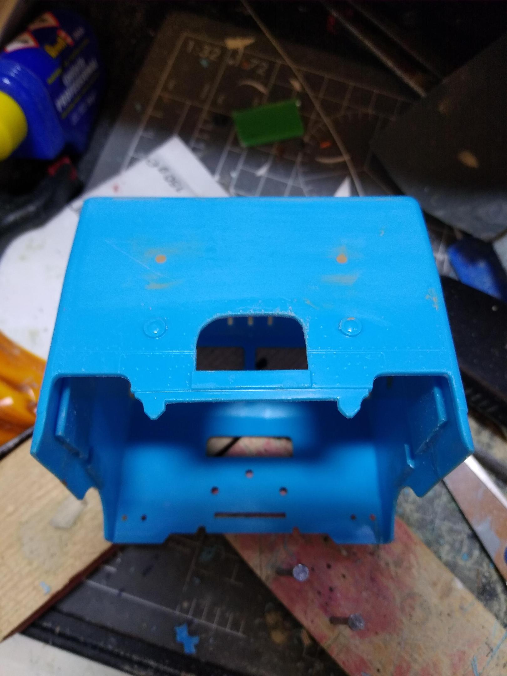

I've always loved the look of the AMT Peterbilt 352 Pacemaker cabover. It's very compact and beefy looking. However, the prices are nuts and I've quite a fleet of 1/32 trucks now so I'd like to stay in that scale. I fell on the Snaptite double sleeper 352 for a good price so I'll have to cut it down and shorten the chassis too. First to reduce the cab to a single sleeper. I decided to cut around the locker door so I don't have a line going through it. It also keeps the air vent and the holes for the grab handles. Quite terrifying but taking care with my marking out and cutting it seems to have gone ok.

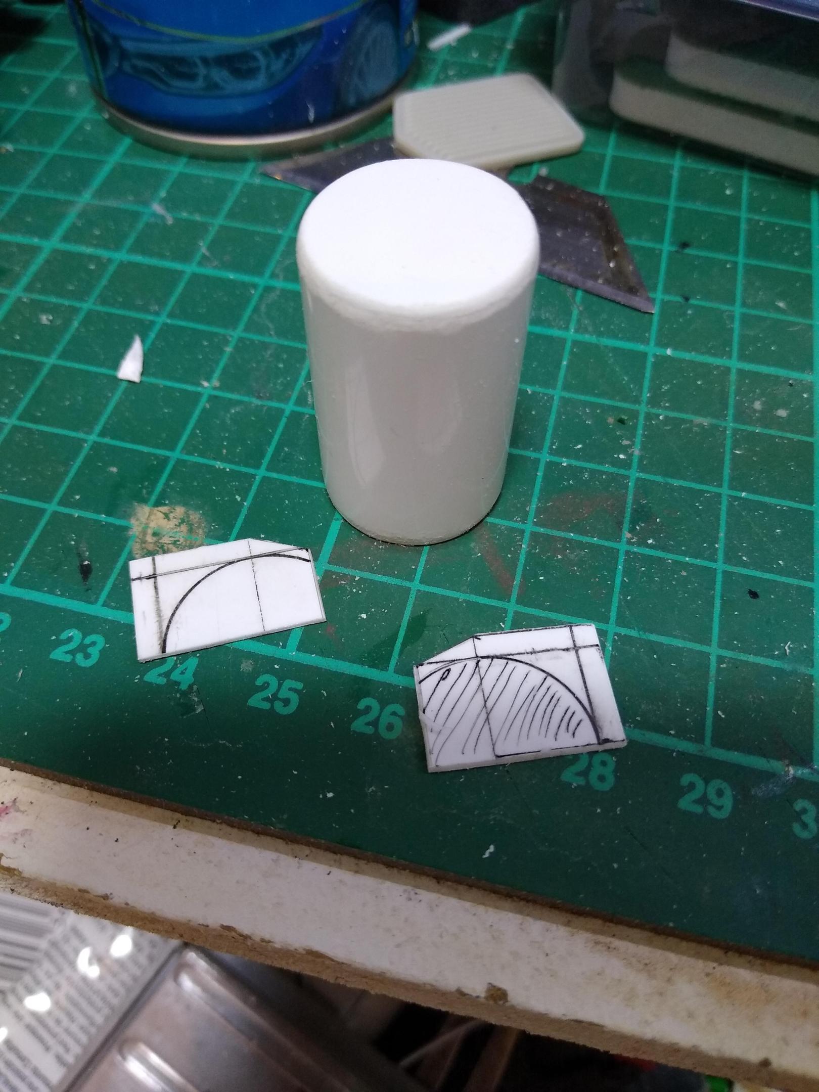

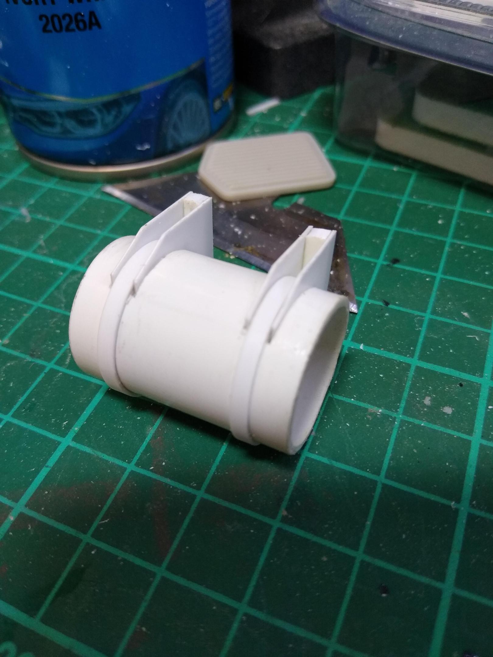

The primer really highlights any flaws in your body work and I knew the rear wall seam would look horrendous after I'd primed the cab. So a couple of skims of stopper and then 800 grit wet and dry paper tidied that up. Fuel tank looked bare after I'd removed the moulded in straps so I made some from plastic sheet and machined a filler cap from sprue. Weather's going to be rubbish this week so won't be able to recoat for a while, but in the background you can see the two built Aerodynes I got off Evilbay for £8 each. They'll keep me busy. I've shortened the chassis on one by a scale foot and it looks "righter" than the stock kit version. -
