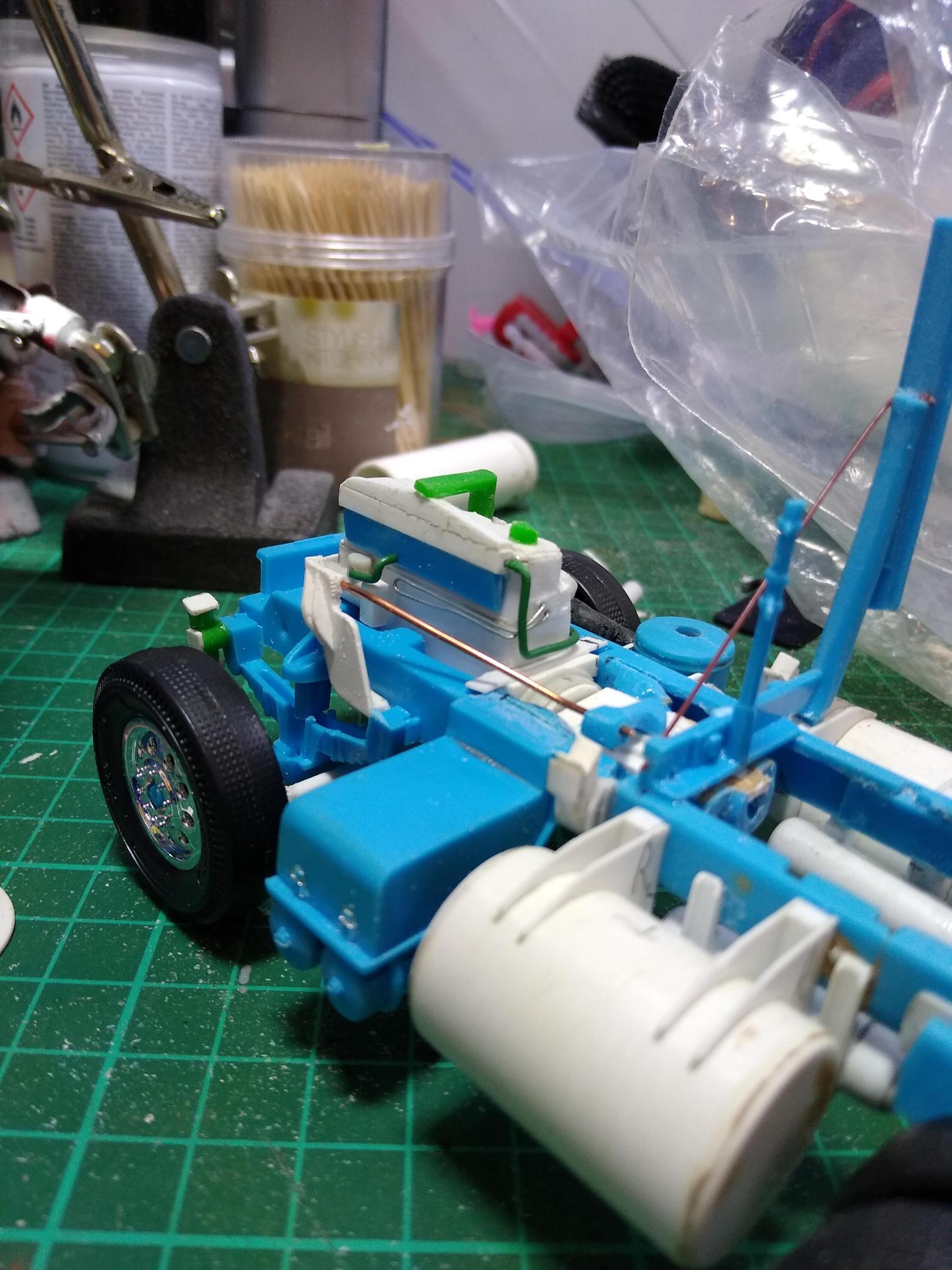

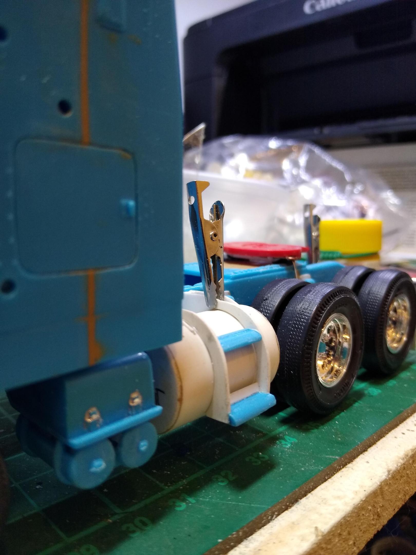

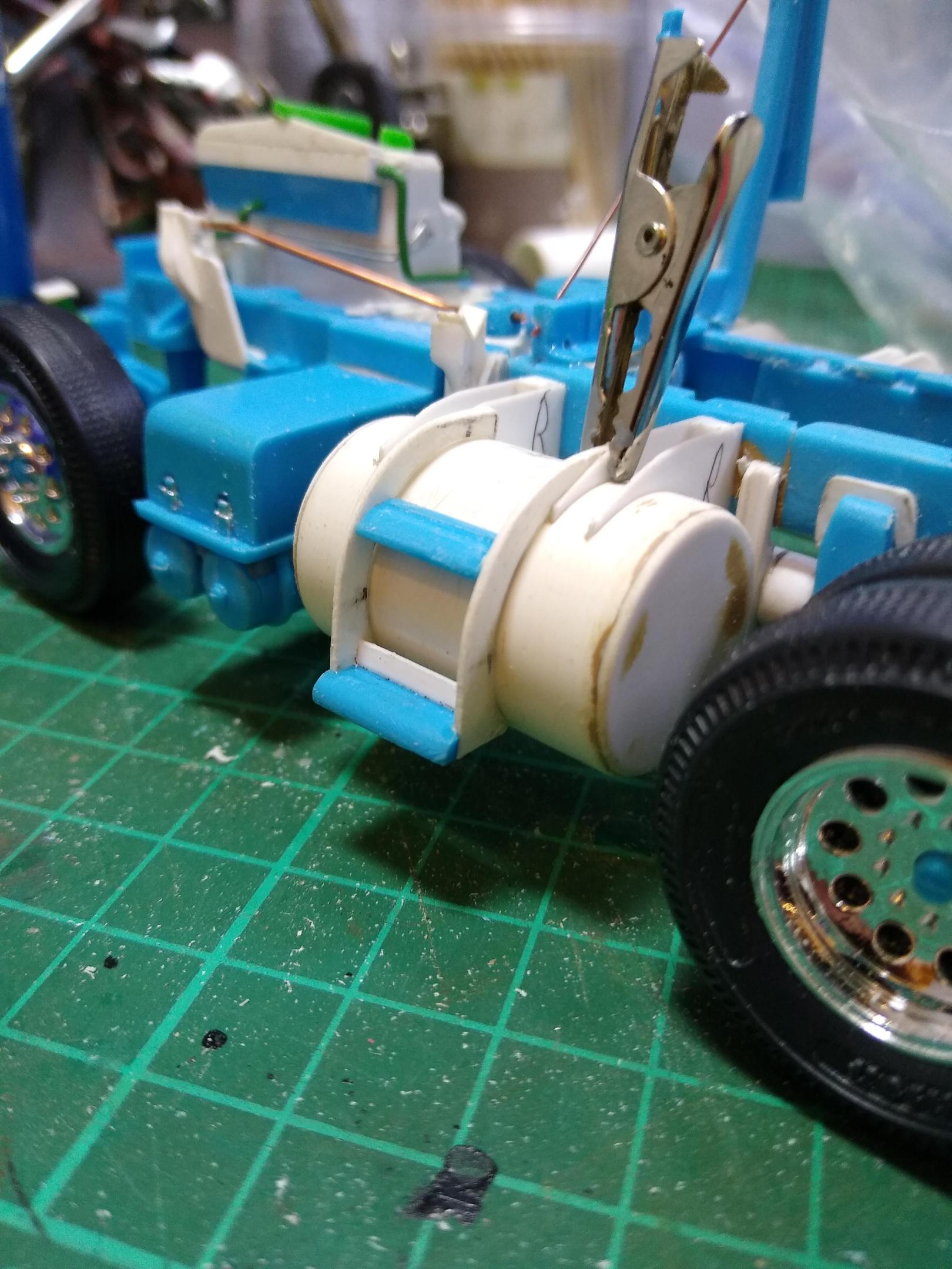

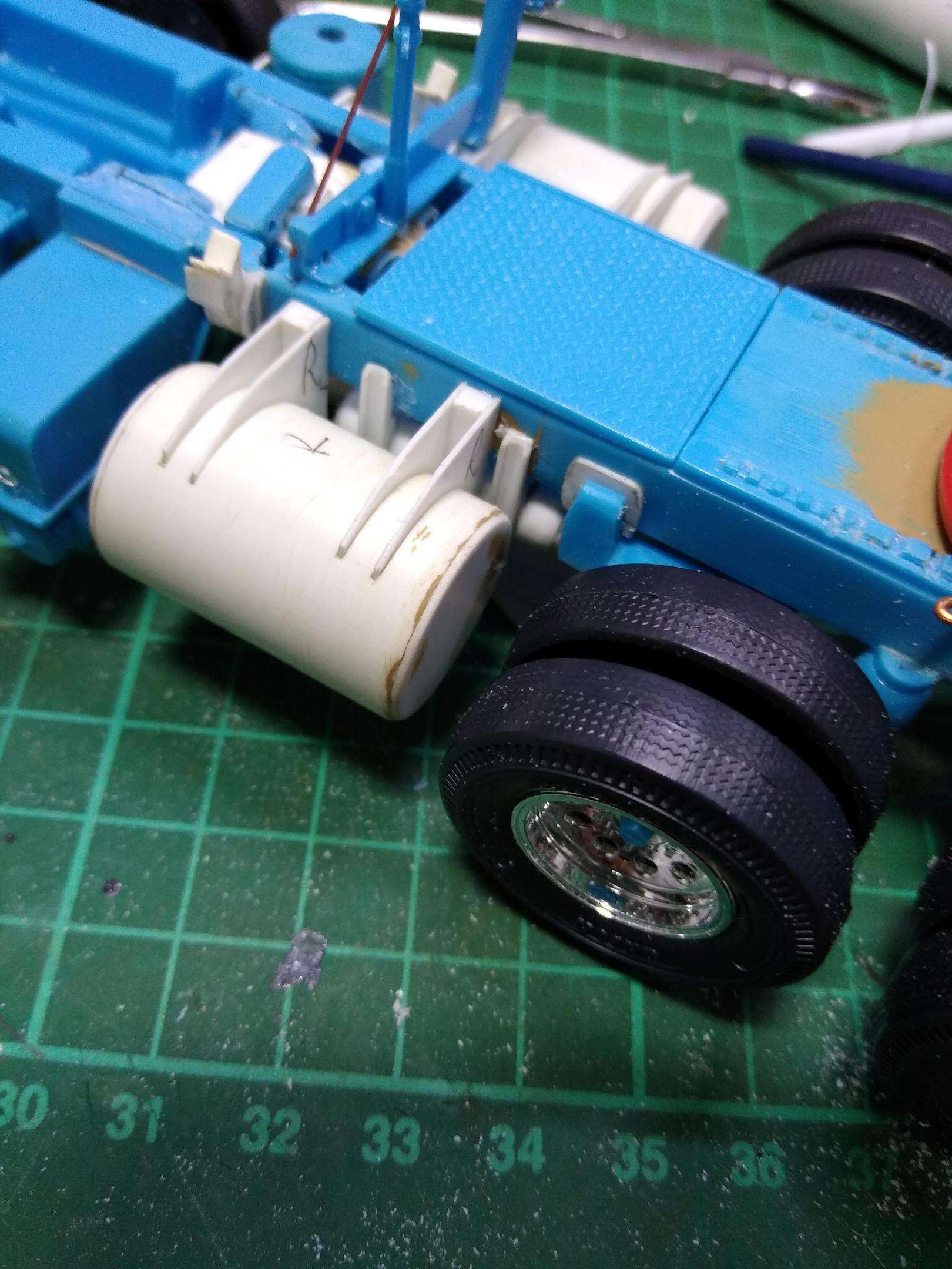

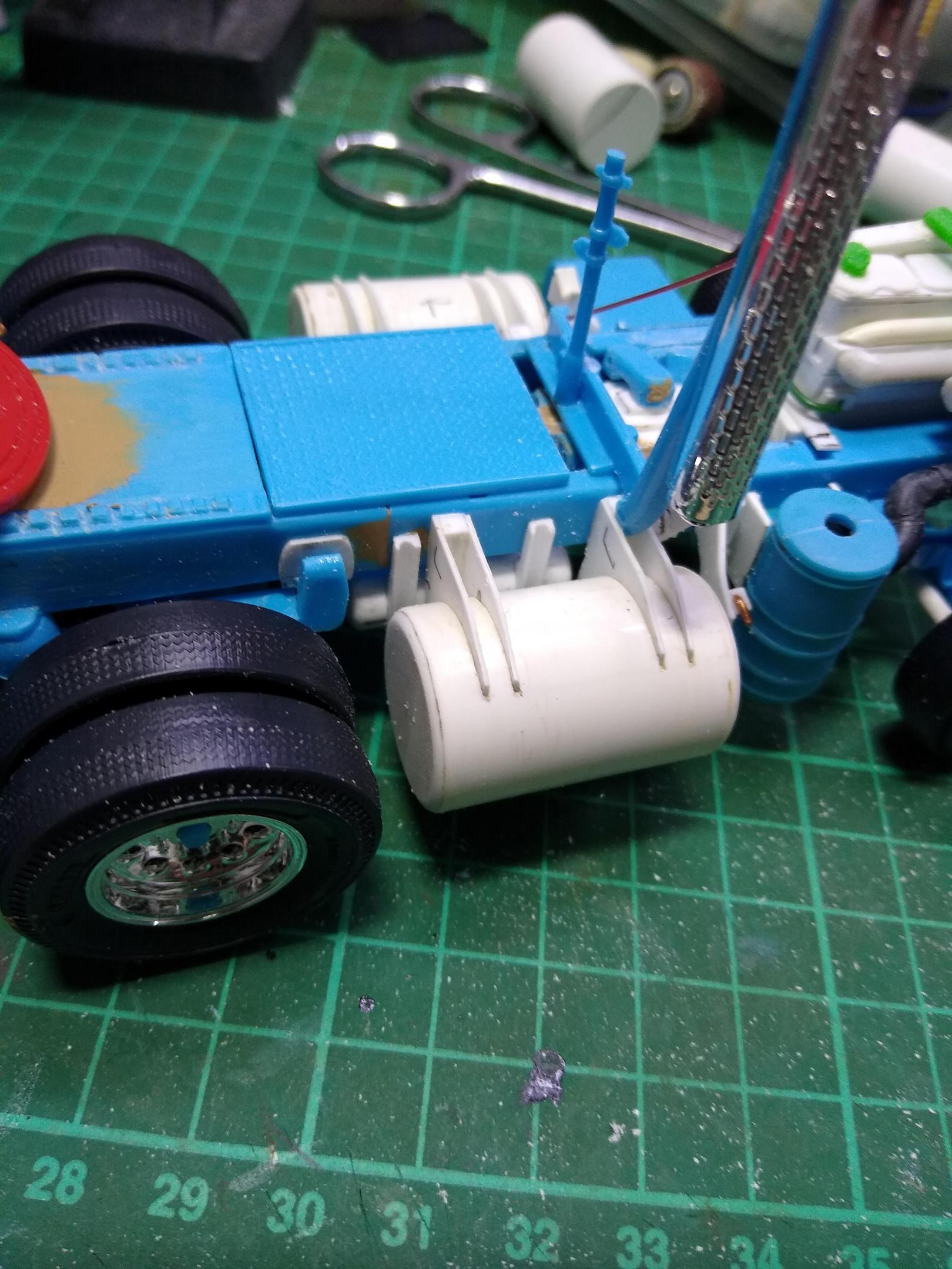

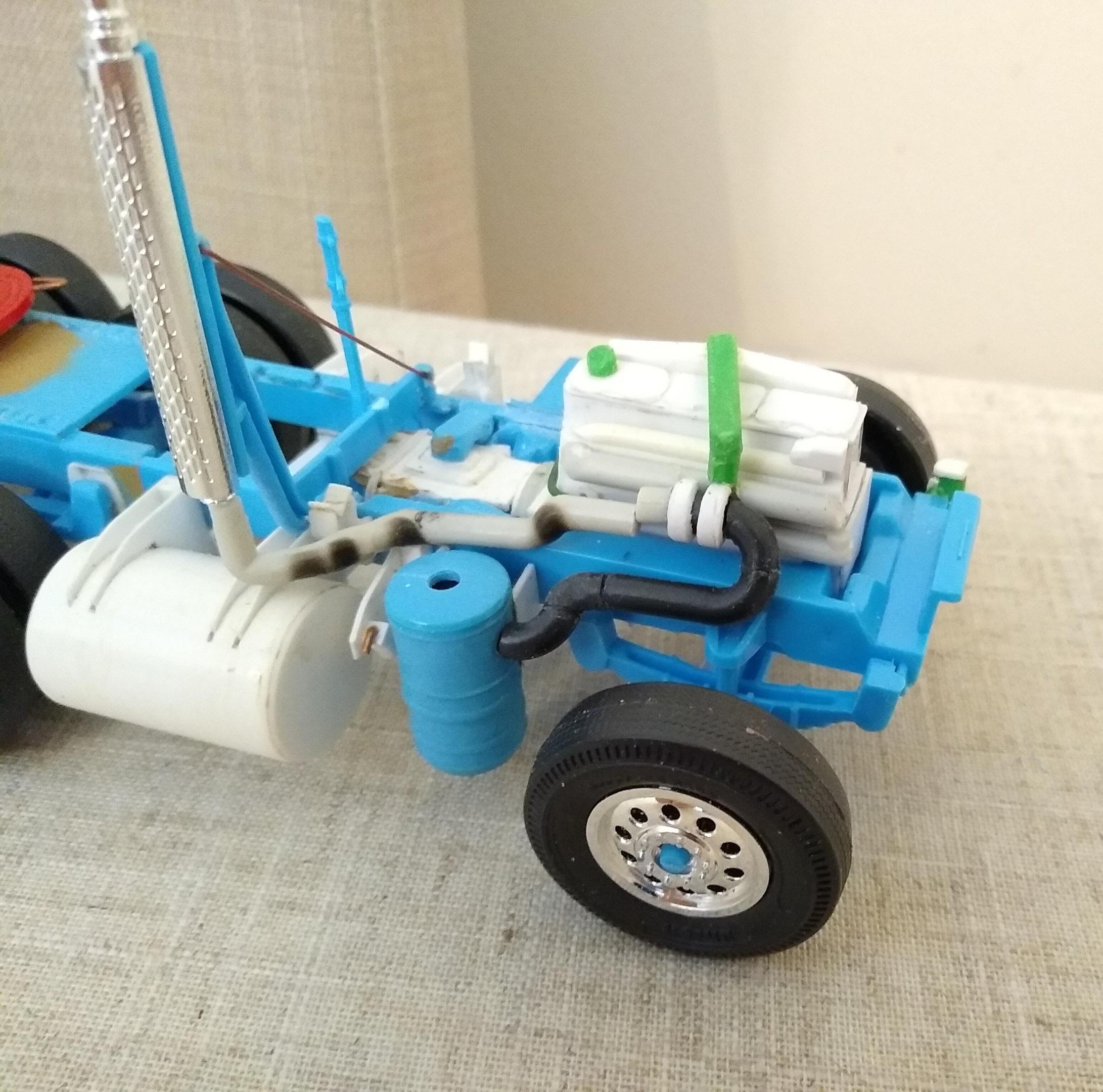

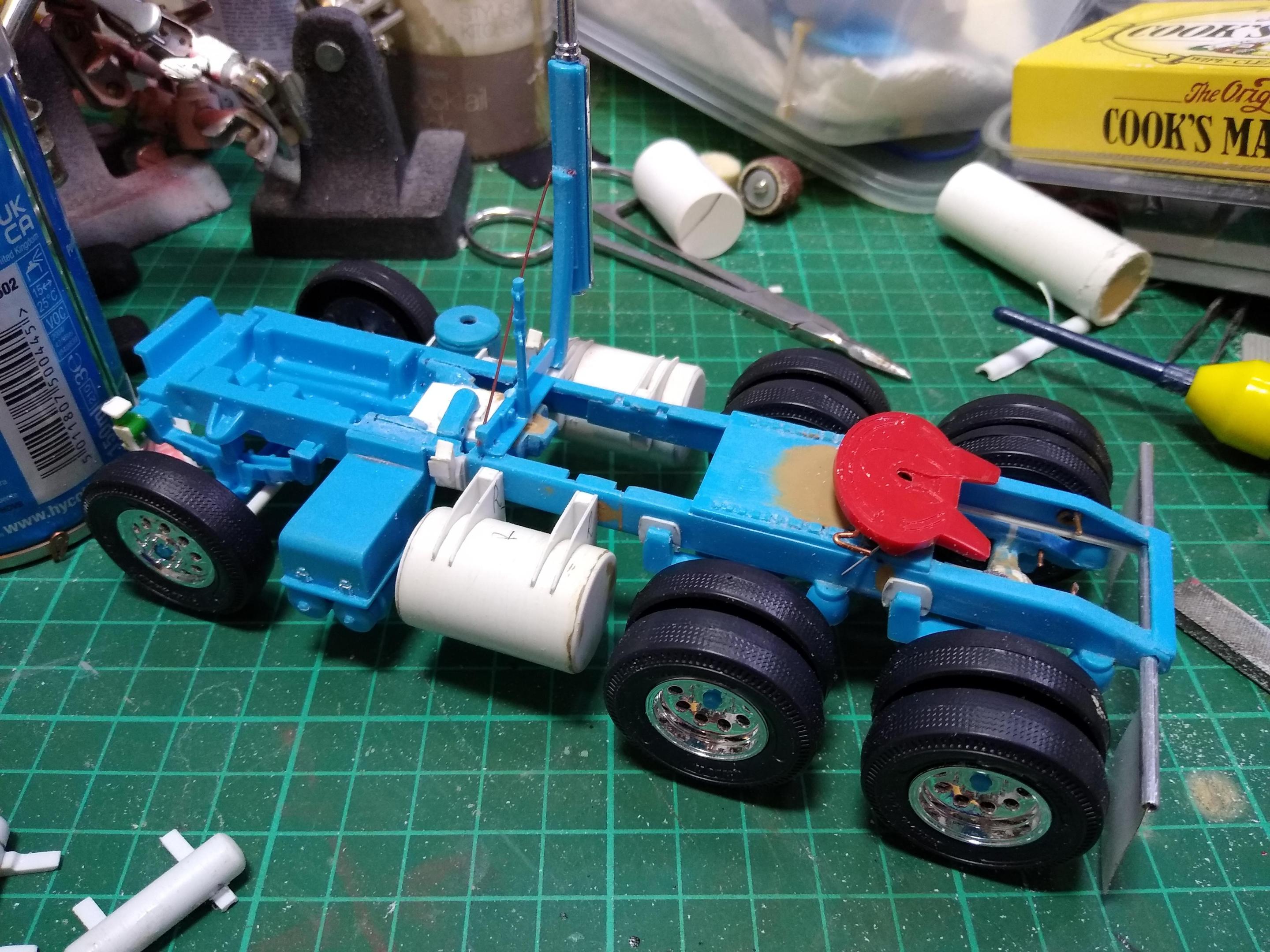

I'm plodding on with this. Added slack adjusters and S-cams for the rear brakes, also turned some brake chambers to install later. Cut out and shaped some brackets for the rear suspension mounts on the chassis. Fitted rear shock mounts and made shocks out of aluminium tube that telescope like a real shock. I'll mount after paint. Bought some 20mm round electrical conduit to use for fuel tanks and made two up. Now drawing up brackets to cut out to support them. Filled the join on the cab and left it for a week before sanding it because it seems to shrink over a few days. Seems to be better this time. -

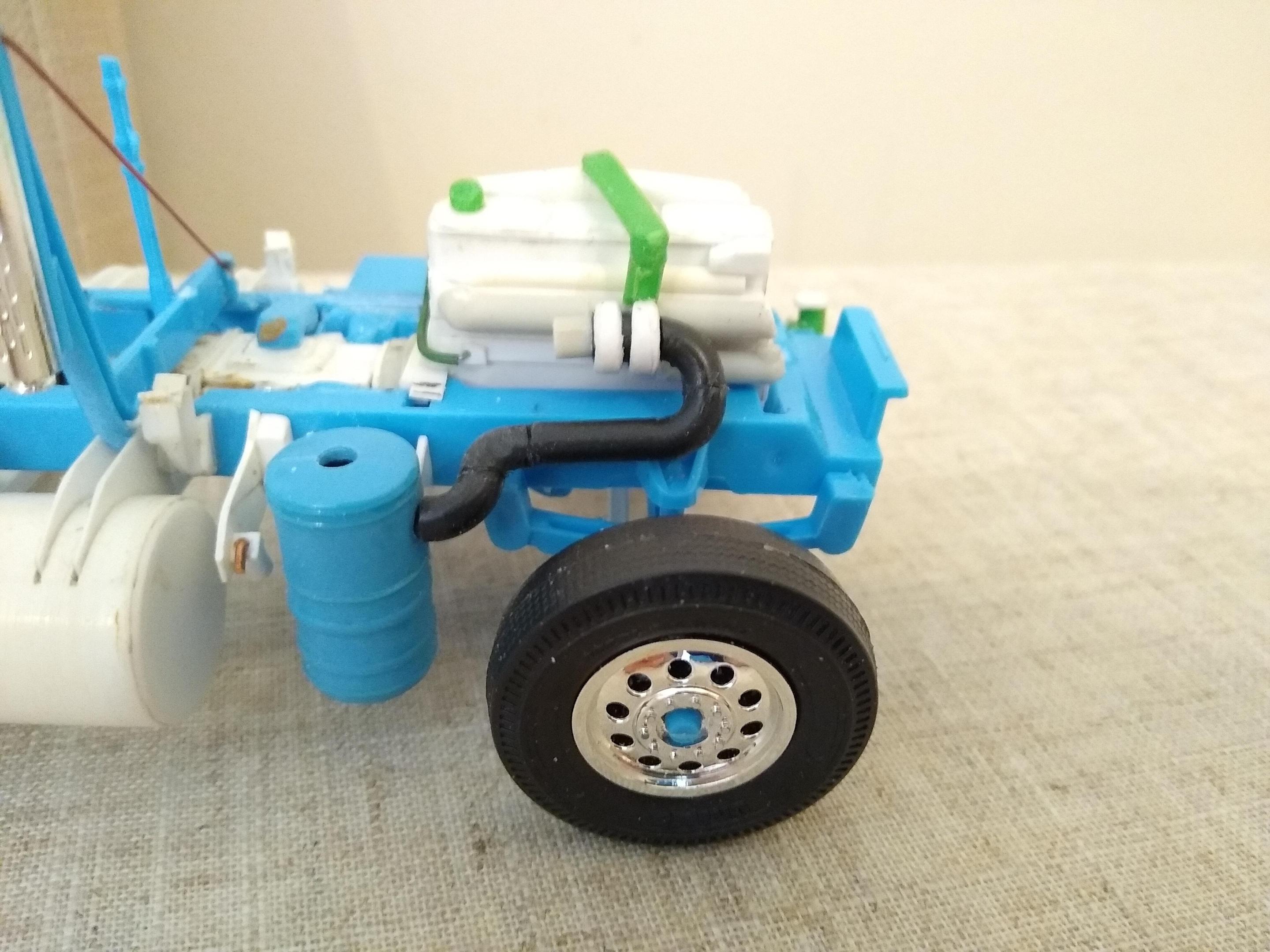

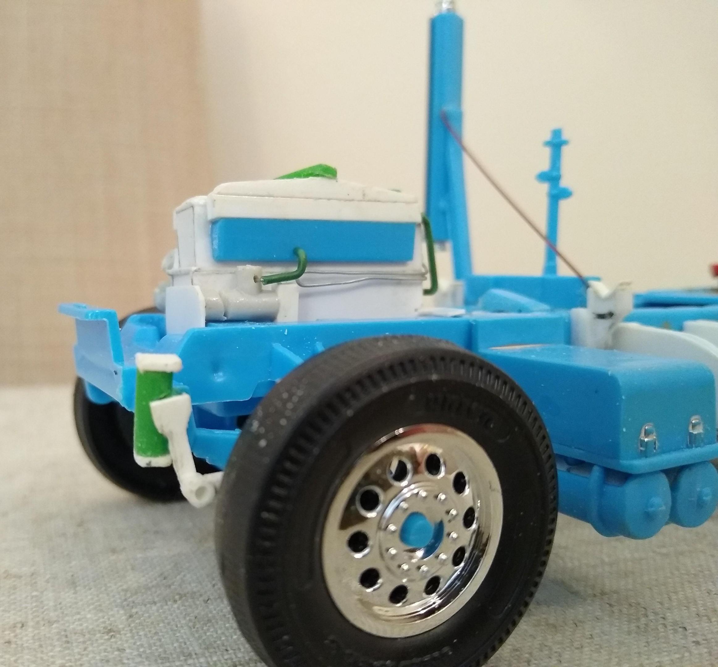

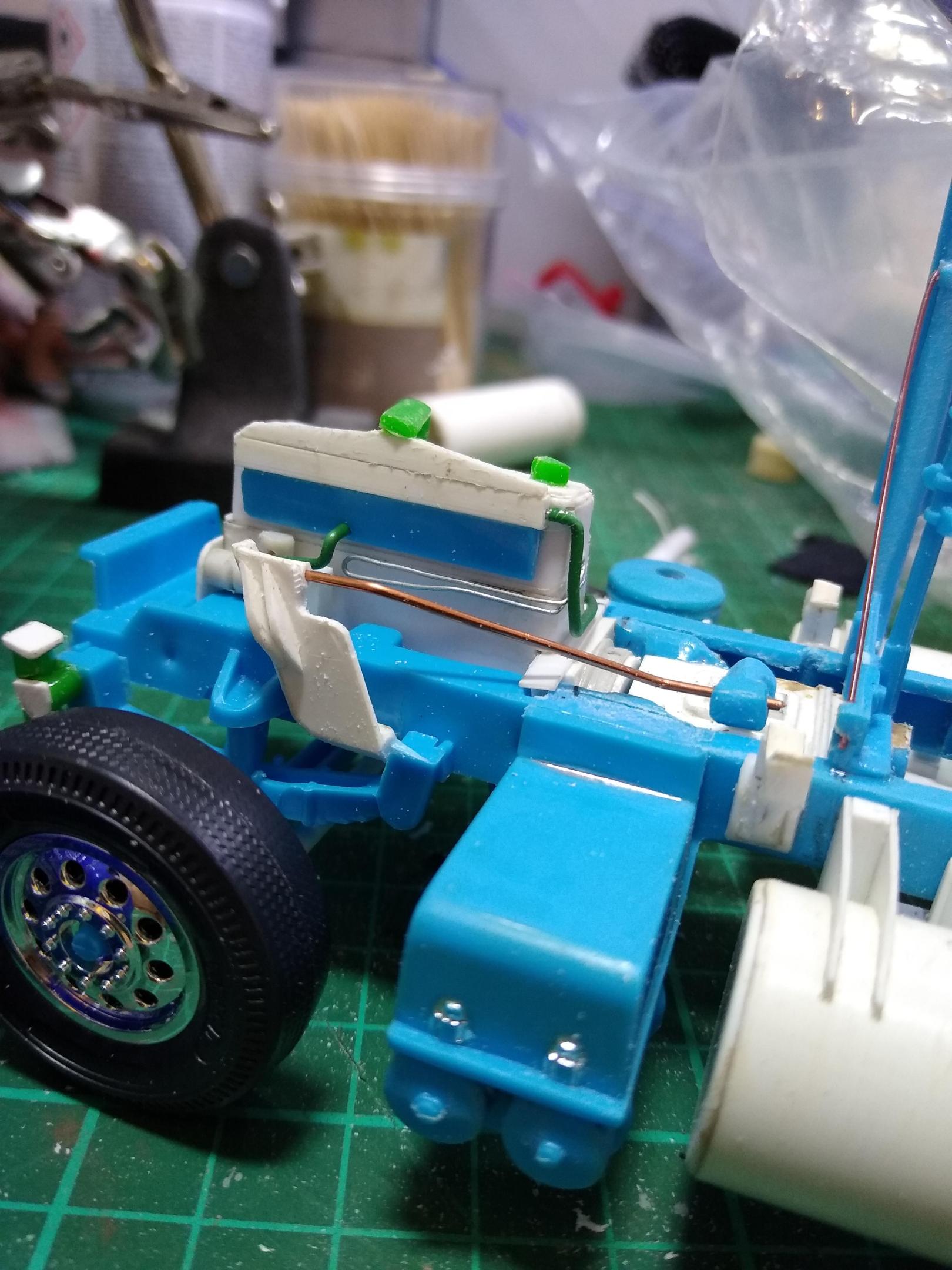

Got a bit more done to the Pacemaker. Added a lower flange to the chassis, used a Camaro alternator for a brake relay valve, filled and profiled the rear axle and suspension arms and installed the exhaust bracket and pogo stick. Mocked up a stack to see how it looks. Still got my usual brake chambers and piping to add, also rear hubs on the drive axles. I like the way the gearbox hangs separately in the frame as it would in the real thing. Also filled and sanded the joint in the cab about three times. Lot more of that to come I think but looks ok. Going to add the intake pipe through the cab on this one. Thinking about fuel tanks now. Don't think I can use anything from this kit or anything else, I'd have to do so much cutting they'd be destroyed. I'm thinking of 20mm electrical conduit but not sure if that would work with any adhesive. ? -

The snap fit design of these kits dictates that function stands over form. For instance, the cab has a hidden locating slot at the front but the rear has two tangs that clip into the chassis. Monogram hid this with the exhaust frame and pogo stick mount but with me just having one stack it's all exposed. So, I took some I beam I had from another kit and rigged up some better rear mounts for the cab, then cut the old locators off, but that exposes the hollow gearbox, so I removed the moulded in piece of frame surrounding the gearbox and formed a lid and selector box out of sprue and plastic card. Looks ok. I also did my first pass with the stopper on the cab seam. I put masking tape either side of the cut so I didn't end up with stopper all over the cab. Not sure whether that was a good move yet. I'll see when I start rubbing down. -

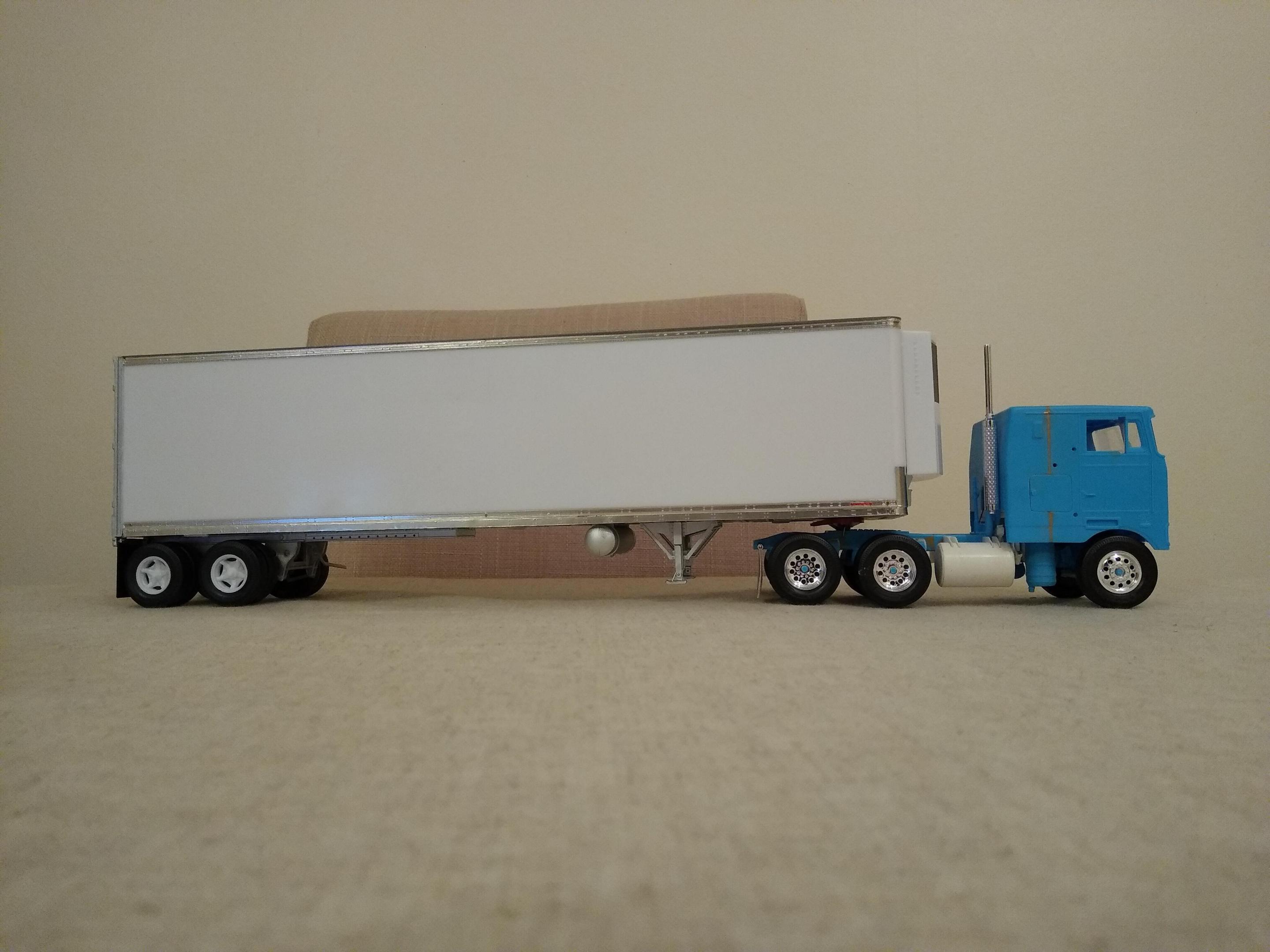

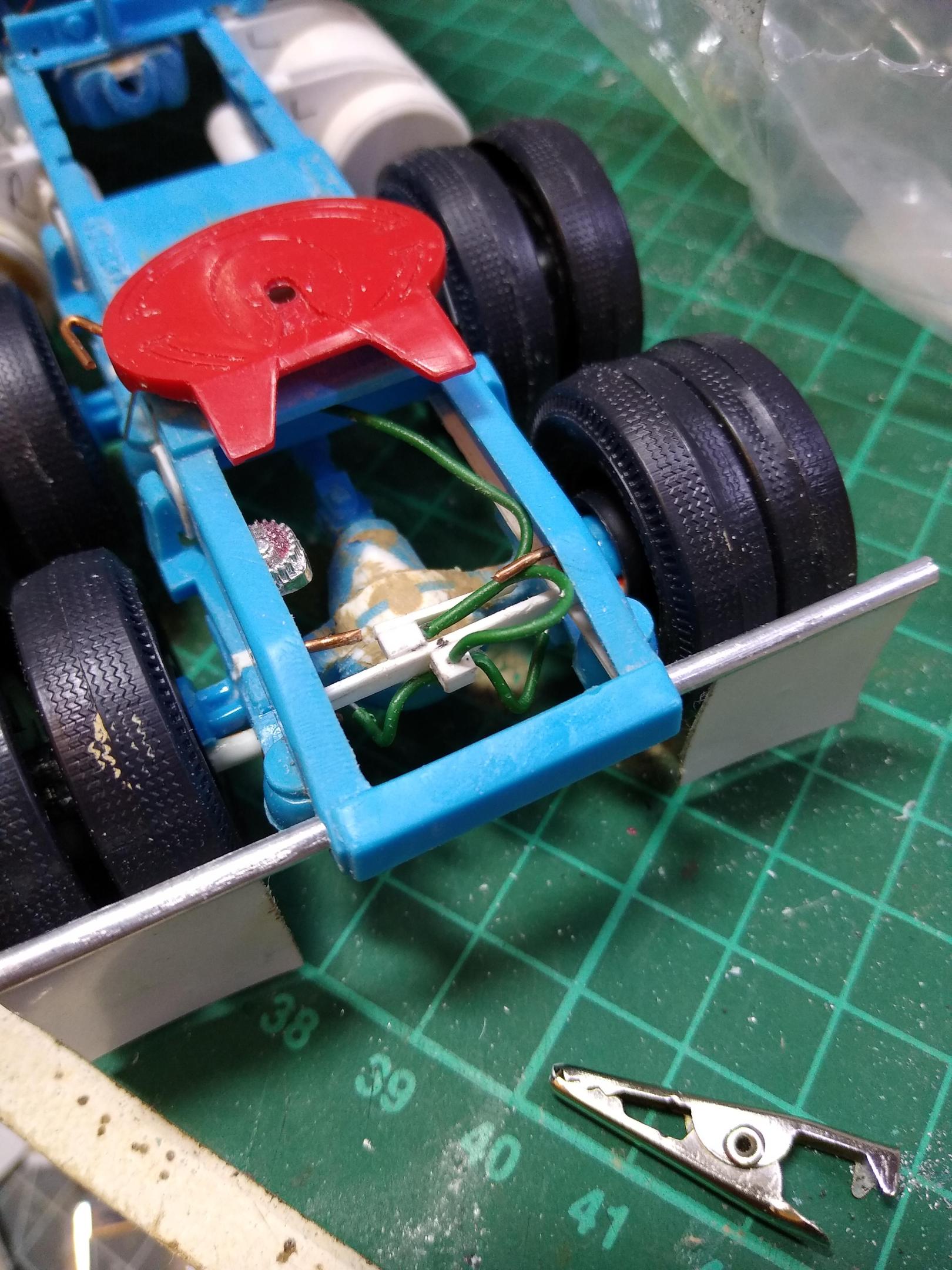

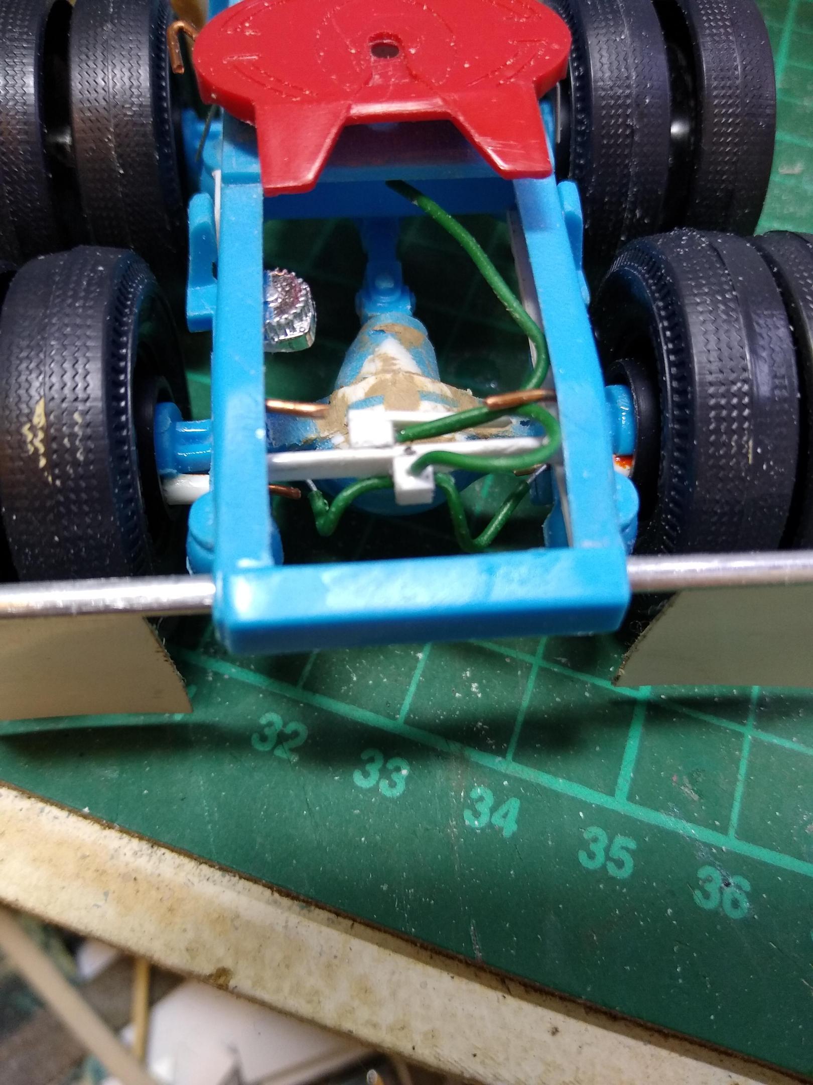

I can't resist a mock-up but I felt I had to this time to determine trailer clearance. I popped the axles and wheels on. Couldn't resist making my mudflaps too. Sat her next to her bigger sister for comparison. -
Thanks gents. Looking at the photos I realised I never posted any photos under any trailers. I also added rear hubs a few months ago, improves the look no end. I do still feel a little sense of pride at how well it turned out because it was my first go at plastic surgery for about 15 years.
