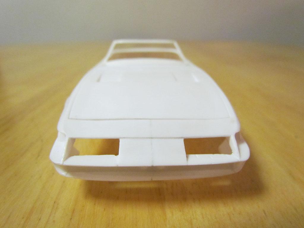

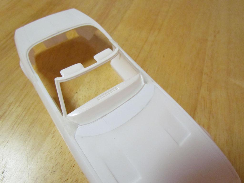

  3. I started working on the head lights. I cut out the openings and filed down the area of the body in between. I'll attach a single piece of .015" clear sheet styrene over the both the headlight openings and the center section. Below I attached a picture from a Miami Vice episode showing what this area looks like without the clear cover. I also attached the picture from my post above showing what it will look like with the clear piece installed. I won't attach the clear styrene until after the body is painted. A couple of progress pictures are also posted showing the work so far on the head light area as well as a picture showing the hood extension progress so far. The rear of the hood looks a bit off, but that's just an illusion caused by the wide angle picture. It's all nice and even with the windshield.

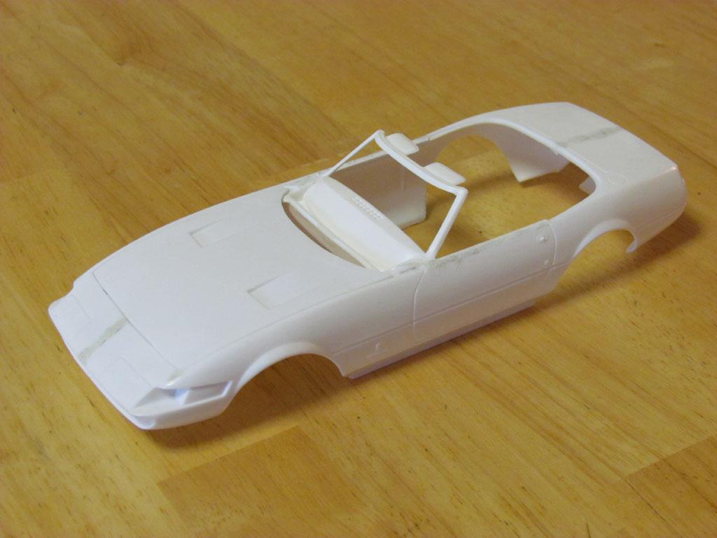

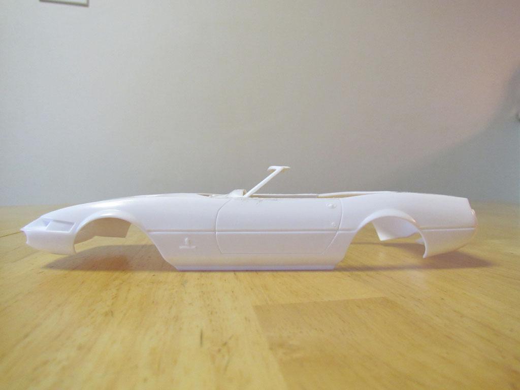

  8. I did a quick mockup today to make sure the chassis fit OK. I narrowed the chassis' front wheel wells by 2.5 mm on each side so it now fits nicely. Since Monogram made the Daytona body the correct width(to a real Ferrari) the body was actually 5 mm wider and there was a space on both sides of the chassis. It looked and fit terribly. Now that I narrowed the body it fits nice and snug to the chassis. The Corvette interior tub now fits really well too. I still have to lengthen the hood to meet the windshield. In the 2nd picture the front appears to be sitting slightly higher then the rear but it is just placed together for the pictures. When I hold the chassis tighter against the interior tub it sits nice and level. I also have to put a styrene spacer between the rear of the interior tub and the chassis since the chassis has nothing to attach to in the rear. The one thing I'm not crazy about is the profile of the tires. They are slightly too high but not too bad. If anyone has a spare set of 1/24 tires in a slightly lower profile then the Monogram tires please let me know. I don't think 1/25 scale tires will work with the kit's 1/24 scale wire wheels. Mike.
  9. Thanks everyone for all of your encouraging words! So far this is a fun project to work on. I'm still trying to decide if I should make the fixed headlights behind the acrylic glass covers or not. I have the head light parts but can't quite figure out how to make the clear covers. I'm thinking maybe attach clear styrene sheet over the headlights and just mask it off before painting the body. I'm sure there are any number of ways to do this. If anyone has any ideas on how to make and attach the clear headlight covers please let me know. Pictures are also welcome. Here is a picture showing the clear headlight covers.

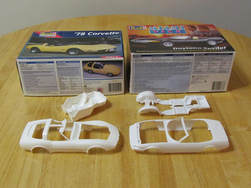

  10. I'm attempting to build a model of the McBurnie 'Ferrari' Daytona Replica that was used on Miami Vice. I'm combining a Revell/Monogram 1/24 Miami Vice Daytona Spyder kit with a Revell/Monogram 1/24 '78 Corvette kit. The Miami Vice Daytona kit is actually based on the Monogram 1/24 '78 Corvette's chassis. When Revell(then Monogram) made the Miami Vice Daytona kit they got it half right. It has a C3 Corvette chassis and drive train but the 'wrong' body. Well the body isn't 100% wrong. Instead of taking measurements of the kit car(McBurnie) body, they instead took the measurements of an actual Ferrari 365 GTS/4 Daytona. The kit's body is actually correct to a real Ferrari(including the Ferrari windshield and frame) and correctly scaled in 1/24, only the wheel base was lengthened 4mm to match the Corvette kit's longer wheel base. The kit also included a 'correct' Ferrari Interior. These features always bothered me about this kit and kept it from looking like the replica Daytona car used on the TV show. The McBurnie(built by McBurnie Coachcraft) replica used on Miami Vice had a basically stock Corvette interior. The dash was slightly modified and the seats were re-upholstered in the pattern used in a real Ferrari but they are still Corvette seats and it incorporated the Corvette windshield as well. A C3 Corvette is similar in measurements to a Ferrari Daytona however a Corvette's wheel base is roughly 4.5 inches longer. The funny thing is the width of both a Ferrari Daytona and a C3 Corvette is basically the same when measured from the wheel opening lips(not the actual body). Now this is where it gets tricky. A C3 Corvette has a 'Coke' bottle shape so the width of the cowl/doors(actual width of the car) is about 5 inches narrower then a Ferrari Daytona. The Corvette's wheels actually stick out further then the actual body thus the fenders and quarter panels 'bubble' out to accommodate this and give it the 'Coke' bottle shape. It's a really nice feature of the Corvette and gives it it's unique appearance. Due to the 'Coke' bottle shape of the Corvette, the body of the McBurnie Daytona Replica is 5 inches narrower(since it's fenders and quarter panels don't 'bubble' out like a 'Vette's). What (Tom) McBurnie did to compensate for the narrower body(and wheels sticking out) was to flare the wheel openings' lips a bit. I think it actually gave the car a cool look. On to my build... I started by narrowing the Ferrari's body by 5 mm and attached the Corvette's windshield frame. On an actual Ferrari 365 Daytona the windshield frame is flush with the door skins. On the McBurnie replica Daytona the door skins are a couple of inches wider then the windshield frame. Instead of cutting the hood in the middle as I did with the body, I removed 2.5 mm from each side. I did it this way since the 2 hood scoops(indentations) are actually closer to the sides on the McBurnie replica then on an actual Ferrari. I'll be adding a piece of styrene to the rear of the hood to extend it to the windshield. I also added some 1.5 mm styrene strips to the sides of the Corvette interior tub as well to give the door panels a bit of width. I'll be adding the flared wheel openings too and most likely will extend the rear of the doors back. I did a lot of research for this build and learned a few things about the McBurnie replica and the C3 Corvette in the process. On the TV show Miami Vice, there were 2 cars used, both McBurnie Coachcraft replicas. The 'Beauty' or rather Camera car(Car 4) and the stunt car(Car 1). Car 1 and Car 4 are just numbers McBurnie gave these cars when they were built. I'll attempt to make this build resemble Car 4 since it was the car used for close ups but I'm not going for an exact build, but something close. Here are some pictures of the build so far: Here are some pictures of actual McBurnie Daytona replicas for comparison:

  21. Does anyone have a Monogram/Revell Miami Vice Daytona Spyder and a Fujimi Ferrari 365 GTS4 Daytona Spider kit to compare the size of the bodies? Revell/Monogram used the 1/24 scale Corvette chassis to make the Miami Vice Daytona. The 'Ferarri' Daytona body they used is based on an actual Ferrari and not the kit car used on the TV show. However an actual Ferrari Daytona 365 is approximately 5 inches wider and 5 inches shorter then a Corvette. I believe Revell/Monogram may have enlarged the Daytona body to stretch the wheel base to fit the Corvette chassis. I'm thinking that maybe the Revell/Monogram 'Ferrari' Daytona body is actually slightly larger then the Fujimi Ferrari 365 Daytona Spider body. Anyone have these 2 kits for comparison?
