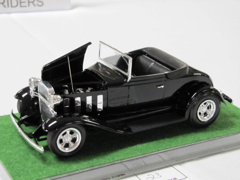

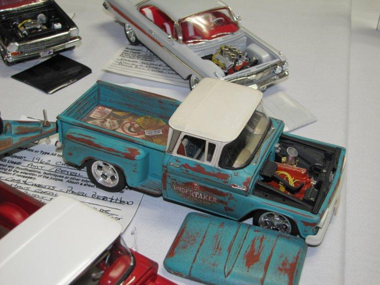

A handful of pics from yesterday's show. Unfortunately, no longer have my Fotki so cannot share all. -
