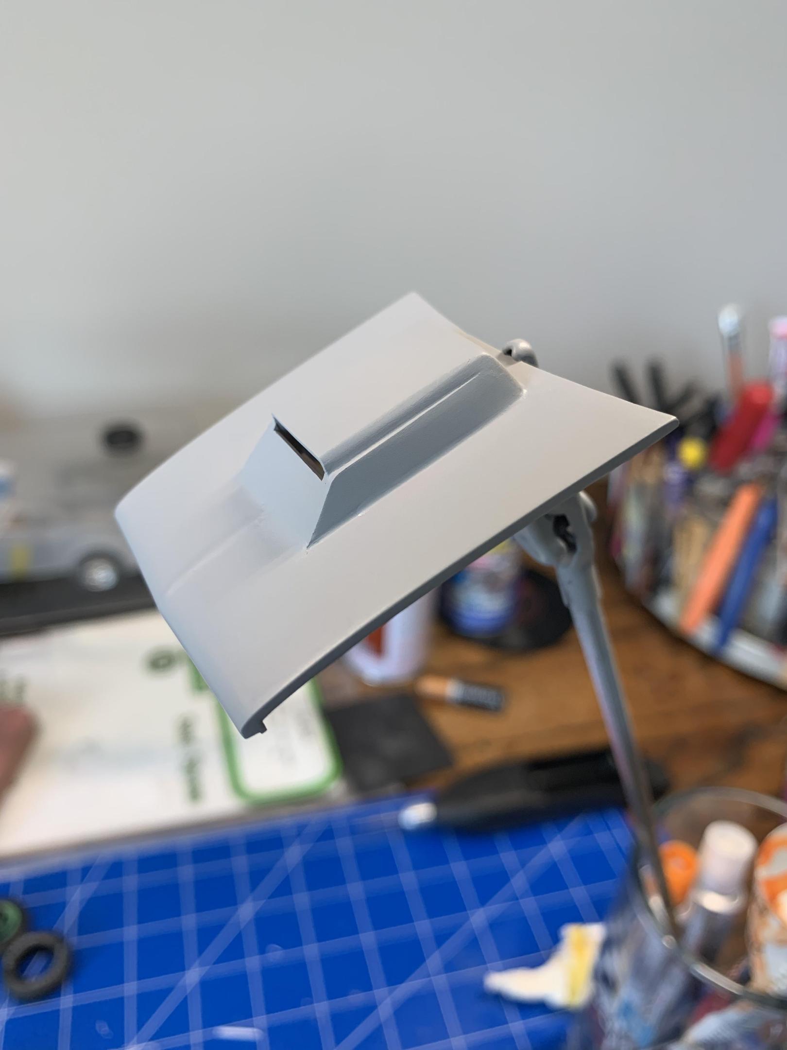

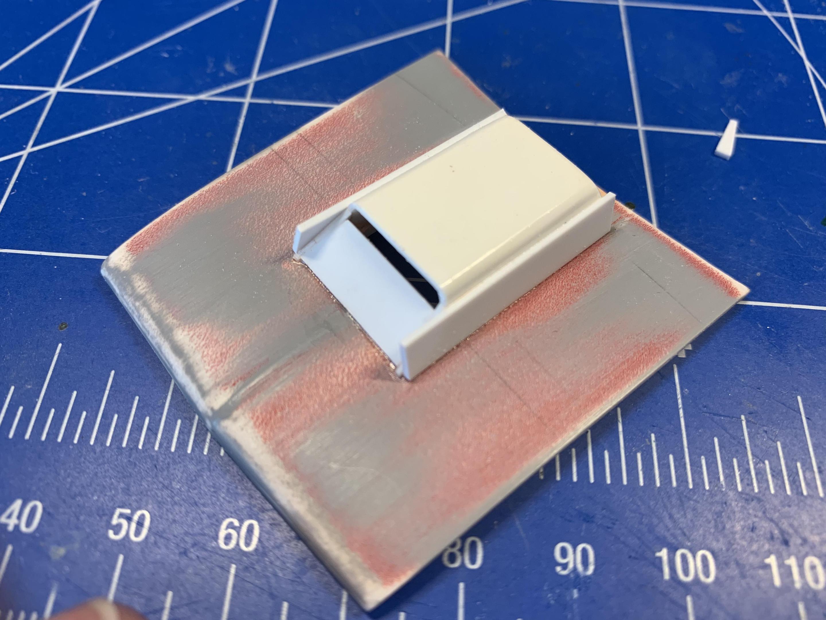

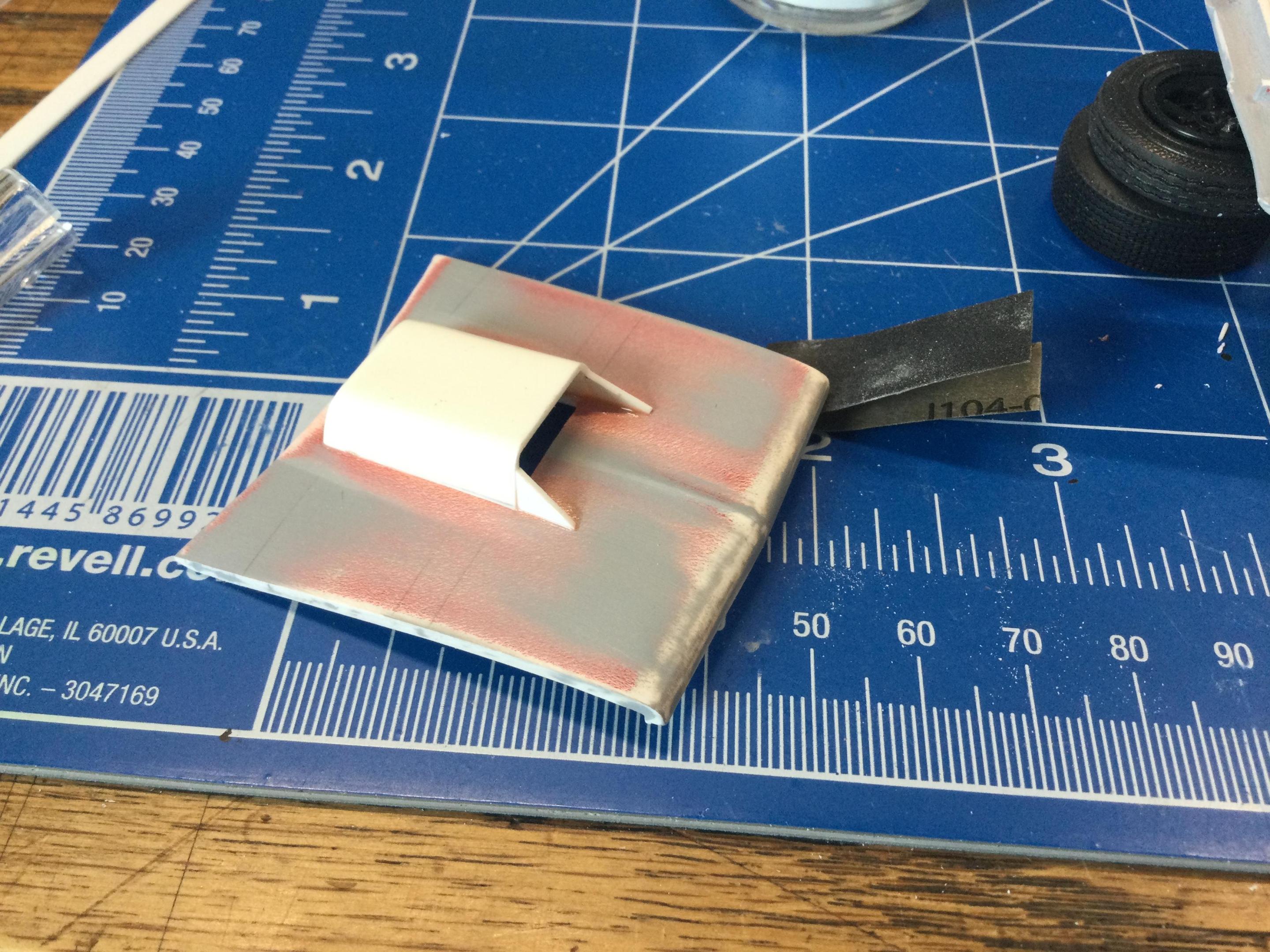

  5. Slow progress update. Scratch built hood scoop. I need to clean up the edges.

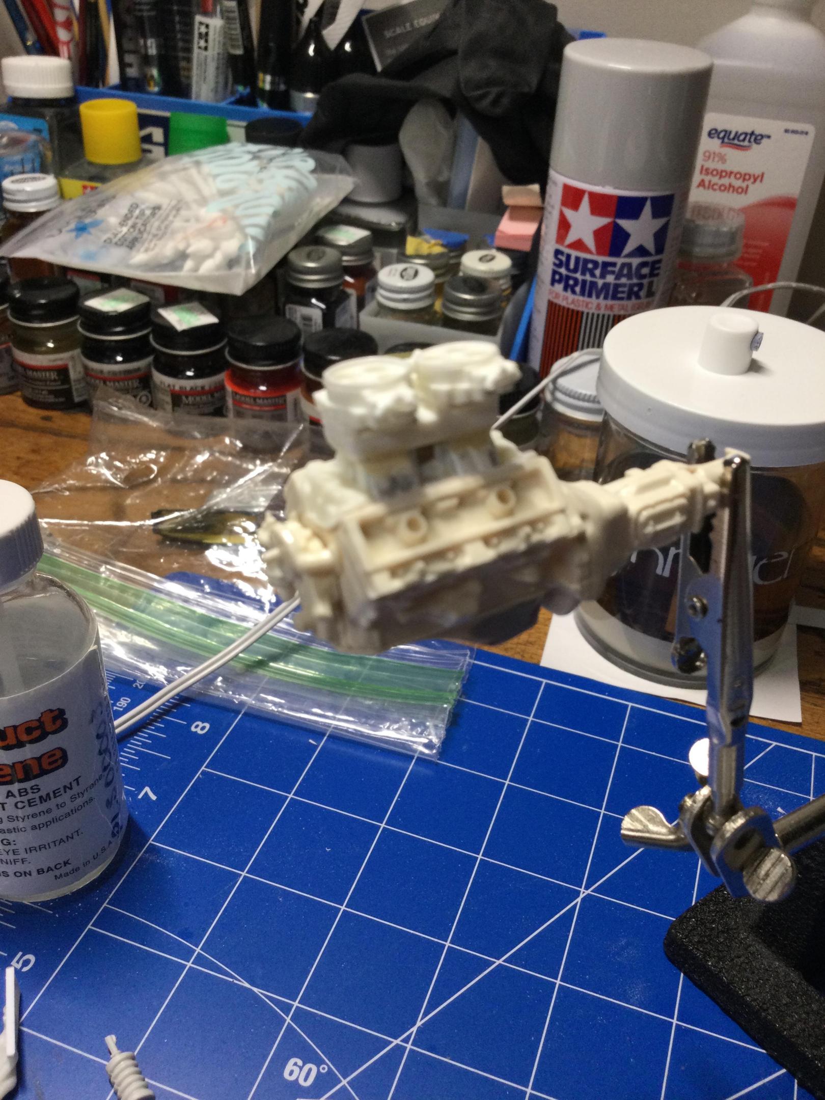

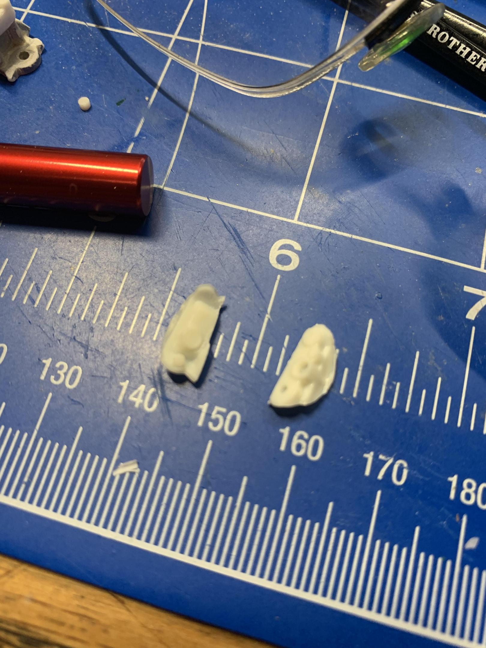

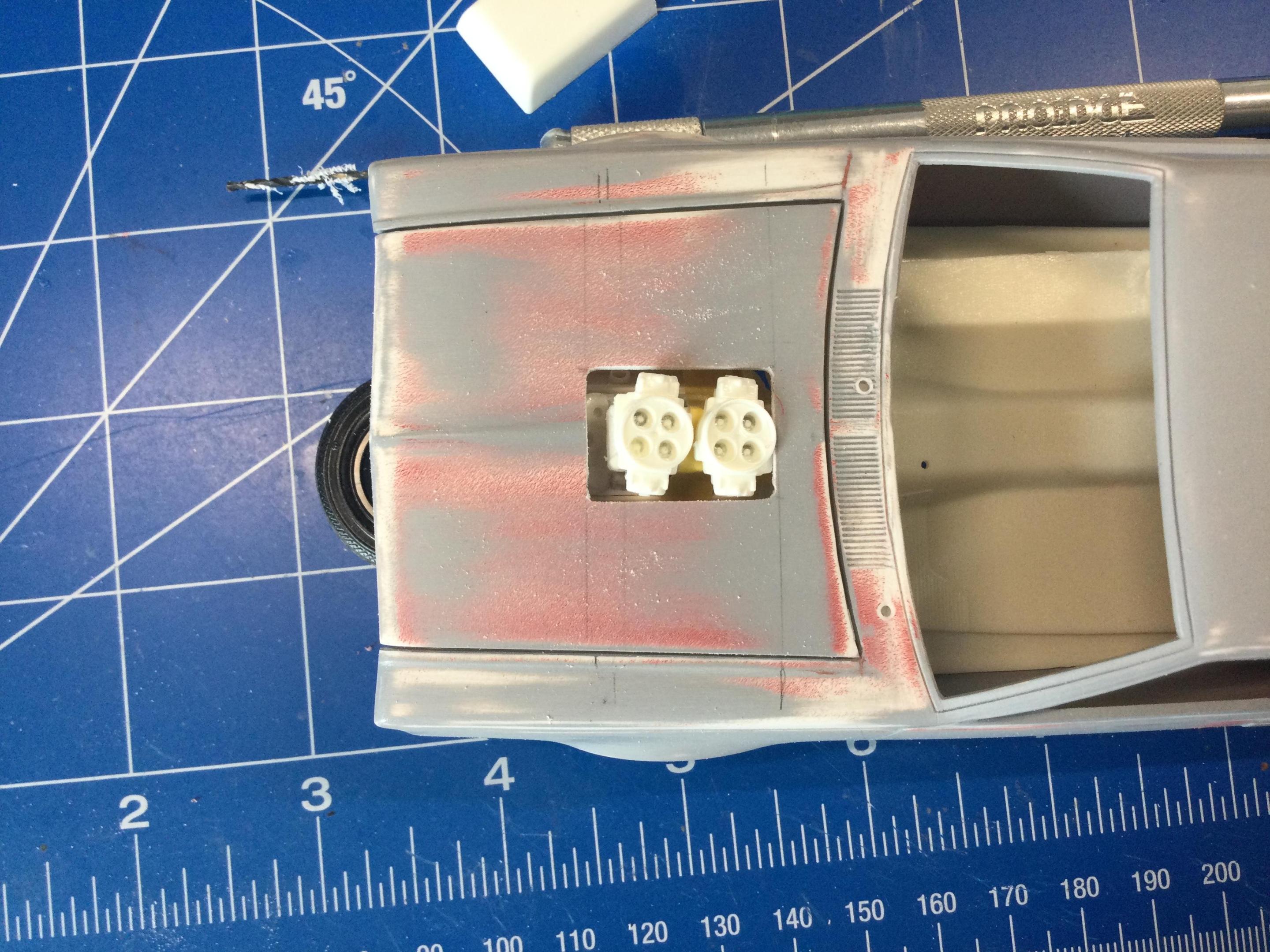

  9. While waiting for the chassis mods to dry, I started on the tunnel ram. The Johan AMC motor has a deep curved lifter valley. A tunnel ram comes in the Gremlin kit but the lifer valley is flat and it’s too tall. I started with the duel quad intake from the 53 Corvette and added the plenum from another tunnel ram. The scrap Matador kit had a single 4 barrel intake the matched the curved valley. I cut the ends from the 4 barrel intake and put the AMC ends on the Corvette manifold. The 1/1 car had modified tunnel ram hobbled together by AMC, and this looks similar to theirs.

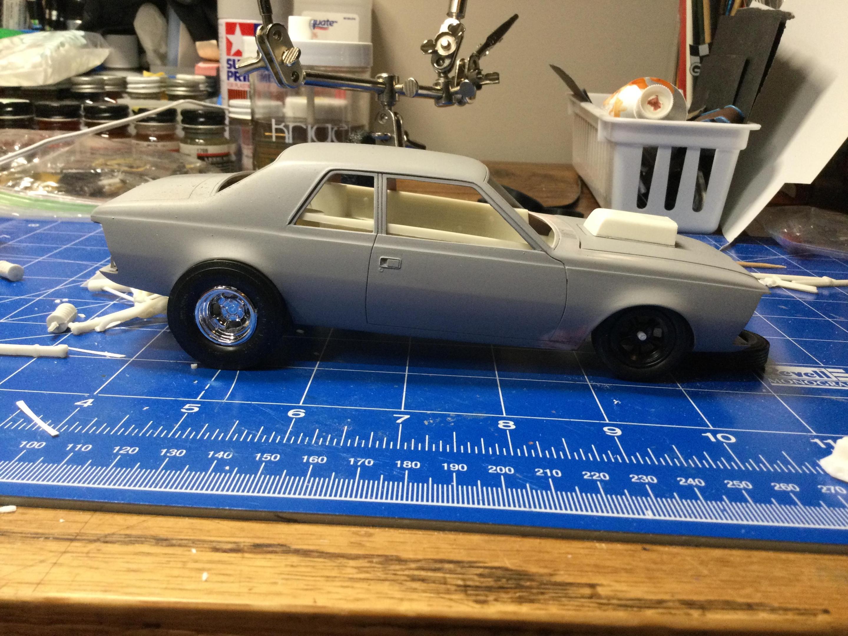

  11. I think the front is a little low and I still need to raise the rear a smidge and get the body off the tires.
  12. I forgot to post the in progress stance photo.

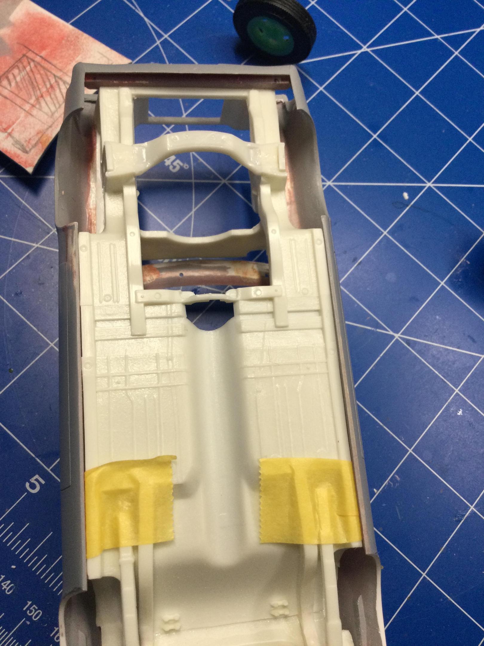

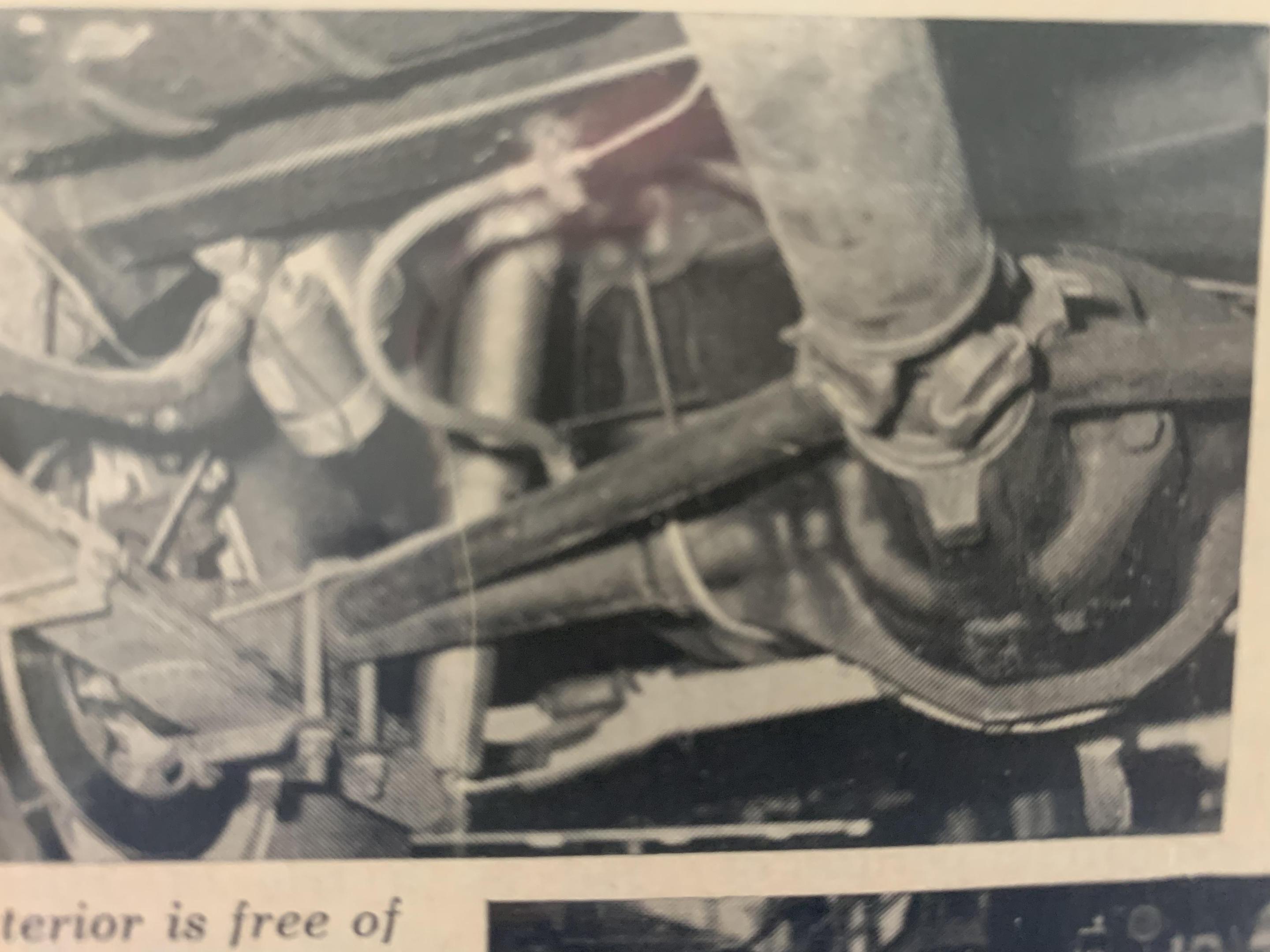

  13. Stance, Ride Height, whatever you call it, can make or break a model! Get this wrong and it just won’t look right. All the detail in the world isn’t going to help if at first glance the model doesn’t appear realistic sitting there. I try to find a good photo of the car sitting still, and pay attention to where the center of the wheels are in relation to the body rocker panels. Is it above or below the rocker panel and I try to place the wheel centers accordingly. I also try and match tire sizes. If I can obtain the correct tire/ slick size, I measure different kit slicks and conversion the measurements to 1/1 scale. On the real car, according to my reference material the rear springs were moved inboard into the rear frame rails for additional tire clearance so I starter these modifications by notching the rear rails and filling the original spring mount holes with styrene. The Dana Rear axle housing was also braced, so I added the braces using Plastic Rod.

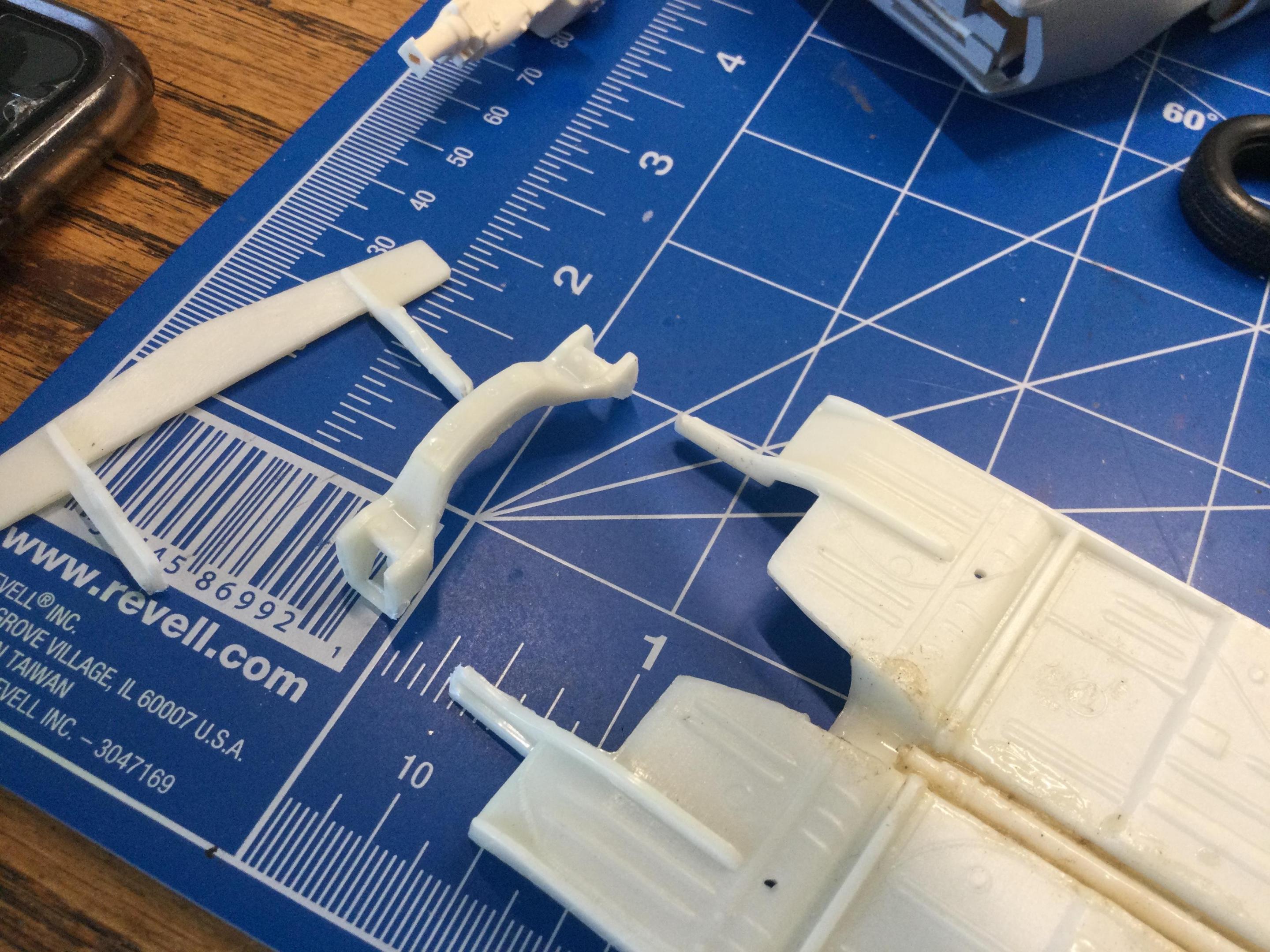

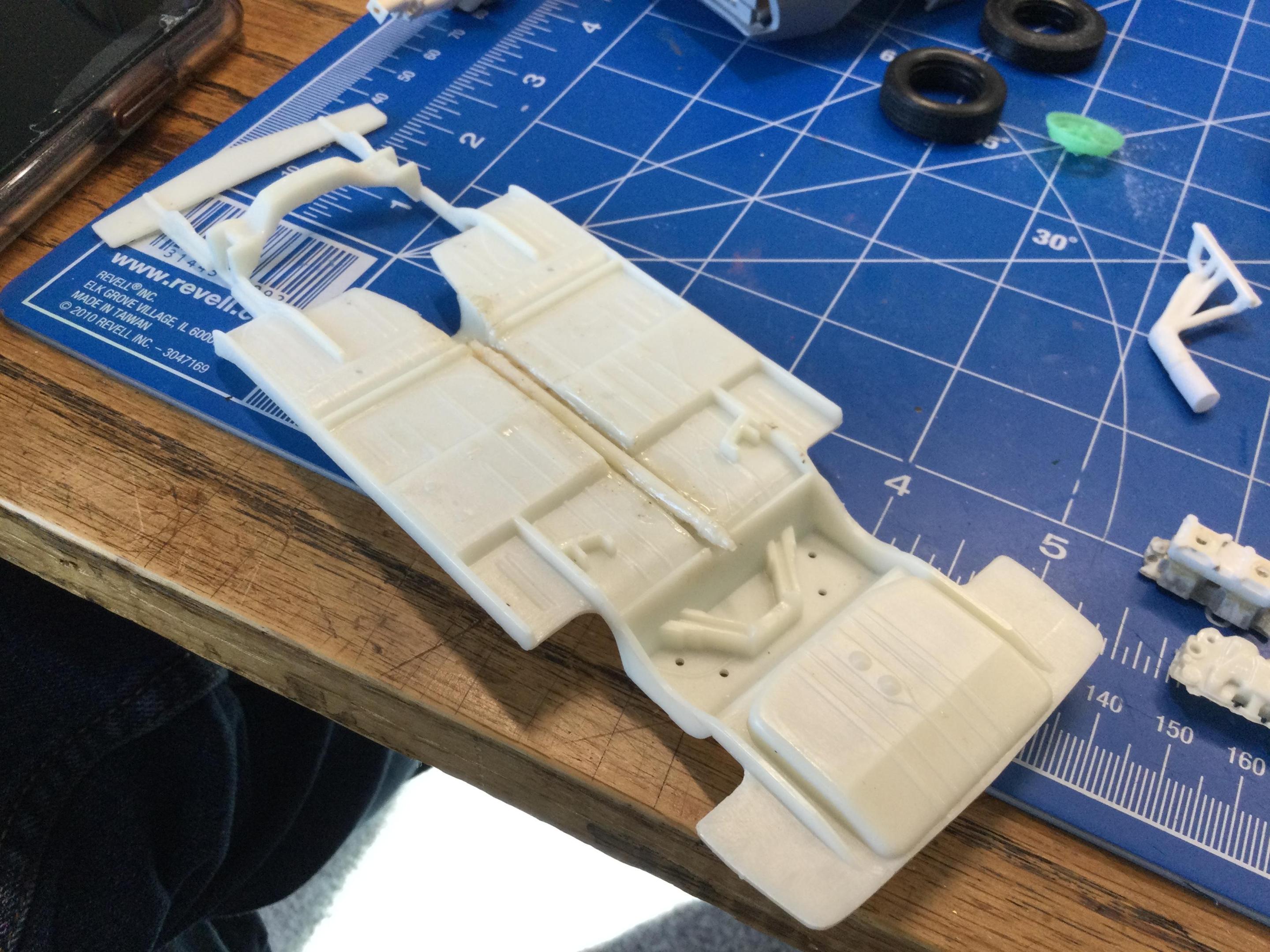

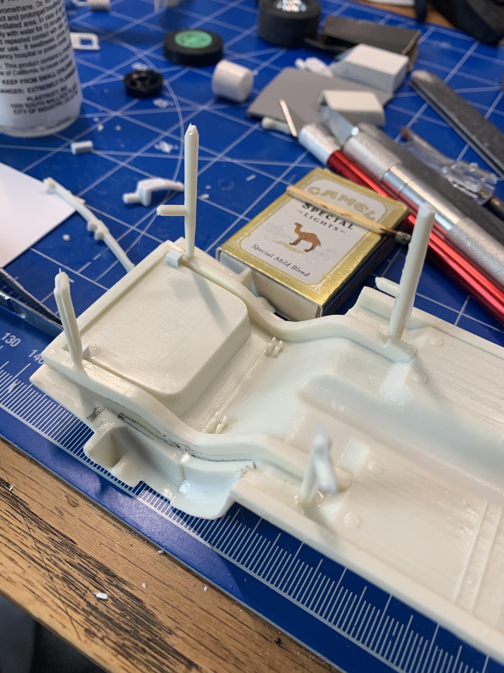

  14. Small update, the downer 69 Rambler chassis’ front crossmember was short molded. The front frame rails were also very thin, like Kit flashing, so I needed to replace the crossmember and I filled the gaps in the rails to strengthen it. Kari suggested the engine from the Matador kit might be a more accurate, so I pulled my NASCAR Matador kit out. At some point I had obtained a poorly built glue bomb and put it in with the new kit. There I found my answer to the crossmember. I cut it free and trimmed it to fit. I did look at the engine though, and I have the one from the original funny car kit and it appears to be a good choice, so I’ll be using it. I also found that the AMT NASCAR kits rear spring fit perfectly in the shock towers. I have some lower control arms, I think there from the Monogram 65-66 Mustang kit, that I’m going to try and make work

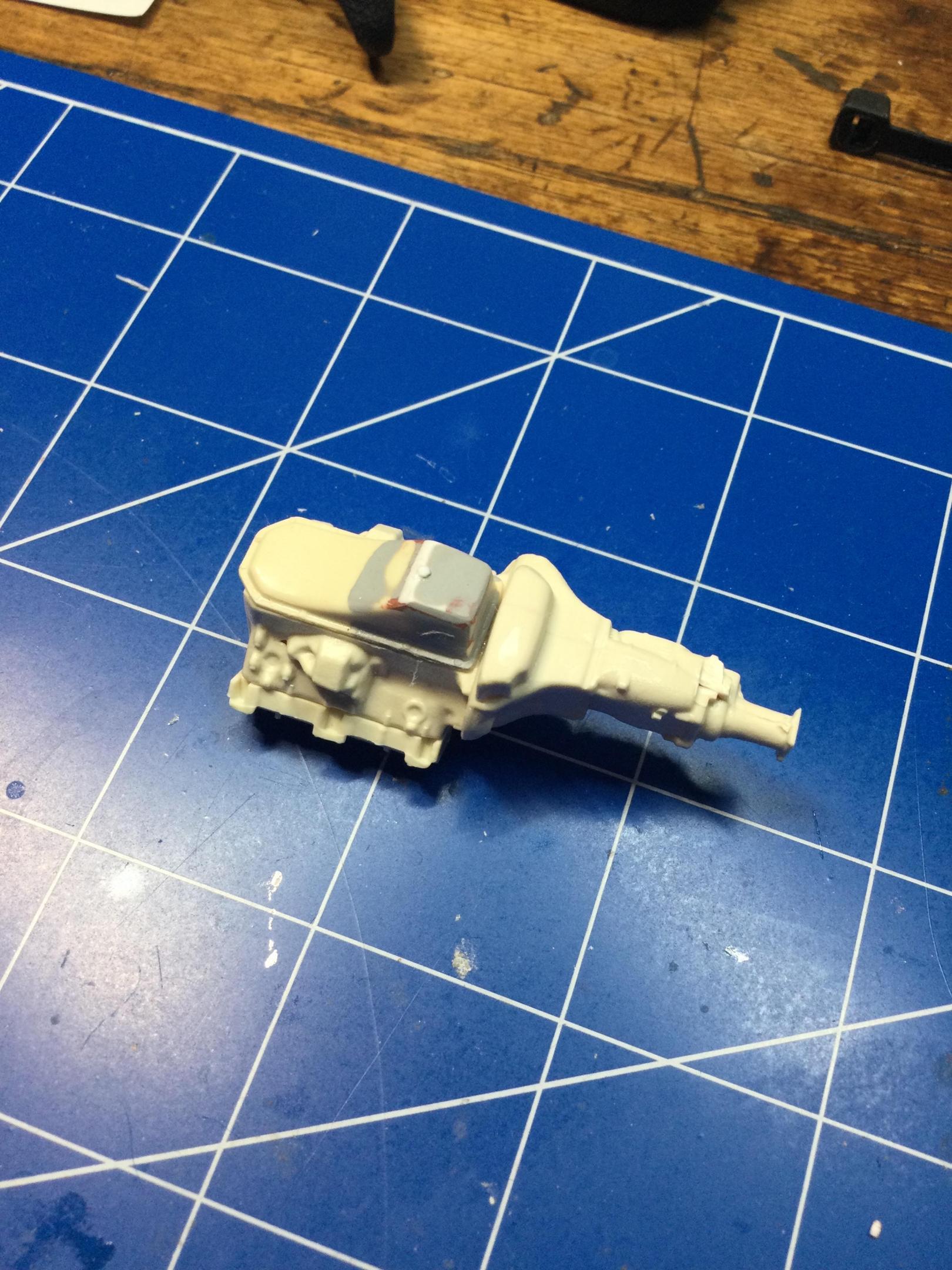

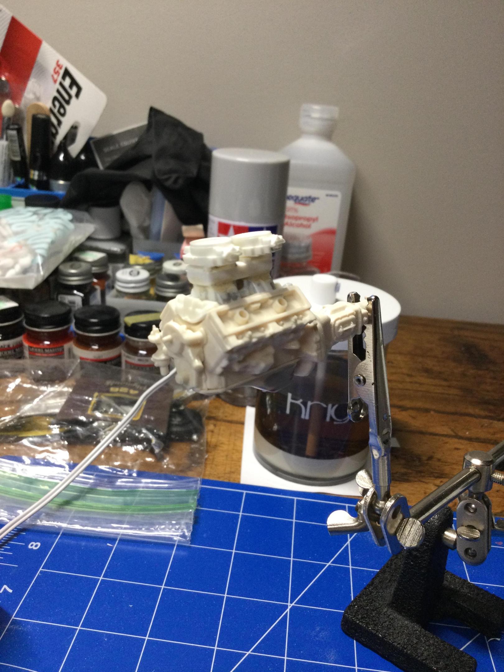

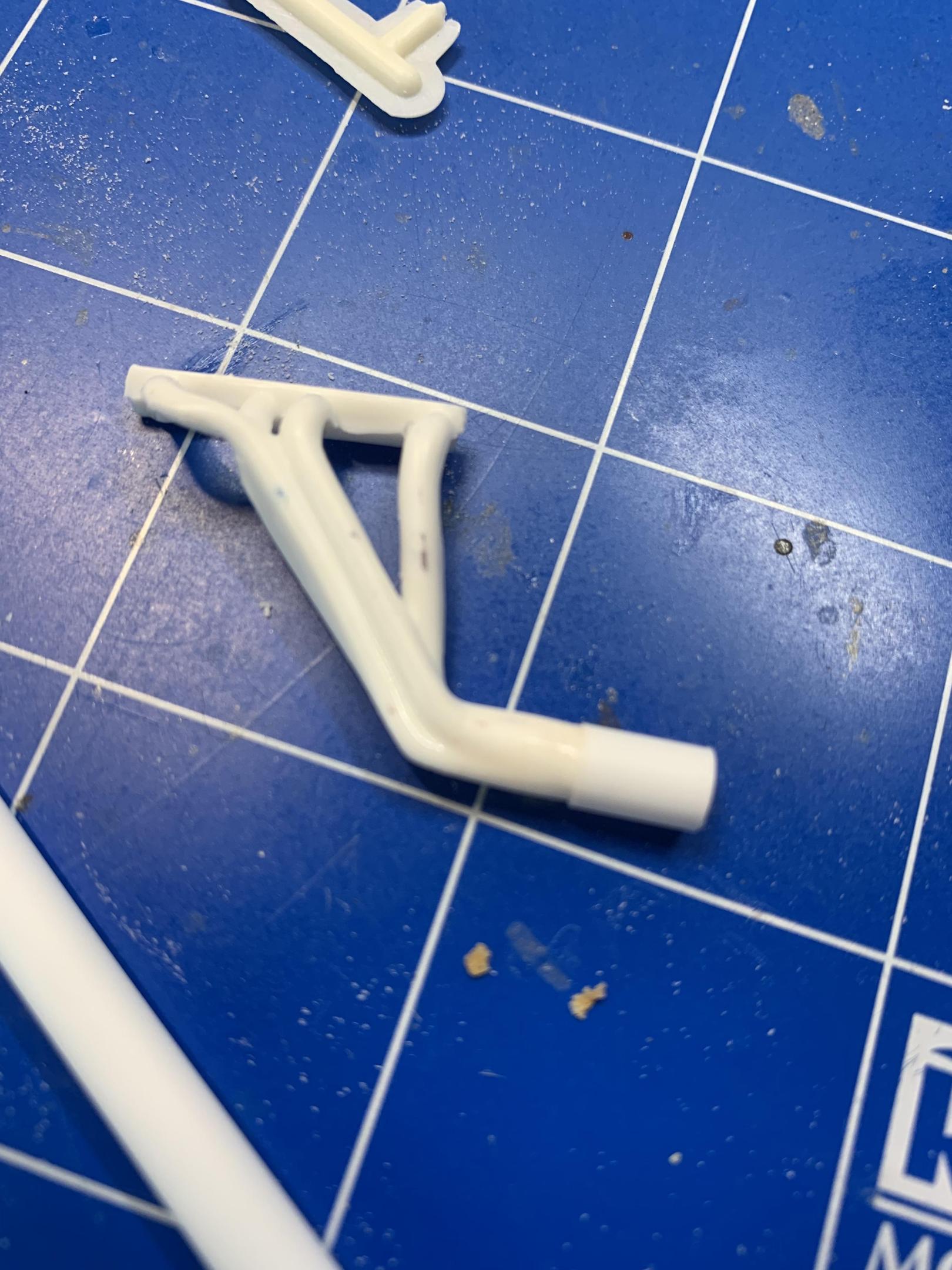

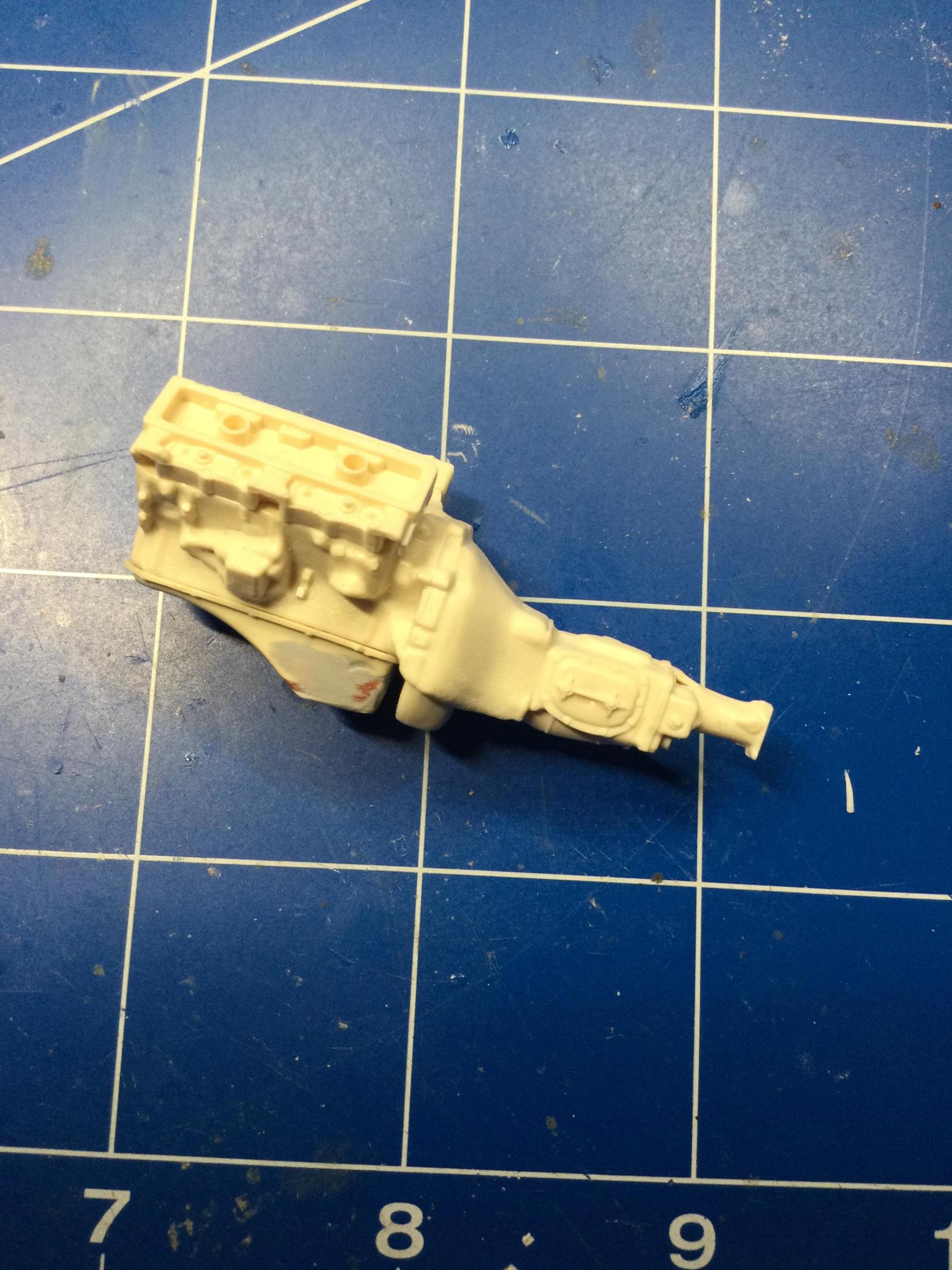

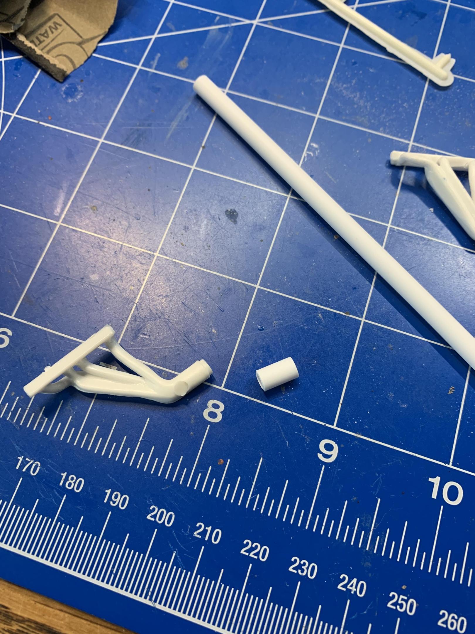

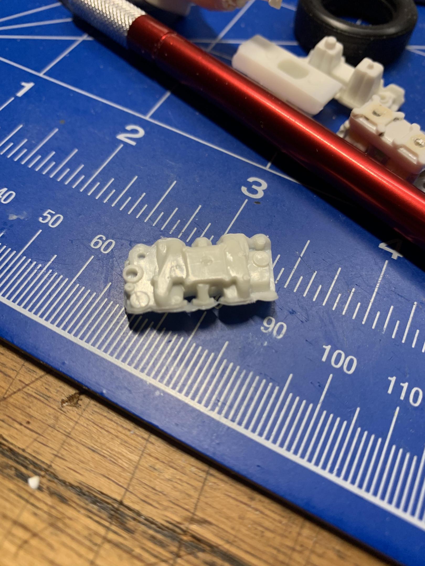

  24. I started on the engine from the funny car kit. I modified and deepened the oil pan as was the practice back the. The headers from the AMT Gremlin kit appear to be a perfect fit. I lengthened the header collectors with evergreen tubing.

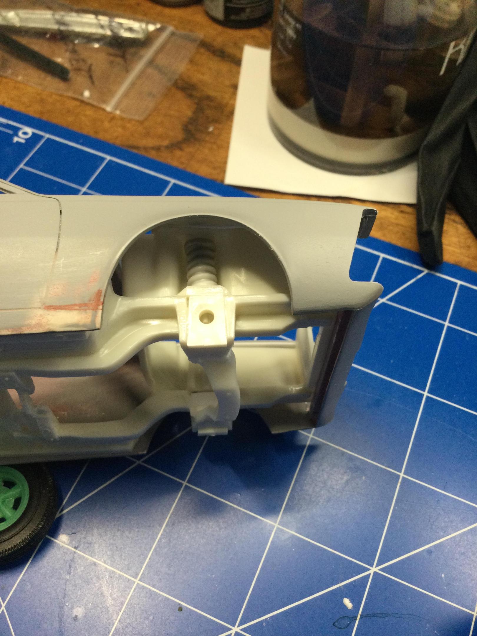

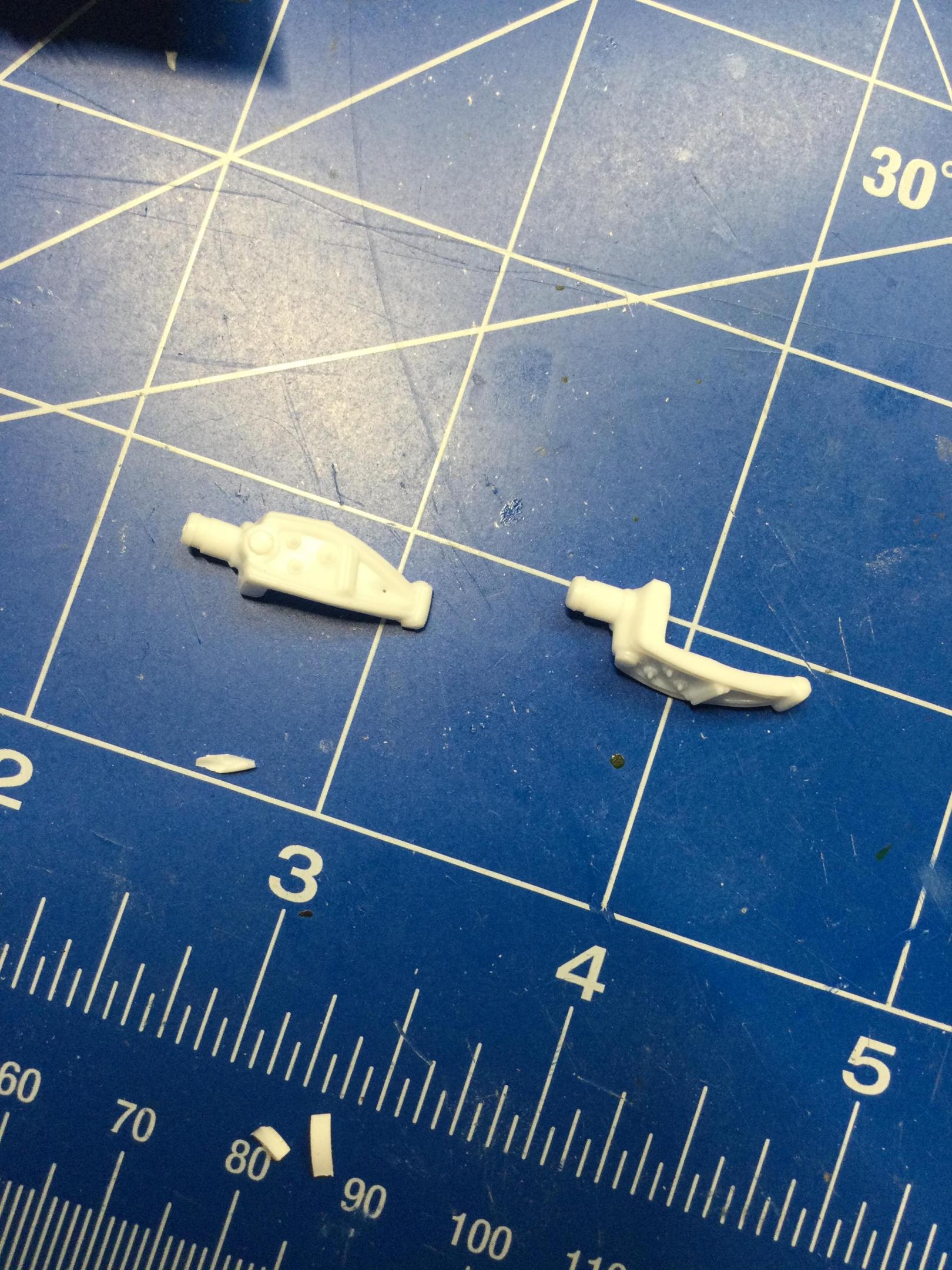

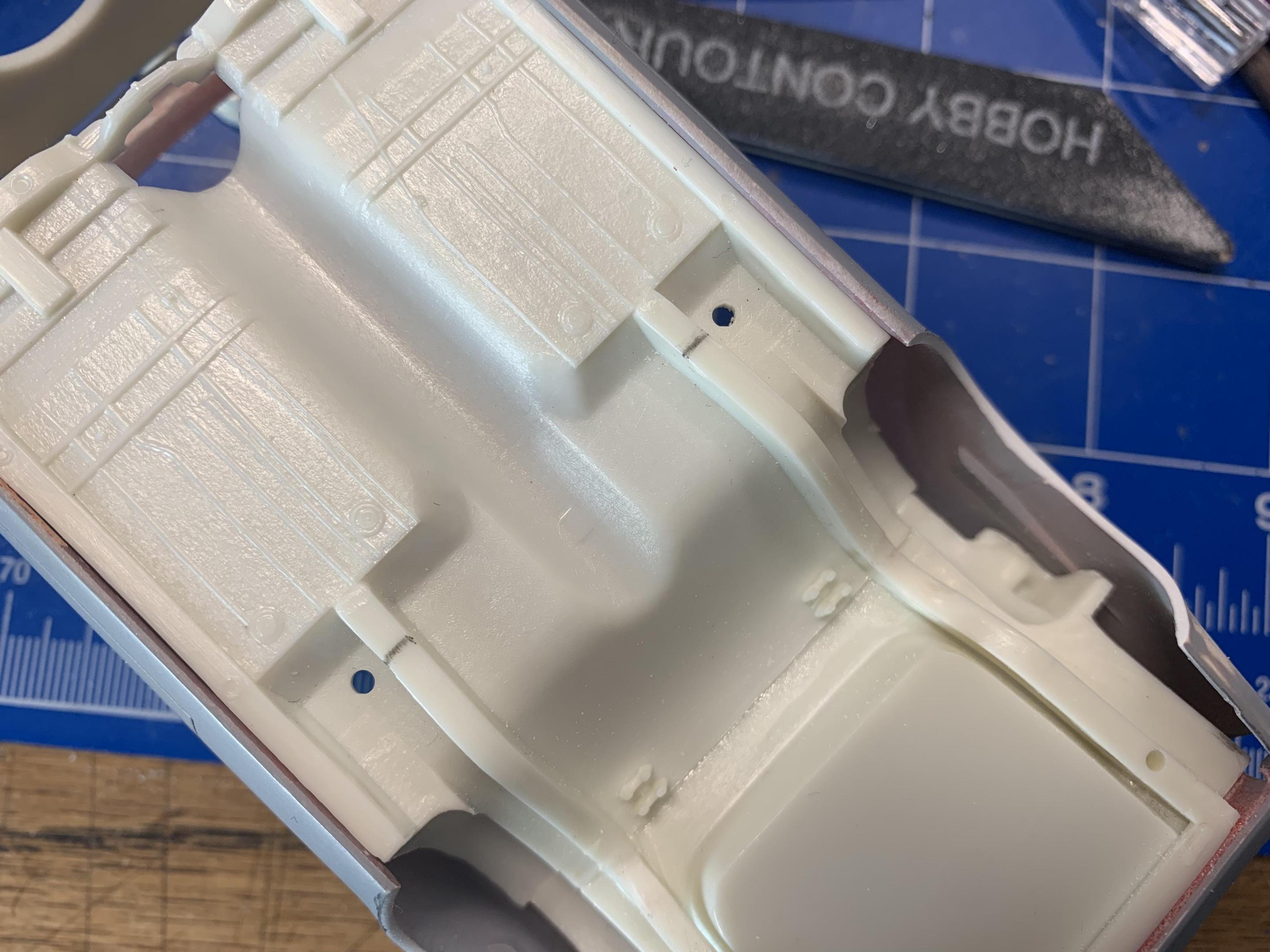

  25. Ok, so I revisited this post as I started working on the Hornet again and realized it’s been a year ago since I last posted anything. It took me forever to get over Covid, it really messed me up physically. Im what they call a long hauler, but enough of that. I had cut the inner fender structure from the American kit and aligned and glued it in place. Since the interior from the American is too narrow I cut the floor from the door panels, and removed the back seat. The molded in front suspension is not accurate so I’ve trimmed it from the chassis plate. I have some parts box Mustang front suspension that is more close to the original AMC pieces. I’m going to need to trim the shock towers and make shock mounts.
