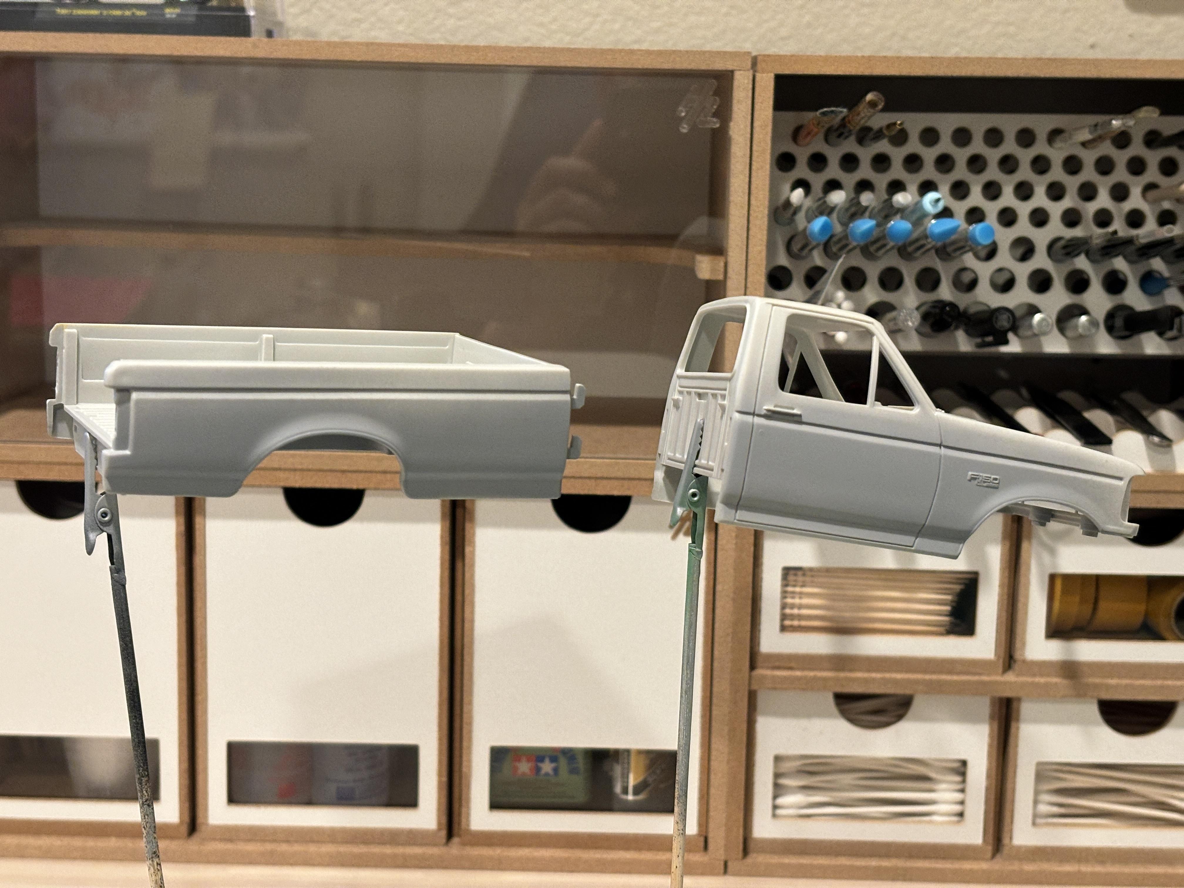

  4. Thanks, Carl. Anytime! Between working a lot of OT, I've been spending time mostly getting all of the parts washed and dried. I set aside some parts that will need a little more sanding to look just right. Most of them are the parts that I de-chromed. As you may be able to tell, I have started to remove the rubber trim on the front bumper to make it look like a base XL bumper. I also drilled out the exhaust tips: I primed most of the big parts in Mr. Surfacer 1500 black and grey since I'm done with the body work. I cannot say enough good things about this line of primers.

  6. Great job! Can the tool box design be found/purchased anywhere?
