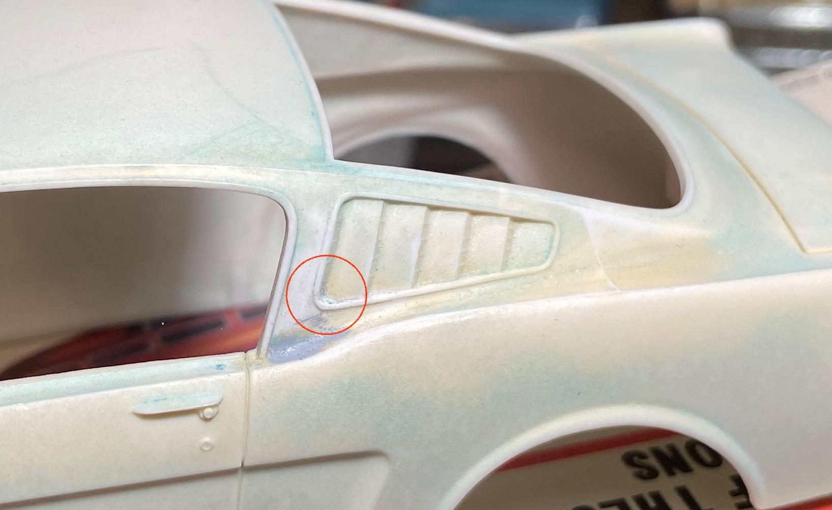

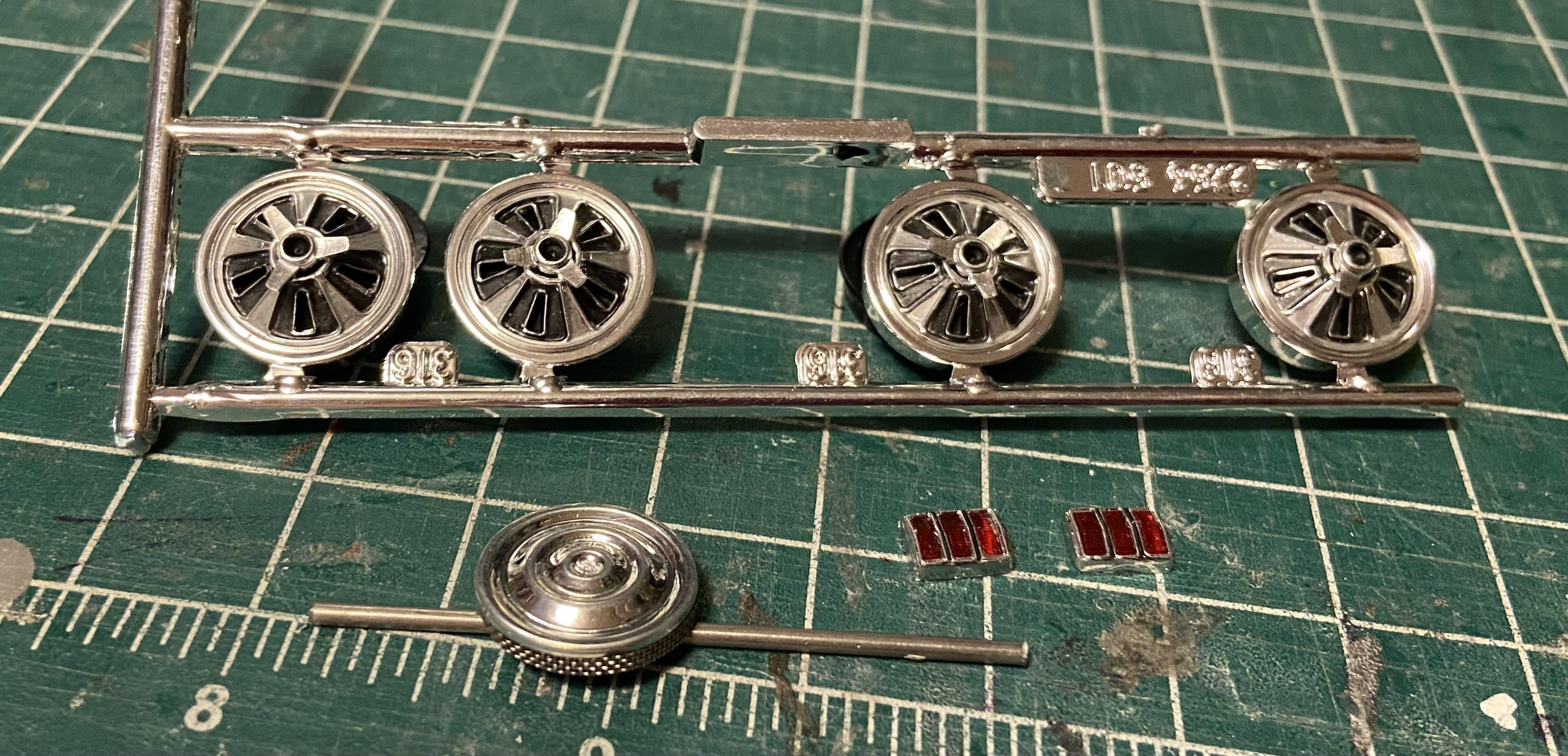

Prime Time! Tamiya fine gray primer used. I like Prime Time because you get to see your car in all one color for the first time. But it also shows all the little things that still need to be done, of which there are a few yet. But 99% of the way there. I detailed a few other parts. The wheel covers were painted with three different colors, the gray being a custom mix of flat black and silver. The spinners were brought over by Dan. He thinks they may be from the '63 Impala kit, but it's still a mystery. I drilled the centers and painted them black to make them look more Mustangish. The taillights were modified a bit, the side wings on the bezels were shaved off so they could be mounted all the way to the sides; as per the real car. The AMT kits had the wings for the mounting spikes, which facilitated quick assembly of promos, Philco radios, and slot car bodies; at the cost of accuracy. When you move them further out board, you will uncover the innermost mounting holes in the rear panel. I filled them with styrene rod so the tiniest wipe of filler was necessary to erase them. The air cleaner was wrapped with a piece of stainless mesh.

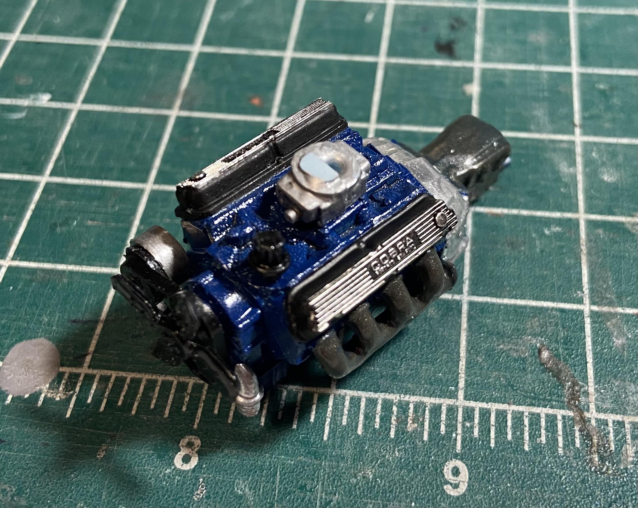

The color I chose for this car is Emberglo, a bright burnt orange, with a matching interior. I ordered the paint from Scalefinishes, and when it came, I did a couple of spoon tests. They came out fine, always do, but there was just one problem: I don't know what color that is, but it's not Emberglo. Maroon with a hint of brown. So I emailed Jameston Kroon, the owner of Scalefinishes. Super nice guy, I've met him at a few shows, and he can always make a specific color whether or not it is on his website. I showed him the spoon tests, and he said that his formula wasn't correct, but he had another one that was, and he would send me a new bottle quickly. Not worried. So I moved on to a few other things. I built a new engine from a coupe reissue. This engine looks more like a '64 260 than a later 289; the timing cover mounted oil filler has to be removed, the timing cover smoothed a bit, and the alternator is way too high on the fan belt - higher even than the stock generator location on the 260. So I modified the fan belt to mount the alternator in the stock location, in front of the right cylinder head. I painted it Ford blue, and used the kit optional Cobra valve covers. The smooth valve covers are too narrow in appearance, but the Cobras are just the right shape. Aside from that, it's box stock. I then did a few parts in Alclad, including the grille from the trashed promo. The Cragar in the pic was done as a demonstration for a local club guy to show him what happens when you spray on too much Alclad - it turns into silver. The Americans are the unplated units from the '62 Bel Air kit, they will be used on another car. Finalizing the bodywork, I corrected an area at the belt line on the left side behind the door window, where the green lacquer paint pooled a little bit and crazed the plastic. While I was smoothing that recessed area, I had a whoops moment and accidentally wiped out the trim around the lower front corner of the 1/4 vent panel. So I rebuilt it with a piece of .000something Evergreen sheet, and carved it to shape. Crisis narrowly averted.

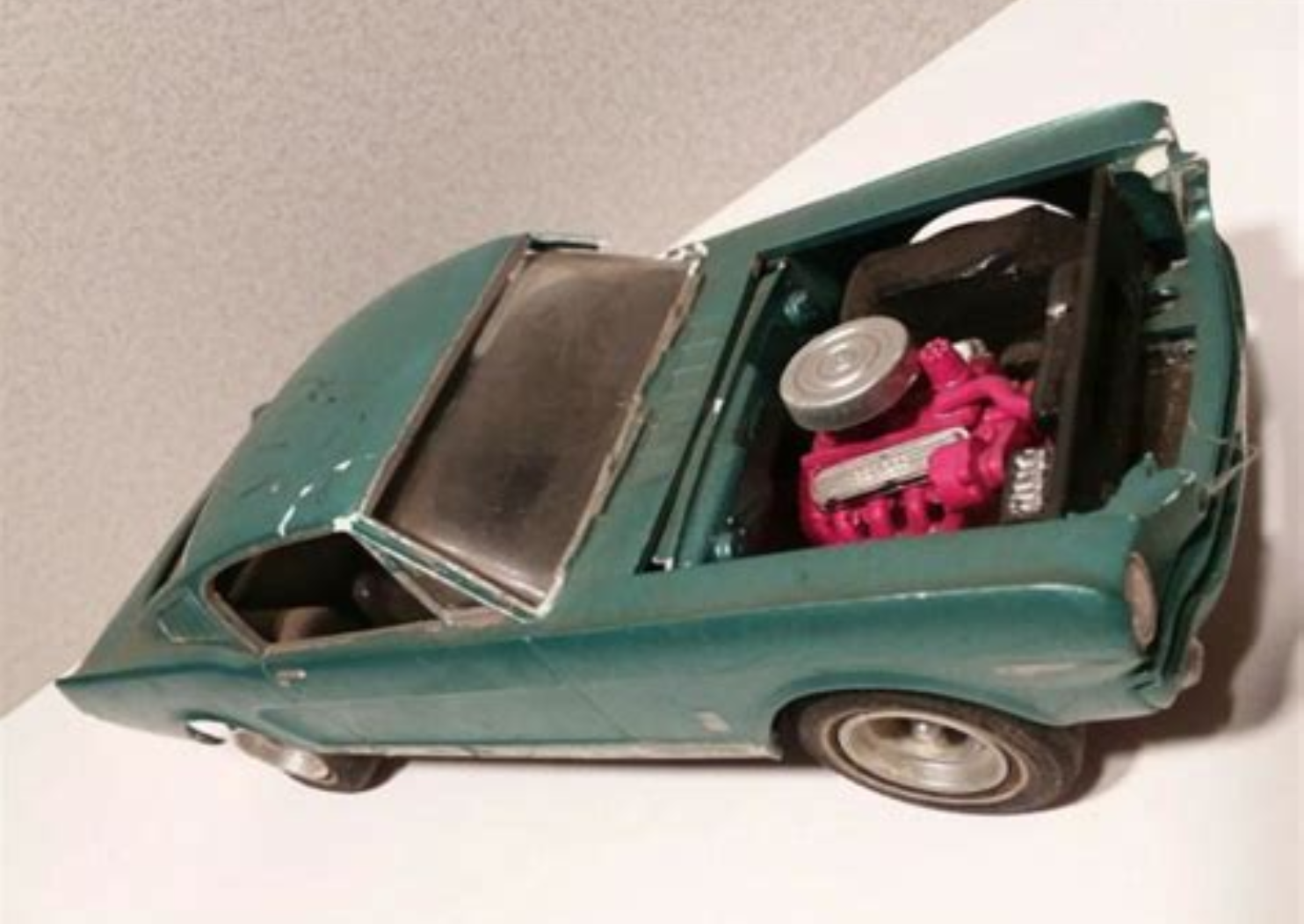

My favorite type of building is, by far, restoring glue bombs. It's just my thing. Late in 2020, this car appeared on Ebay, listed for a silly high price, north of $150. After seeing it listed several times with no bids, my buddy Dan told me, "Hey Mike, give him a stupid low offer and see what he does." So I thought about it and did just that, a fraction of his asking price. I thought he'd just tell me to pound sand, but 12 minutes later, it was mine. Great, now what? I already have a minty built/no paint example of this kit in my case, as well as a near-mint unbuilt one in the box. Why do I do this? So it sat in the junk yard for a year, and then AMT announced that a new version of the kit was to be issued with a new body and parts. So now seems as good a time as any to get busy on this hot mess, both as a comparison to the new kit and as a preview of sorts. Dan wanted the wheels. No problem, Dan. First step was to remove the paint, likely AMT lacquer from back in the day. The Purple Pond did it's thing, and now we have something to work with. The paint crazed the plastic very slightly, so a sanding to 1,200 grit will be necessary. Second step was to replace the broken A pillar with the vent frame from a donor coupe body. The roof was cracked open on the right side too, it was probably stepped on. The vent post is at a different angle on the coupe, an easy fix, the rest is the same. TBC.
