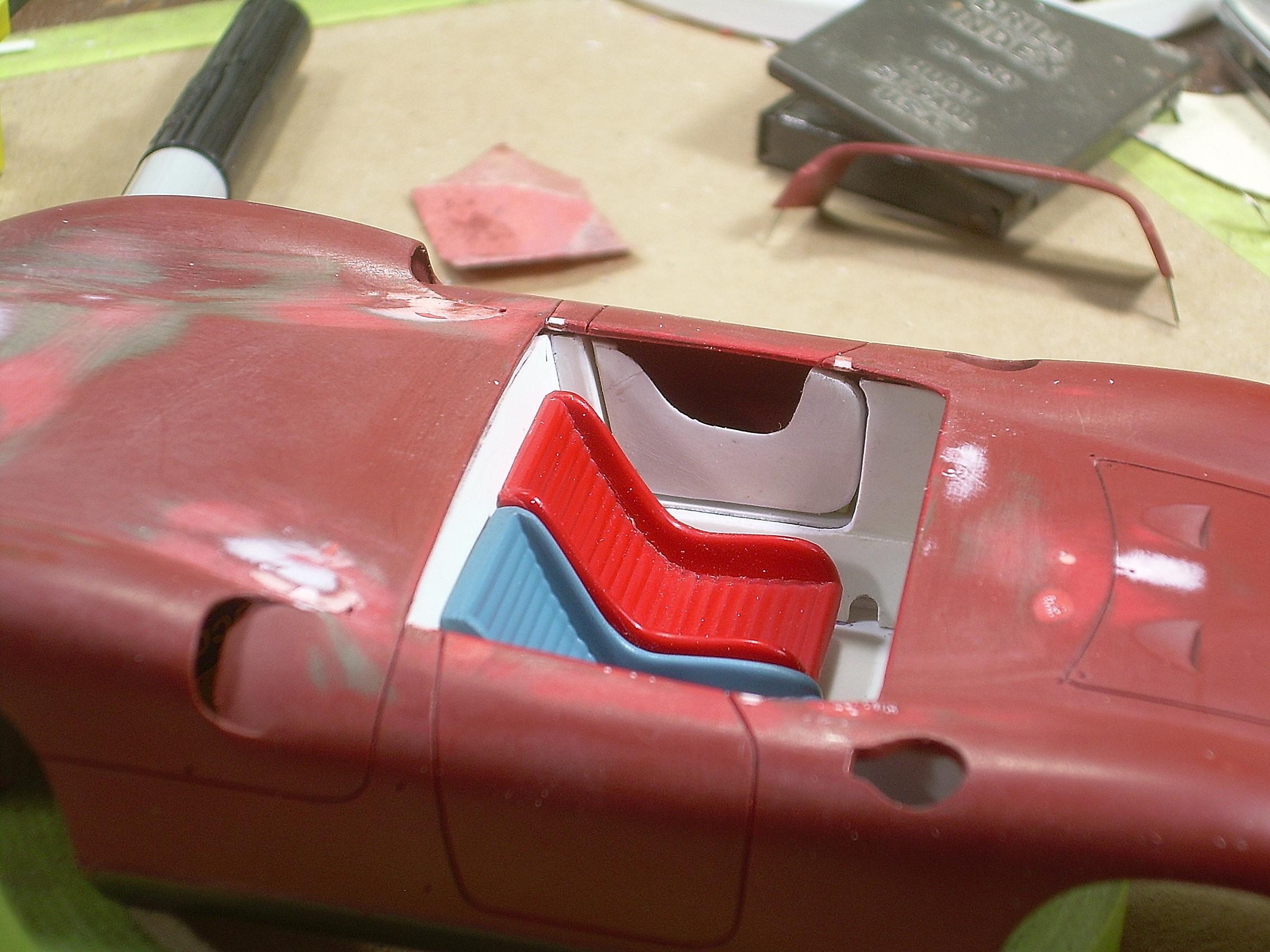

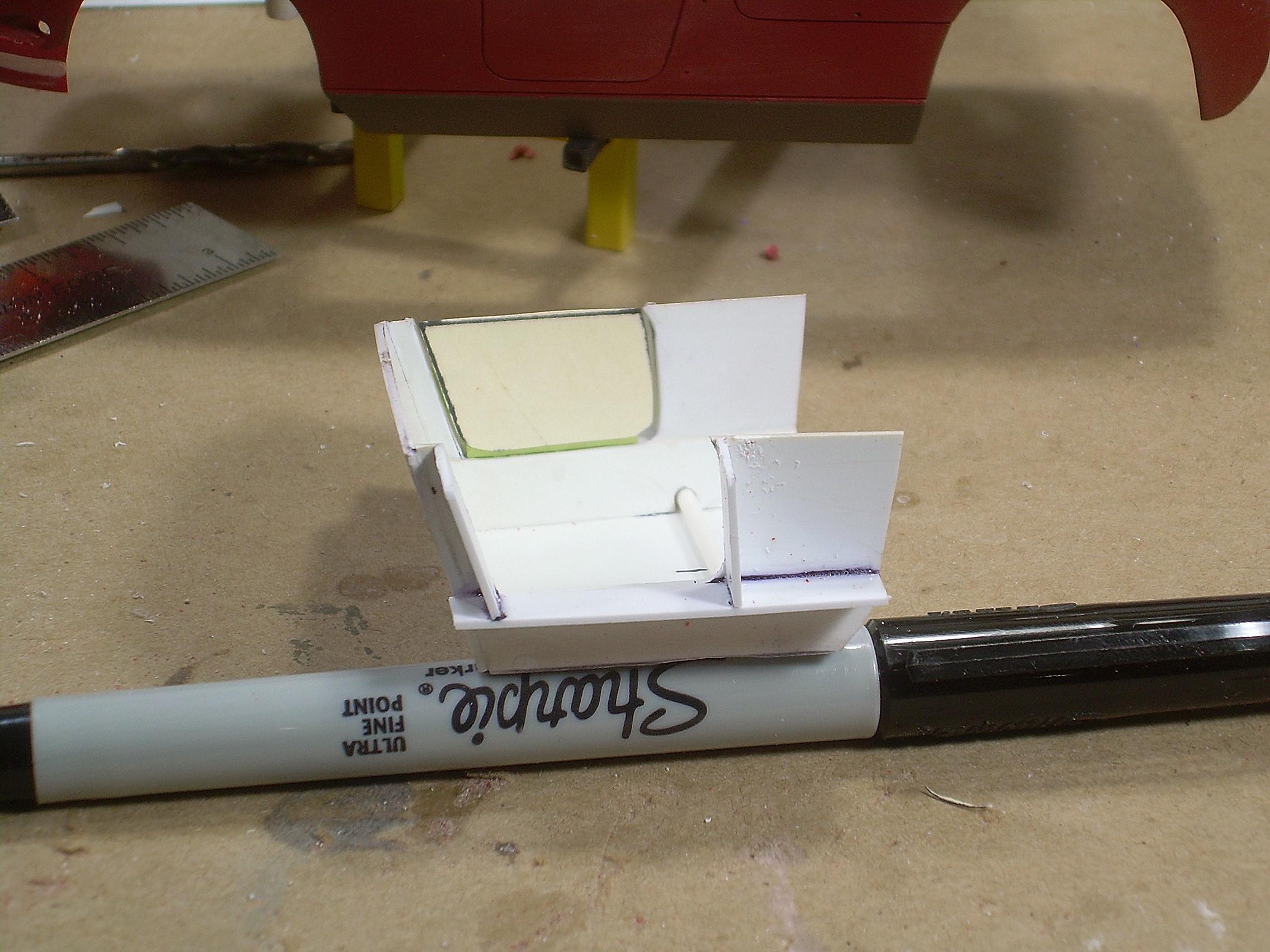

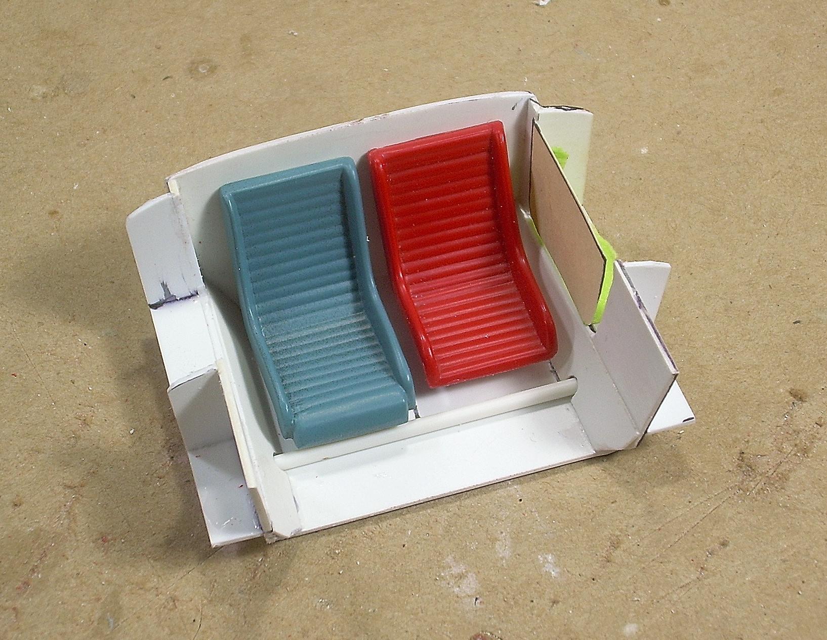

  6. With the door openings in the tub pretty much the way I want 'em, I was able to make cardstock templates for the inner door shells. I tried a Tamiya color on the RH seat, more to see how the gloo-smear repairs would look than anything else. I'm satisfied with the seat repairs and mods, but the color needs to be a little more purple. May just go with this though. We'll see. Need to kill the gloss. Just noticed the seat side bolsters are fatter on the real car. Maybe I'll address it, maybe not. Inner door shell made from .010" sheet stock, framed on the back face with rectangular stock...allowing me to round the edges to approximate the look of the real ones. Needs a little more tweaking, but compares pretty well with the reference shot.

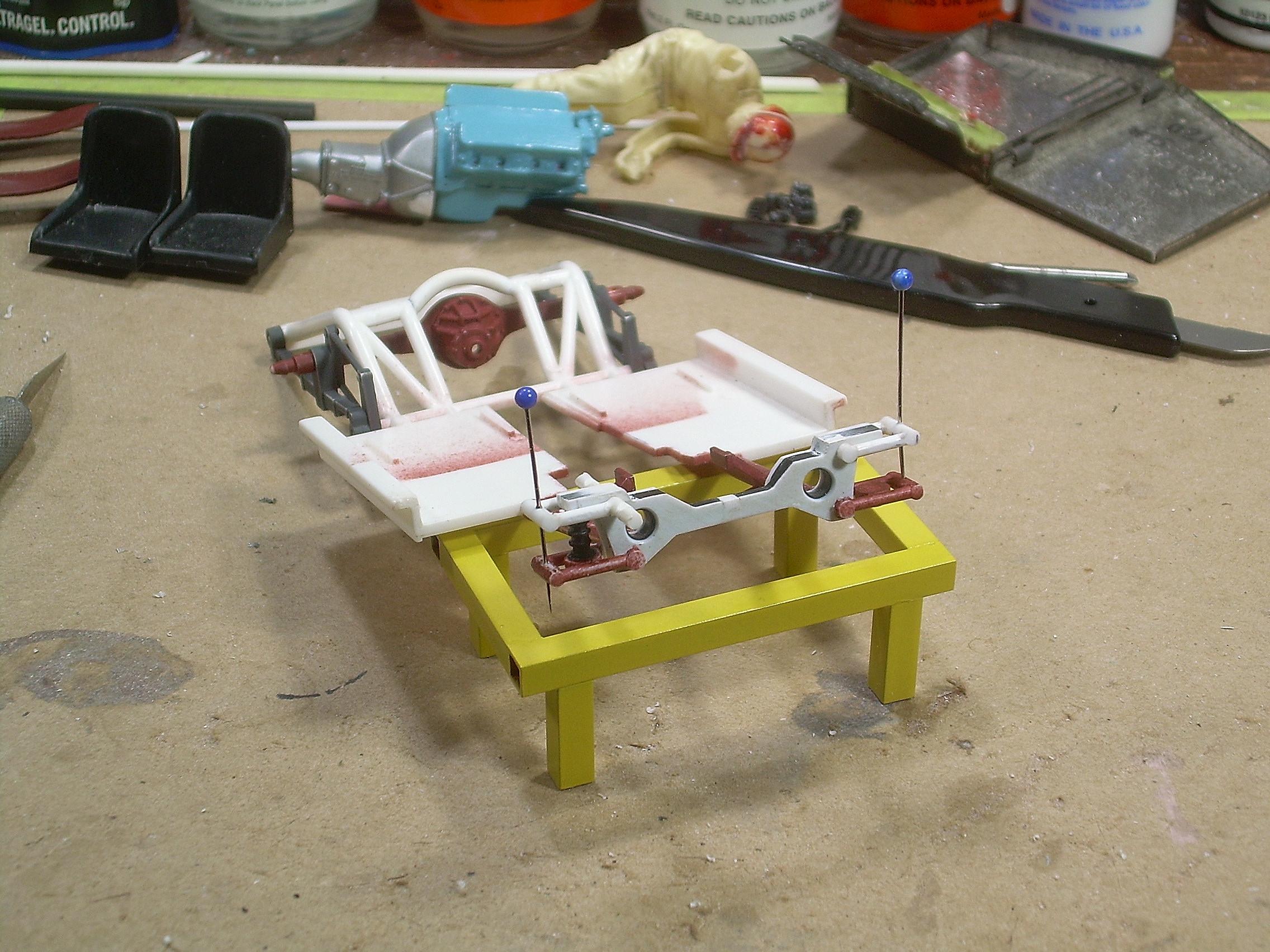

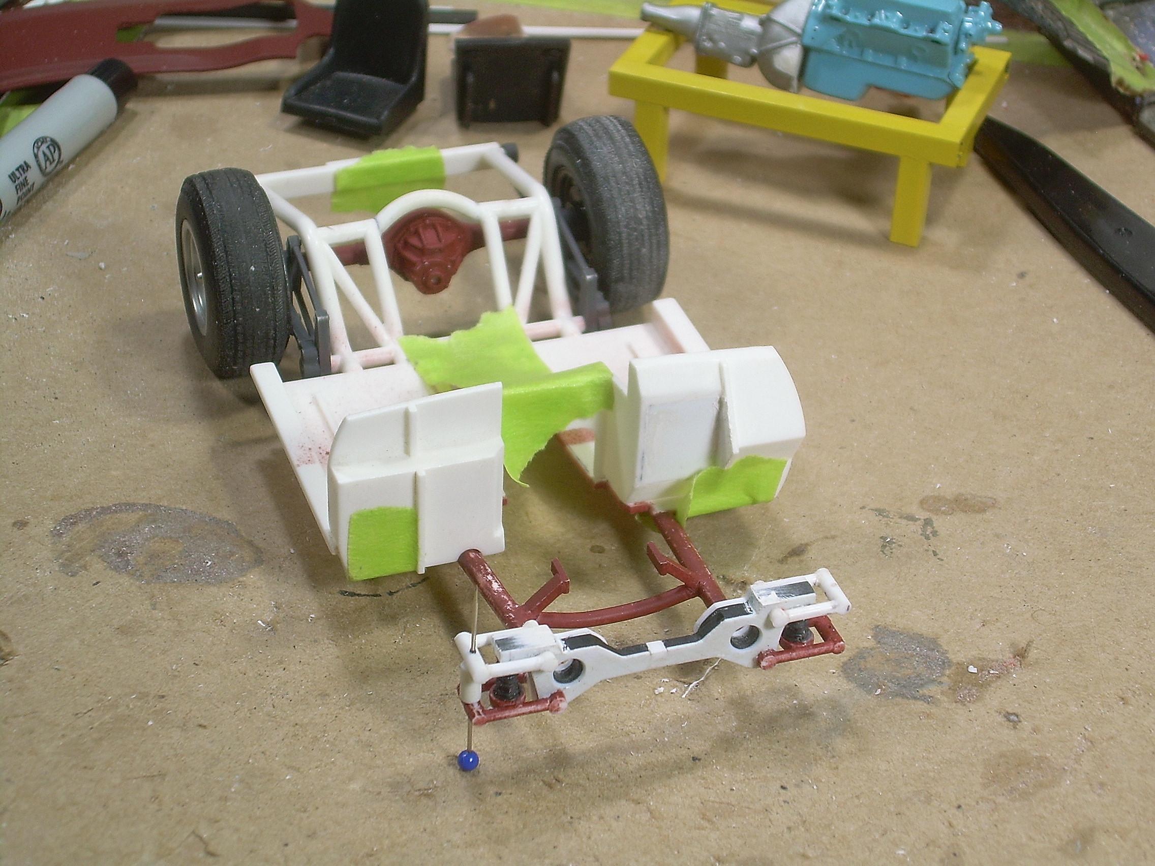

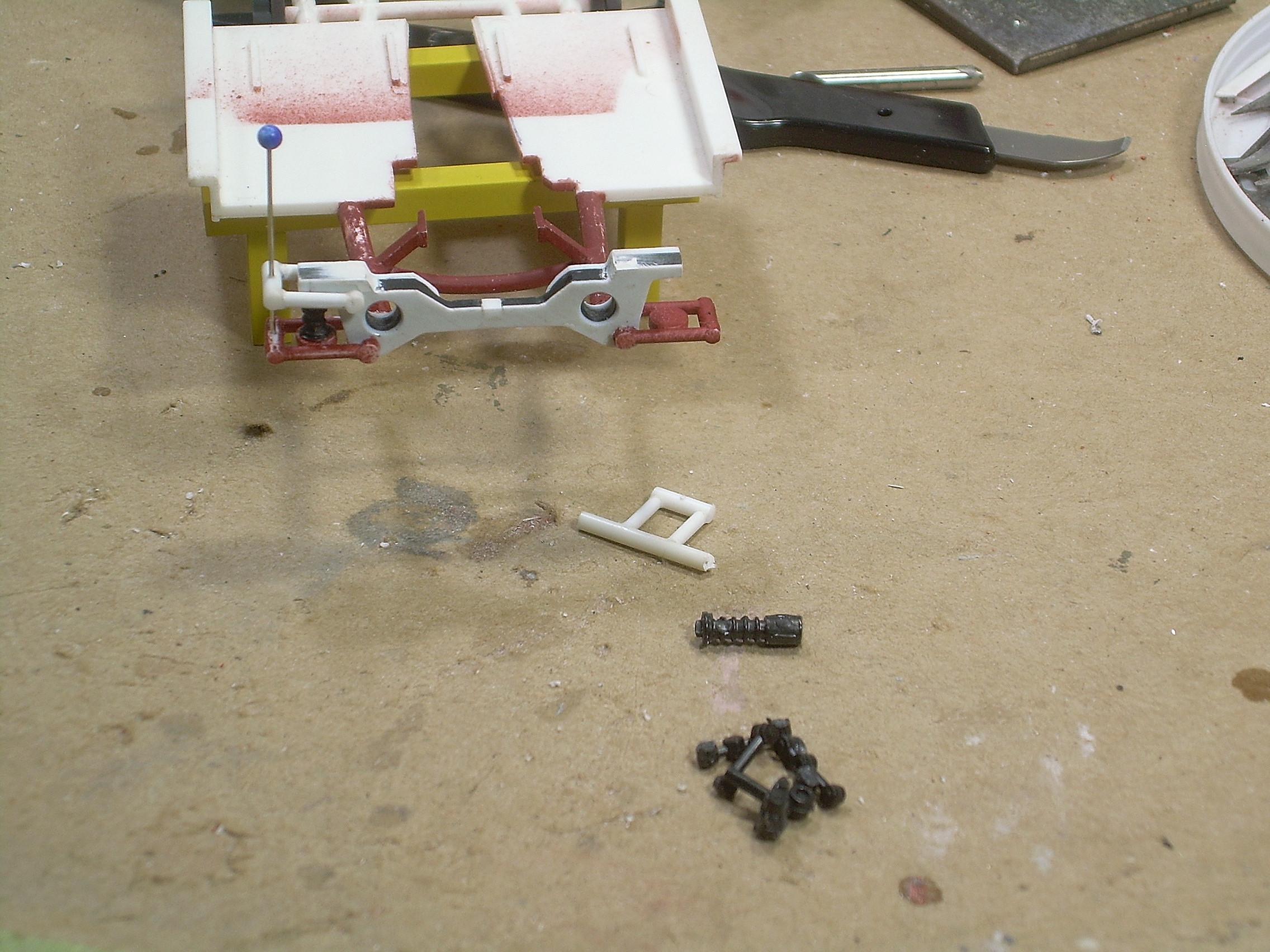

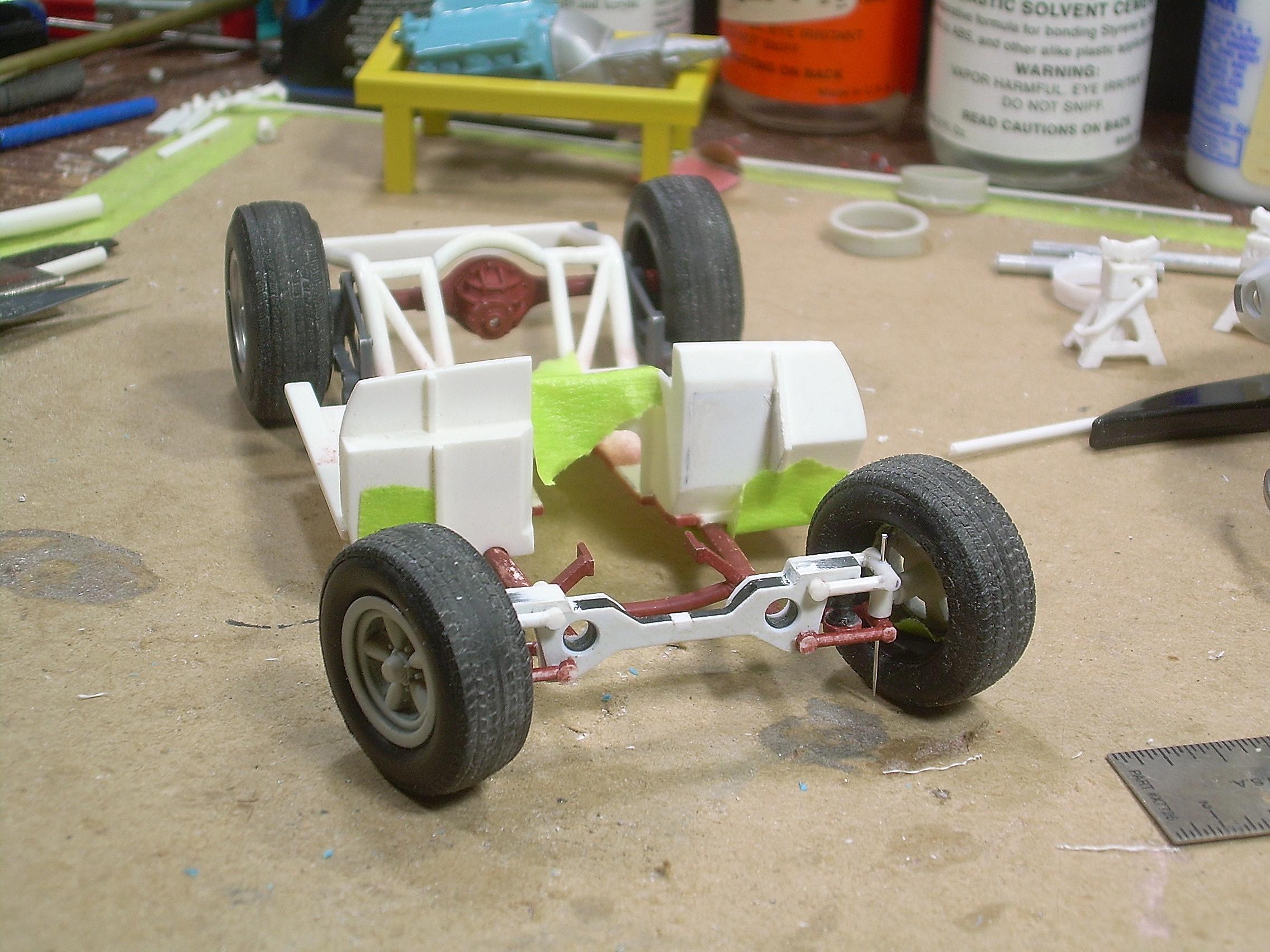

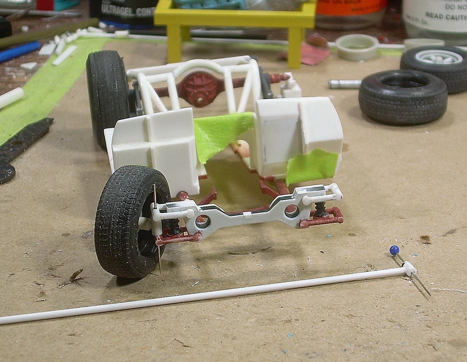

  7. I've been a little under the weather, moving kinda slow, but managed to make some progress. First shot just shows a spring liberated from its glooey prison, one installed, and the remaining control arm nearing completion. Next shot shows camber verification prior to final gluing, using round-head pins as kingpin centerlines. As the .021" pins are a tight fit in the .020" bores, reversed they make a great way to hold the ride height while measuring the spindles for stub-axle location. Maintaining the exact stance established during the mockup phase is critical for the look I'm after. RH stub-axle in position, LH measured and assembled to match. Both spindles mounted, with the final wheel/tire combo. Amazingly, all 4 wheels touch the ground.
