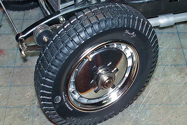

And the finished wheel...
Pocher tires are super stiff and almost impossible to slip over the wheel. I have found a simple solution... I put the tire into a small bowl of water and microwave the water for a minute or so. That softens up the tire and makes it very flaxible and easy to slip over the wheel.

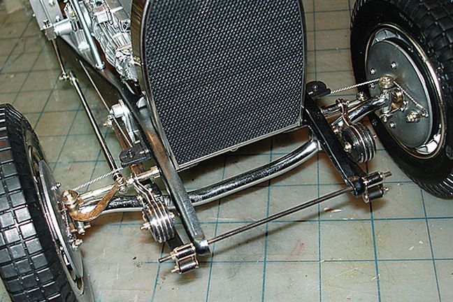

Pocher supplies a thick nylon cord to use as the "steel" brake cables. But the cord is white! Duh!
I thought about painting the cord steel gray, but no matter what paint i used, I was afraid that the cord would wind up too stiff after the paint dried to be able to easily thread it through the various pulleys (and tight-radius turns) in the braking system. So I went to Hobby Lobby and found a suitable gray cord in the jewelry aisle.
Not sure why, but the cable looks much lighter in this photo than in real life. For all you old guys (like me) who remember film photography, the cord is about 50% gray... looks just like "steel" cable.

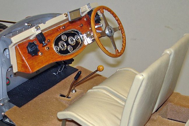

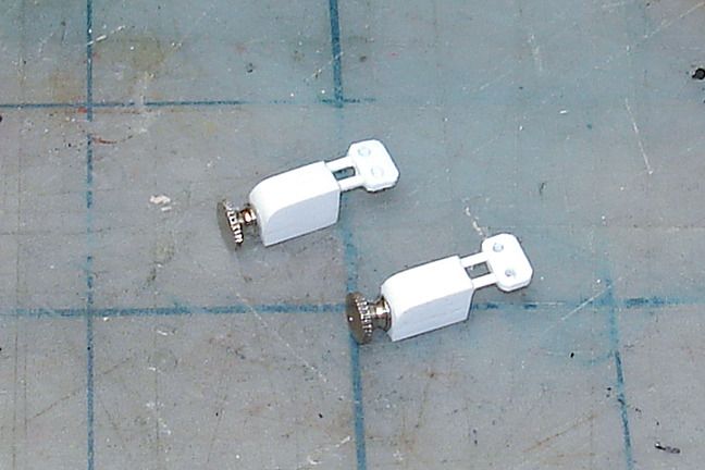

The real car has a windshield that can be cranked open at the bottom to get some "flow through ventilation." The kit only hints at this with two machined plated brass handles, but not the cranking mechanisms themselves, which are very obvious on the real car... so I scratchbuilt them...
And here you can see them installed on the dash...

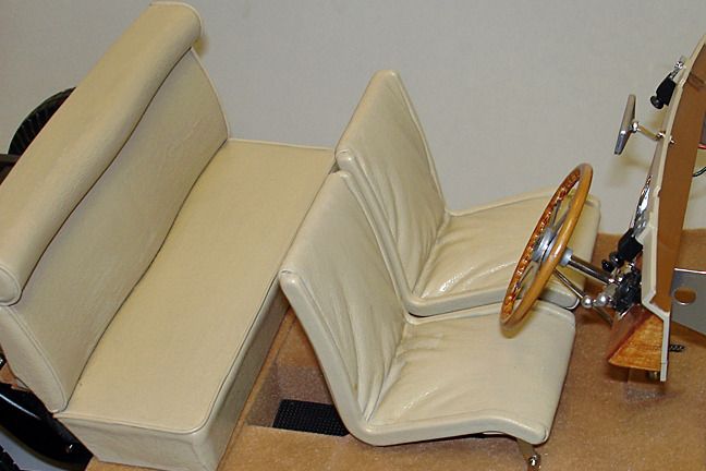

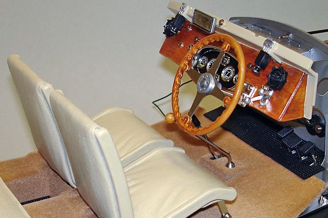

The floorboard comes flocked, so you're sort of stuck with the color of the "carpeting" as is. The kit supplies upholstery material for the seats and inside door panels, and every piece is diecut, which is nice... but the material itself is too thick and too stiff to go around tight corners and compound curves. Plus the "leather" texture is more like 1:1 scale, so it looks pretty clunky. I used my own material to upholster the seats (the stuff I always use, a soft, stretchy vinyl that has a pretty much in-scale "leather" look to it). The material itself is a very dark brown, but after I upholstered the seats I painted it a light "buff" color. I did use the kit's foam seat cushions, though...
To get the wood look on the steering wheel rim and shift knob, I first painted them the same color that I used on the seats (an acrylic craft paint), then "painted" the wheel rim and shift knob with oil-based wood stain. The stain sort of soaks into the acrylic paint, and the result is a very nice "wood" look. Because the stain is oil-based it takes forever to dry, so I used the dehydrator to speed things up...
