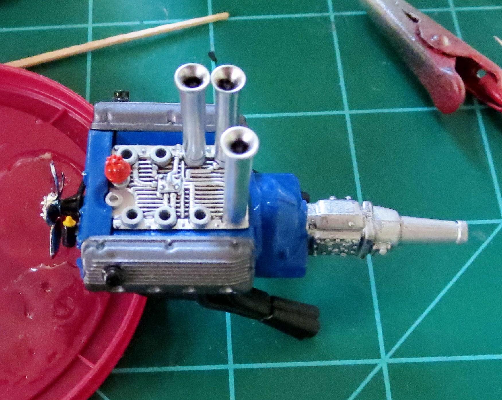

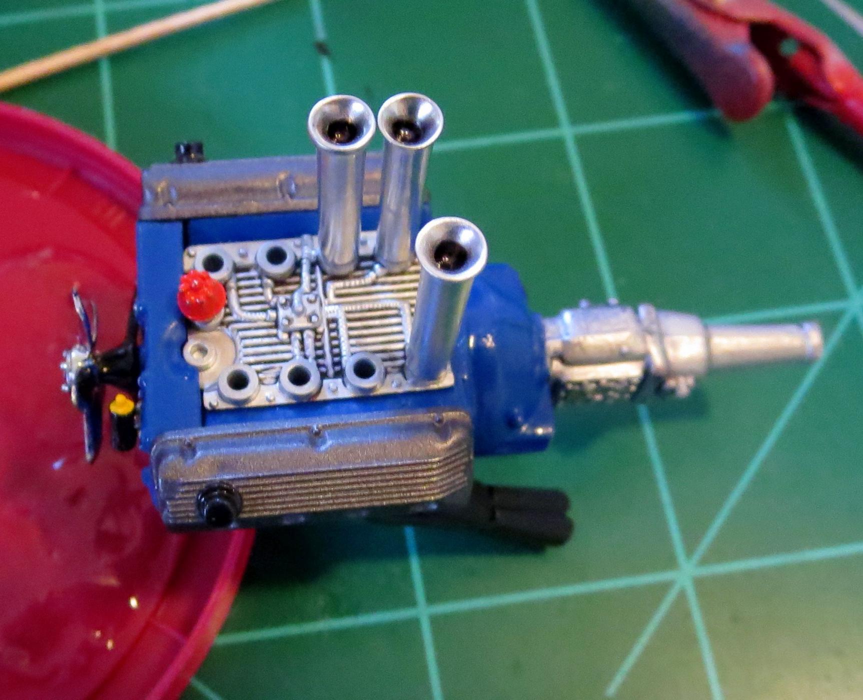

Speedfreak Posted August 29, 2015 Author Posted August 29, 2015 Okay Ace, this engine is from the AMT '69 Ford Galaxie kit, with the blue car on the box. It's the same engine but has a little better/different details. So, the main drain plug sat right in the middle of the cross cross member where it mounts. In the case of this specific model, I broke one side off that hole/square in the cross member (where the drain plug would fit) when I was doing initial prep six months ago., so I had to fill that in with epoxy and add a brace to one side so the front end piece would hold, (it also uses that hole/square) which made it flat on top and difficult to balance the engine, so I cut it off, no one sees that anyway. I hope that makes sense. Thanks for asking the question. Here's a couple of pics of the engine progress. The problem here is that I cut the tabs off the bottom of the ' Intake Horns ' thinking it would make it easier for mounting, yes that's right. So now, because CA melts the Alclad I've got to mix a batch of epoxy for each horn! Wear plastic gloves and all that, Yes! Oh what fun! I've got three of them on! The coil and the oil filter are from the Revell parts pack 427 FE engine.

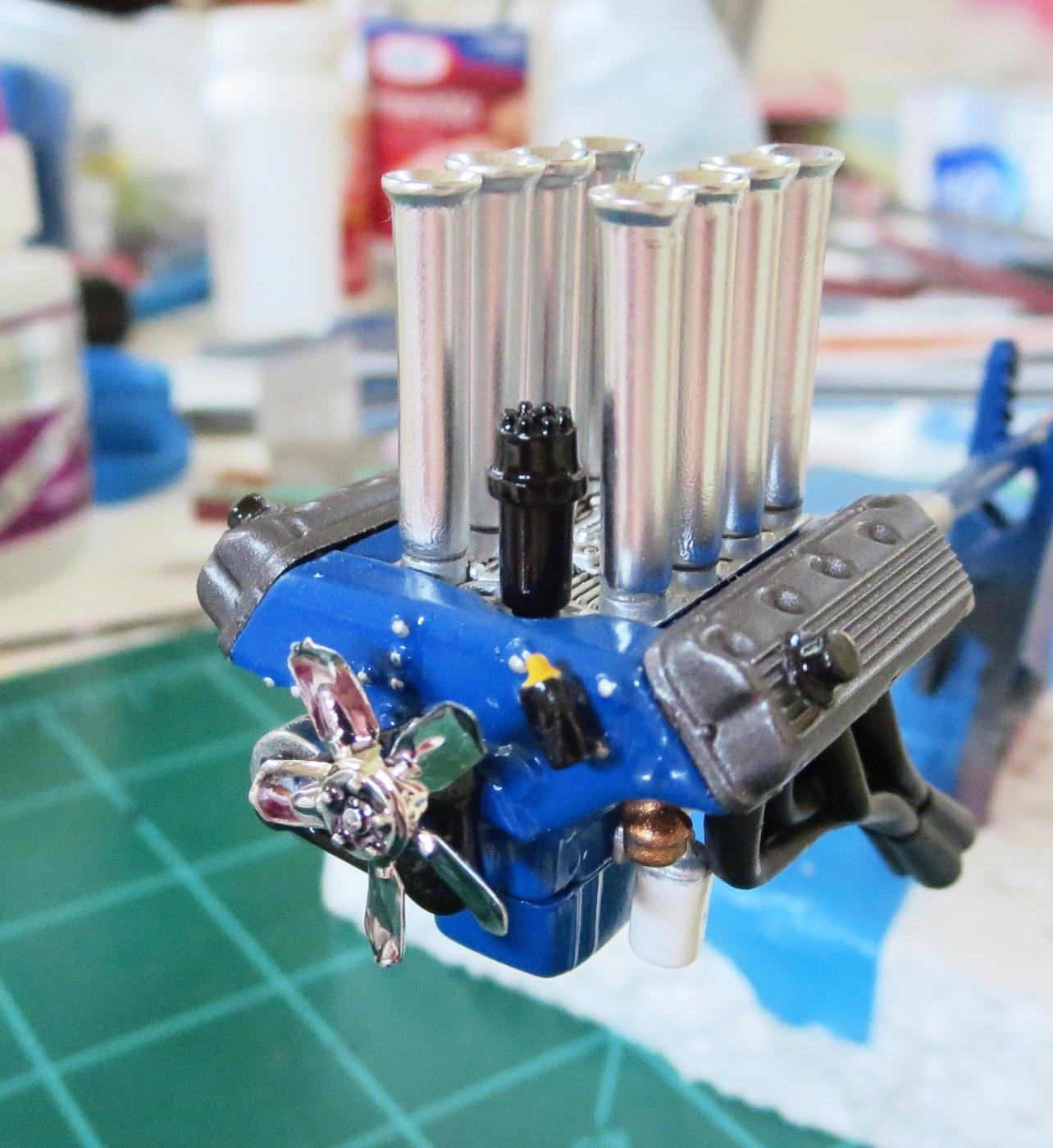

Speedfreak Posted August 29, 2015 Author Posted August 29, 2015 (edited) ............. and then there were eight.......... Edited February 26, 2016 by Speedfreak

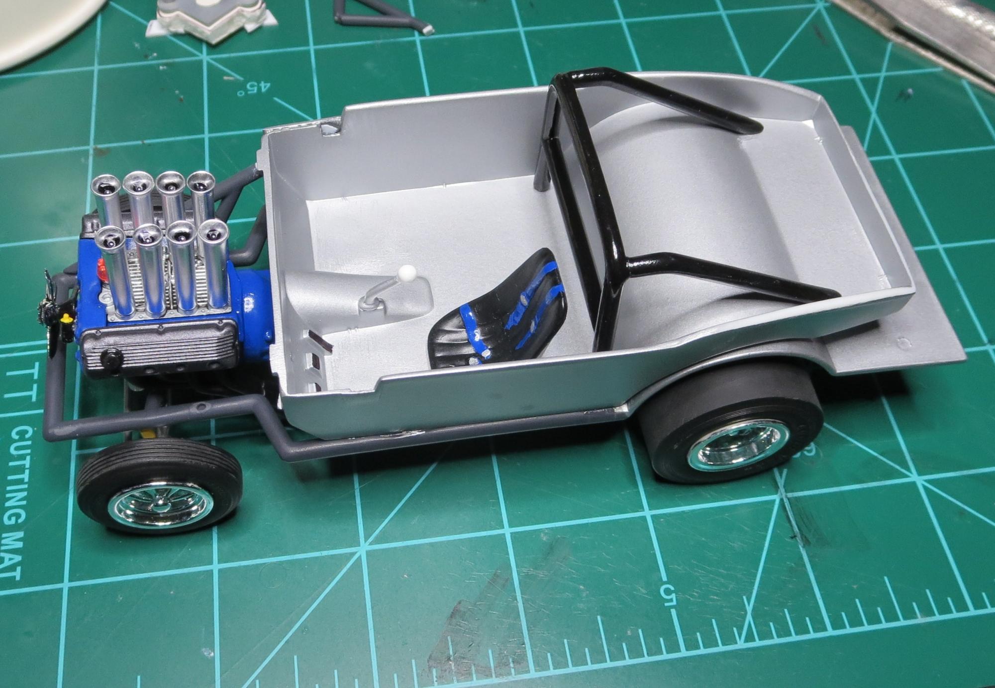

Speedfreak Posted August 29, 2015 Author Posted August 29, 2015 (edited) Ace, you have any tips/advice for installing the engine? The first attempt was thwarted by the headers being too wide to fit in the designated area. I have since relocated and pinned the headers, also one of the cowl braces is off as well as one of the trailing links, so , hopefully things go smoother this time.Even with things as described above the drivers side headers still hit the drivers side trailing links, resulting in the engine not sitting upright, or , straight, so,....... there's no way I'm messing with the headers again. I'll have to try and figure out a way to widen the location of the trailing links. Edited August 29, 2015 by Speedfreak

AC Norton Posted August 30, 2015 Posted August 30, 2015 ok, first off I presently do not have the 69 galaxie kit at this time, even though over the years some have come and gone.......however if memory serves, I recall that particular SOHC engine being a bit bulkier than the engine supplied in the stang you are building. the actual dimensions and measurements of AMT engines, even the same type of engine,,,,,vary greatly. if general fit is an issue here, and I see that it is, you may have to alter everything from engine mounts, suspension components, and sadly, maybe the headers as well. I was not aware of an engine swap right off the bat in your build...wish I had...because it usually changes everything, length of tranny, oil pan , exhaust , etc, etc........the other main concern I have here is,,,the injector tubes...that is to say, does the width across tube to tube, and the length of 4 adjacent on both sides a proper fit for the hood opening,,, of your fresh painted hood.....without having BOTH kits in front of me, and just having the stang, I will have to get you to walk me thru these concerns, so we may figure them all out....get back to me when possible, I know we can make all of this work.....the ACE....

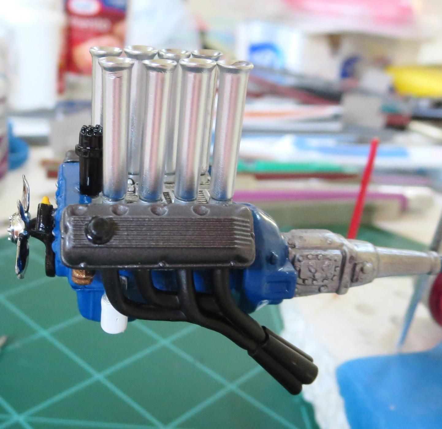

Speedfreak Posted August 31, 2015 Author Posted August 31, 2015 Oh god, maybe I'll just start that Shelby GT-350R kit I'm not sure this 'Super Boss' Mustang and I were ever meant to be mates. As far as engine dimensions go everything seems to line up okay for the tranny etc,. I think part of the problem is that fact that the heads weren't even with the ends of the front cover, (they were significantly lower) , so I had to do some things (I raised the heads with thin stock) to get that surface even so the valve covers would mount. Anyhoo, in that process the angle on one of the heads is off slightly, thanks AMT. And, this is the first time I've built this kit so I have no historical reference here. I think AMT forgot to put one sticker on the box for this kit, it would read " Instant Glue Bomb!
Sledsel Posted August 31, 2015 Posted August 31, 2015 (edited) Not any criticism but an FYI's.... the valve covers are upside down and on the wrong sides. The plug holes should be at the top and the square end always goes in front (as you have them) Also, the distributor is in the coolant hose location. The relief cutout in the timing cover is for distributor clearance. . "I think part of the problem is that fact that the heads weren't even with the ends of the front cover, (they were significantly lower)" I have had that issue and filed the top of the timing cover to match the head. I may try your way on the next one. Looking great. I am working on the Pontiac and did a lot of trial fitting and mods to get it right. Old kit, so I am not complaining about it tho. Edited August 31, 2015 by Sledsel
Old Nasty Posted August 31, 2015 Posted August 31, 2015 What Andy said. Valve covers are upside down. Otherwise, very nice.
Speedfreak Posted August 31, 2015 Author Posted August 31, 2015 LOL, I got it right now, I can't believe I had the distributor wrong, just not paying attention. Thanks for the comments, and , encouragement.

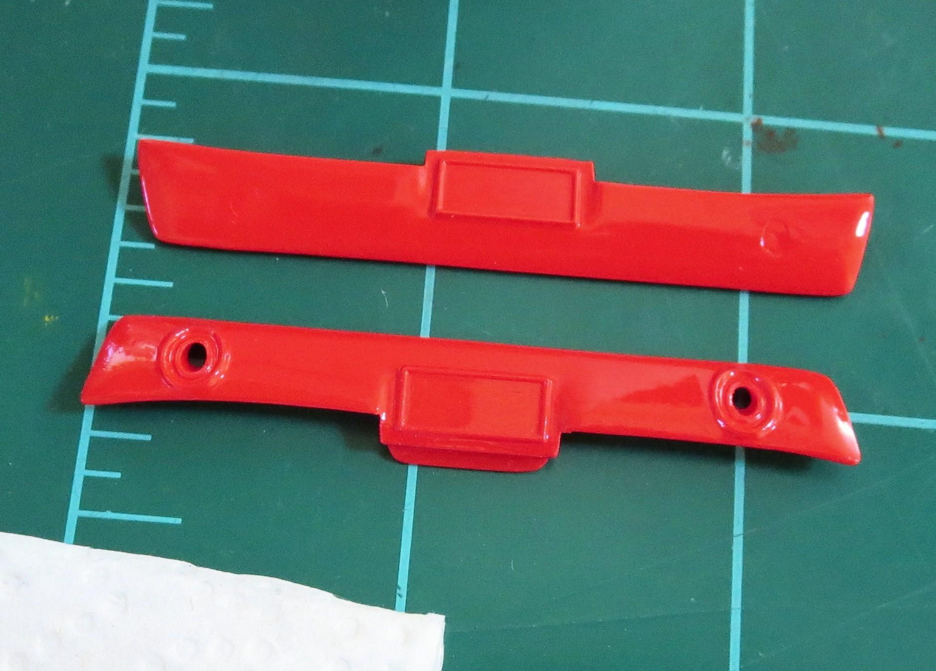

Speedfreak Posted September 1, 2015 Author Posted September 1, 2015 Wow, thanks for the encouragement you guys. Bob, thanks. There are plenty of weird things about the way this car fits together, that make sense with what you say. I think I've got the tub issues solved at least to the point that I put on the body and get things lined up moderately well, I'll find out in a few days! Alan, thanks, glad you're liking it. Ha, ha, on the paint thing! I'm always looking for the easy way out, and , it never works! I had another of these kit, so , I just used the other rear panel and filled it in, not the greatest job but now I know something new. I used to hate the very idea of using putty. I had thought of the plate idea too. Ace, I got those tabs in for the rear valence, (redid both the front and rear) , it looks like it's going to work. Then it will be time to polish the body. Here's the most recent progress shots: Here's the panels and the engine:
