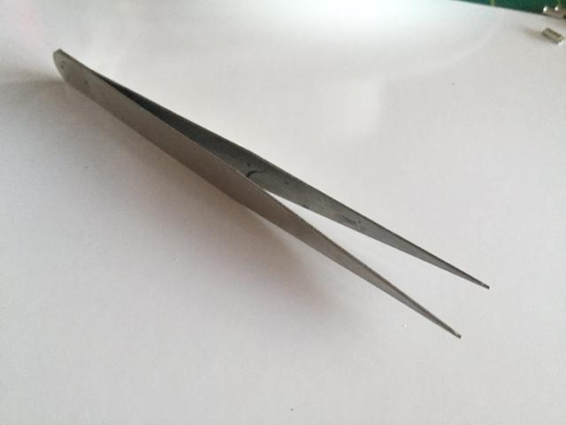

aurfalien Posted September 20, 2015 Author Posted September 20, 2015 (edited) Cool deal SfanGoch, I forgot about that site. As for rivets, I'd like to use up what I got and will prolly end up using Grabit Sticks to manipulate em. As for tweezers, I picked these up for $.99 and bend, sharpen, etc to taste. They are hard enough yet soft enough to change shape when needed. Right now they are sharp enough to draw blood if careless; Edited September 20, 2015 by aurfalien
