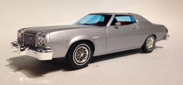

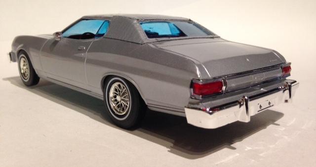

Porscheman Posted October 7, 2015 Share Posted October 7, 2015 (edited) Got my 2nd S&H Torino yesterday and I just couldn't wait. I primed it with Tamiya grey primer and then Tamiya silver Mica, followed by 3 coats of Testors Wet Look Clear. The interior is painted with Rustoleum Merlot. I added a masking tape split vinyl top painted silver. I lowered the suspension to stock and added AMT's Whitewalls parts pack with some spare parts box wheels. I have to add BMF, Headlights and side markers, etc. How does it look? I value your imput. Al Edited October 8, 2015 by Porscheman Quote Link to comment Share on other sites More sharing options...
1zebra3 Posted October 7, 2015 Share Posted October 7, 2015 NICE! What did you do for engine? Quote Link to comment Share on other sites More sharing options...
Dave Van Posted October 7, 2015 Share Posted October 7, 2015 VERY COOL!!!! that's how it looks!! Quote Link to comment Share on other sites More sharing options...
chunkypeanutbutter Posted October 7, 2015 Share Posted October 7, 2015 The top doesn't look good, but the rest is stellar. Quote Link to comment Share on other sites More sharing options...
Porscheman Posted October 7, 2015 Author Share Posted October 7, 2015 The top doesn't look good, but the rest is stellar.Thank you for your opinion on the top. I'm going remove it tomorrow and try another material for the top. Thanks for the nice comments.Al Quote Link to comment Share on other sites More sharing options...

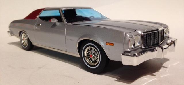

Porscheman Posted October 7, 2015 Author Share Posted October 7, 2015 (edited) Thanks everyone for the nice comments. Per your suggestions, I changed the vinyl top material to 3M Masking Tape and painted it the same color as the interior. I'll start the BMF as soon as the top drys. How does it look? Thanks again for your help. Al Edited October 7, 2015 by Porscheman Quote Link to comment Share on other sites More sharing options...
Mr. Metallic Posted October 7, 2015 Share Posted October 7, 2015 The color combo looks great.May I suggest adding some thin trim around the vinyl top, made out of Evergreen? It will give you a nice clean break and give you something to put the BMF on. Quote Link to comment Share on other sites More sharing options...
Sledsel Posted October 7, 2015 Share Posted October 7, 2015 (edited) Looks better with the contrast. FYI, The vinyl should go all the way to the 1/4 window trim though. Yours looks similar to what a 72 or 73 has. Nice part is, with the tape, it can always be modified. When happy, add the trim. This will help with your shape on the bottom Edited October 7, 2015 by Sledsel Quote Link to comment Share on other sites More sharing options...

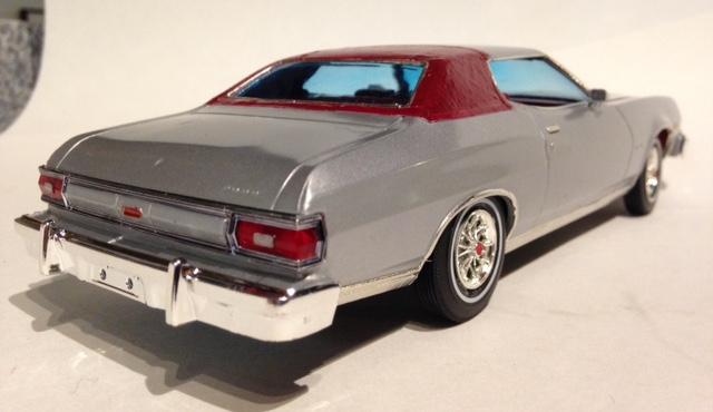

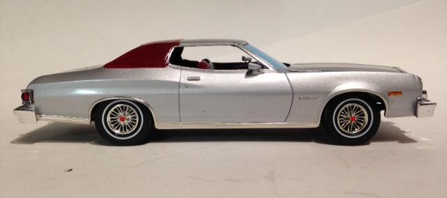

Porscheman Posted October 8, 2015 Author Share Posted October 8, 2015 I want to thank everyone for helping me with my Torino without opera window. It's done and I think it came out pretty good. Let me know how it looks. Al Quote Link to comment Share on other sites More sharing options...
Dave Van Posted October 8, 2015 Share Posted October 8, 2015 Two thumbs up! Quote Link to comment Share on other sites More sharing options...
SSNJim Posted October 8, 2015 Share Posted October 8, 2015 I like it - looks good. At first, I thought it needs a red vinyl top. Silver with a maroon/red top was a pretty popular combination back then. I'm glad you changed it.How did you lower the suspension, and by how much? I'm working on a non-S&H version myself. It won't be stock, though. Still working out the details. Quote Link to comment Share on other sites More sharing options...
mikemodeler Posted October 8, 2015 Share Posted October 8, 2015 I am usually a fan of silver (half my builds tend to end up in that color) but somehow I remember a lot of these being earth tone colors (brown, green, tan). Nice job and done quick! Maybe the silver will grow on me..... Quote Link to comment Share on other sites More sharing options...
charlie8575 Posted October 8, 2015 Share Posted October 8, 2015 Nice. Very, very nice.Charlie Larkin Quote Link to comment Share on other sites More sharing options...
Ron Hamilton Posted October 8, 2015 Share Posted October 8, 2015 The car is quite handsome, but you need to add the trim to the vinyl roof to give it some depth. Quote Link to comment Share on other sites More sharing options...
espo Posted October 8, 2015 Share Posted October 8, 2015 The top looks great either way, just different styles. A coworker years ago had a Buick from the late '60s with the silver body and vinyl roof and I thought it looked good. I think the maroon roof would look a little more realistic with maybe a light coat of flat or semi- flat clear. Great build either way. Quote Link to comment Share on other sites More sharing options...
