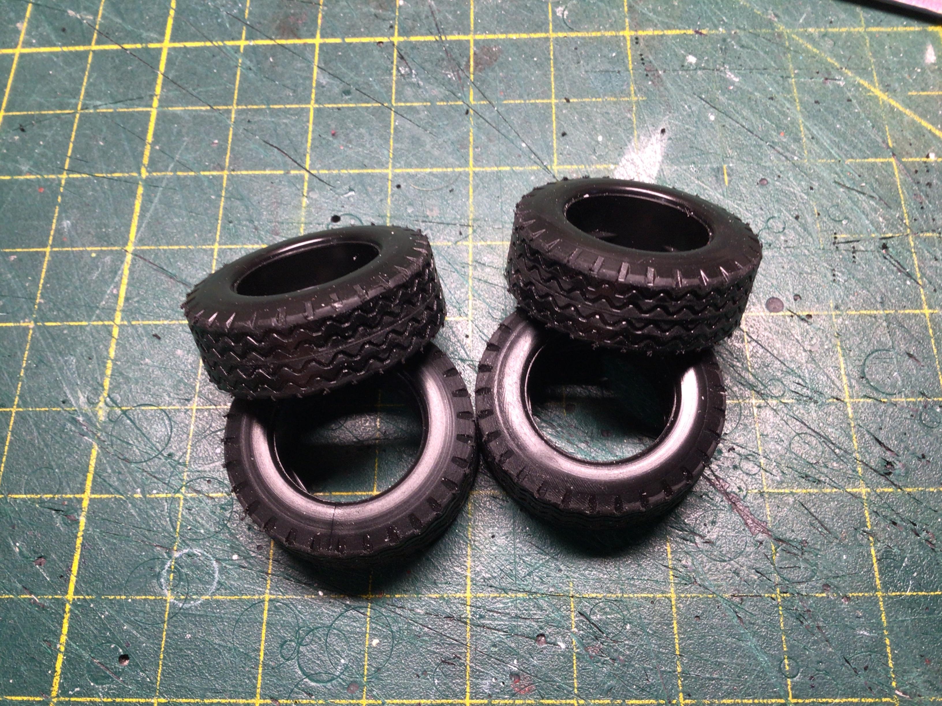

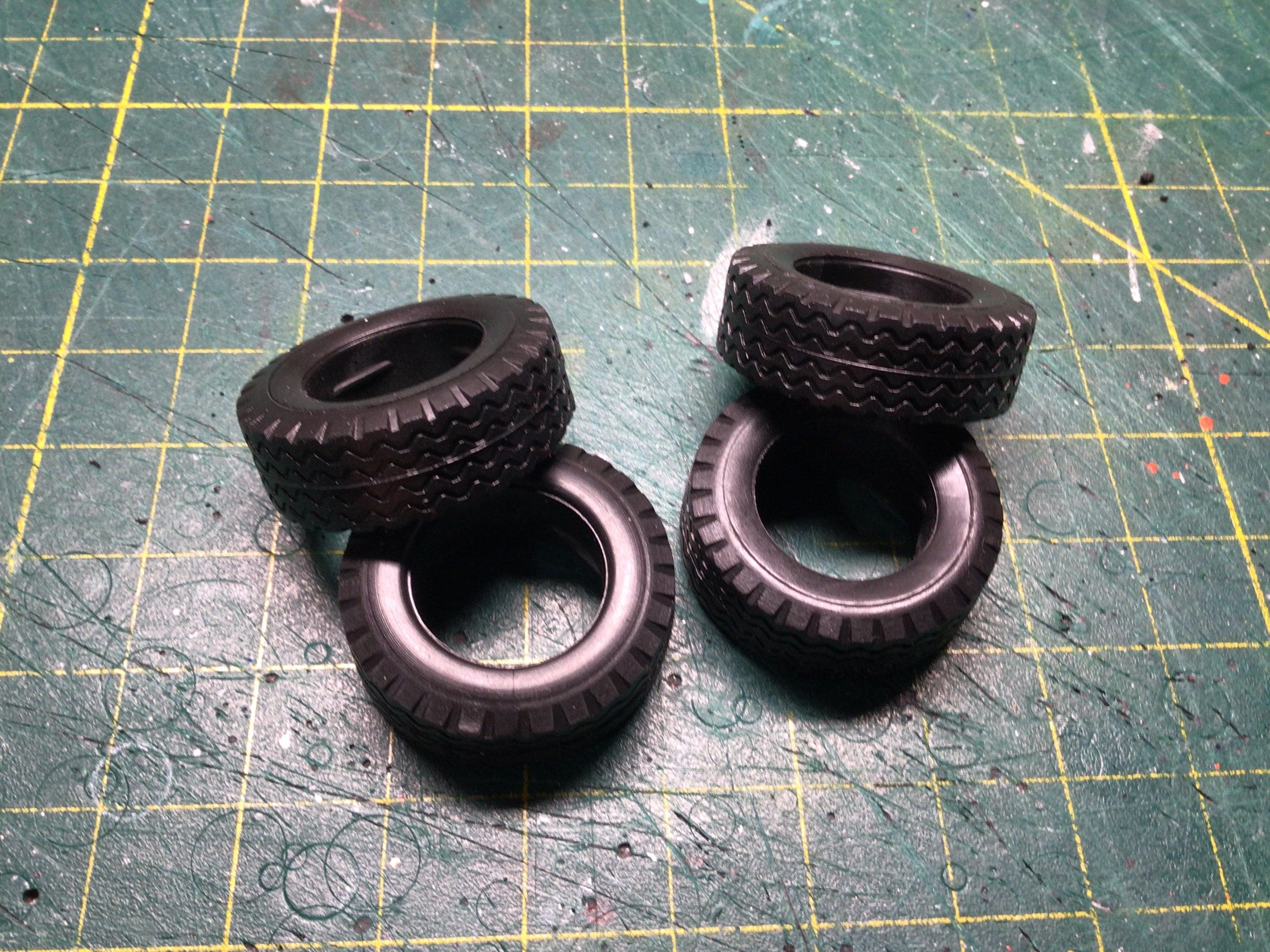

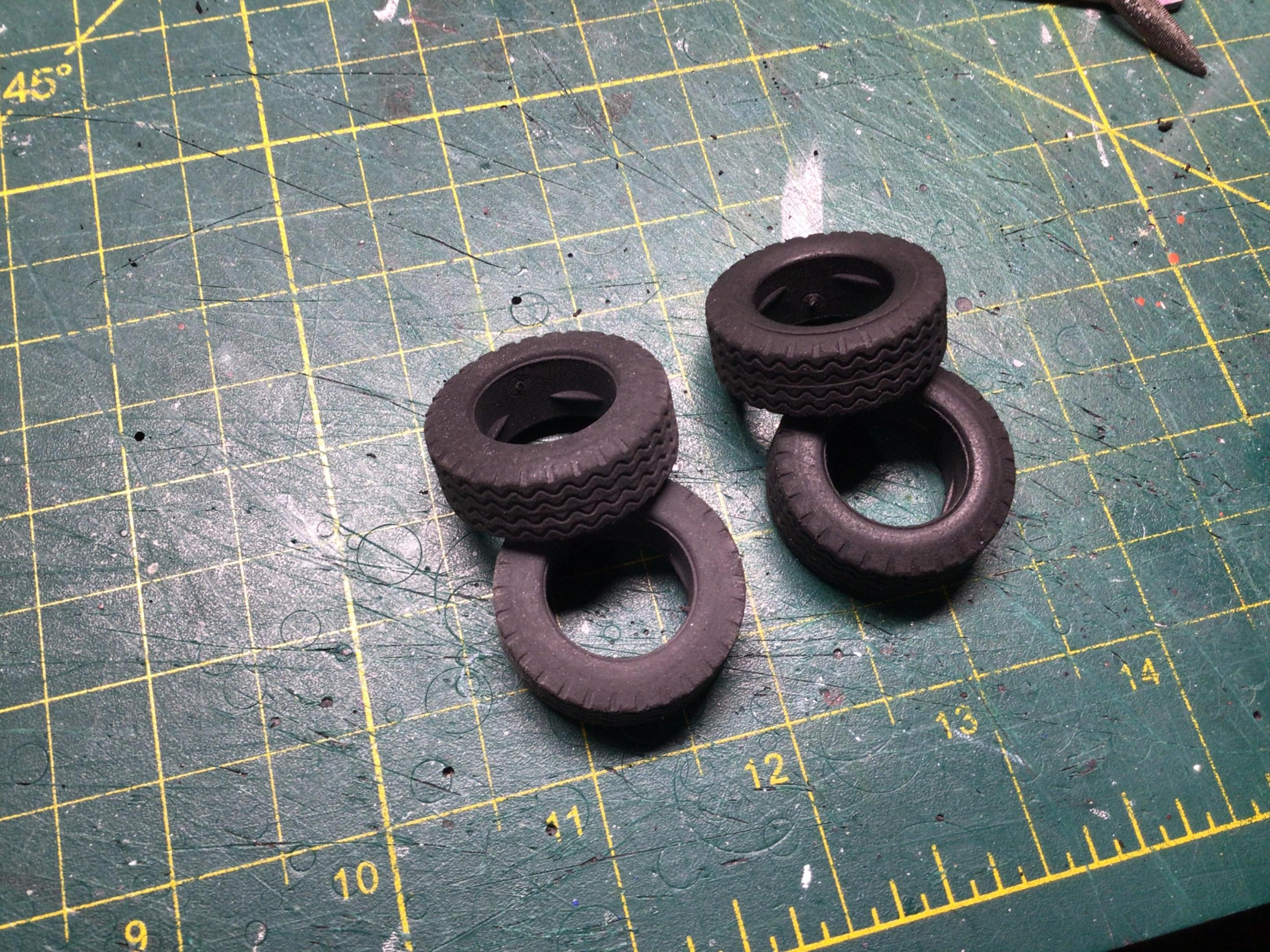

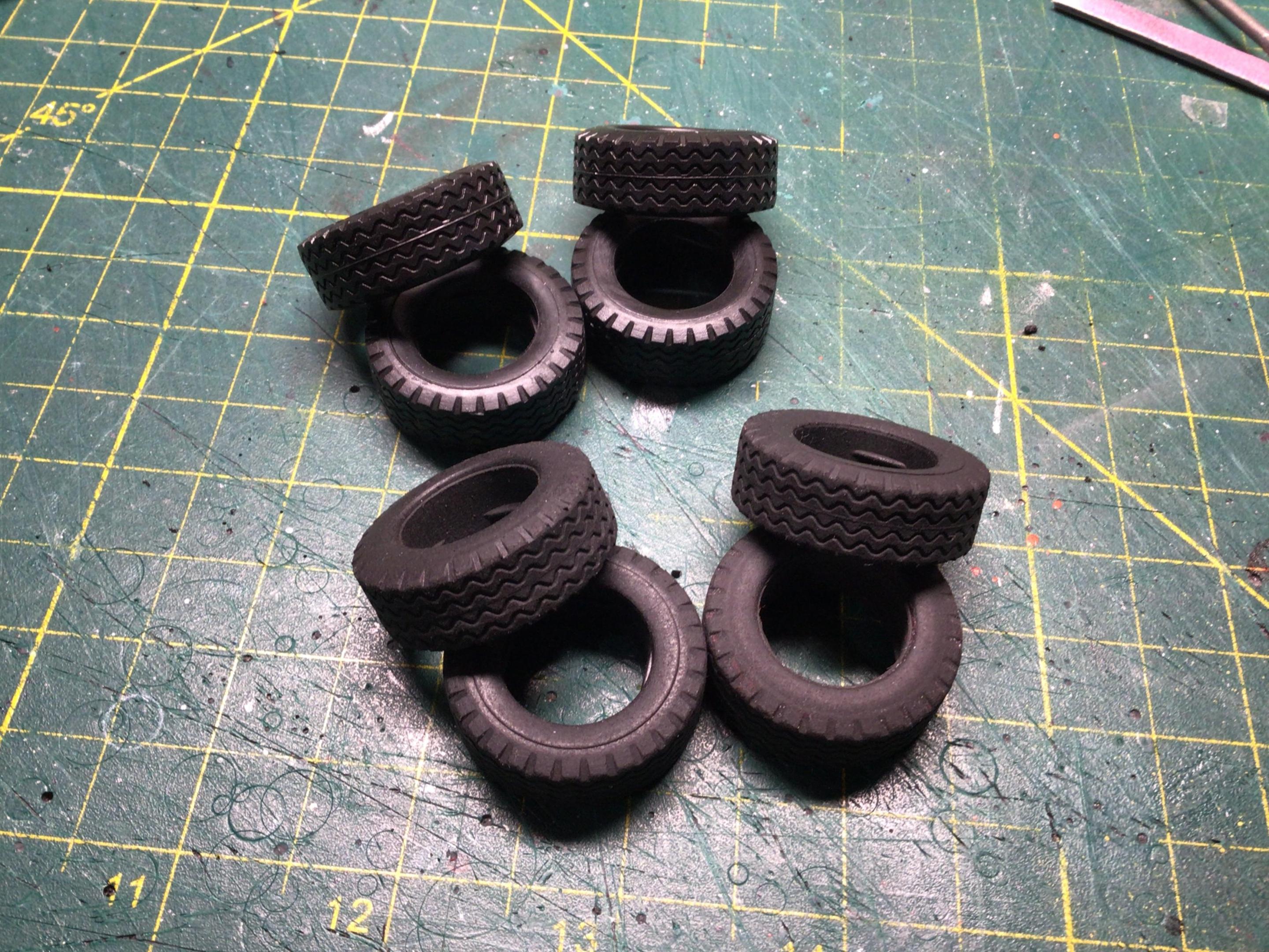

NOBLNG Posted April 16, 2022 Posted April 16, 2022 On 2/9/2016 at 9:57 PM, Ace-Garageguy said: A builder of spectacular truck models (whose work I'm pretty sure I saw on this forum) uses a glass-bead blaster to take the shine off his sidewalls. His truck tires are absolutely realistic in appearance. I found this thread after trying my sand blaster on some tires from a Revell Jeep kit. First I rounded the edges of the lugs a bit with a file and took down the center mold seam (not quite enough?). Then blasted them lightly with the crushed glass that I have in my cabinet. 3
Straightliner59 Posted April 16, 2022 Posted April 16, 2022 35 minutes ago, NOBLNG said: I found this thread after trying my sand blaster on some tires from a Revell Jeep kit. First I rounded the edges of the lugs a bit with a file and took down the center mold seam (not quite enough?). Then blasted them lightly with the crushed glass that I have in my cabinet. I've not seen much better than that! Looks great!
