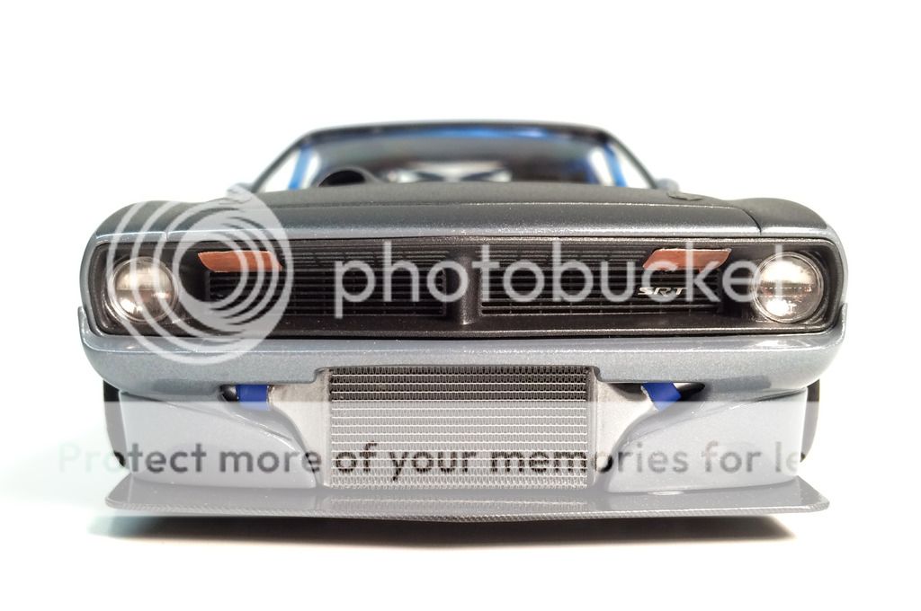

Finally some studio shots... thanks for looking!

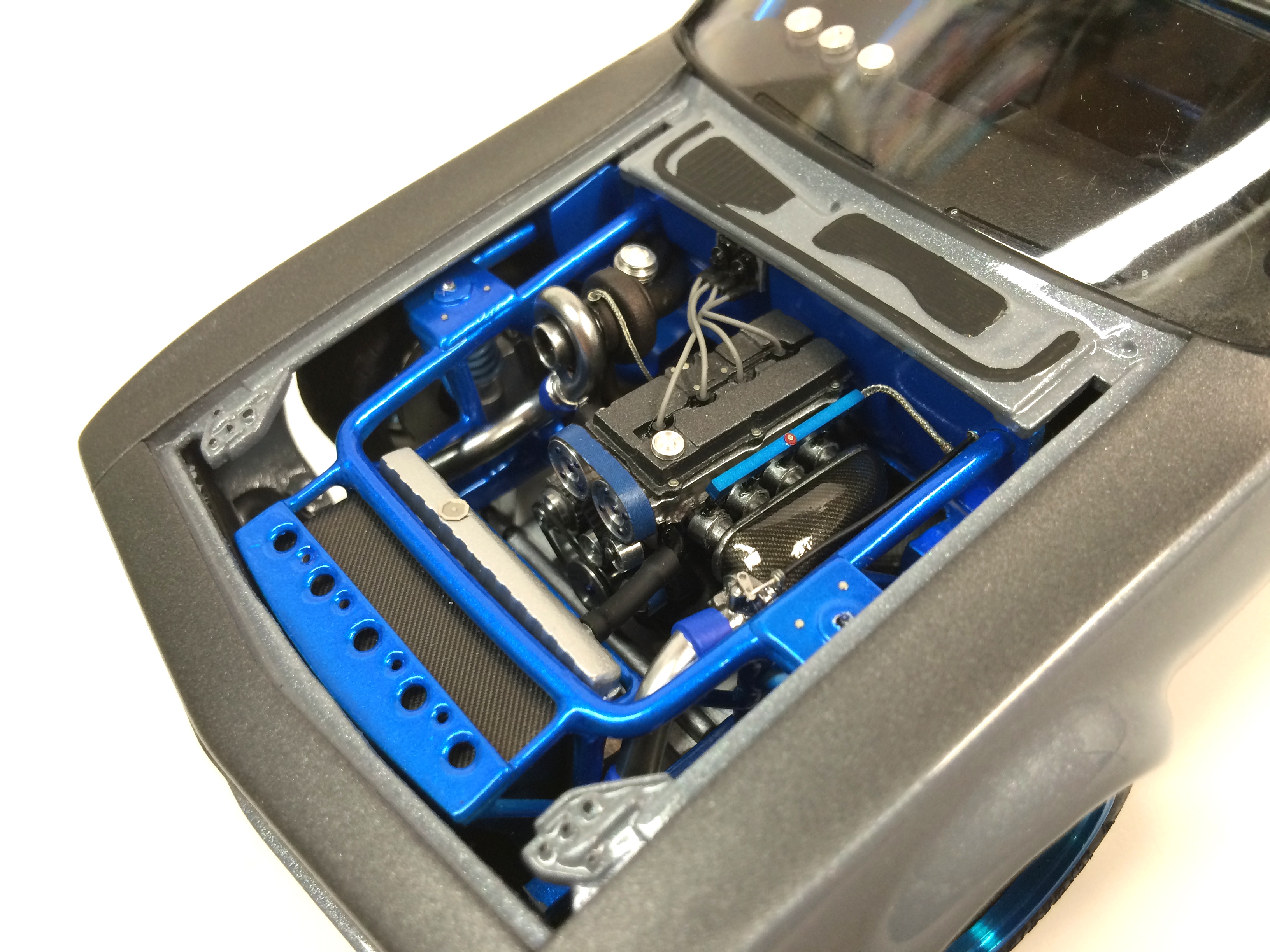

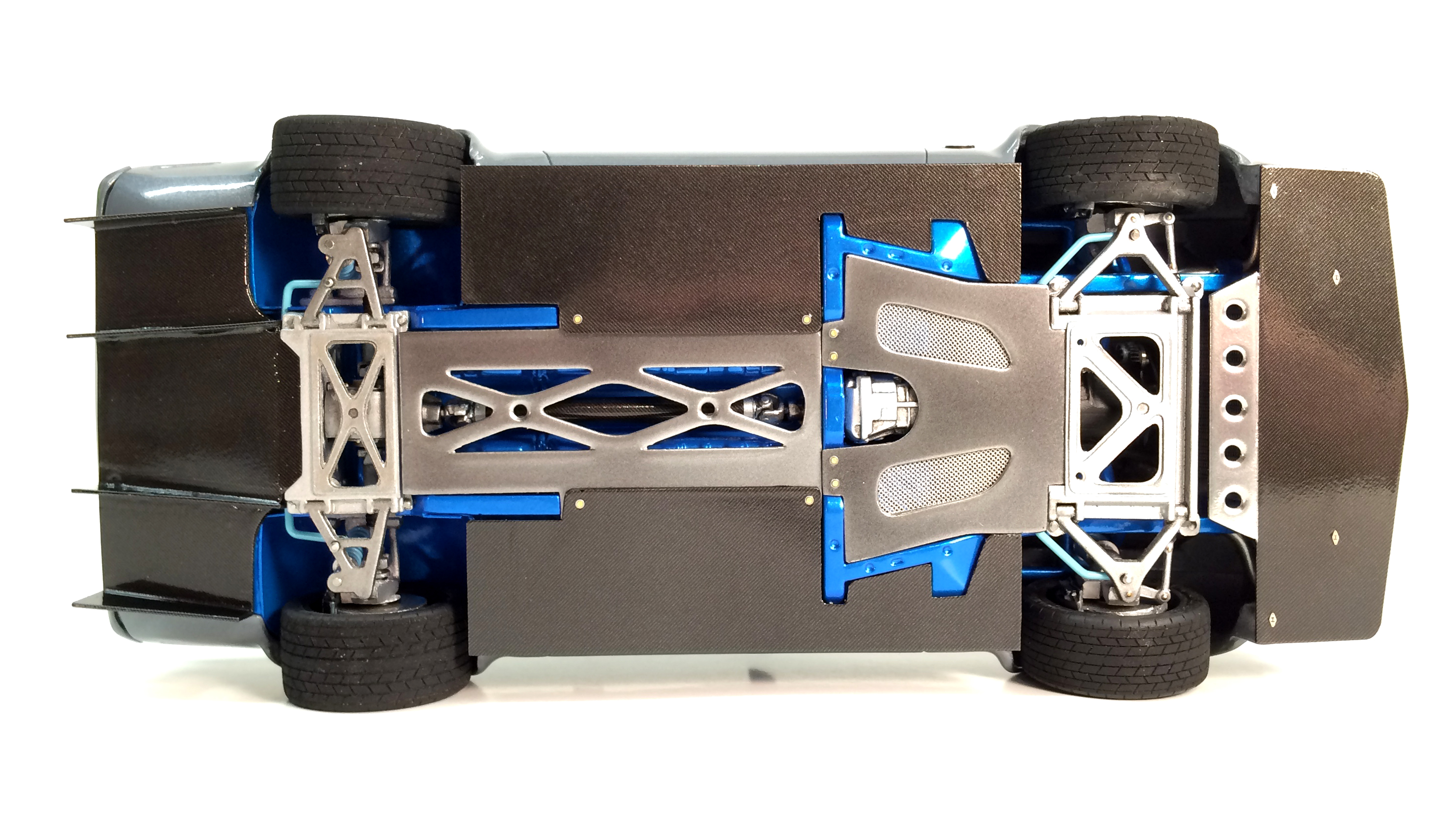

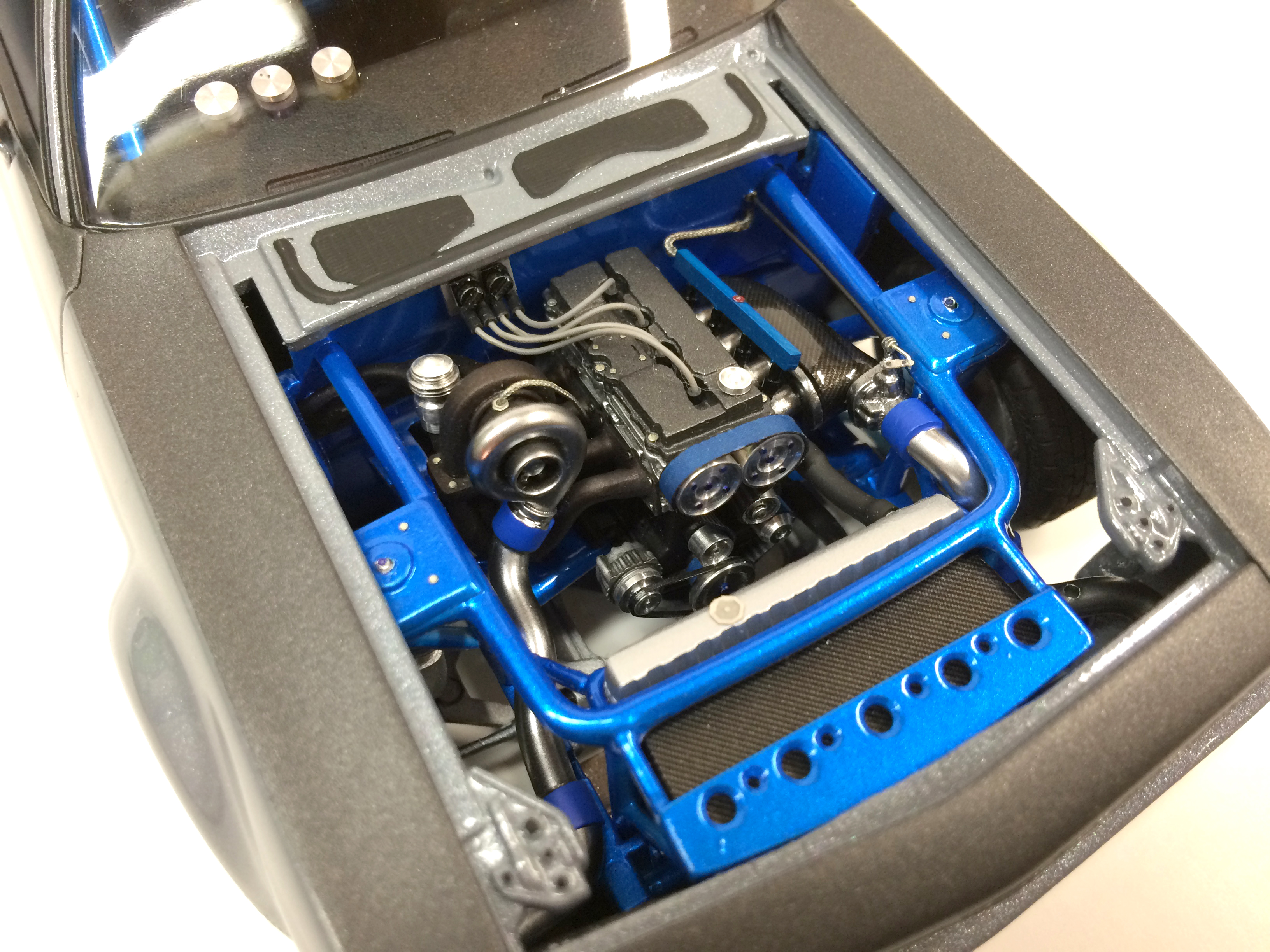

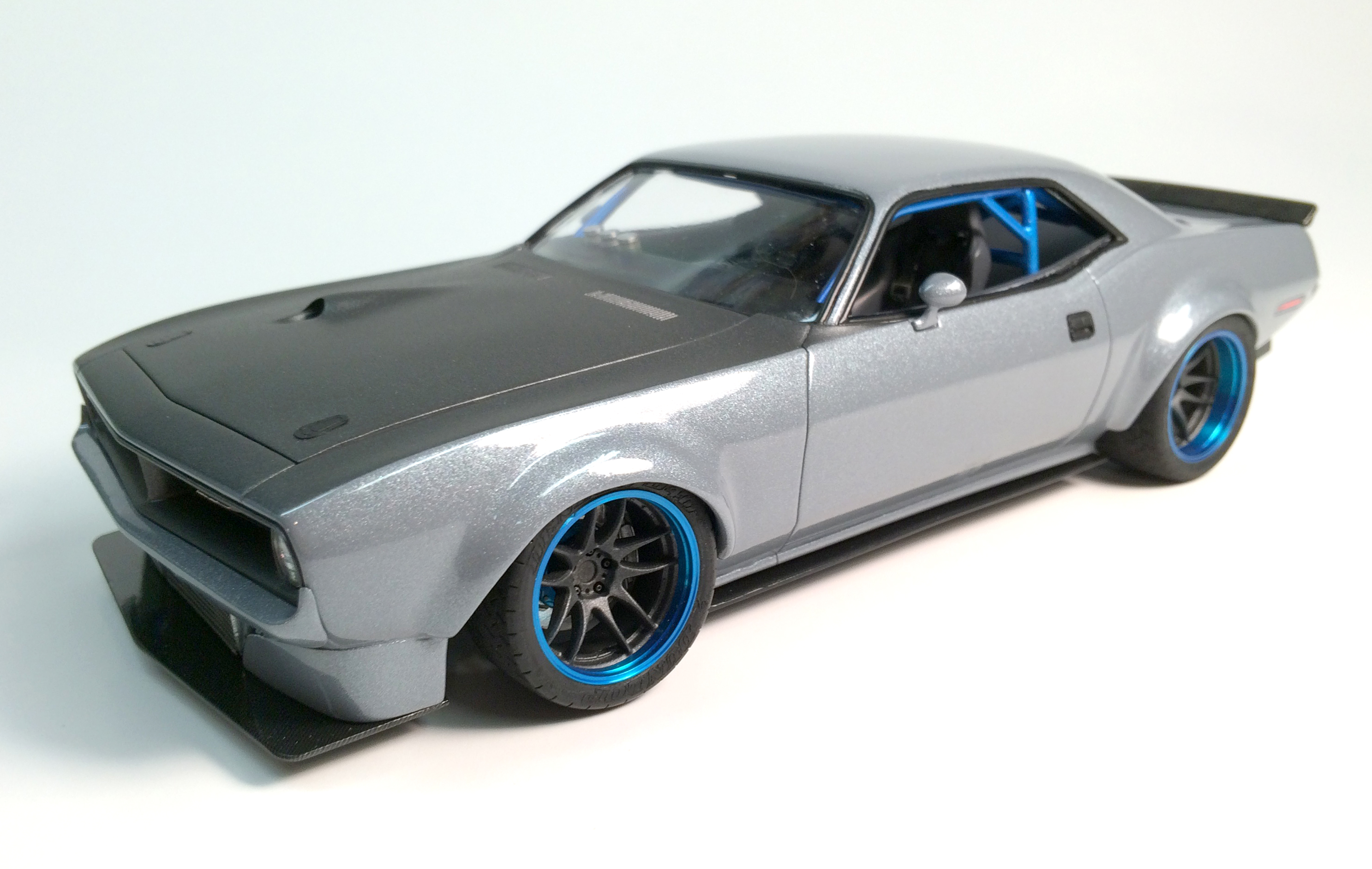

Here is a quick rundown:
  • 3d printed Neon SRT4/ PT Cruiser Engine -  the block, head, cam cover, intake plenum and oil pan were 3D printed the rest was scratch-built or machined (only kit parts are alternator, and throttlebody)
  • Full independent suspension from the C5R Kit adapted to the fit tub'ed and massaged cuda chassis plate. Machined shocks and struts.
  • Wheels are Aoshima Work Emotion 18's with custom machined lips. Tires are from the tamiya Porsche 959.  Lips painted with tamiya clear blue.
  • Scratchbuilt roll cage and tube front frame section
  • Smoothed interior tub, reworked dash for Digi-Dash and brake and clutch fluid reservoirs. Resivoirs turned from acrylic rod and filled with tinted future. Clearly Scale ACR seats.
  • Flared fenders from Aoshima hakosuka works kit, molded in, scratchbuilt spoiler, and front air dam.
  • Fully bellypan and diffuser covered in scale motorsports 1/24th scale twill carbon fiber and Alclad polished aluminum
  • Paint is tamiya neutral gray followed by a white pearl mid-coat and then urethane clear. Accents are GunMetal non-buffing metalizer.

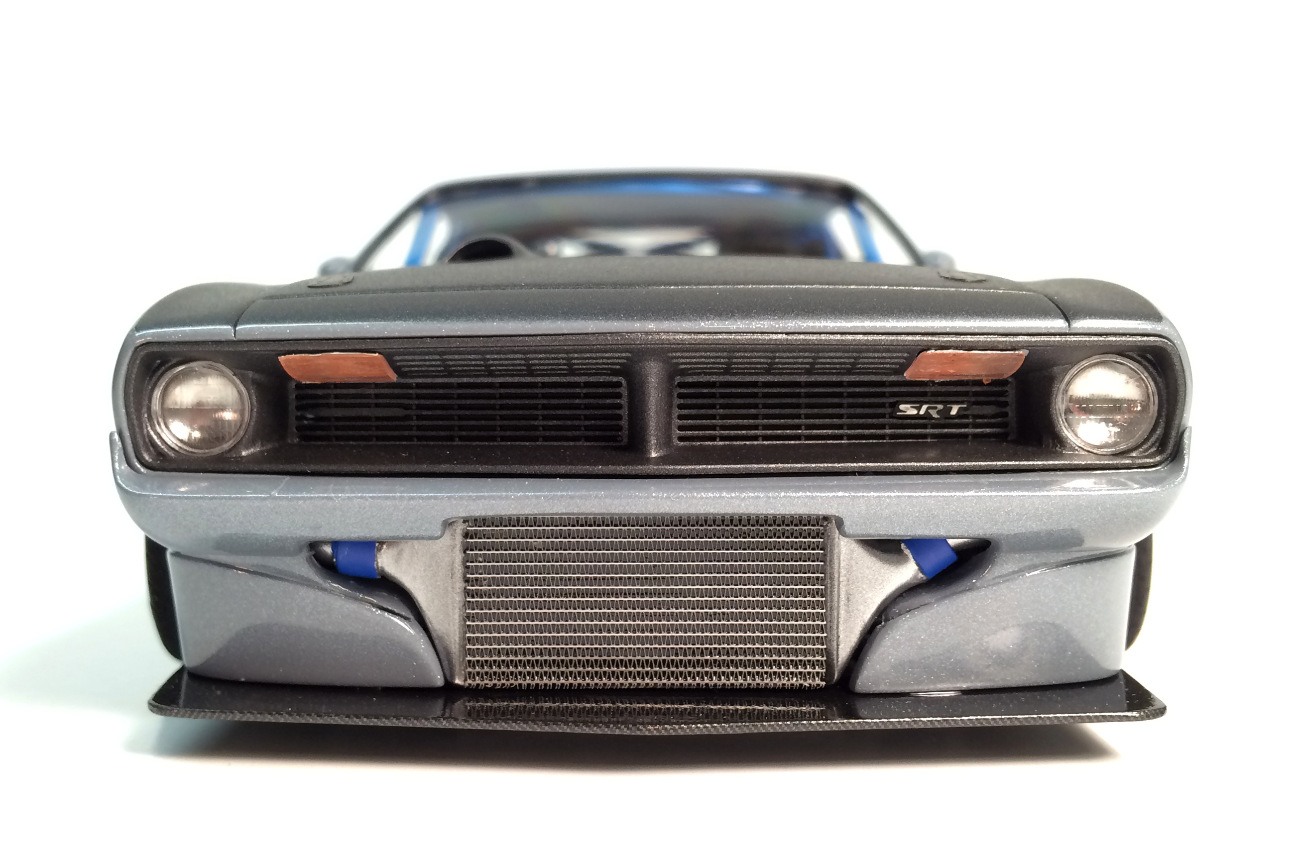

May I ask how you get the Intercooler so detailed?
Sure!   Its a Scale Production intercooler I picked up at a show, but the fins were pretty bad.. so i sanded them off. Primed and painted with alclad polished aluminum, then I brush painted the center section flat black.  After that was dry I cut a piece of the detail master radiator face panel to size, making sure to keep it very very flat.  I then flooded the black area with future and set the photo etched piece in place. Let that dry and applied a few more coats of future to encapsulate it in there. It was pretty easy and worked better than i expected.
Here is a link to the detail master photo etched piece:
http://xtremescaledetail.com/component/hikashop/product/52-detail-master-2490-radiator-face-panels
Edited by Impalow
Link to comment
Thanks so much! I build my own intercoolers but will definitely add the fins like you did! I really appreciate it.
