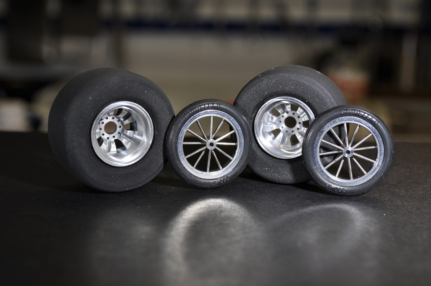

Codi Posted October 14, 2016 Author Posted October 14, 2016 1 down, 1 to go. Assembly should have been a breeze I thought. I made a simple but fairly effective jig to locate everything but it took quite a bit of fiddling with it to get the first together. I'm sharing pics of the wheel next to the kit wheel/tire combo as a comparison. Fining polishing will really bring it to life. cheers, tim You can clearly see how out of scale the kit wheel hub, spokes and rim are.

Codi Posted October 14, 2016 Author Posted October 14, 2016 (edited) Hey guys, thanks much. Here's all 4. They're all drilled to accept tire valves after final polishing. I'll do that last during the final assembly phase. Cheers, Tim Edited January 14, 2019 by Codi

Randy D Posted October 15, 2016 Posted October 15, 2016 Gorgeous machine work on the rims Tim!!!! The style of the rears are something I have not seen before in scale, Love it!!! Those fronts look amazing, I can appreciate the planning that it took to get those angles right.What material are you milling the tires from?Truly impressed sir!Randy
Codi Posted October 15, 2016 Author Posted October 15, 2016 Thanks Chris & DaveWilly. yes, one more thing on the list before I get to the chassis. I have all I need now for proper planning and fitment to start it now.Joe, limericks now huh? That got a loud hearty chuckle from me. Keep em' coming. Thanks too Randy. The front rims, after assembly and removal from the jig were centered and didn't require any glue to hold the hub in place whatsoever. It was that tight of a fit and the angles I got lucky on. I did add a little glue just to be sure of course. The front tires are kit bashed and the rears are modified compresin tires. I've still got a little more sanding and finessing the slicks yet as they're just a shade too wide and the sidewalls need a slight correction. Close though. When will we something soon from you btw?

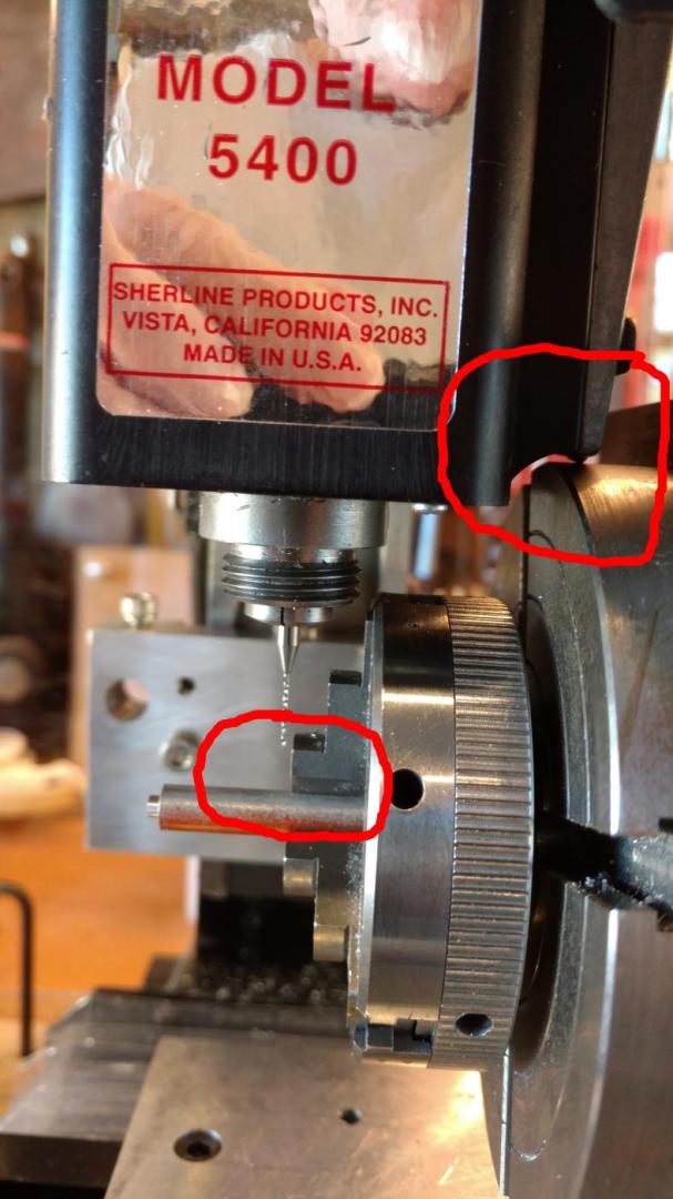

Pete J. Posted October 16, 2016 Posted October 16, 2016 Ok, I will try to bring this back on track. This is a photo of an issue I ran into with my mill. With the rotary table mounted on the angle plate I have a clearance problem with the motor mount on the right side of the mill head. This only happens when I am using end mills that require the use of a collet to hold them. You just can't lower the head far enough to make contact with the part. I am bring this up to you because I discovered something. As you probably already know the rotary table can only be mounted one way on the angle table and that is to the right. Well, Shurline will custom make a rotary table with the controls on the other side so you can mount is on the left side of the head and avoid this issue. They don't charge extra for it, but it is definitely not in their catalog. You have to call them and order it special. If you ever run into it, you know they have the solution.
